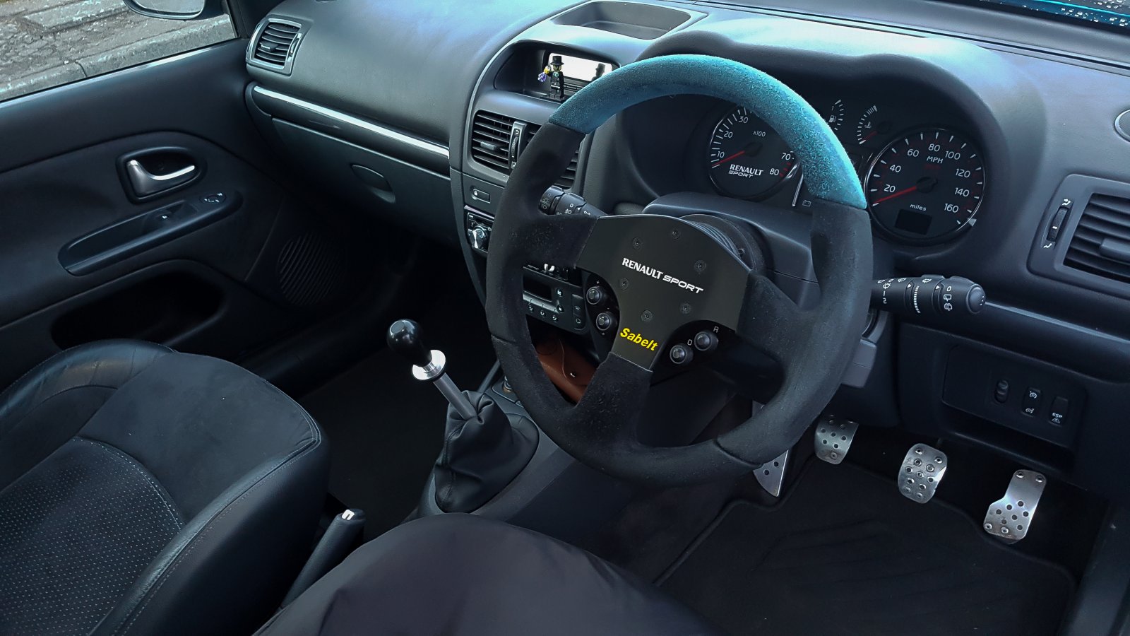

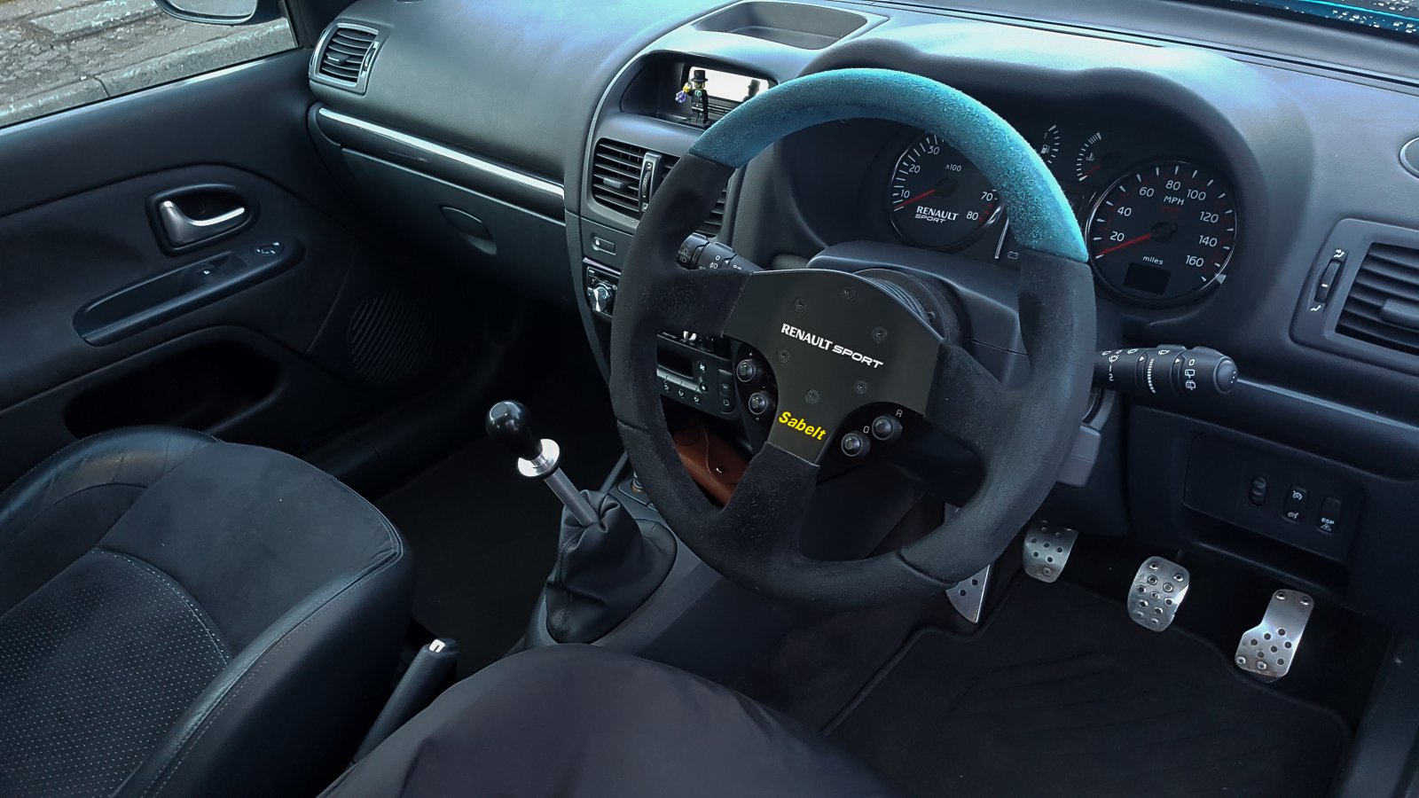

Gave the Sabelt a clean today. Well i tried the best i could. Unfortunately its lost quite a bit of colour but its a lot better now than it was before i started. It will do until i get it retrimmed. I do love the wheel and even more so now that they have been discontinued, so its worth keeping it now. Will look great once its retrimmed, but unsure when that'll be.

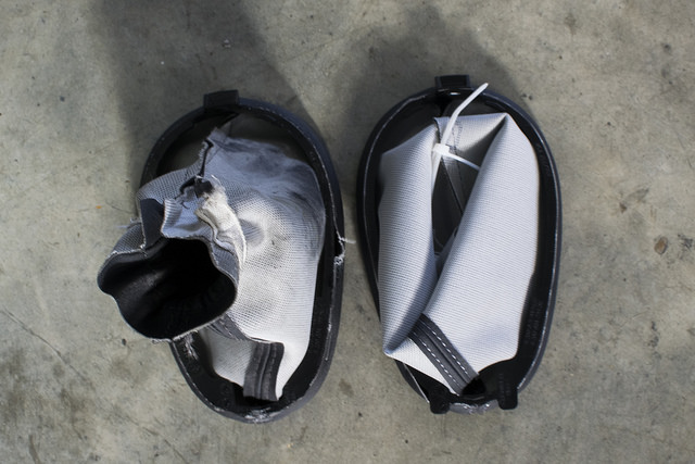

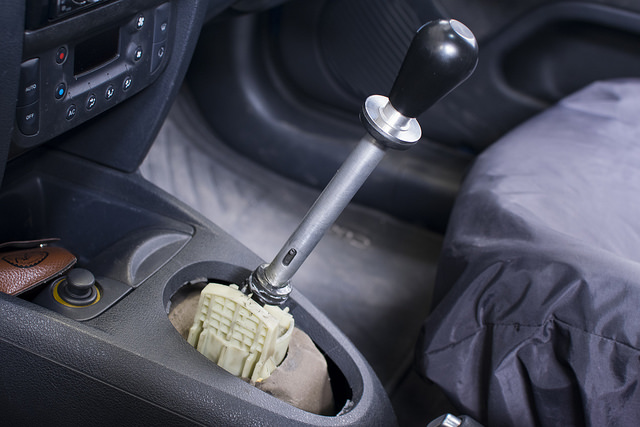

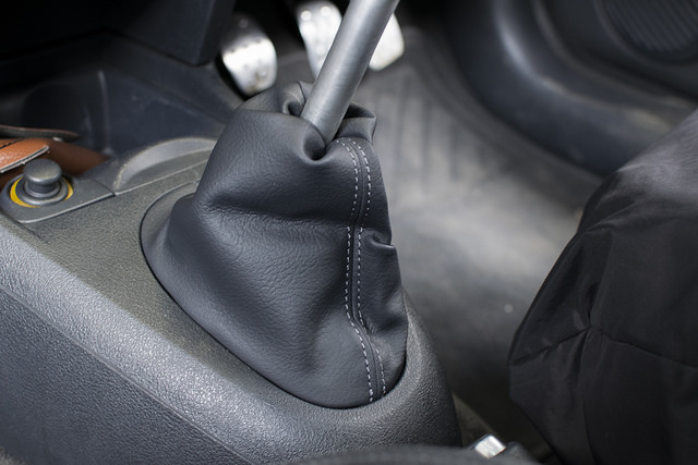

Part 2..... Done! Well 99% so all but.
Fitted the new gaiter today.

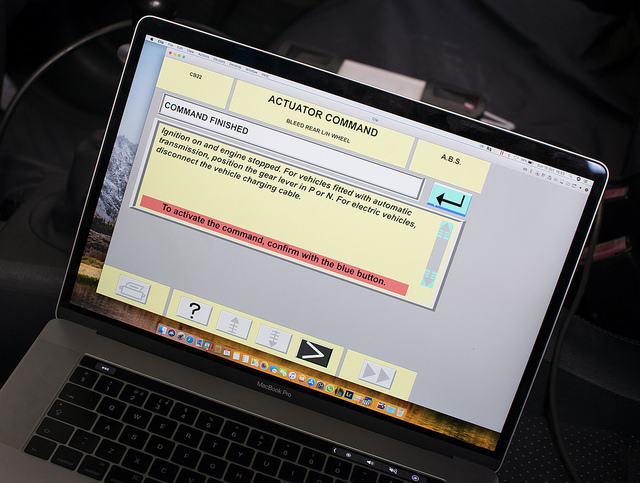

@MrBlonde came over to clean hes car and help also. Then @.Joe turned up and after a coffee and chat we got to work. CLIP plugged and and Joe doing there work while i bled the system and Steve topped up the fluid.
Had a few issues, mainly the new nipples for the rear was too loose. I think they was too long as the thread was the same. Luckily i kept the rears from the new 2nd hand calipers so we fitted those and bled the system again. All was good. Fitted the wheels and drove it out the workshop but heard a knocking. Sounded like the top mounts, then i realised i only nipped them up and forgot to tighten them fully. (I did this because they was fitted while the car was on the ramp and it hadnt been lowered on the ground with the wheels on until now.) Got out the 7mm allen key and 24mm spanner and jobs a good 'un. Car felt good around the farm, but brakes a tad soft. With that, we packed up, locked up and headed home.
Car drove great on the way home. The steering is a bit heavier than before but feels really good. Nice and tight. I was imagining a harder ride but i can honestly say, it didnt feel like that at all. Im really happy and was well worth the choice and purchase of them all :smile: Brakes are a little spongy. They stop which is good but there may be a small amount of air in the system so i'll do another bleed during the week. New shocks should be here too so may kill 2 birds with 1 stone. I will tackle the heater, seat and sidelight bulb change (Passenger side is out) at the weekend or later in the week, maybe friday?

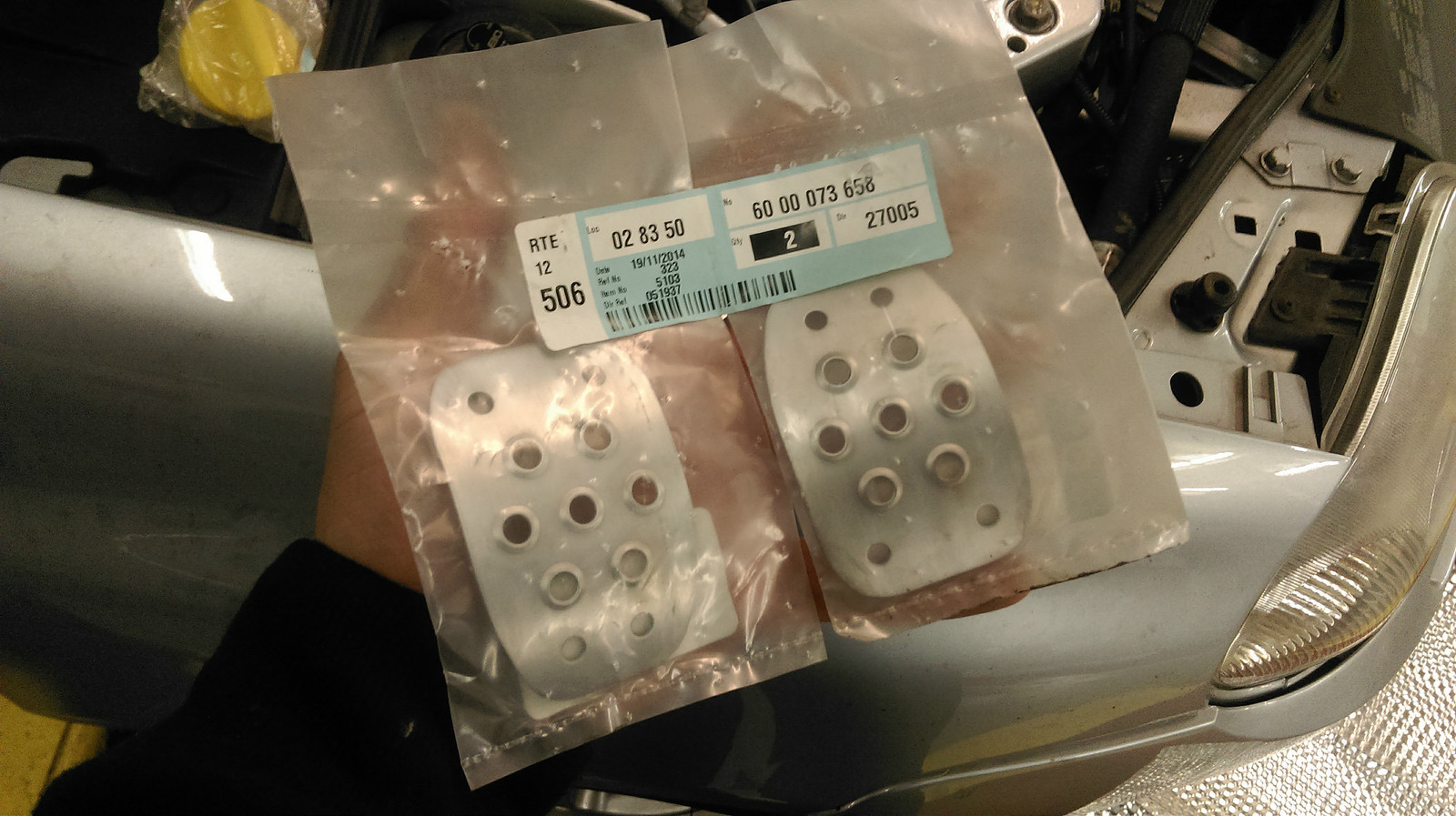

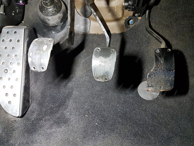

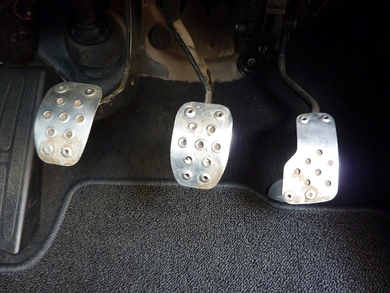

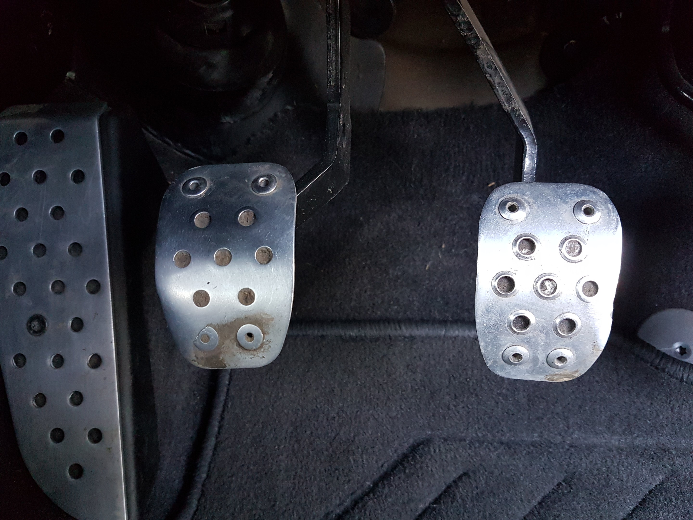

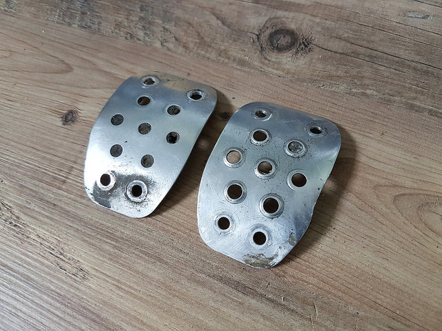

These are my current pedals:
As you can see, they have the standard chewing effect! Well tbh, the car is on 121k so that is to be expected!

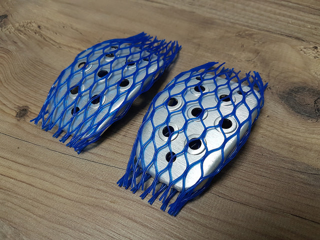

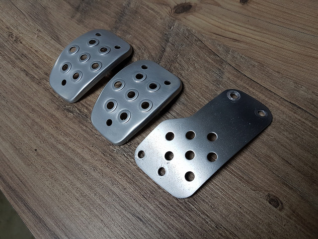

I've just bought these:
https://www.ebay.co.uk/i/281366463029
Now they aren't the fully correct ones as you'll notice they have 3 rivet holes and my current ones have 4 rivets holes.
This is the part number for the originals:
However Renault have discontinued them since 2015 and nowhere has them. Not even on OLD stock. The ones I've bought are for a 197/200 and are the closest you will find to the originals. They are also genuine parts, but a copy. Now once I drill out the old rivets and drill a new hole for the center of the new plate and fit it, you would never know there was originally 4 holes as the plate covers that.
The throttle pedal plate can still be bought though, although mine is in good condition so I will remove it and give it a clean and replace it with new rivets when I do the clutch and brake pedals.

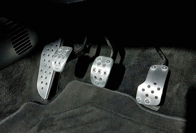

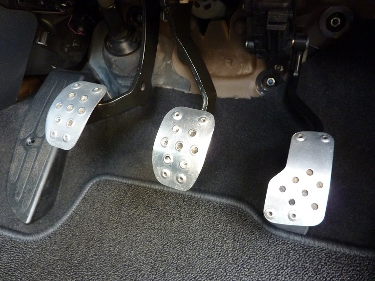

Well i got the new pedals fitted. As mentioned above, these are from a 197. @MarcB has looked into this quite well and has kept me in the loop. They are the same fitment and the top holes line up, but you have to redrill the lower hole. These are genuine items, and we've both noticed they have now gone up in price. Anyway, thanks to Marc for all the info you did :up:
I removed the old ones, painted the actual pedal bases with some black paint and cleaned up my existing throttle pedal plate. Fitted with all new rivets and jobs a good 'un.
And out with the old!
Gave the RB another brake bleed and there was air in the drivers rear. All sorted now and the pedal feels better :up:

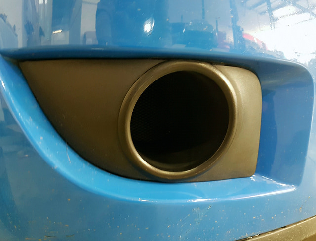

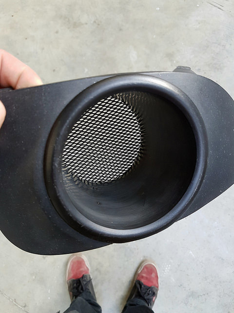

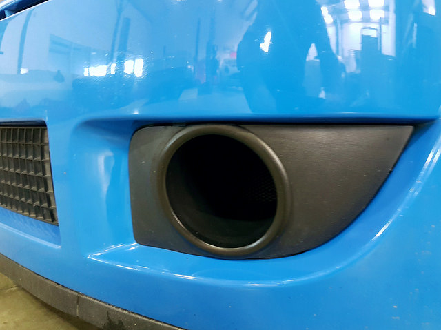

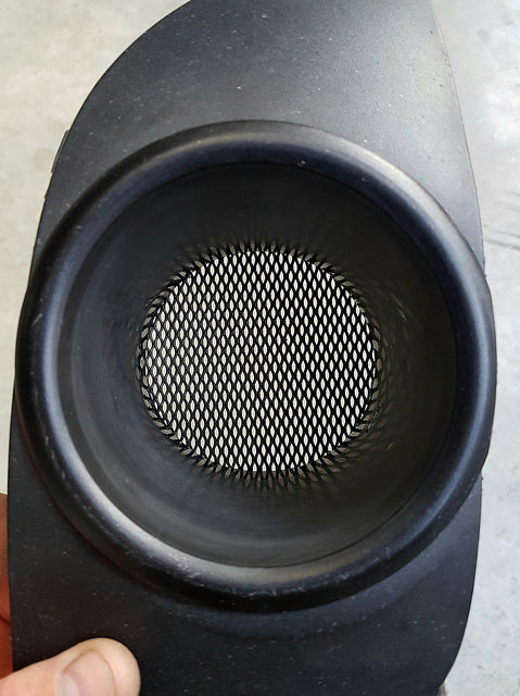

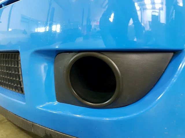

Decided to change the fog ducts, again. After a while, i decided i didnt like the look of the mesh so up front and with the surround so i took the old ones out, and just fitted new mesh to the rear of the bass ports. Gave the inner parts of the ports a quick 2000 grit to remove the old glue. Will give them a proper clean up at a later date.

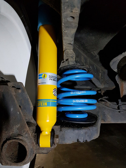

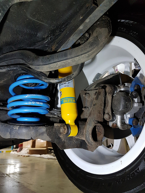

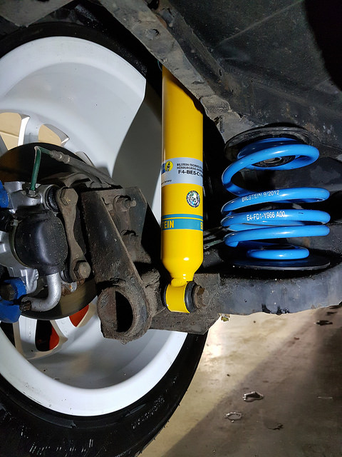

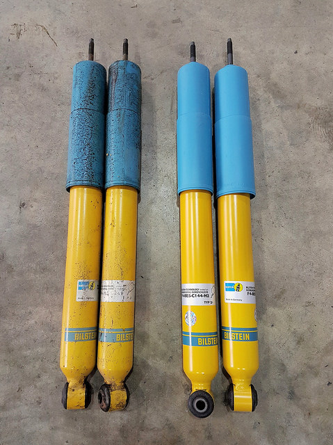

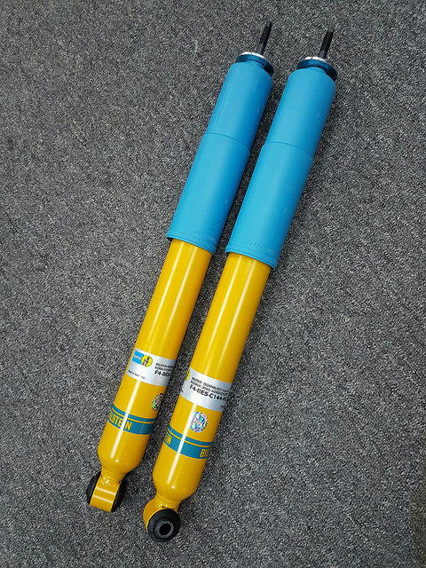

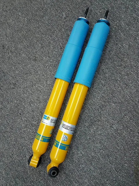

New Bilstein rear dampers turned up.
As you can see, these turned up with new covers. Ive not long just bought some at £35! Oh well, at least i have spares.
Went ahead and fitted them and gave the springs a clean too.
Now when i had the old ones side by side i compressed them both and it didn't seem that much different between the 2. But after fitting, i felt a big difference. The new ones are much firmer, noticeable straight away, but most of all, they don't seem to knock. I will do more driving to clarify.

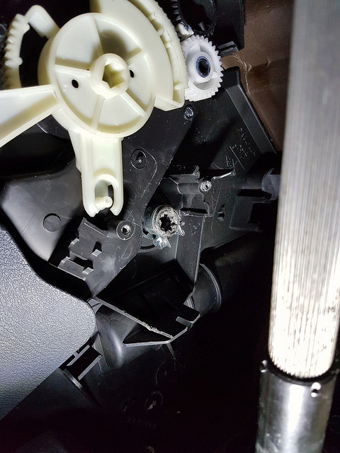

Investigated the heater issue but i think i need a new blower setup as mine is chewed. I swapped for a jubilee clip but i think its just fucked! Will be on the hunt for one soon.

What the problem is steve, is the 2nd spline on the motor doesn't fit into the spline pictured. The mortor itself works fine and i actually had it blowing cold as it should when i was tinkering, but once it moves round, it must push the motor spline out. Unfortunately, no matter how hard I push, it doesn't sit in the spline as it's to chewed which you can see above. I even tried to Dan some superglue to hold it and it worked fine for a bit then gave up. Admittedly it was on the edge of the spline anyway so it wasn't fully pushed in, but was worth a try!
Whatever that part is, is the part I need.
Ahhh I see yeah that makes sense :up: do you think that's something that can be bought on it's own? Or needle in a haystack job? I never looked into for mine so would be interesting to know!
