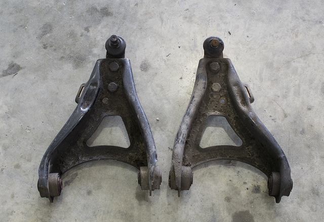

How much were the genuine wishbones mate? Thinking of getting a pair in the future.
I paid £126 from Renault Wolverhampton by buying them separate as i didnt see the pair in one sale, however ive jsut seen this so a couple of quid cheaper from the same guys :)

I paid £126 from Renault Wolverhampton by buying them separate as i didnt see the pair in one sale, however ive jsut seen this so a couple of quid cheaper from the same guys :smile: Me? Pics? You sure you got the right guy? :tonguewink:

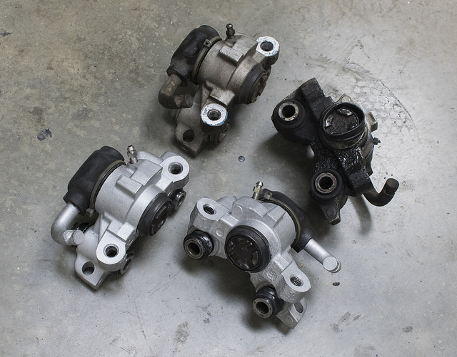

Weird about the rear calipers failing, never heard anyone have that problem, always seems to be the fronts.

I have no idea bud. Oddly the ones I linked say there for a ph1, the ones I bought say there for all models of 172/182 yet the part numbers are the same.

Rear is very rare. That was part of the reason of getting second hand rears. Plus new reconditioned ones are £100+ each.

£126 Pair of genuine lower arms

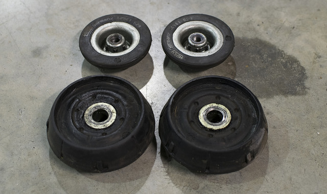

Didnt you remopved the unibal solid top mounts already and have now the drilled holes there with standart topmounts? Why you wana change now again back to solid topmouns?
Jekyll

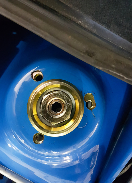

I did yes. When I bought the car, it came with Ktec solid top mounts which I sold as it was easy to make money back. I then bought aftermarket Febi ones, which are ok. They do creak however, when the car is stationary and I'm turning.

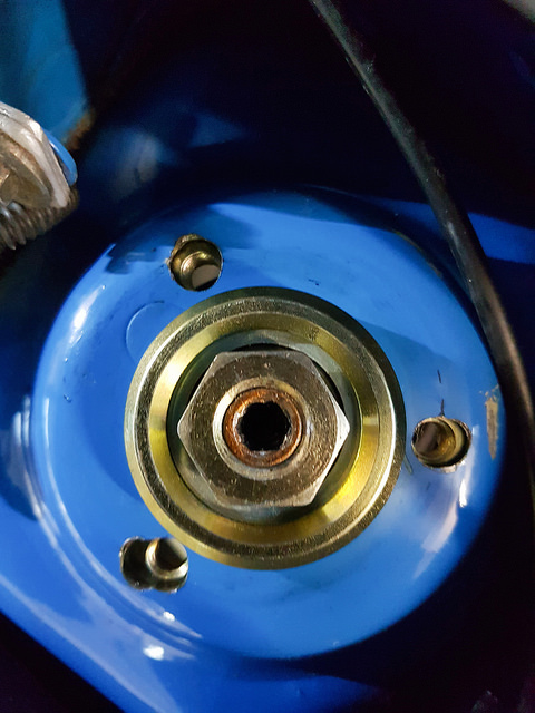

Whenever I lift up the bonnet, is see the 3x drill holes from where the old mounts were and I hate that with a passion. I like the turn in feel of solid top mounts so I opted to buy new PMS ones which I'd thought about doing for some time.
We shall we how they are but I think they'll be better with the bilsteins I have over the Ktec mounts and Cliosport springs I had before.

I went from k-tec mounts to PMS, couldn't actually notice any difference apart from the KTec ones come with a nicer top plate if you don't have a strut brace. Luckily the holes were in the correct place so fitted straight in.
This is good to hear. When i spoke to Nick, he said the difference in PDC between the PMS ones and the Ktec ones was 1mm. Yes the Ktec ones look better, but i didnt want to spend another £200 so opted for the cheaper PMS ones. Plus i wanted to try them as i had the Ktec ones before, although that was combined with Cooksports.

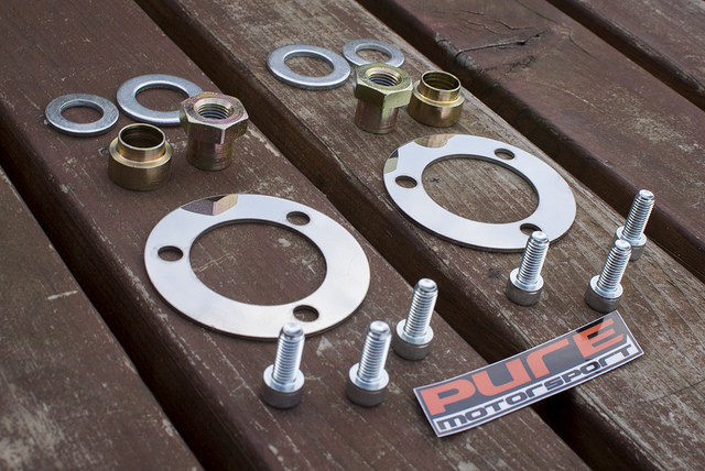

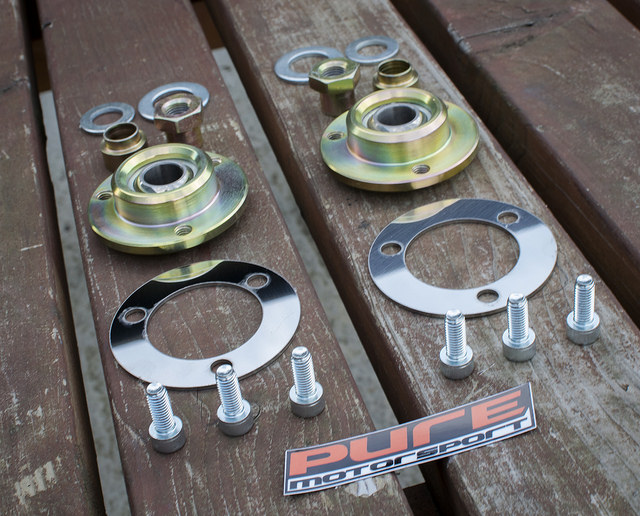

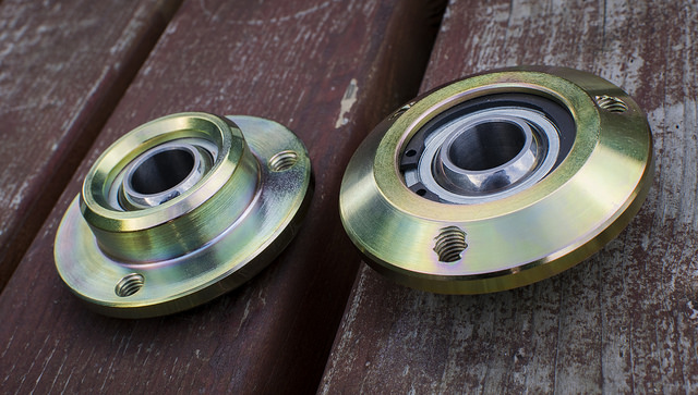

PMS top mounts turned up.

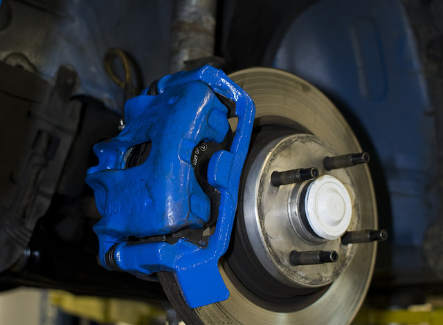

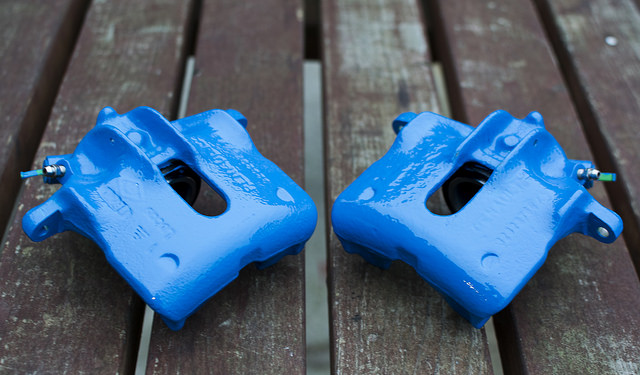

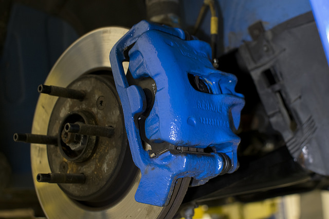

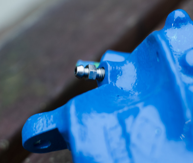

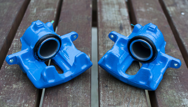

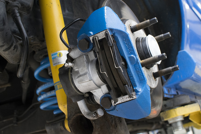

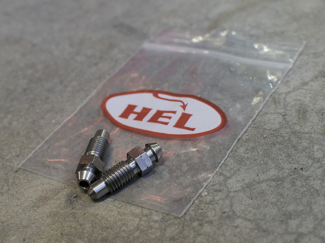

Painted the front calipers blue and fitted the new stainless steel bleed nipples
Ignore the paint on the rubber, i got most of it off. The rest can stay on as it'll get covered in brake dust and hide it!

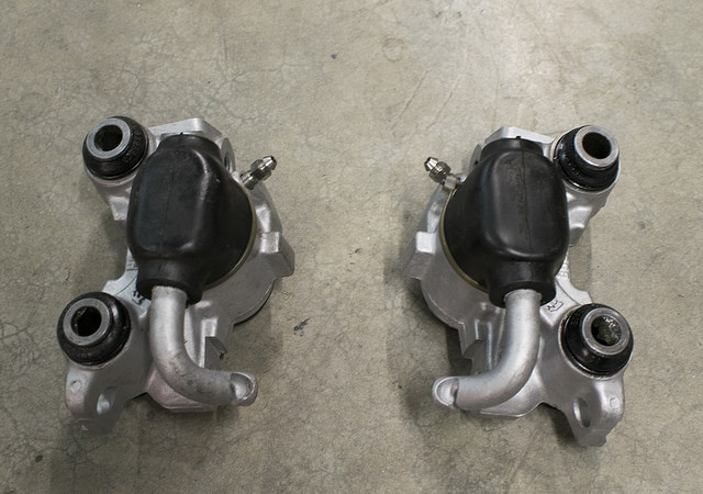

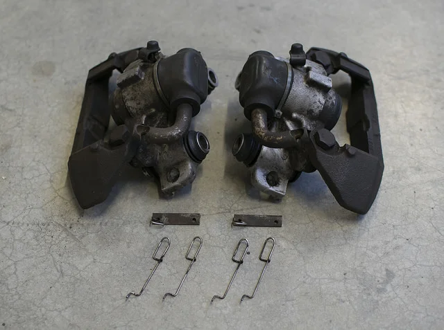

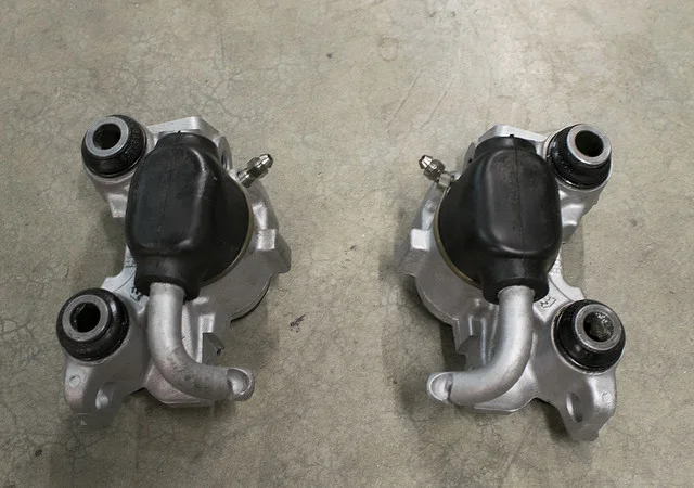

Rear calipers turned up today. Looked clean for 2nd hand calipers and the seller made sure he picked the best set. Sliders all free and all clips were included. I cleaned them up and gave them a quick silver paint. It was quick and i wasn't bothered if i got paint on the rubbers, i just wanted them clean looking. I removed the slider pins and gave them a regrease before refitting along with the newly purchased stainless steel bleed nipples. Carriers have been painted blue to match the fronts.
For anybody wanting to know, the bleed nipple sizes are M7 X 1.00 :up:

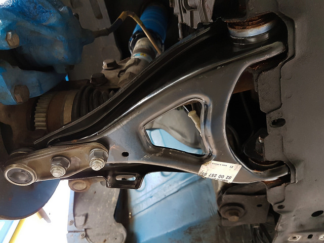

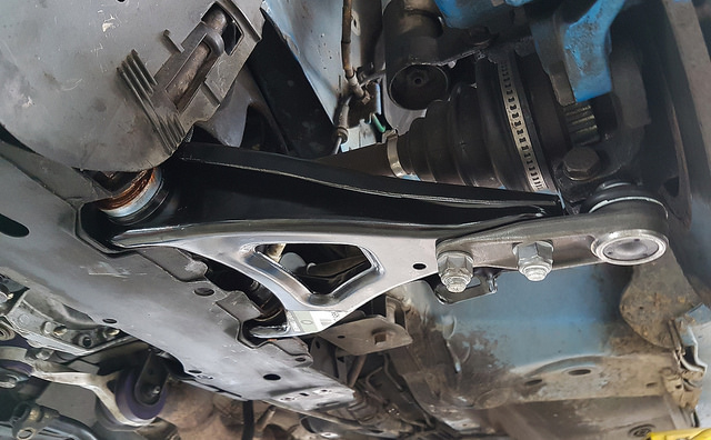

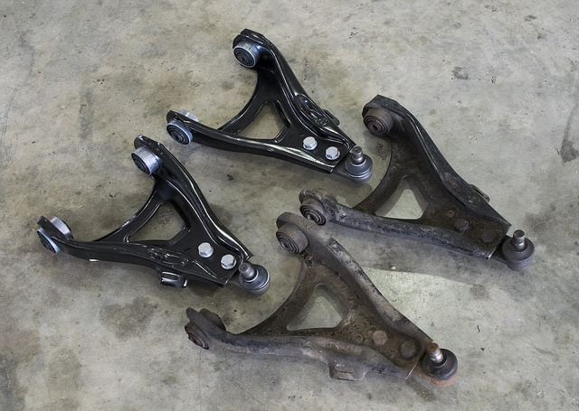

Fit new genuine lower arms

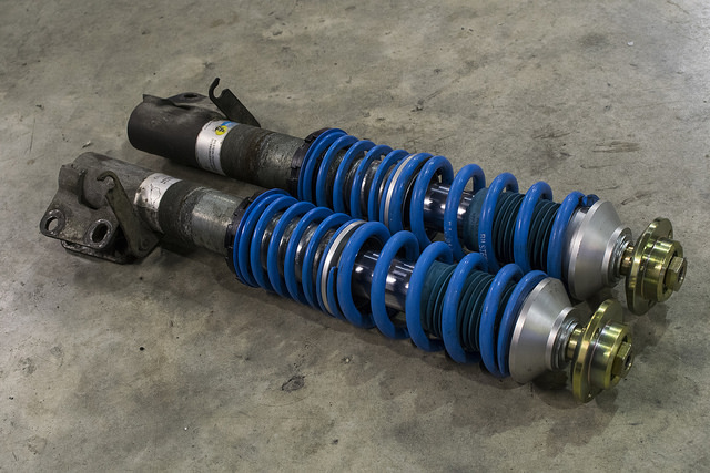

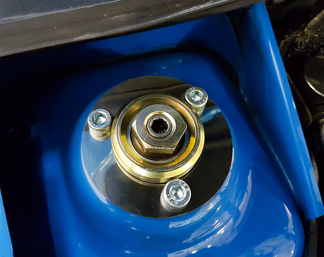

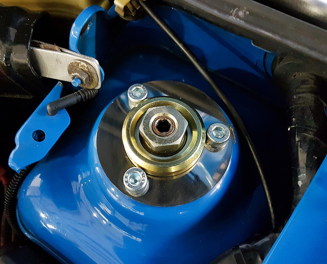

First job was to fit the new PMS top mounts.

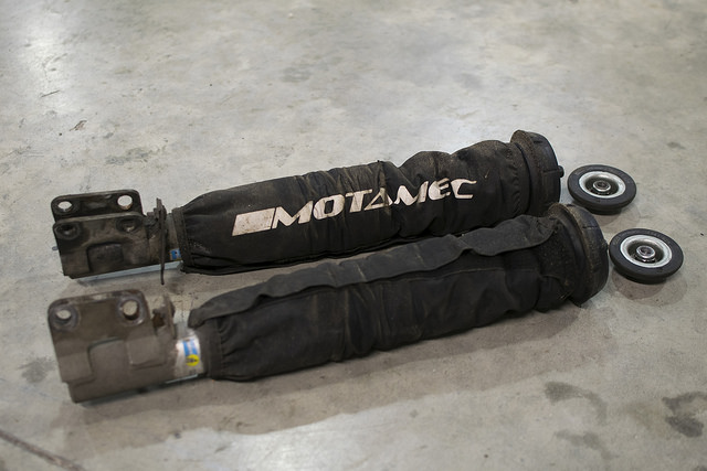

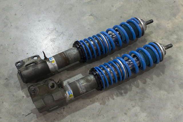

Shocks and old top mounts off
Took the coilover covers off and gave them a wash too.

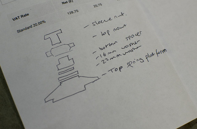

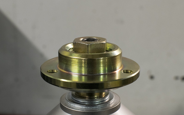

When i called up Nick @ PMS i mentioned i had the B14 kit as i knew there was a difference between that and the standard ones. Its just a case of extra washers but i asked him if he could do me a quick drawing on the way they go on.
With the old mounts out, you can see how bad the previous holes are......

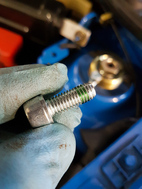

I added some locktight to the loading bolts and fitted them with the spreader plate. The bolts wont be going anywhere now.

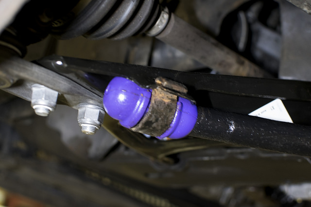

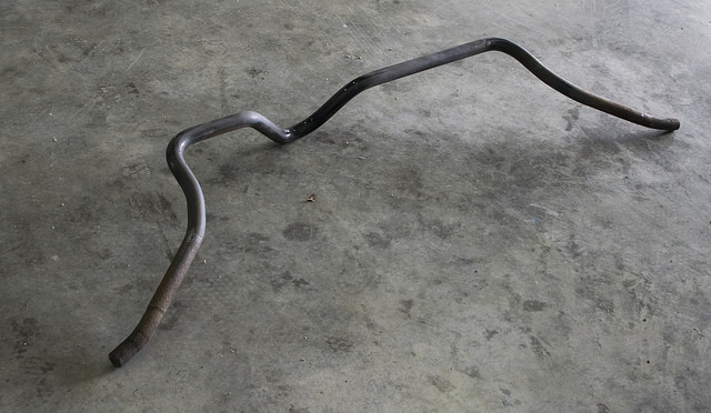

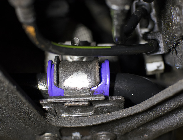

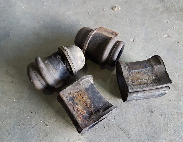

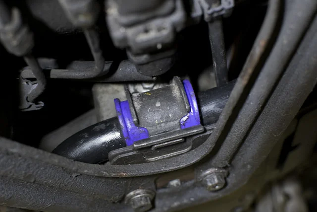

@MrBlonde turned up and after a quick cuppa, we set to work removing the anti roll bar. Got that off and also the lower wishbone arms.

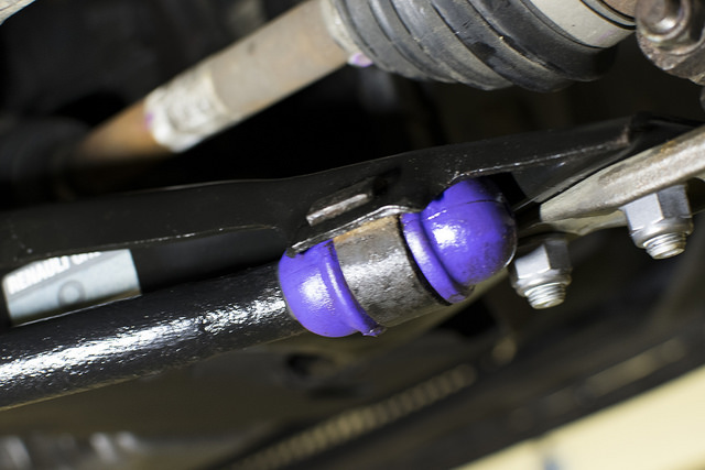

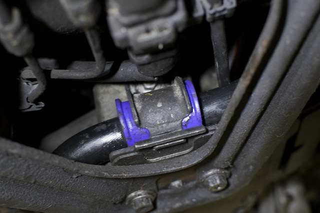

Im glad i bought both inner and outer bushes as my outer ones were buggered as well. Originally i was just going to buy inners.
Gave the anti roll bar a sand down and a quick coat of black paint. While that was drying we fitted the new bottom arms.

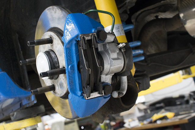

Next up was the brake fitting.

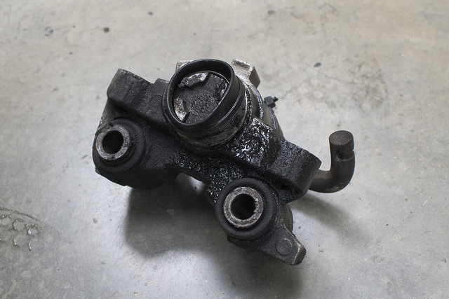

Old knackered NSR
All fitted up.

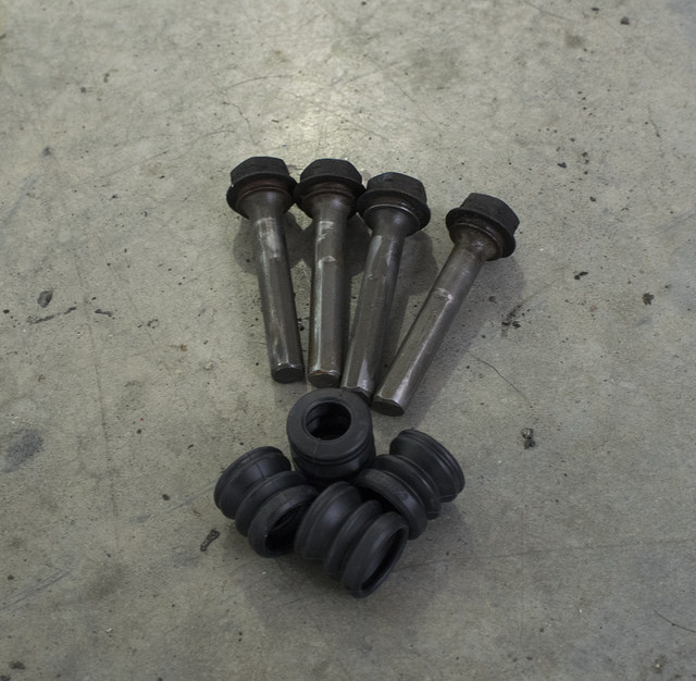

Fitted up the fronts also. Cleaned up the slider pins and fitted new rubbers. Ignore the back bits on the calipers, they are just dirt.

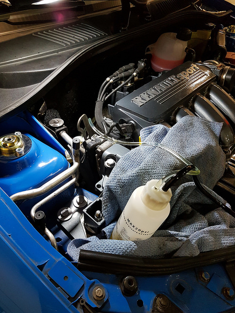

Here's where we encountered a problem. We bled the brakes manually and had no pedal. Got rid of the air but still no pedal. So then we decided to scratch our heads, have another cuppa then fit the arb bushes and the roll bar back on. Got to say the inners were a pain, and after reading on tips on here, we did what others have done and added longer bolts. Bit of a bodge, but chances are there never getting worked on again so its a fit and forget job.
Then we shot to halfords as time was getting late and bought a Eezibleed kit. With trade discount it was only £10 so not a great deal of money. Didn't cure the brake issue unfortunately 😧
We think its the ABS thats doing it. Herad a few horror stories of these after a seach. Luckily @.Joe has one so after a call to him last night, he is politey coming to me today and hopefully pump the system with CLIP that he has. Im hoping thats the issue as we have no leaks anywhere else. I have brakes on the OSF/NSR but not on the other circuit.
So, achieved a few jobs which im happy about, just need to get the brakes sorted now. Once again, thanks to Steve @MrBlonde for your help yesterday.

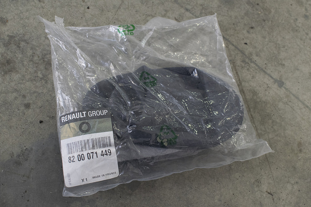

On a side note, this genuine gear gaitor and surround turned up from @RichValver yesterday. My current one has the clips broken, so its a much need replacement :smile:
