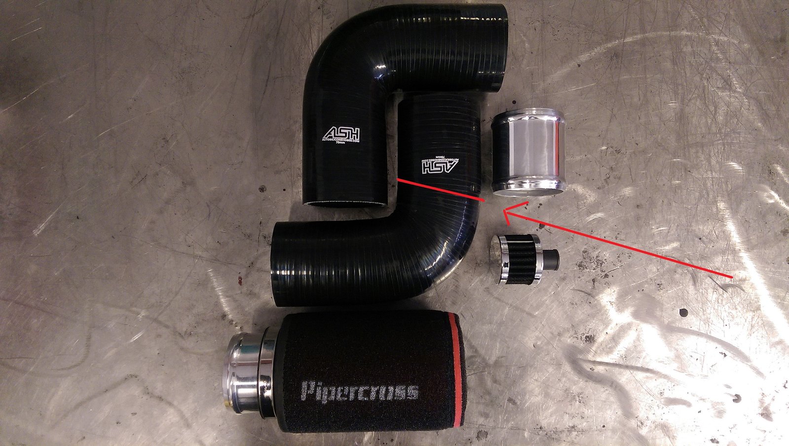

Silicone bends x2:
I bought these ones but they are currently out of stock. Shame as these are the cheapest ones around that are long enough. You can get cheaper, but they are too short/dumpy.
http://www.ebay.co.uk/itm/131676086...49&var=431063786095&ssPageName=STRK:MEBIDX:IT
These are next cheapest/correct ones.
http://www.ebay.co.uk/itm/Silicone-...hash=item2c71a06a5d:m:mnK8MVPn1unqpcqMQW0HNGQ
Ally Joiner x1:
http://www.ebay.co.uk/itm/381537206...49&var=650640058375&ssPageName=STRK:MEBIDX:IT
Filter x1:
http://www.ebay.co.uk/itm/271763944731?_trksid=p2057872.m2749.l2649&ssPageName=STRK:MEBIDX:IT
Breather filter x1:
http://www.ebay.co.uk/itm/191579940089?_trksid=p2057872.m2749.l2649&ssPageName=STRK:MEBIDX:IT
Obviously you'll need filter spray and 4x 60mm - 80mm jubilee clips.

What size is needed for the pipes?
I though I posted the sizes? Anyway it's 70mm (2.75") on the silicone pipes, ally joiner and filter and 12mm on the breather. The breather just feeds into the back of the inlet with the sleeve provided.
You also need to cut the top silicone hose at an angle to fit between the throttle body and the ecu cover.

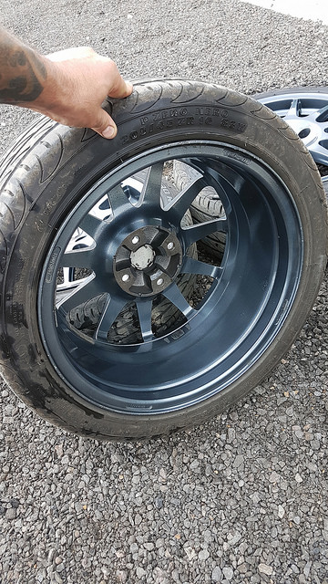

I'm picking some up tomorrow, 150 miles there though as its in newcastle! But £150 for 4 with centre caps and 2 tyres with decent tread it's worth it in my eyes.
Induction kit looks great, wish I'd have gone for silicone bends rather than the alloy one! Where did you get the rubber strip from on the body of the car to stop the hose rubbing? I could do with some myself :)
That's a result @dann2707 Cheap really. You going to get them sprayed the same color as your current ones?

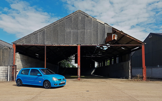

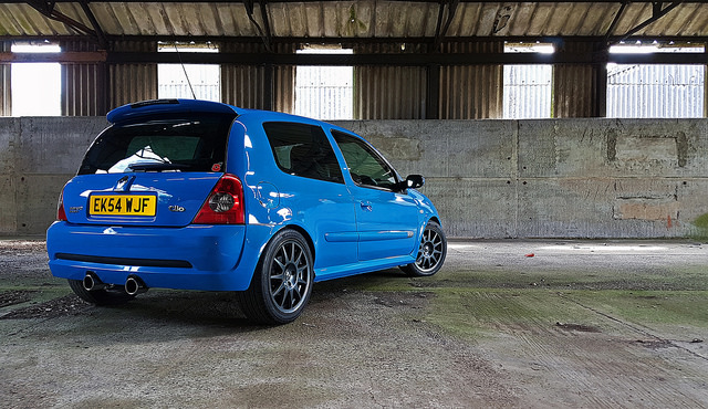

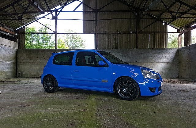

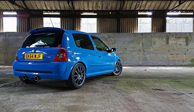

On the way back i took some pics in a barn about 2 mins away from Blyton.

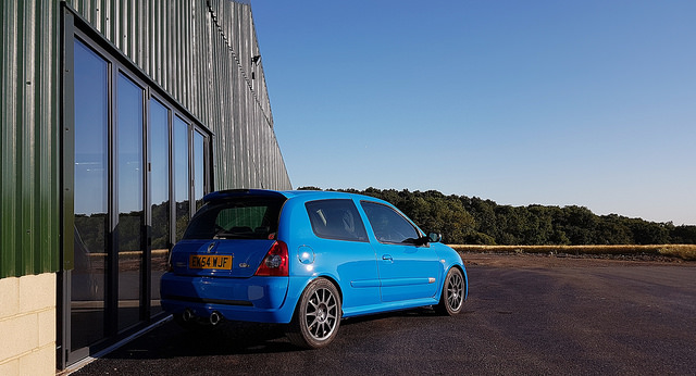

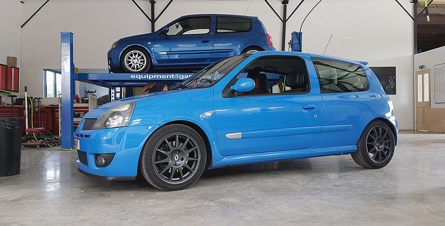

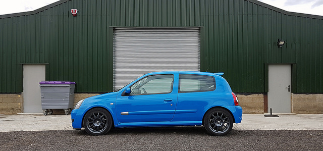

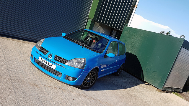

Didn't really do much for a while. Car had its MOT and passed with no advisories which i was happy about. I did think they'd mention about the rear bearings and i had the humming noise but it went straight through. I took some pics at work to celebrate!

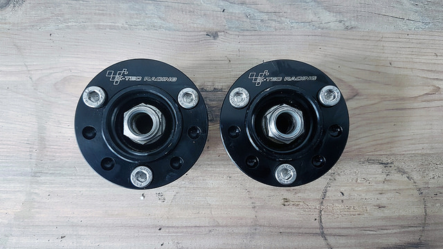

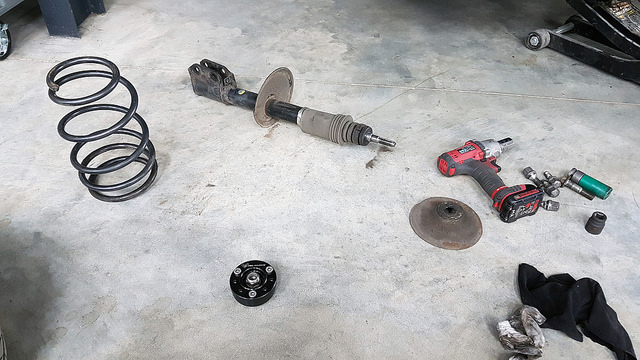

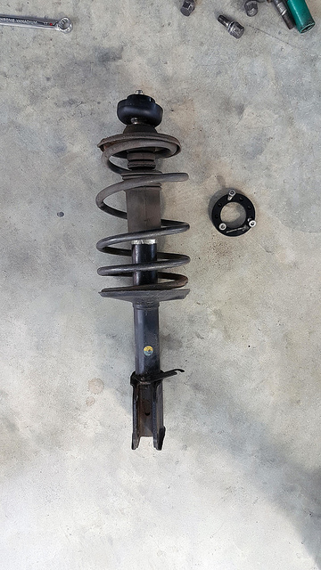

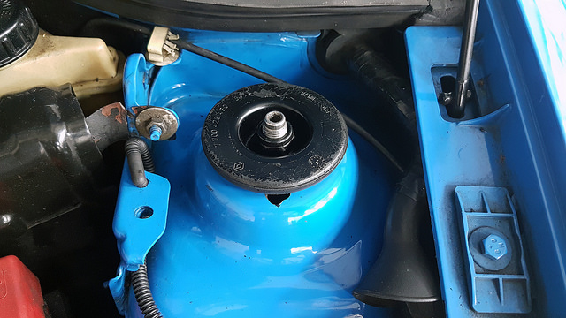

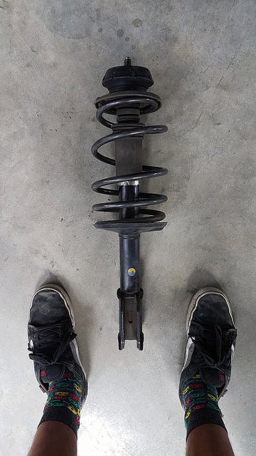

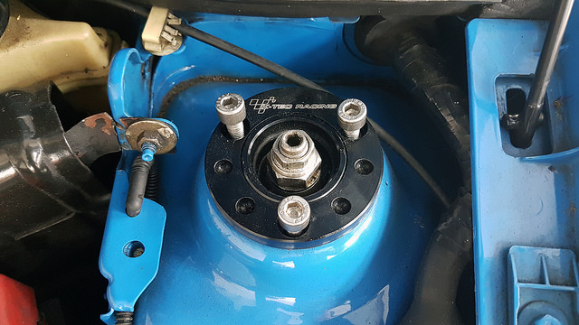

Then i decided to remove the Ktec top mounts as i felt the ride was too harsh with them on. Met up with Steve @MrBlonde and we went to my work on a sunday to both do a few bits on our cars.
Nice PacMan socks! :cool:

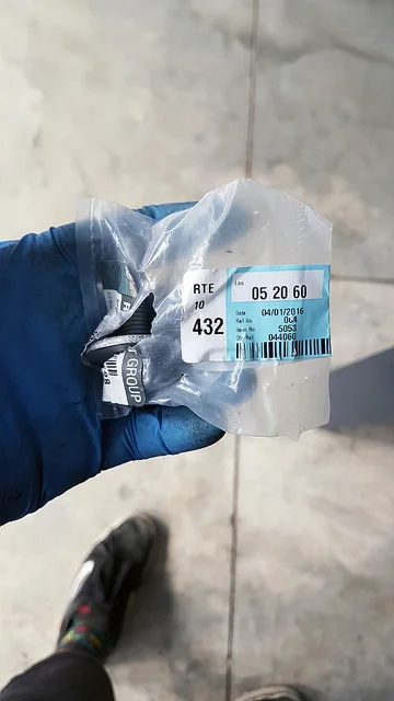

I also changed the engine mount bolt for the OE one that i had in the spares box.
It rides better and its not so crashy with the standard top mounts now, but i'm left with the drill holes, which was to be expected. Will have to look into a cover up of some description.

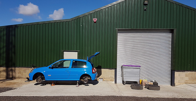

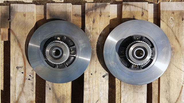

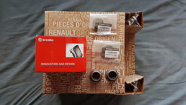

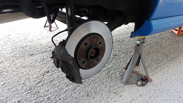

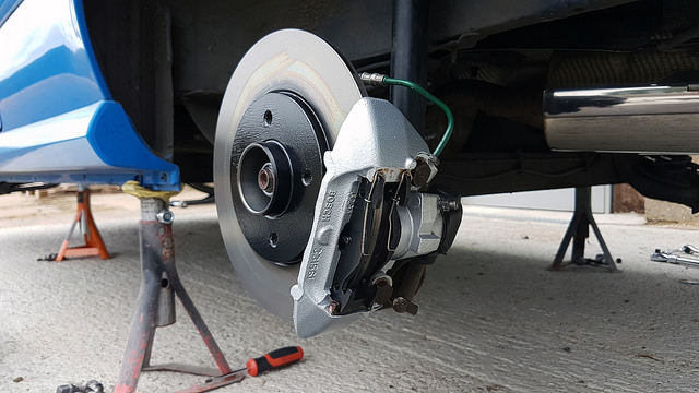

Today i took the car to work to fit the new brakes that i ordered off @George@RTR_Parts. As always, top service from George! I wanted to do it inside, but i couldn't find the shutter keys, so i did the work outside and caught some rays instead :cool:
Nice cup of coffee before i started
The wheels needed to be cleaned also which i decided to do while it was on stands

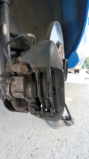

Old brakes

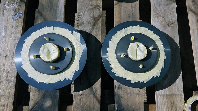

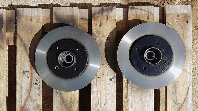

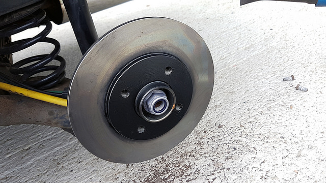

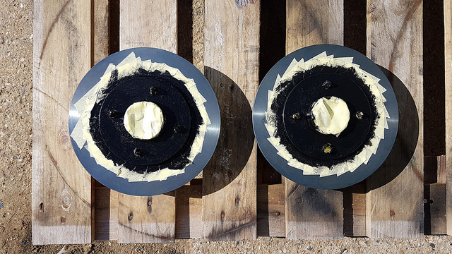

Gave the discs a paint up before they was fitted

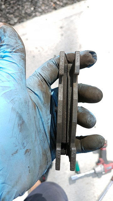

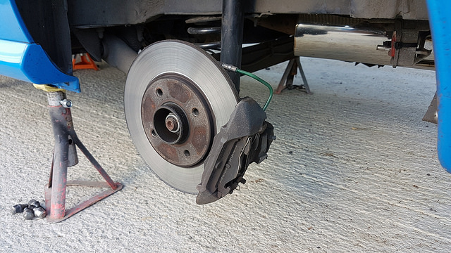

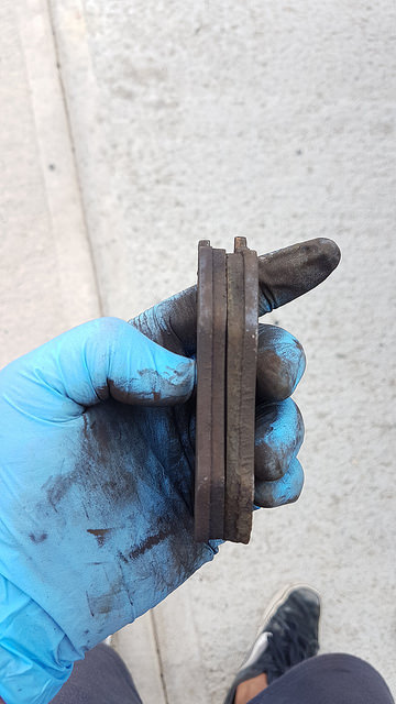

Pads removed. Seems like there is uneven wear.

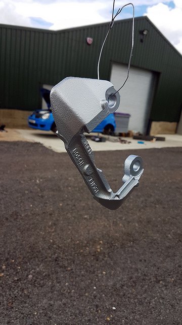

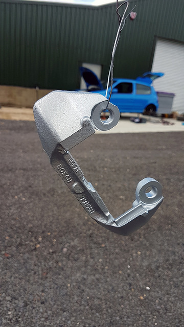

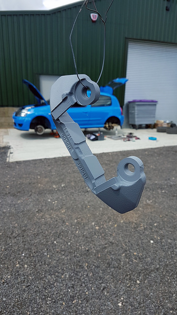

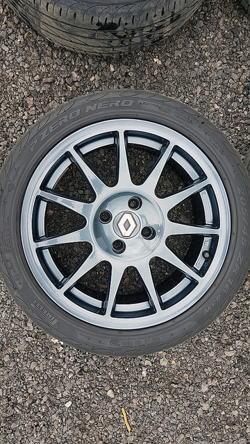

Before the new discs and pads went on, i decide to paint the calipers and carriers. I only gave the calipers a quick paint just to brighten them up, but i sandblasted the carriers, then added etch primer, Iceberg silver (In memory of the Ph1!) and some lacquer.
Had lunch while i waited for the paint to dry

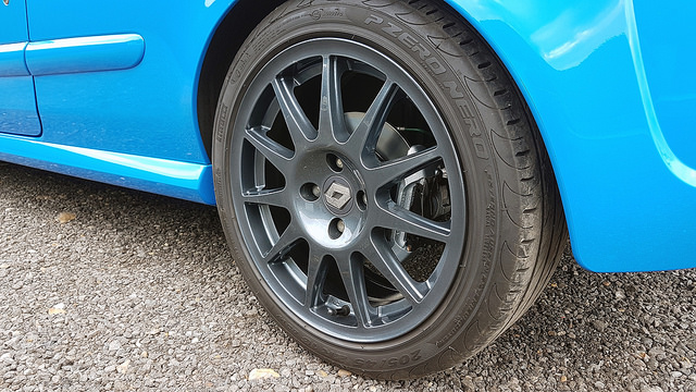

All dry, done and fitted up to the correct Nm (175)

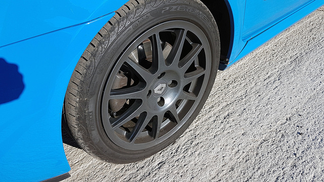

Gave the wheels a clean and the RB a wash
Painted rear brakes through the wheels

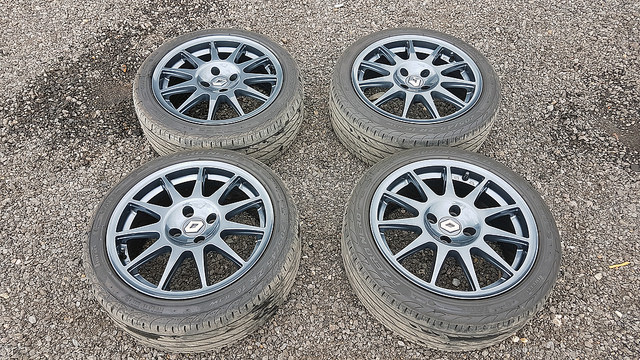

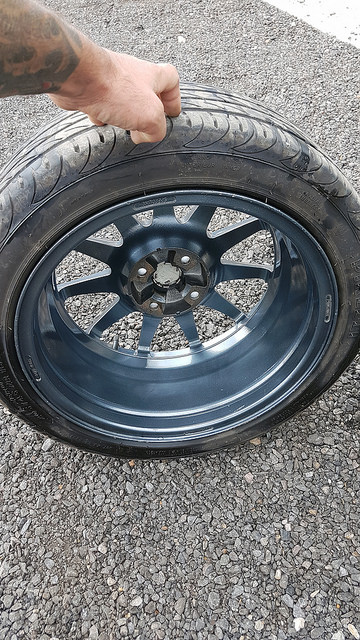

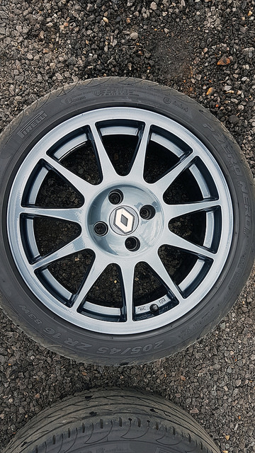

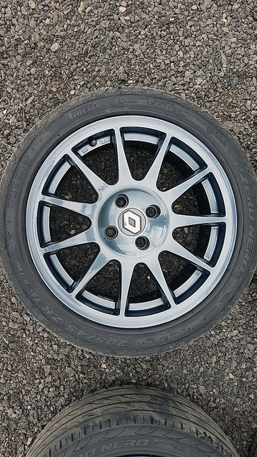

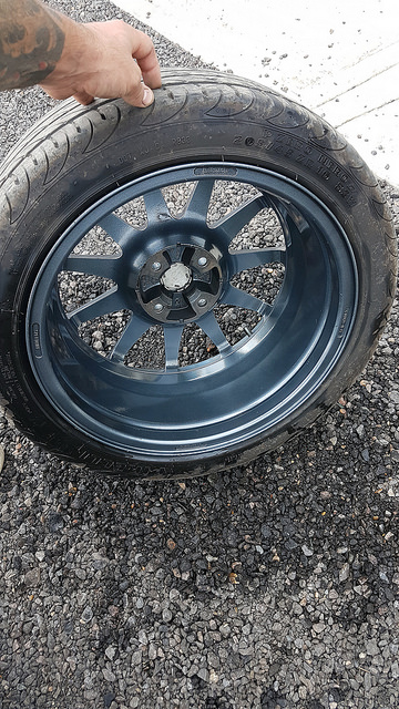

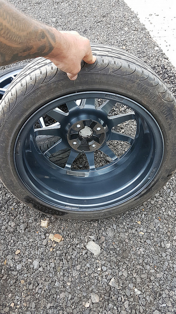

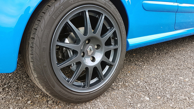

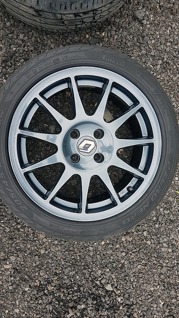

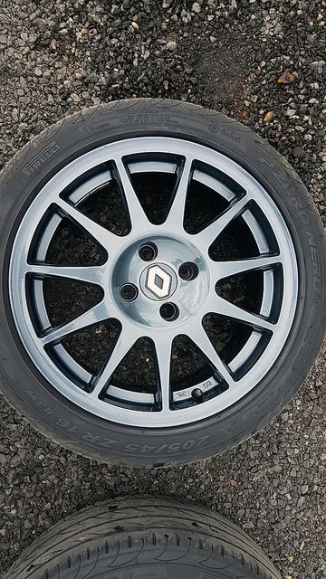

I want some 15" wheels. Ideally i'd like to swap for a equally good condition as my Turinis (No kerb marks, good tyres, etc) as it saves me trying to sell then buy others. If you are interested in my wheels, let me know. I do have access to some standard wheels which i can use so i can put these up for sale, should i need too.
All cleaned, el finito!

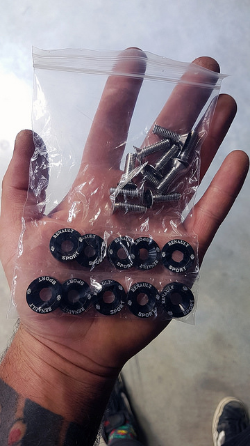

I've already removed the foglights and have ordered some bass ports for a cold air feed. (These are pre clean pics from a few days ago)
Where did you get the bolts and countersunk washers from?
