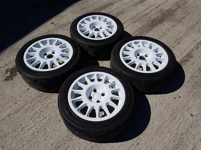

Are they et38 or et43?
They are et43, going for Pilot sport 3's as I have some OZ F1's with R888's on for track days. I know it won't sit as sweet as yours but fingers crossed they won't look totally lost in the arches.

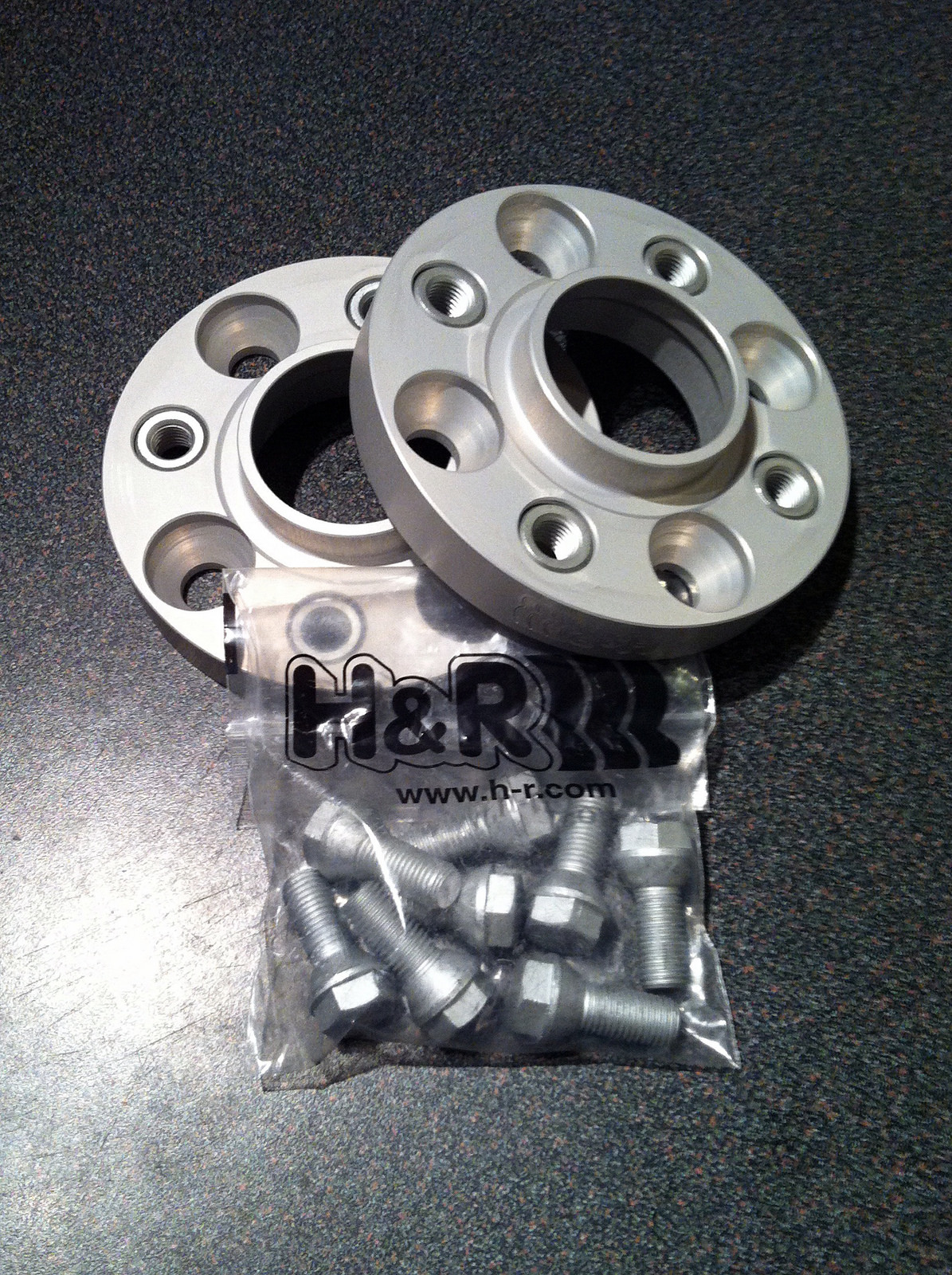

No none at the moment, I guess it's just a case of fine fettling with it. Recommendations on best front and rear type spacers to use??
Jekyll
It's not necessarily better with wheels, it's more what you prefer.

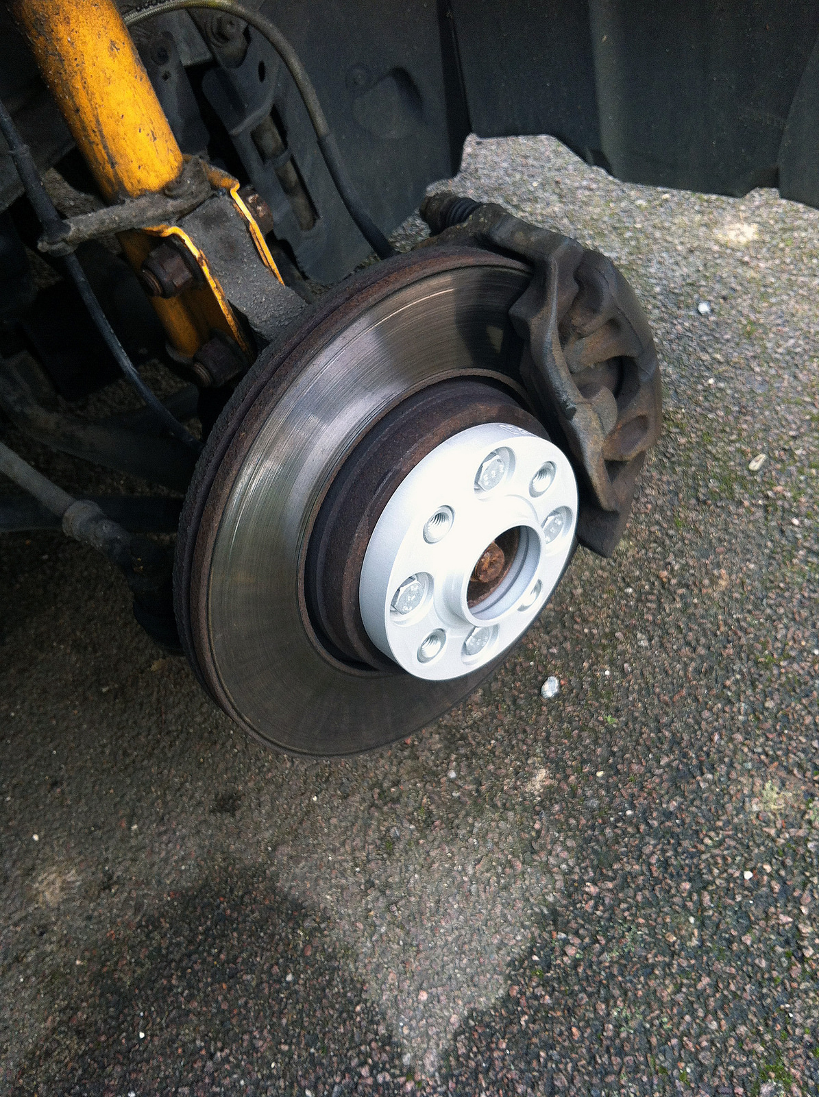

Me personally I prefer the stud and nut type. I take my wheels off a lot and I find it easier as you just remove the nut and the wheel still stays in place on the studs. But some prefer bolts and the look of them.
But seen as your running bolts now, then I would go with 20mm front spacers and 10mm rear hub spacers. And I would also go for a bolt to hub type. In fact, I had H&R 20mm spacers on my old ph1 and I would recommend those (DRA+). They are well made, lightweight and have steel inserts for added strengh and being a bolt to hub type, means you still get to keep your existing bolts.
10mm rear hub spacers will be great as they push the wheel out nice and is a nice size. You can always add a 5mm wheel spacer if you want a bit more out but even with both, you can still use your existing wheel bolts. The H&R's aren't cheap at around £100 but they are worth the money.
If you decide to get hub centric, non bolt to hub type, then you would need longer bolts to suit the added spacer size.
  182 Cup
Top advice bud, i really do appreciate it. My wheels should be through within 10 days so will get them on the standard cup shocks, cook springs and I'll get some photos up. H&R looks good quality in all fairness.

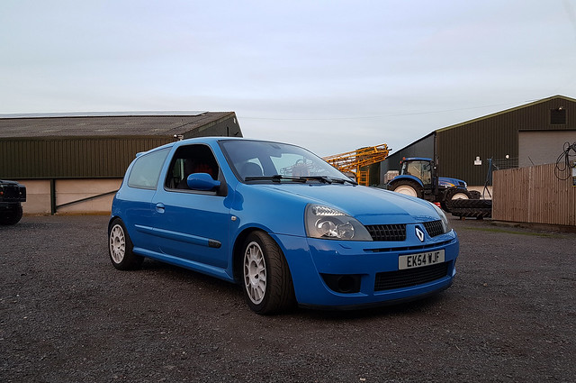

Haven't updated this in a while. Not a lot has happened tbh apart from a lot of picture taking!

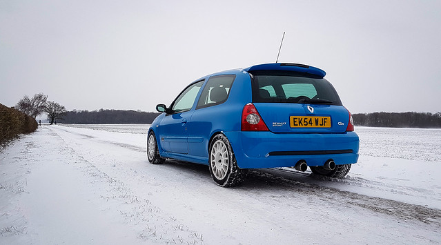

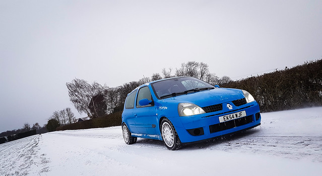

So as the car is a daily, i braved the weather when we had the beast from the east storm. AD08R's in the snow aren't that bad. Rule is, don't drive like a knobhead and you'll be reet!
Of course i grabbed a few pics during the cold season!

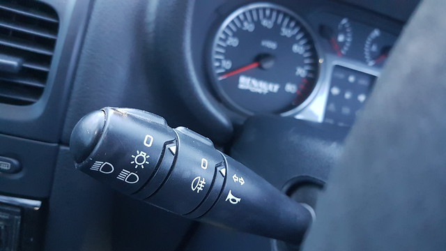

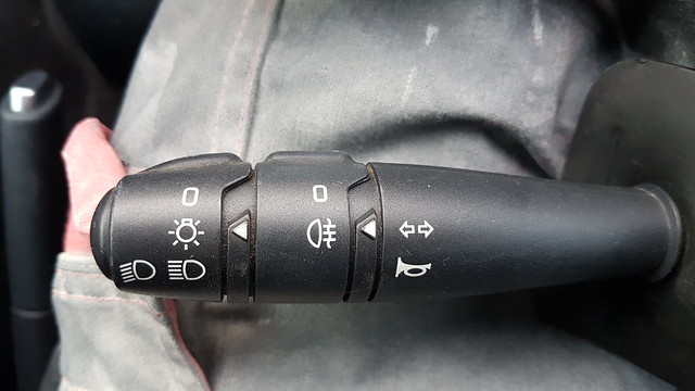

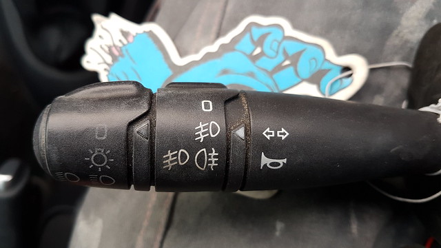

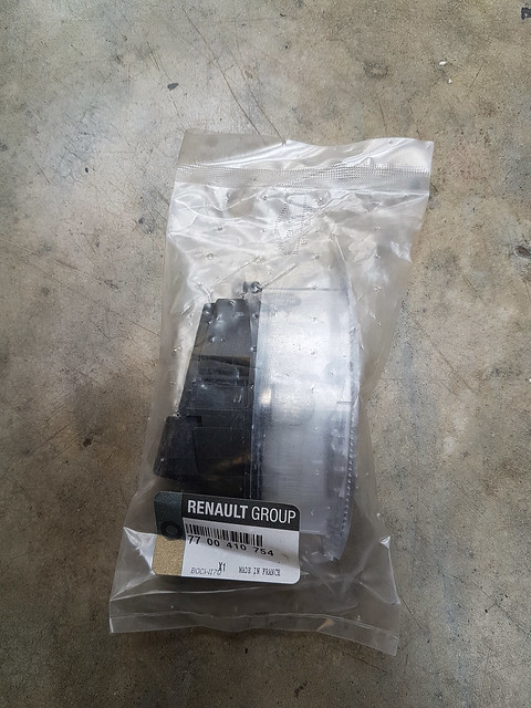

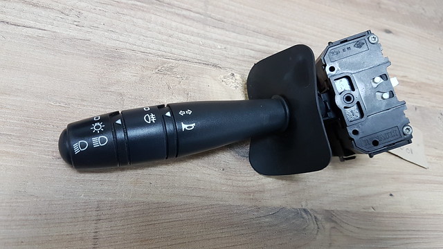

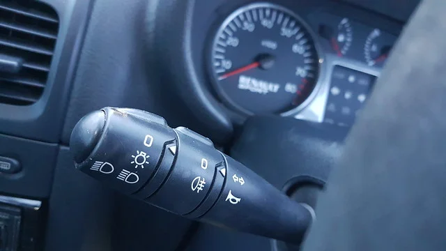

One thing that's bugged me for a while was the ph1 indicator stalk i had, had worn away on some of the symbols. These tend to go for around £25 now for a sport one. I managed to get a non sport ph1 stalk off ebay, in better condition, for £7! This one was from a non sport and the only difference is it doesn't have front fog light switch, which suits me as i've removed mine anyway.
Old
New
All fitted and working as normal

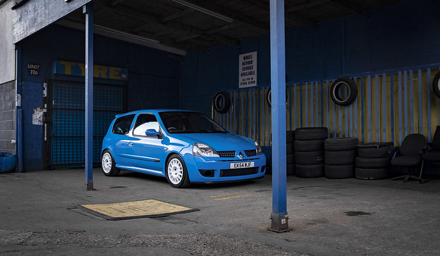

I treated myself to a new (2nd hand) camera so over the last few months ive taken various snaps of the RB. These are some of my recent favourites, with the new camera and my other one.

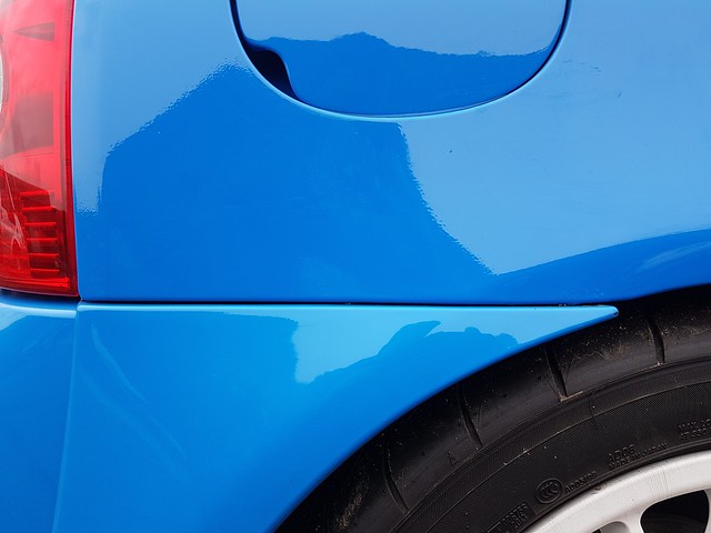

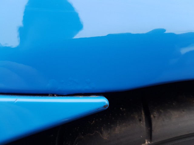

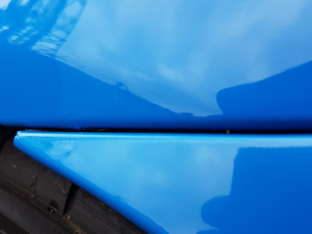

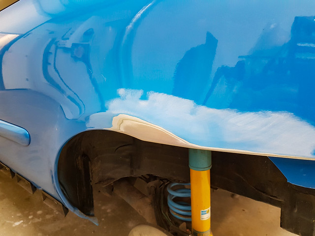

Now the car is not mint. The pics make it look better than it is. Its just ticked over 126k and while the bodywork is in decent condition for its age and mileage, it does need some attention. I noticed a few months back that i've developed a little bit of bubbling on the rear arch. I know the car has had a repair at some stage in its life as the rear quarter and bumper has been repainted and not the best either. Rather orange peely and in some lights, the bumper is brighter. I must admit, its never bothered me that much, however this will now be addressed as i want to remove the bubbling paint and kill it before it gets worse.
The near side has a small amount too but it was hard to picture as it really is small.

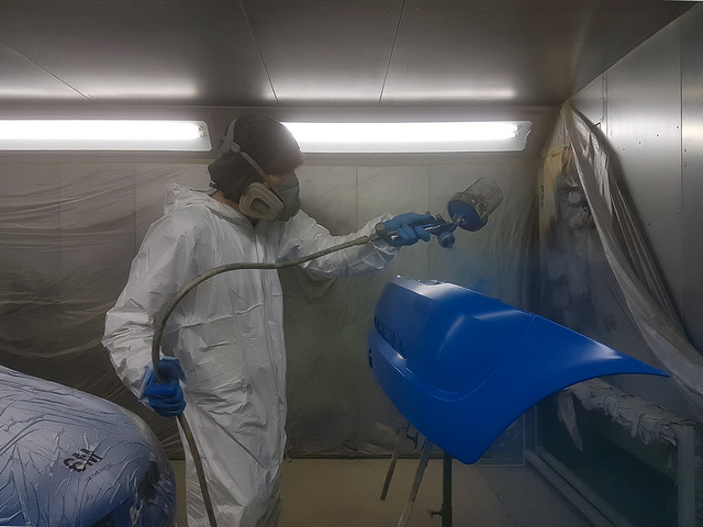

So having a paint booth at work and having guys that are good at what they do, one is doing the repairs for me as i dont know bodywork, apart from the basics. I will hopefully be getting the bubbling removed this weekend. We have spoke about painting both bumpers too but will will do that at a later date and just concentrate on the repair work for the time being.
When the bumpers get repainted, i will buy a new fabia splitter and rear number plate light so its all fresh. I also managed to pick up a renault tunepoint. This enables you to have a usb stick that can go into the original head unit and replaces the cd changer. I still had original head unit and wanted to get rid of the Pioneer one i had for a more oe look.

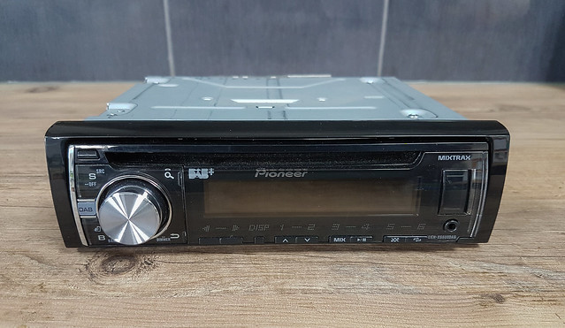

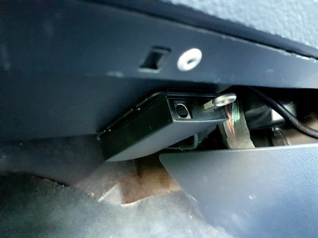

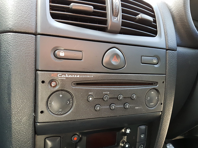

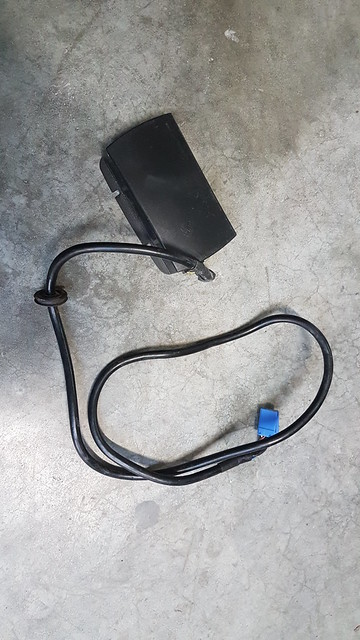

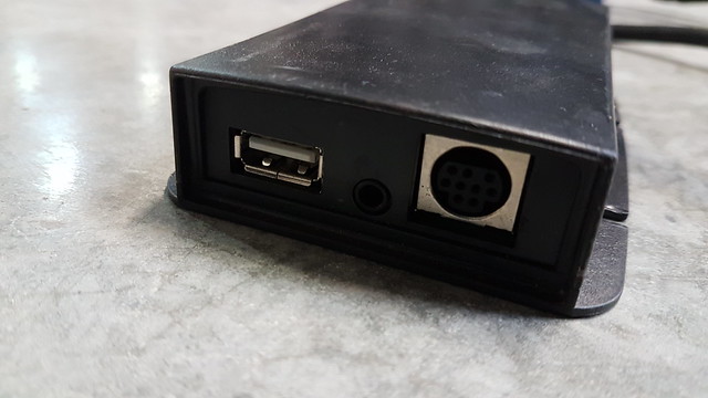

Ive velcro'd the tunepoint under the glove compartment so its all hidden. Yes the original head unit is manky, it suffers from the tackiness from the soft touch film the sports have, but i will swap the face for a non sport one as i believe the face is a straight swap.
The old head unit and extras are for sale here if anybody is interested:

Yeah it is and it isn't. I've always been honest about it having paintwork in some form of it's life. Fortunately it can be fixed. Let's be honest, I'd imagine most cars of this mileage have had some form of bodywork in the past.
Being used as a daily, I'm not going to get every panel done. I'm not chasing for a mint car, just a clean one. Once these parts are dome and both bumpers are repainted, I'll be happy.

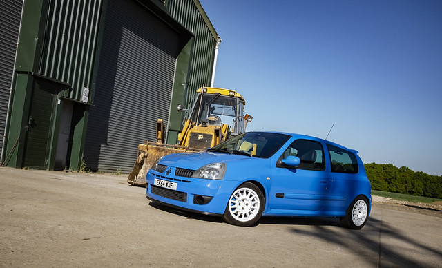

I deeply, deeply love this car. It just looks so right.
Thanks mate, that's a proper nice comment to read ?

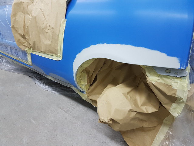

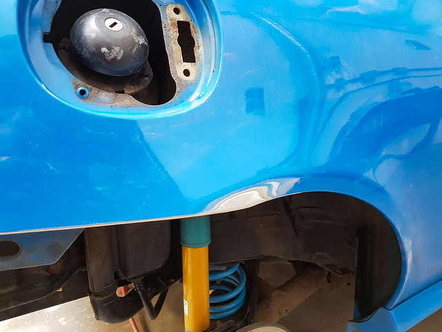

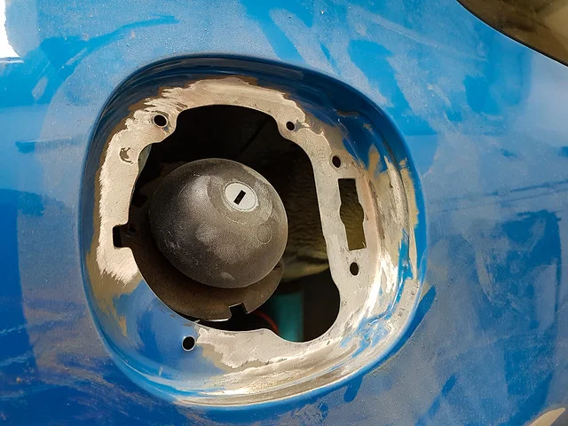

In other news, we attacked the arches today and I'm happy to say that it's turned out to be surface rust. We pulled the sills off and there is no rust on there either.
So far the car has had the arches and fuel area sanded down and primered. We plan to stay after work and get the arches, fuel area and possibly rear bumper painted tomorrow.

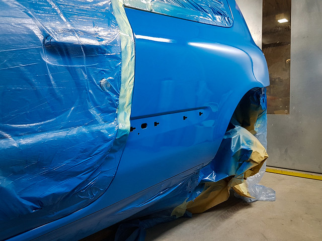

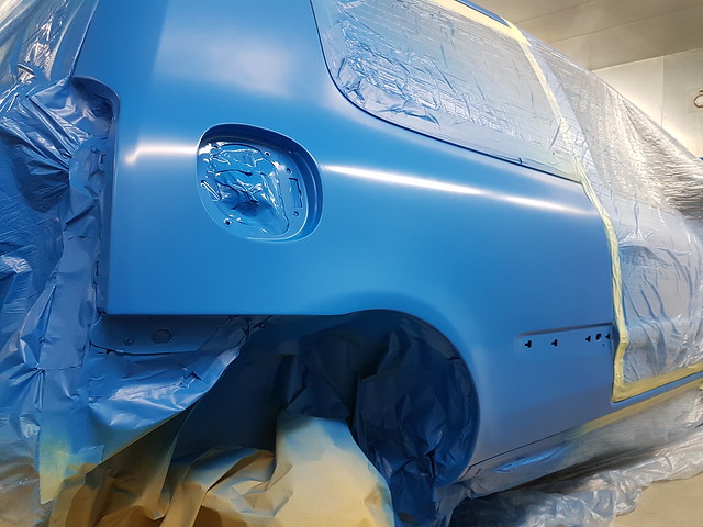

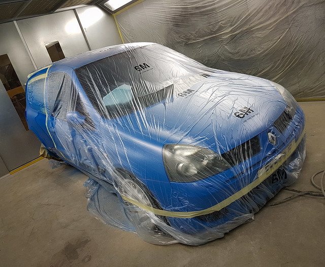

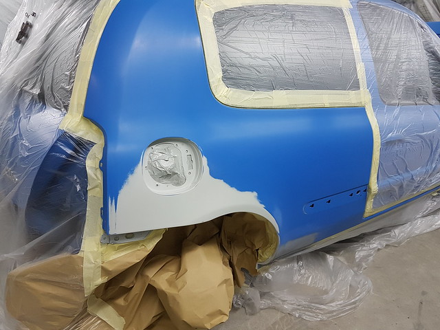

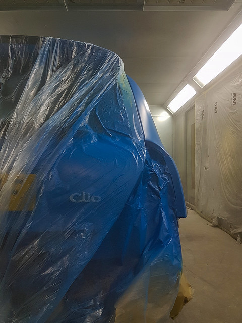

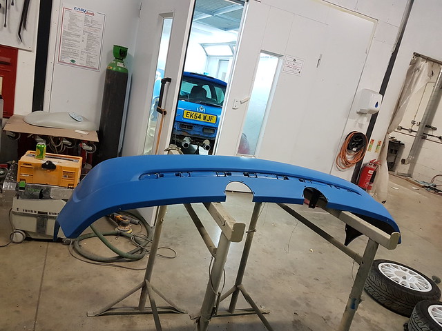

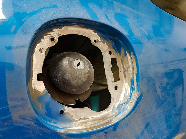

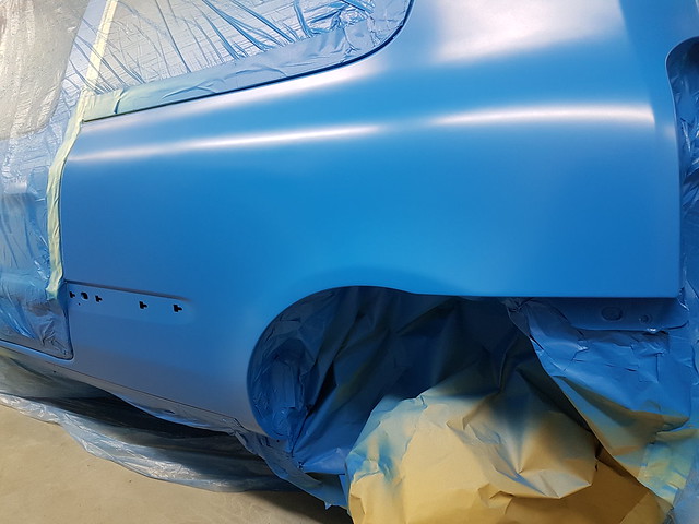

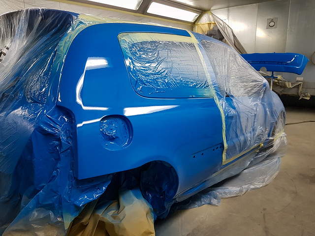

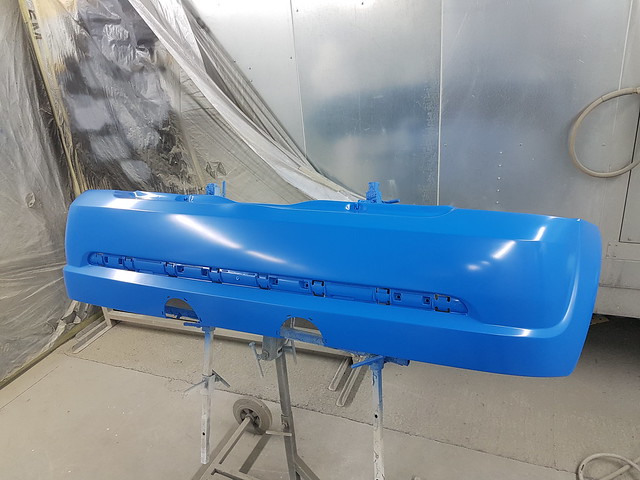

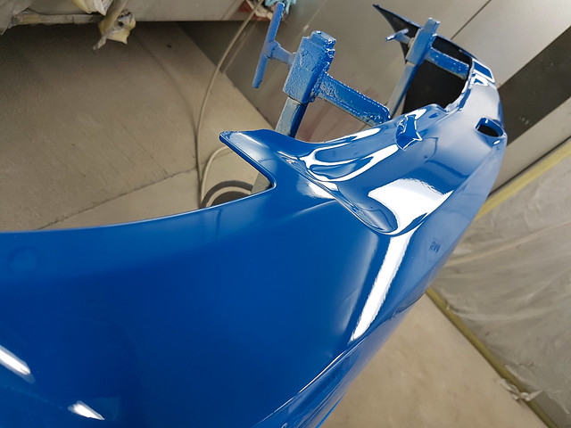

So i got the RB in work to start the paintwork. We decided that seen as the bodywork was in good condition barring the issue, it didn't need filler work. What we did was grind out all the rust, primered the area and blended it in. Sounds a bit half arsed but i didn't want to do extra work if it wasn't needed. I'm not going for a show queen car, i just want the rust gone before we have anymore issues. Ill be honest, i cant even tell where the rust was before or even where its been blended so im happy with that.

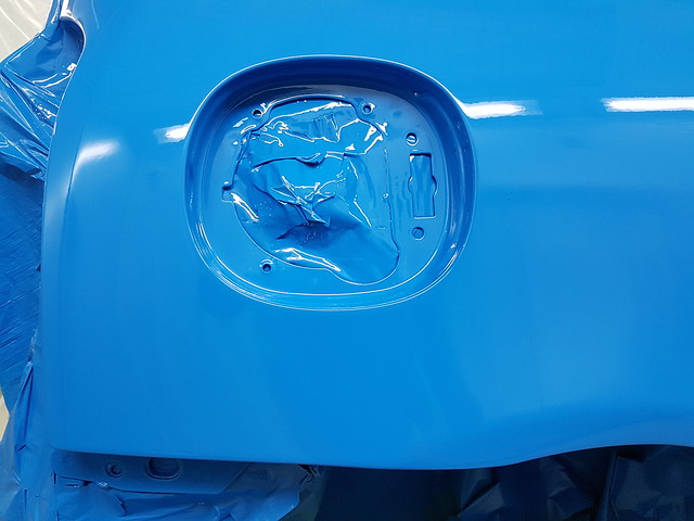

We also did the fuel cap area too as that have some very small patches.

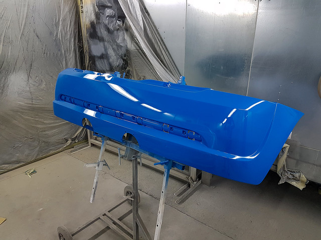

Rear bumper being done also.
And in the booth.
We finished around 12pm friday night and decided to leave it until sunday morning before we fitted it up. No pics of that process but i got a shot after it was all back together outside the workshop. We had a mk1 escort in and i thought this was a cool shot.
Its not been flatted or polished yet. Although its a colour match, it does seem a tad darker compared to the door. i'm hoping that its just against faded light on the old panels and with a decent flat and polish and a polish of the other panels, it'll be sweet.

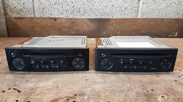

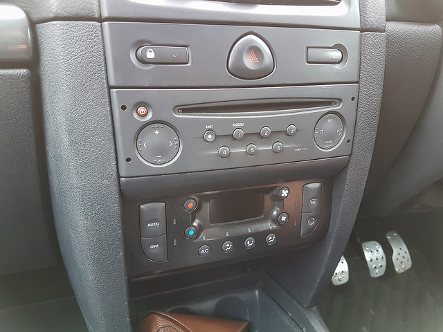

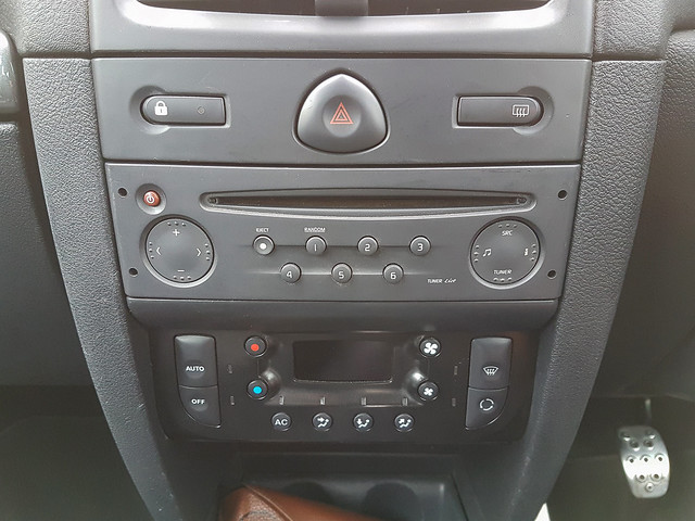

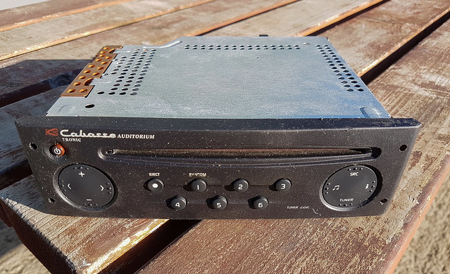

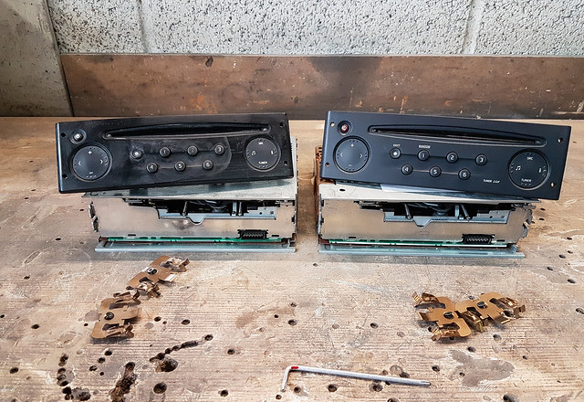

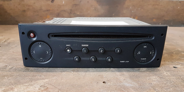

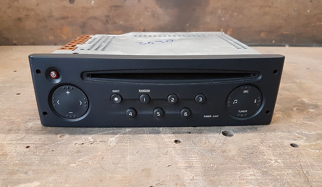

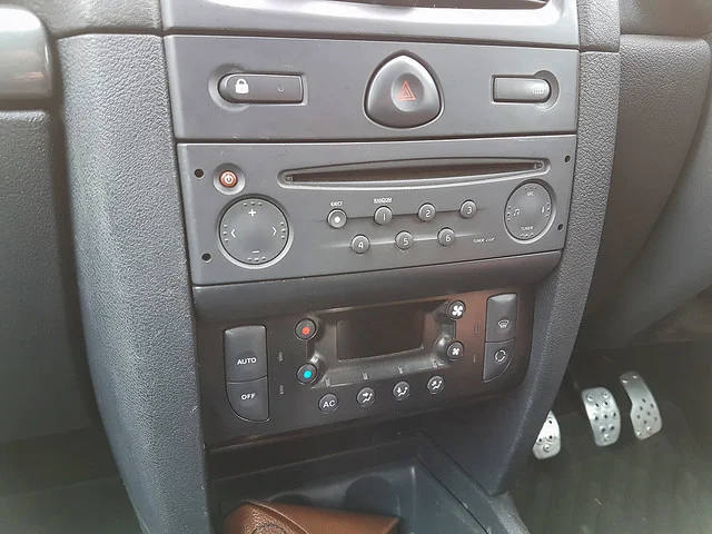

I bought a 2nd hand non sport stereo to it. Mine was sticky as hell so i gave it a good scrub to remove the stickiness, which worked but it looked s**t, which i knew it would. This didnt bother me as i knew the replacement would only be a few days before it arrived.
Non sport head unit arrived.
I read that non sport head units dont work in sports, but the faces are the same so thats what i bought it for. So i removed the old one, got them on the bench and swapped over the faces.
And fitted. No more stickiness and it matches the rest of the non sport stuff ive swapped over too.

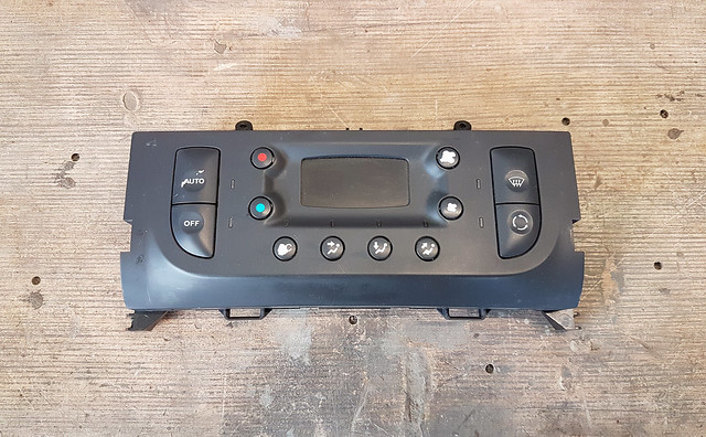

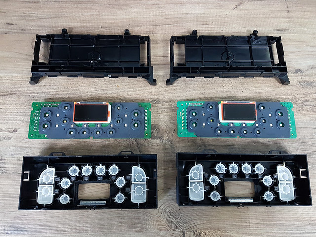

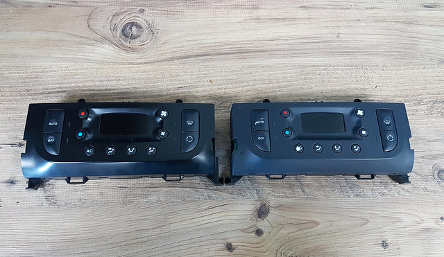

All that was left to do was the climate control panel. Although i had a non sport, as you can see it was black and i wanted grey.

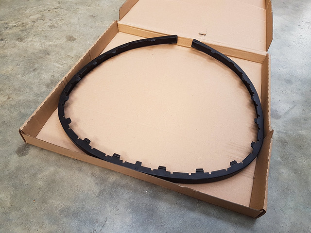

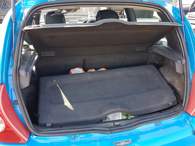

My old parcel shelf rattled. Not sure where, but the fitting was never great, even with the foam strip mod. I managed to find one for sale on here from @edwarj123 and fitted it. Fits a treat and no more rattles. Well its a renault, so it just means one less rattle!

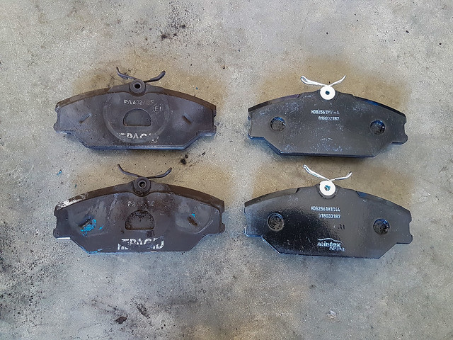

I also wanted to order some new brakes as i wasn't getting the performance i liked out of my old ones. I wanted to get rid of the Pagid road pads i had, but didn't want to fork out for new DS2500's at £130, plus i've had them before so wanted to try something different. Contemplated PBS pads but they were more track focused and being a daily on white wheels, id like something that gives off less dust, so i opted for Mintex M1144's. My discs have never been changed in my ownership so i wanted new discs too while doing the pads so i got some trusty Brembo HC discs. The rear discs was only replaced last year so i just bought pads for the rear. While i was ordering, i though it was best to change the lambda sensor as the eml light kept coming on. I ran a decat and have the sensor in the heat shield and every now and again, the light comes on for a day or 2 and then goes, but this was on permanently. My little ODB reader clarified it was the post cat sensor. A quick message to the trusty @George@RTR_Parts and all of the above was ordered. As always, the service was spot on both in advice and price and the delivery was prompt. He has a great reputation and i've used him for year and i would preach if you haven't already, to do the same if you require brakes, sensor or powerflex stuff ?

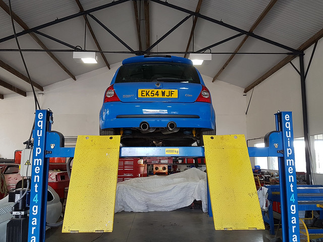

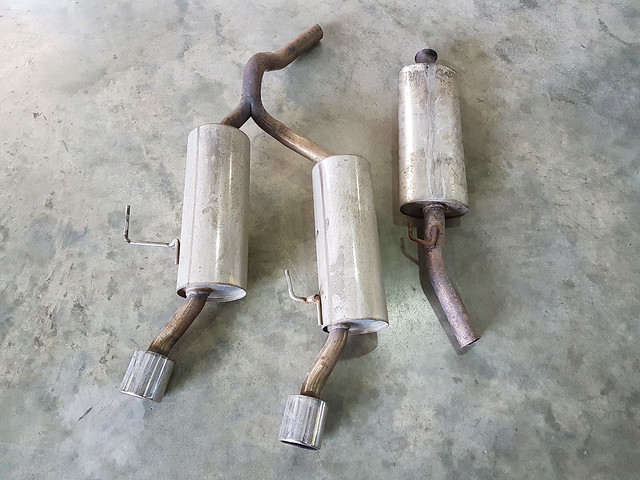

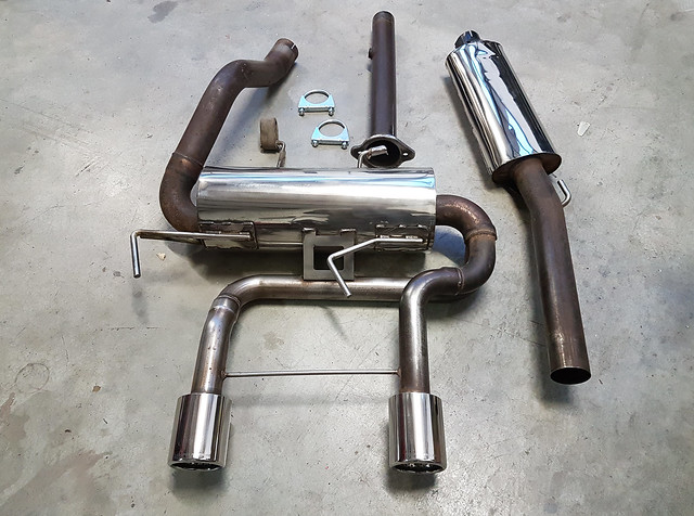

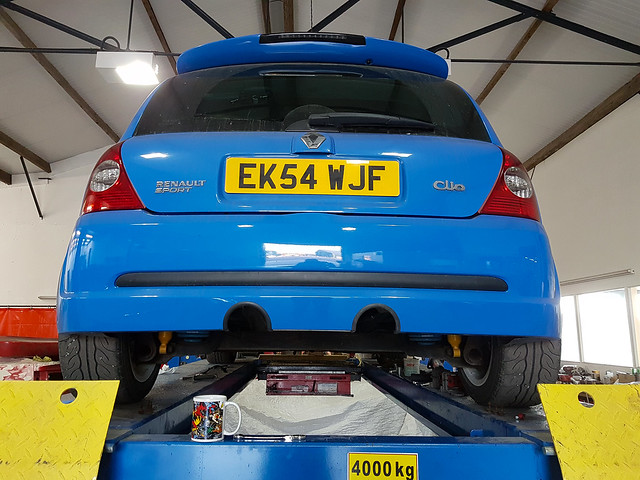

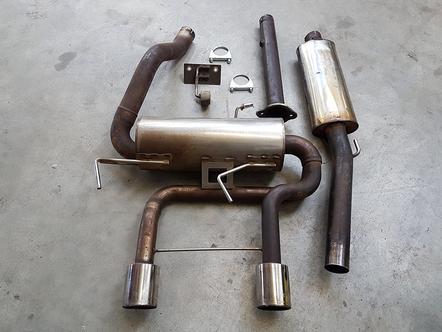

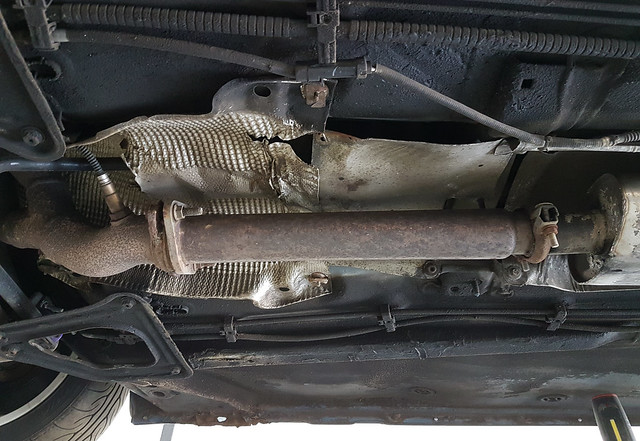

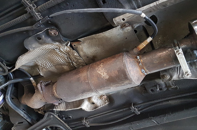

My exhaust was souning terrible and i needed one sooner rather than later. I did contemplate buying new but decided i'd look second hand to save some money. A ktec Ultra exhaust + decat came up from @Russ Rallye and a few messages of enquires and i bought it. Its dented on the center secton but not seen once fitted. Plus i didnt really want slash cut tailpipes and these arent. I'd seen 2 others for sale and they was the same price but no center section, which i wanted. All paid for and it turned up a few days later.
I gave it a good clean with a drill, variuos wheels and metal polish. Came up pretty good. I used a scoth pad and degreaser for the pipes to remove some of the tarnish.

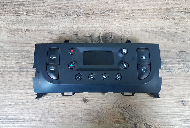

I managed to find a grey non sport climate control panel. The buttons were worn but my current ones were decent so i swapped the faces and buttons over.

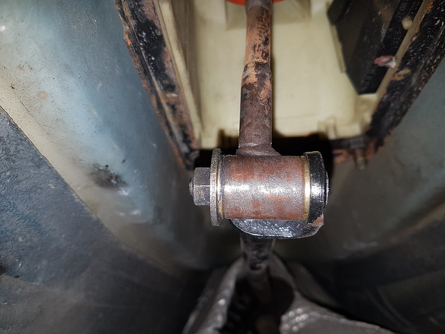

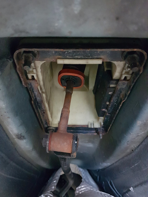

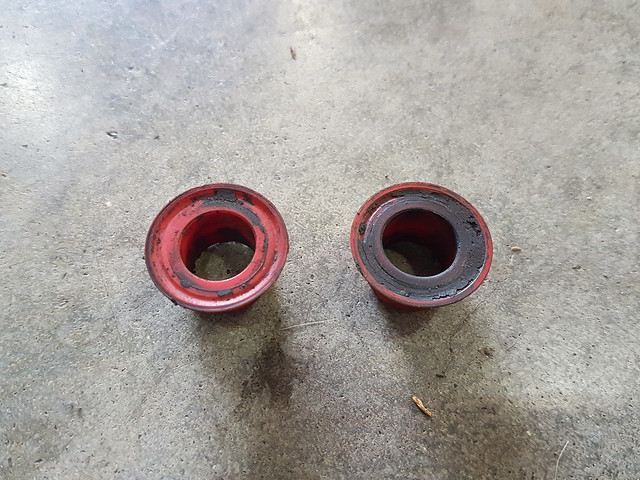

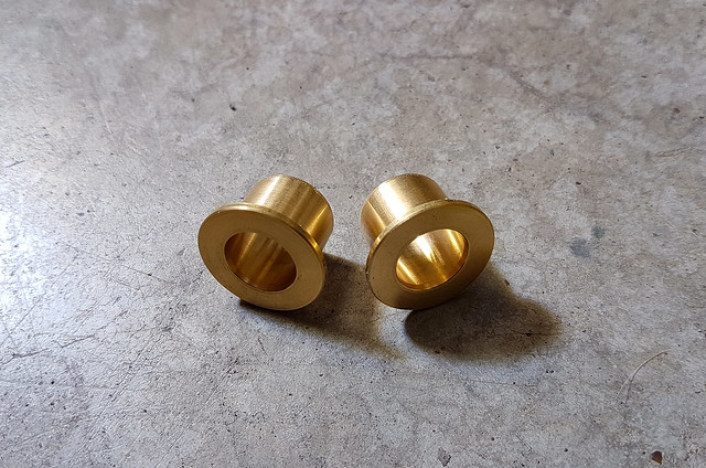

I also ordered some Brass bushes for my BMS shifter from @Yanoo as i was told they was better than the standard ones. Stayed behind after work on friday and decided too fit the exhaust and bushes while the ramp was free.

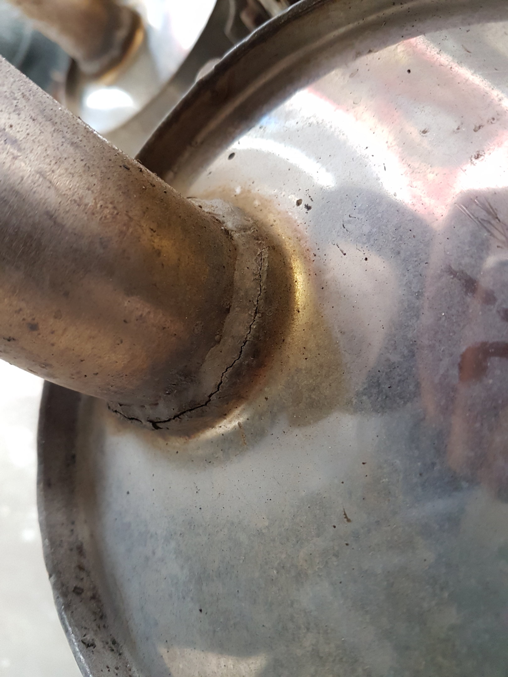

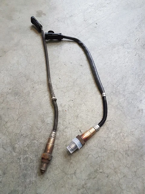

You can see it was blowing here too. Needed changing for a while but there was no point until now really.

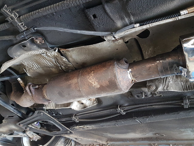

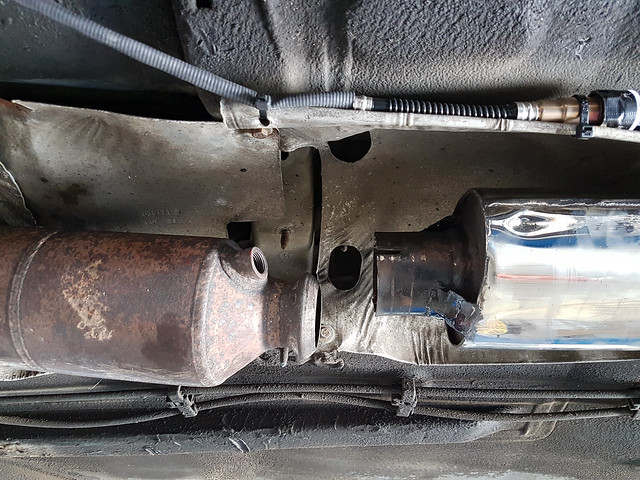

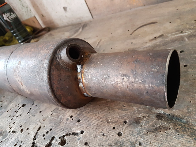

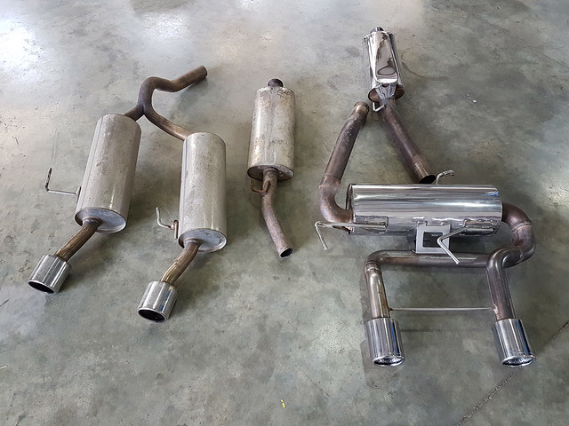

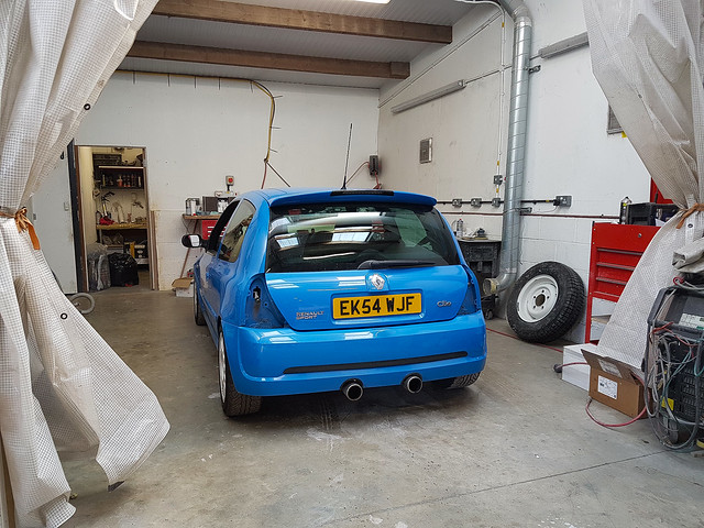

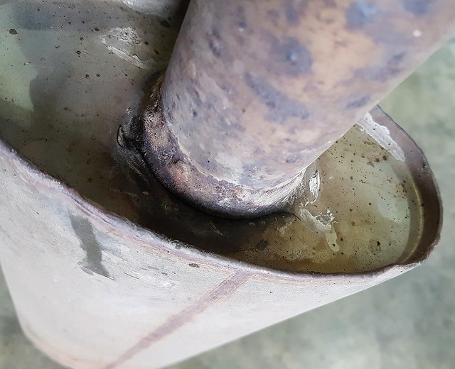

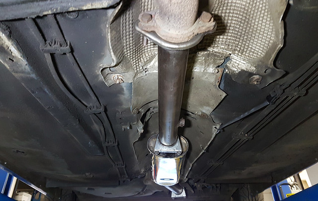

It was a cheap made system which i've always known. Had to take a grinder to it as the center section was all one piece. Came off easy.
Another crack. This is what caused it to have a horrible rattle at 2k.

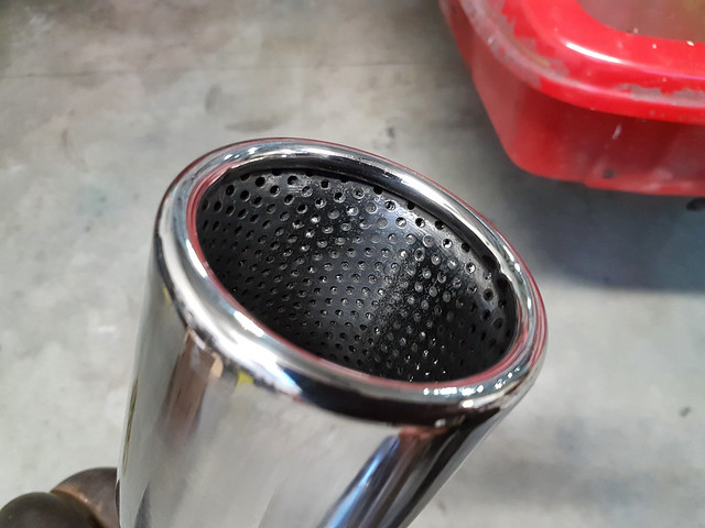

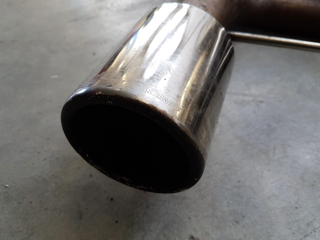

And next to the replacement. I thought the old system was 2.25" but was actually a 2"! The ktec is 2.5" all the way through.
While the system was off i fitted the brass bushes
Jekyll
Coffee and break time

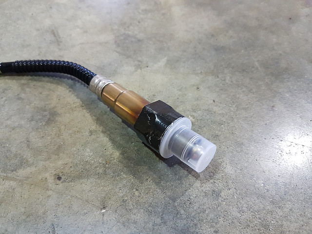

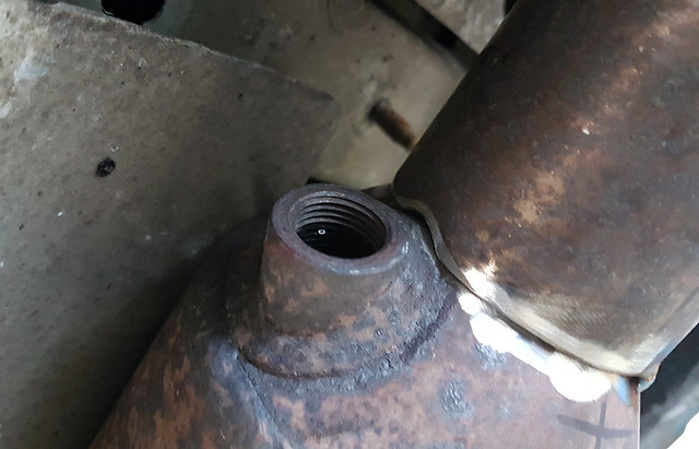

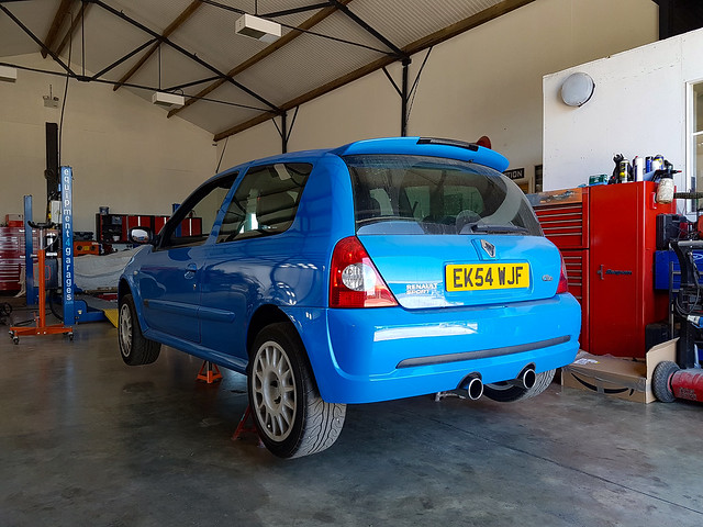

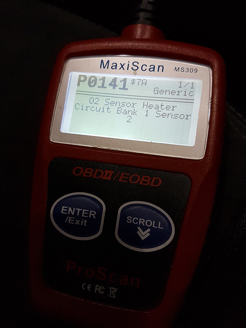

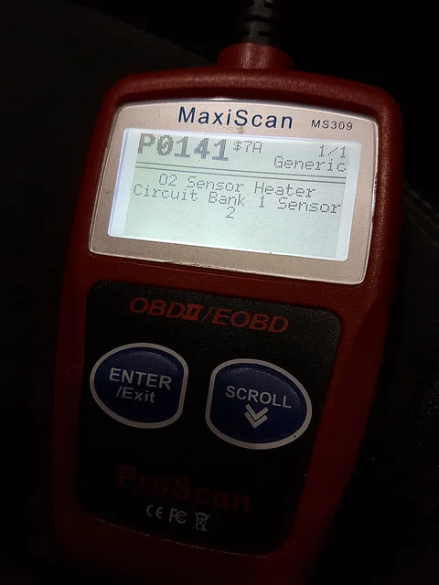

Removed the old Lambda and fitted the new one

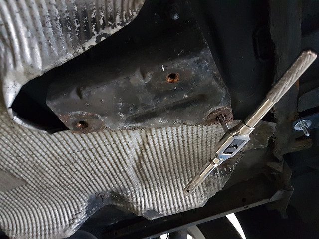

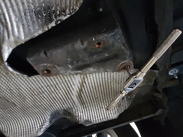

Retapped the exhaust mount holes
Seen as the decat was being fitted i taped up the lambda and fitted back in the heat shield Though this way its always clean.
Got the little code reader to erase the code.
All fitted up
A few vids.
Start up
Reva and pull
And a quick drive by
With that all done i packed up and went home. Exhaust is nice. Has rasp and throaty sounds to it. You do get a resonating sound a 3k though. Looks good too.

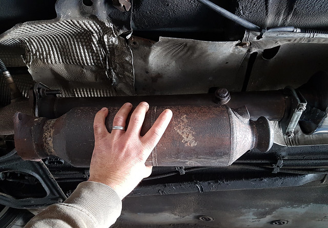

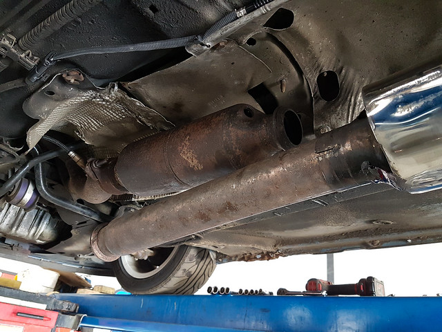

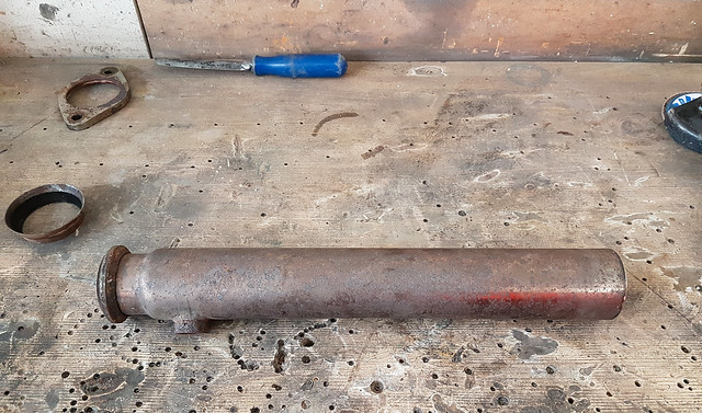

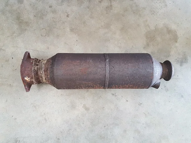

The next day i went to work with the aim of fitting the brakes but i was curious to see what the Ktec would sound like with the cat in place. I still had my original so i took that to work.

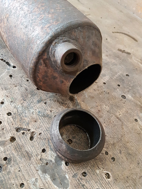

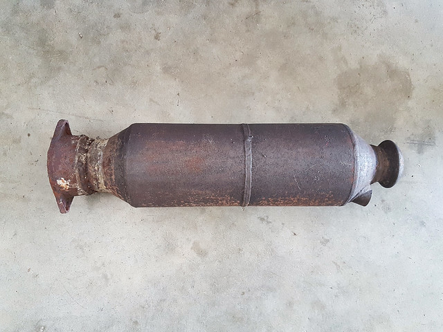

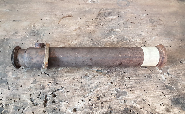

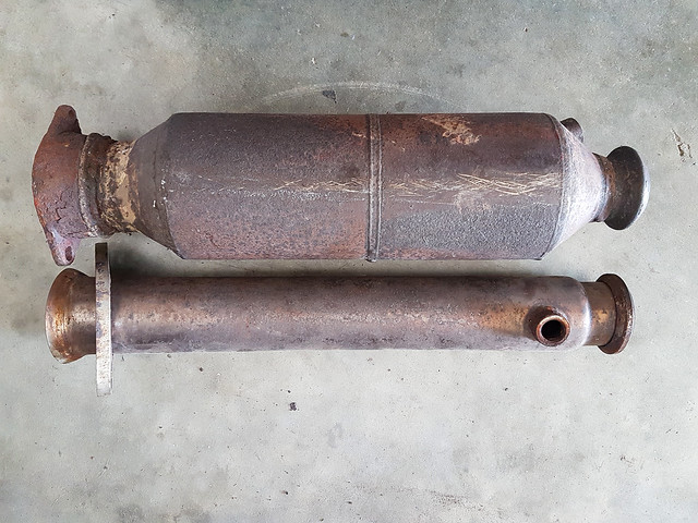

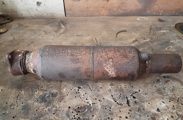

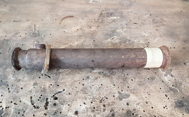

A quick mock up against the Ktec decat
And up against my old decat which i removed as the ktec system is sleeved, meaning this wouldn't have fitted.
So after a measure up and knowing that it would fit, i decided to cut the old decat and use the material to weld ont my cat to make my own sleeved cat.
I fitted the lambda into the cat as it didn't need to be hidden anymore.
Then i got the chap at work who was painting hes own bumper to drive it for me while i got a few vids. The cat hangs down lower than the decat but they always do.

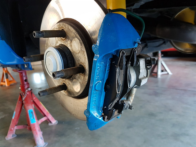

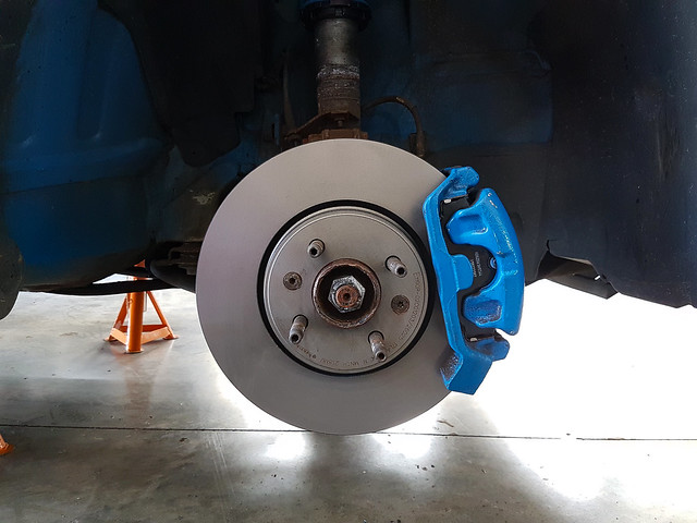

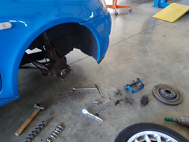

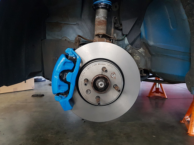

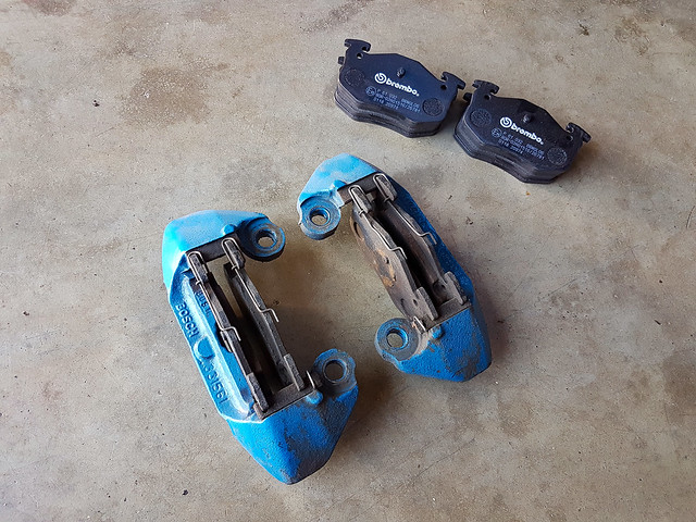

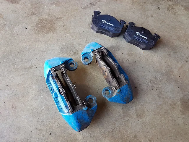

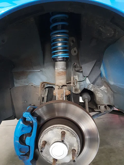

After all that and a quick bite to eat it was brake change time. Ignore the condition of the brakes, im going to repaint them at a later date
Took the wheels and coilover covers off to give them a wash. Bilsteins still looking decent.
Fronts done

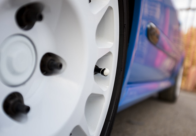

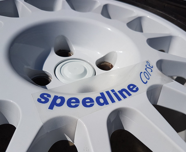

I had ordered some stickers from N2Grafix as my other stickers are not coming yet due to the chap being busy. He did apologise to me so all is good. Picked these up for £8 off ebay in medium blue.
Seen as the wheels were clean i decided to fit the stickers.

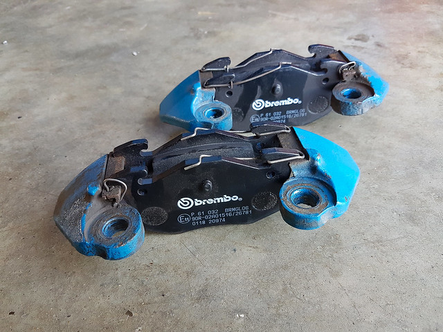

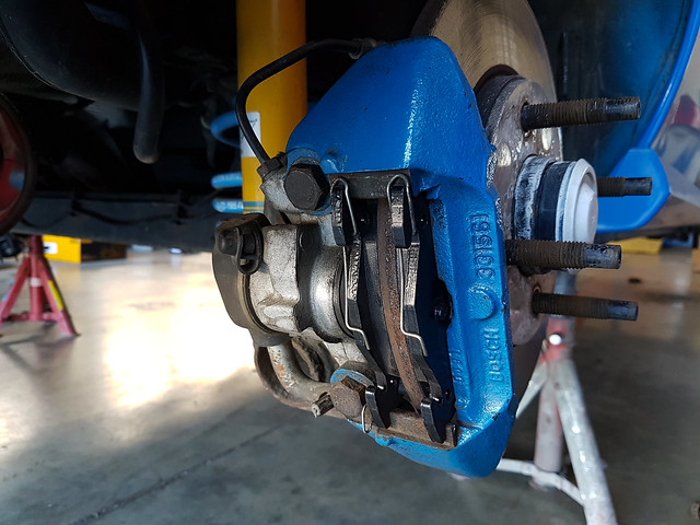

Then onto the rear brake pad change.
