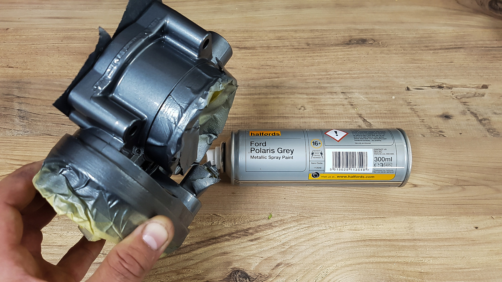

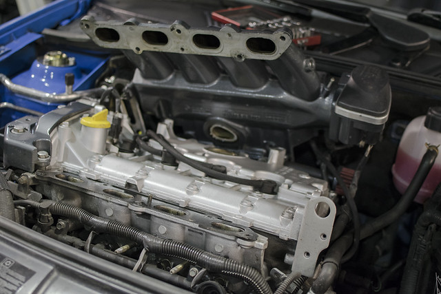

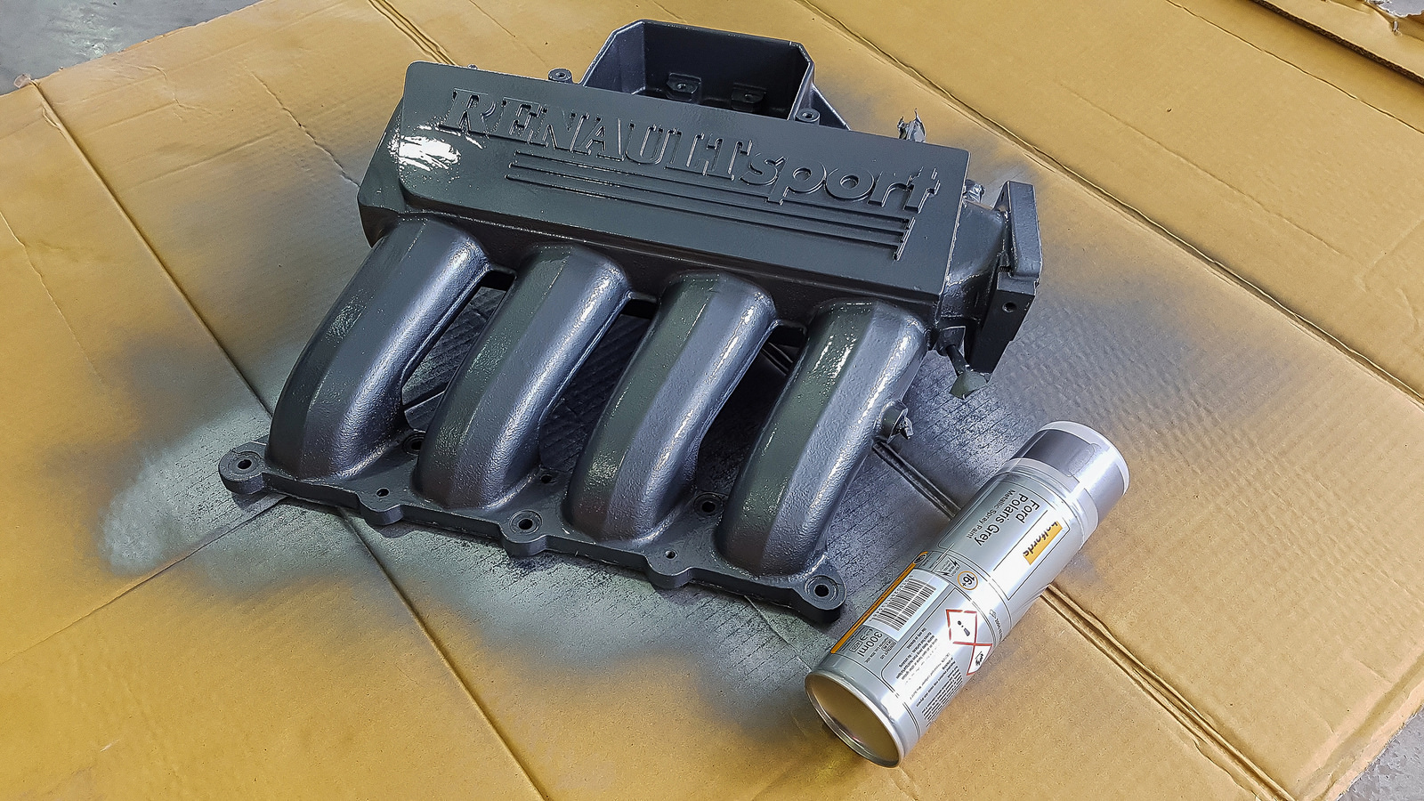

What camera do you use? Also, can you remember what paint you used for the inlet mani and fuel rail guard?
Thanks buddy. Comes up ok for a 124k car :)
My camera is a nikon d3300. My go to lens is 35mm which is probably the lens I shoot most with. I also have a sigma 10-20mm and nikon 55-300.
As for the paint, I used Halfords Ford Polaris Grey.

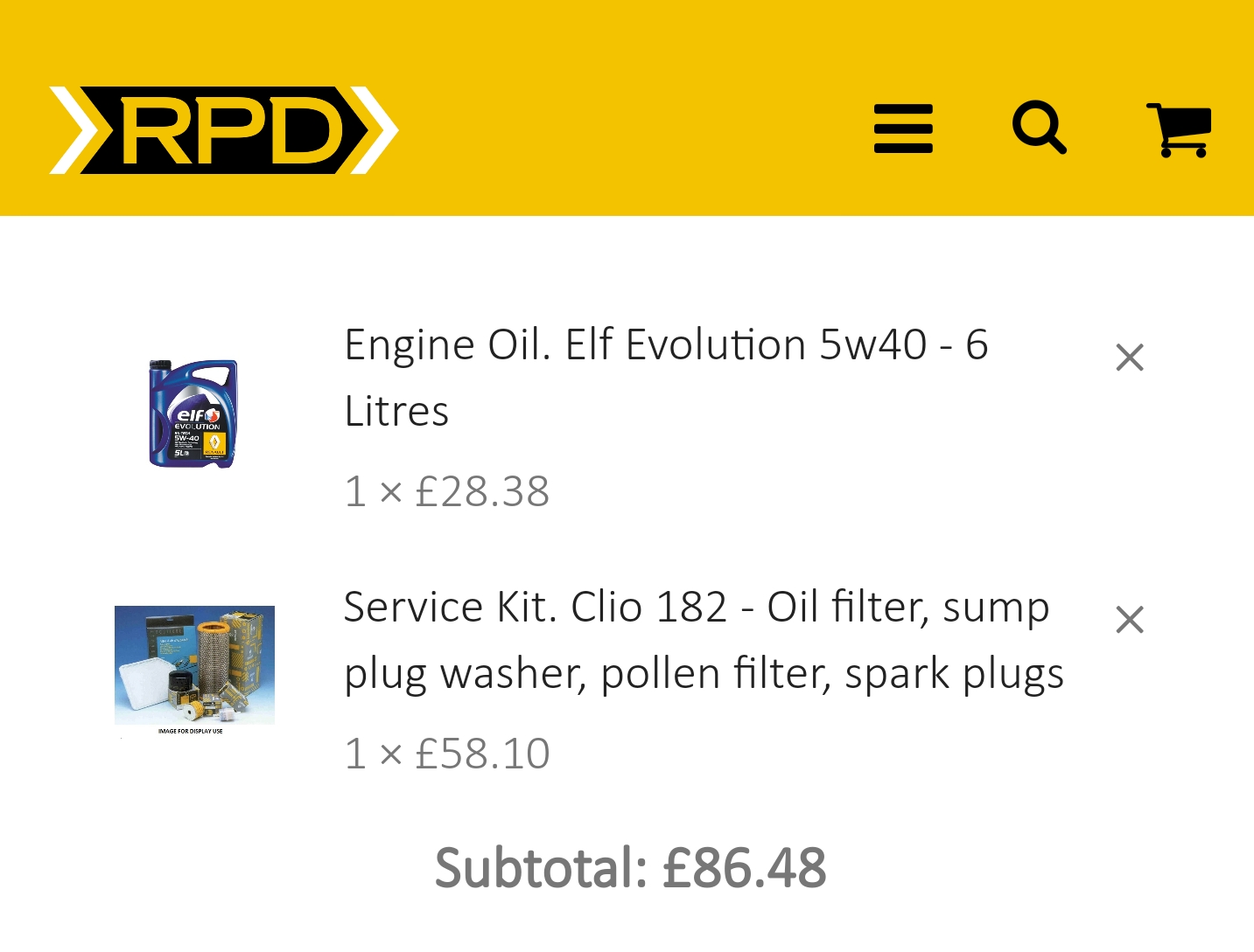

Did you get your new plugs from RPD in the end?
I'm servicing mine and get everything but plugs but not sure where's cheapest for NGKs.
Jekyll
I did Ethan. I bought mine from RPD as I wanted the full service kit and made sense to buy it in one transaction. Deducting the price difference from the service kits they do, the plugs came in at £40. These are the proper NKG ones, just in a Renault box.
However seen as you've bought the service parts already then I'd say to get just the plugs, @George@RTR_Parts is the cheapest around. Plus you can't go wrong with him :up:

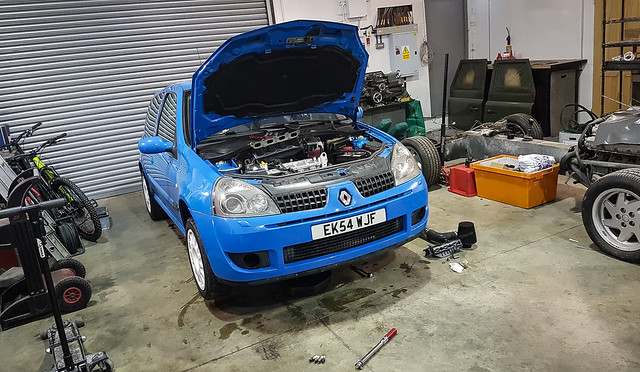

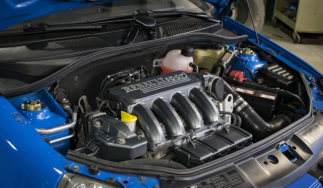

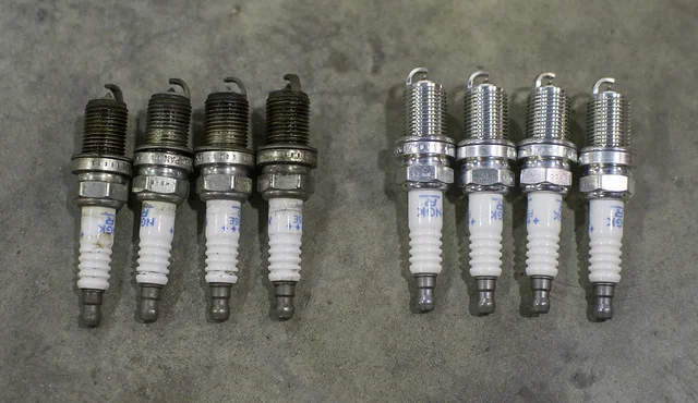

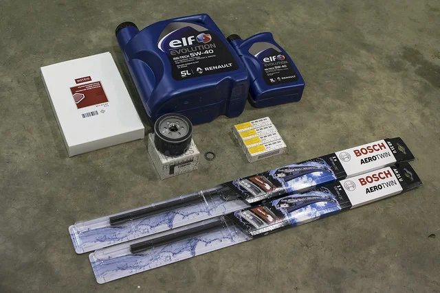

As mentioned above, i got a service kit from Renault Parts Direct and made a start on it thursday morning. I did bits throughout the day as i was working on and off and helped out during the afternoon. Got the car in, jacked up and then removed the inlet so get access for the plugs.
Service kit and new wipers

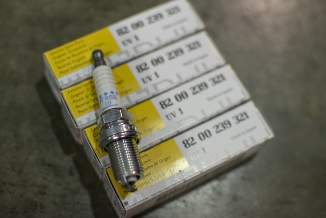

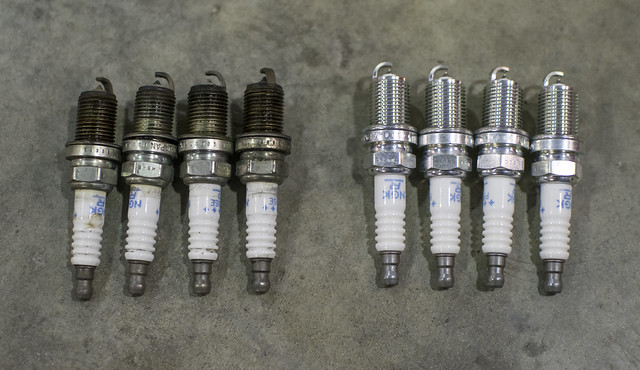

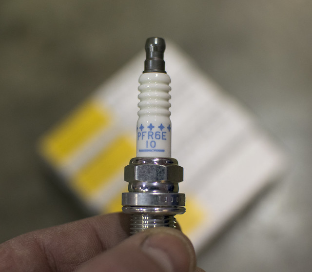

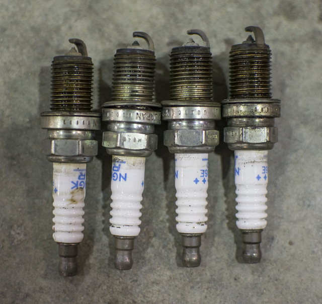

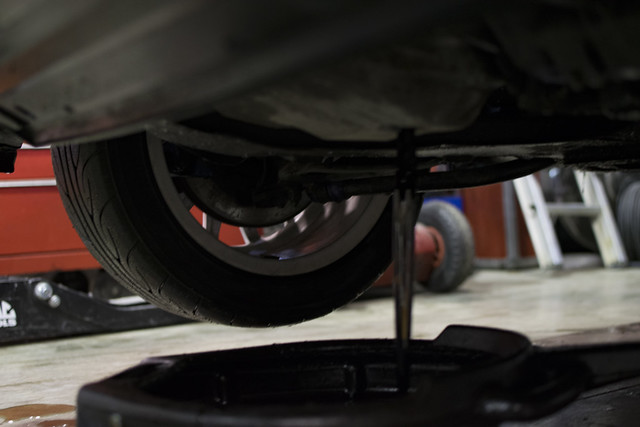

I drained the oil first and let that fully drain while i did the plug change. I've never fitted new plugs since ive owned it, only a spare set from the spares bits the previous owner gave me. This was done last year but for peace of mind i thought i'd buy new on this service interval.
The proper NKG ones, just in a renault box.
Old ones wasn't in bad condition

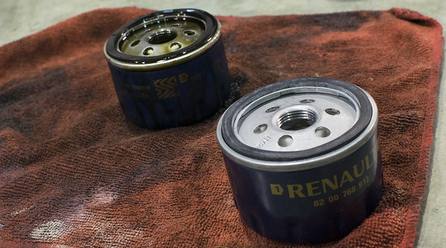

Old Vs New

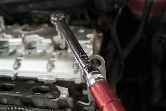

New ones fitted and torqued up to 25nm.

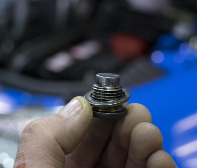

With that done i removed the oil filter. I put a rag down to save spilling oil but as always it never works and i got more on my hands and the block than i think was in the actual filter!
New sump plug washer

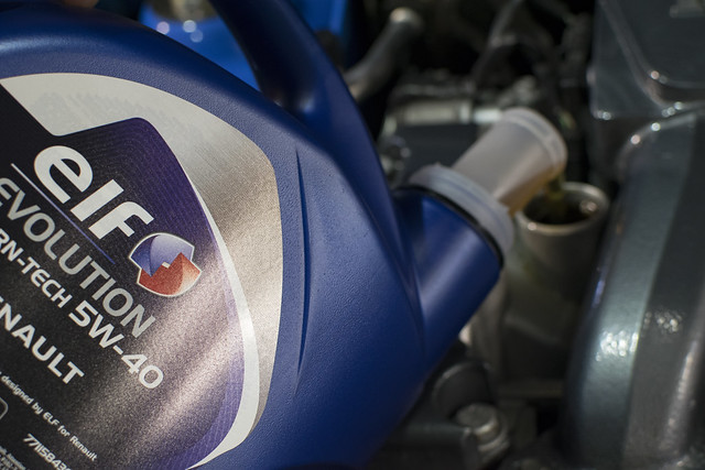

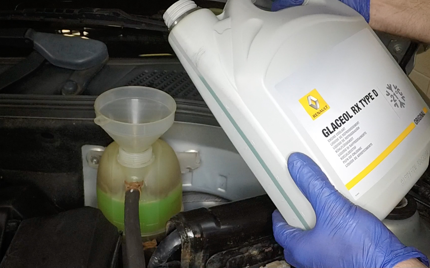

All back together and filling up with the Elf stuff

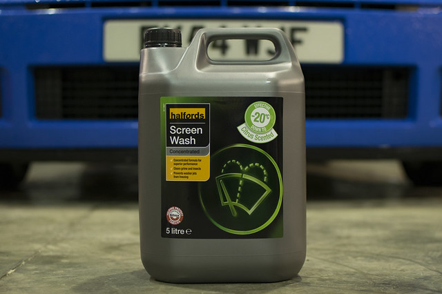

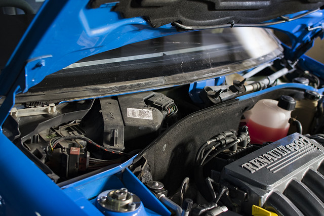

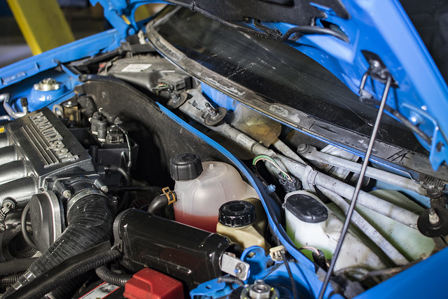

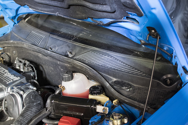

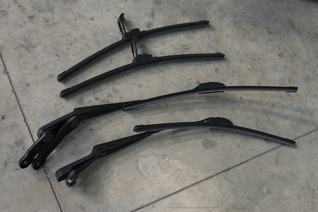

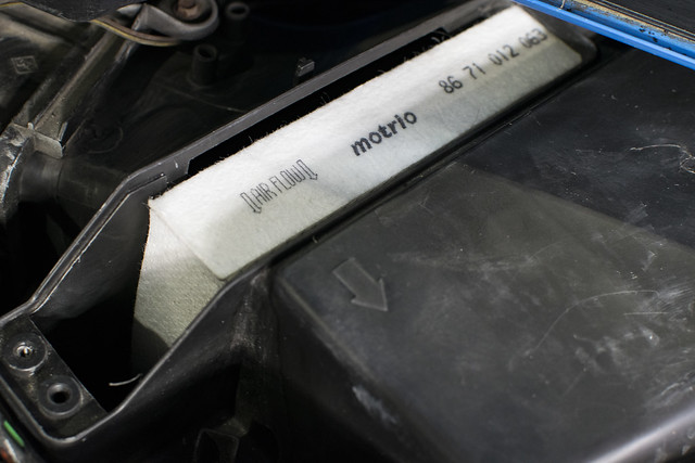

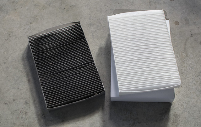

Next up was the pollen filter change. I removed the wipers and took apart the scuttle panels. I also filled up the washer bottle with halfords screenwash. I like this stuff as it looks like predator blood!
I also gave it a bit of a clean under there. Pointless really as i doubt i'll need to go under there again!
New wipers fitted
Service complete

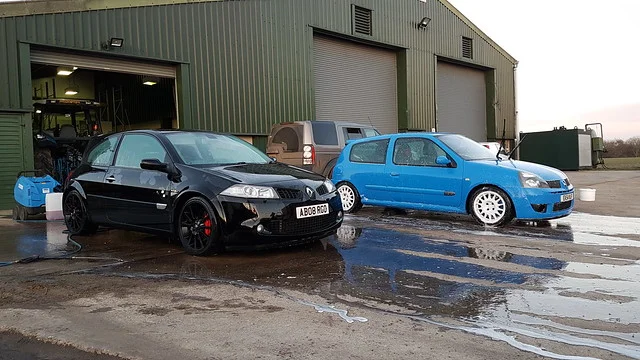

Then me and a chap at work washed our cars.

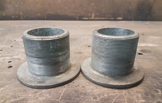

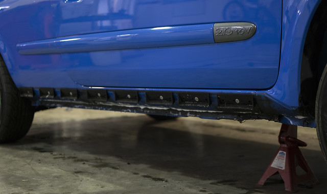

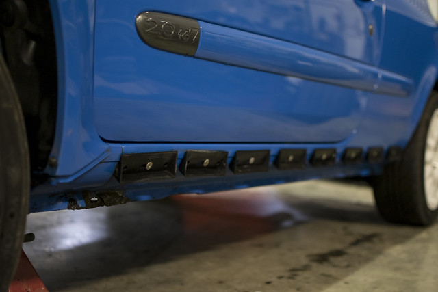

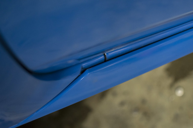

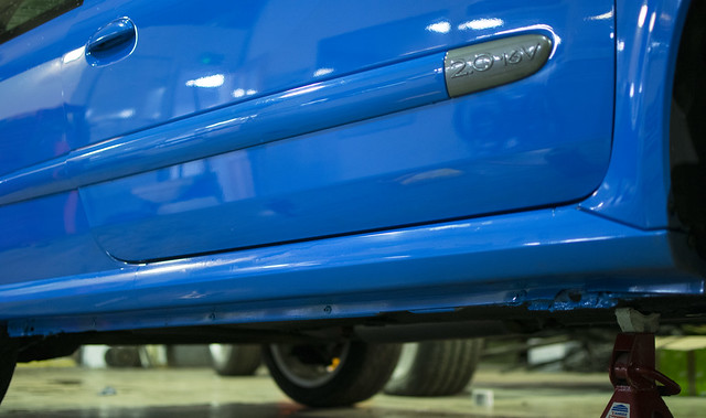

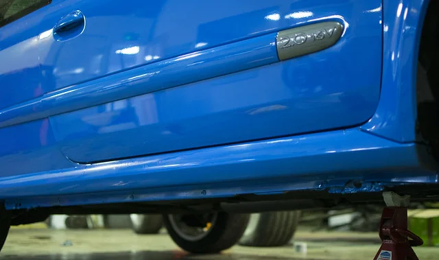

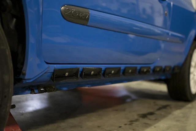

Then i bought it back inside to dry and did something that i've been wanting to do for absolutely ages. I decided to straighten up the jacking points. Now i know they are crap and i think most have bent up, but mine was bad. I hated seeing them in side pics i've taken over the past. So i decided to take the sills off, straighten the jack points, give it a clean up, refit and rivet the sills back on and give it a small bit of paint. Luckily i had a small bit of RB paint let in a spray can so i used the last of it up on this job. Not the best, and i will have to jack it up on a different point now, but this job has made me happy and not only is it straight for side pics, but the sill actually fits next to the door now!!

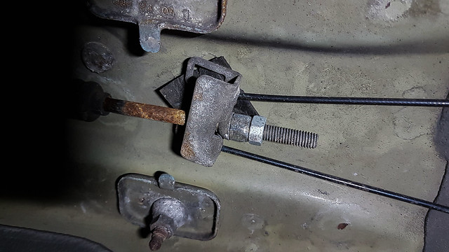

The last job was to adjust the handbrake cable as it was pulling up a bit high for my liking.

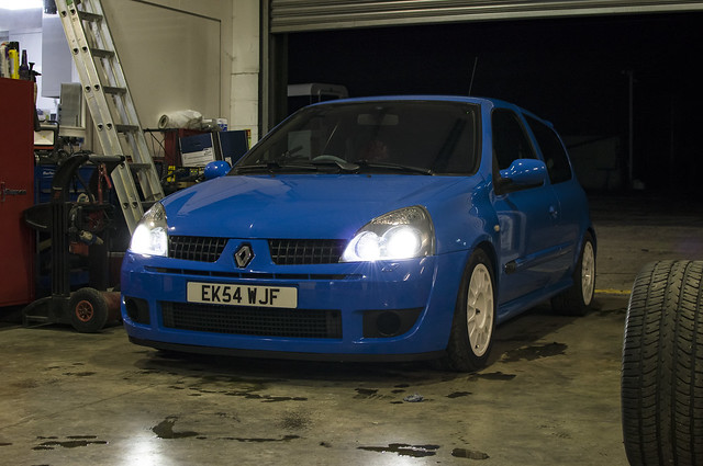

All done. Was dark by the time i was finished but got a pic anyway.

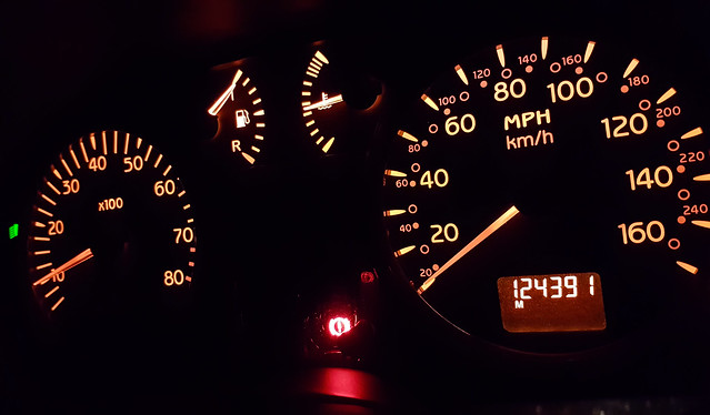

Mileage at this service interval

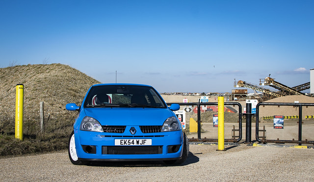

Then on saturday me and @MrBlonde went down to dungeness for some pics and a bit of a drive. I've been wanting to visit here again for some time. I went there a good few years ago with a couple of guys that were on here at the time. This pic was taken of my old BG and i loved it and wanted to get a similar shot with the RB.
The weather was absolutely blinding :cool: Be rude not to take pics of the cars while we was down there so here are a few.

Cracking mate, i would never jack a car up on the sills. I used to jack my PH1 up in the middle of the rear beam and at the front on rear sub frame bolts. (after driving it up on bits of wood)

You know what, I think because they was already bent, I just got carried it on out of laziness/lack of care but I'd obviously had made it worse overtime, but enough was enough.
I did Jack it up on the surname bolts this time and will continue to do so from now on. Either that or the actual chassis but I can do the latter with the jacks at work as there just not low entry enough.

I ended up bolting a bit of 1/2” square bar to the jacking points, provides a good point for the jack plate and spreads the load out to stop the sills bending up [emoji1303]
Yeah I have a bit of 25mm box section that I think I will do the same with. I welded a bit of box section at the same place on my old ph1, but I think I will bolt them on this time.
Got any pics of yours? Did you drill all the way through the box section or only one side and have the nut on the inside?

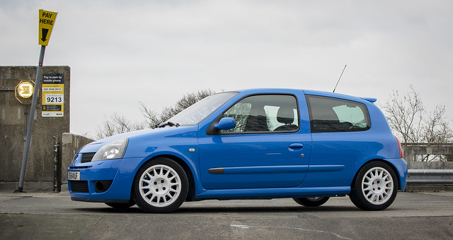

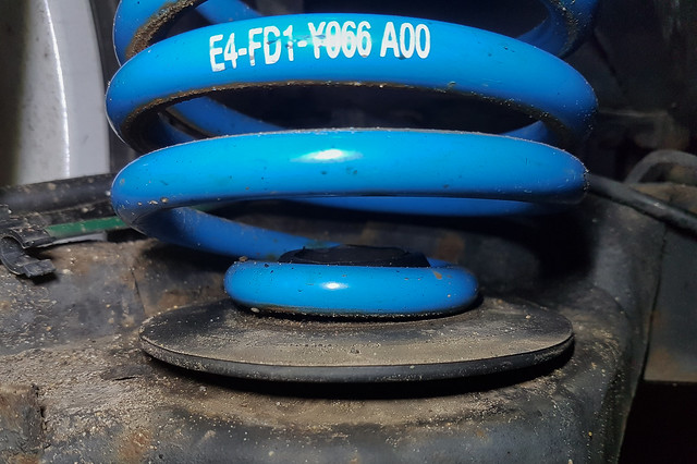

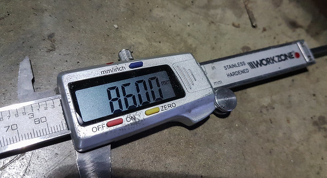

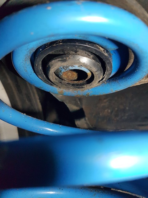

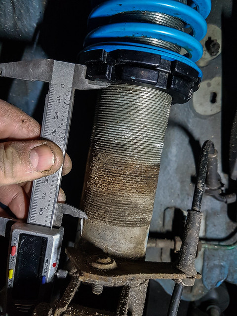

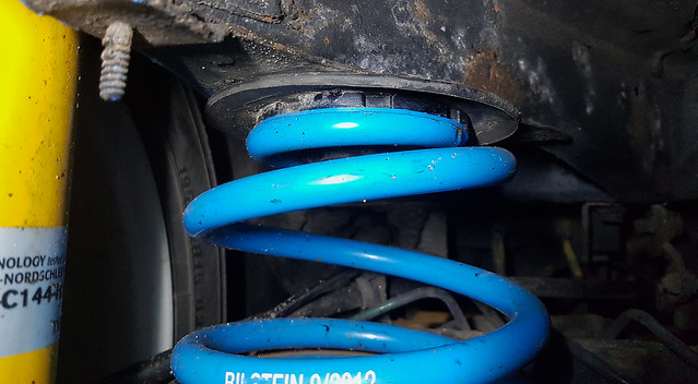

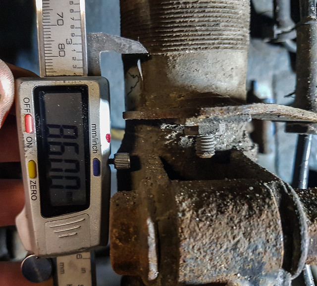

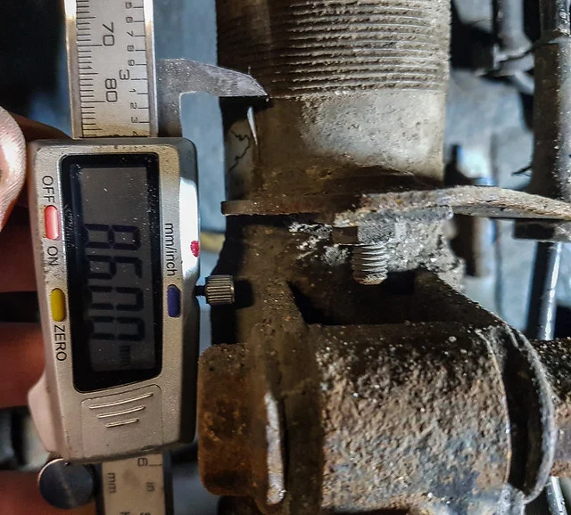

I've been asked by a few members now on how ive got my ride height set up so i took a few pics last night which may help others.
The rears are basically as the kit comes apart from these:
The gap between the lowest part of the arch to the ground is 580mm. This give this drop side on:

It’s been a few years since I did it but I’m pretty sure I bolted it right through...
used the existing hole in the sill and then used hammerite on everything.
When I finally get a chance to work on it again I’ll renew them with captive nuts and dip them in chassis black to stop them rusting from inside/out
I'm thinking of similar by using the existing holes and then drilling all the way through and welding nuts on the back so it's captive that way.
