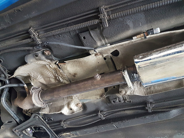

Love the new exhaust, and love the ability to be able to custom make the original cat to fit.

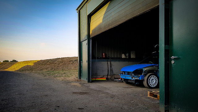

Can you show us some pics of the Mk1 Escort instead of your shed ?
Nah, just messing (and being a knobhead) fantastic update mate, it's sure looking good!!! ???

Glad you’re happy with the exhaust mark, It did look a decent system. I even thought about keeping it for my trophy but have a Yozza to try first, might end up being too loud though!

This decatted dooesnt sound too far off a yozza, just not as raspy.
Cheers Tom.
Yeah i had seen it done before and i thought, i got nothing to lose. Wanted to give it a go as a achievement too, which worked.
Haha, i wish i could. It was being worked on (not by me) and was only in for a few days. I should of got some pics when i took that pic but i didnt for some reason. It was proper cool too. Widerned arches, a drop and revolutions ?

Two quick questions. Where'd you get the brass inserts from for the gear linkage thingy?
And I noticed you don't have the springs in on the manifold to cat joint. Have you had any problems as I'm constantly trying to fight a losing battle trying to get that joint sealed. Have you got the gasket in still?

I spoke to @Yanoo who does the brass bushes. Was £9 delivered and does feel tighter. Not a lot of money and I wasn't to sure how old the old ones were.
As for the cat bolts, I've never had a fitting kit on this. And I'll be honest I've never had an issue. I see people all the time saying get a genuine cat fitting kit but I've not experience issues yet.
I did think about getting one recently but forgot and just fitted the exhaust. I spoke to @Louis about epc ones and he didn't recommend them. I still have the gasket in place and have just not and bolted it.

That does sound proper naughty on the decat, think you've made the right choice there Mark - tempted to decat mine sometimes but would be more of a hassle for me come MOT time so haven't bothered, but that's a real touch you can swap them over so relatively simply!

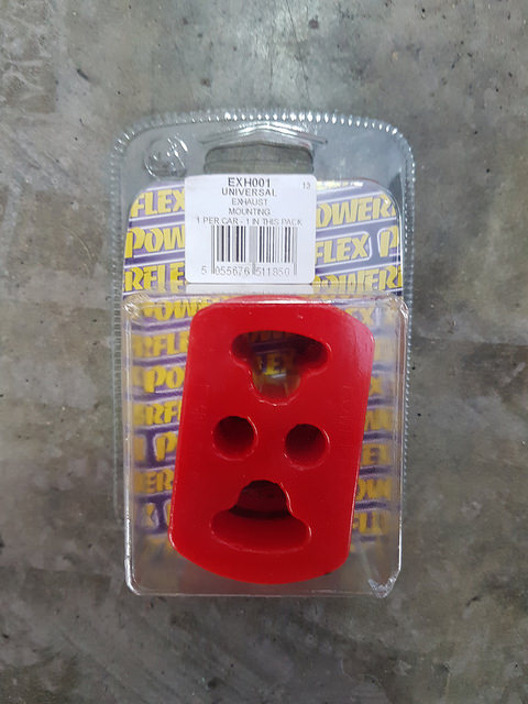

Bought a new powerflex mount for the ktec exhaust hanger as the standard one was a bit perished and made the system sag a tad.

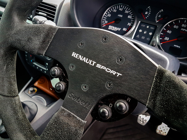

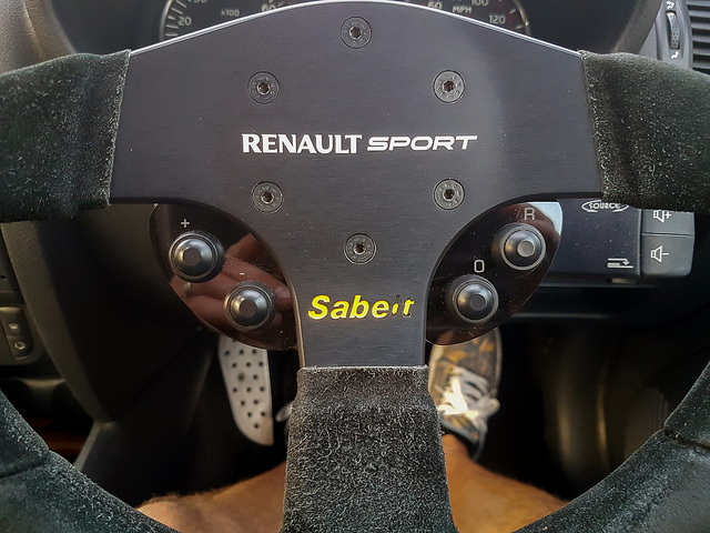

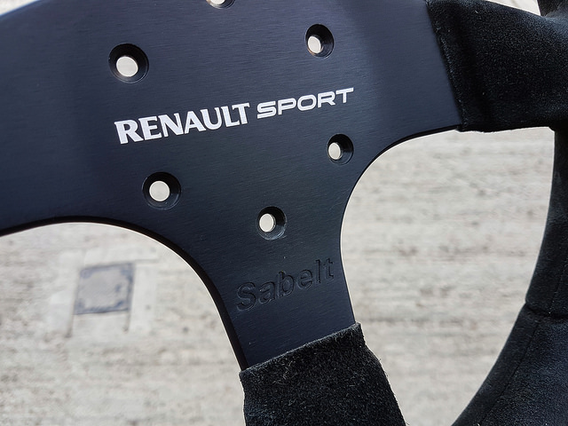

My sabelt writing on the steering wheel had chipped. I decided to remove it all so i could repaint it all in one colour rather than trying to touch it up. I have bought some Tamiya yellow model paint to paint the lettering but haven't got round to doing that yet.
I dont like the look really but its better than half painted lettering. Steering wheel is looking really tired now so a retrim needs to happen really. Unfortunately snappy cant seem to get the blue alcantara so i think i'll speak to royal steering wheels about it but that can wait as its not a priority at the moment.

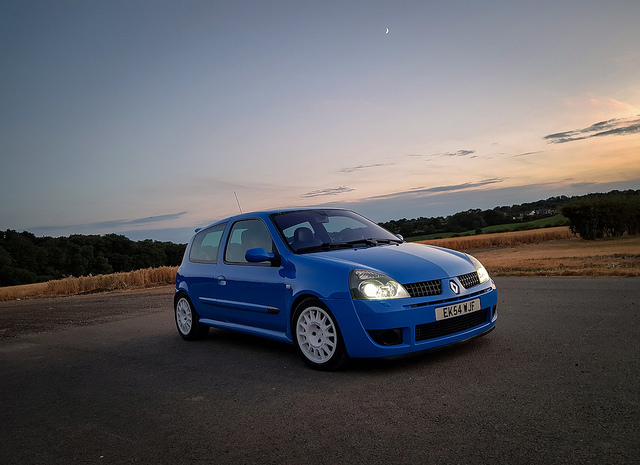

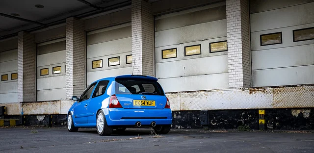

Got a few shots of the RB after work in the sunset:
Love this one:

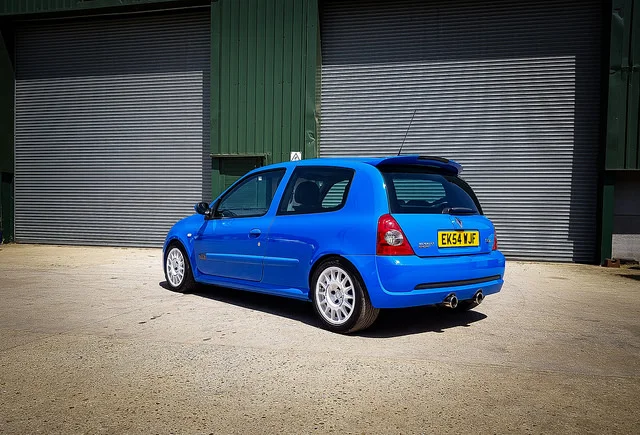

And then a few more after it was cleaned one weekend:

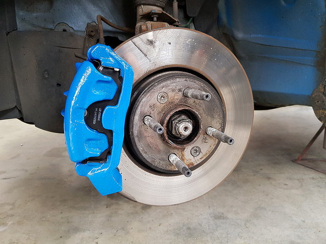

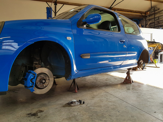

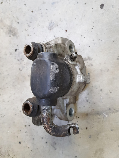

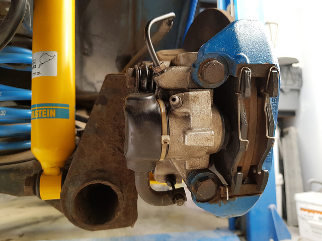

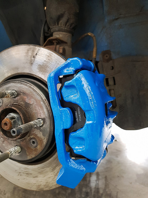

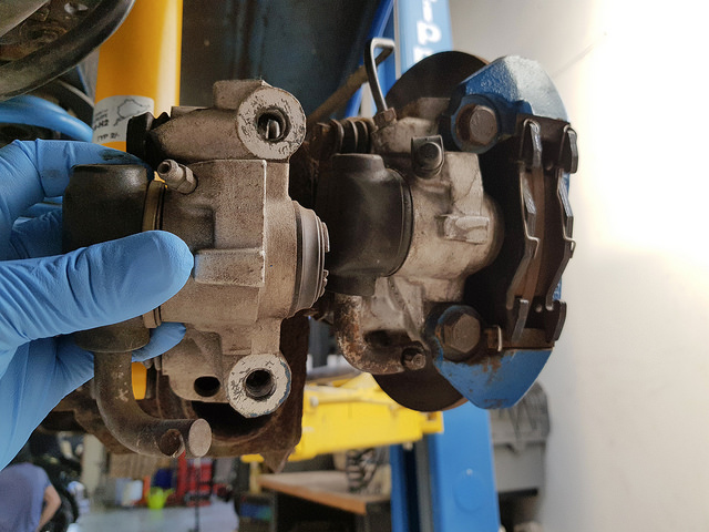

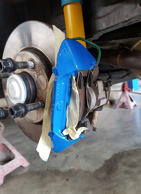

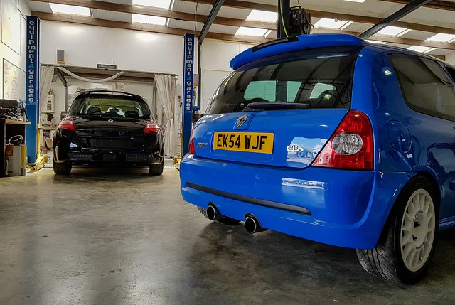

My handbrake just wasn't working so i got it on the ramps to investigate and it turned out to be a knackered drivers rear caliper. It was moving as it should, but wasnt appling the brake so the wheel would just turn. I had a spare caliper at work but for months i though it was a passenger rear. I nearly even threw it away a few weeks ago as it was just sitting under my toolbox and i couldnt be bothered to sell it. Turned out it was a drivers rear! Happy days! So i swapped it over, re-bled the brakes and now its all good and working.
Worn caliper removed
Replacement caliper fitted
MOT was due to run out so i booked it in and it passed with a clean sheet ?

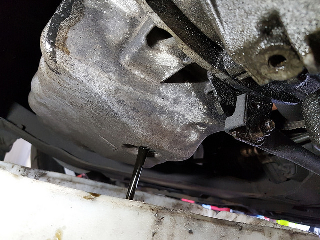

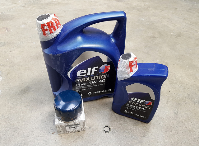

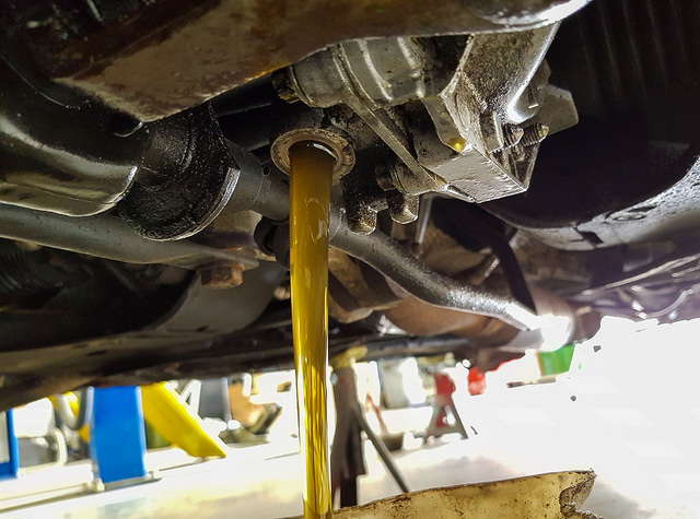

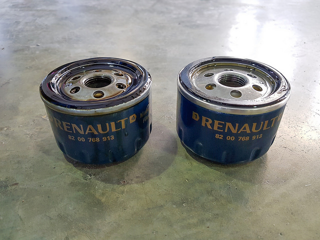

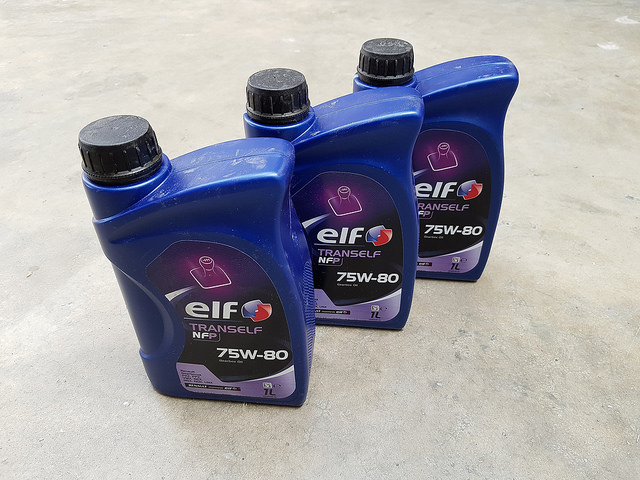

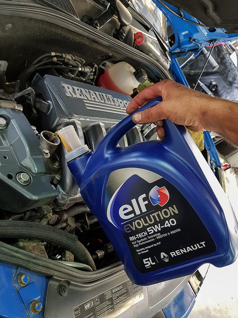

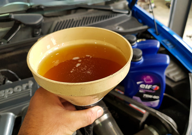

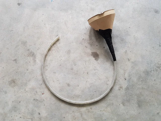

Then i did a engine and gearbox oil change:

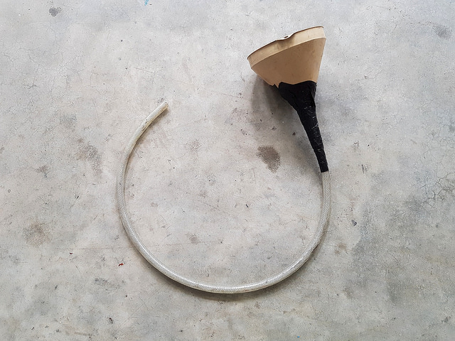

Got my trusty gearbox oil filler tool: Garden hose on a funnel!

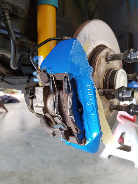

I also gave the brakes a top up of paint. Will get some thinners on the paint that went on the pads at a later date.

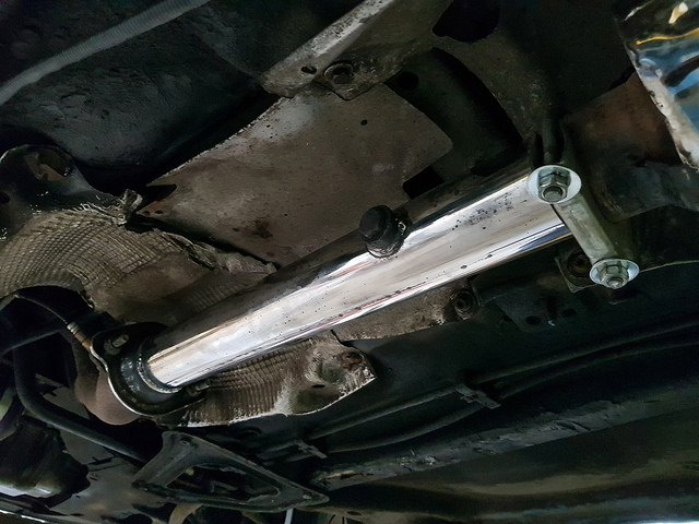

Then after work one night this week i fitted my decat, again! Yes it is more droney, but my cat sags too much and scrapes, which was annoying. Plus it was tight between the heatshield and the gear selector so fitting the decat has given me more room. Lambda fitted to the heatshield so its out of the way. I will change the exhaust clamps too for some proper ones, but i haven't ordered them yet.
And a quick pic after it was fitted

What I meant was, I gave it a oil service of engine oil and filter and new gearbox oil. All fluids checked and all is good so no need to change anything else really.
Plugs and other bits was changed on the last service 6 or so months ago.

Good Job mate,pretty much the same as what ive been doing to mine,i painted the calipers and did a brake fluid flush.Along with oil and filter change,also a rebuild on the rear calipers.Need to sort that little road trip soon mate while were getting this great weather!?
Very nice as always Mark, the usual attention to detail I expect :D
I'm going to go against the grain however and say I prefer the Sabelt engraving with no paint, as it is right now - just seems to match the interior better somehow!
I don't know Steve. It just looks a bit.... unfinished? Maybe because I've always known them as having yellow paint. Don't get me wrong, the steering wheel is well work and in dire need of getting retrimmed.... but I feel the need for yellow.

White or blue would be the only colours I'd contemplate, but I think on sold on redoing it yellow again.
That sounds like a nice idea actually.
The way these go black anyway you may aswell just buy my sparco with white engraved logo and black tip ;)
Haha, has it been the bath? That could sway me...

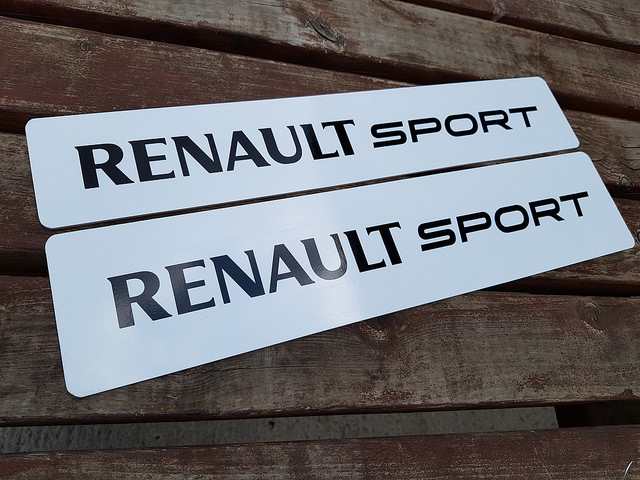

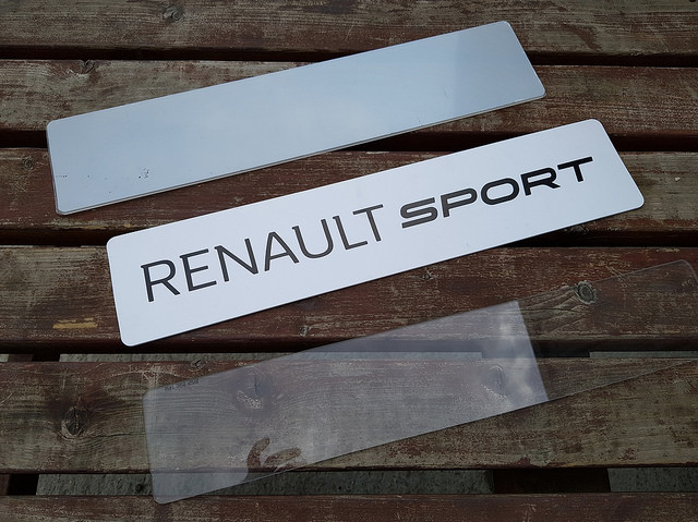

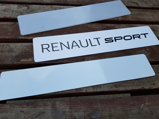

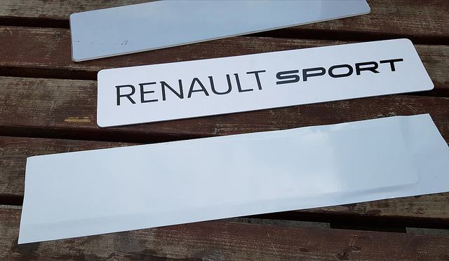

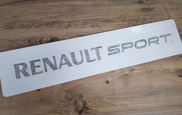

For ages, ive had some stickers made from @LeeRS as i wanted to do a Renault sport plate, but in 3/4 size so i can swap when i take pics.
I got a standard plate and cut it down to size, then added a white strip and cut it to size, then place the renault sport on top. I had bought the genuine plate a while back but didnt like how flimsy it felt so i wanted to make my own set. Not perfect, but pretty happy with them.

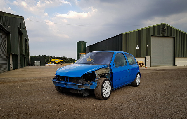

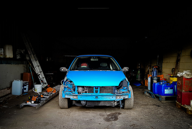

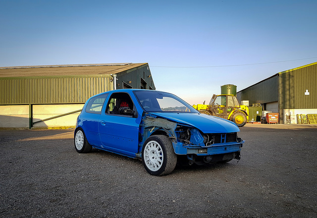

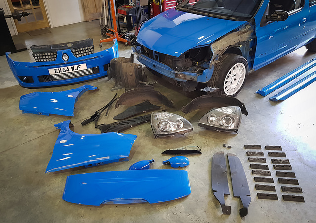

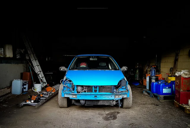

Then after work this week, the stripping has started for preparation for new paint. This was the first night.

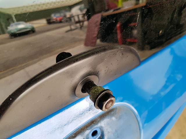

All came apart easy and as it should apart from 1 bolt under the drivers wing which was rusted. Belt sander sorted that out.
Then i got arty with the parked up/ stripped pics:
2nd night. More was stripped. Al rubbers and door cars removed, handles, wing mirrors, speakers, boot lock and wiper motor. Unfortunately, i bent/crimped the passenger side door rubber upon removal. It may be salvageable but i'll enquire about a new one. The rear wiper decided that it didnt want to be removed. Im toying with doing a wiper delete and fitting a wiper blank as it doesnt really get used but i may just buy a new arm and remove the stripped cog. Will ponder on it. Lastly, i just caught my wing mirror plug when i was winding up the window. It will plug into the loom but i will buy a 2nd hand one and solder the wires together if i can. Other than that, all went smooth.
I will keep posting regular updates ?
Jekyll
Pretty much tom.
All outside panels. Not bothered about door shuts as it's all clean in there.
Doors, bonnet and boot will be removed. Rear bumper is good as it was painted the other month. Not painting the roof and some things I'll just polish up, such as the rain drips.

The Renault Sport plates look great!!
Does it need painting ? It always looks really good in the pics (sadly I don't think I've seen it yet)
Jekyll
Thanks mate. Should be good when done!
Thanks mate. Not bad for home made and I really like the 3/4 size. I did use sappy water but there are some air bubbles still but it's ok unless really up close.
