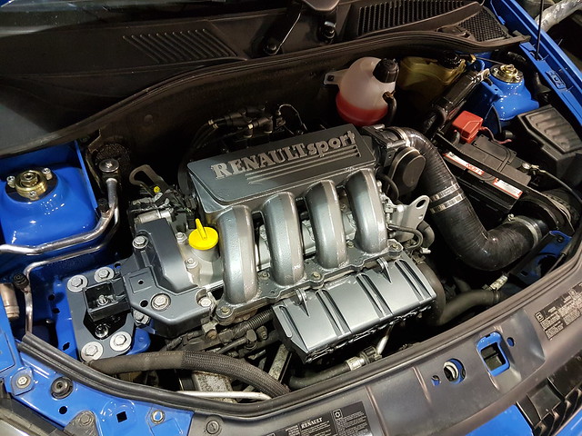

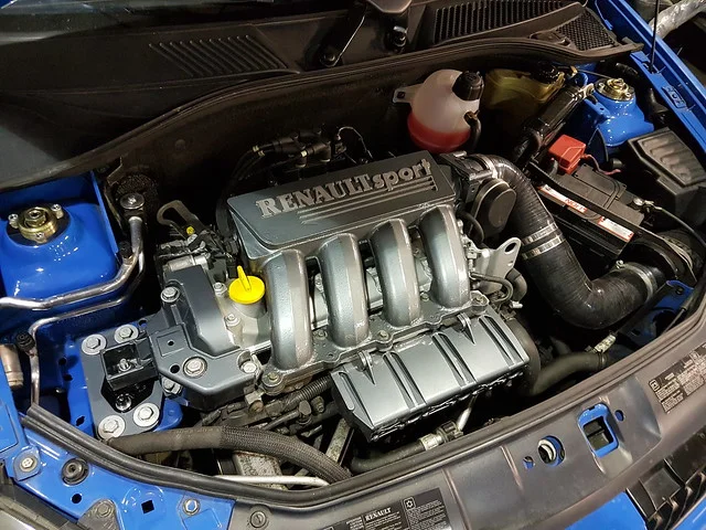

Did you do the engine bay yourself?
I have a powder coated inlet etc to go on my RB and want to clean up the rocker cover and maybe even spray it. How did you do yours?
Yes I did. I just degreased the engine bay, covered everything up and painted it silver. Admittedly I removed all the inlet as I wanted to check the plugs and leads.

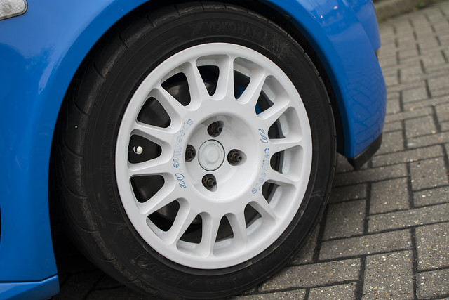

Have noticed that my speedline decals are starting to disappear. Admittedly i was told they would eventually as these are the motorsport spec ones so it was only a matter of time. Thinking of ordering some decals of N2Grafix off eBay. I'm thinking of going medium blue like they originally was, although i have pondered about an anthracite to match the bullets.
When the weather is better im going to give them a proper clean (de-tar, polish, wax, etc) buff all the decals out and fit new ones.

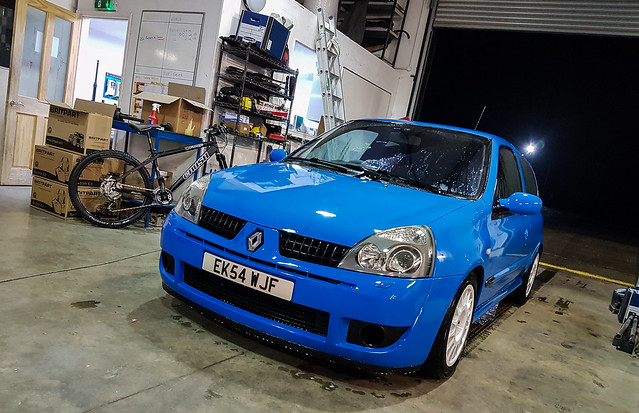

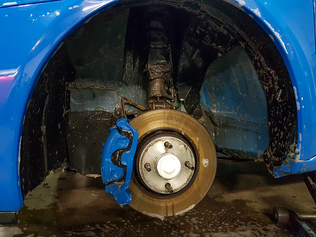

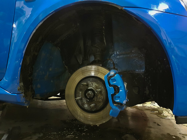

After work one night i decided to give the arches a clean. Not sure why because it was cold and raining and they would get (and indeed did get) filthy on the way home. Good old mental brain!
All done. I used some stuff called Rhino 105, which was amazing! Borrowed some off a chap at work but i will be making a purchase of some myself after using it. I sprayed it on, let it dwell then agitated it with a brush and rinsed it off. Came up lovely.

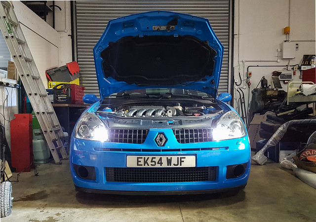

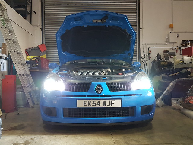

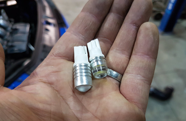

Next up was a bulb change. My interior light had blown and i wanted to get some proper cree sidelights like i had in my ph1. So i bought some off HID's Direct.
https://www.hids-direct.co.uk/501-w5w-5w-cree-canbus-led-extremely-bright-sidelight-bulbs/

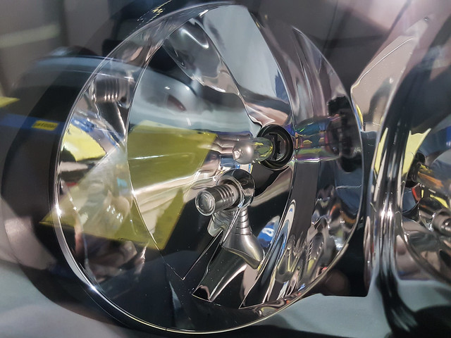

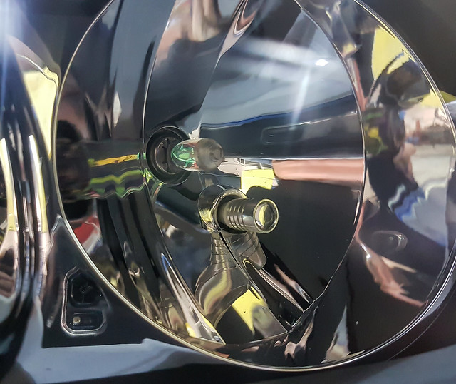

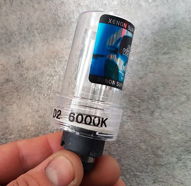

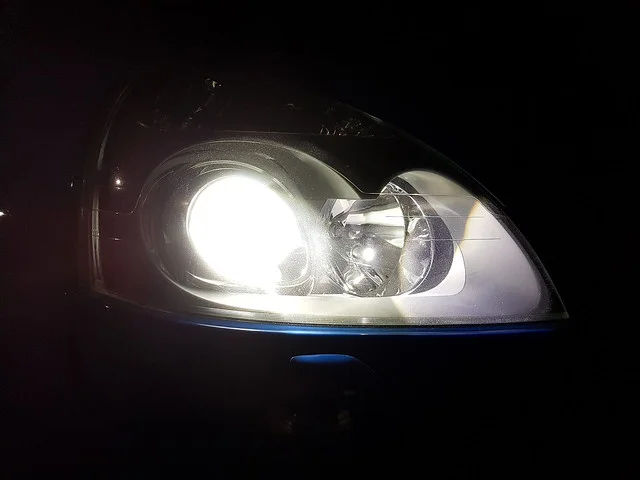

I also ordered some new xenon bulbs. I opted for 6000k ones as i wanted a tint of blue to match the new cree sidelights. My current 5000k wouldn't look as good next to them.
https://www.hids-direct.co.uk/d2s-35w-premium-hid-xenon-bulb-set/

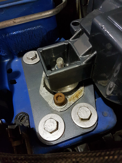

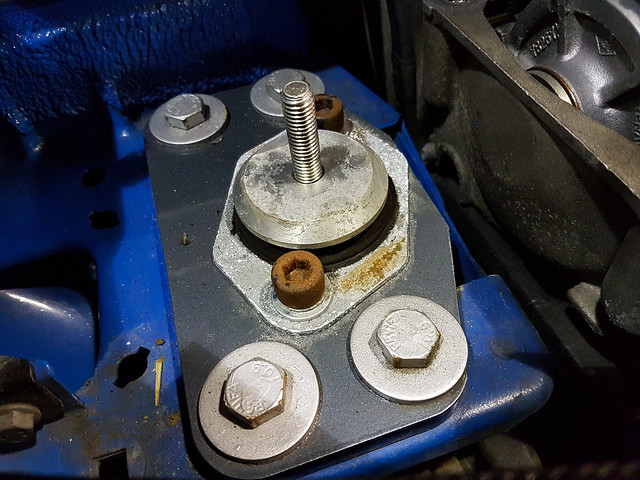

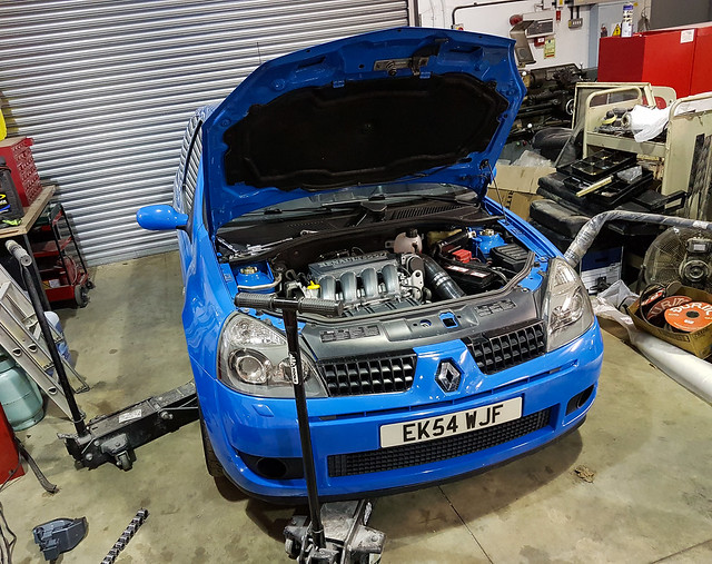

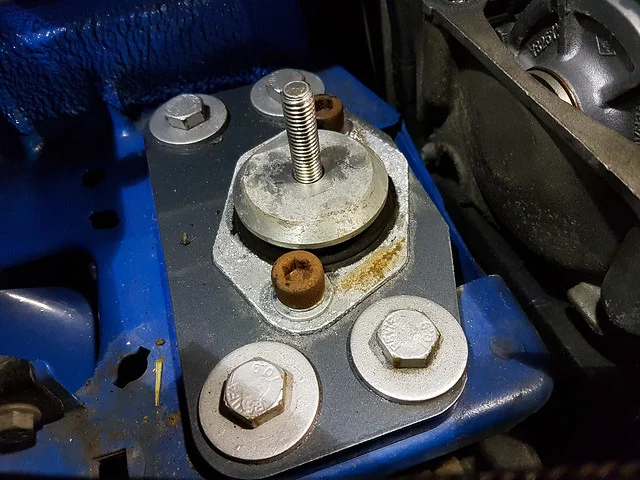

Once they arrived i set at fitting them. While it was at work i decided to paint the engine mount as it was was a tad rusty along with the retaining bolts. While the mount was out i removed the little black plastic holder that held one of the pipes to the carbon canister (Not needed as the canister has been removed last year) and gave the area a small clean up.

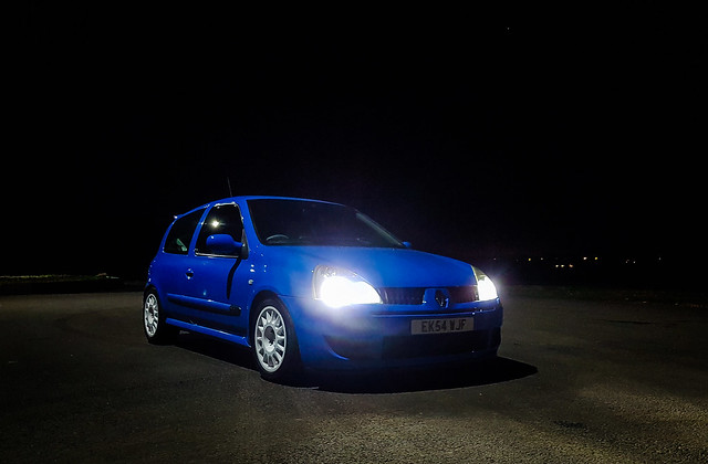

Ignore the D2 label. I got these thinking they was wrong as i know the standard is D2S. I gave HID's Direct a call to which they clarified they would fit and the difference between D2S and D2R is the coating on the bulb for reflection housing which i don't have being a projector. But i thought its better to ask, than assume.
Its hard to picture the brightness and colour. In these pics they look white, but they do have a tint of blue in them both. Unfortunately my camera doesn't capture it fully.

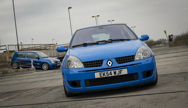

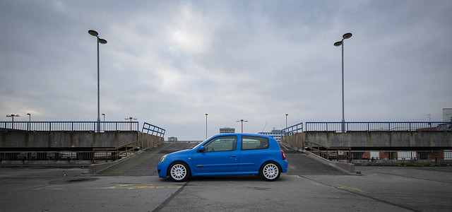

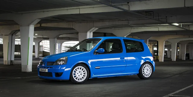

Met up with Steve @MrBlonde for a couple of pics at a local multi storey car park after a south east meet.
And my personal favourite
Full set can be found here:
https://www.flickr.com/photos/58003155@N07/albums/72157691467819744
Thanks for looking :smile:

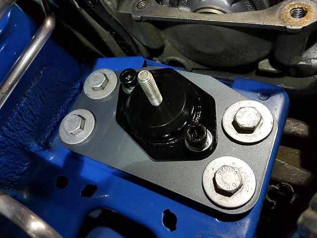

How are the engine mounts with a full interior? Mine need doing soon but was planning on standard fresh ones.
Had a full set of solid ones before but that was in my rattle box PH1. Didnt mind the harshness of them in that but in a fully furnished car I imagine it's a bit more subdued.
I'll be honest Chris, it's not as bad as expected. I don't find it an issue and it's been on for 2 years. Maybe because I'm used to it. It's worth it for the feel and look when you open the engine bay.

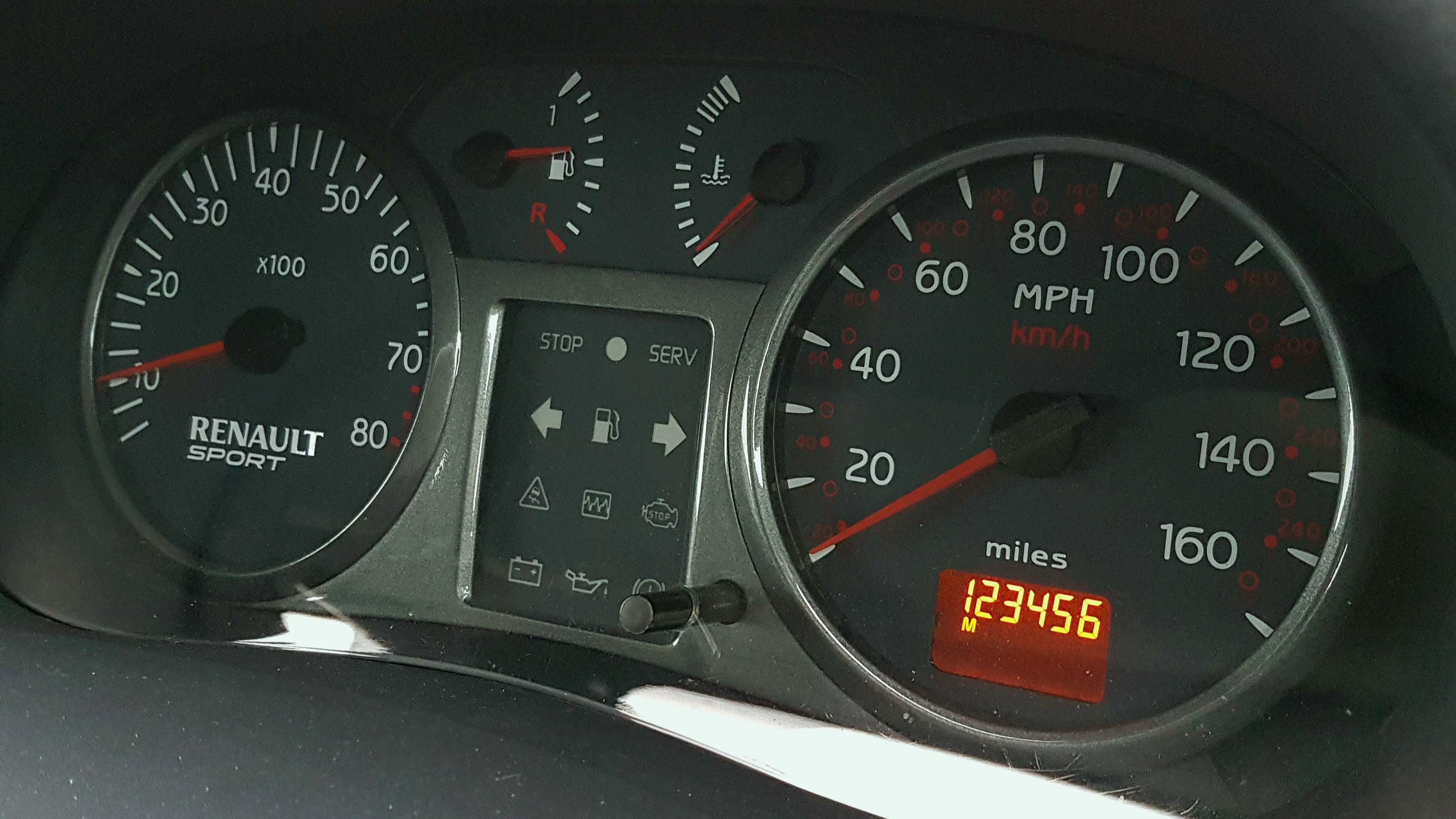

I hit that mileage when I got to work and took a pic, but it was dark at 7am so I took another pic at tea break which was the one I posted.

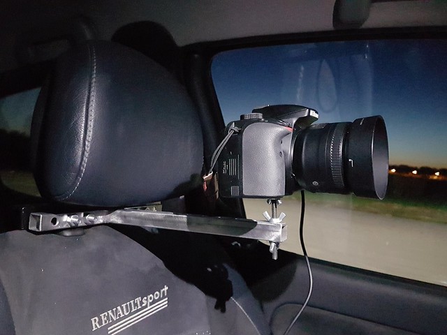

Decided that i'd have a go at some long exposure in car pics. I made a mount at work and gave it a go. Its not perfect and its unfinished but i wanted to try. I still need to have a further play and get the settings right. It also doesn't help with the bumpy roads and being on coilovers but here is my 1st couple of attempts.
Im definitely going to have another go on it, but so far its only cost me time and the studding and wing nuts as these are 1/4 UNC pitch which most cameras are unless they are the big boys ones. The metal we had at work. I have welded some wing nuts to the clamp bolts and have an angle bracket which locks in past the head rest. Ive also drilled 2 more holes either side so that it fits onto most vehicles now. My headrest spacing is sLimmer that a new clio but hopefully this is now universal as ive measure it on @Ricardos 200t EDC.

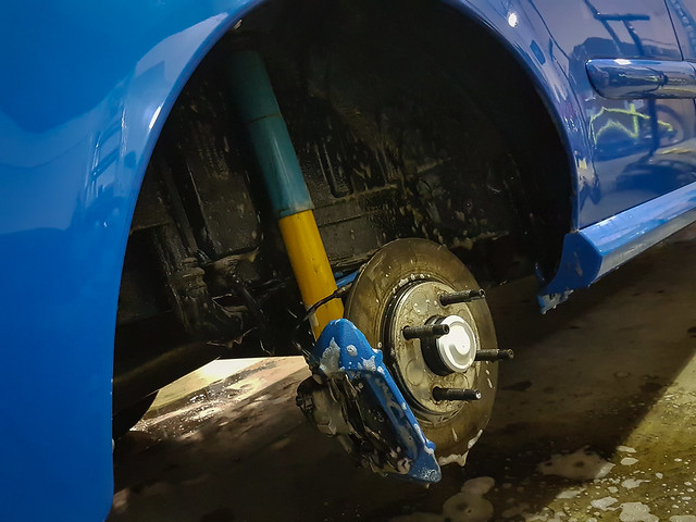

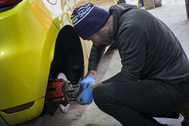

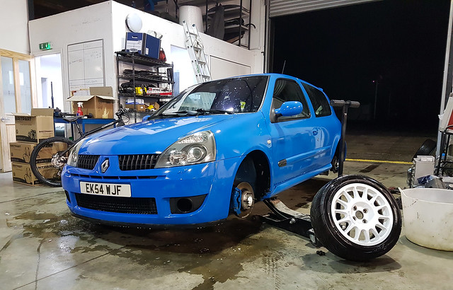

Next up was a tinker-time with @Ricardos again. Rich came to my workplace to fit some wheel studs to his EDC and give the car a check over and i wanted to check mine over too.

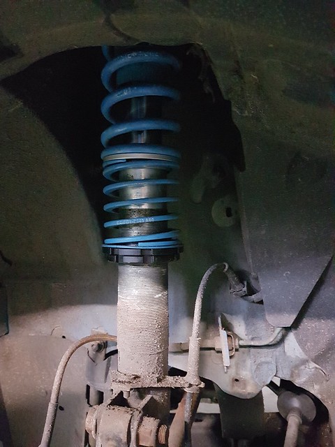

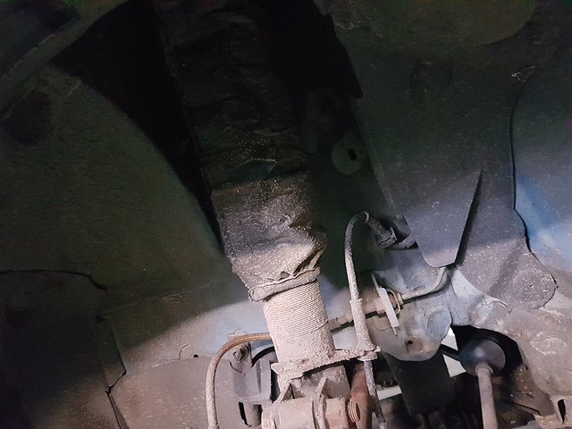

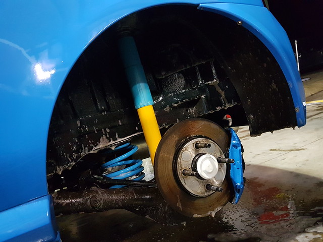

One thing i wanted to check was the coilovers. Removed the covers and they still look decent so the covers was definitely money well spent. It was the same both sides, but only pic of one side. The crud on the lower part is to be expected as when the car is down, the covers ride up slightly.
Then i decided to remove all my speedline decals as it was annoying me with some of them faded. Doesn't look as bad as i thought tbh. Will leave the stickers for now but ultimately i think i will add them back on.
After that we washed the cars and got a few pics.
