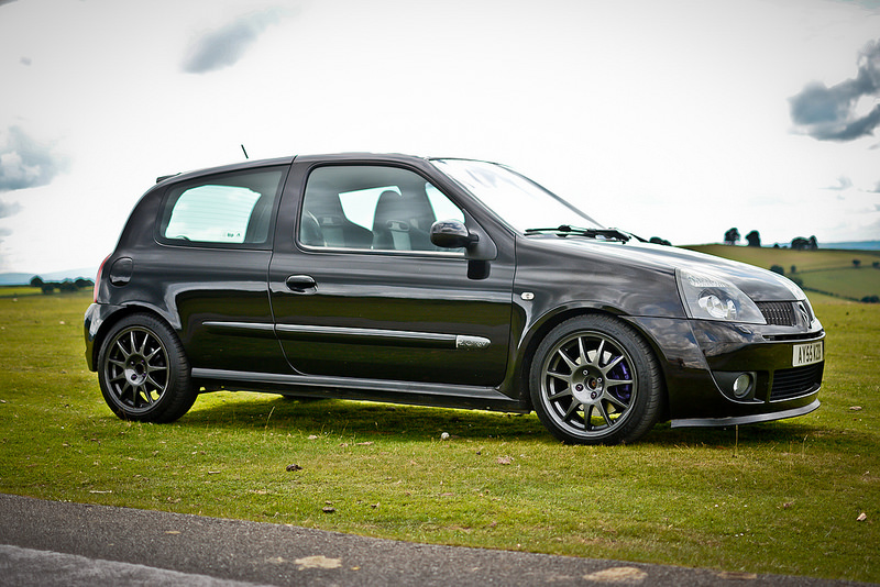

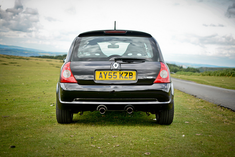

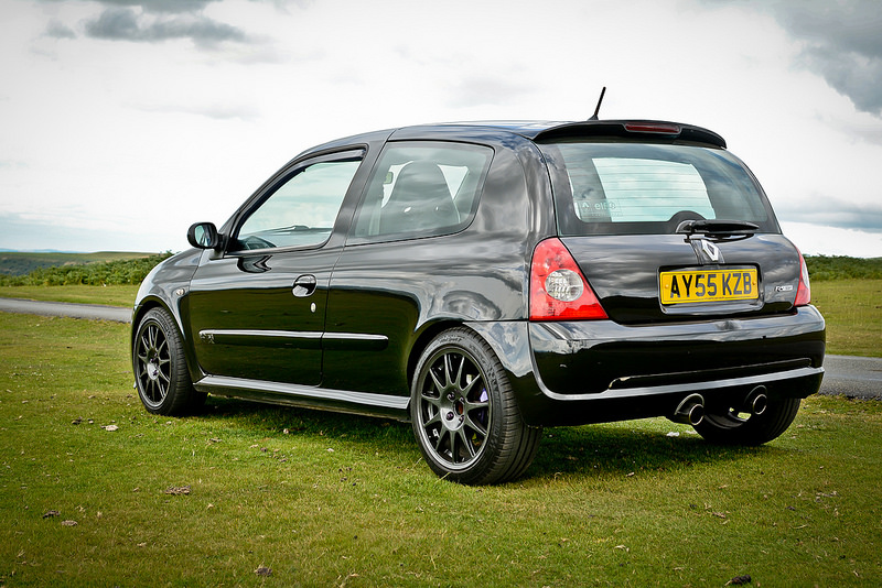

Never clicked until tonight on FB that that was your RB 182, looks absolutely mint! Trophy Spoiler or a Rep?
1234

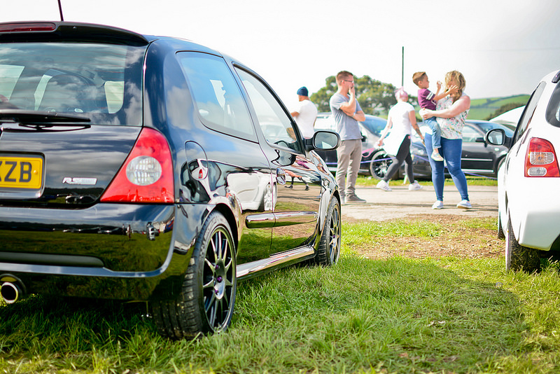

by Jimbob_2705, on Flickr
Shame I only had my iPhone on me, but still came out half decent after a quick clean
If anyones looking of for a decent spray on wax/detailer - Sonax 'Brilliant Shine' Detailer is awesome : http://www.cleanyourcar.co.uk/detai...brilliant-shine-detailer-750ml/prod_1178.html
Normally get my stuff from CleanYourCar.co.uk , but as a heads up its cheaper from EuroCarParts, especially after using one of their discount codes, I've just bought 3 bottles to stock up with!

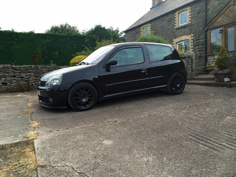

Yes, but I have to confess it's got a set of 19" alloys in the boot so it's fake lows lol
Does make me want to get Coilovers for it though, although how low you could go before you sacrifice handling I wouldn't know...
Thought it was quite low for Cooksports, just drive round with them in the back all the time and you've got lows for a fraction of the price haha.
I'm on KW coilovers and got them quite low and still seems to handle ok. Fair doo's if I raised it a bit it'd probably handle a bit better but I like how it sits atm. If you look in the media section at the 'Todays Yorkshire Meet' thread, there's a pic of mine in there that I took at the weekend.
Just had a look, looks a good height! Is that as low as they go on the back?

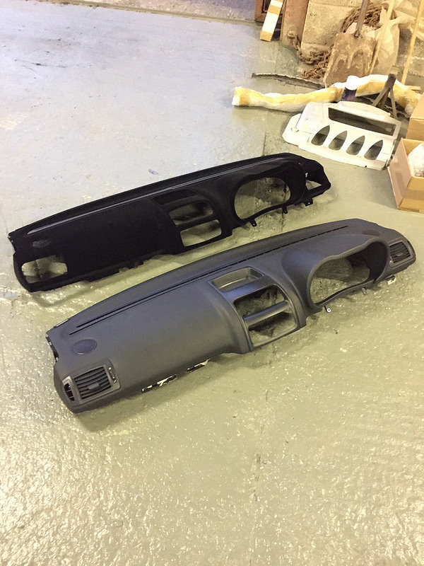

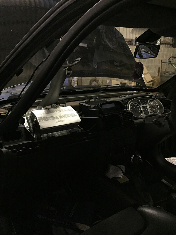

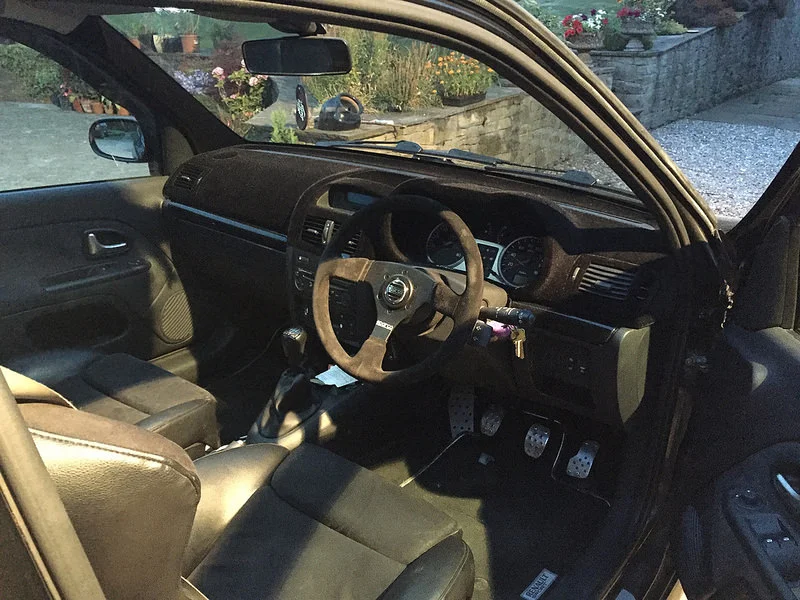

Well instead of fitting all my parts I've bought...I ended up buying more parts!!
Can you guess what I've bought with this as a clue...
Untitled
Pretty obvious isn't it?!
Untitled
That's right, a flocked dash!
Untitled

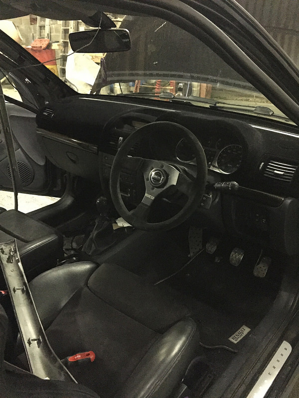

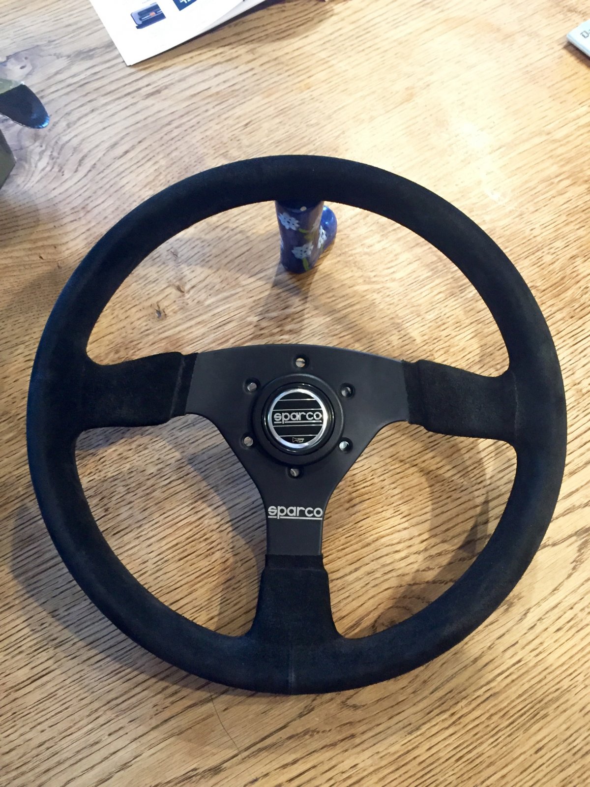

Also fitted my Sparco 330mm Steering Wheel and Momo Boss, and I absolutely love the wheel! Perfect size and looks very OEM (well as far as after market wheels go) so I'm chuffed with it
Got a Cruise Control bracket coming off a chap who makes them on Facebook, so I won't lose any features which is nice
Also used my RS Tuner with the Airbag Module to simply turn off the Steering Wheel Airbag which is awesome, so much easier than using resistors, and just seems less of a 'bodge'
I've got some Flocked A Pillars to fit as well - once I've worked out the best approach with my alarm sensors
Half tempted to just not fit them onto the new pillars as they'll look rubbish being grey, but will it affect anything? Not sure how critical they are? So any advice would be greatly appreciated!

Nice work dude. That wheel looks great too!
Cheers Dan, always wanted to go flocked but couldn't be bothered with the hassle, but there's a localish guy who has started doing Clio ones and at a good price so thought why not!
Yeh really pleased with it, suits what I want absolutely spot on, wanted something smaller but not too aftermarket looking with all the yellow trimming, etc
And at 330mm with a ever so tiny amount of dish it seems perfect, but only early days yet
They're something like £165 new, but I managed to get it at a decent one off price

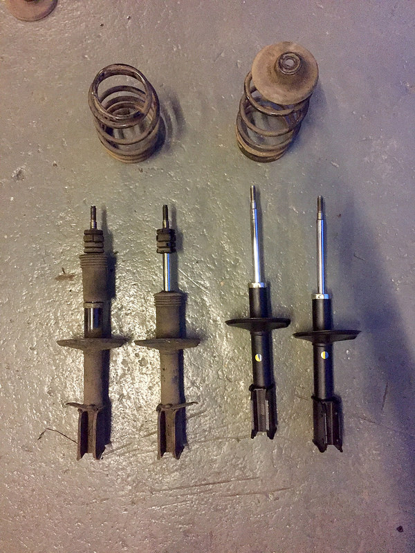

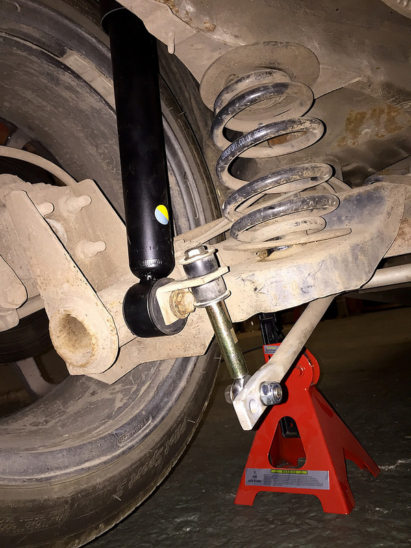

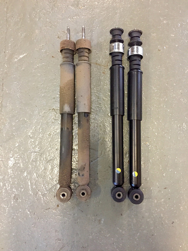

Had another night working on the car, quite pleased with the progress tonight - only quick snaps off my phone again sorry, didn't have my DSLR with me
Changed out the rear shocks for brand new Cup ones
Untitled
Old Vs. New
Untitled

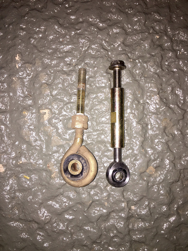

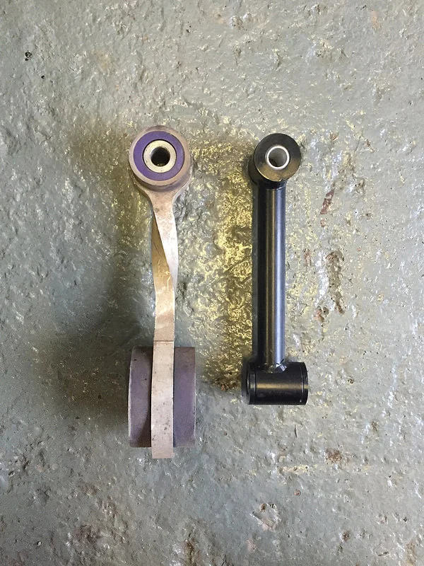

Also uprated the drop links on my Whiteline Rear ARB, not that I felt like they needed upgrading, just more a reason that I could and it gave me something to see if it makes any difference
Untitled
Basically they're just ultra high performance rose joints, with a couple of different type fittings
Both shocks and drop links fitted

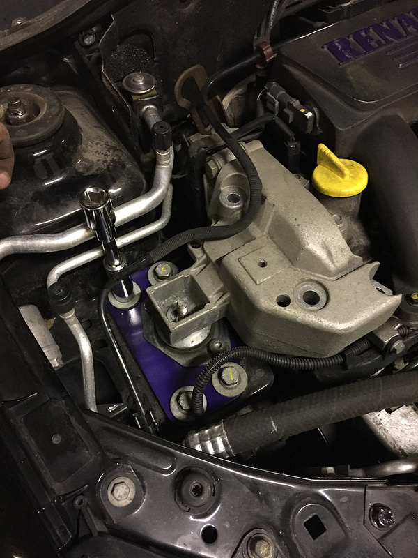

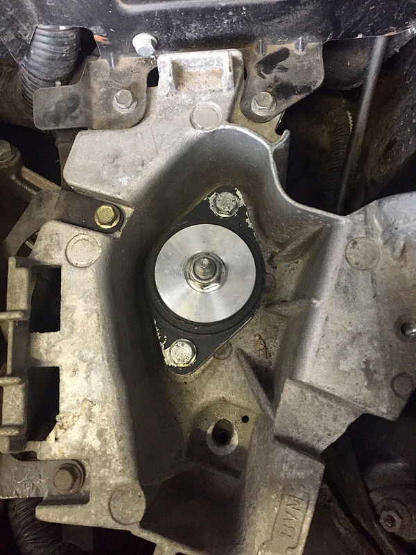

Also made a start on fitting my Vibra-Technics solid engine mounts, fitted the engine one which was nice and easy with the car on axle stands and a jack with wooden block on the sump
Untitled
As you can see I sprayed the base bit purple, more as a test to see what colour the paint was, as it is what I will be spraying a couple of bits (rear strut brace, etc)
Eventually I'll get around to tarting my engine bay up properly, but that's last on my list - performance mods first, along with interior and exterior
I did start on the Gearbox Vibra mount, but if I'm honest I was halfway through taking the cage off and it was 11PM, so thought I'd call it a night and finish it off tomorrow, which is another job for the very long to-do list!

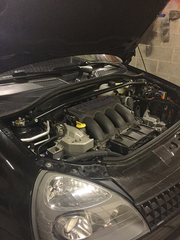

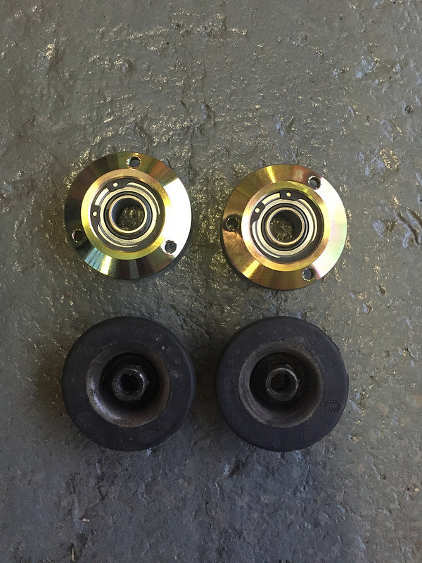

Tonight was the night to fit the PMS Solid Top Mounts and Strut Brace - Exciting times! Although a bit daunting with drilling holes in the turrets
The famous spherical PMS top mounts vs. the old originals

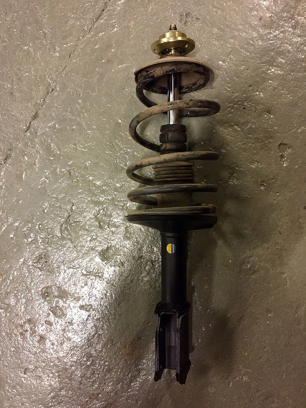

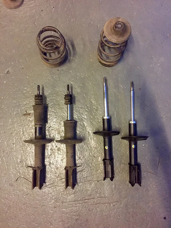

Old Front Shocks Vs. Brand New Cup Shocks
Untitled
New Shock all made up with PMS Bits, unfortunately I never realised new shocks never came with the rubber bits, so had to use them from my old shock (not that it will affect anything, just me and my OCD)

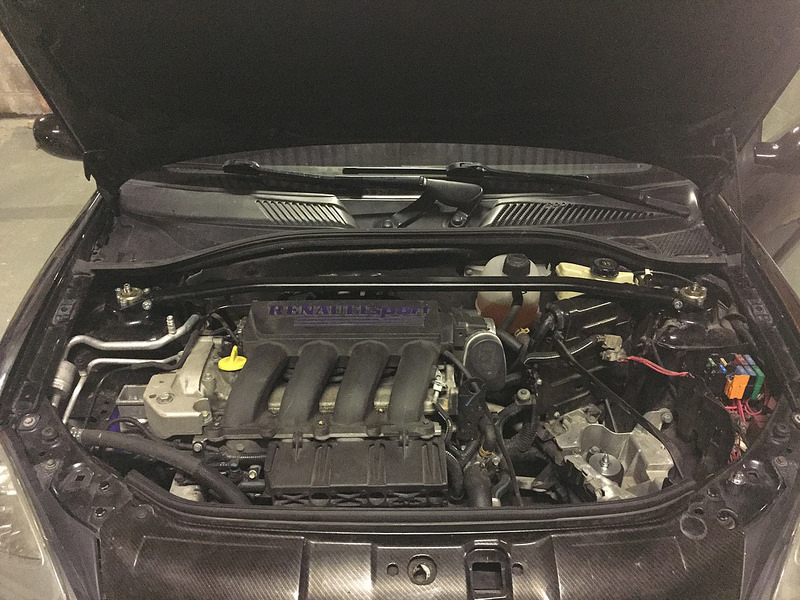

Couple of Engine bay shots with the PMS Goodies all fitted
Untitled
Untitled
Engine bay could seriously do with a good clean and a tart up, but that's the least of my worries for now!

Plan tomorrow night is to fit the new Battery and refit my Fatty Induction Kit, Fit my Evol Dogbone Mount, and hopefully if time allows fit the Powerflex Bushes, along with my Lower Arms/Wishbones

Theese top mounts are.... not good. When you hit in holechina seger broke, and china uniball go away to top. Only way is buing a high precision hard seger, and take care of uniball. Price is big, but precision unfortunely no.
Those PMS top mounts are pure p**n! What springs do you have on mate? I look forward to hearing how it rides with everything new and more solid.
Cooksport Springs, which I'd really recommend if your after a set of springs. Ideally I'd like a set of coilovers (B14's or better), but as I can't afford to go any lower because of the roads I live on, they can wait for now
Your the very first person that I've heard from complaining about them, the only thing I've heard is people saying they're too harsh, but that's just the nature of the product. Everyone else just says good things about them
Time will tell how they go, but from what I've read PMS are great at sorting out any issues - so really I'm not bothered, I'm sure they'll be fine

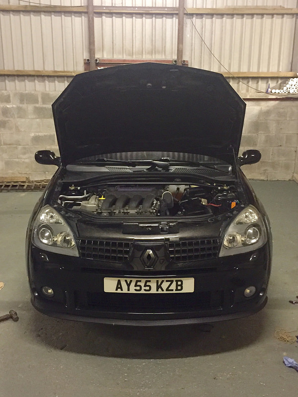

Tonight update isn't anything too exciting I'm afraid, but still got some stuff done never the less;
Swapped my Powerflex Dogbone Mount for a Evol Race Dogbone Mount
Untitled

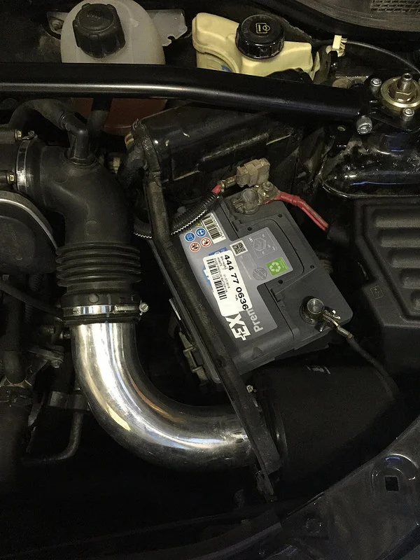

Fitted a brand new Excel battery I bought from ECP, as thought with Winter coming up it wouldn't be a bad idea
Untitled
In that photo you can also see my Fatty Induction Kit, which I've had on for a few months now and rate well!
Put my flocked A Pillars in, but I've decided to spray the Alarm Sensors black, which I'll fit back in over the next couple of days

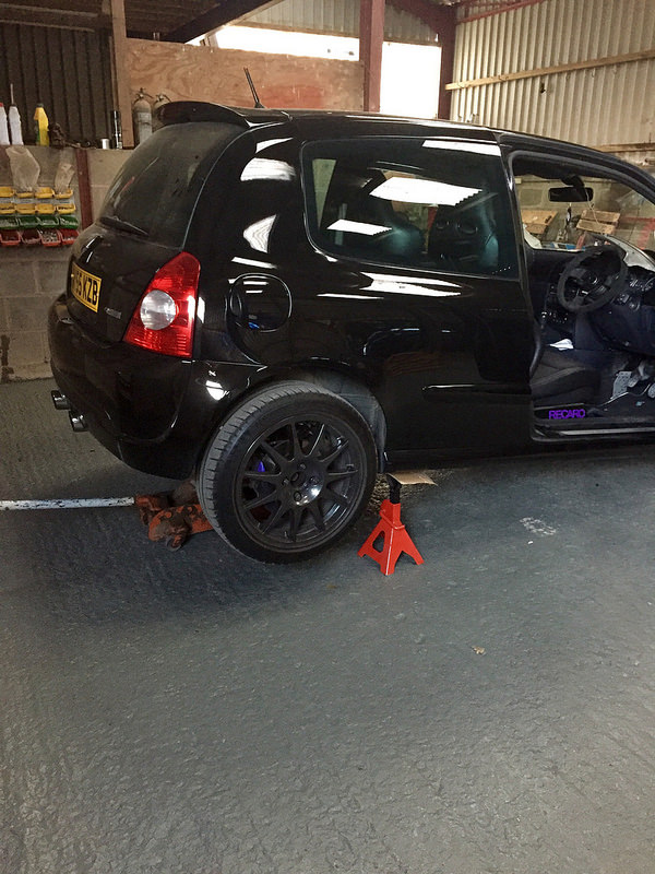

Quick snap of it after being started and dropped off the axle stands
Untitled

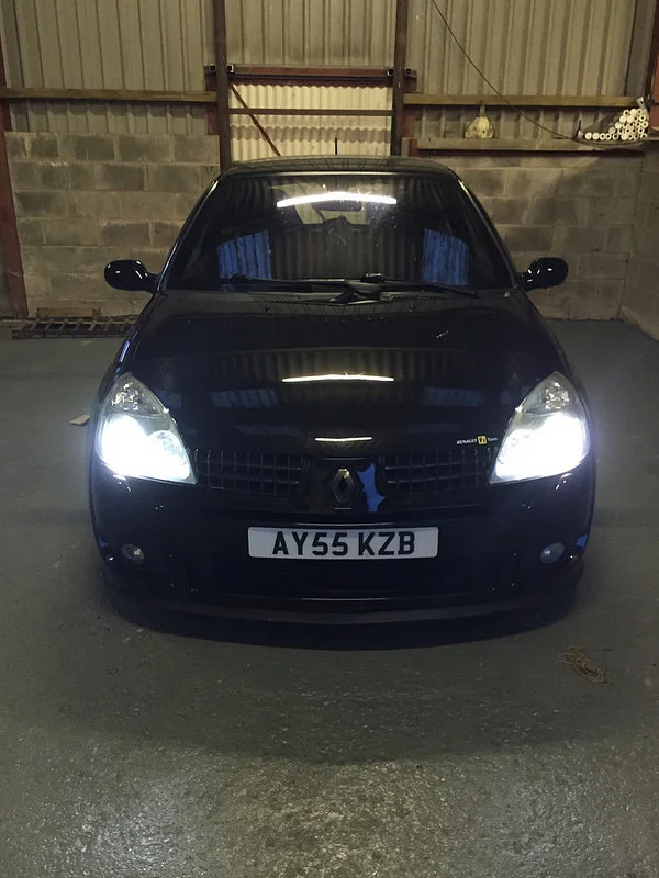

And a quick snap of it parked up outside the garage
Untitled
I've still got lots of things to fit, but I'm just missing the car and I need it for Saturday so thought I'd stop doing anymore until I've got a bit more time. So still to fit I've got the following :
