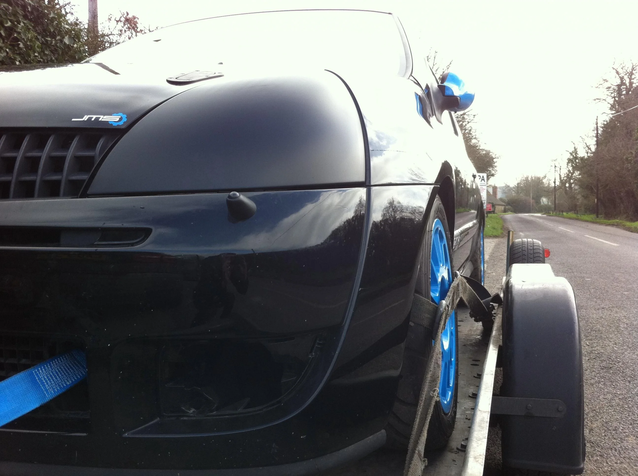

Isn't that thing running yet,![]()
Get those washers removed. As it's a race car you want it as light as poss and those thing are not needed now are they!
It looks shiny.
Did you clean it? :dead:
