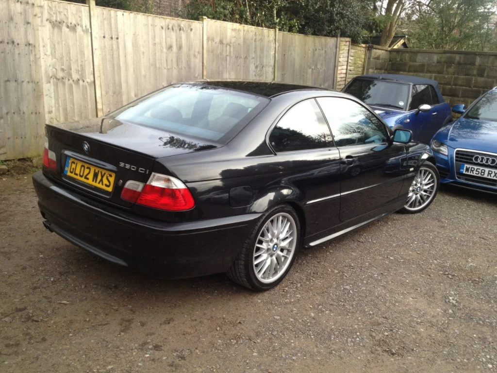

I really wanted a black one. Like mega bad. I went to see this one, was awesome spec, but condition was pretty poor :(

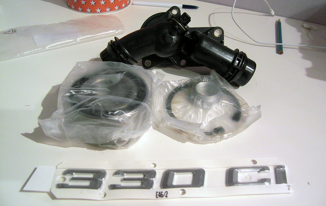

It sits fine by the looks of things. I'm not really planning on putting springs/coilovers on this one. I'm just going to tidy it up, I've ordered a genuine thermostat and a 330Ci bootlid badge as well. I very nearly bought two new genuine tail pipe covers, but I'm going to take mine off and attack them first.

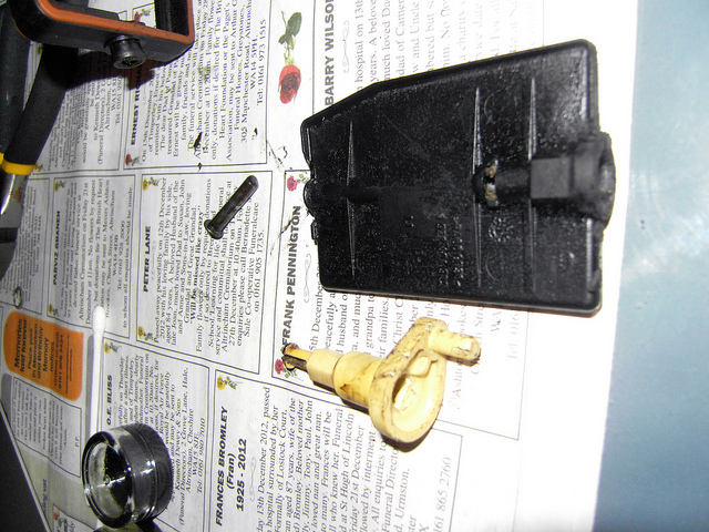

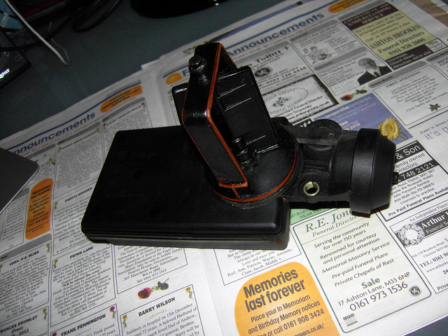

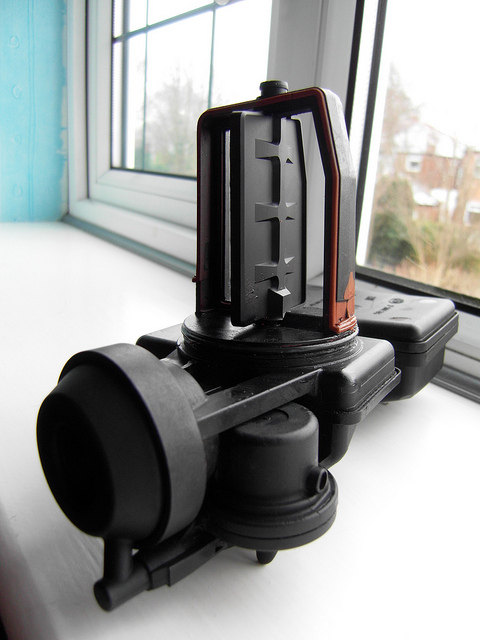

When I first went to see the car, I noticed there was a tapping coming from the inlet. After being sure that it wasn't internal to the engine I bought it. A few days after buying it, I found out it was the DISA Valve. From what I understand it modulates the airbox inlet length via a flap. There is a metal pin and plastic part that holds the flap in place, they become worn and rattle. I bought a repair kit for the valve and fixed that the first week of owning the car.
Basically the new part has a new design, preventing excessive ware and most importantly preventing the pin from falling into the head!
Before:
SDC18943 by Jon Garrett, on Flickr
Pin and plastic part:
SDC18946 by Jon Garrett, on Flickr
Rebuilt:
SDC18949 by Jon Garrett, on Flickr

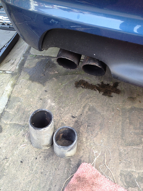

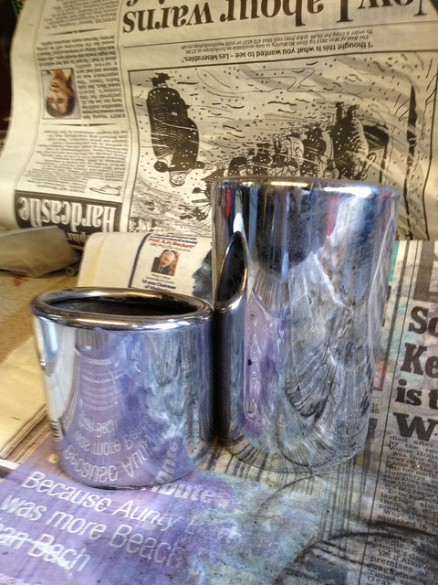

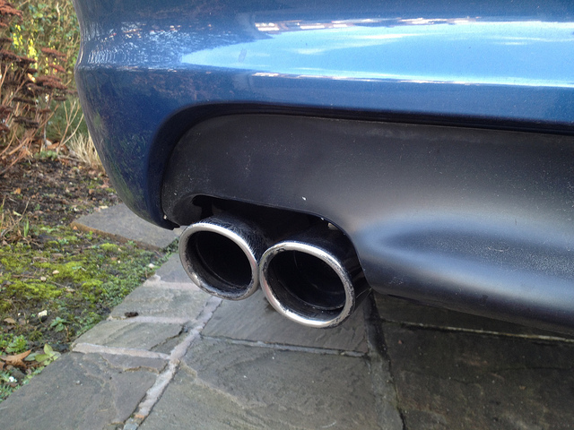

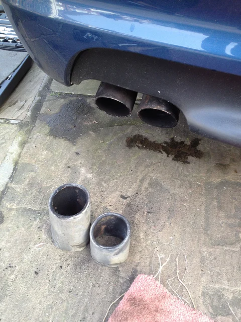

Next up, the exhaust tips were looking VERY tired, so I pulled them off and gave them a polish. I think they are well past there best though, so I might buy new ones, which I think are about £30 each.
Off & Before:
tips_4 by Jon Garrett, on Flickr
Polished as best as possible:
tips_2 by Jon Garrett, on Flickr
Re-fitted:
tips_3 by Jon Garrett, on Flickr

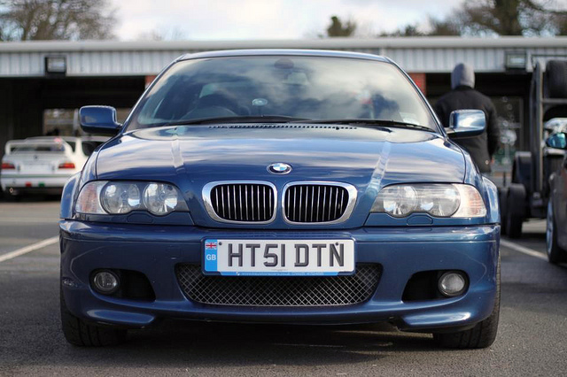

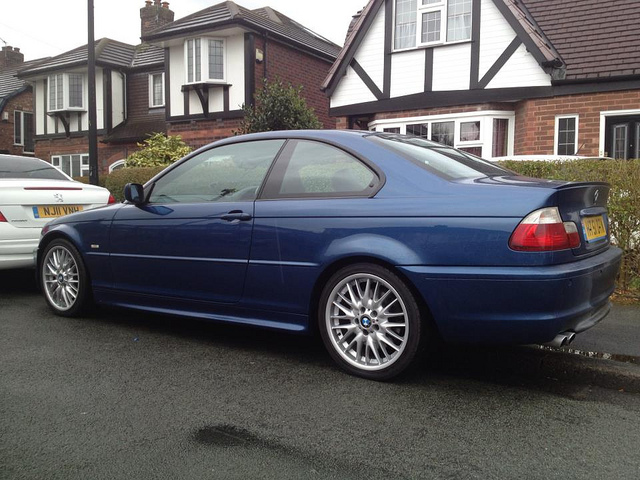

Pete snapped a picture of the car at Oulton a week ago, I 100000% need new plates. Just waiting on Insurance renewal then I can transfer my private plate. I'm also going to spray the lower grill satin black as it looks very tired now.
330_at_Oulton by Jon Garrett, on Flickr
