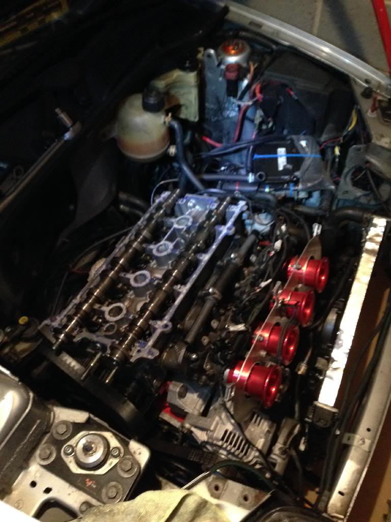

Had a faff with the shims for the cams, ended up with 2 sets. Have to say getting them to sit below the hydraulic lifters without dropping them into the head was the worst job i've ever had to do. It wasn't the hardest thing in the world but if one had slipped (which it nearly did) the head would've had to have come off. Steady hand needed.

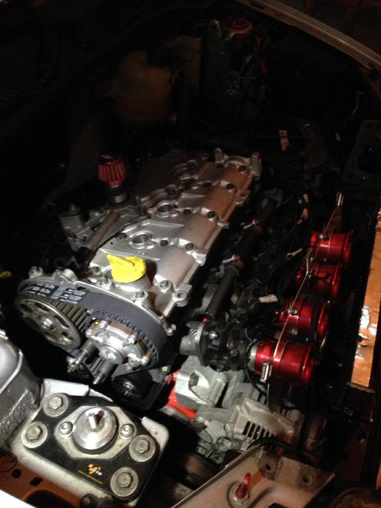

Anyway, cams in, cam resealed and replaced and then got the engine timed back up with (another) new belt.
Sump is coming off this week to install the ARP bolts. I've bought (another) sump gasket from Reno, these seem to be going up in price but I think i've nearly got enough points to buy the entire franchise, especially since I paid £35 for a fuel hose just for the clip on the end of it...
a little bit of carbon that I brought back from the dead with some wet and dry.
ARP bolts in and it's finally all back together. Just got to sort mapping out now and then it's good to go.

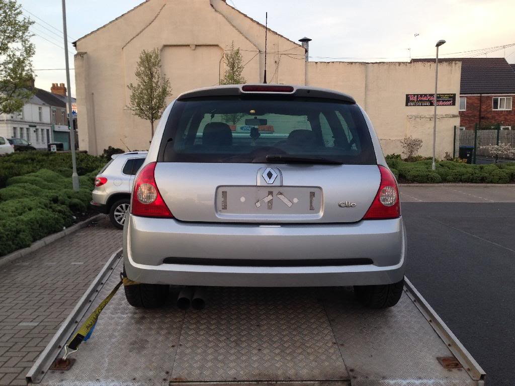

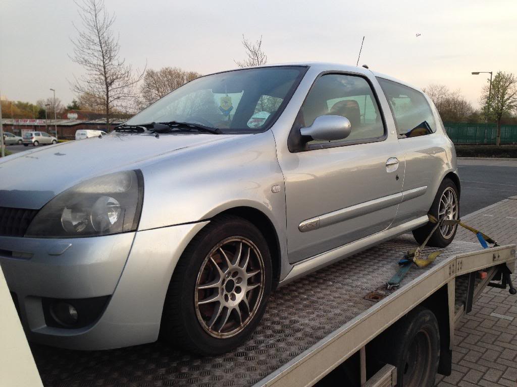

I also bought this the other day for the second time. I bought this car brand new 11 years ago. Needs some tlc, but it's a good project. Plan is to fix the faults it has (only minor) and let my dad have some fun in it.

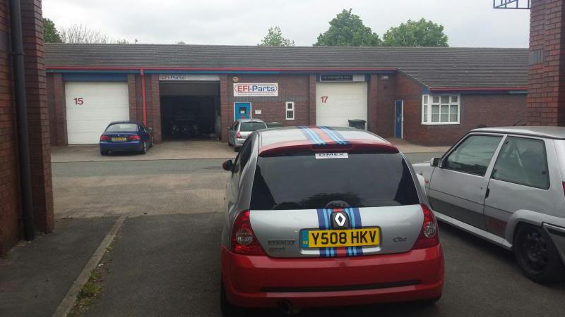

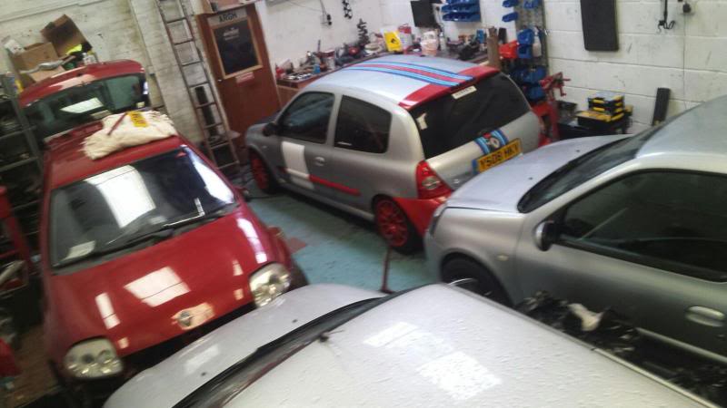

Car went into storage whilst we moved and then it got taken to be mapped at the weekend whilst I was still unpacking boxes. It's spending all week there on the dyno so the cold start issue can be nailed. Collecting next weekend.
At EFI for mapping.

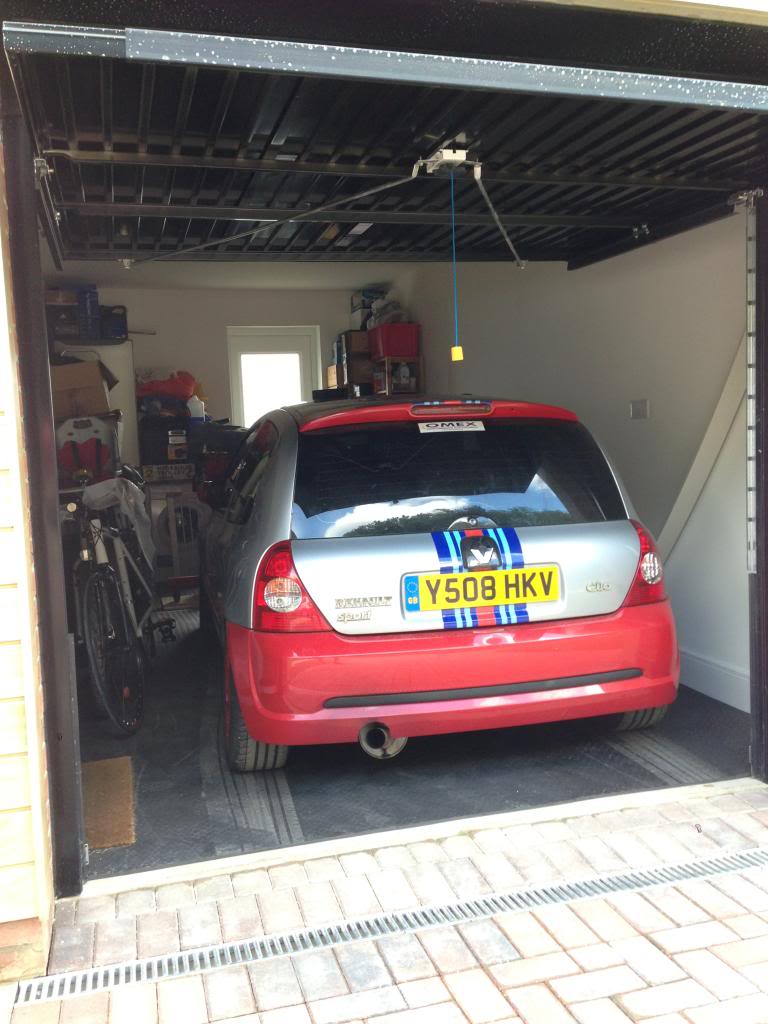

I've already begun trying to sort the garage out before it returns. I've got to build a shed to get rid of the garden junk and then the rest of the flooring can be put down.
Done
First up this one was fixed and then driven south by my Dad. Simple fix and she's good to go.

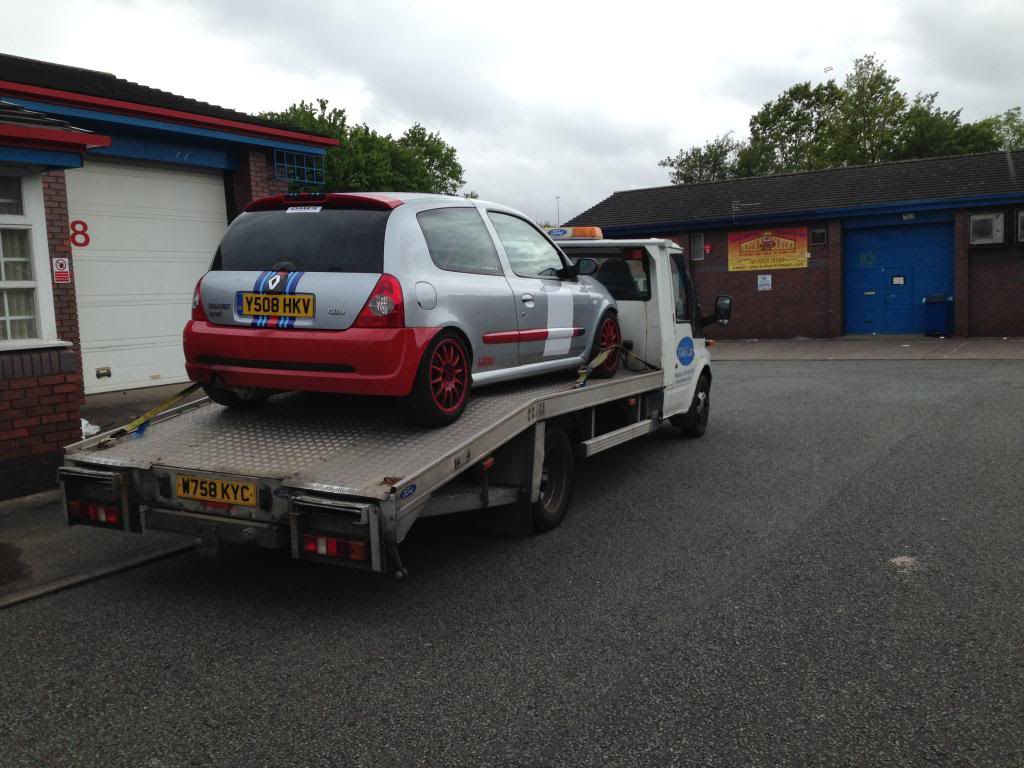

Mine had been left with Chris at Efi for the week and we travelled down to collect it Saturday. Liverpool is a bit of a trek from Durham!!
The car now starts and runs from cold which is a 300% improvement on before and the power is very linear all the way up to the limiter. It drives really well.

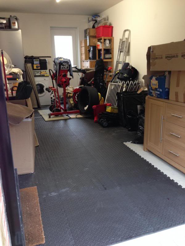

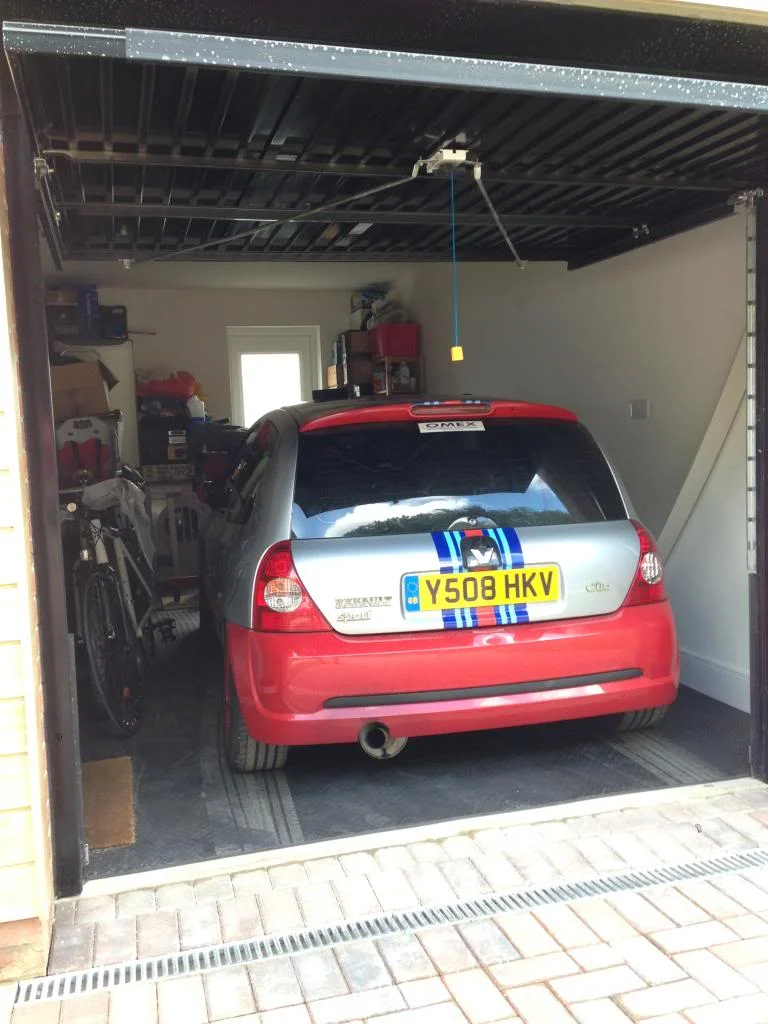

Just type garage flooring into Amazon. It's not the stuff I was after, but it's about 1/4 of the price. My garage is almost 7m long so I couldn't justify the extra cost.
These do crush under weight, where as the proper rubber tiles I was after don't, but it's something I can live with. They are like a large jigsaw puzzle and just push together, it only took a few hours to fit!

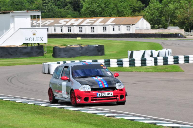

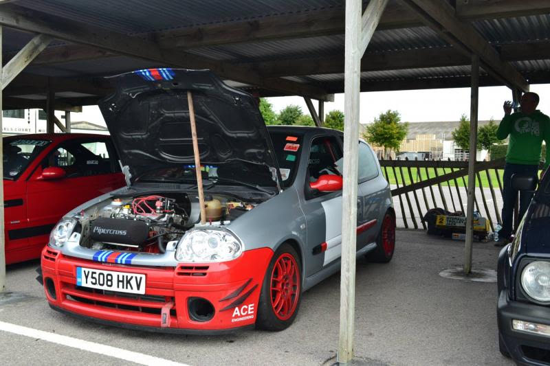

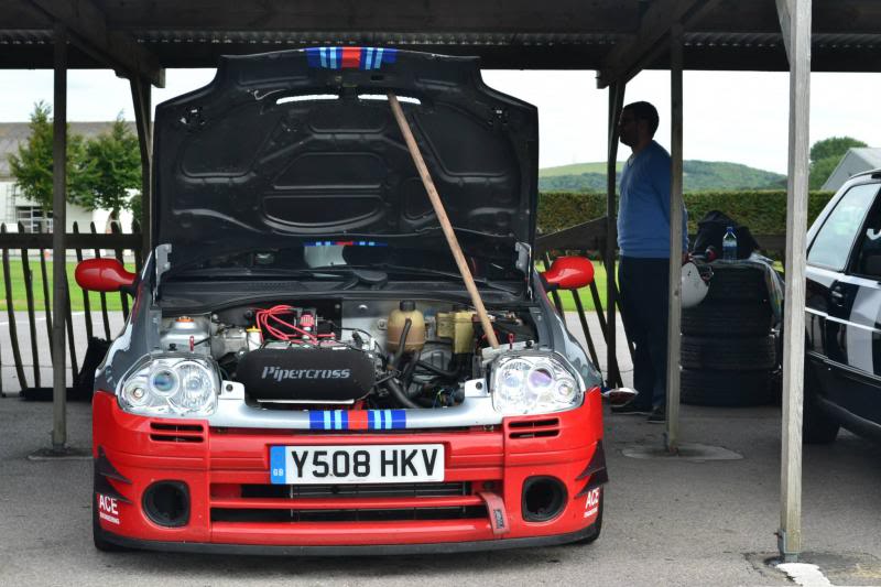

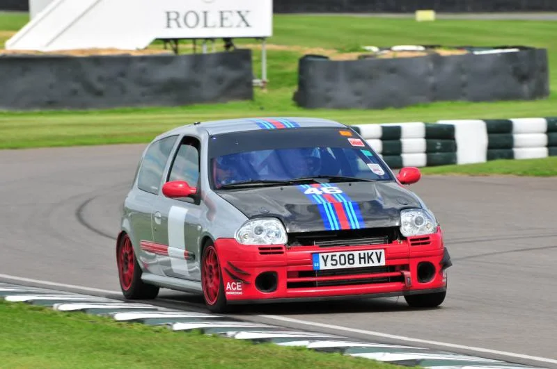

I drove the car south last weekend because I've got Goodwood booked for this weekend.
A few changes on the car since the last update, so i'm hoping for a dry day and looking forward to seeing how she runs.
