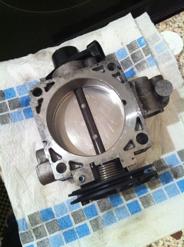

First off, I think the idle issue is now hopefully sorted after replacing many, many things. Quite a lengthy thread on it here: http://www.cliosport.net/forum/show...ssue-Anyone-got-any-ideas-because-i-m-all-out! if you are interested at all! What came out of it all was that the replacement '100% working' throttle body I bought wasn't. In the end I rebuilt the original after cleaning everything and it now seems ok, though I haven't gone for a drive yet. Fingers crossed.

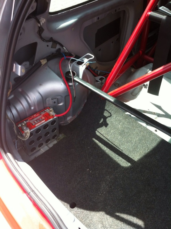

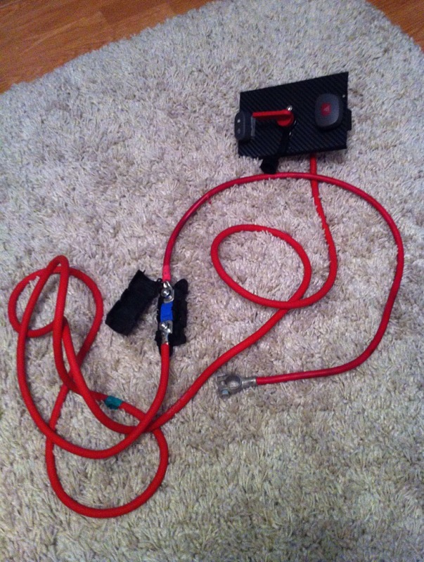

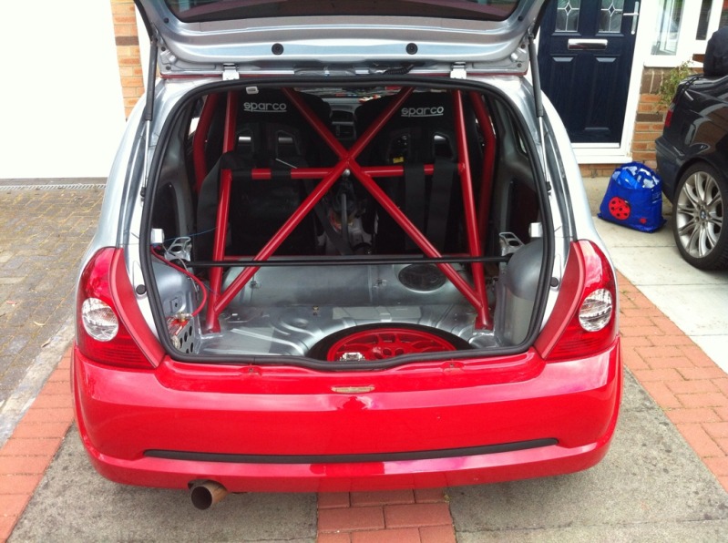

I ordered a few more bits online to sort out my battery in the boot project which has been in the pipeline for 6 months
. It's all sorted, though they sent the wrong cable 'p' clips to secure the wire so i've cable-tied until the correct ones arrive.
As well as saving weight and shifting it backwards, it's left a nice amount of space in the engine bay
This will (eventually) allow me to run a straight pipe off of the throttle body and mount the airbox sideways.

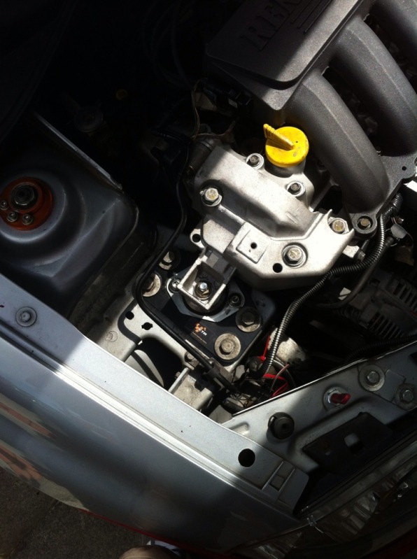

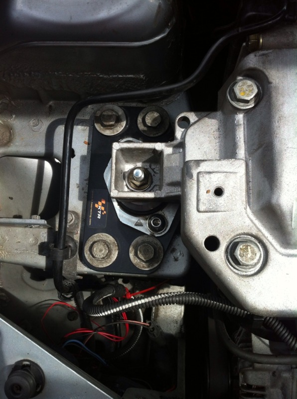

Finally for now i've got hold of a Ktec solid(ish) top engine mount. It's reduced the engine movement by a lot. My standard mount was knackered.

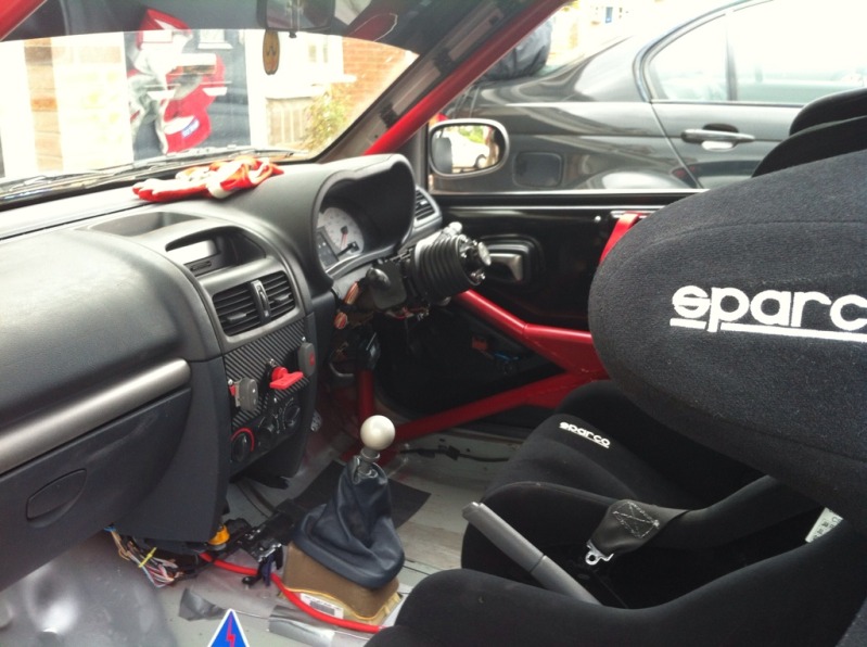

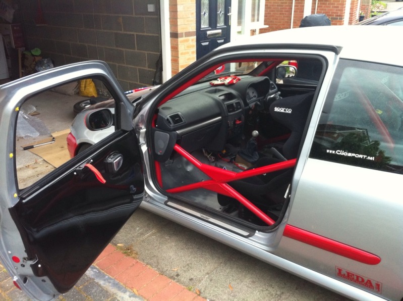

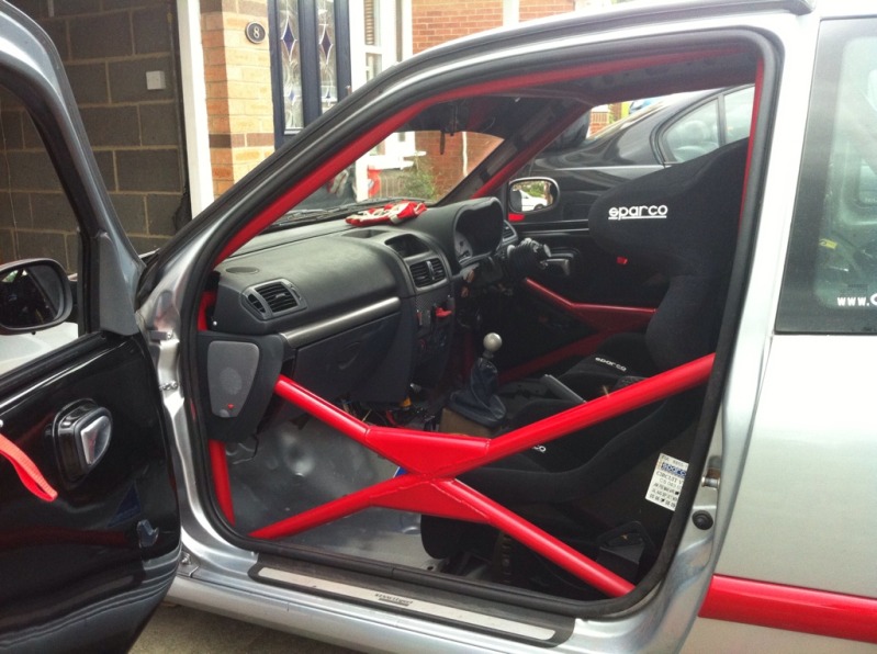

I've had a set of doorcards turn up as well. Drivers side is done, but i've got 3 left to fit, so no pics yet.

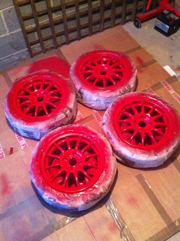

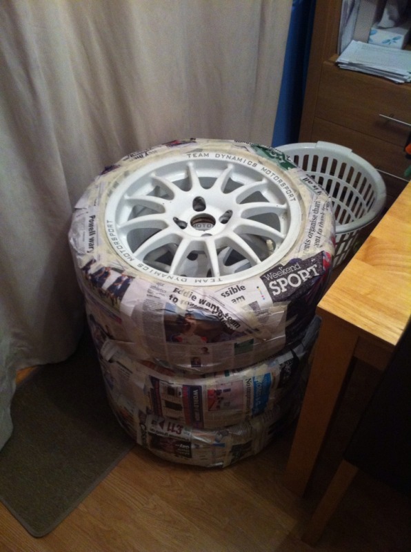

I've been refurbing the white wheels over the last few nights. The car has been sitting on an old set of wheels i had knocking around.

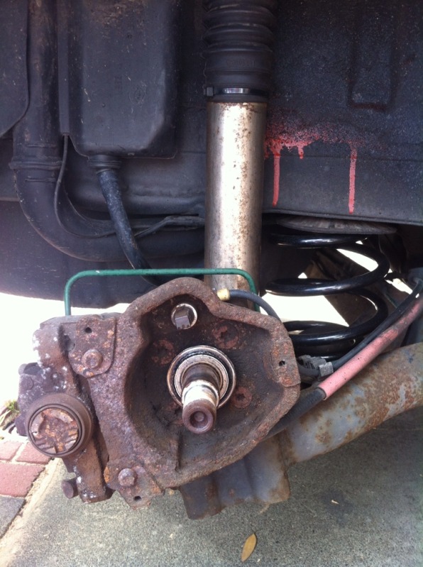

Whilst the wheels were off I fitted some rear abs rings that have been missing since UB fitted some new rear disks ages ago.
Anyway, the wheels
5 cans of Capsicum red later:

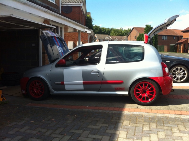

Floating car to change the lambda sensors
Fitted
Next up I got round to finishing the doorcards and tidying interior a bit

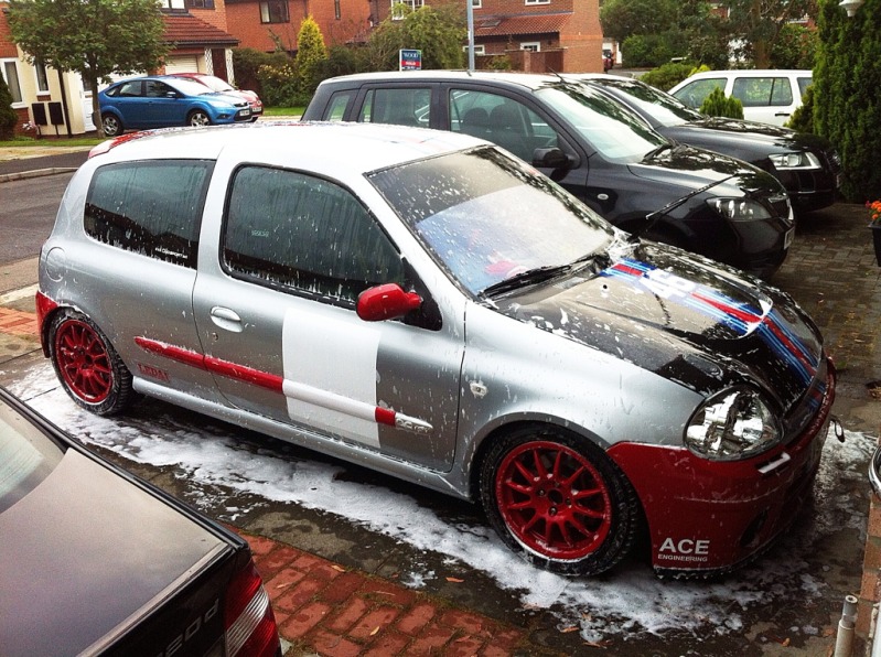

Out came the Fairy Liquid.
Ready for the next couple of weekends, just needs some fuel. Not used it in a while.

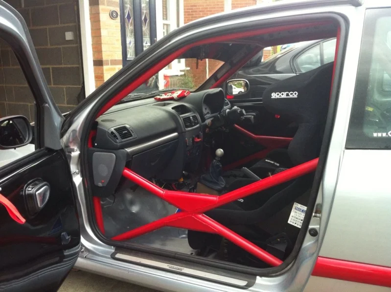

I collected the car and drove straight to my parents in Sussex via the Garage where the cage was installed. I hit the M25 at rush hour and slowly melted in the car, I was very glad to finally arrive. The car was given a good going over before the fun commenced the next day. We had a very spirited run down to Goodwood with my friend Jamie in his M3. I love the run down there. It was a great day and the car proved faultless. I did 8 or 9 sessions and as many laps as I could. It knackered both front balljoints, but thats curb hopping for you. Thoroughly enjoyable.

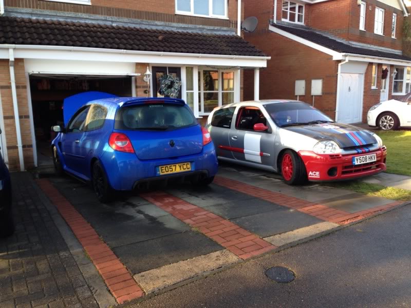

I'll be honest, nothing has really happened. It got a younger brother to keep it company:

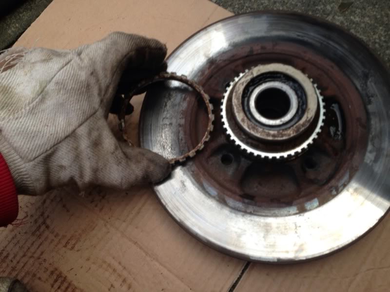

I did grab an hour or so last weekend to finally (pending test drive) fix the ABS issue. Originally the new rear disks came without abs rings. I bought a set and fitted them, but they had the wrong number of teeth and it caused loads of issues. The car thought the rear wheels were still travelling faster than they were so the abs was kicking in all the time. UB unplugged the whole lot, so I ran the car at Goodwood without it. It was fine, but the dash was more impressive than Blackpool illuminations. I purchased a new set with the correct 44 teeth and plugged everything back in. Hopefully it'll be fine. The dash is now light free, but the car hasn't moved to trip anything yet.

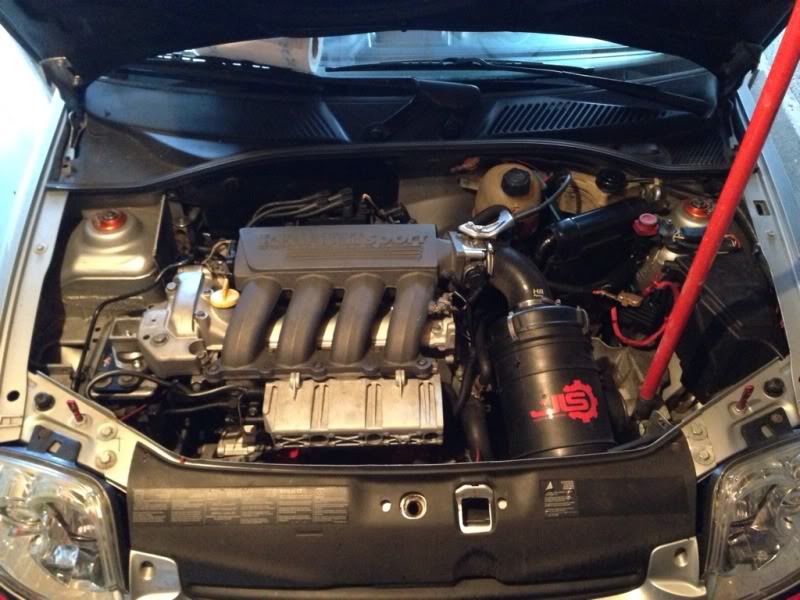

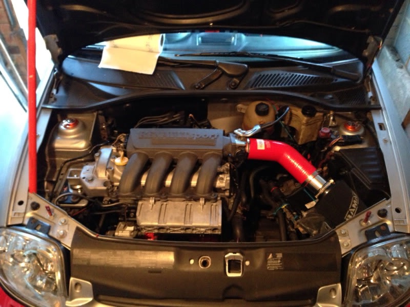

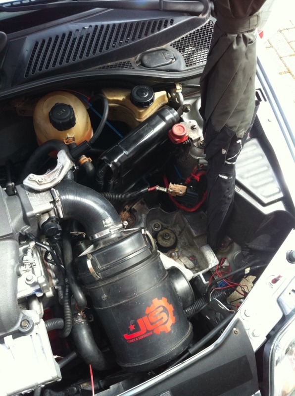

In other news, i've been speculating about changing the airbox and the route the air goes into the TB. Since moving the battery into the boot there has been more room in the engine bay to allow for a routing similar to the racecars. After a quick fiddle around it became apparent that it was possible, but the ECU was in the way. After a lot of swearing i've managed to get the ECU out of the way. It now lays flat on the battery tray and is firmly in place.
I've purchased a few different hoses and a new foam filter to try various combinations. I've ended up with what you'll see below and the engine builders on CS seem to think this is now the best i'm going to get a single TB'd car. Apparently the F4r benefits from the longer inlet - and its not getting any longer than this! Plans are on the table to make some sort of heatshield, though there is no urgency. The panel gaps allow much cold air in
It should go and sound better. Again, i've not even started it yet.
Before:
After:

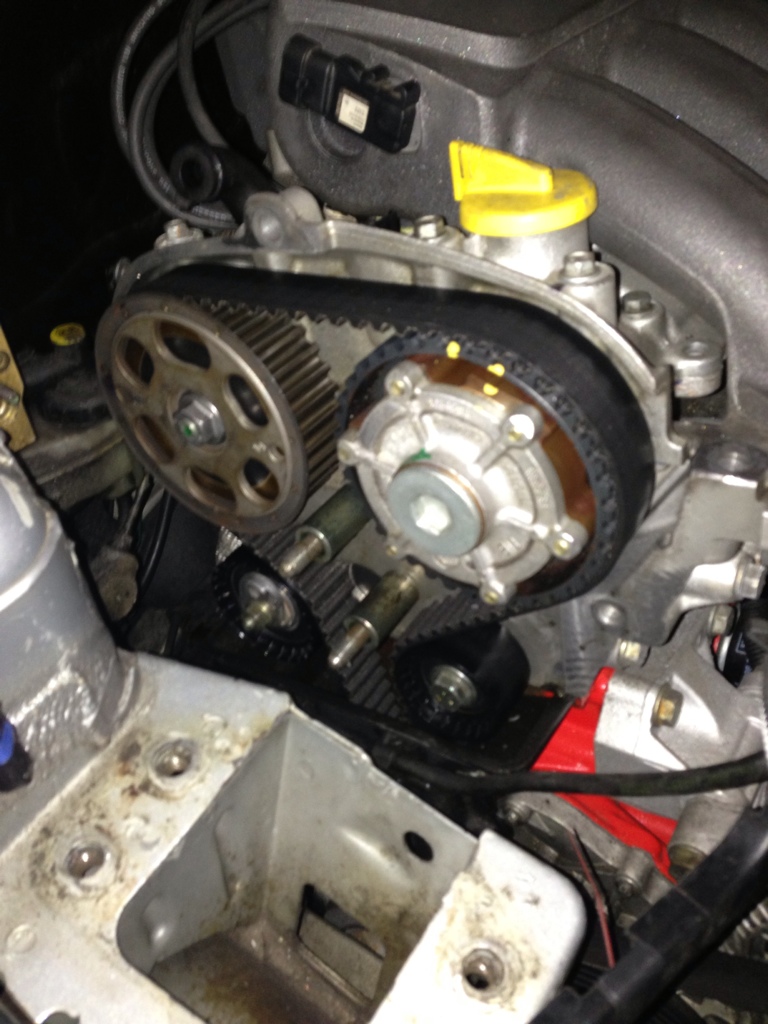

There is a random lump of metal thats attached to the offside chassis leg on the Clio and i've always thought it must've been there for a reason. I remembered to do a bit of reading and eventually found out that its there to dampen vibrations on the standard roadcar. I'm not fussed about that, so I set about removing it.
To get to the bolt holding it on you have to remove the top engine mount. I eventually managed to support the engine using a scissor jack and a lump of wood and removed everything.
The small lump of metal weighed about 3kg's, so it was worth the hassle.

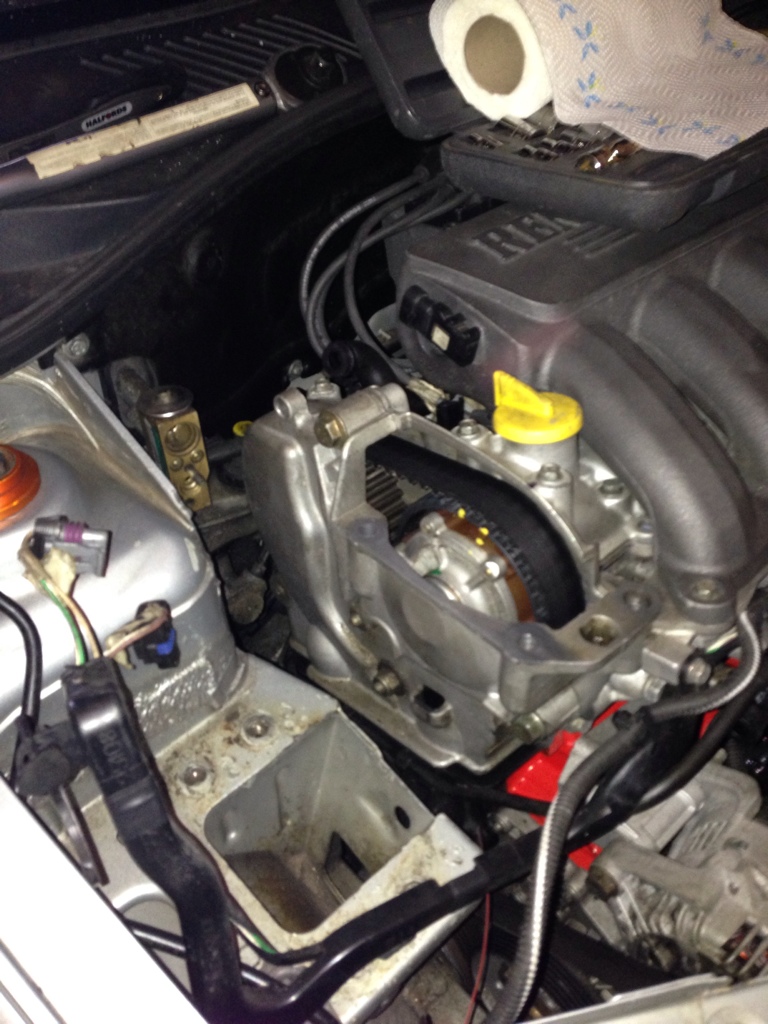

Whilst I was there I changed the upper cambelt cover as one of the threads that the engine mount bolts to had stripped itself and it wasn't gripping. I jacked the engine up further and got access to all the bolts. Off it came.
It was also a relief to see if was all dry behind there. Regular readers will know why!

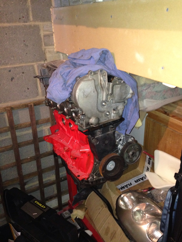

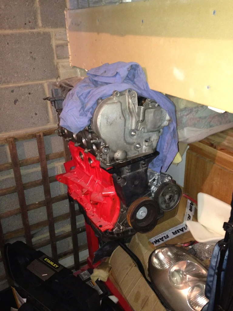

I robbed the cover off of the spare engine

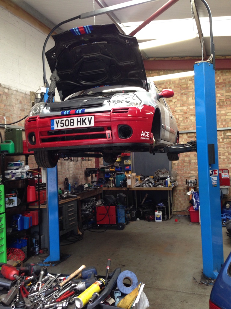

I've also changed the thermostat and coolant ready for the week ahead. The car is finally going to get a run out again. I'm off to Dan's Thursday to get the Cup wishbones fitted and the suspension sorted + tracking hopefully. Then on Saturday it'll hopefully be at the Surrey rolling road day.

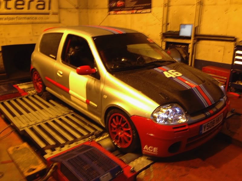

Spent some time on Thursday with Dan @ 519. Fitted Cup wishbones (yes, confirmed loads more caster) with Polybushes and also polybushed the front ARB. Adjusted AST top mounts. Sorted out a sensible level of front end camber and alignment! Thanks to Dan for all the hard work.

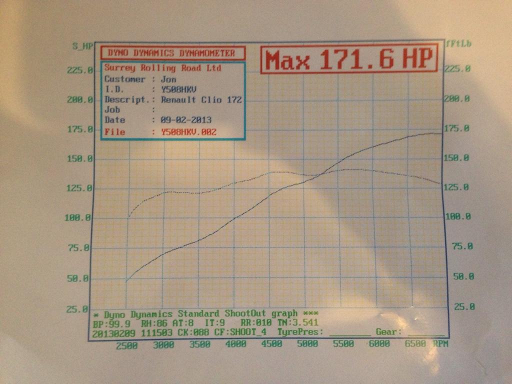

Saturday 9th February. At Surrey Rolling Road, Clio owner nearly faints in shock.
  172, Tiguan
The phrase pot-luck comes to mind!
Yeah, that's with the homemade induction. Sounds miles better than the old v6 box as well.
