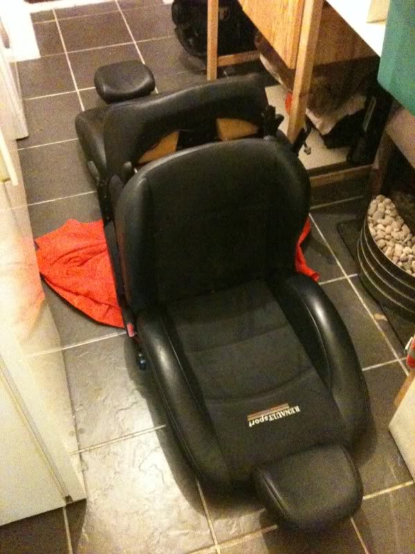

I've sold the interior so that came out the car last night (its virtually funded a pair of second hand Sparco Pro 2000's so i'm chuffed with that.
I didn't weigh them, but they are fairly heavy old things so it's saved a reasonable amount of weight.

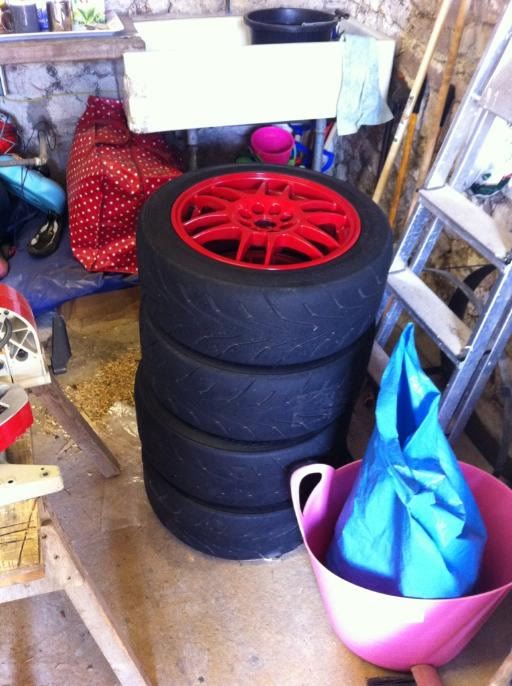

I've also bought a set of the original oz wheels which will be refurbished and fitted with some decent rubber.

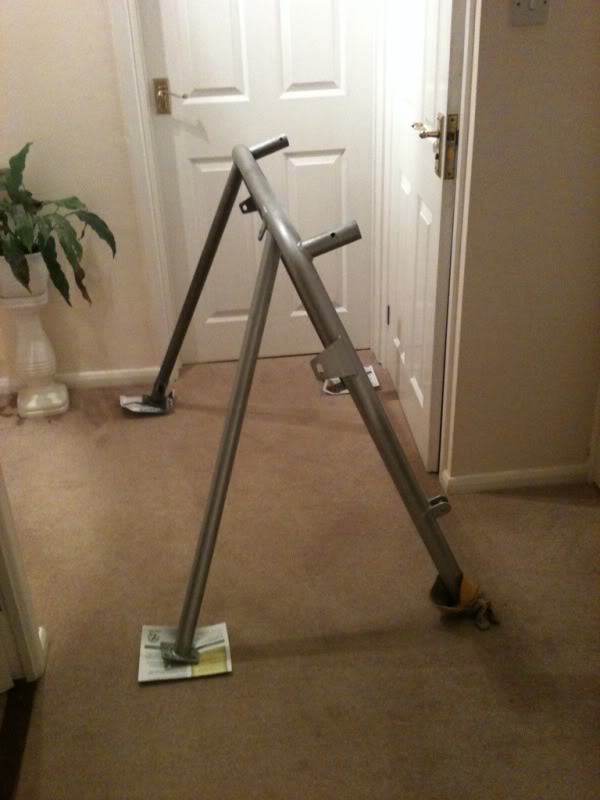

I also managed to buy an OMP rollcage for the car (front section is in garage). It's a 6 point, but i'm having another diagonal put in to make a rear cross and a harness bar added.
A previous owner has added some additional brackets for connections to the seatbelt mounting points on the B pillar for additional rigidity. Seems a bit odd, but i'll see how they go.

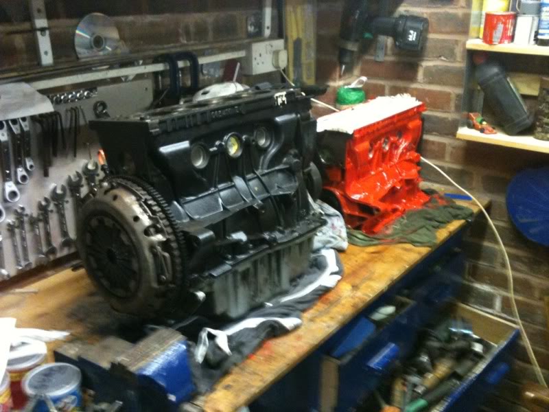

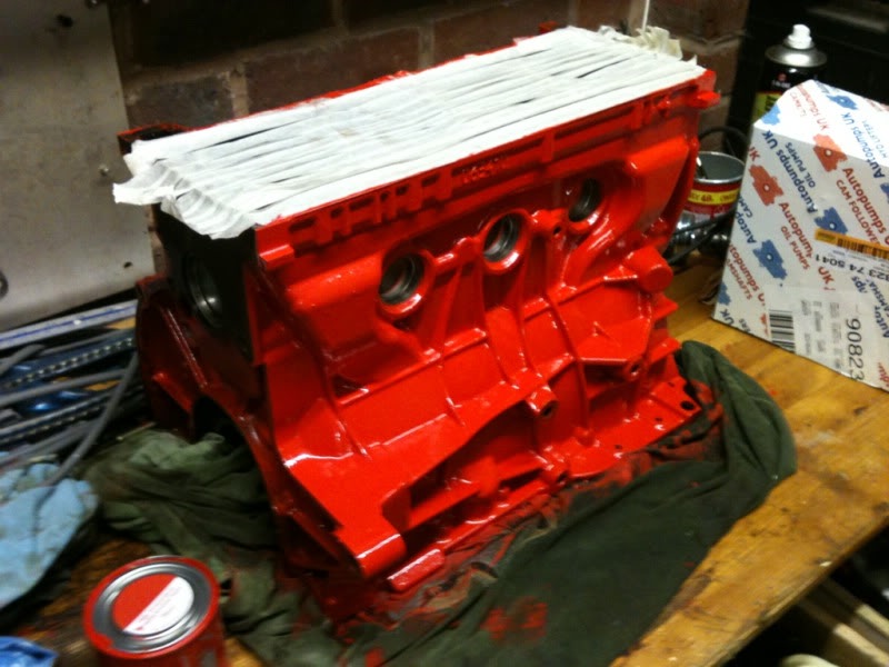

Finally, in my absence Dad has been painting the stripped down block. I've got all the bits together to rebuild this now, so that's the next job.

I'm turning into you by the way, I now have 13 wheels and tyres for this car! Haha

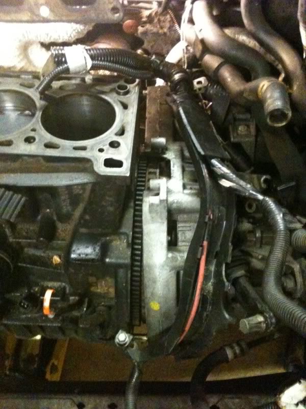

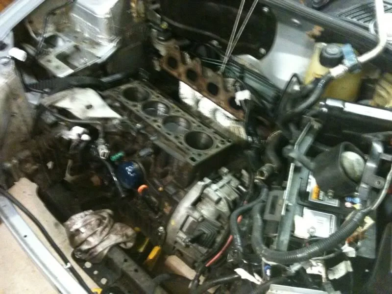

So back down south.
Decided last night was the ideal opportunity to remove the head from the engine in the car as had a couple of hours. Plenty of time I thought.
Bloody car.
I removed the engine mount which had been put back in place to get the car up in the air and removed the oil breather from the top of the cam cover. All going well so far.
I loosened the 20 or so cam cover bolts (4 different lengths of bolt!) and the cover felt loose. Went to remove it and it was stuck. Thinking that was odd I removed the cambelt cover to gain access to the pulley's as this is where it was getting stuck. Definately didn't want to come off.
I cut the cambelt as it was getting in the way and it wasn't going to be used again, then twigged that the pulleys have to be removed to get the rocker cover off! :rolf: It also turns out that the camshaft bearings are mounted to the underside of the rocker cover.
Cut a long story short I've had to source the expensive renault tools to lock the pulleys, camshafts and crank in place to release the bloody pulleys. Once done i'll then be able to remove the rocker cover off enabling me to get the camshafts out and then to remove the head.
:brickwall:
  172, Tiguan
Re: Jon's trackday MK1 172 project thread

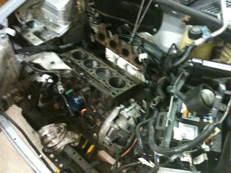

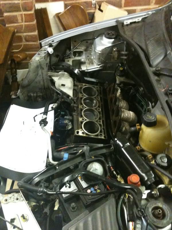

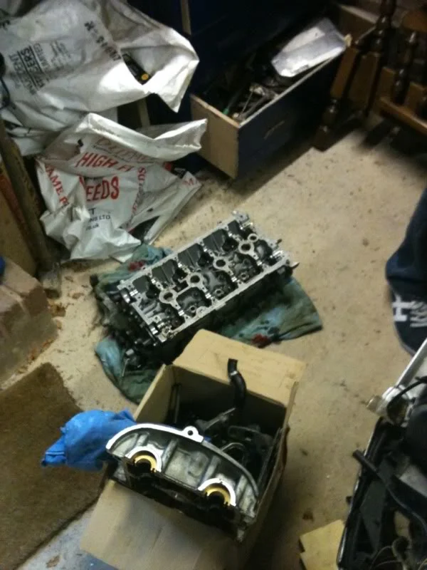

Success!
I've managed to hire a set of the Renault tools and very quickly last night the head came off. Didn't have a great deal of time but at first visual inspection it looks fine. Both Dad and I have a free evening tonight so we'll take a better look.
The bores and top of the pistons looks fine, though there was a bit of oil there. We suspect we'll find most of the damage when the bottom end comes out, hopefully this evening.
I'll get some more pics tonight.

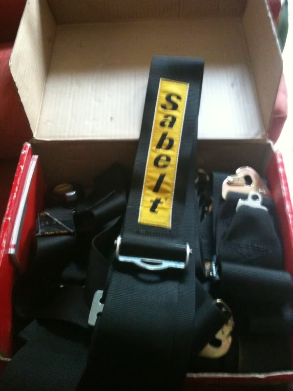

First off my harnesses had arrived:
A pair of 3" 6 point Sabelts. Lovely. They've been added to the pile of bit's.

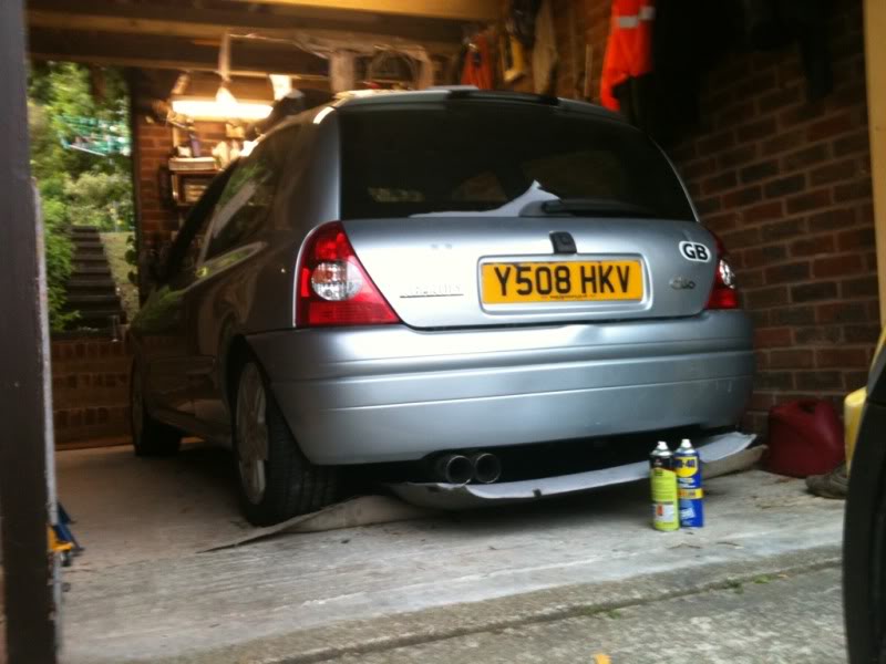

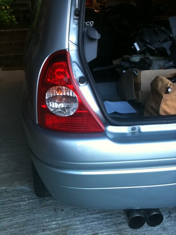

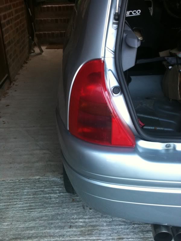

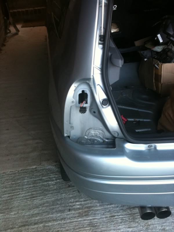

Slightly fed up of not actually seeing much happen I tackled the rather simple task of bringing the rear of the car a bit more up to date. A purely unecessary expenditure, but improves things no end. It took 15 mins to swap over, take the plug apart and re-wire using an excellent pdf guide.
Before:
During:
After:

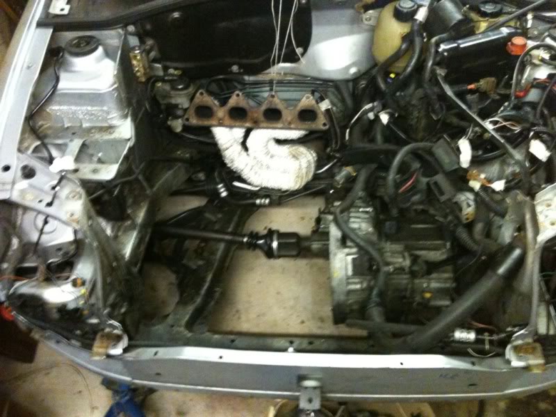

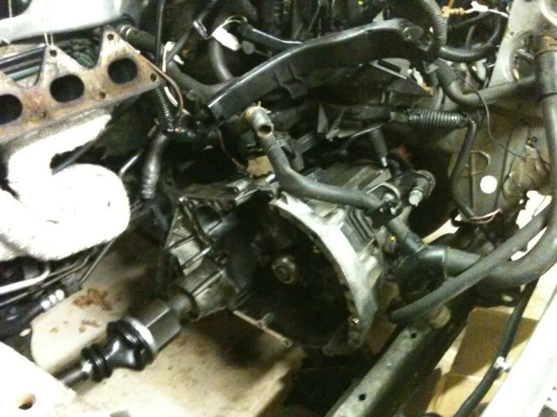

So after the problems of earlier in the week I asked online what the best way forward was. I had varying reponses along the lines of dropping the driveshafts out and lifting the gearbox and bottom end out at the same time. This probably was the best way forward but being an impatient sod and wanting to get the engine out this week I couldn't get hold of a crane in time - though I did have a few offers, thank you :)
There was also much debate on whether the best way out was through the top, or drop the subframe and out the bottom - it would seem that both routes are viable and some prefer one way, some the other.
Eventually though another member suggested there was room to take the bottom end out with the gearbox still in place. I thought it probably was possible, but it was nice to hear someone say it was! All that was required was to undo the rear engine mount, the gearbox mount and the front gearbox support. I found the gearbox mount a real arse to get to, but once undone the gearbox visibly shifted an inch. With some persuasion it moved another inch or so. This gave us about 4 inches of room at the pulley end of the bottom end, so with some jiggling the engine came free. 2 of us lifted it at an angle and out she came.

I'm working from home this week but Dad has some spare time so he's been fiddling with bits engine related. Just got this through:

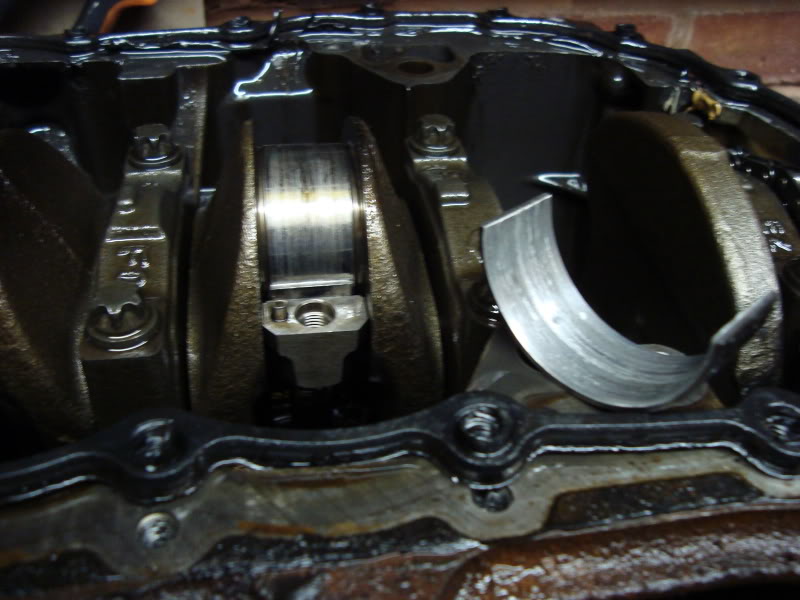

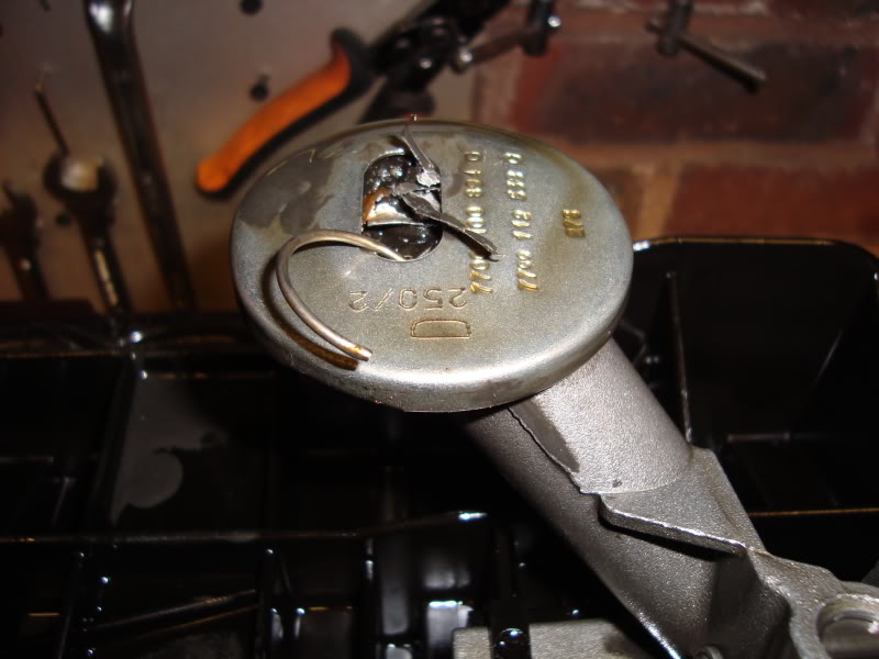

Hello,
Got the new torx socket today so I took of the sump.
The inlet for the oil pump was full of swarf and a broken washer.
The big end shells were loose in the big ends and would have spun round – they appear to be too big ??
I wonder if the engine was rebuilt with the wrong shells?
Pictures attached.
Dad
That would explain the knocking then :D

It was knocking pretty bad before we took it all apart, least it was obvious why now!

Looks fucked.
Glad the engine came out via hand!

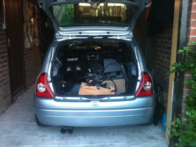

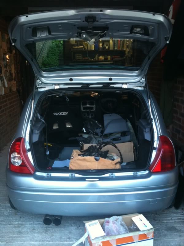

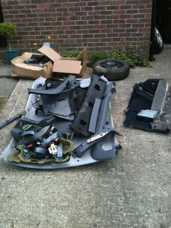

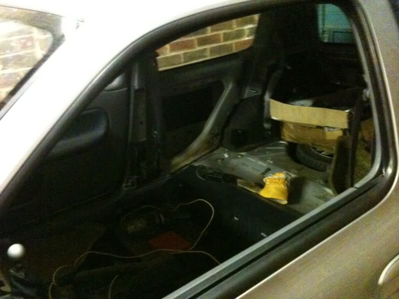

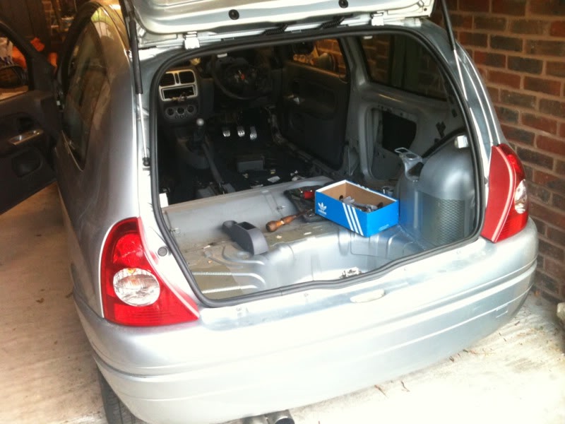

I had some time today and have a full day tomorrow so looking forward to cracking on. Decided to start getting the interior ready for the cage to go in even if it might not be for a few weeks yet. I'd only removed the seats so I had a reasonable amount to remove.
The obligatory 'look how much i removed shot':
I didn't weigh it, but i'd say it was probably 25kgs, more if you include the stereo stuff.
I've found a load of extra stereo wires behind the dash which would indicate it's had a biggish install in it at some point. I'm going to remove the dash tomorrow and strip out what I can, it'll also allow me to remove the passenger airbag at the same time.
Anyway, it all ended up looking like this before I got bored and came indoors:

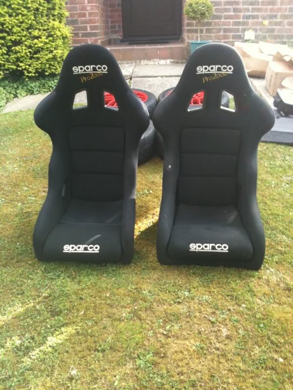

On another note all the bits to mount the seats have turned up so I might give them a trial run tomorrow:

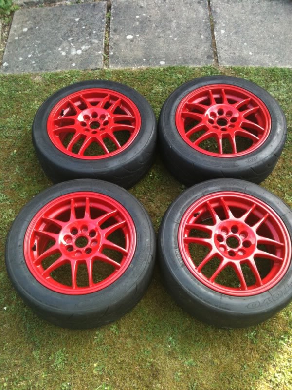

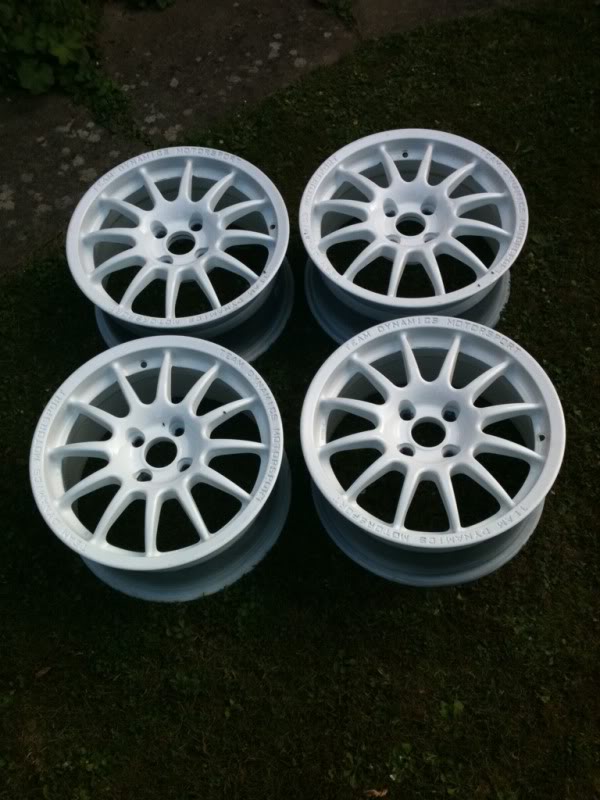

Finally, i'd bought a set of original wheels for the car and had big plans for them, however was browsing the forum the other day and a deal just to good to miss came up, so I sold my original wheels and went for them. They look great and come complete with cheat tyres!
....and then, well, I was browsing the forum the other day and a deal just to good to miss came up, so went for them as well.
I now have far too many wheels again, so am going to sell the renault wheels currently fitted to the car. One slight problem though, god knows where the locking wheel nut key is...

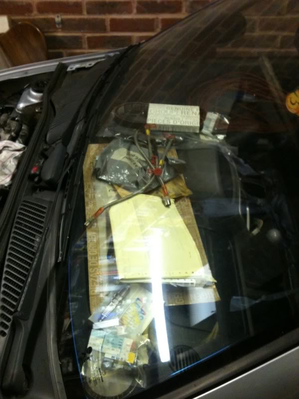

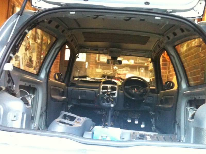

Had a day on the car today, and come late afternoon even had some help! Cheers Tom and Chris!
Started off by tidying the garage a bit and putting all the bits outside that are stored in the car every night. I'm at the point where we've virtually taken everything possible off the car and there is stuff everywhere, so everytime I want to do anything it all has to be taken outside!

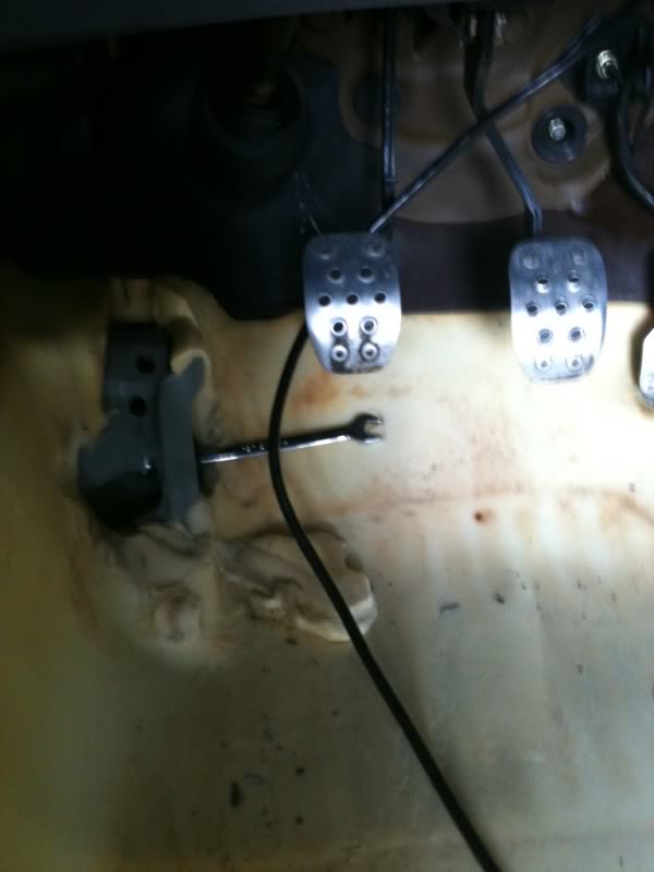

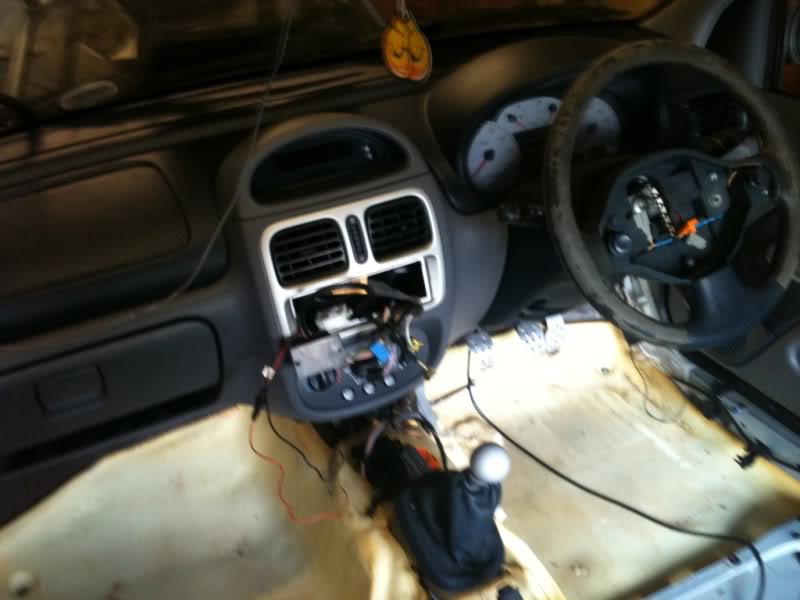

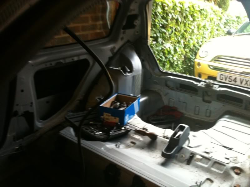

With that done I gave the inside of the car a hoover and removed the remaining carpet, again it was fairly weighty, so ill probably chuck this away having originally thought I'd keep it.
This just left the rather thick foam sound-deadening. Centre console had to come out to allow this to be removed.
I did however find a nice Snap-on spanner and 50p! :D

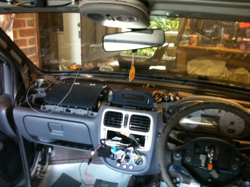

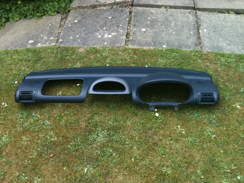

With that all out I set about removing the top of the dash:
This allowed me to remove the passenger airbag (heavy!), tweeters in the dash, various stereo and airbag wires + all the cd changer harness.

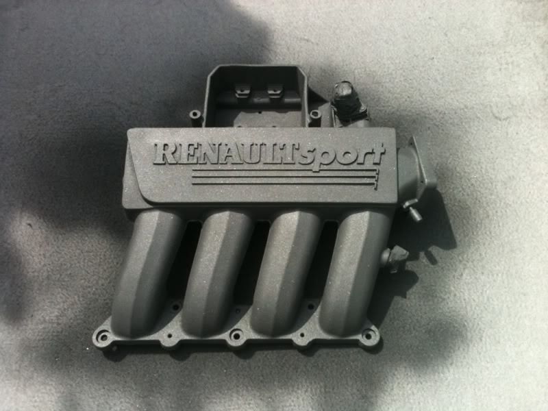

The weather had improved so cleaned up the upper inlet and sprayed with high temp paint. Was quite chuffed with this!
I then set about stripping the cabin of all the seat pretensioners and airbag wiring (there was lots). I stripped the loom right back and am just keeping what I need. I forgot to take any pics at this point, but made some progress. Electrical stuff and wiring is my least favourite activity, but taking it slowly i'll get there. Most of the loom can be discarded, I need very little of it.

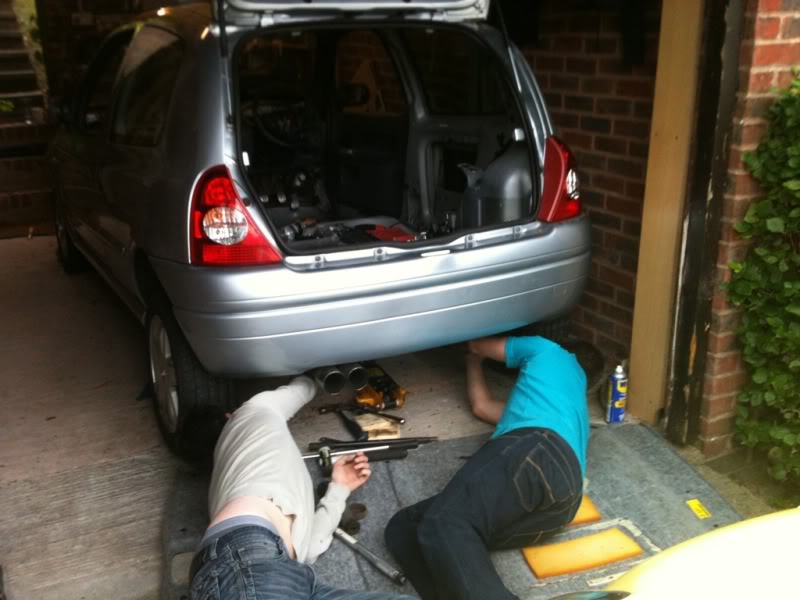

Late afternoon and Chris and Tom turned up. I had a list of jobs as long as my arm, but even with further searching we couldn't find the locking wheel nut key. We tried a hammer and chisel on one but it didn't budge. I've got various options to get them out, but the easiest will just be to order a new key i suspect. Frustrating.
Tom helped remove a bit of wiring.
With the rear wheels still on the back of the car went up:
Shocks were undone top and bottom and they came out very easily once we'd got the bolt undone!
Boys working hard!
