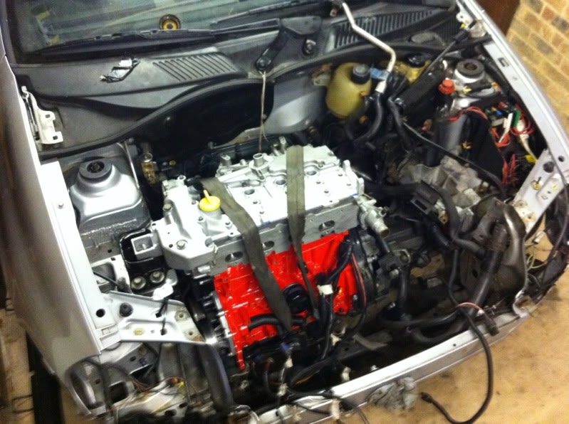

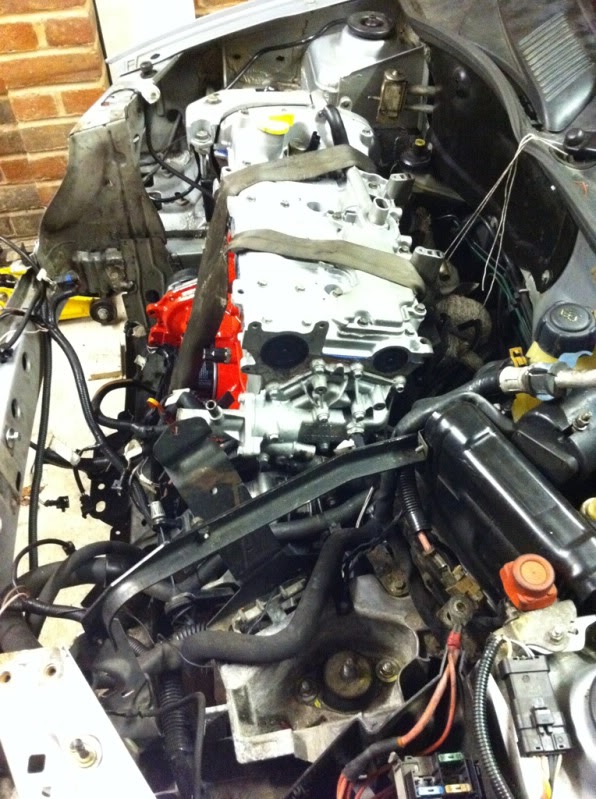

Hopefully i'll find some time to get it all connected back up this week before I go back up north.

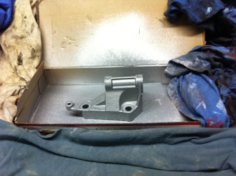

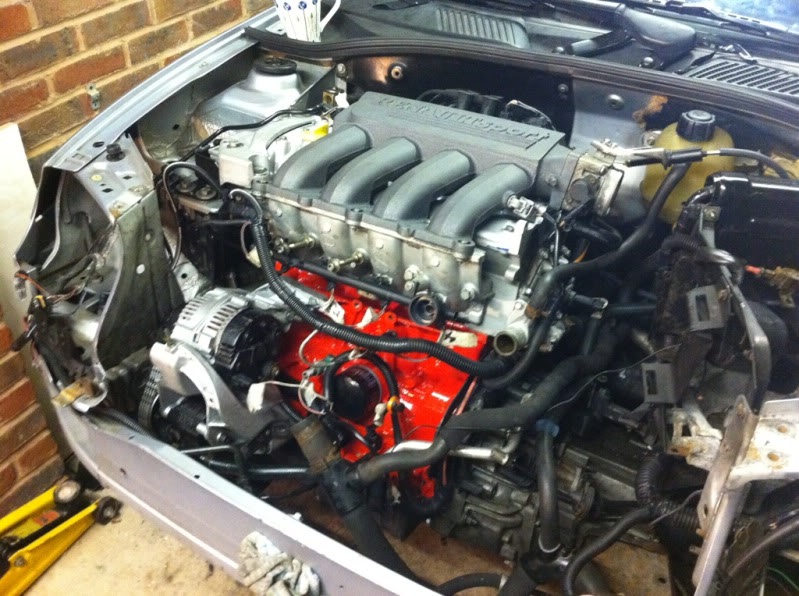

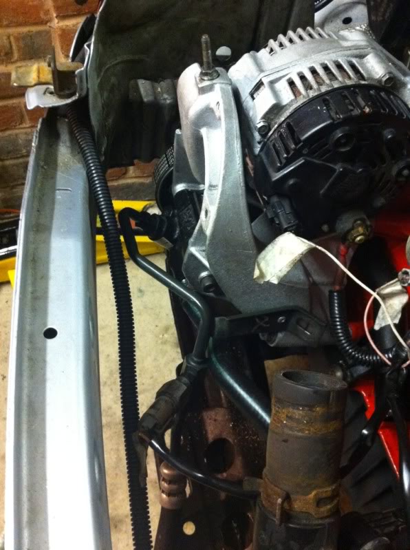

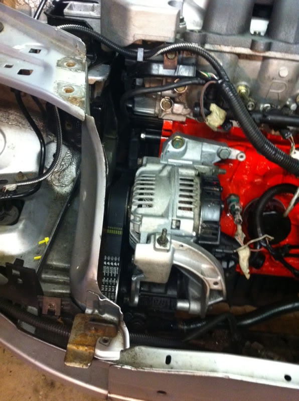

Spent an hour last night beginning to attach it all back up again. Engine was shifted to the correct angle then I reattached the upper and lower gearbox mounts. The top engine mount was loosely put in place. Also sprayed up the last alt bracket from a 172 Cup that enables me to do away with the heavy aircon compressor. That's the first job this evening.
After dropping off the old seats to their new owner (cheers Jamie) I got home and found dad had spent a few hours already on the car. He'd jacked the car up onto ramps (lol) to start with.

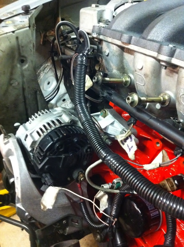

The starter motor was on which i was glad of as it's a b*****d of a job hidden up in between the block and the exhaust manifold. He'd also fitted the alternator and power steering pump + the belt.

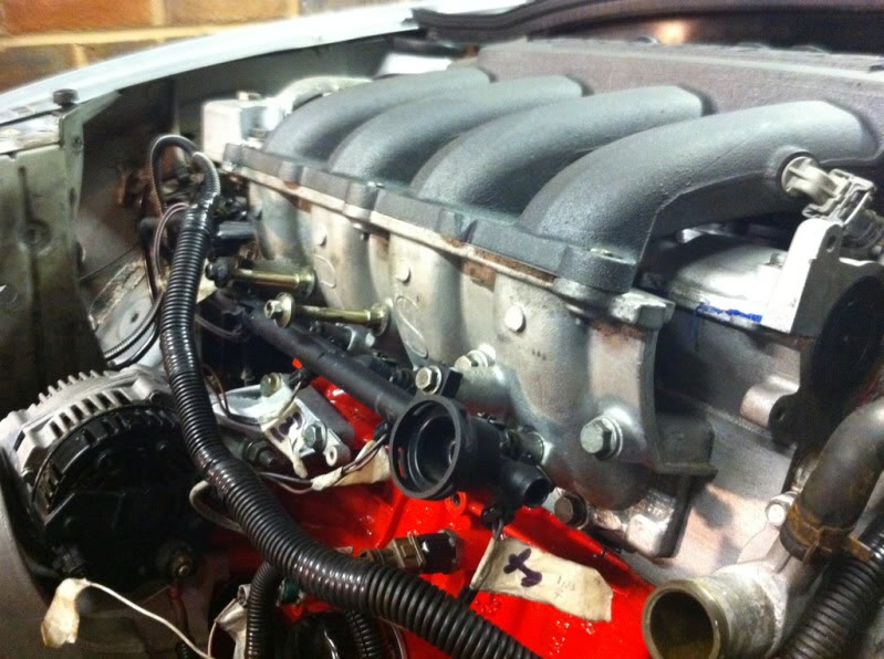

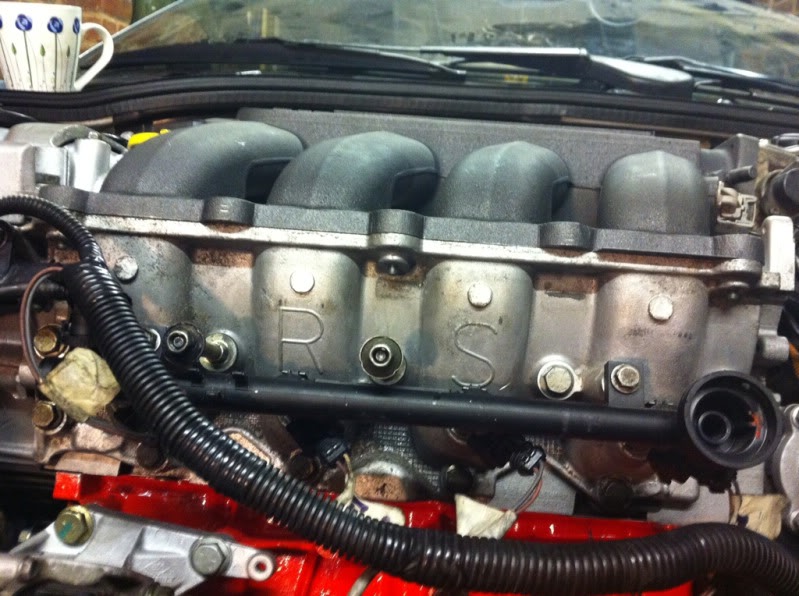

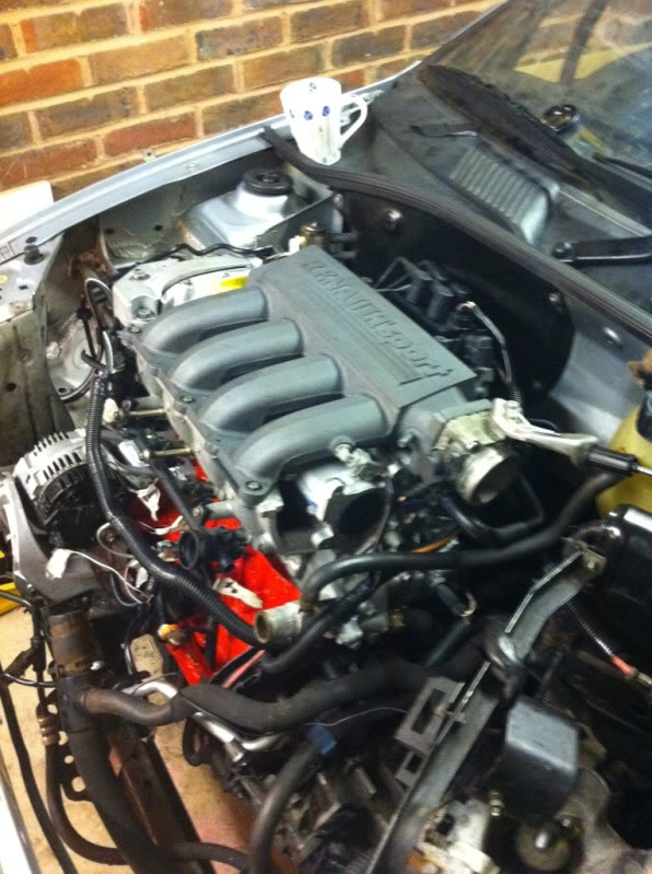

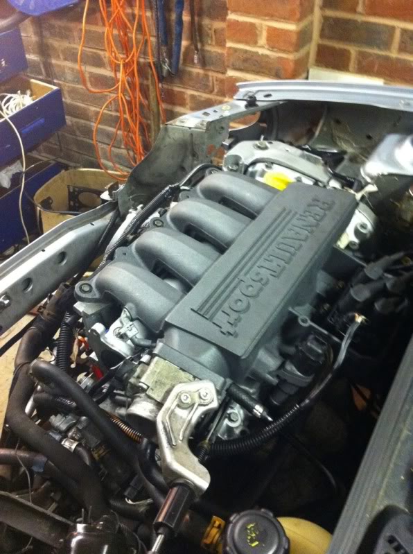

I then worked round the engine fitting inlets, coil pack, throttle body + cable, oil pressure switches, fuel rails, tdc sensors, etc etc. Managed to waste some time by fitting upper inlet and then realising the plug leads weren't in place.
It all had to come off again.

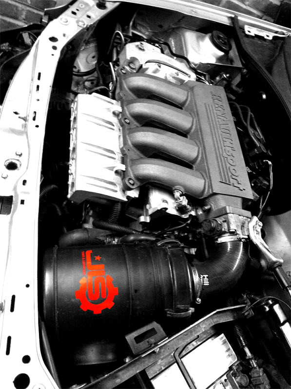

(later RS stamped lower inlet - better flow than non-stamped)

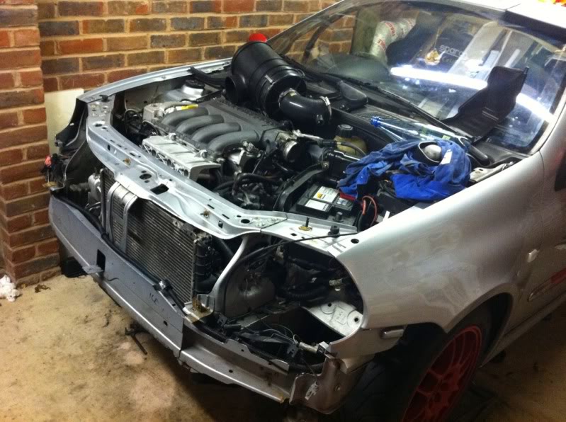

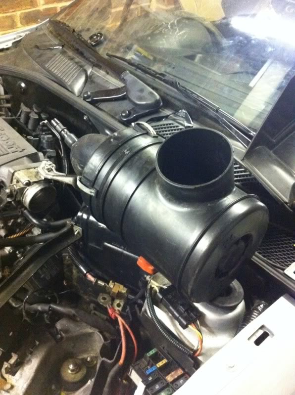

(Airbox needs connecting up - from a V6 Espace)

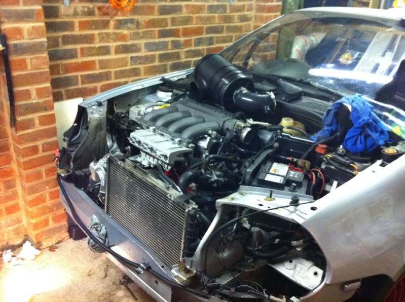

I was so close to getting the thing started but I want to get the rad in place first and it all plumbed back together. Once thats done we are good to go, fingers crossed.

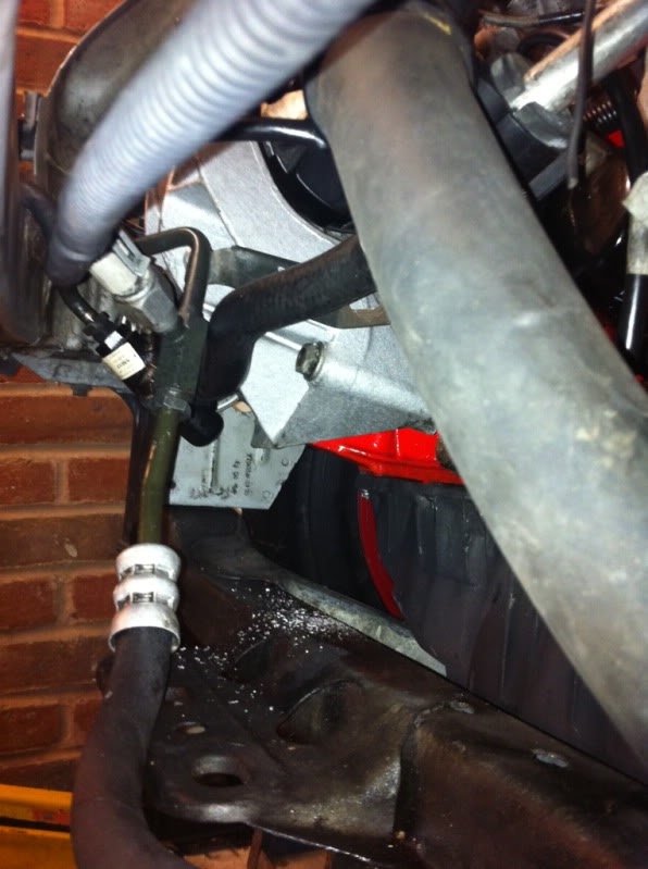

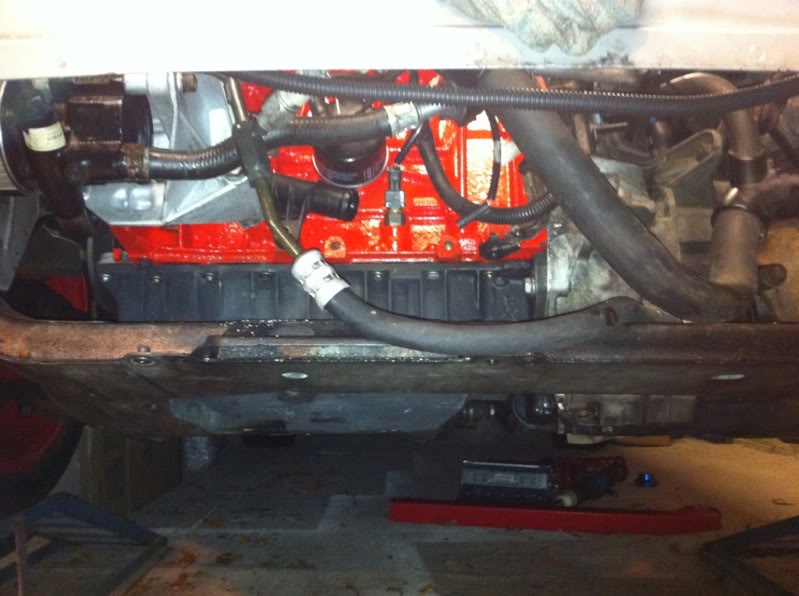

We have a slight issue in that one of the PAS pipes will have to be bent to clear the rad. Because it's no running a 172 Cup alt setup to remove the aircon the pas pump has moved and as you can see the pipe will foul the rad.
Apparently it can be slowly bent to a new shape.

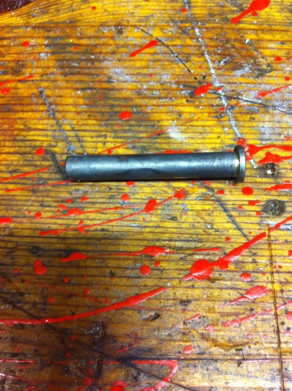

I do have this left over (was in a tub marked gearbox mount!) God knows where it goes:

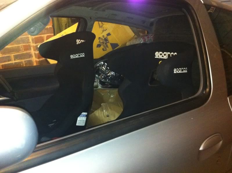

Finally a sneaky pic of new seats rested in place:

First off I spent an hour or so bending the metal PAS pipe that connects the flexi pipe to the PAS pump. As I've mentioned before the PAS pump moves using the Cup setup and has to be bent to shape. It's a bit nerve-racking, but got there in the end and it clears the rad. Connected that all up and filled the system with PAS fluid.
Next up I fitted the rad and the hoses back in place. I'd completely forgotten which order they came off in and where what went, but I got there in the end. The system takes 7.1 of fluid, but put 3 in and the header tank was full. Wasn't starting the car, so let it be. I'll get back to that.

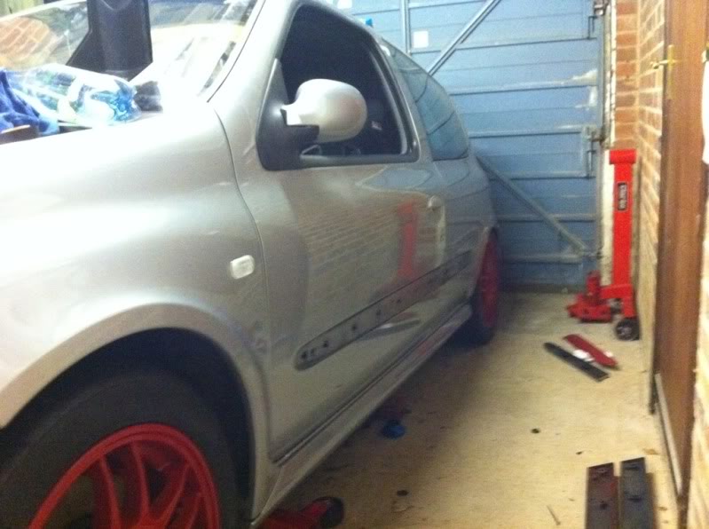

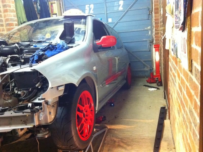

Next up I've bought a few cosmetic bits, different coloured bumpers, mirrors and sidestrips. Changed the mirrors and the sidestrips.

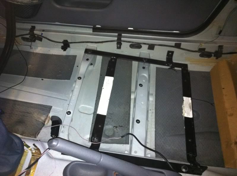

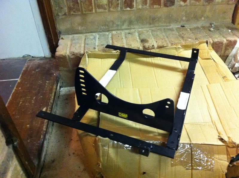

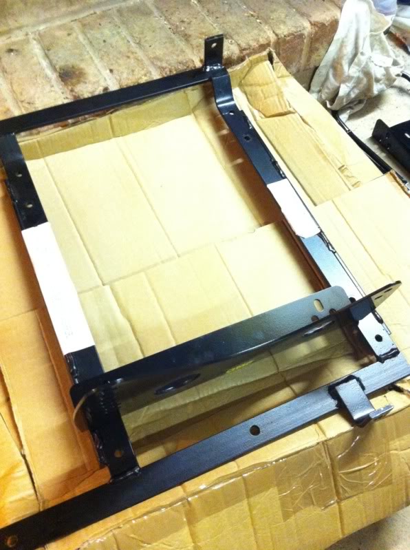

then decided to put one of the seat subframes in the car.

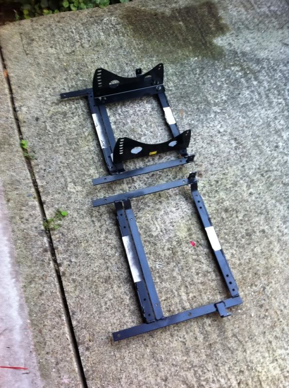

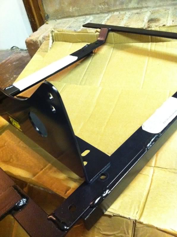

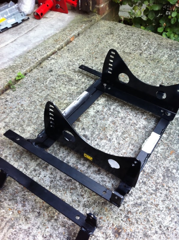

I've bought bolts that were too long, but more of an issue is the Cobra subframes don't fit the OMP sidemounts i've got.
I've either got to buy a whole other set of Cobra sidemounts, or buy OMP subframes, or get these modified. As a short term solution (just so i can get the car mobile) I'm going to source some steel and bolt it all down. Thoughts appreciated!

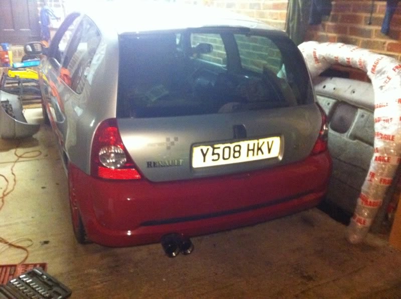

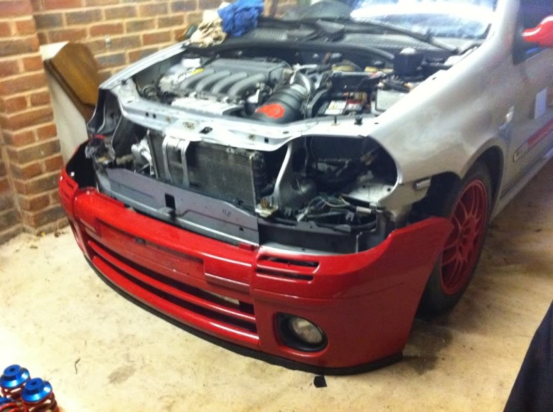

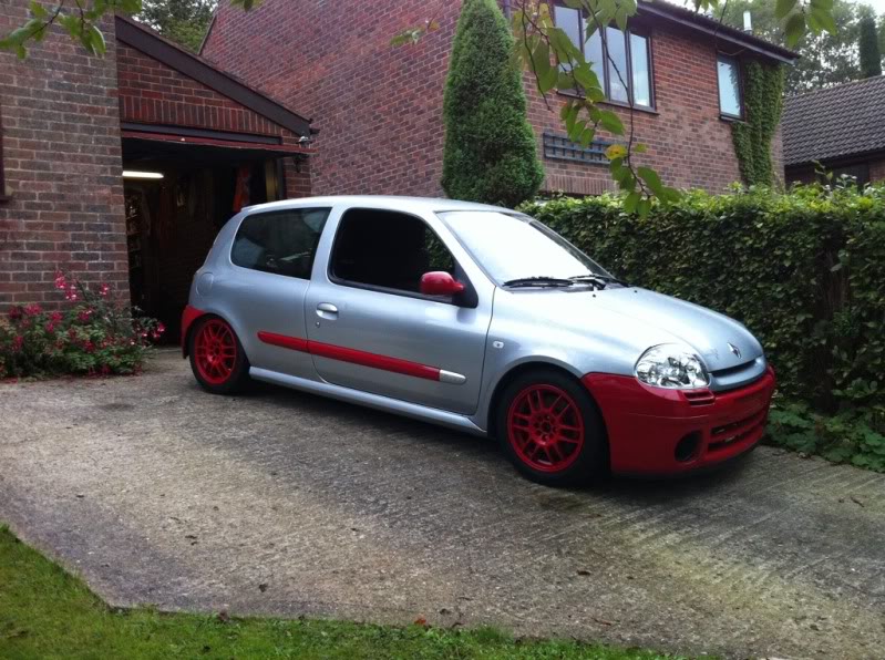

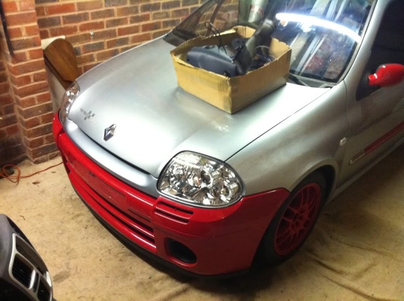

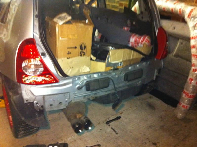

After dinner I removed the rear bumper and fitted the new red one.
(It was pitch black at this point)

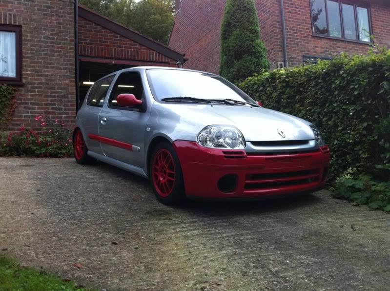

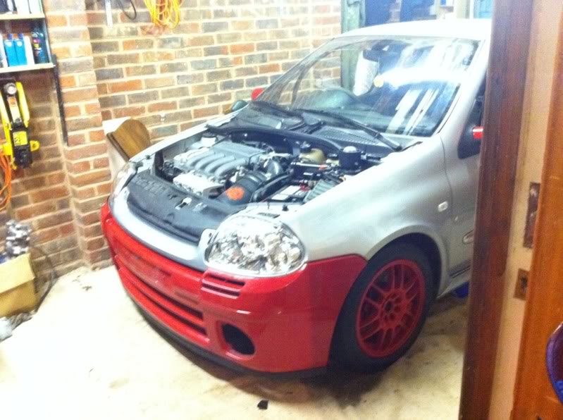

Offered up the front bumper
Fitted it, then remembered on the PH1 the grill has to go on first! Bumper off and back on again.

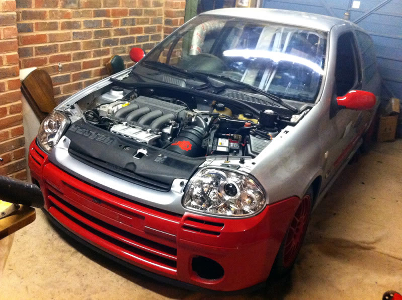

As she stands when I went indoors:

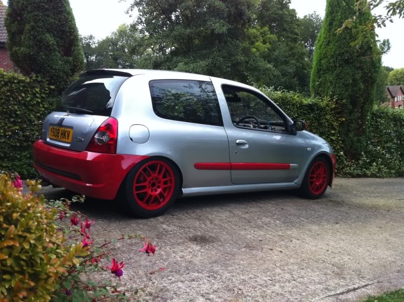

I've fitted the chav lights back to the front of it, but I do have an original set if necessary along with all the original silver bumpers. I'm aware some aren't keen on the colour scheme, but doesn't bother me in the slightest.
Finally:
I've got a few hours on it tonight, so i've got to finish of a few items of trim that need fitting, then the dash has to come out ready for the cage to go in.
Please remember this isn't a road car! If I turn up to a trackday in yet another silver Clio then what good is that?
It looks like you have chosen to have red wheels and then had a bash and got some red bumpers! Ha.
At least get a blue rear or something. Yellow bootlid. Clio Harlequin.
Rob, finally a man with style!
I guess it's not scene to have red bumpers, therefore I fail.
I think the red looks good

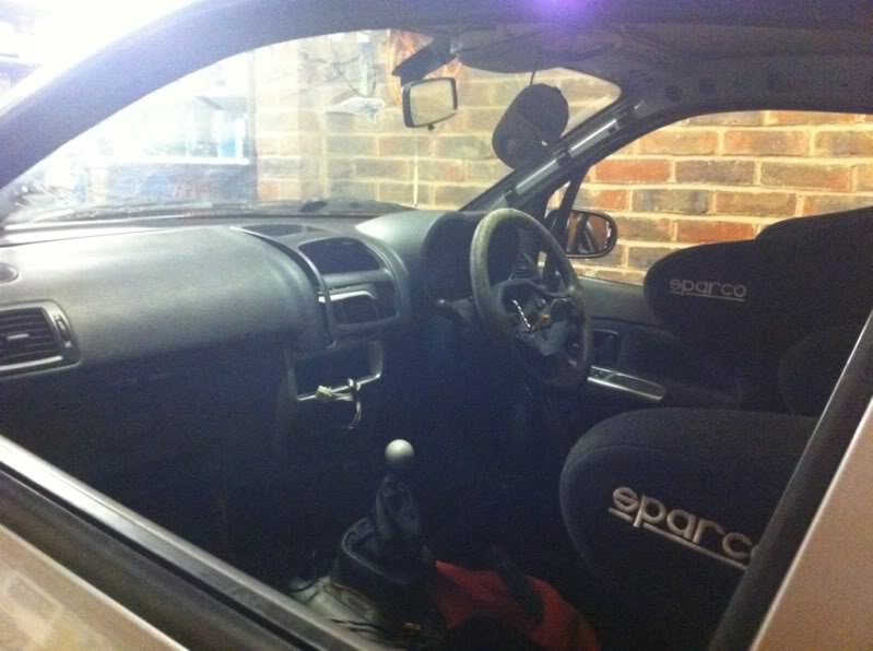

Seat frames back, all sorted:
Andy charged me £30 which I was happy with. He's done a good job and even flattened off the horrible Cobra welds so the sidemounts sit flush. He was less than complimentary about the build quality, especially after I told him the original price!!
Drivers one in place already! :)

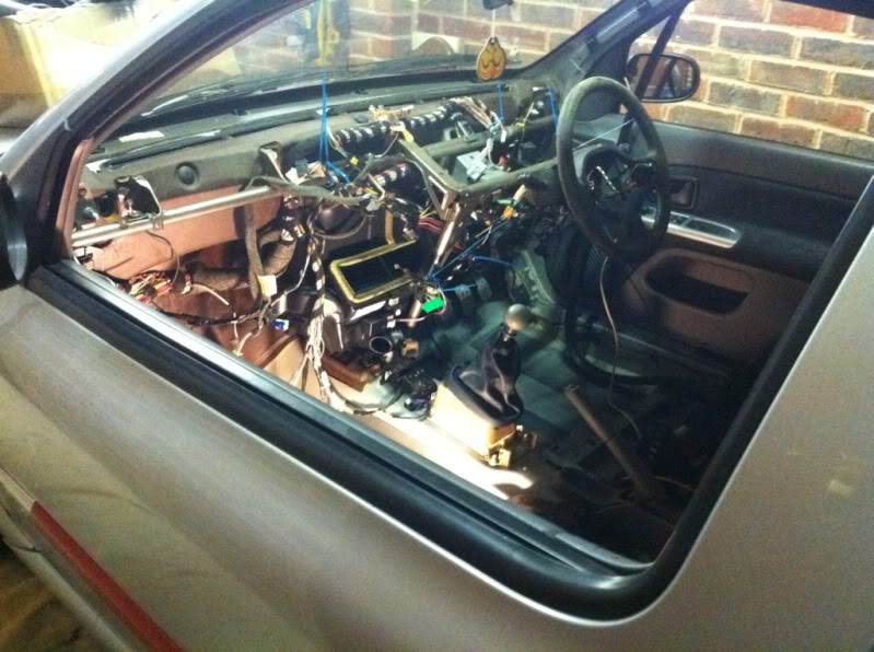

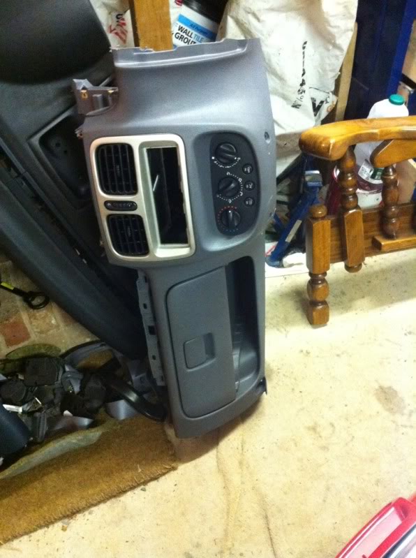

Next up, I needed to remove the dash. Top bit was easy peasy, so that just left the bottom half. Steering wheel off, stalks off, radio hand controls off and binned. Disconnected the heater controls (fiddley) and then the 7 obvious screws, 4 hidden screws and the one b*****d screw. Everything free I then yanked it and it came free, except it didn't. The guy that had fitted the alarm had run the loom between the dash and the heater pipes, which is all one sealed unit.
Out came the hacksaw.
Nevermind, i'm going to a newer shape dash anyway.
The resulting mess:
The loom is HUGE
In addition to it the Cobra alarm wires are everywhere.
Tidyed temporarily with cable ties and called it a night.

I'm not keen on the tailpipe design anyway so it'll change to a single exit out through the bumper cut out. It's a lovely exhaust otherwise, so no need to change much.
