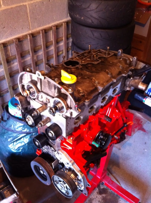

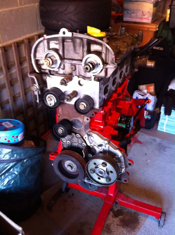

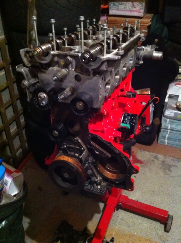

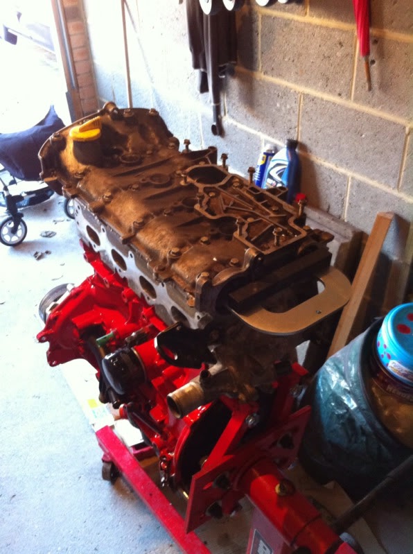

Engine coming along. Hope to clean rocker cover properly tomorrow and paint it all up. Then ill get the cambelt on and it timed up. You can see the cams are locked an the crank is also pinned in place already. I've got a new crank bolt to fit as well.

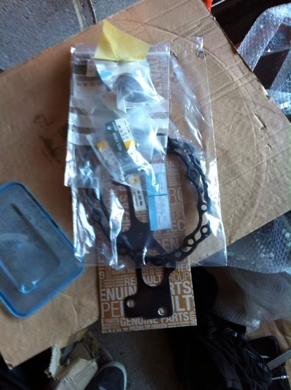

Needed a couple of bits from Renault. Kerchinggggg!

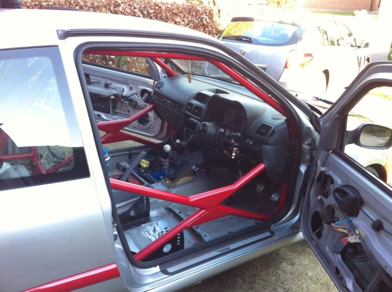

Annoyingly in the 3 weeks the car has been sitting the dead quiet engine has developed a really loud screech. We thought it might be the dephaser pulley again but I think its alternator related. I've not got time to fix this now so it's going to be like that for Rockingham. It did get a bit quieter when it warmed up and it's only when you rev the engine. Frustrating.

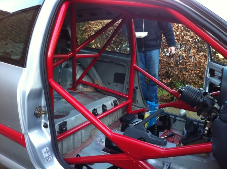

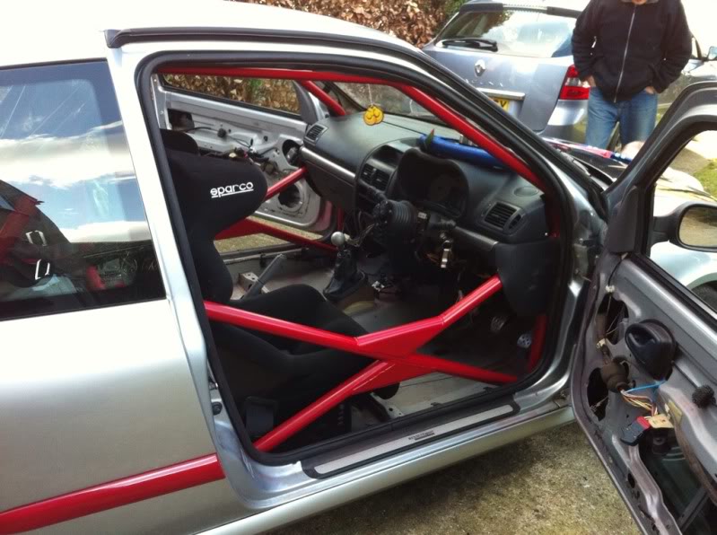

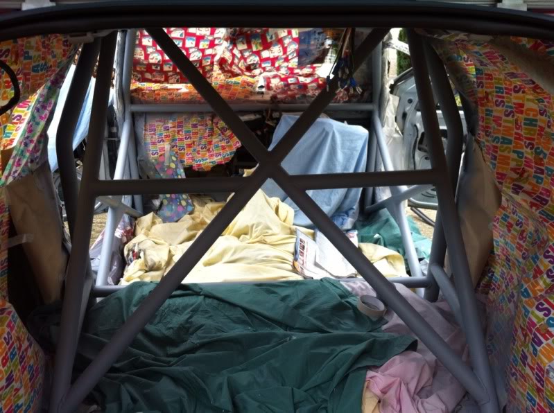

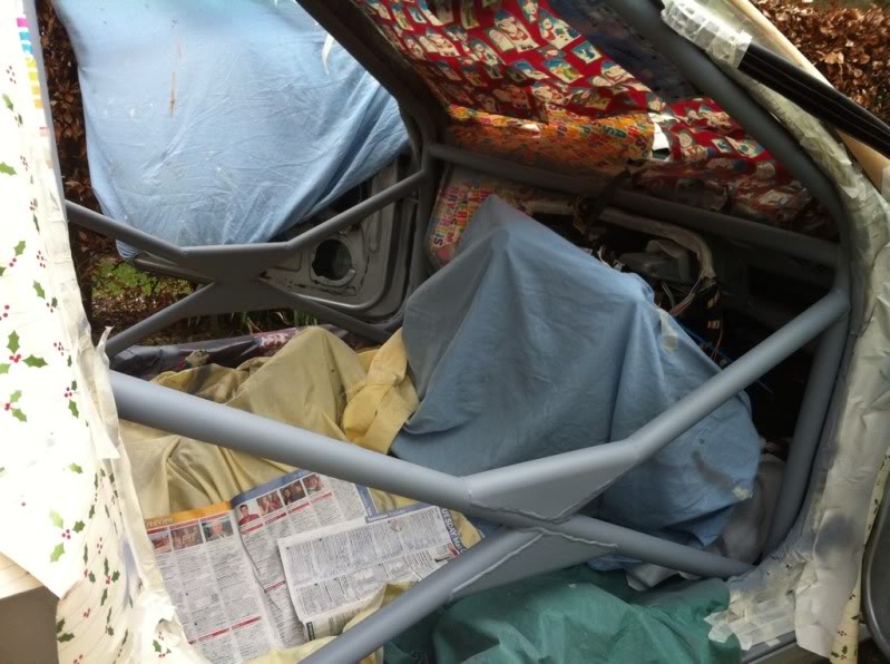

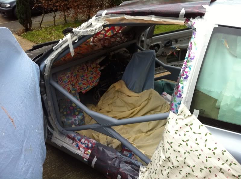

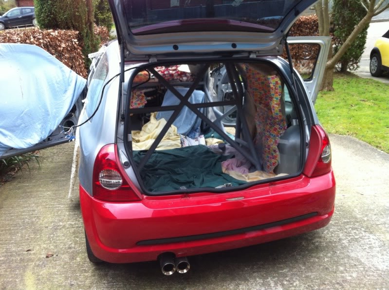

First thing first the car was rolled out the garage and seats/dash removed. We began masking up to paint the cage. What an arse of a job, it took bloody hours!! It also started raining halfway through so I ended up finishing very early Sunday morning before heading north. In total it took 3 big cans of primer and 6 cans of Capsicum red. Looks good though I think.

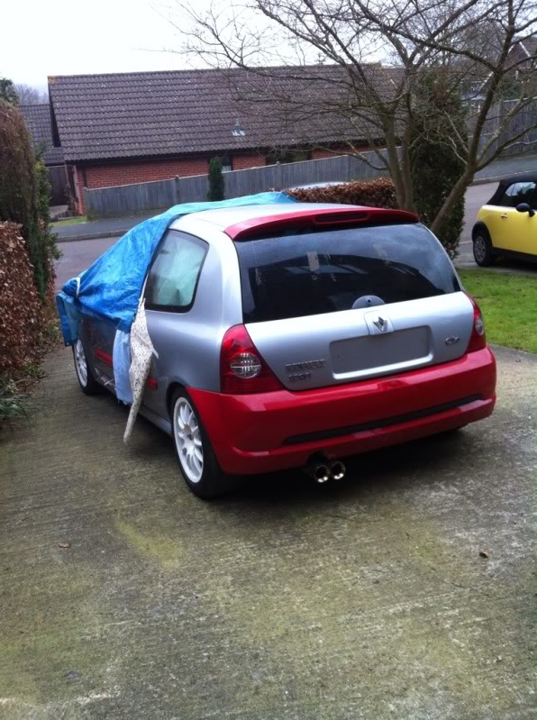

Quick cover up when it rained!
Done.
(Dash half in properly.)
Dash almost finished.
I still need to connect the heater back up, but apart from that everything is in and working. As it stands it's useable for Rockingham so thats OK.

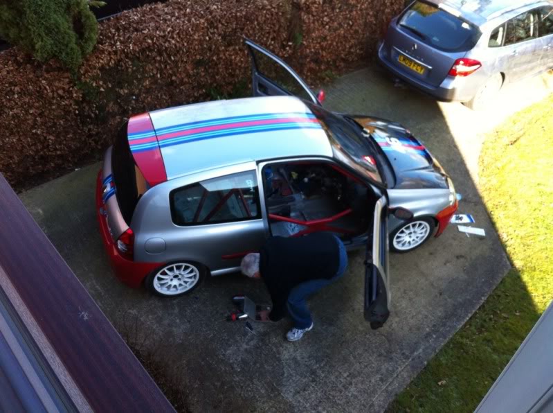

We did find some time to apply a few stickers though ;)

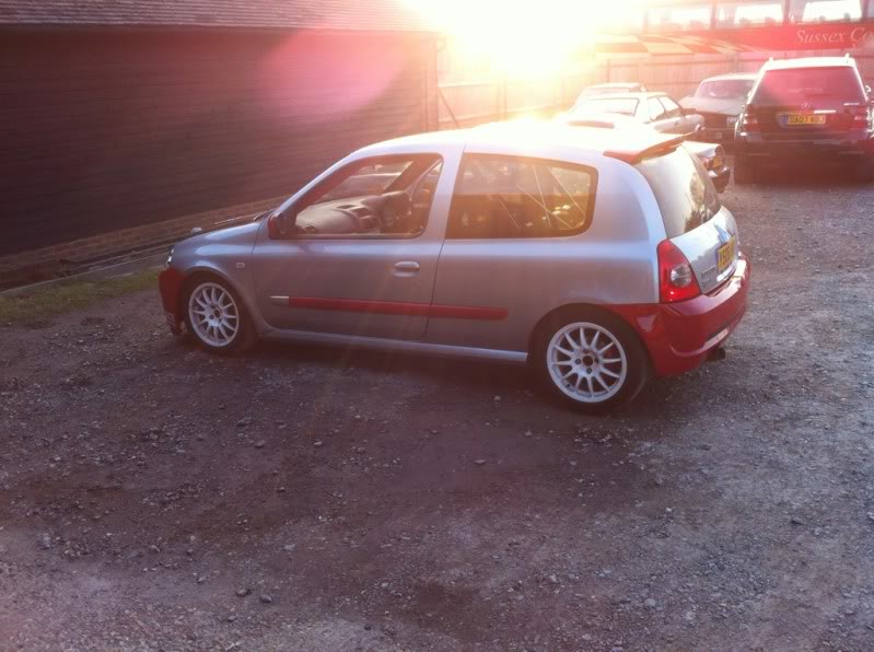

Bright and early I started the car and backed it onto the road. This was the furthest the car had moved in 13 months and would also be the engines maiden journey. Half hour later i was at Gareths and apart from a weird burning smell and continual suspension bangs it was fine. Phew.
