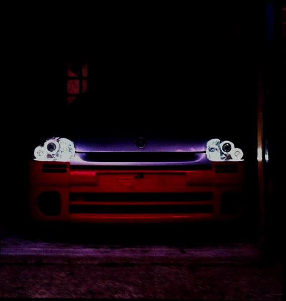

The chavvy ones that were on the car when i got it. God knows who makes them. they weren't wired up properly before. they've also got inbuilt daylight running leds that look 'ok', i've just got to find a permanent positive feed and get them hooked up as well. The angel eyes are now wired into the foglight circuit, so i just put front fogs on and on they come. they don't look that bad, but i do have a set of originals should i wish to change.
  Golf GTD Mk7
Fair enough mate.

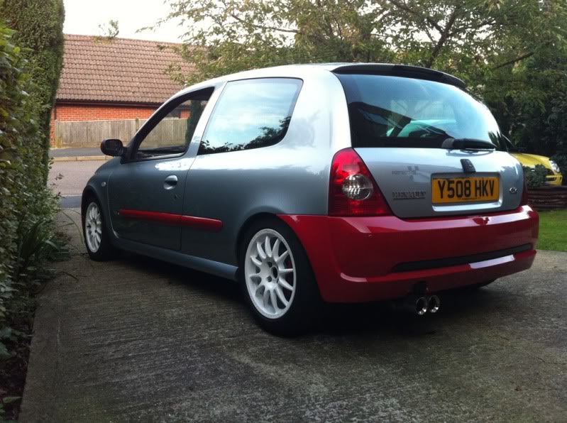

I do feel that looking at her in the light of day that you need a little more balance with the red. Maybe skirts red also? Just a thought ;)

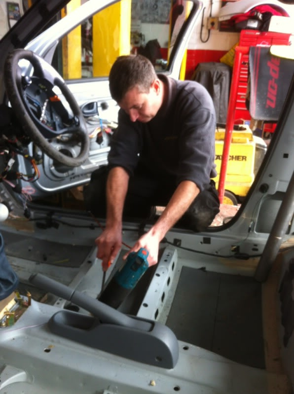

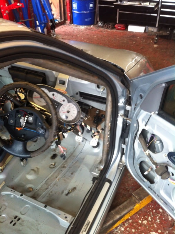

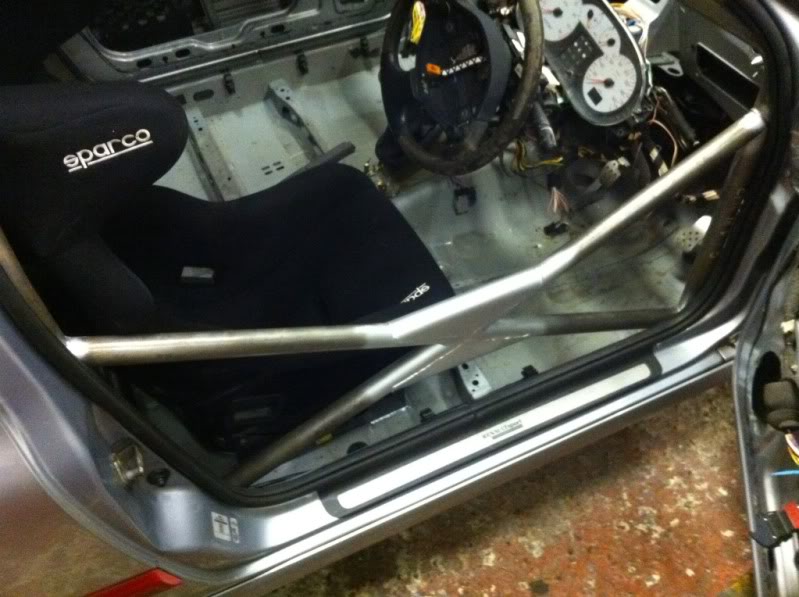

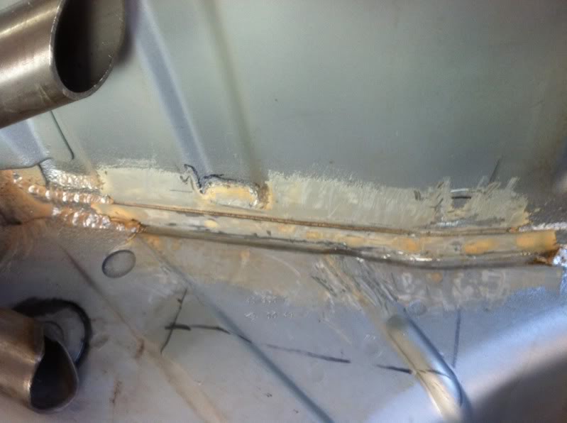

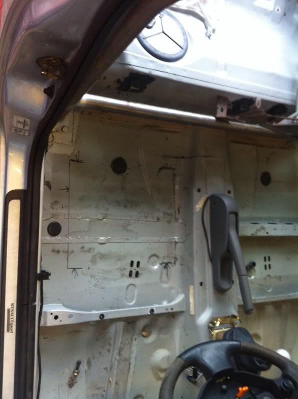

Jon arrived this morning with his seat. The aim was to get him in the car to establish the seat position so I could continue with mounts and harness positions.

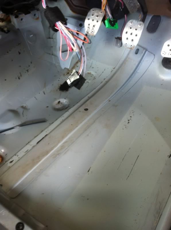

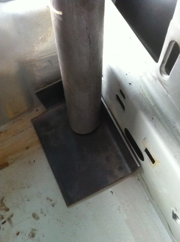

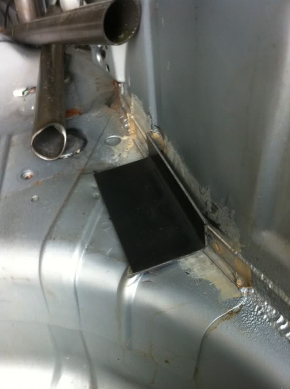

After some discussion we decided that, because Jon is a lanky fella, the best solution would be to put the seat straight on to the floor. This involved removing the original rear seat mounting rail. Once this was out Jon sat in and happily could reach the pedals fine.

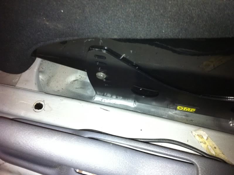

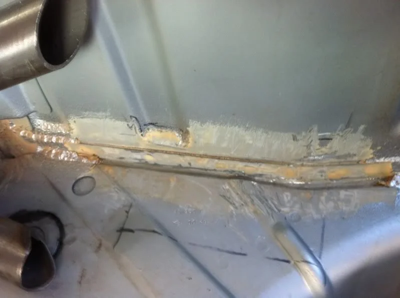

Jon - Box section of the floor was cut out before seat got mounted in:
(The seat cannot go lower than this!)
FIA regs mean that there must be 40 square centimetres of contact with 3mm thick counter plates at each mounting point either side of the floor. These counter plates were made and welded in, and the seat mounted.

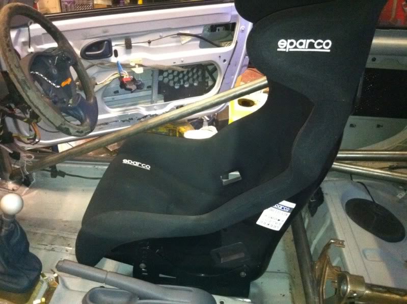

Seat in, feels lovely!
The passenger seat will be mounted in the exact same way.

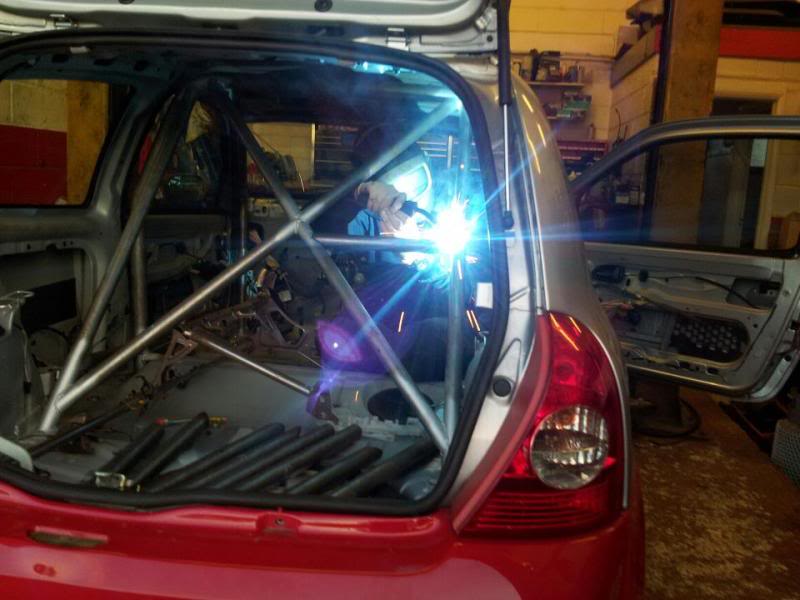

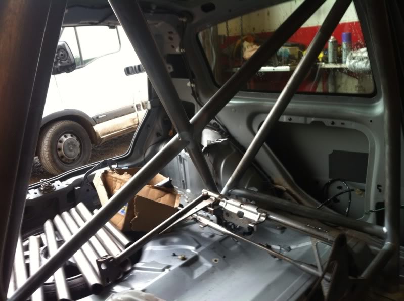

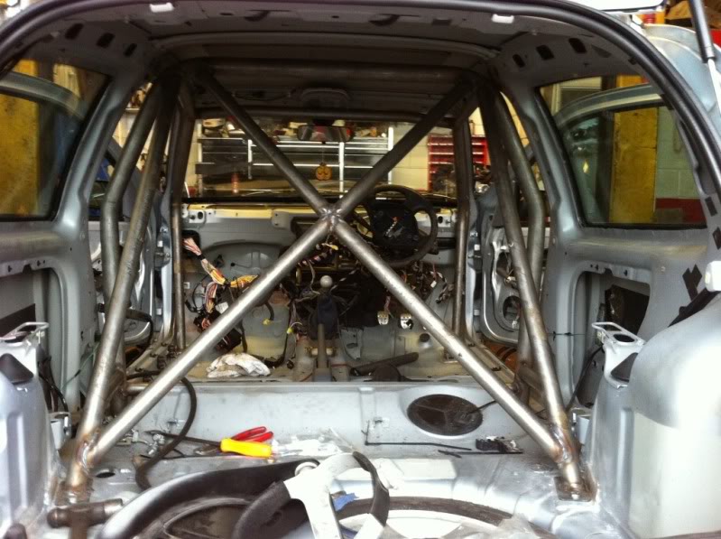

The cage is looking marvellous, I'm really chuffed with the way it's gone in and the work Gareth has done so far. It's going to be great when it's all finished.

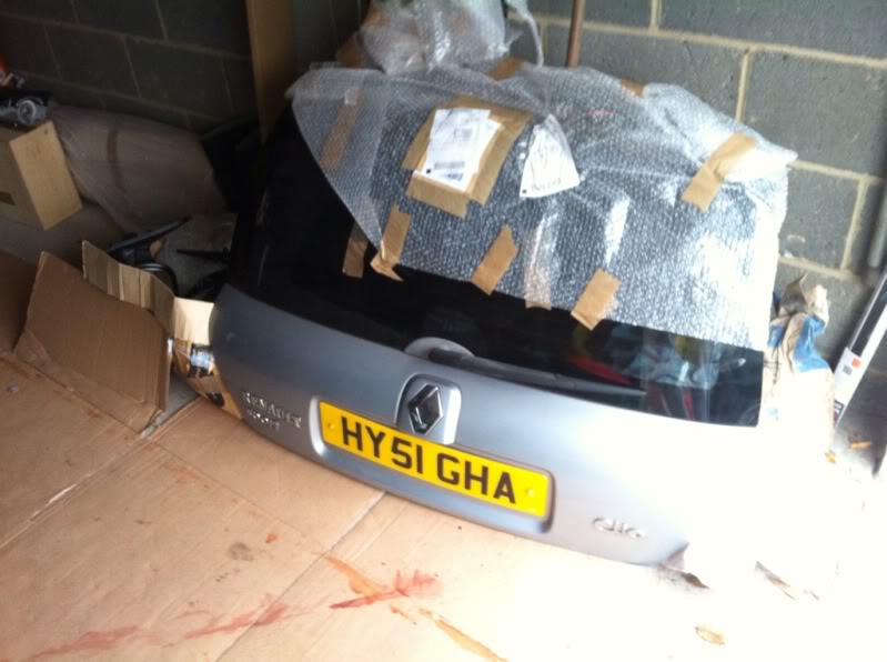

New bootlid to replace the one with a dent in it on the car (phase 2 rear end now complete)

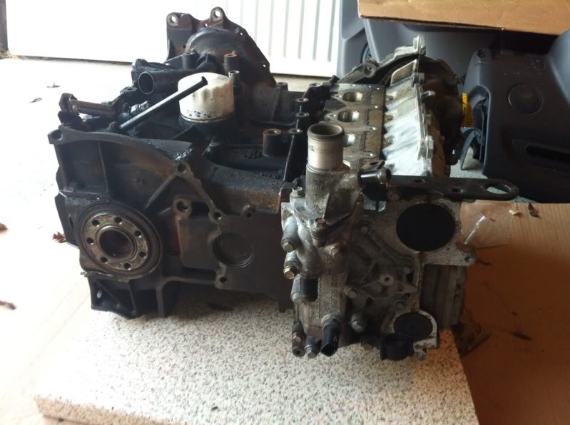

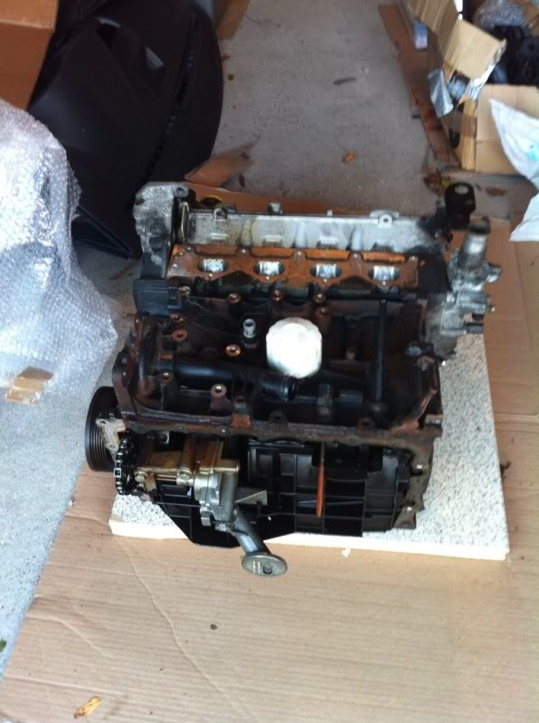

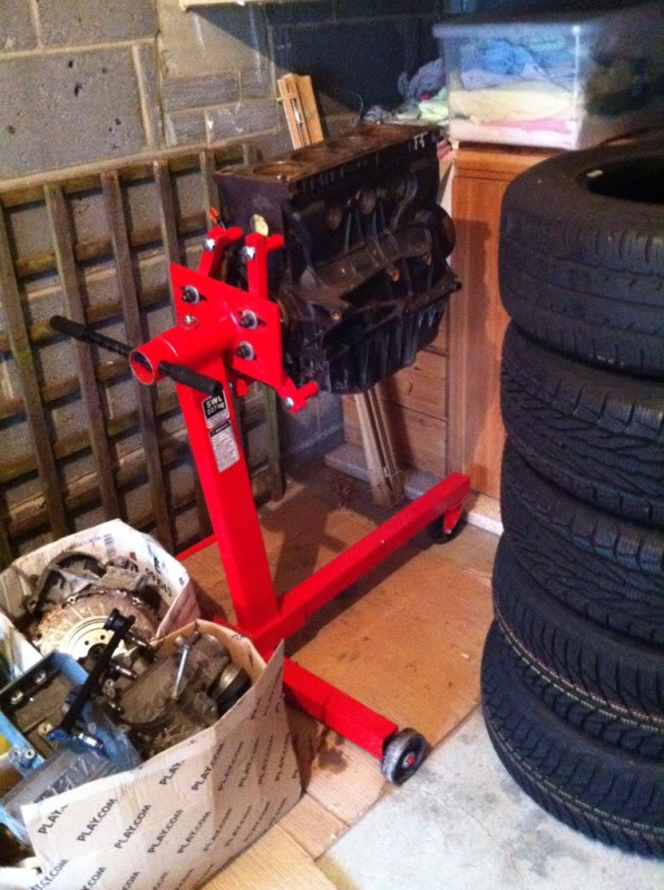

Spare engine project:
Complete bottom end (that i'll strip and rebuild)

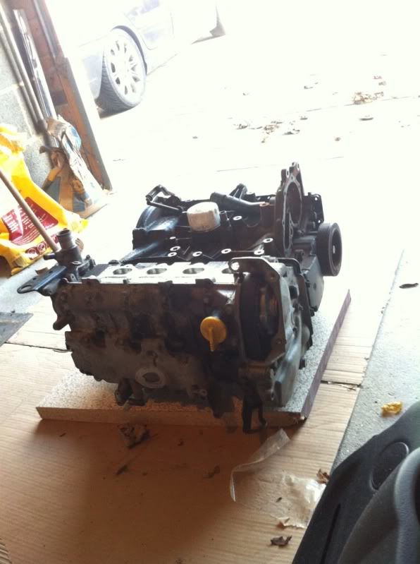

Also, had a brief trip out last night to a cold Middlesborough and picked this up (i've just lifted this out of the BMW by myself
Essentially i'm only going to use the head as the bottom end has some 'issues'. It apparently runs fine and had a new cambelt 500 miles before it was broken. It's a 182 engine with 55k.
Anyone see the obvious problem?

Christ Jon, you must have some guns hoisting that out on your own. :hail:Found it a right ball ache lifting one out of my 106. Had to drop it onto a tyre.
did it empty itself of oil completely? Sump looks bone dry?
  172, Tiguan
I think it's been in that state for a while mate. There are a few drops of oil leaking out so it's not totally bone dry. I must admit the back of the BM is pretty low so i rocked it onto the boot lip and then just went for it, lol! It's not moved since as i'm still waiting for the extended cog that goes on the pulley locking tool to turn up.
  Golf GTD Mk7
It's worse when you try and lift it, the suspension on the car raises, and makes it ten times worse.lol.
