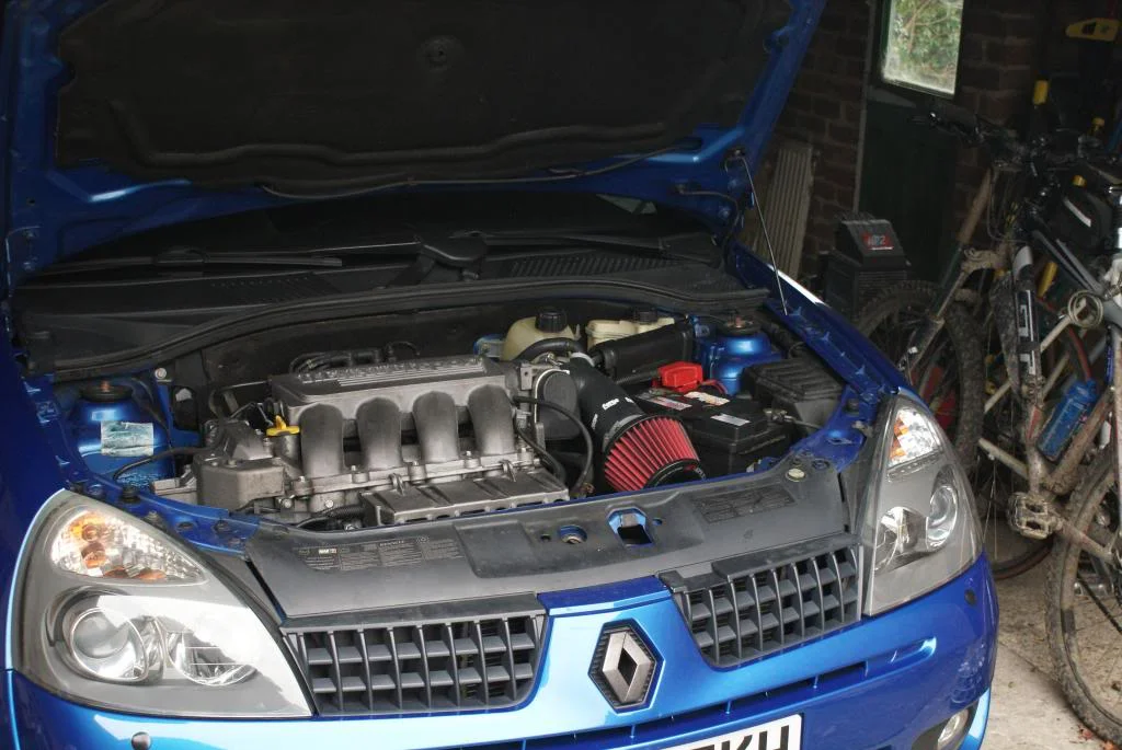

  • apexi filter (get one or you're missing out)

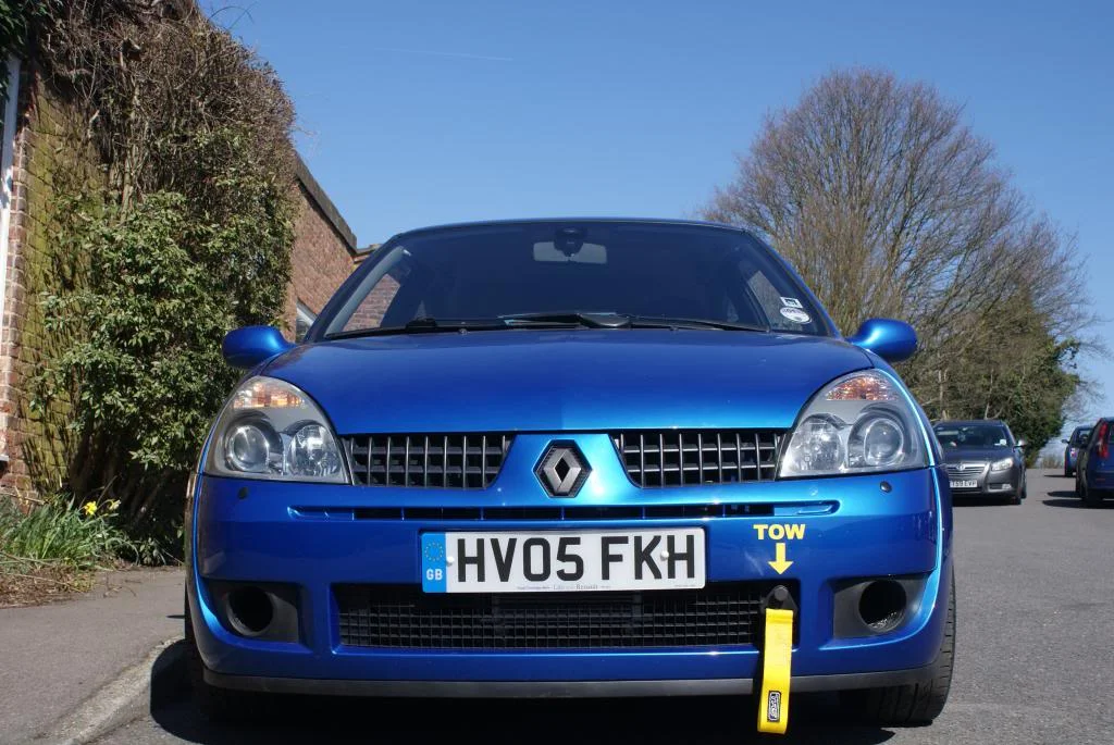

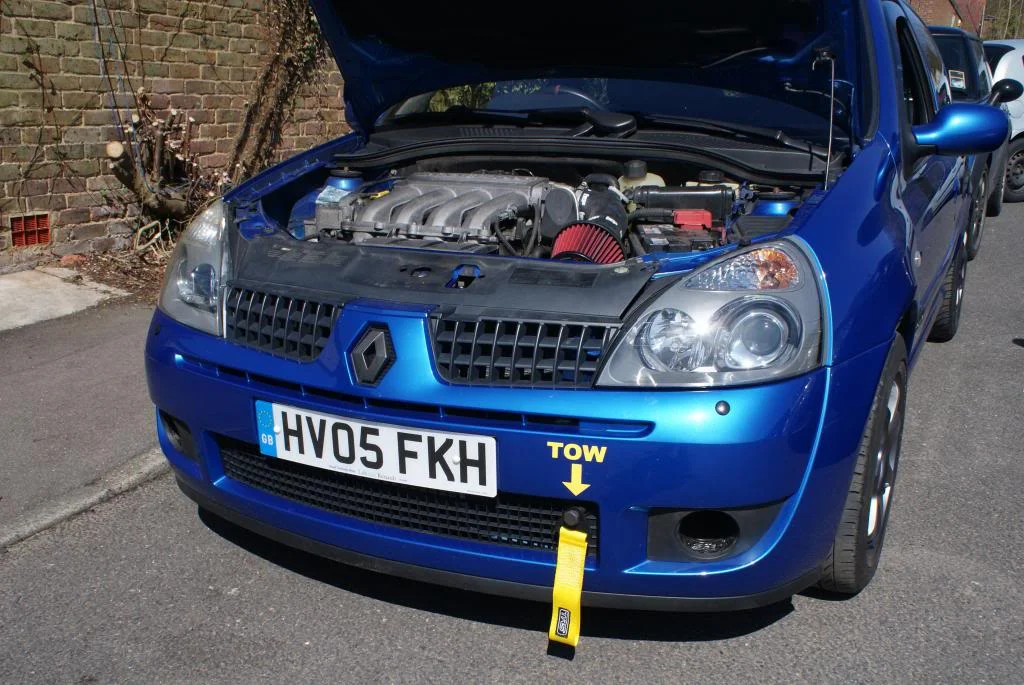

  • tow strap (going back to omp eye)
  • skoda splitter

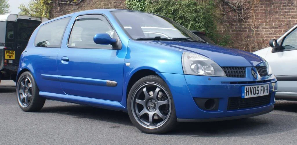

Here she is as she stands then! Lemme know what y'all think yeh!

Both have been built to a nice spec. Only thing I would recommend for your ring trip is a smaller steering wheel. Makes such a difference.
Oh and some decent rubber, your left hand rear looks like a ditch finder?

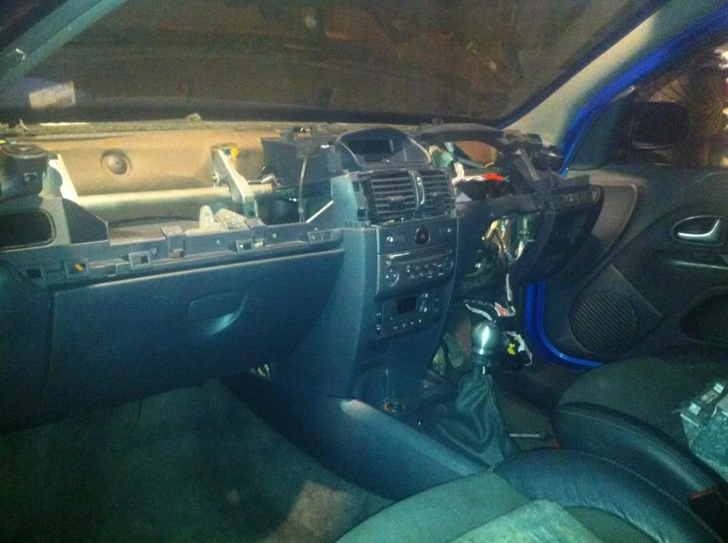

did a little bit of work today, steering column out and a few other little bits

Fit steering rack, epas 75% done now.

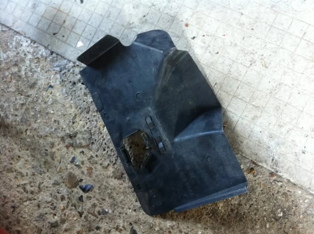

There are a few sticking points left before it's a go go go. I'm looking for a way to attach the ducting to the hole in the arch liner....but...without using tape. If the ducting comes through at all I get rub on the tyre due to the spacers.

All done and complete bar attaching the ducting; pound land tape didn't stick. I put the steering splines on 180 degrees out (been in the garage too long) which was throwing up lights all over the shop. Sorted that, taking a whole day. All work carried out over the last 2 months is now complete and it's ready to hit the ring in august.

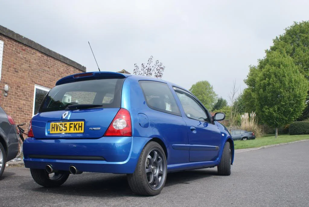

Couple of piccies from the weekend after a clean.
WHERE DOES THIS GO????!!!?!?!?

Looks like its coming along nicely, reminds me of my old arctic.
Your RARB looks to be fitted wrong. It looks to be sitting too low, probably have the mounts that bolt to the shock absorber round the wrong way.
