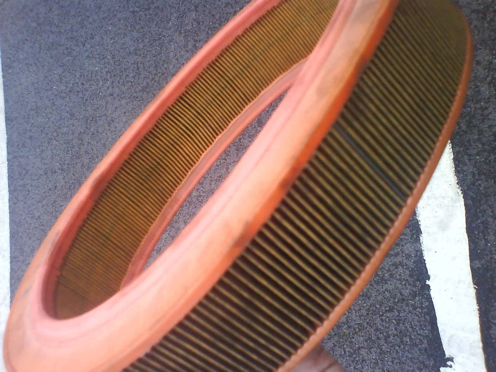

This is one of those round (oval actually) ones. This is what I took out. I've never changed an air filter before, don't know the service history of the vehicle. Does this look as though it was ready for a change or could it have gone on for longer?

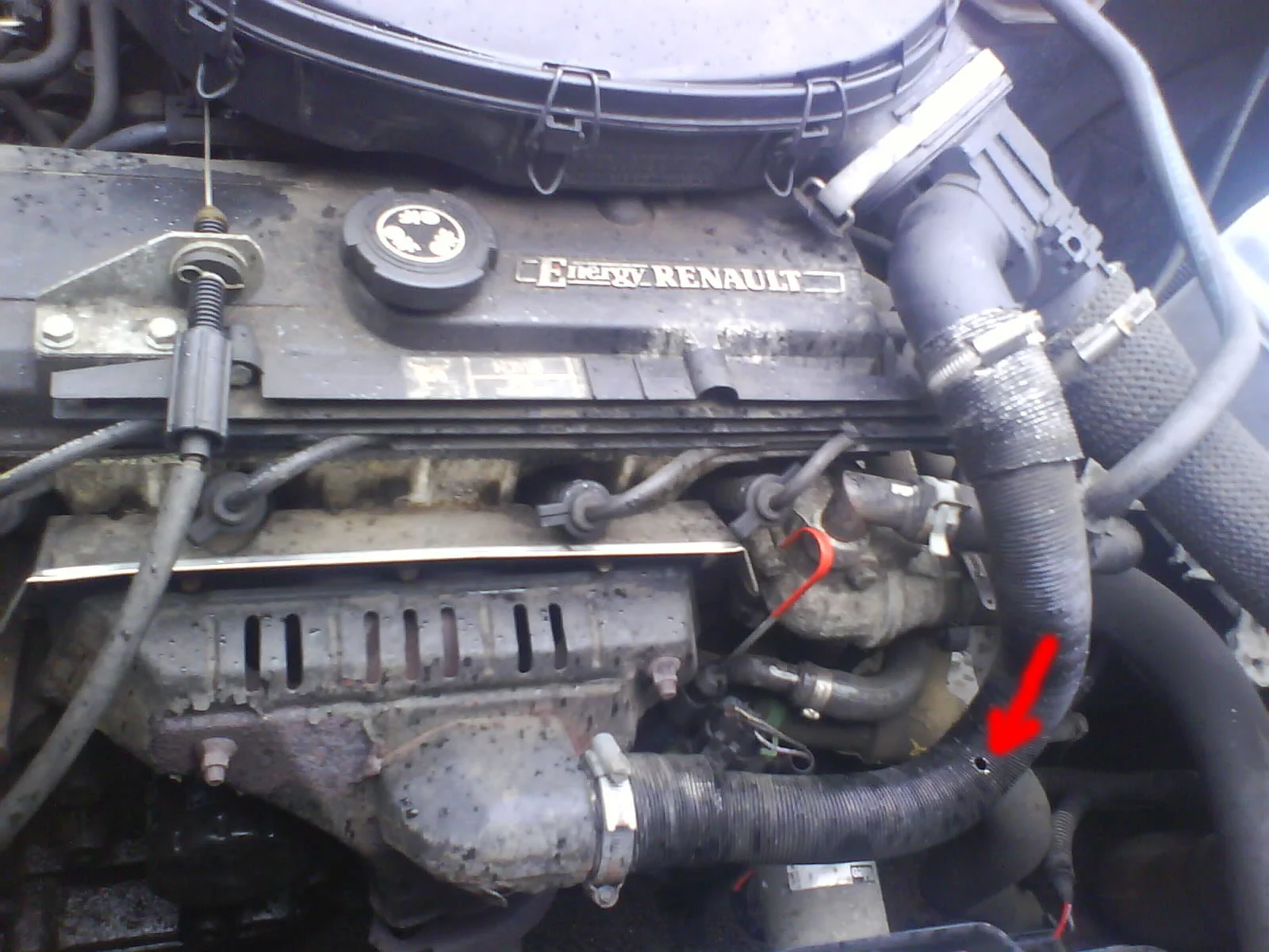

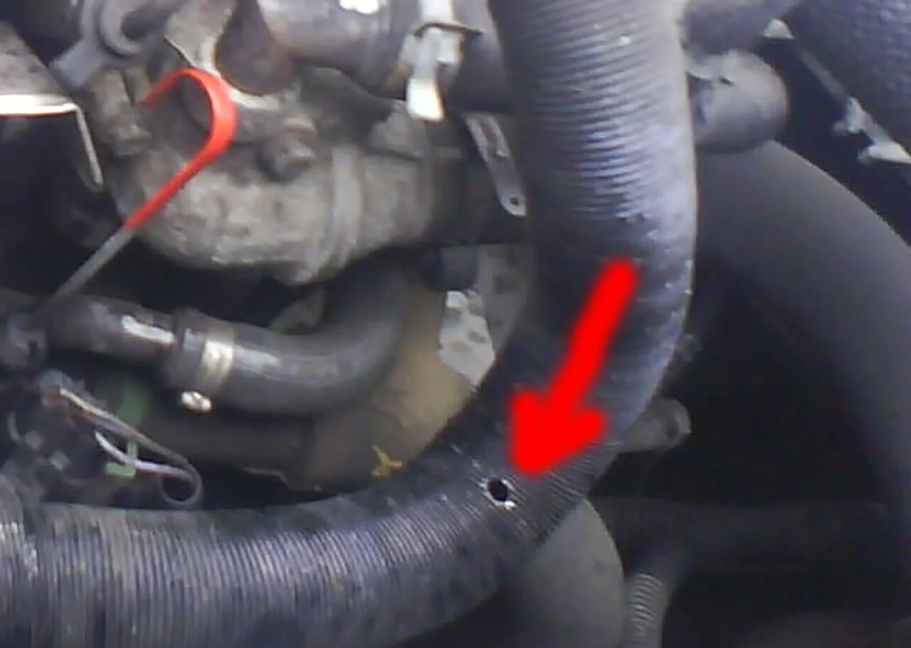

Lots of questions, sorry! When I bought the car 6 months ago, I noticed a hole in one of the vents (see pic). Because of the position and the tidyness of the hole, I always assumed it had been deliberately drilled for a good reason. But maybe its affecting performance negatively instead?

lol that pipe is for sending a certain amount of cold air into the engine when its cold,helps with cold running until the engine reaches temp
it does nothing for performance matey

that pipe puts warm air into the airbox from the exhaust. no idea why..
Carb freezing.
Is it a carb or injection engine? If it is a carb, it may need re-jetting to adjust fuel flow.
I'd lose that feed from the manifold and fit a nice feed from the front of the car.

if the filter was 2nd hand did you clean it?
