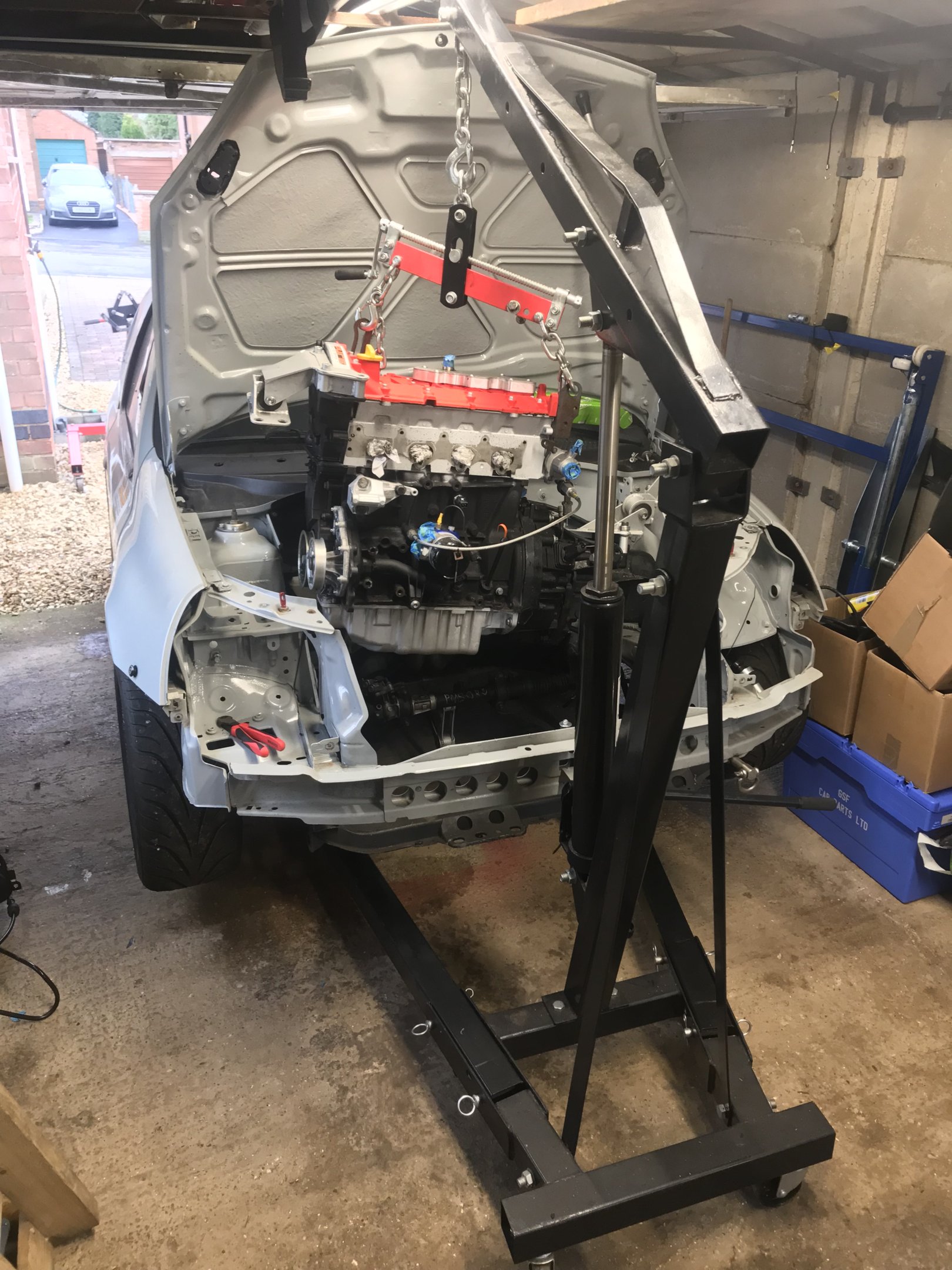

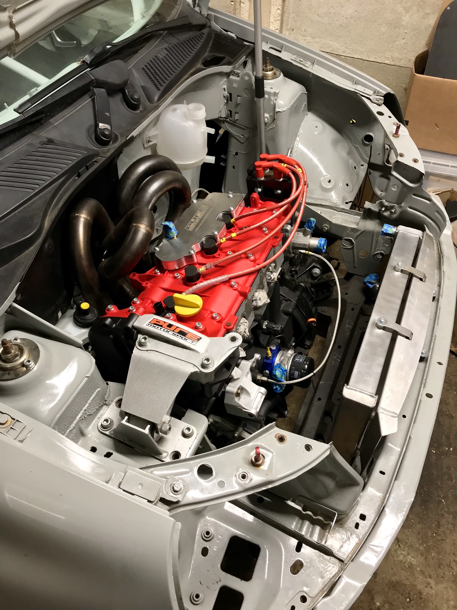

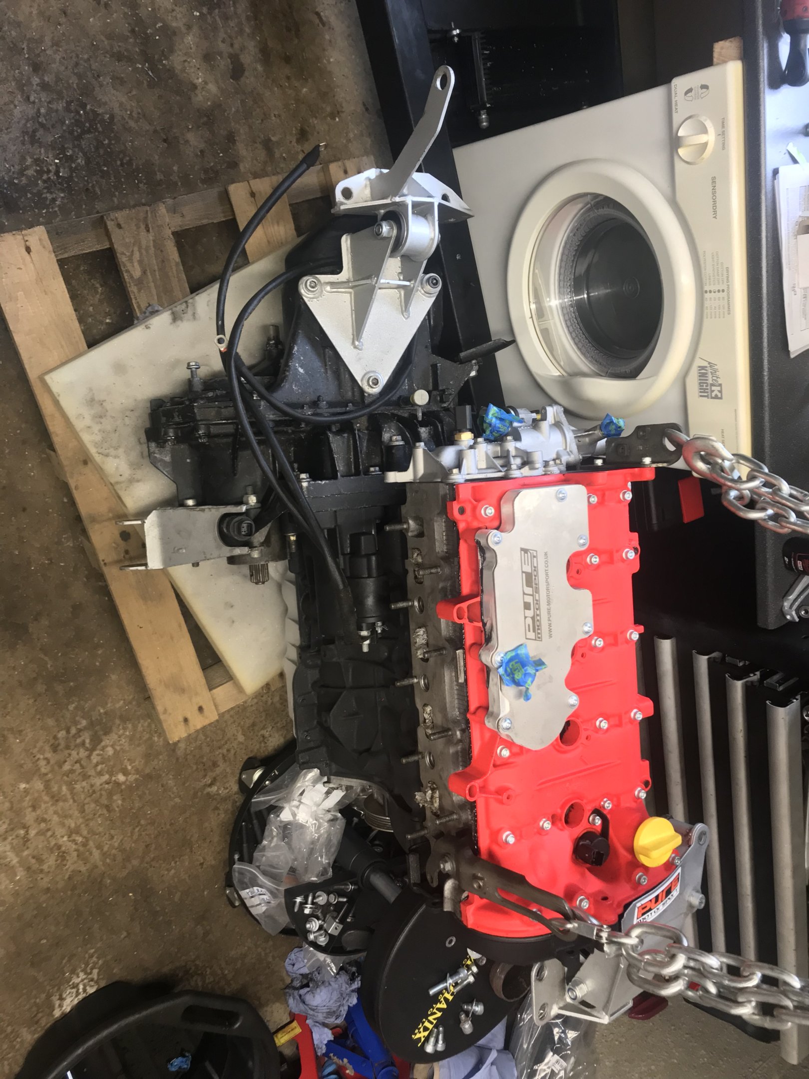

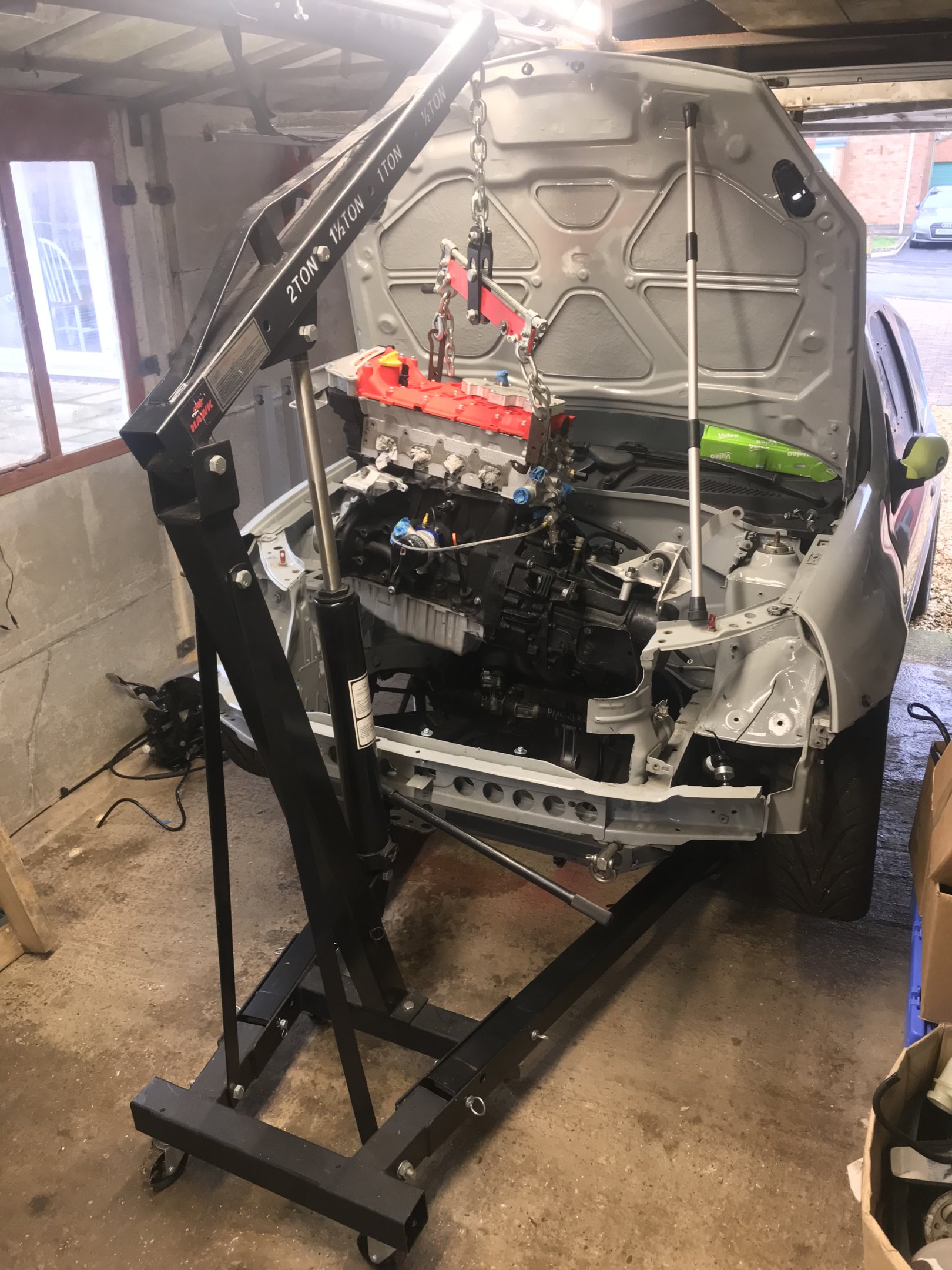

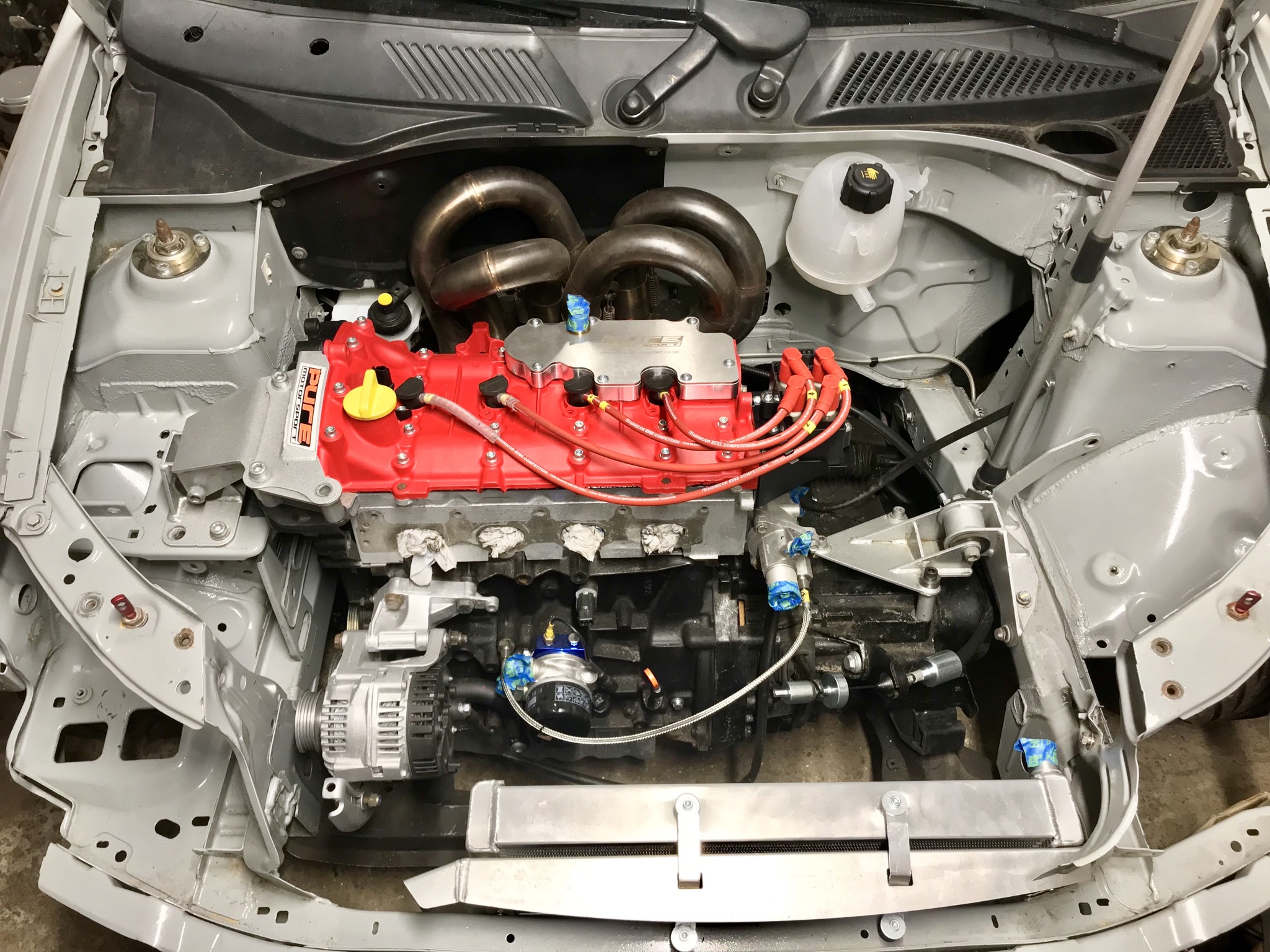

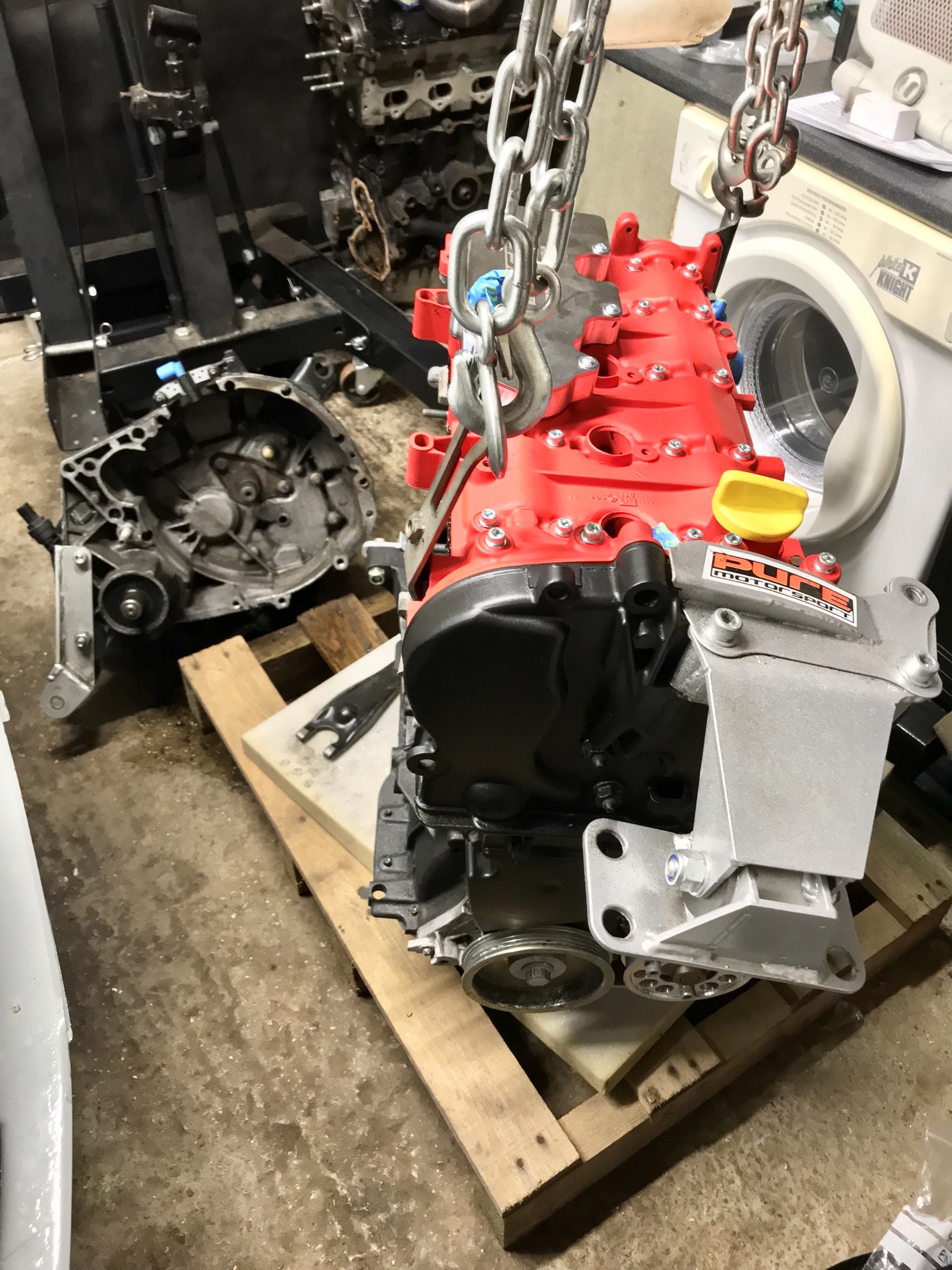

Few pictures from dropping the engine in today.
Started bolting some bits on to make it look like an engine bay too.

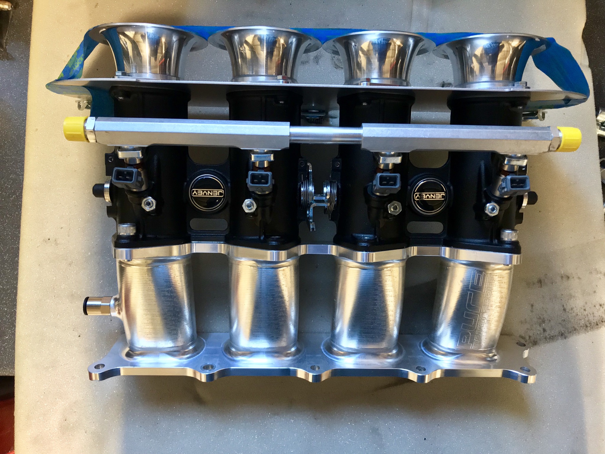

I need to swap the PMS linkage for the Jenvey linkage, anyone got any ideas how this is done and if it’s easy enough?
I haven’t even looked yet but I’m sure I read on here someone has done it ? just can’t think who lol
vroomtshh
  Seat Ibiza Cupra TDi
I've done it.
Its a bit of a f**k about. I'd do it in the warmth of my living room if doing it again, before you fit the bodies to the car.

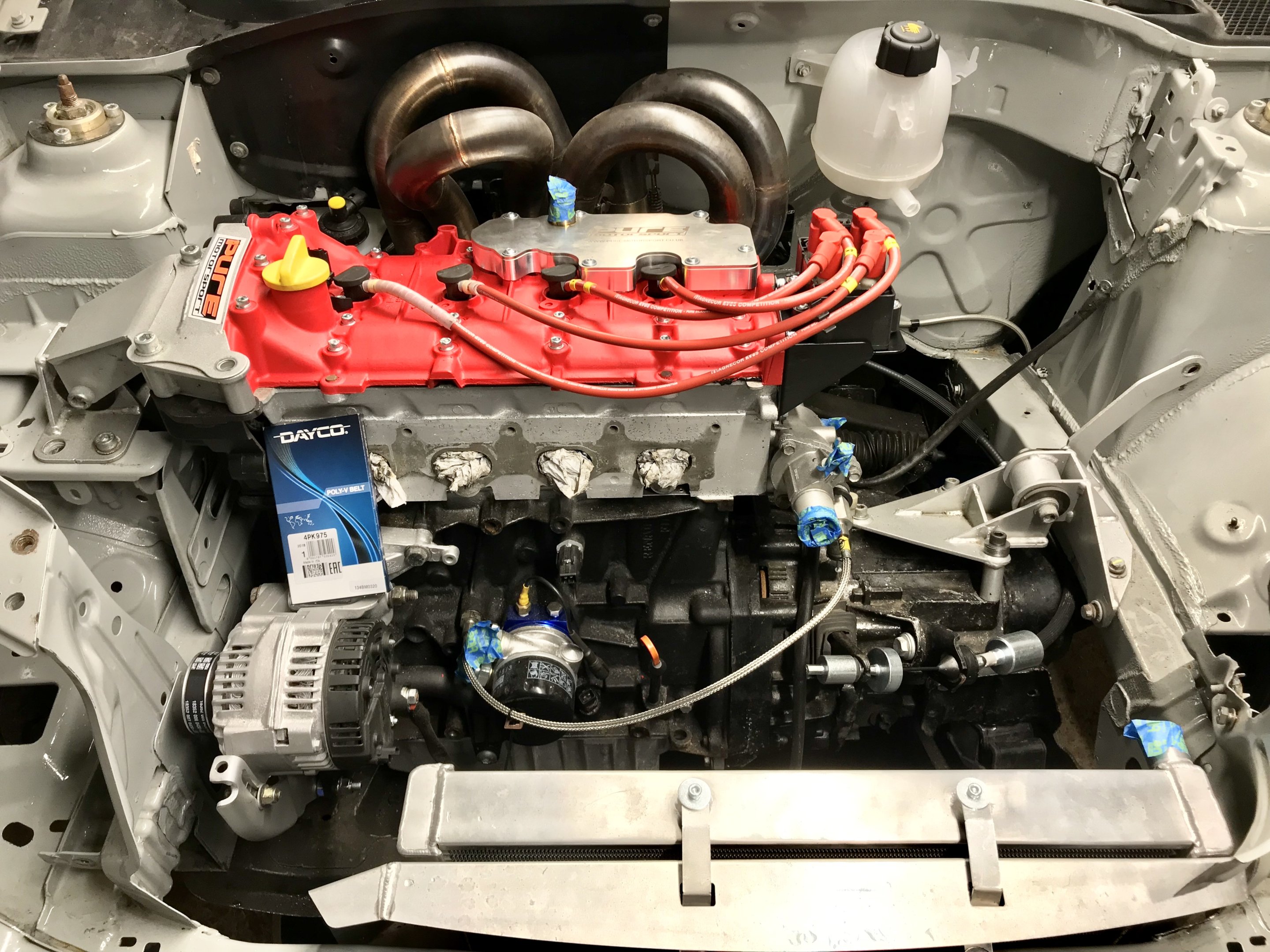

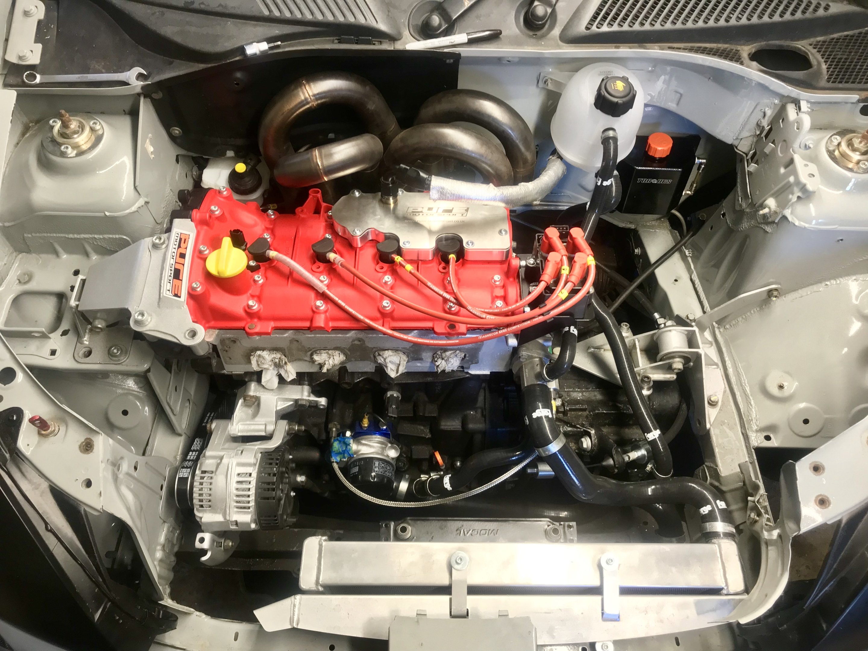

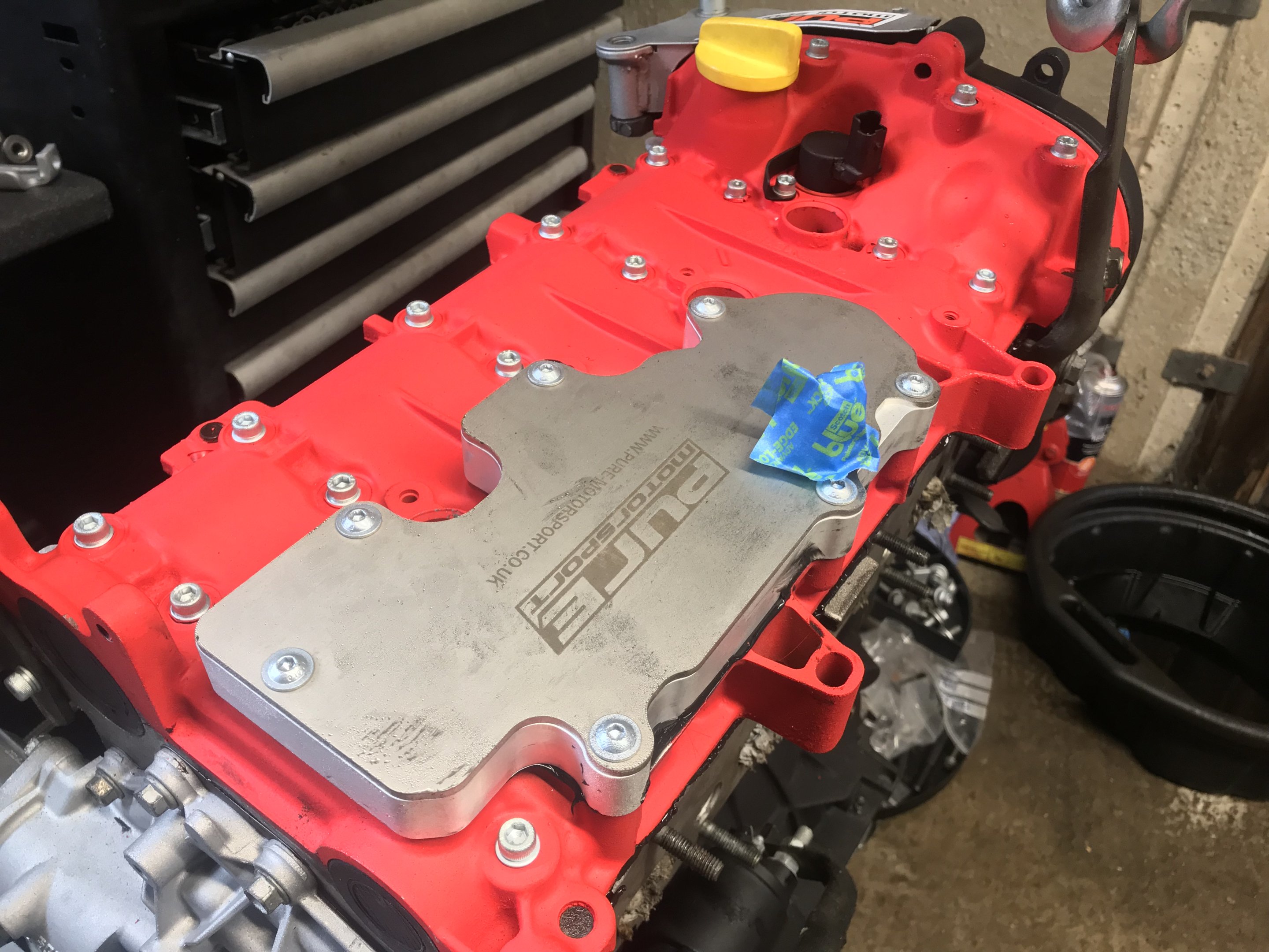

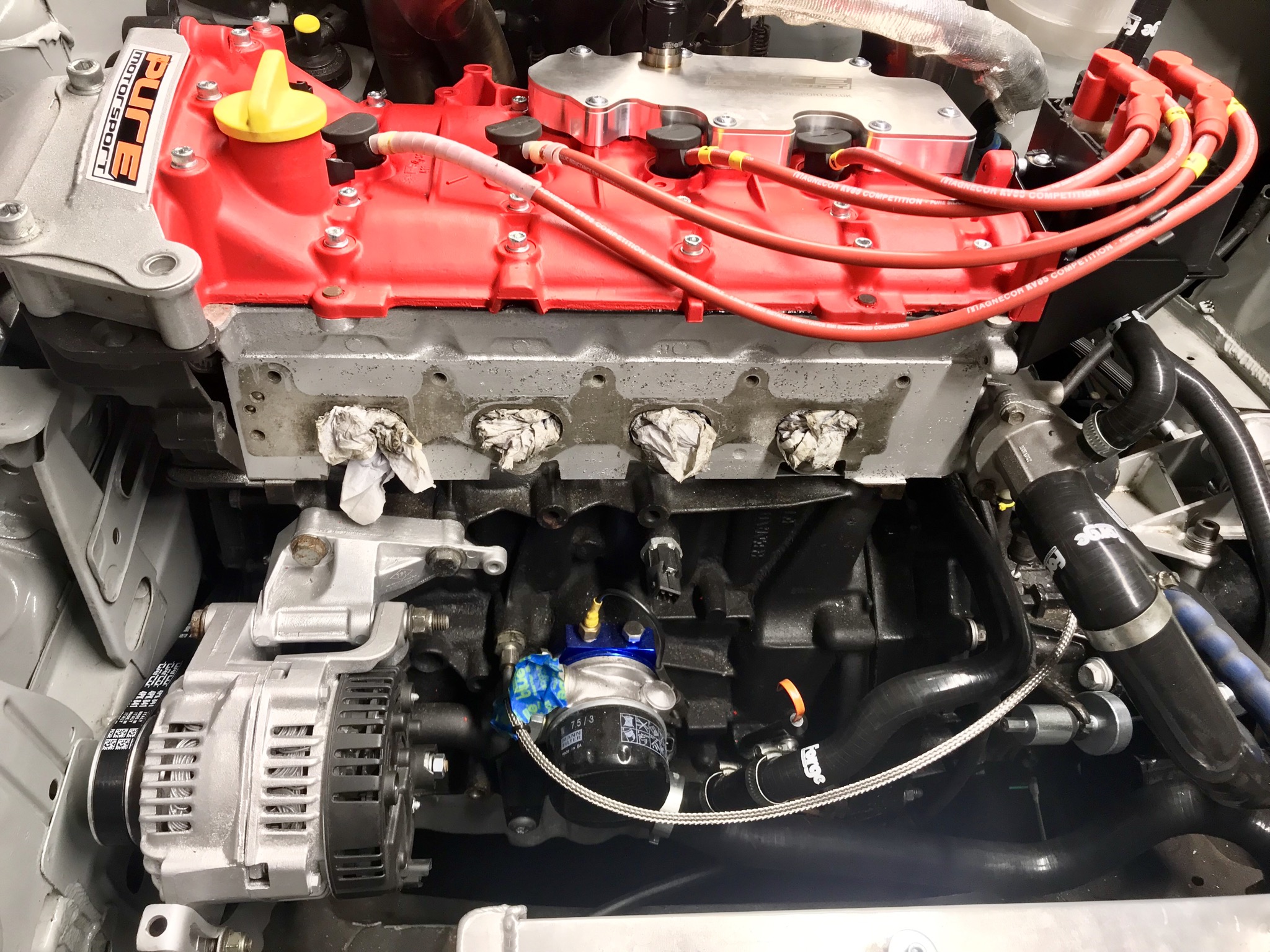

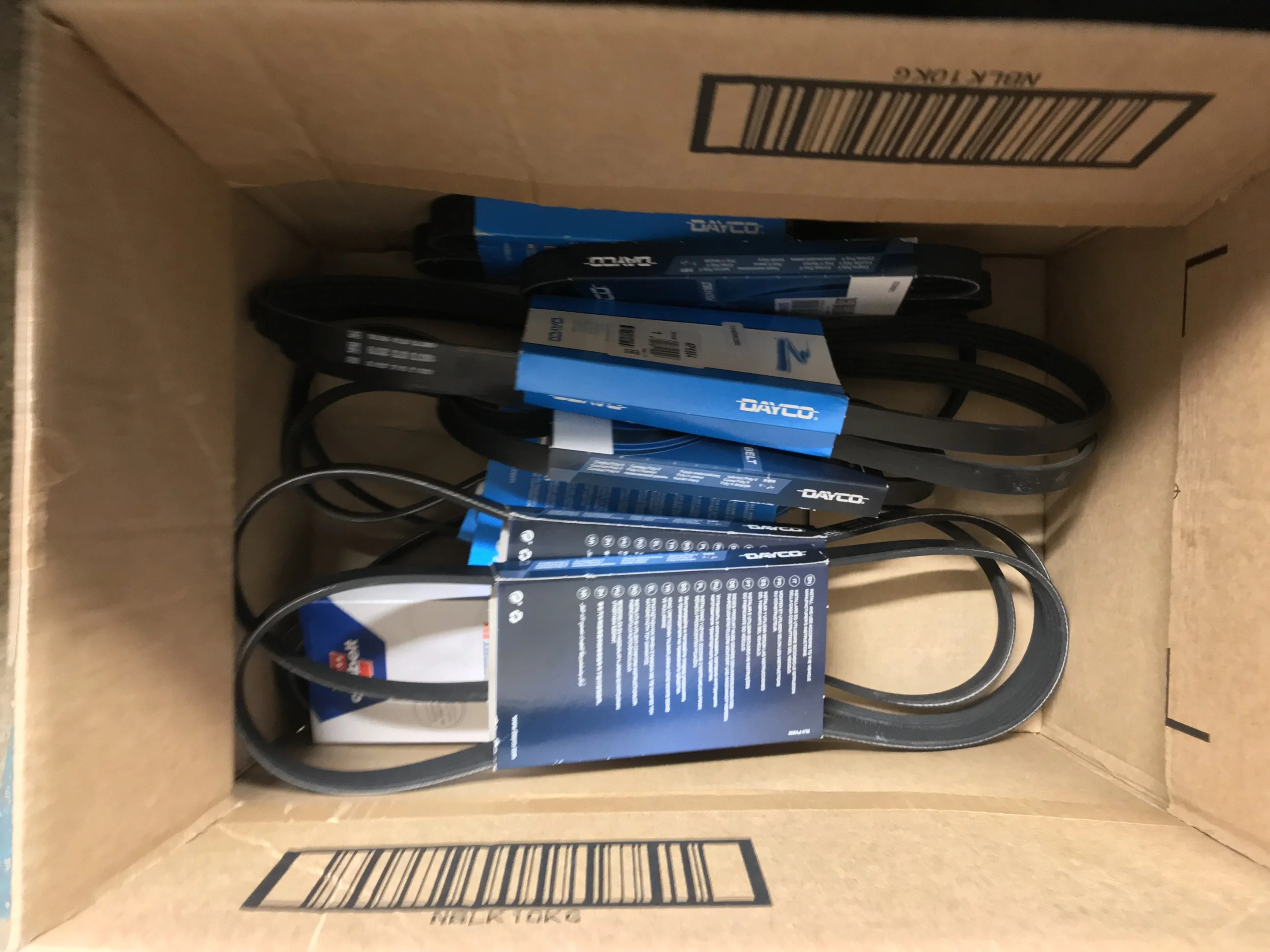

Few little bits done.
Clutch cable fitted. New rad cap.

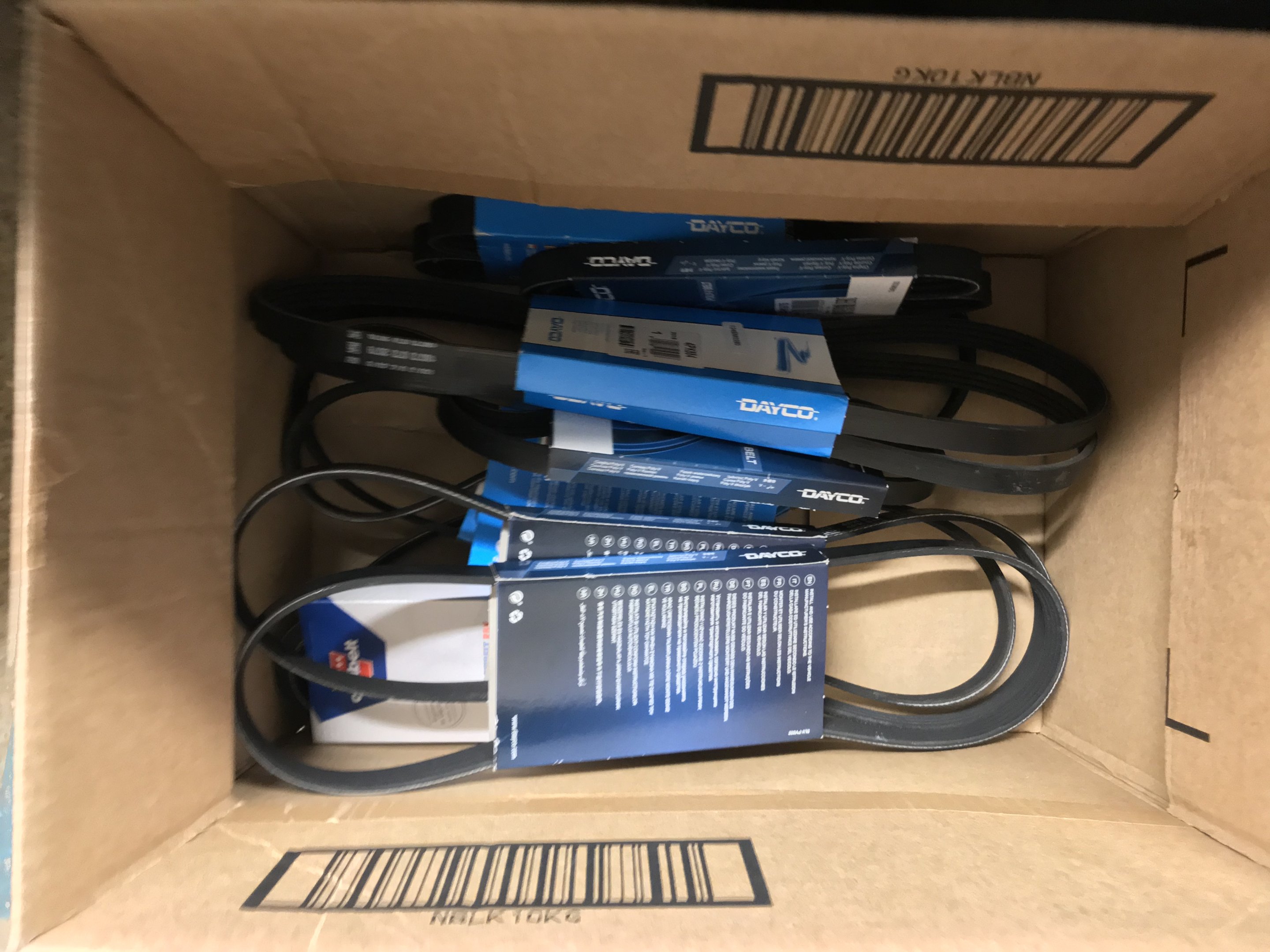

Alternator, 12v feed in and mount fitted just needs a belt and tensioning now. Luckily I have a few to choose from ?
Next on the list is finding somewhere to fit my oil cooler ??‍♂️
Seems to be an issue everywhere I look currently. Any ideas welcome ? as I’m currently thinking of chopping the front panel like I did on my CUP shell or getting a small cooler.

Looking good. The oil cooler is a tricky one. Although I've got the smaller PMS radiator, mine fitted to the side which still gave it good airflow.

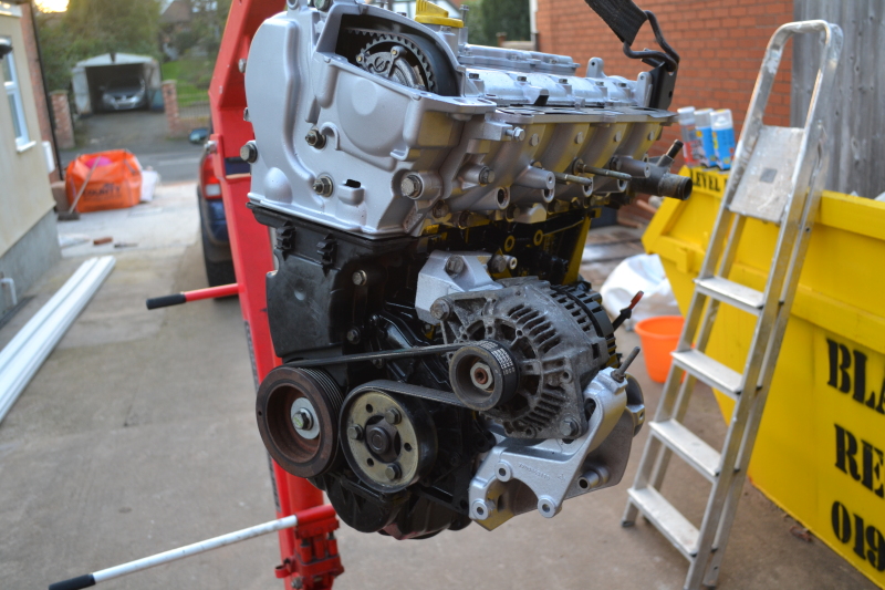

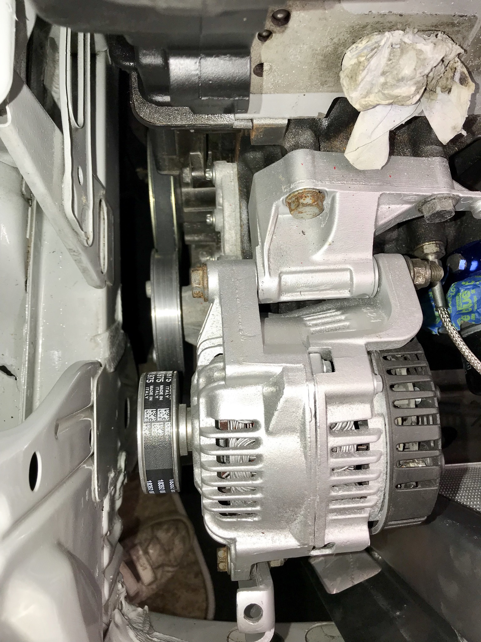

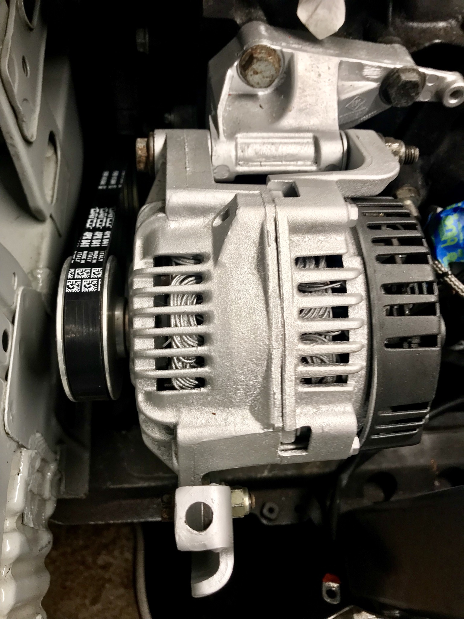

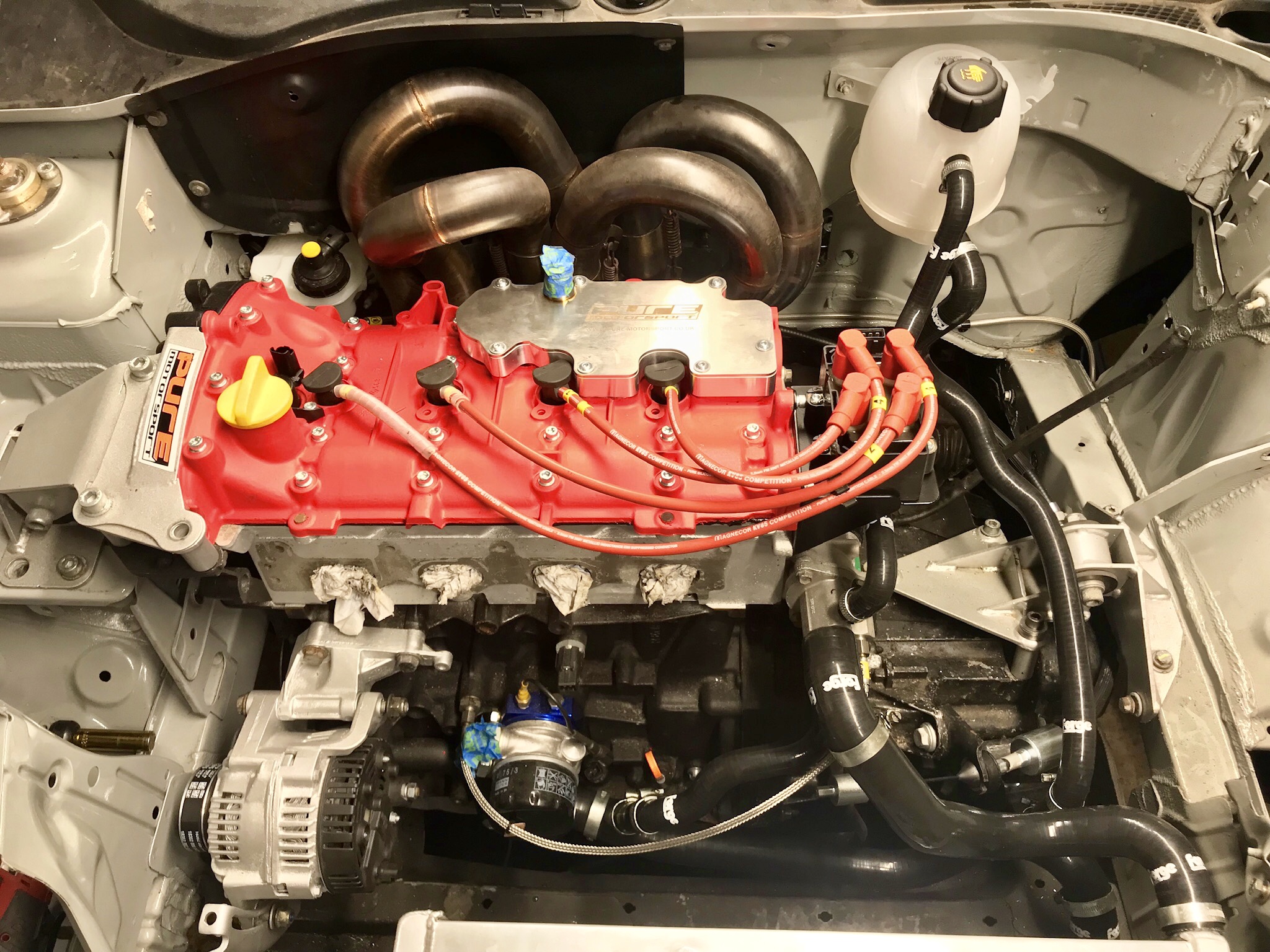

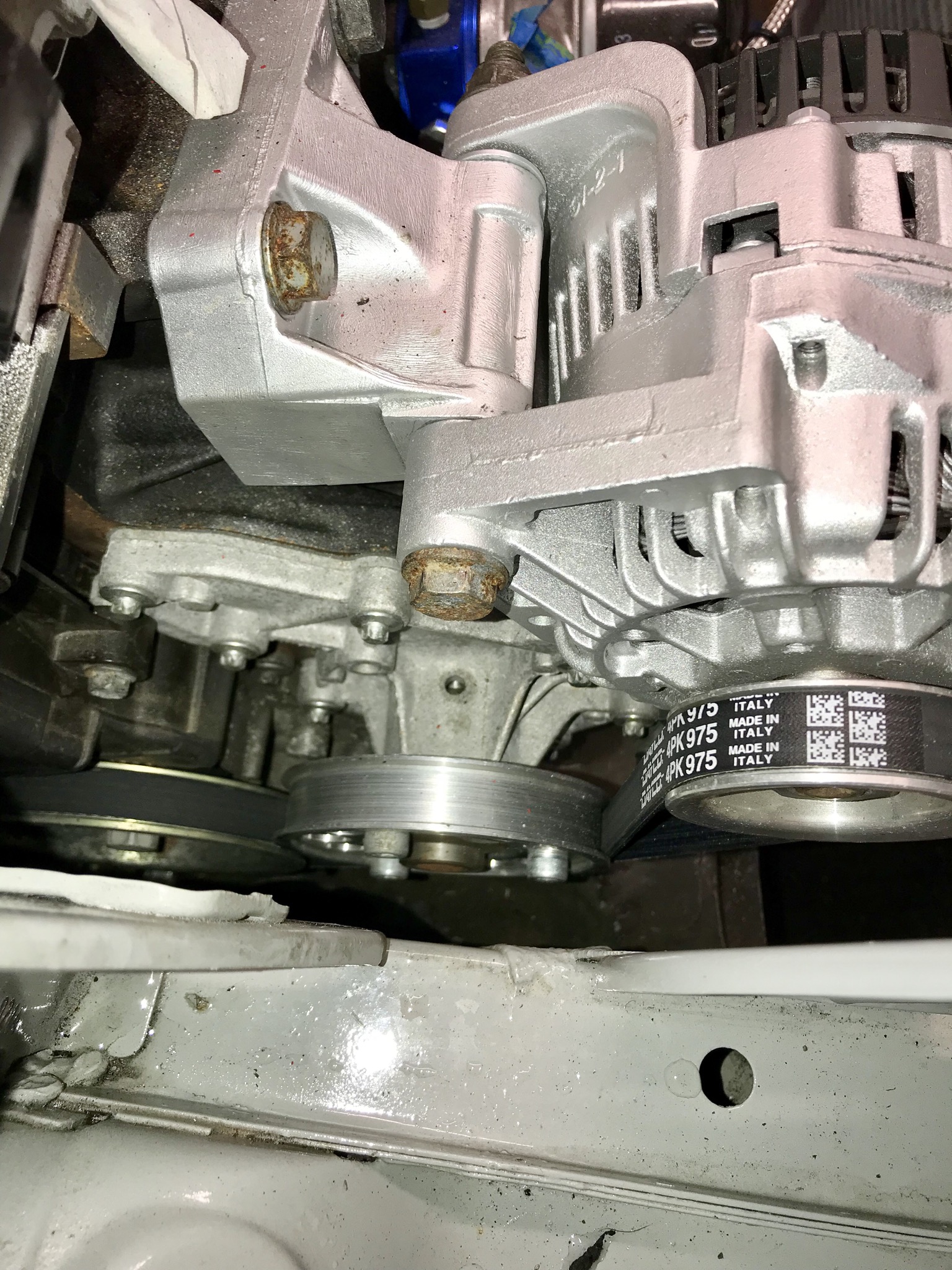

Is that belt running just the alternator and water pump? If so what size was it?
Do you have a lower pulley that we can't see ? Because that lower part of the belt looks like its hitting the water pump.
Yeah is just the water pump and alternator using a cup racer style bracket.
Didn’t look like it was hitting the water pump last night but it was late and now you’ve worried me ?
I’ll check tonight and confirm.
R29TJR
  2005 RB 182 Cup
I’ve run the belt wrong ??‍♂️
I’ve gone under the water pump assuming that picture is correct ?
Picture above is correct.
I've been running mine like this for over a year and working well. ? I'll check my thread to confirm the belt I'm running.
  Clio f1 r27

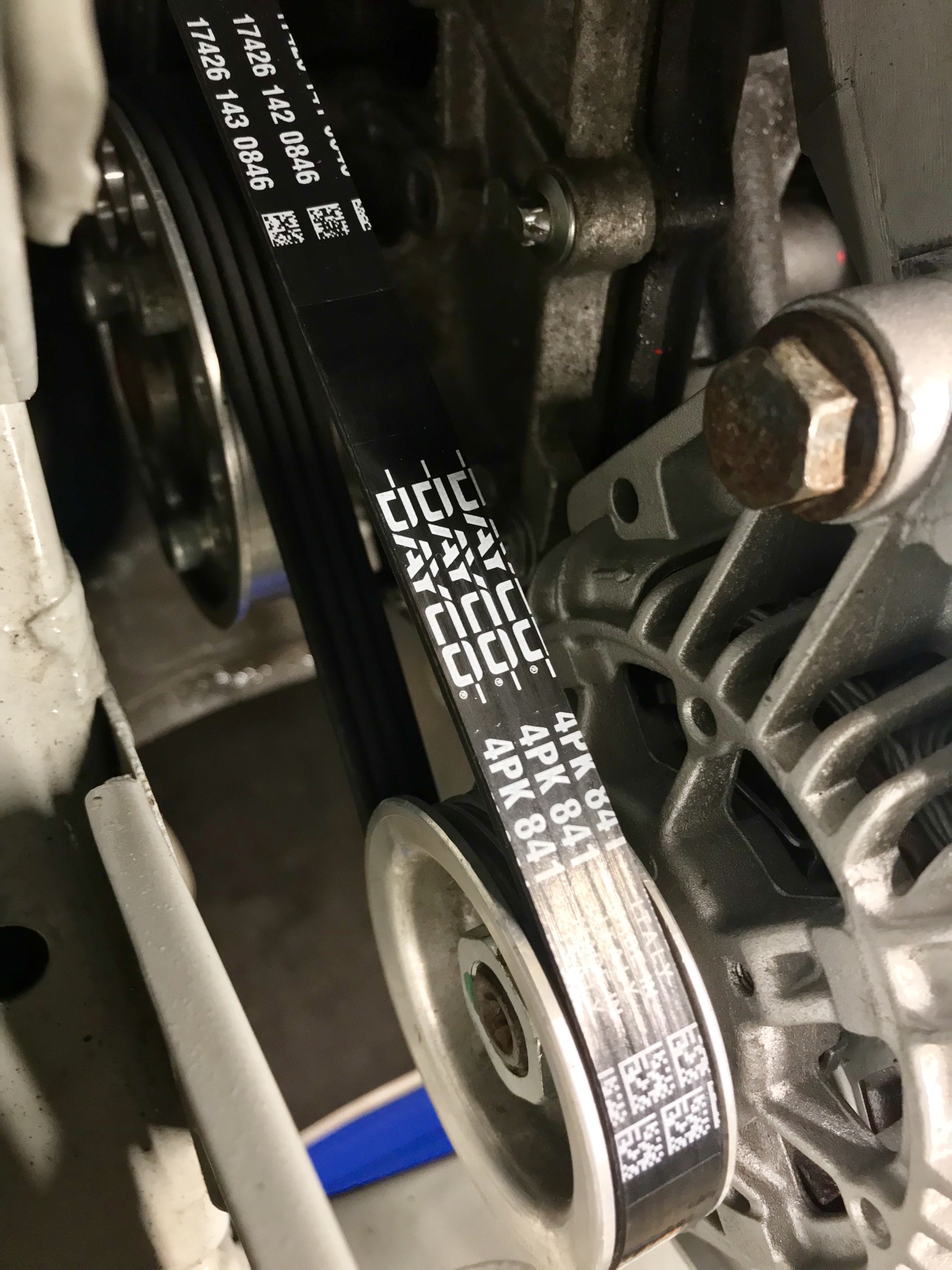

The belt on chambers_rs engine is a 4pk975. Is there going to be that much difference in length running over rather then over the water pump?
Chambers_RS
  Clio 172 Cup&Leon K1
Not a lot but it will probably be slightly shorter
Will be a a tad probably near the 847 figure quoted above.
Think the water pump would be running backwards the way I had it if my mind is work correctly ?

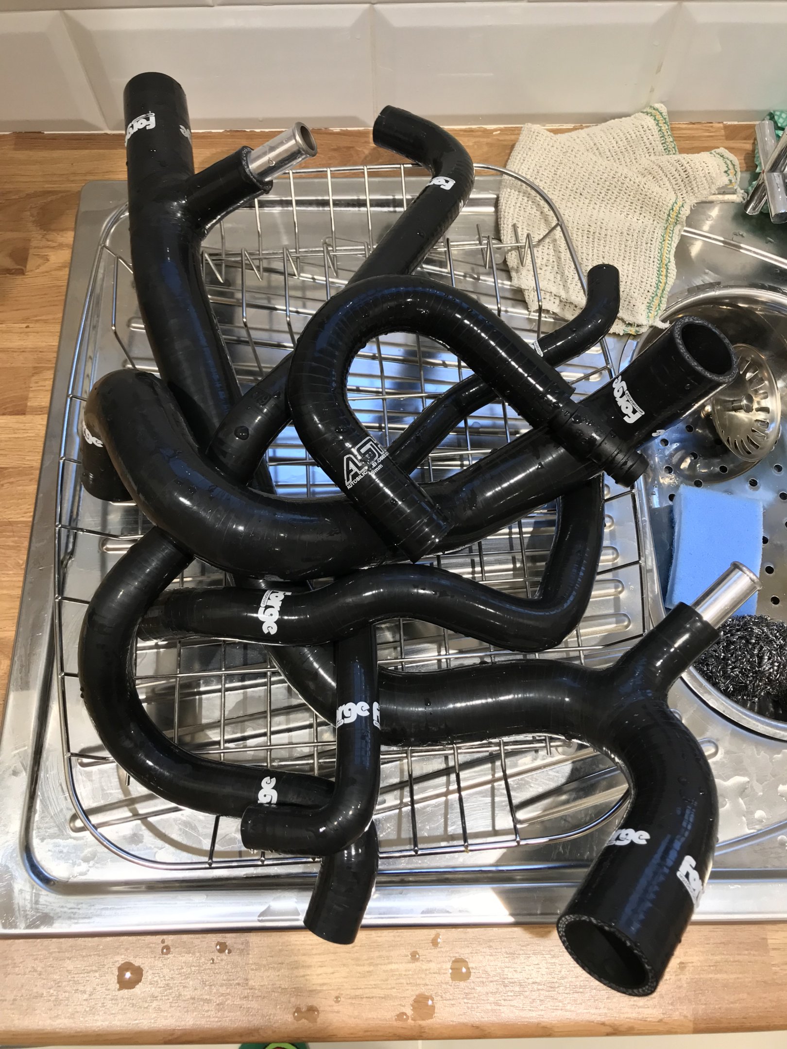

Put the coolant hose on the stop any bits getting in them.
Should have a new belt to fit tonight and started sliding the manifold together.

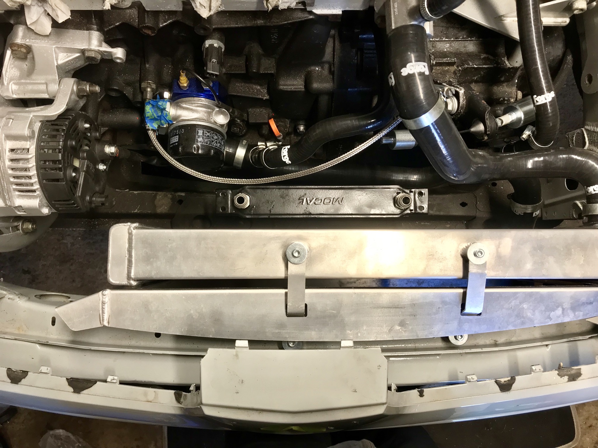

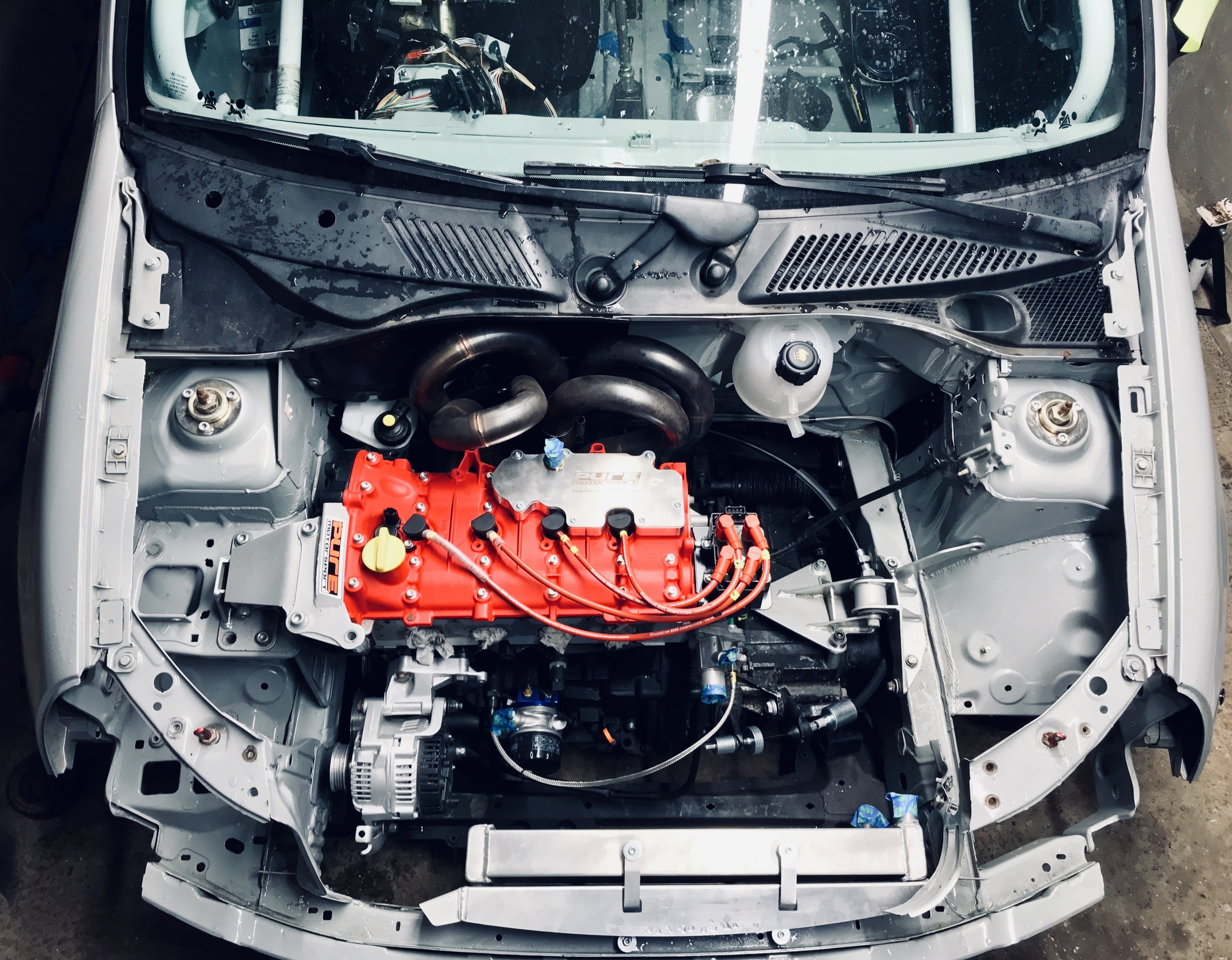

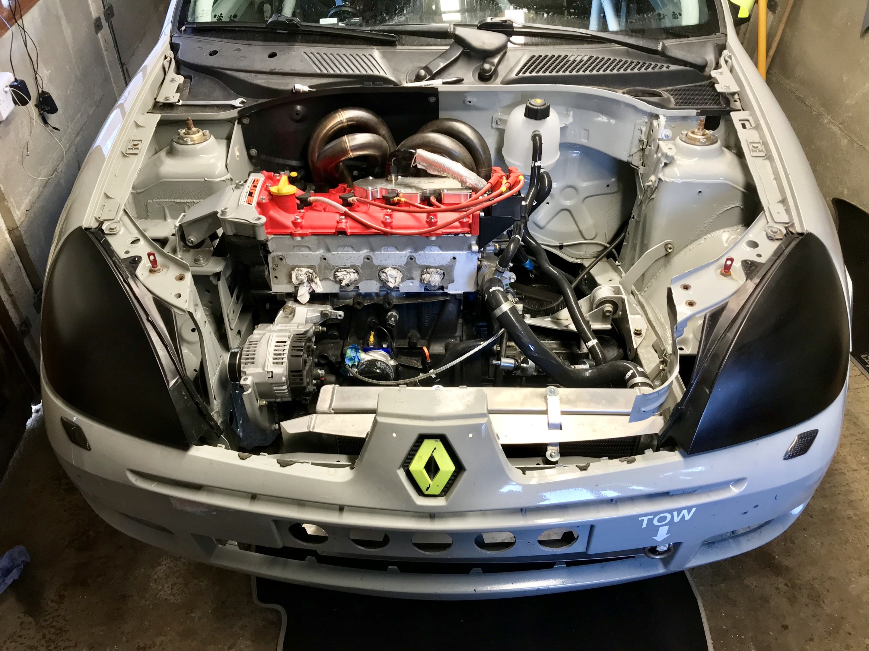

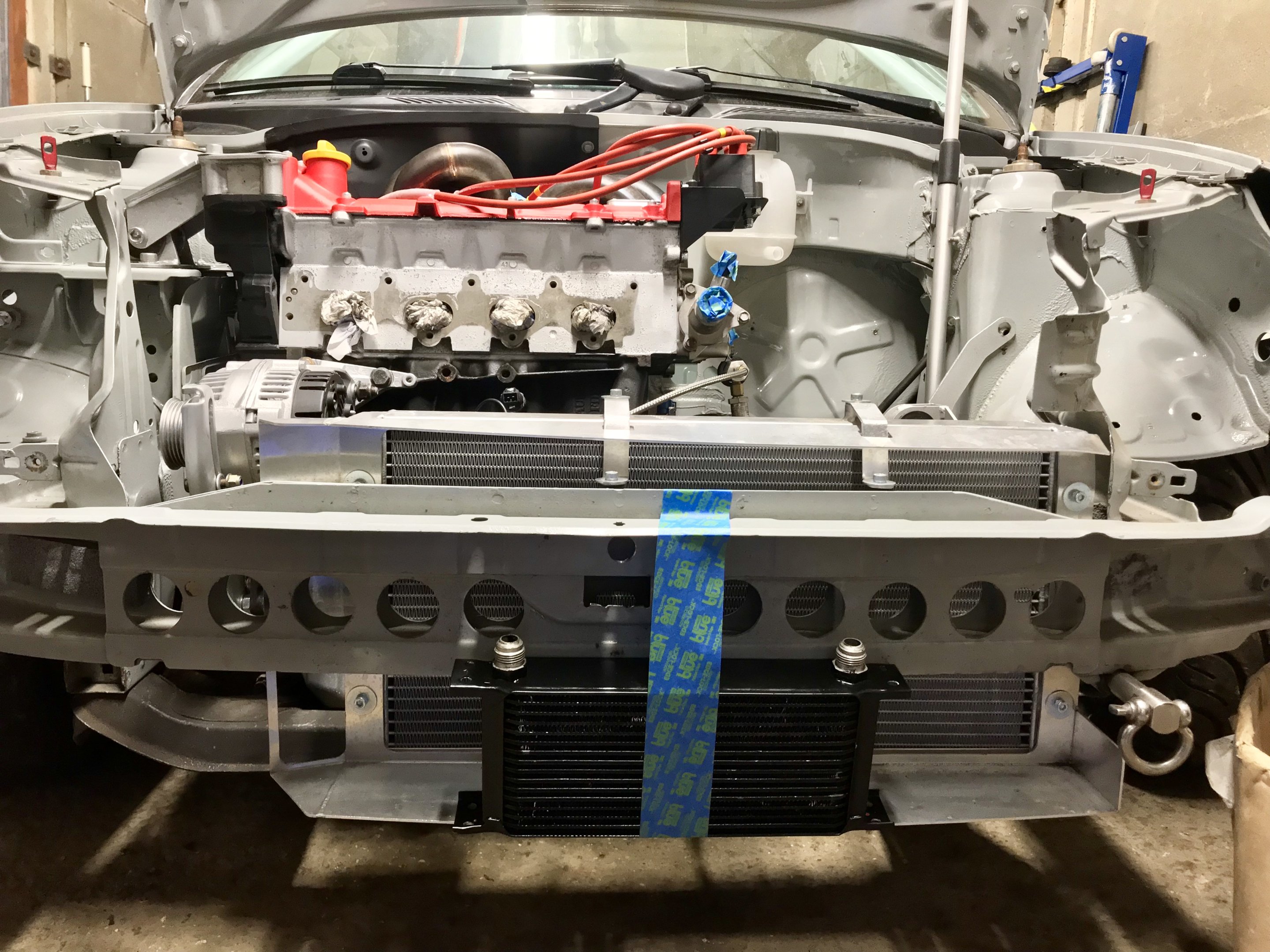

Next on the list was to look at the oil cooler and catch tank.
So decided to get the front end built up, ended up throwing the headlight blanks and bumper on loosely.
Needed to see what space I had to work with, which turns out not a lot.
I’d don’t really wanna have to cut the slam panel like I did on the Cup shell. The only place I can see is mounting it on the subframe behind the rad.
Here
Would make a nice easy fix but would mean I’d need to run a fan on the front of the rad.
Anyone see an issue here I’m missing?
I don’t really wanna spend out on an oil/coolant cooler currently.
I’ve managed to get the catch can mounted using rivnuts nicely.

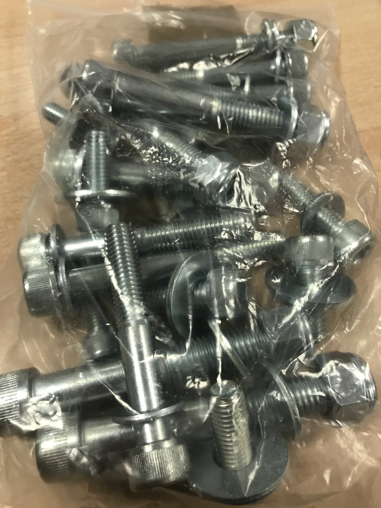

I’ve also ordered new engine mount bolts from PMS so can finialise the position, torque up and tighten the exhaust up ?
I’m enjoying all progress for once even if it is slowly.

The PMS engine mounts make it easier to get the engine out ?

NorthloopCup

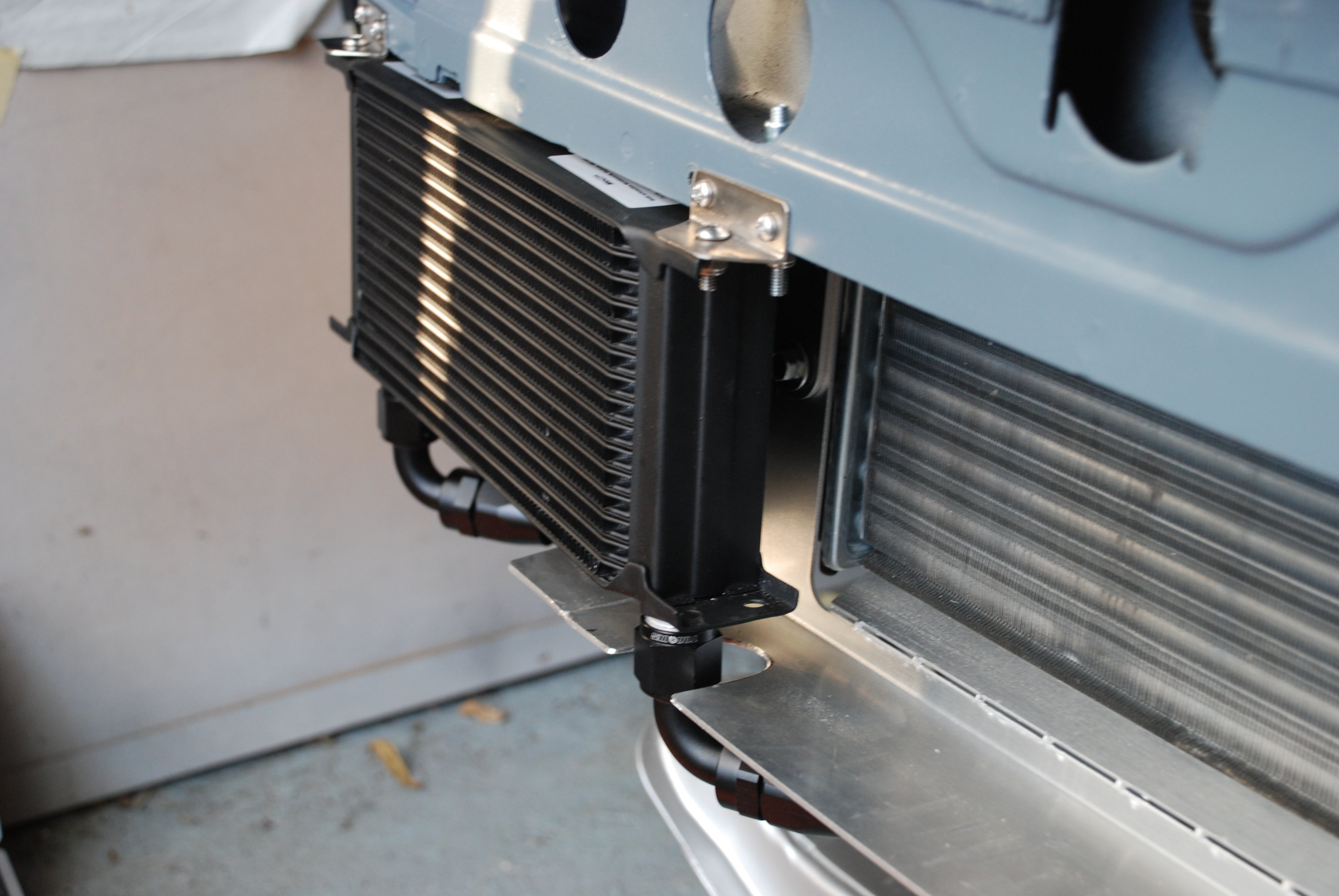

Various ways to fit the oil cooler.
  1. Fit it on its end and vertical in front of the alternator.
  2. Lay it down flat so it’s face down with the tarmac and duct it accordingly. Look at the setup on an F80 M3 if you’re not sure what I’m on about.
  3. Mount it behind the bumper and make various holes to allow air flow through. (Wouldn’t be my preferred method tbh)
  4. Laminova.
With any of those solutions, except the laminova, getting the air through and out is the most important thing. Stale air will massively reduce effectiveness.

Cheers, I’ve got a place to mount now but will eventually move to a Laminova cooler I reckon as reading up today seem to be a better way of cooling and controlling the cooling.

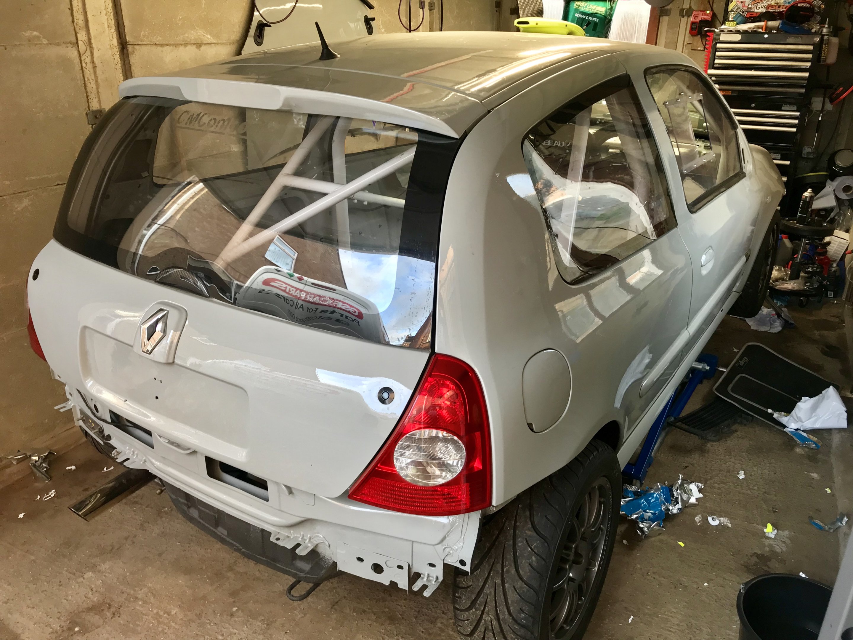

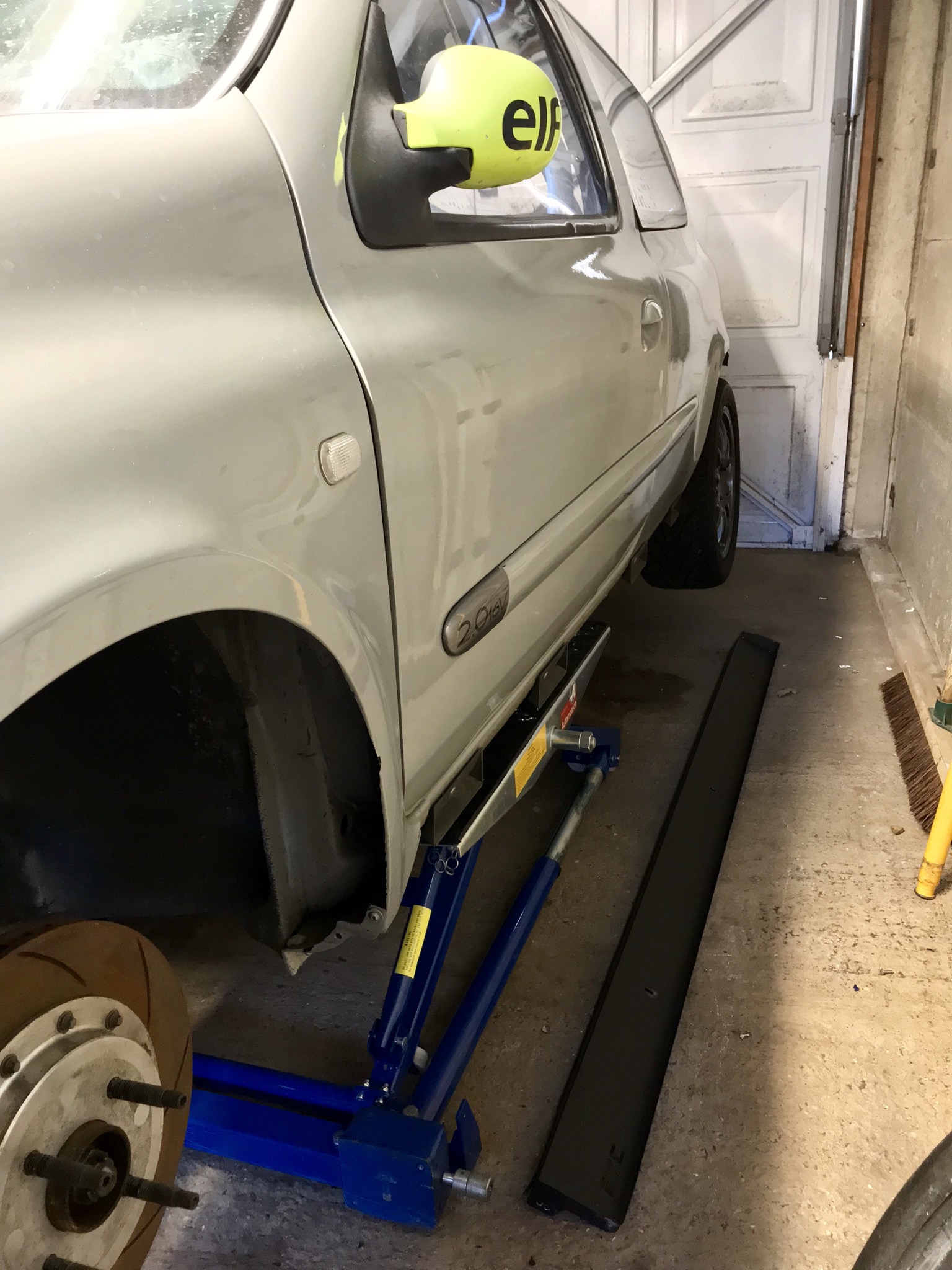

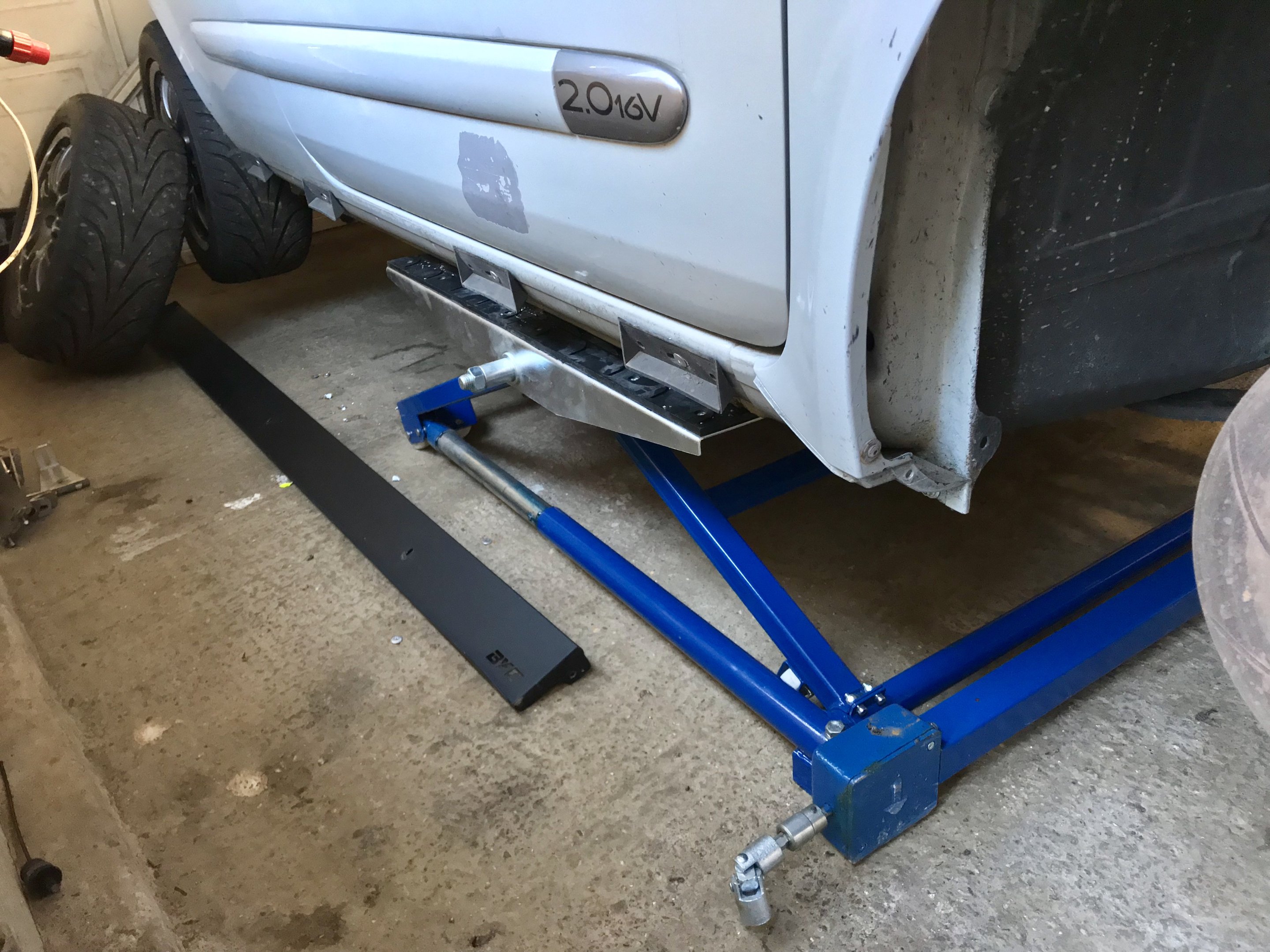

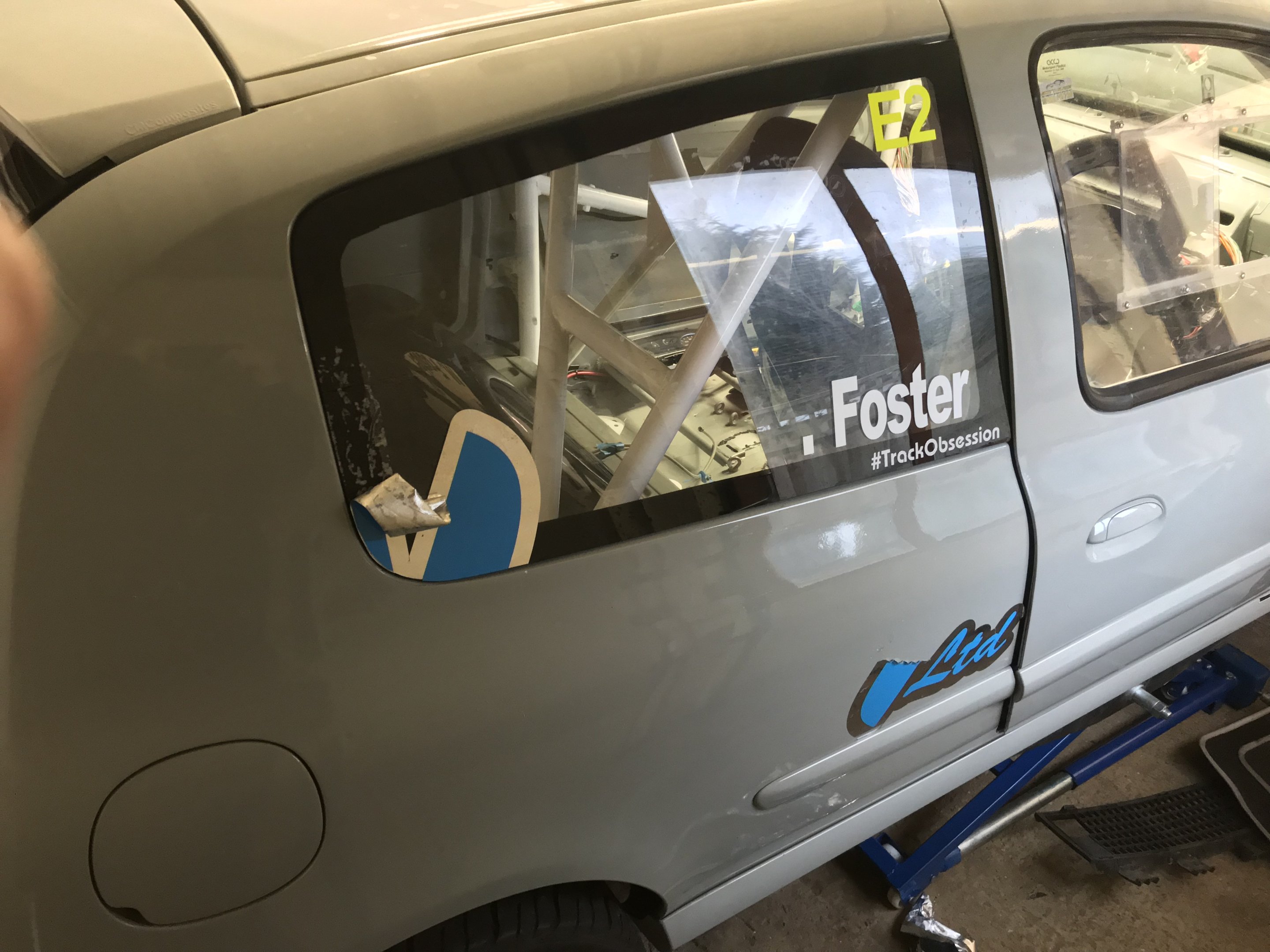

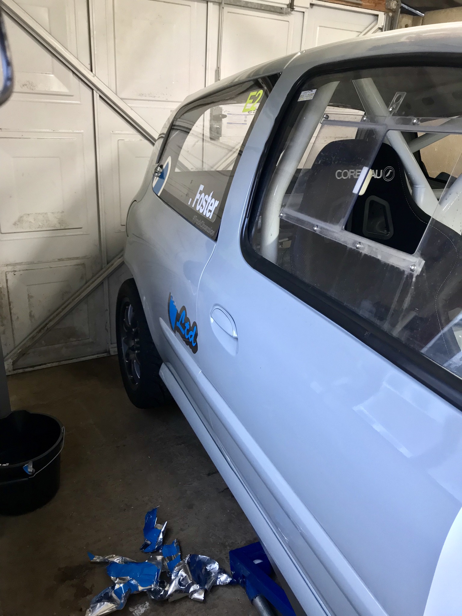

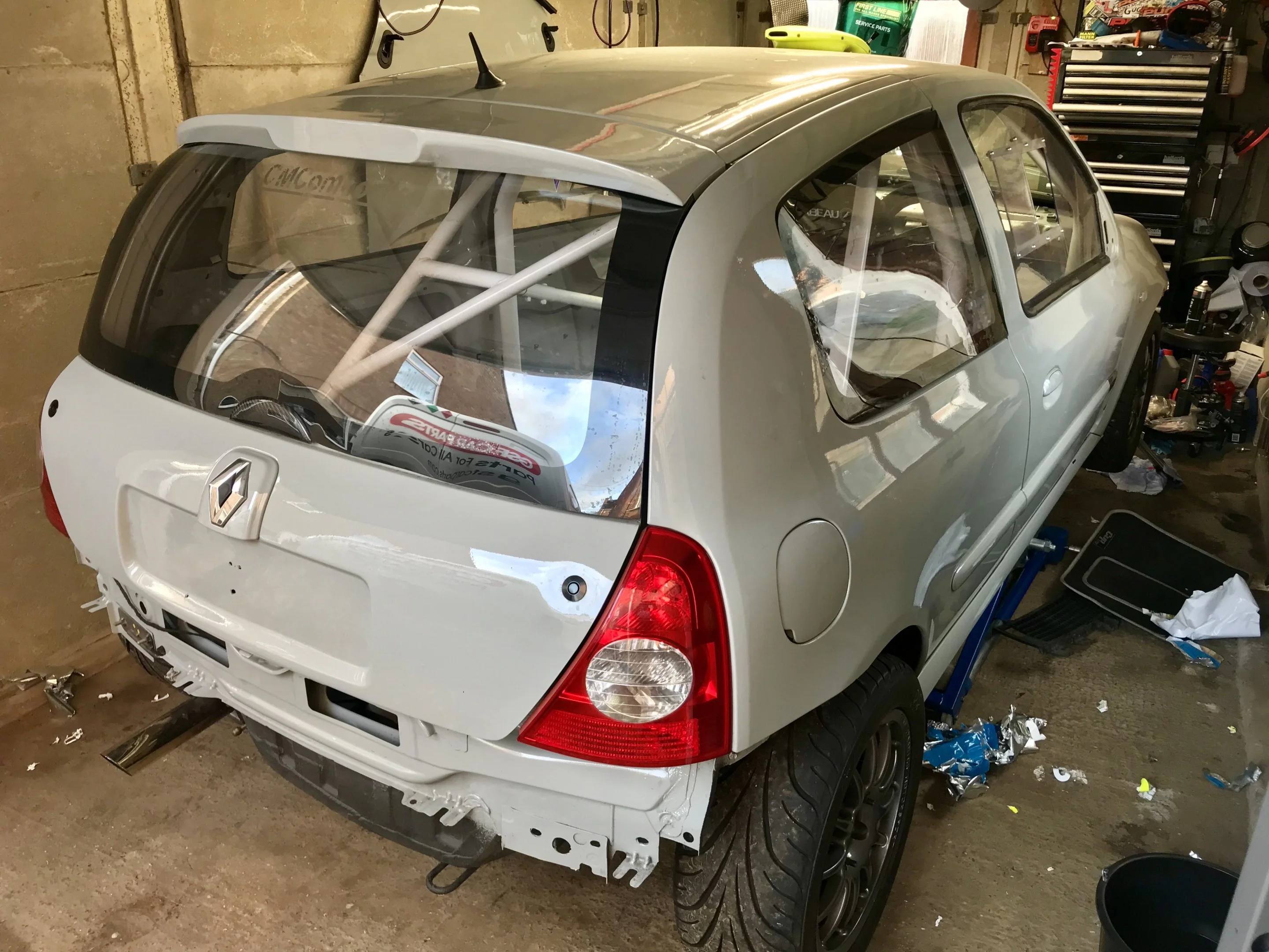

Removed the side skirts this morning to start offering up the BYC skirts.

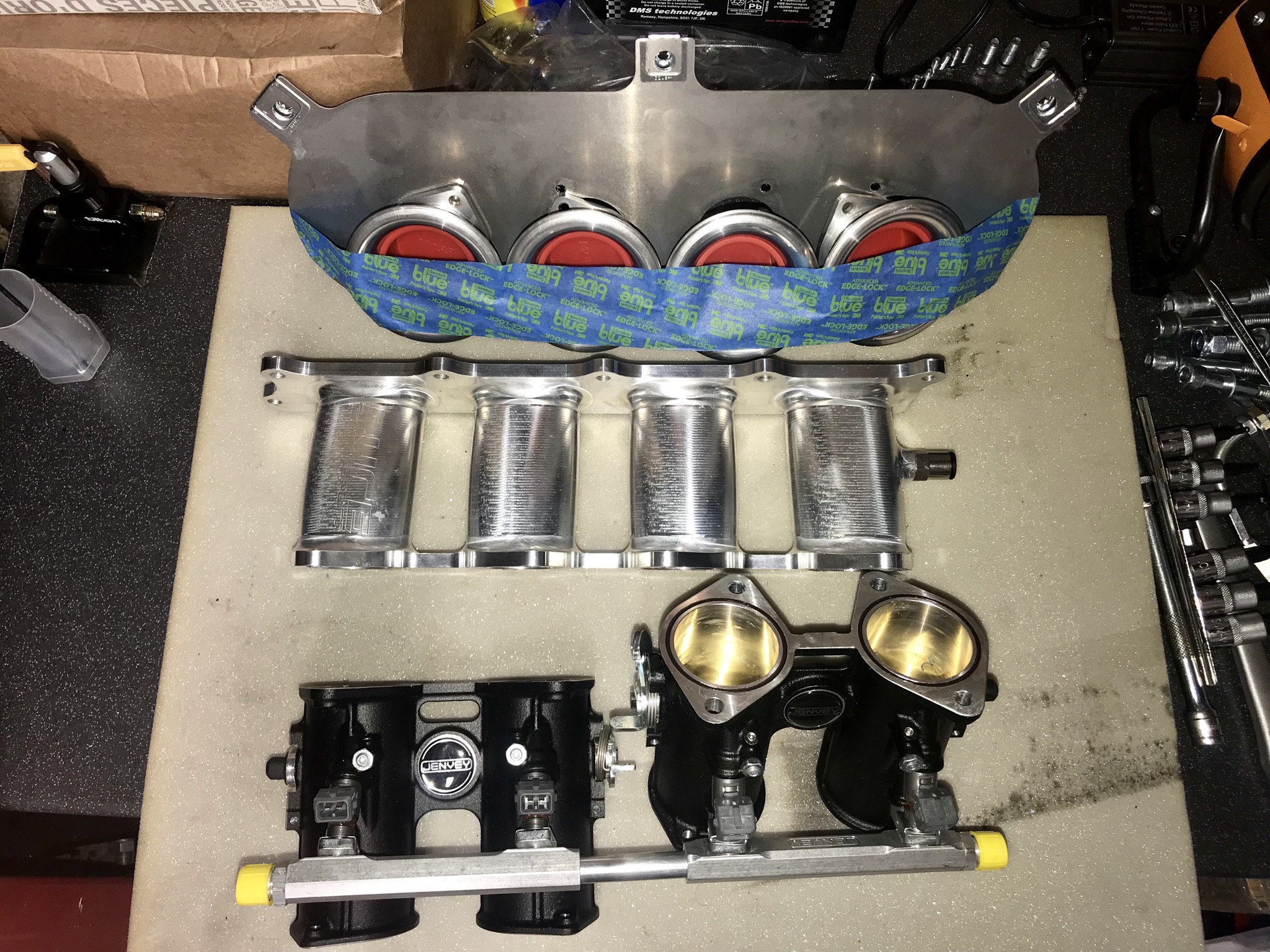

Also had a delivery of ITB to head seals and exhaust springs from PMS so I can finish off the manifold and fit ITBs ?
Need to order new subframe to chassis bolts, then fit driveshafts and torque the front suspension up to finish off the front end.
