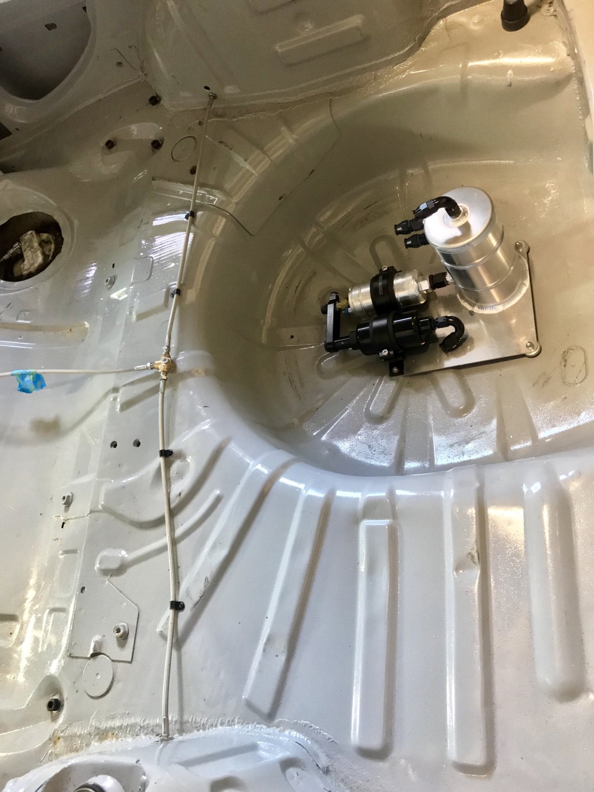

If it's going in the wheel well, can you make a removable cover?
I'd feed from the tank into the wheel well (bulkhead connector in the front/side of the wheel well). For the line(s) to the engine, you could just use a bulkhead connector to come through your wheel well cover. The cover could be two piece - one fixed and then an access panel for maintenance.

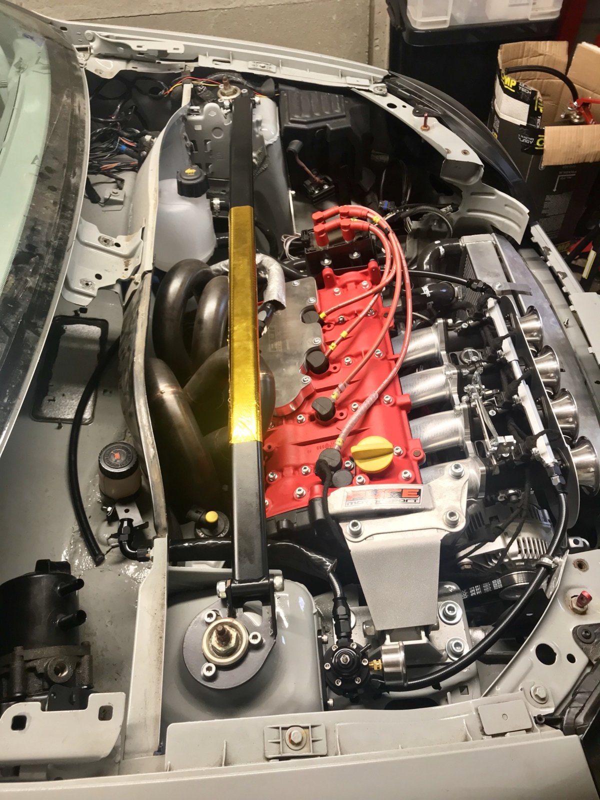

Haha seems the most logical place for the FPR ??
Thanks bud.

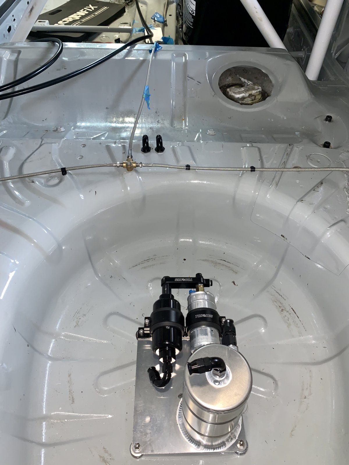

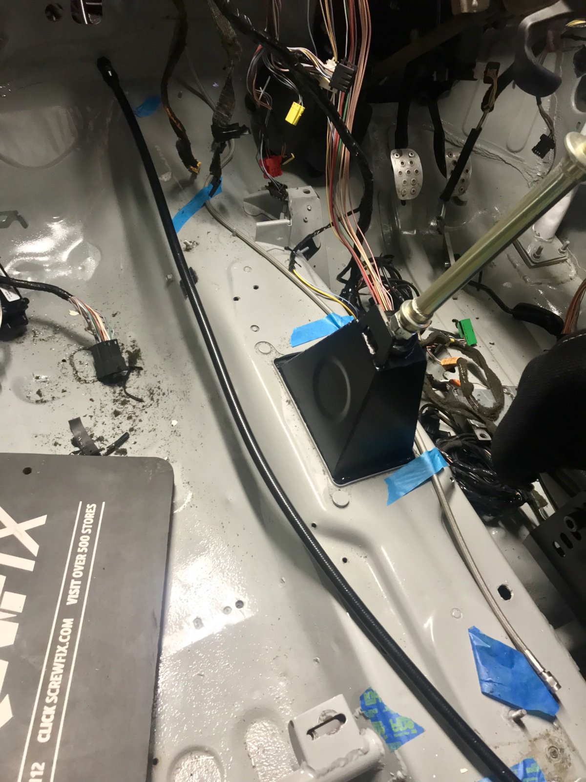

Where does your feed run after the Bosch pump? I see you’ve drilled and fed it through the wheel well but running the fuel hose through the car by handbrake etc.
Have you gone over the tank under the car and back in behind the front seats?
Yeah in the wheel well.
This is defo my plan to make a cover etc just want to do it once haha and not use loads of fittings as it soon adds up.

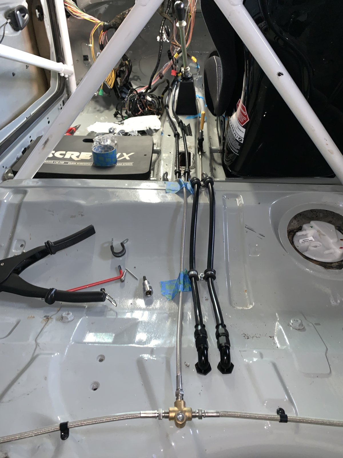

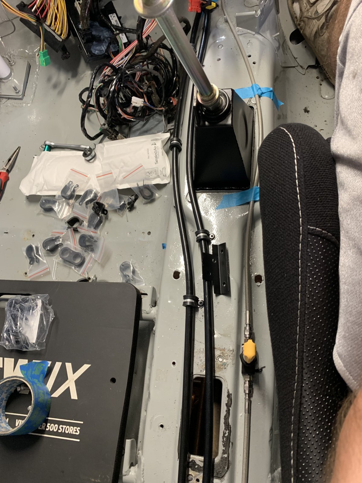

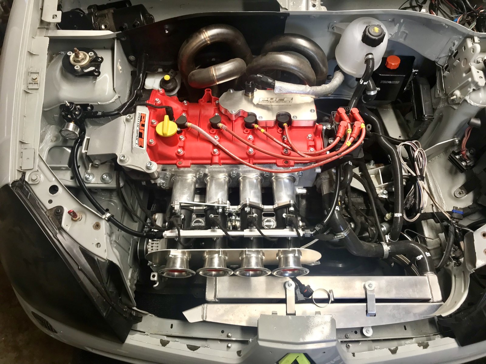

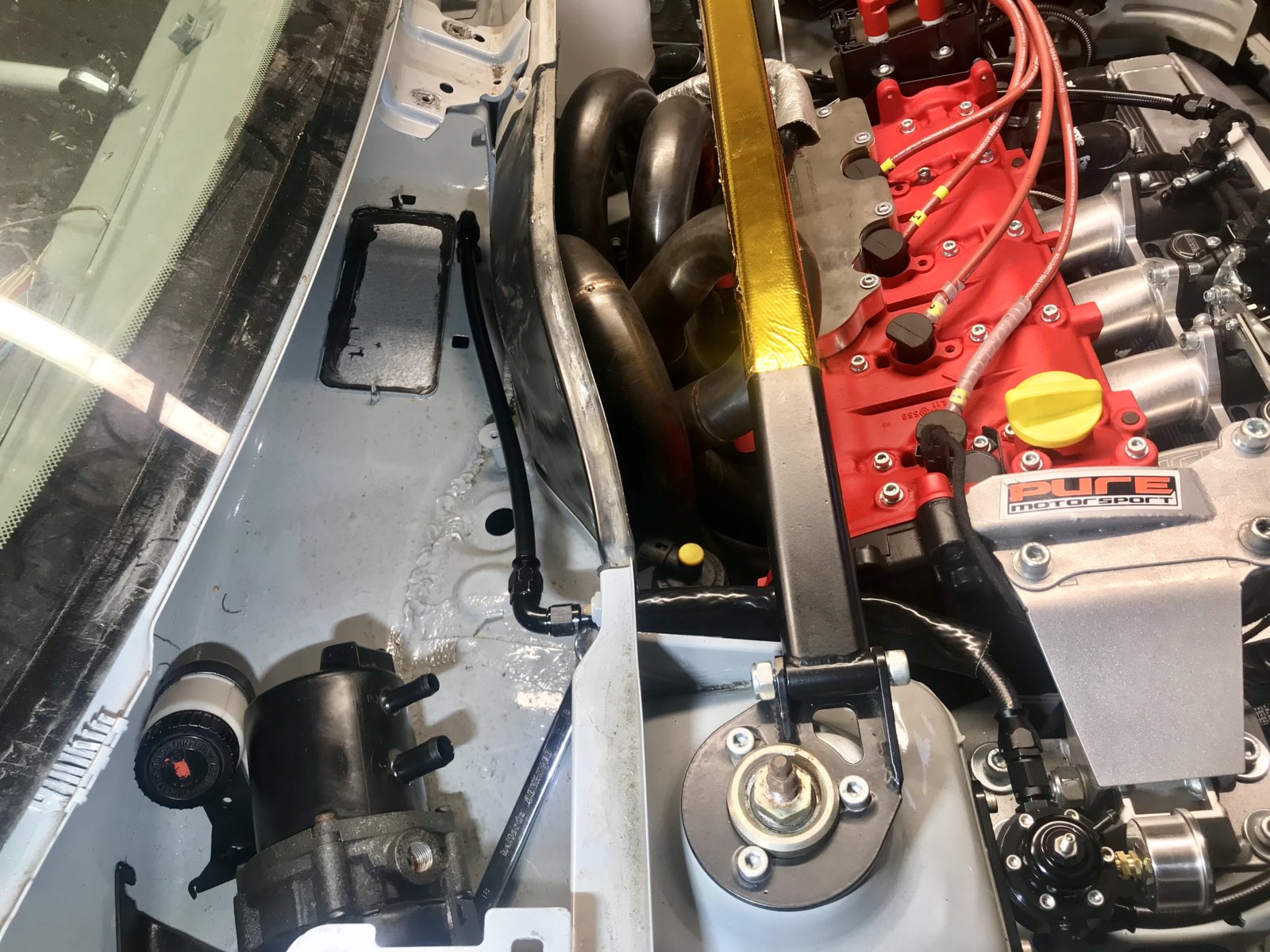

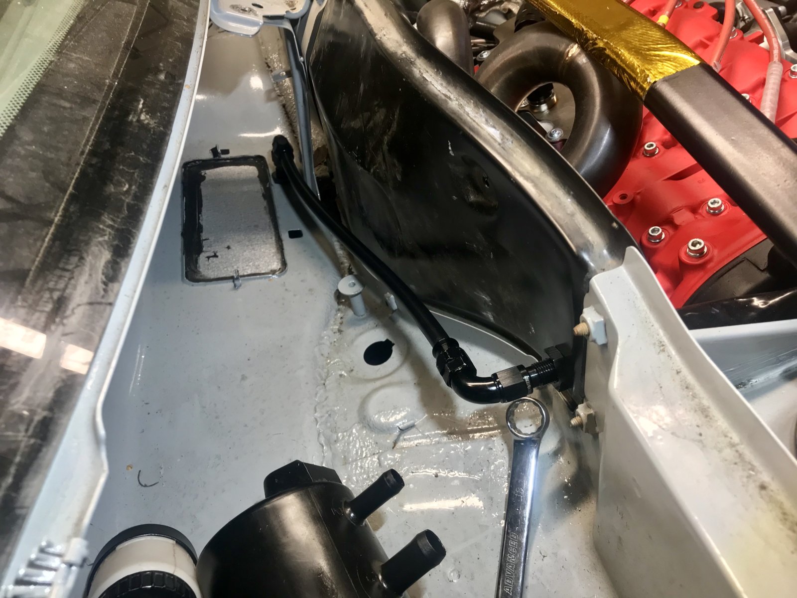

Slowly chipping away at the fuel lines
The engine bay is done. Bulk heads fitted and pipes pclipped to stay secure.
Need to do the fuel hose through the scuttle panel, then it’s just bulk head to swirl pot left. Need to decide how I’m running them into the wheel well tho, still.

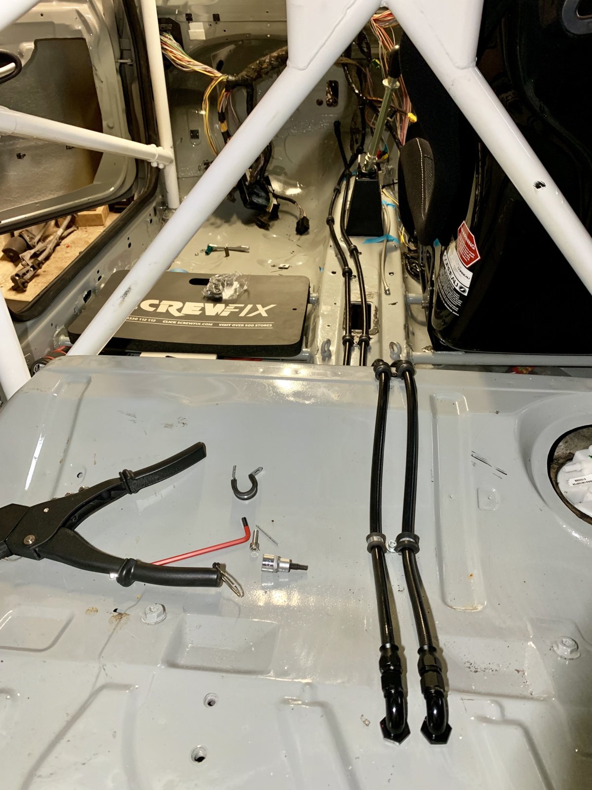

Swirl pot etc is mount and I’ve pclipped the rear brake hoses down.

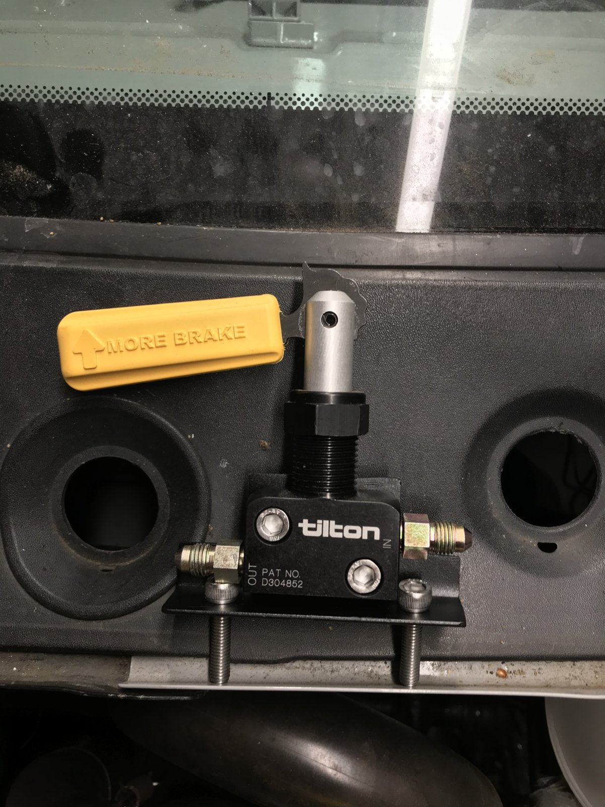

I’ve made the bracket for the bias valve

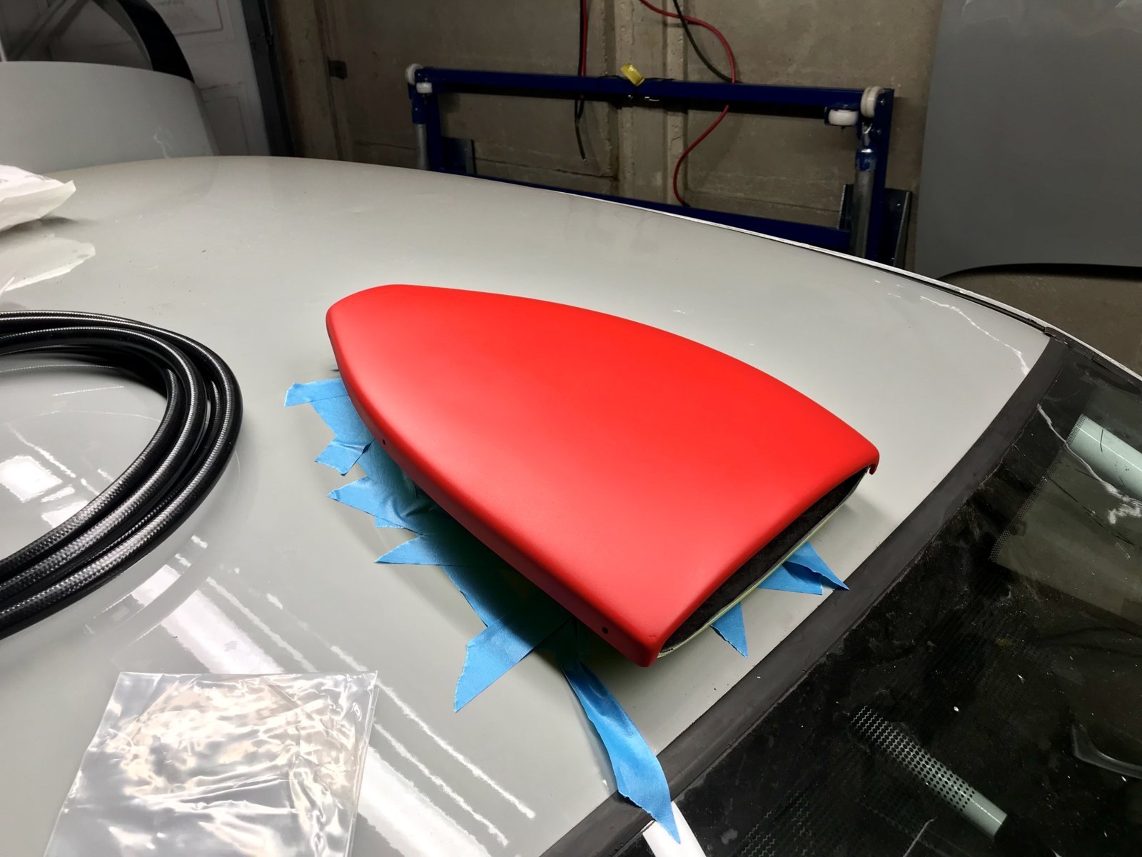

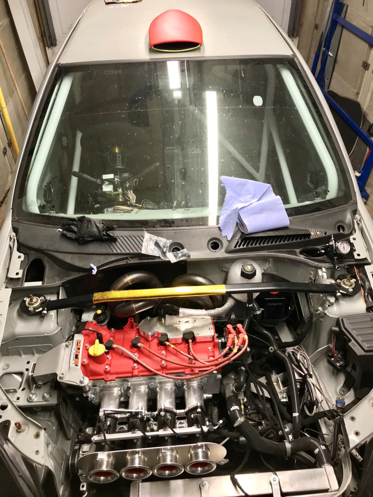

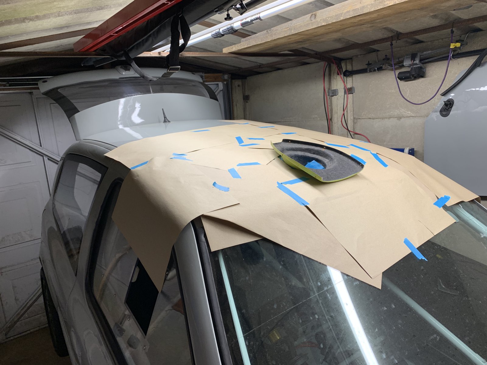

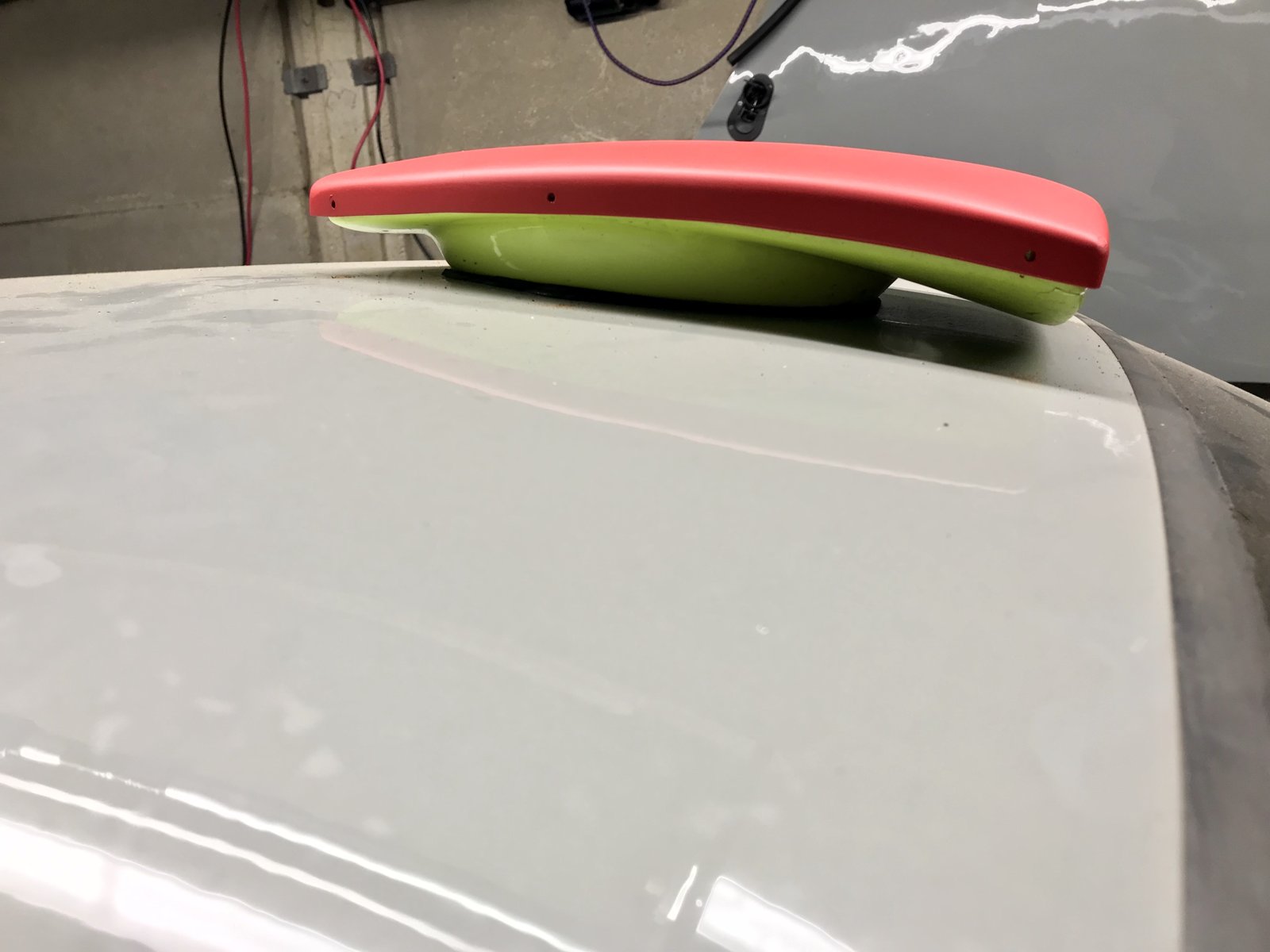

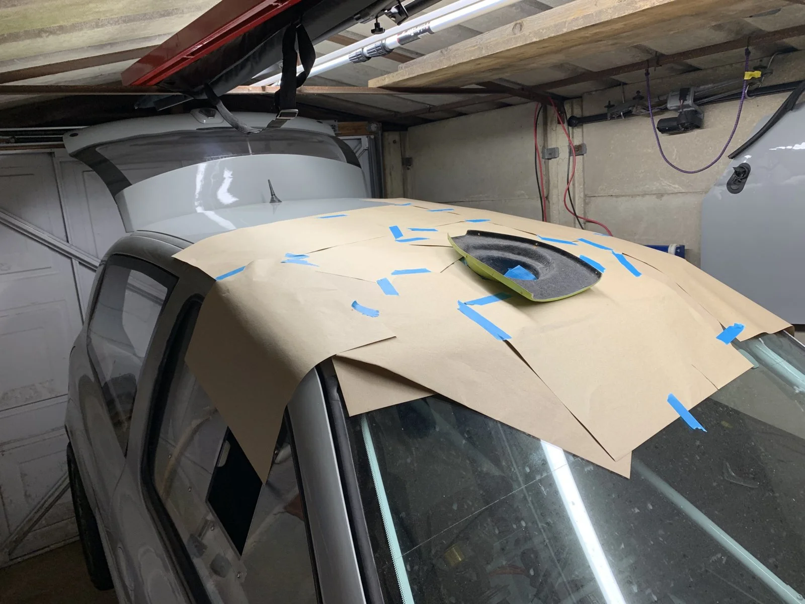

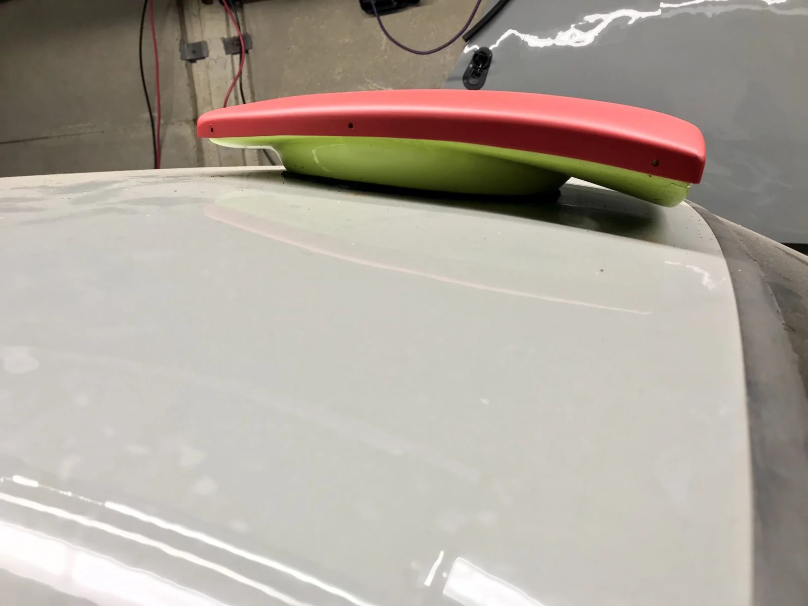

And as the hi-vis yellow has faded badly, I thought I’d try and make it more my own by painting it Matt red, after sanding and filling a few sections.
Just need to get some newspaper or something to mask the car off to paint the underneath of it. Inside can stay yellow lol
Looks good with the bonnet off tho matching the rocker cover, and mirrors will go the same I reckon.

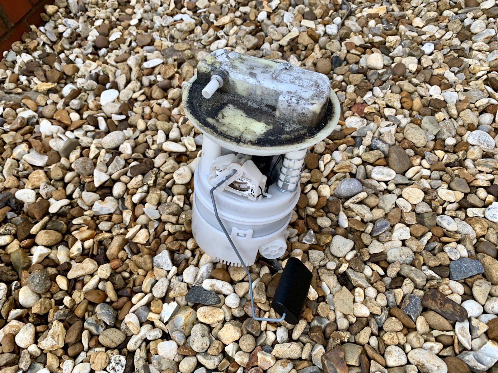

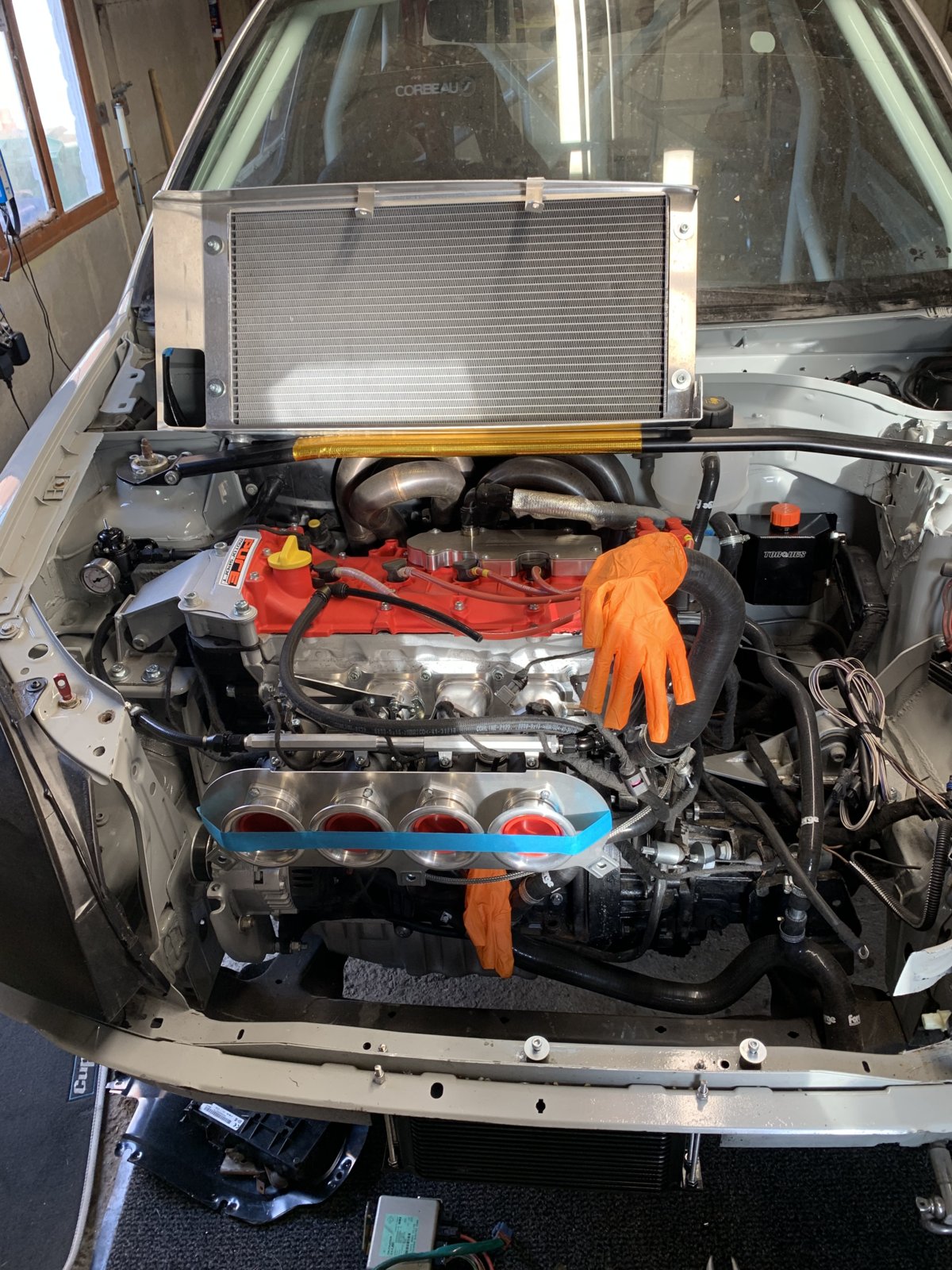

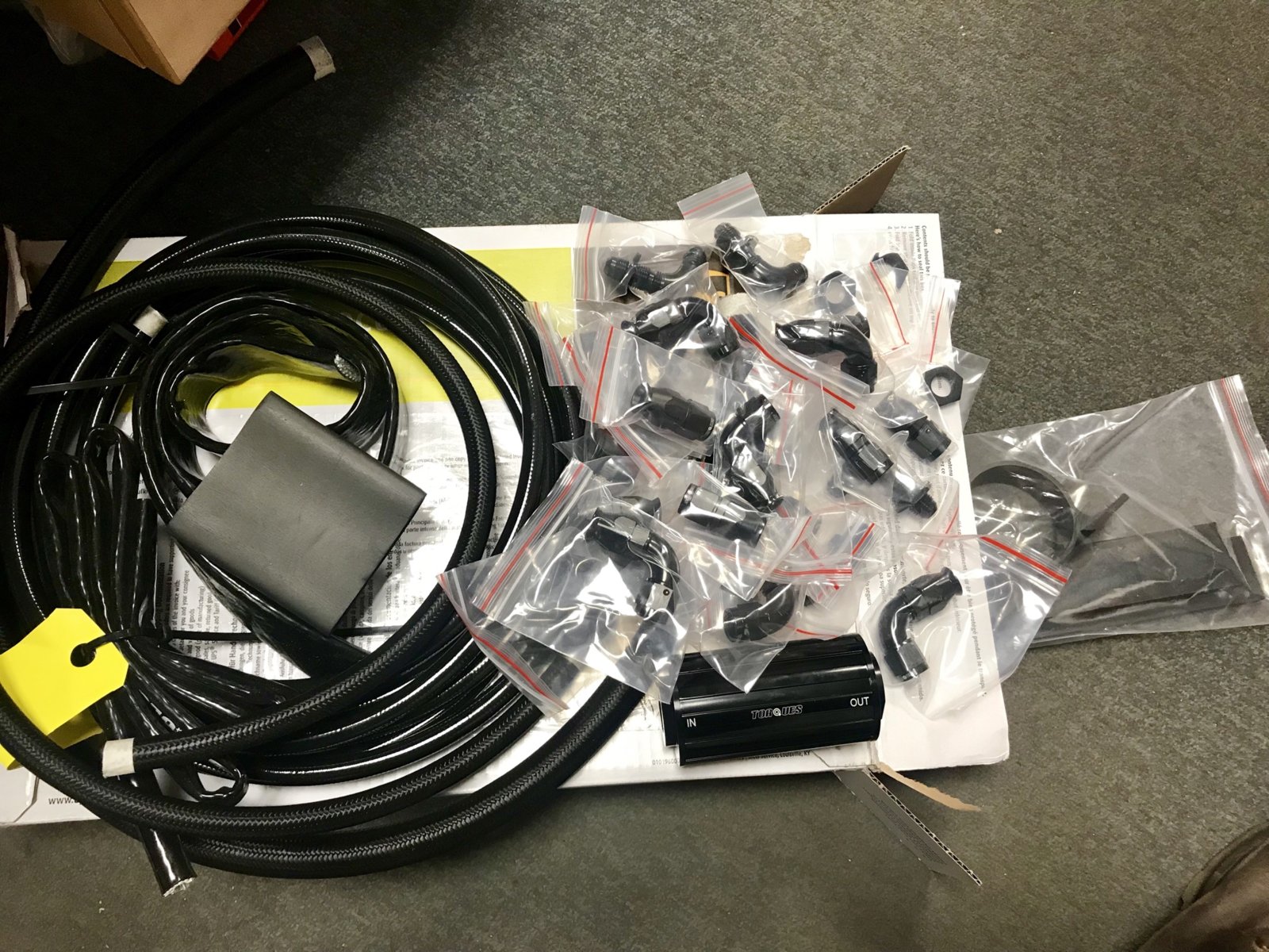

Finally got the fuel pump out the tank
That’s all so far, ordered a few little bits here and there to tie a few little jobs ticked off and decided on another change with the bits on route to me.
Currently finishing the fuel and brake lines, need to research and decide on wiring and everything that goes with that ??‍♂️

Pinned down the fuel lines tonight. Slowly making progress. Trying to get a bit done each night.

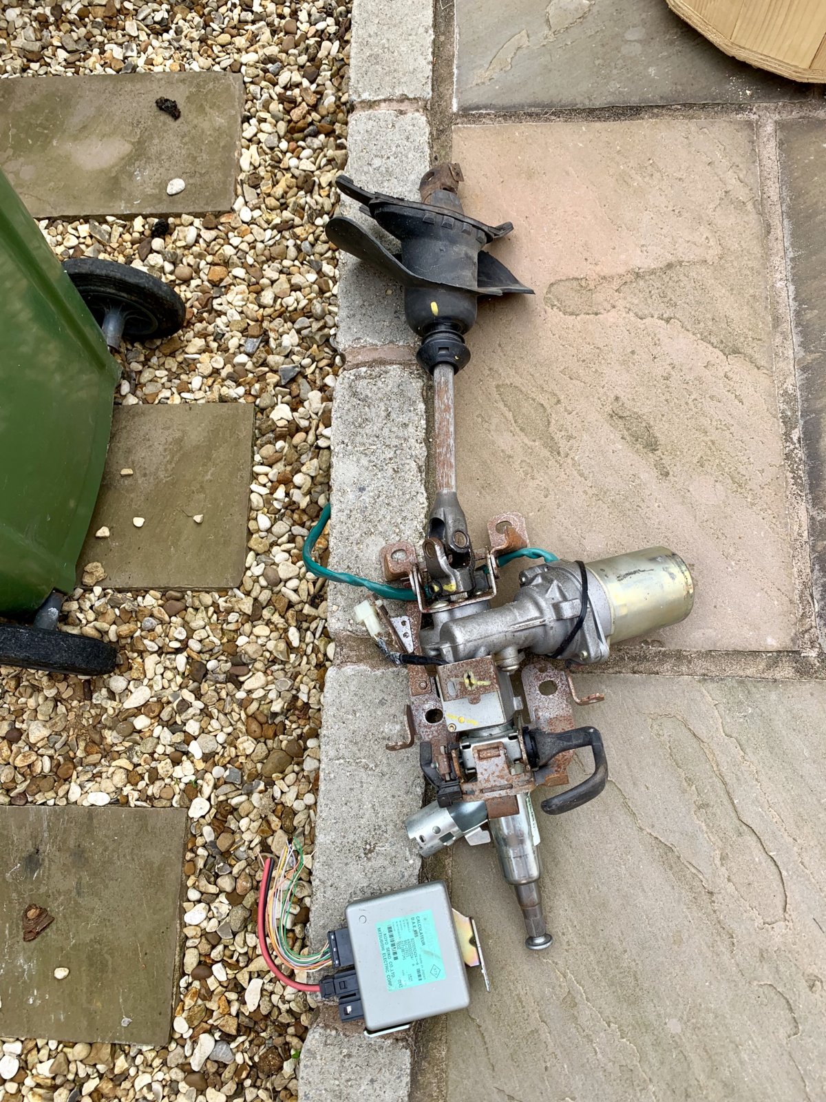

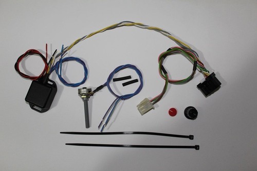

Also made a decision that if we’re going racing that the manual rack might be to much hard work. It’s fine in track days as there’s plenty of time to think about what your doing and plan each corner, but I feel racing maybe a different ball game. Even being the quick rack from PMS I feel it might be a hinderance so ordered a EPAS column.
What else do I need?

Do you run EPAS?

Brake lines and bias valve positions sorted, just need pinning down.
And next
One step forward and two back as always ?

Looking good! I have the fuel and brake lines to do in my car next (twingo rs) so it's good to see other people's.
What's the advantages of epas for you Clio guys and what do the controllers do? Just the twingo has epas
Removes one more thing which can fail and f**k up your life. No more leaks either. More access for working under the bonnet. Less weight in the bay less strain on the aux belt (if those things count).
Then you can manually adjust how much assistance you like when driving. For example you might want full assistance when maneuvering around but you might want minimal when on a track.
My car now feels exactly how I remember it before I had Epas. But I have the option to make the steering lighter or heavier if needed. Very worthy upgrade if you ask me.
Or you just grow a bit of chest hair, and be a man, and drive without assistance. ? Just kidding, but it does save the most weight, and gives the most direct feel.
NorthloopCup
Virtually nothing in it! Although the column is heavier, it’s offset by the pump, hoses, reservoir and fluid.
I think I worked it out to being about 100grams lighter!
Technically though, the weight is higher with the column in the position it’s in compared to the pump/hoses. But that’s seriously splitting hairs!! ???
