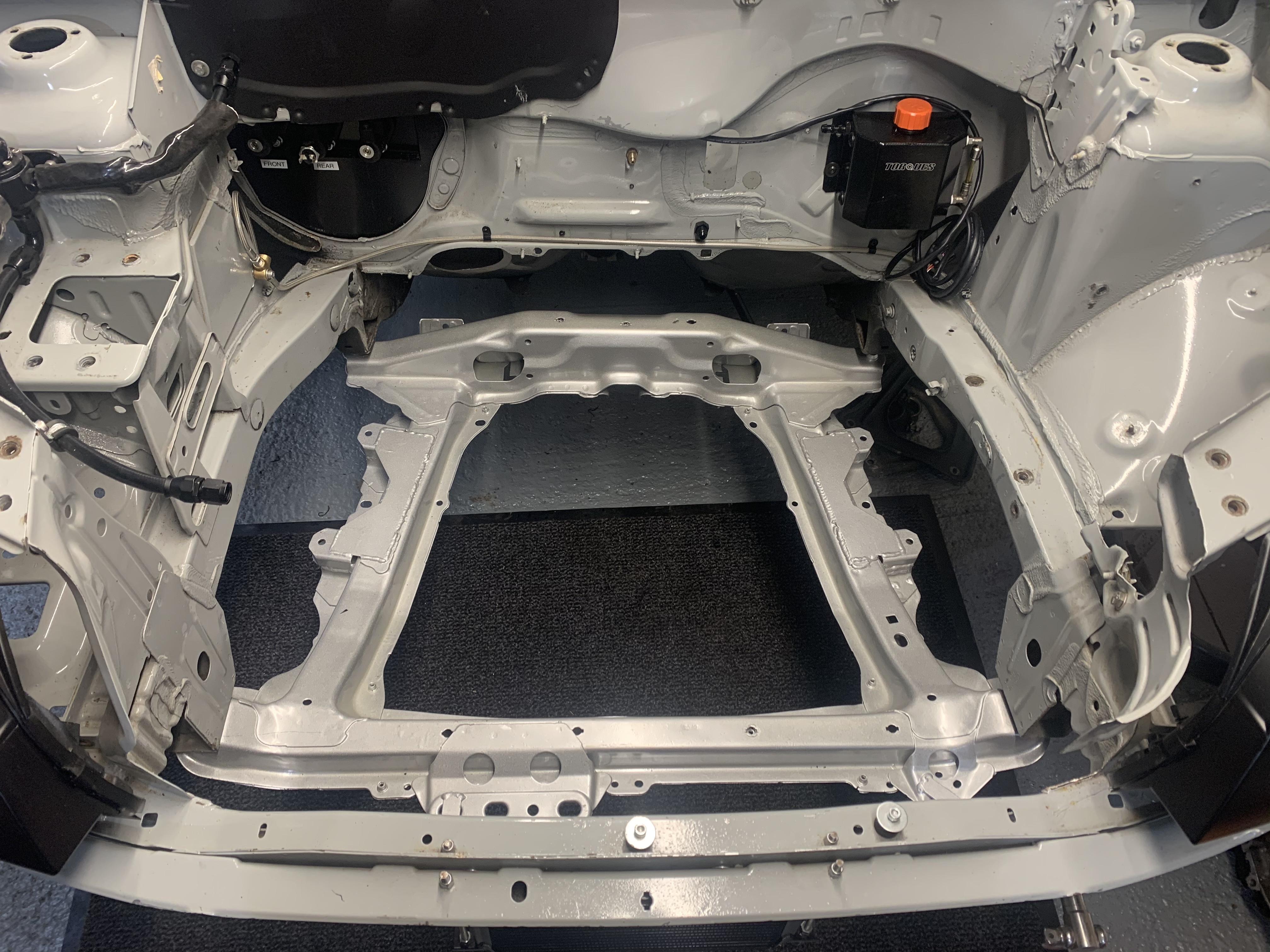

Not throwing it in the hole stock 👌🏻

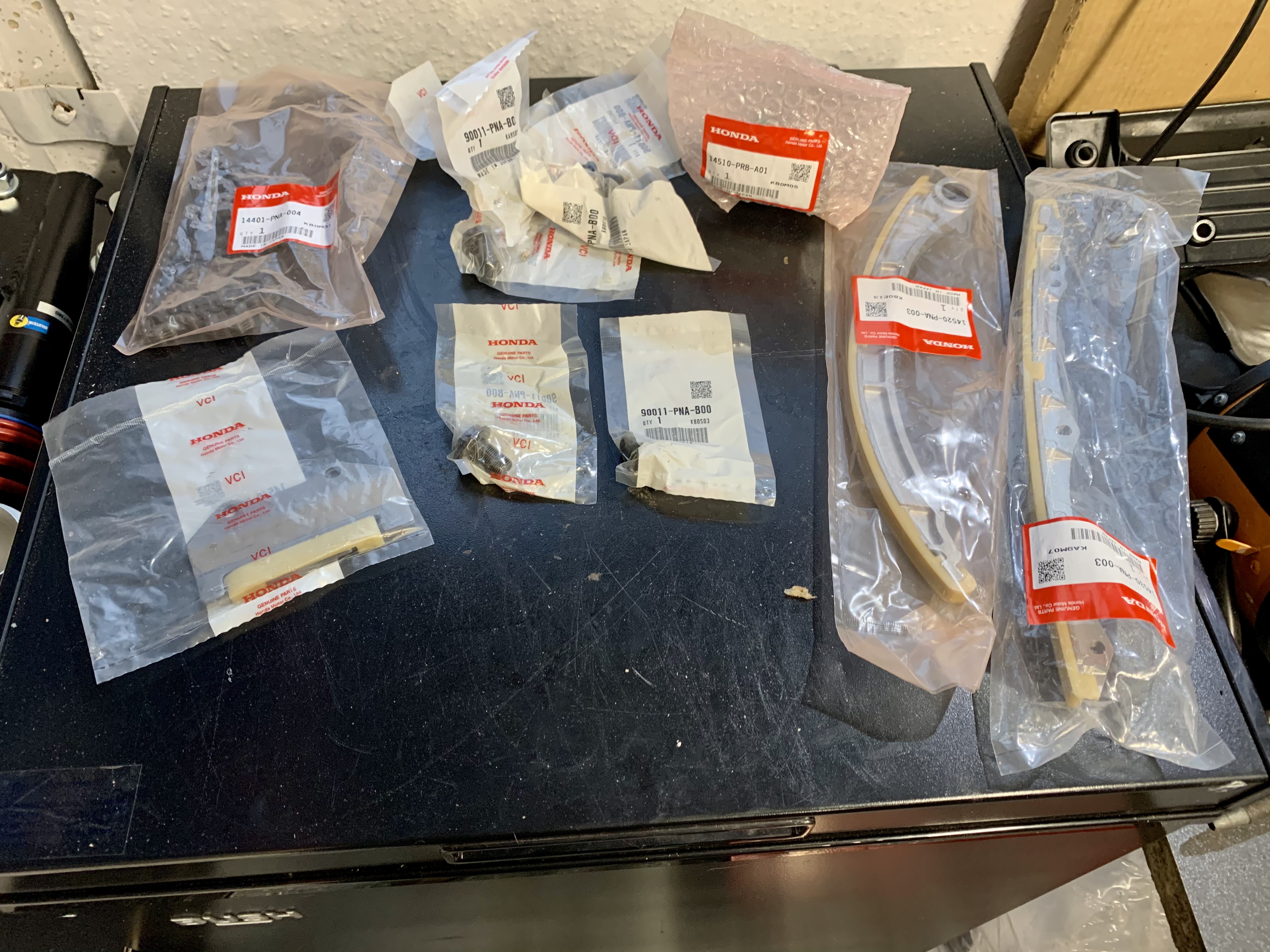

Honda timing chain chain kit

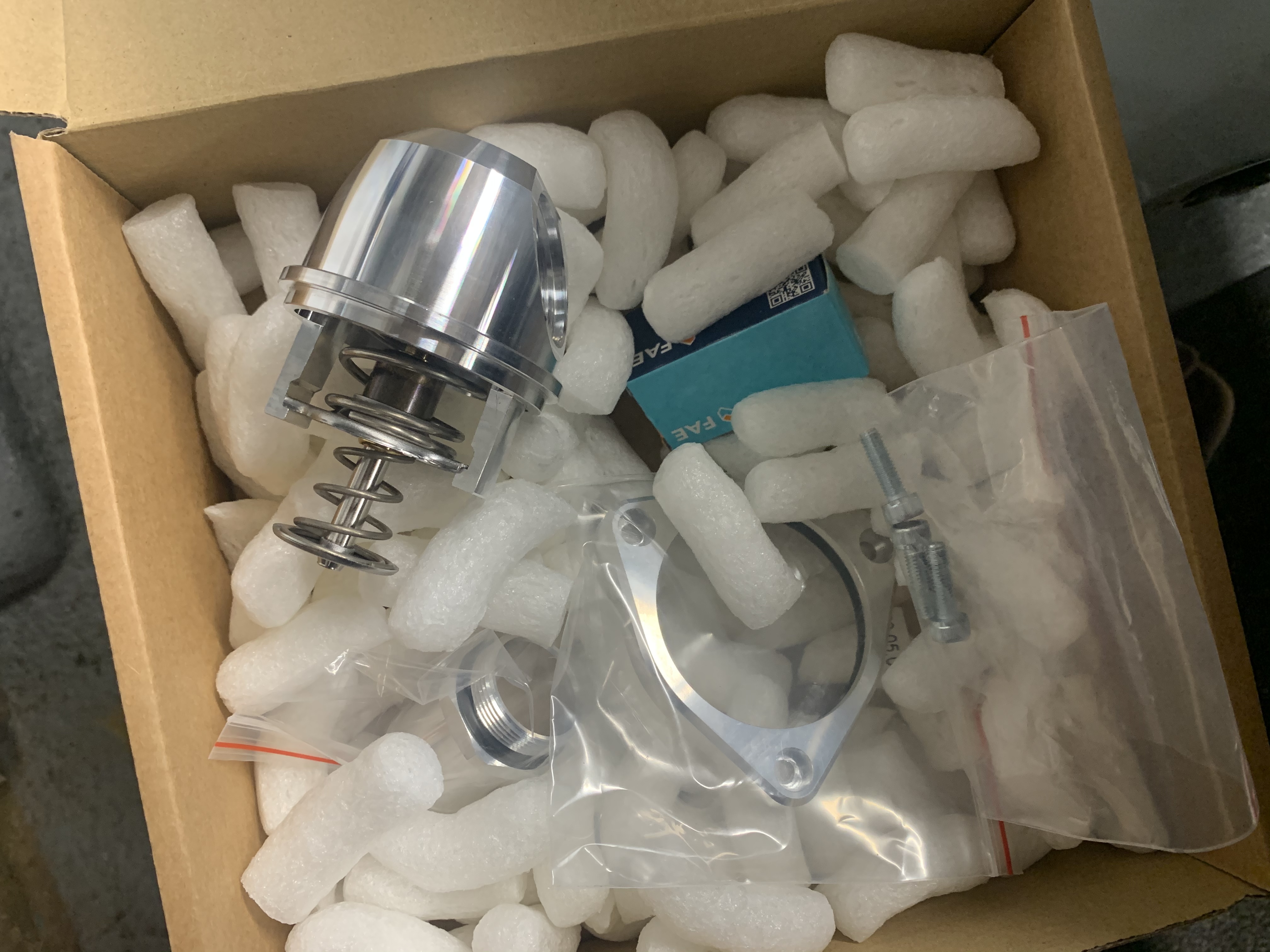

Alternator relocation kit and billet thermostat housing

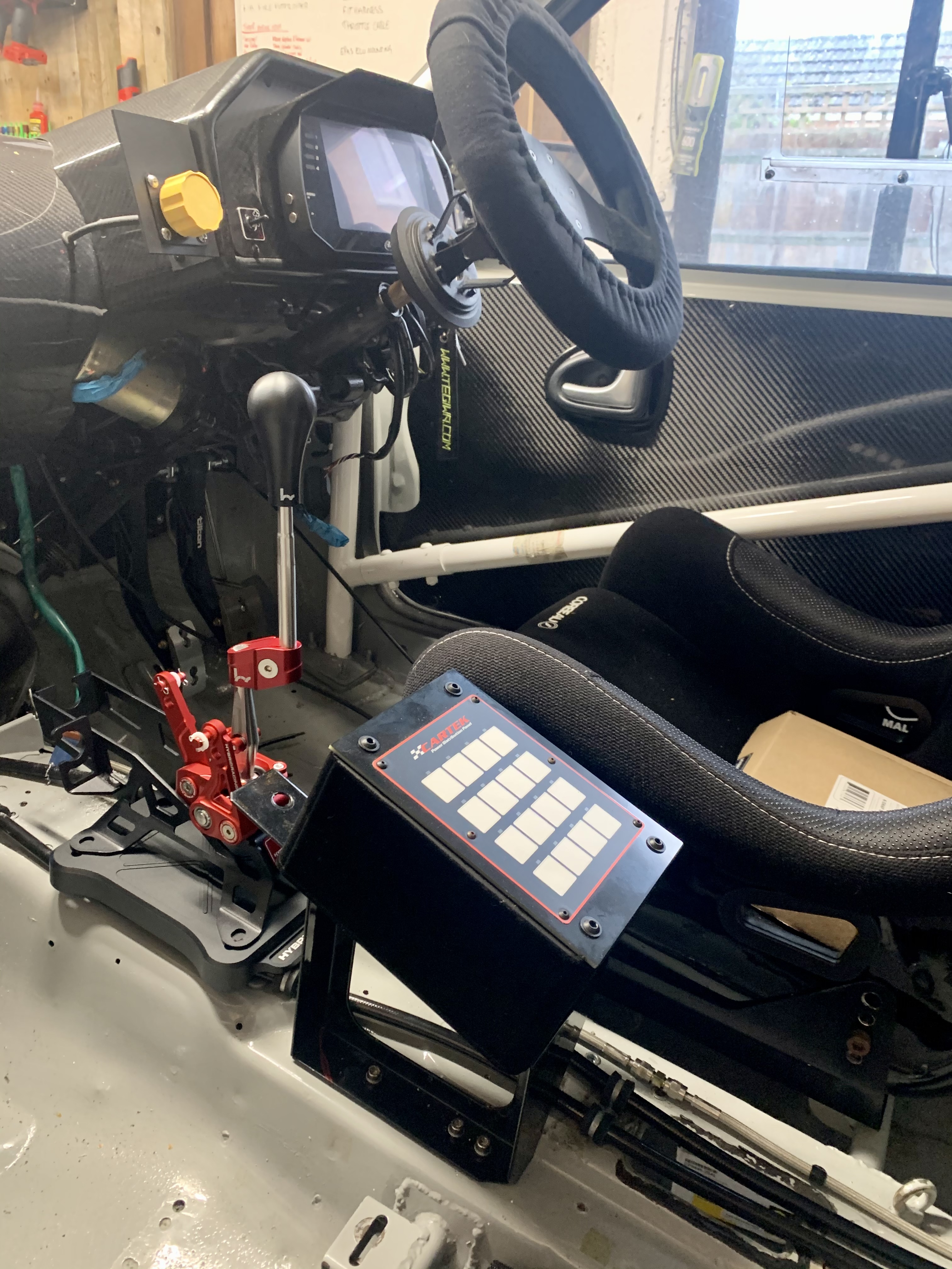

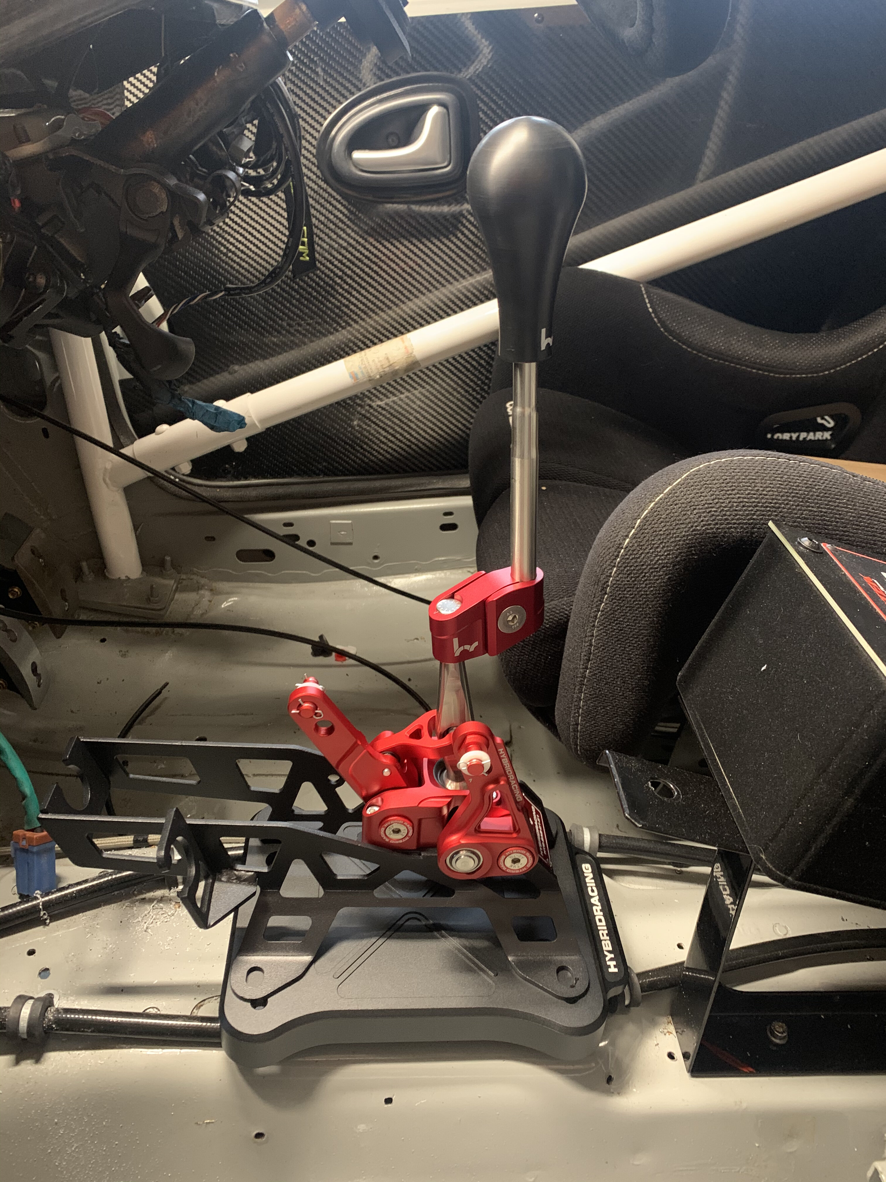

Hybrid racing shifter and cables
Haha not that deep and only plastic 🙄😂😂😂
I toyed with the idea of boost but thought it might take away the Clio personality 🙄😂😂😂 if that’s at all possible with a Honda engine 😂

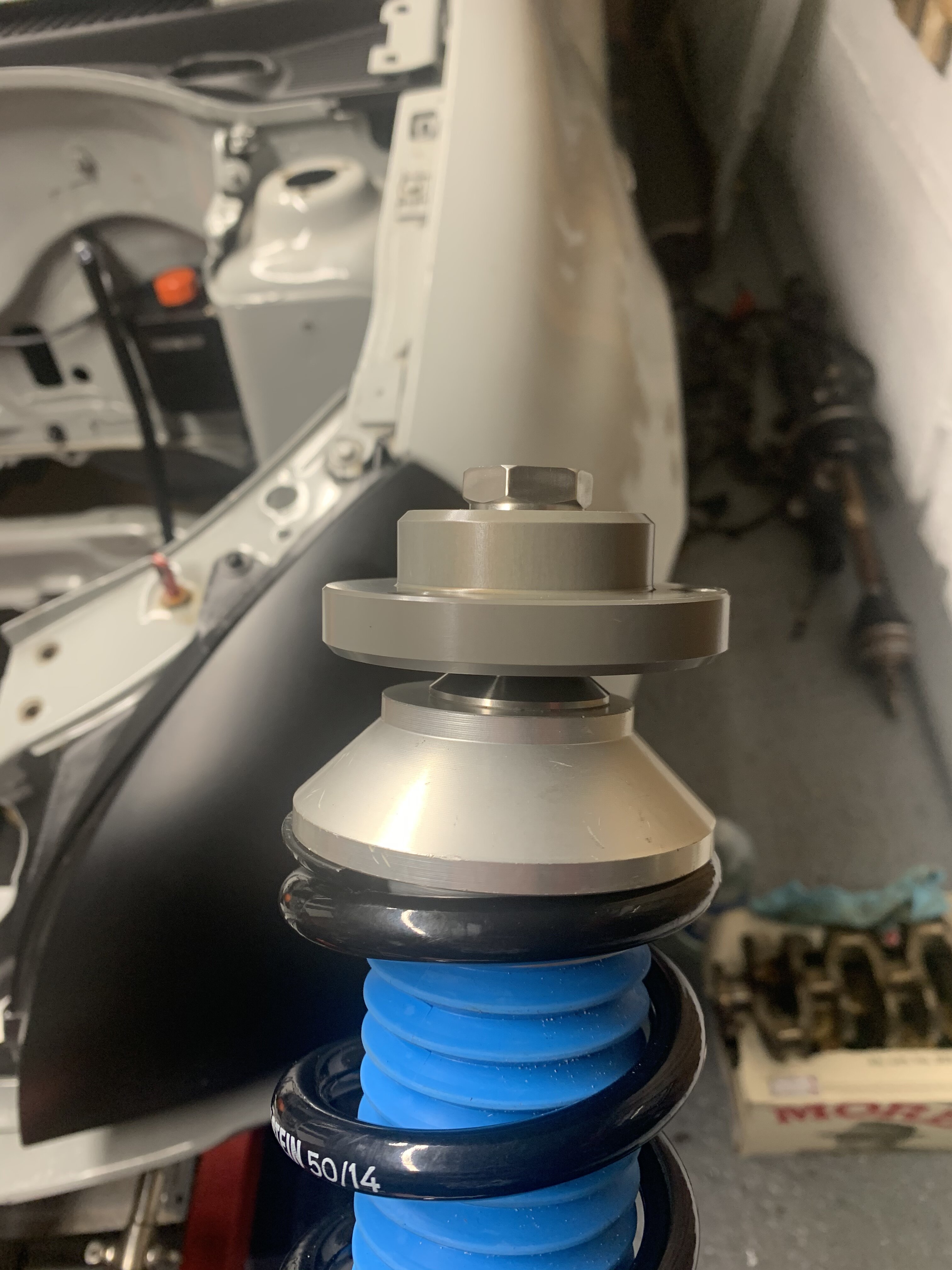

New style PMS top mounts
The shifters you can get for these engine/gearboxes are sooo much nicer than the clio offering. Dont blame you for going this route and cant wait for the updates!

The shifters you can get for these engines are sooo much nicer than the clio offering. Dont blame you for going this route and cant wait for the updates!

Yeah defo! This hybrid shifter is proper smart.

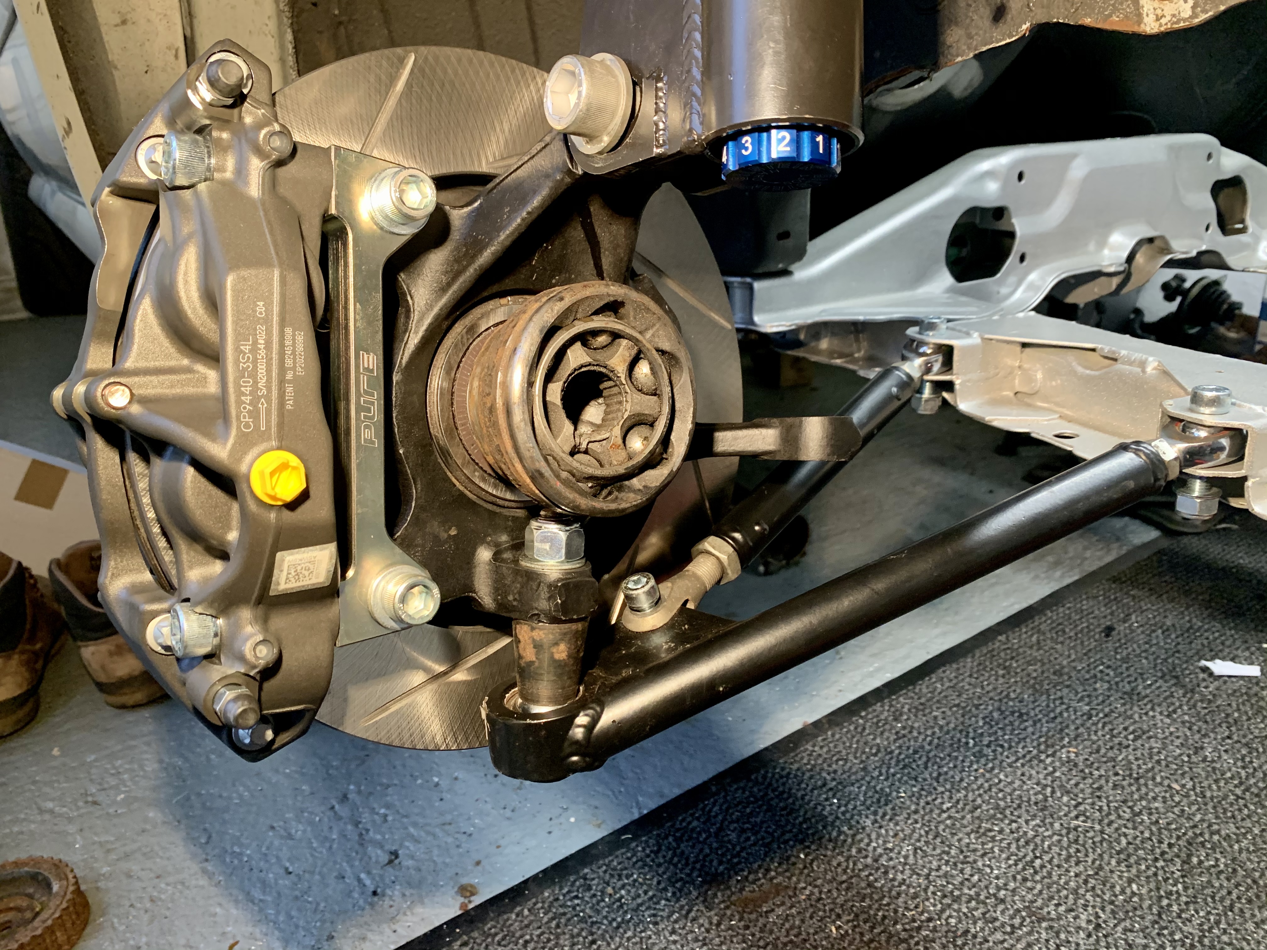

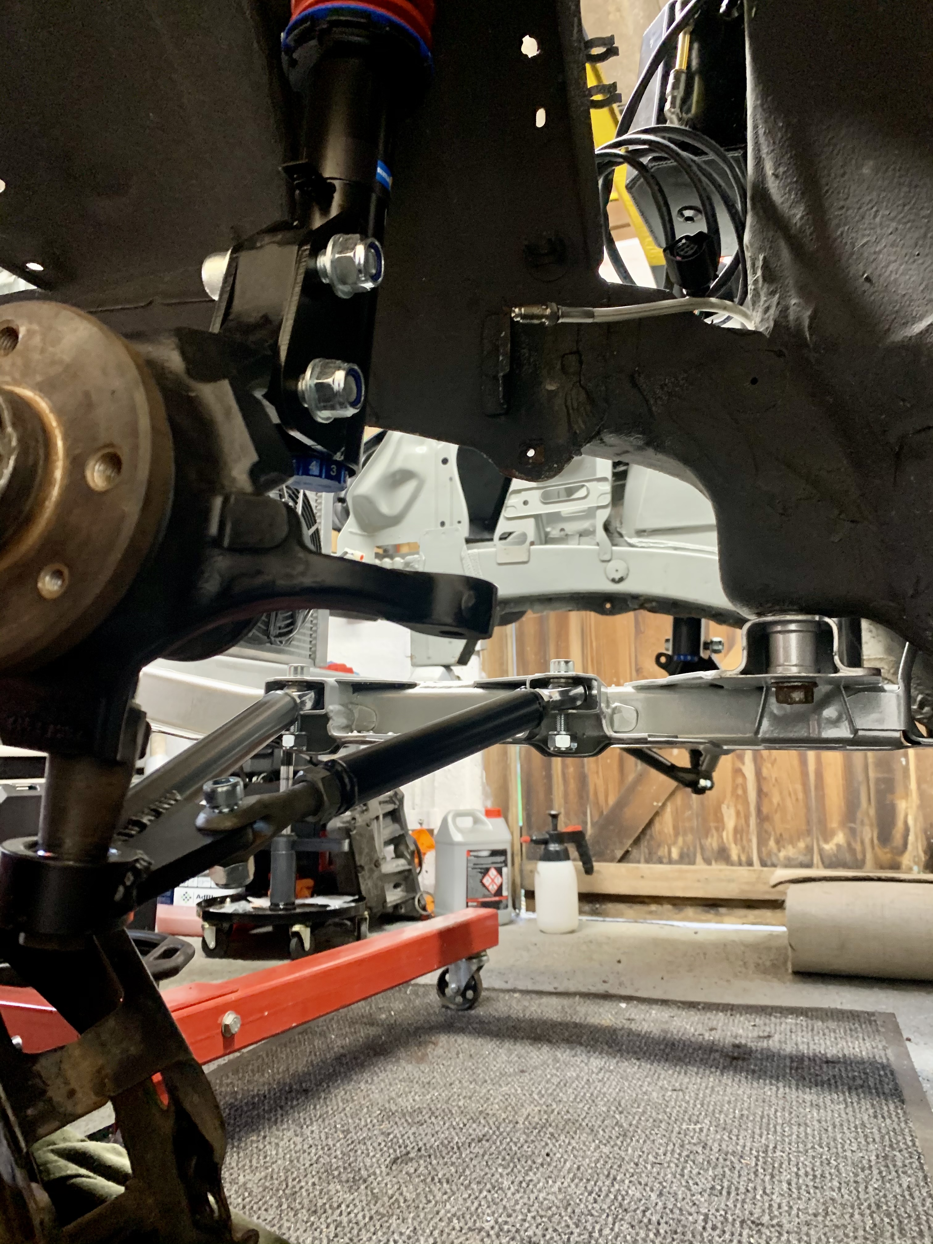

Spent some time on the Clio fitting some nee parts.

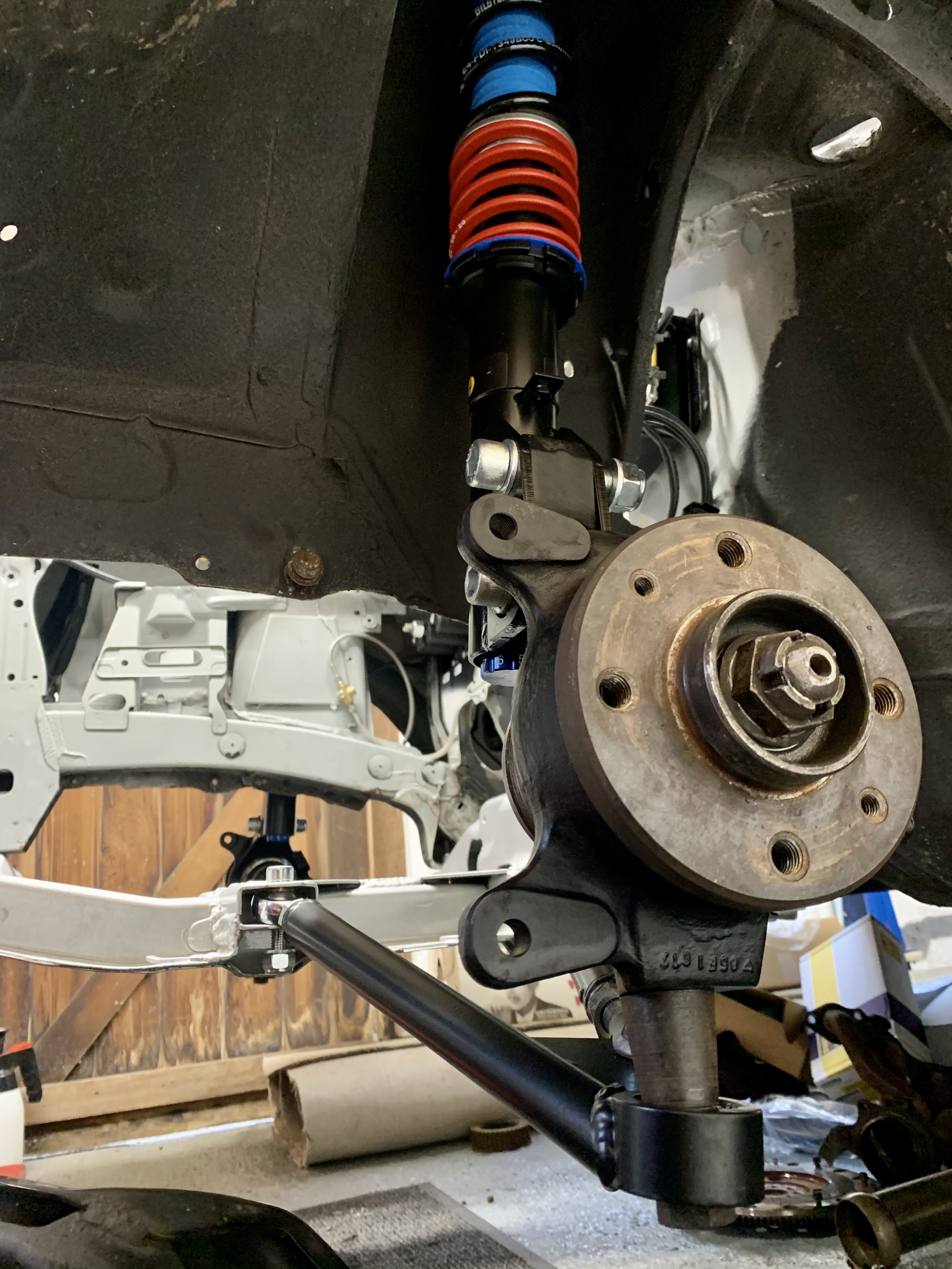

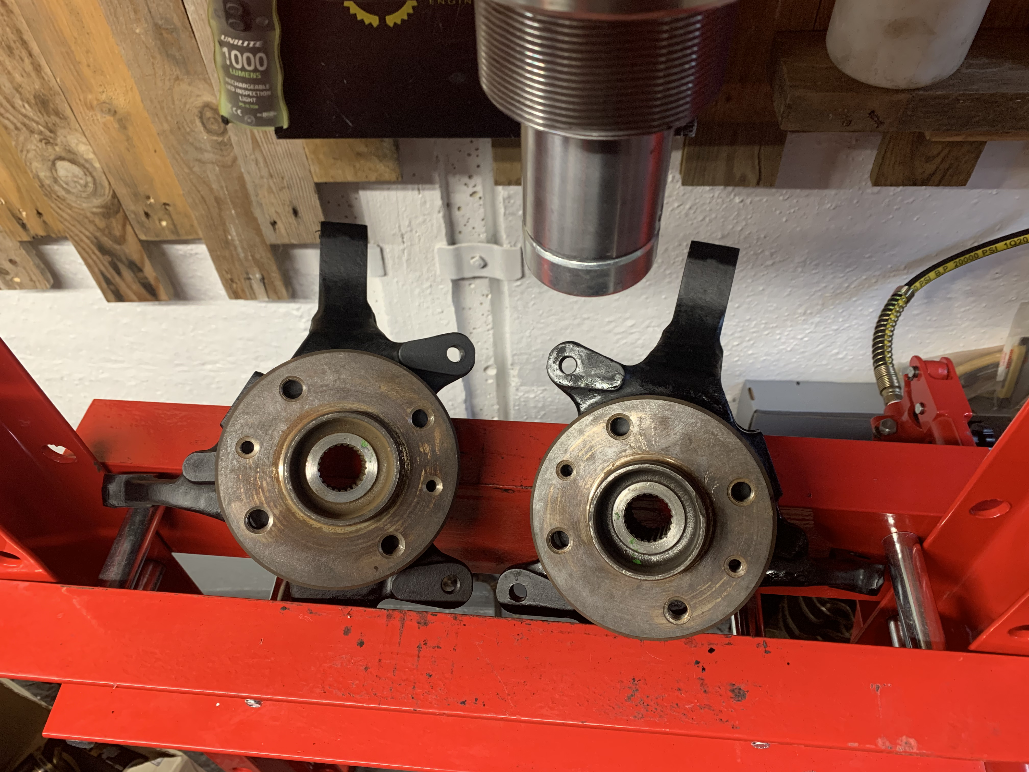

Started by getting my Laguna hubs built up. I’ve machined these to be able to produce much more camber and accept a large ball joint pin bolt.
Got a 20 tonne press to press the bearings in which worked really well.

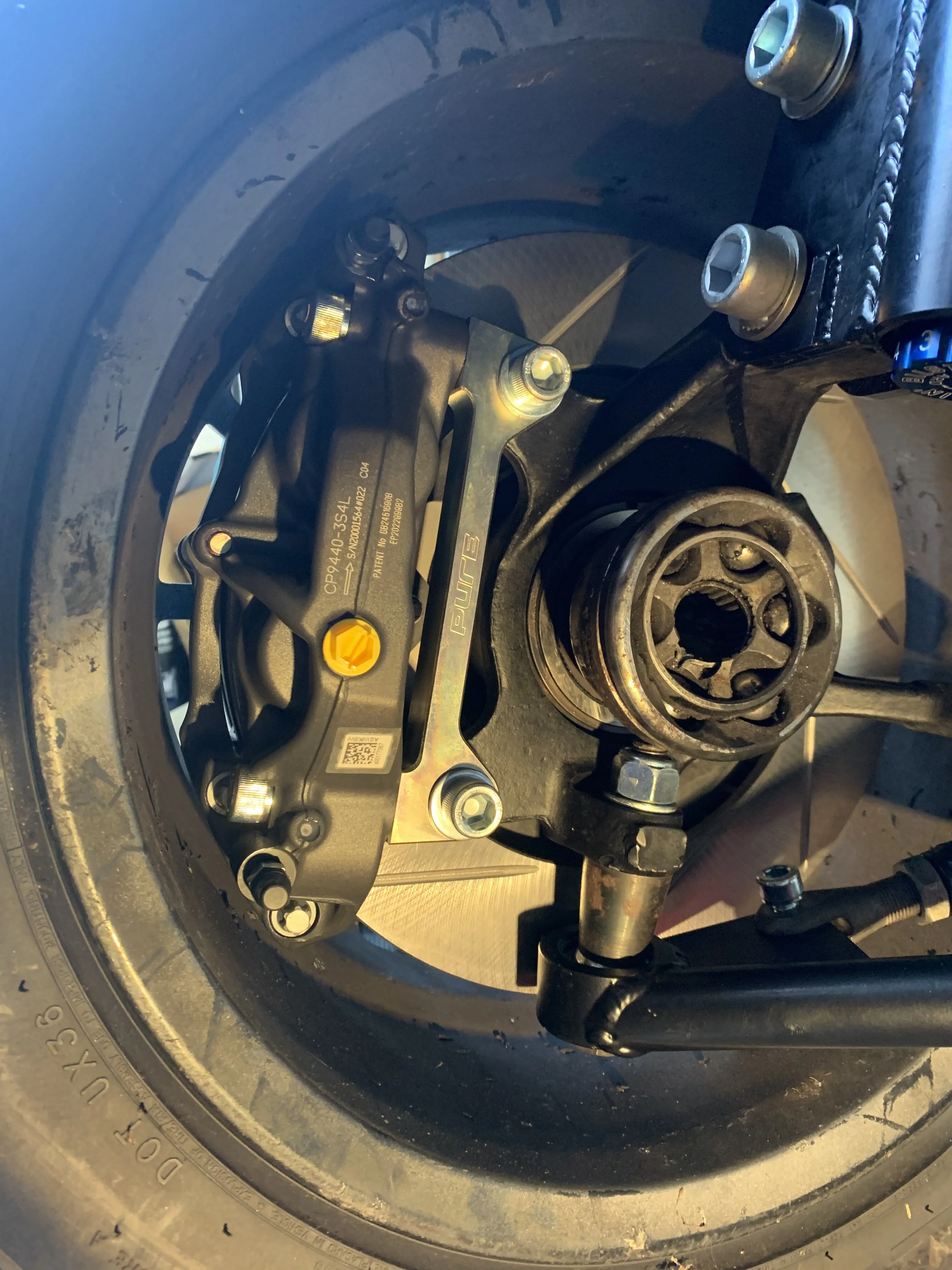

The hubs needed the machine work to take advantage of the PMS suspension
Subframe was strengthened by PMS

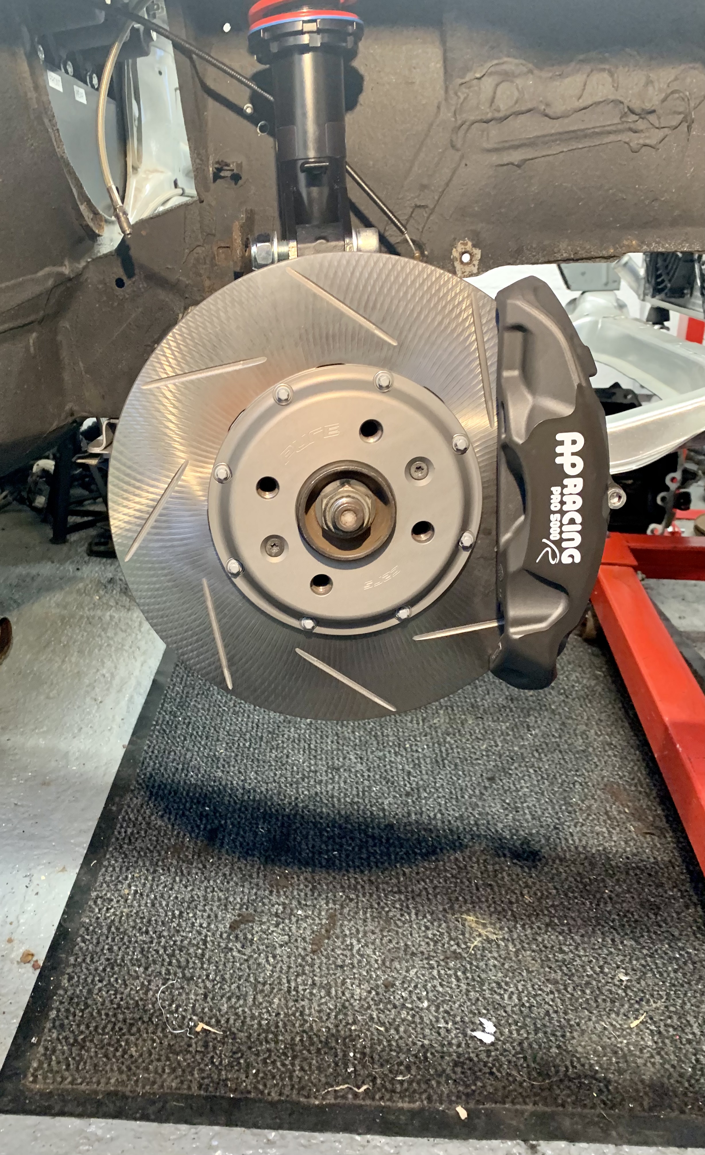

And to finish the hubs off with some new brakes

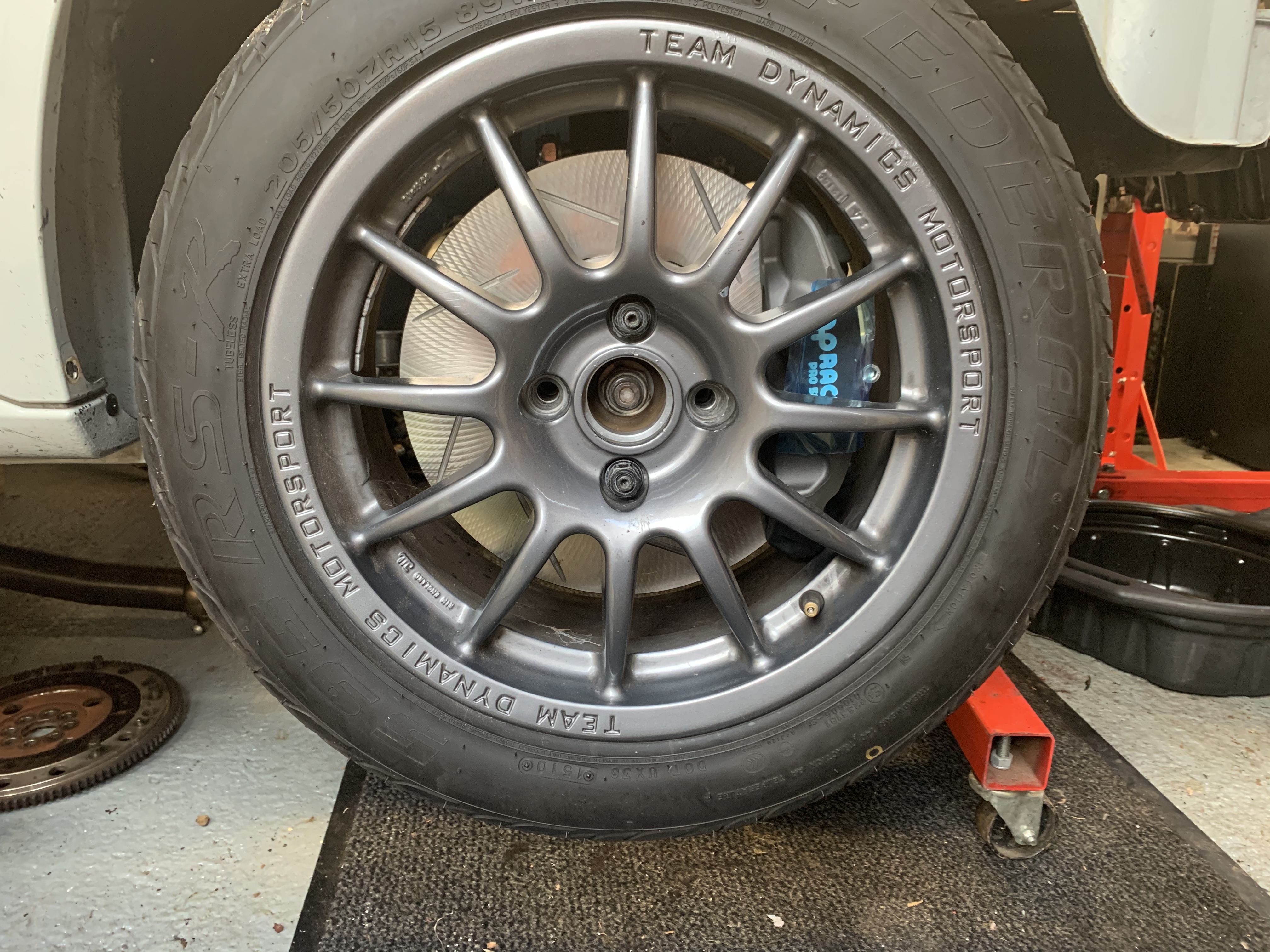

Think I’ll have an issue with wheels fitting over them 🤦🏻‍♂️

the PMS AP brake kit is epic, what wheels you trying to fit it under? I’m contemplating swapping to the laguna hubs aswel but undecided as yet

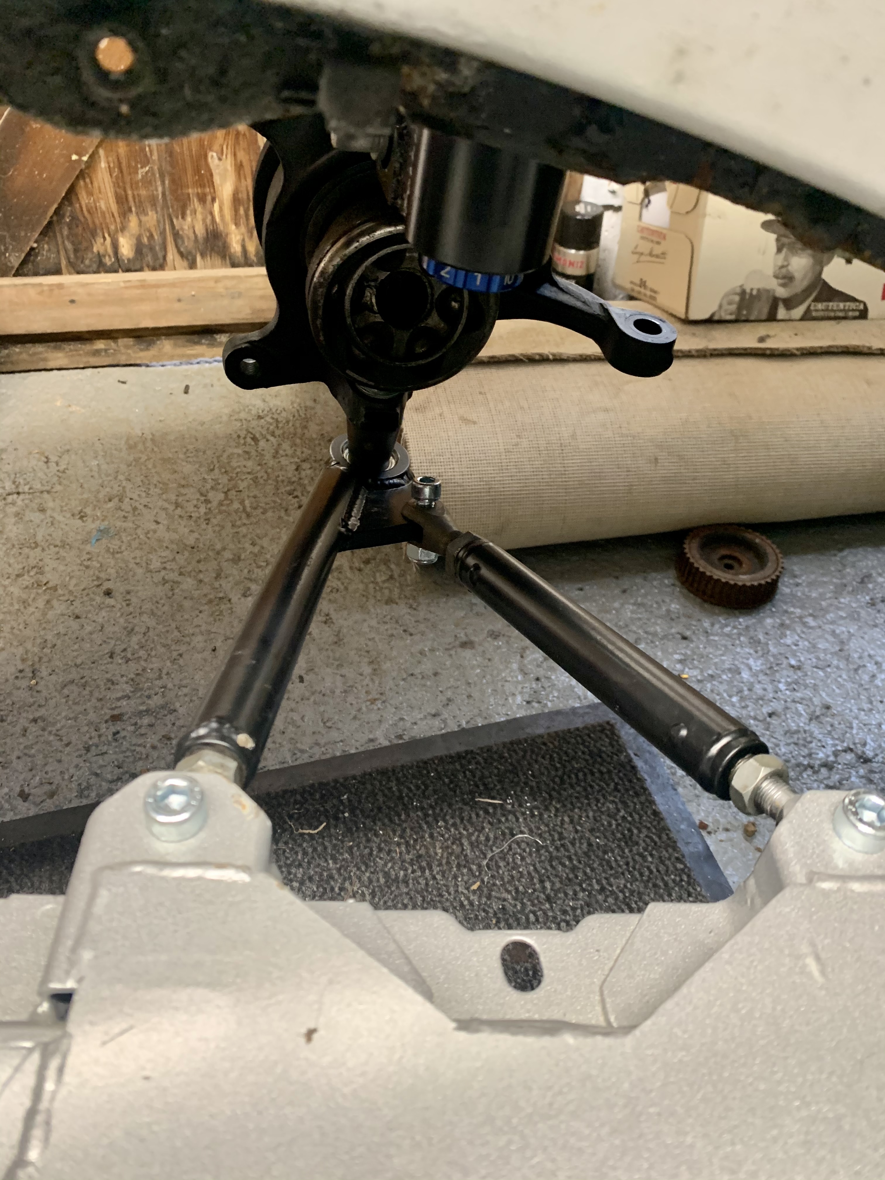

I’ve made my own tubular subframe and lower arms, waiting on my custom RC pins arriving before I can fit it all together
Judging by the effort so far, the result already speaks for itself
The Kits really nice but designed around the Braid wheels that puremotorsport sell. Nick doesn’t think this kit will fit under TD 1.2s which I’ll need to address 😂
I’d be very interested in seeing the tubular subframe and arms if you don’t mind posting pic or PM them?
I’ll send over a few snaps of the subframe etc when I’m back at the garage midweek.
I hope the brakes fit under ultraleggeras as I’ve 2 sets still in boxes

Fingers crossed, if you send Nick a wheel he’ll trail fit it over the brakes before you buy
If you want wheels with good clearance for big brakes td Pro rallys are good for space. I used to run alcon 4pots and 300mm discs with them on my rally puma. Most gravel rally wheels are designed to run with the biggest brakes you can under them.

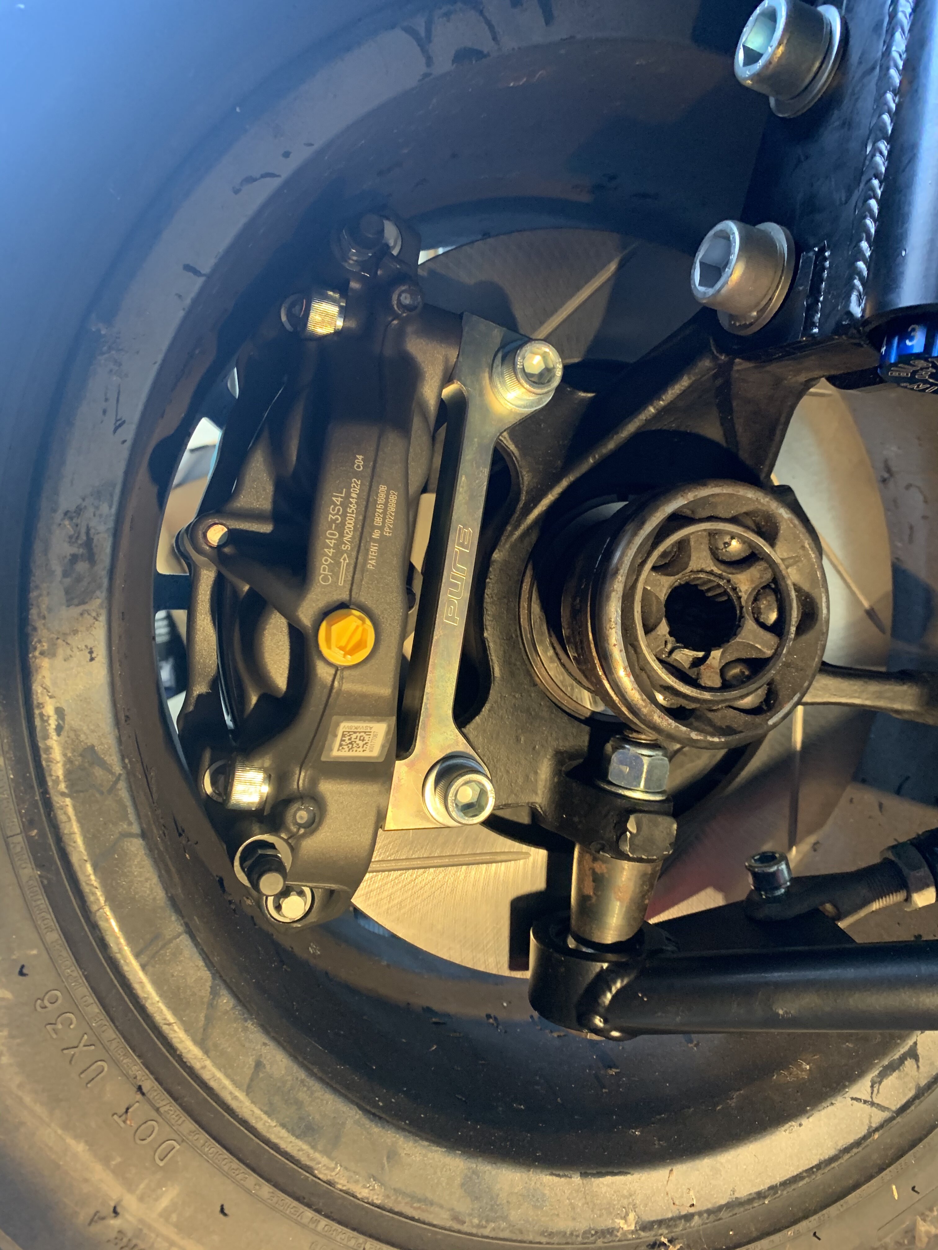

View attachment 1509066View attachment 1509065
Think I’ll have an issue with wheels fitting over them [emoji2359]

Also that design of wishbones is totally diffrent to mine. Is that not PMS I assume?
This is AP news isn’t good. I’ve been ordering these from Nick this week although he’s out of stock of the discs at the moment.
I run both ultraleggeras and 1.2s so I really need these to fit.
I hope the 18mm spacers will help but I’d better speak to Nick first.

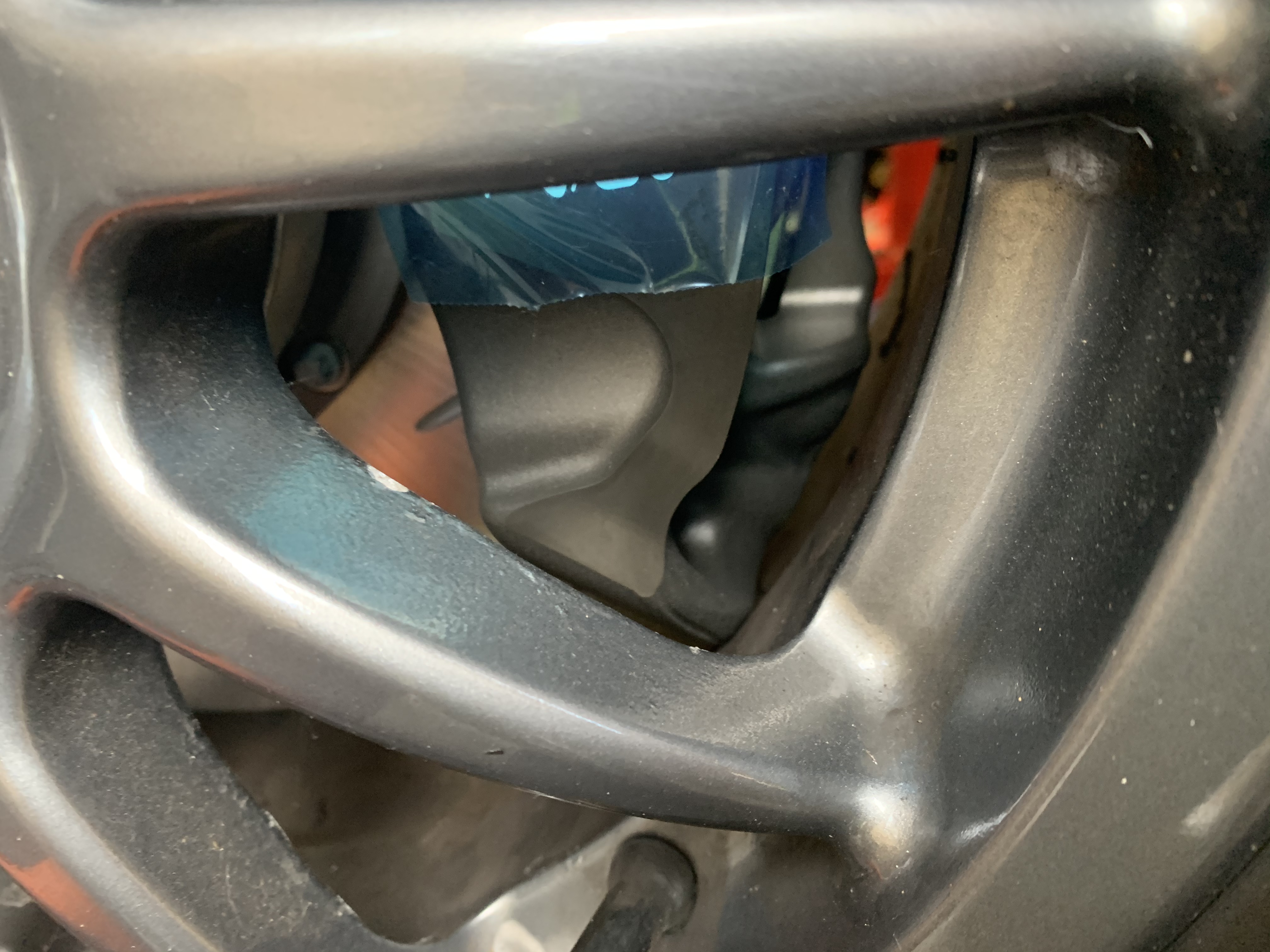

My 1.2s I tried in the pic above have 20mm spacers on and don’t clear
It’s more the barrel of the wheel than the spokes
