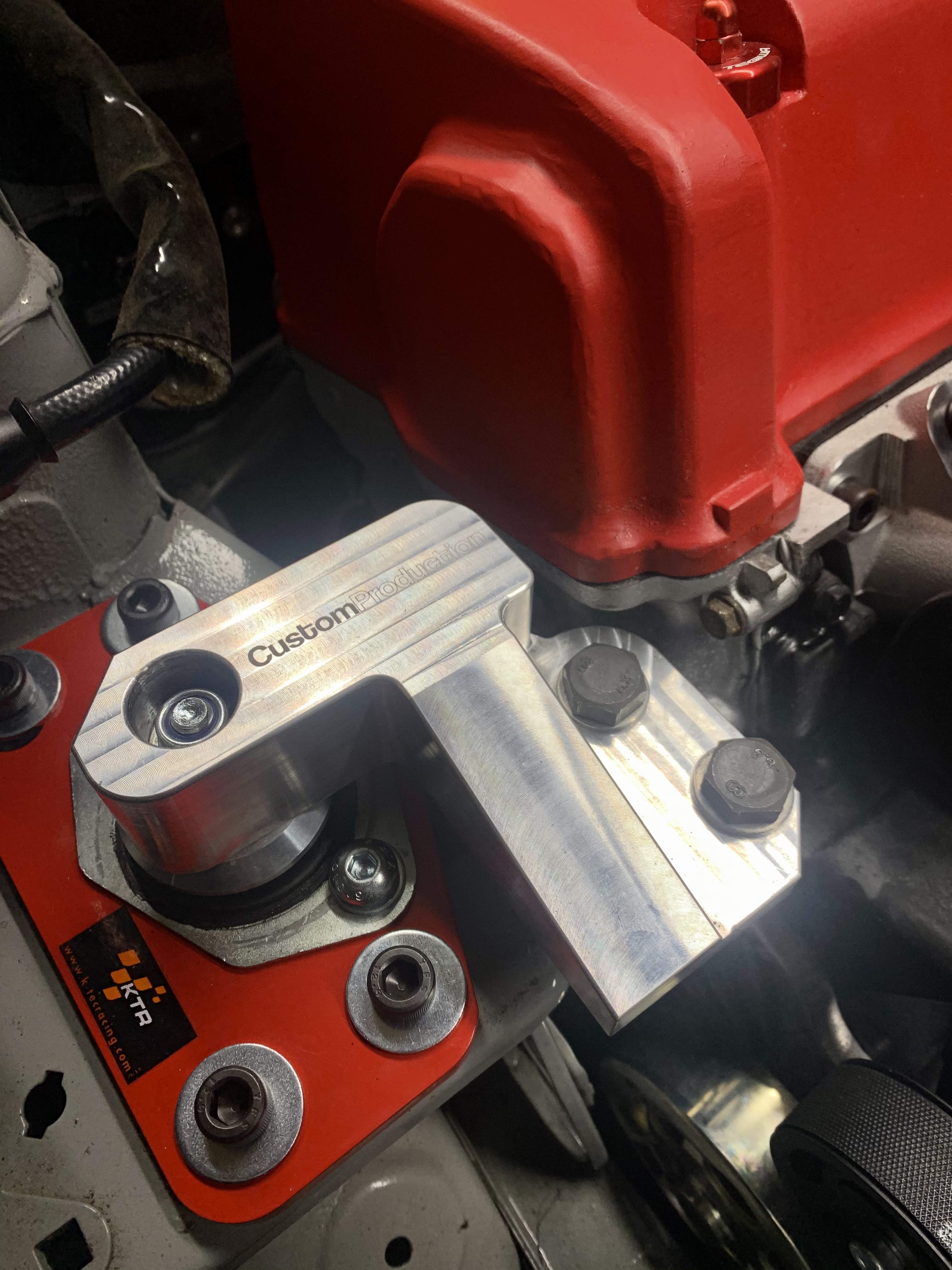

Yeah it’s mega close. Even changing the alternator belt will be a challenge.
Don’t think the engine will come out the top either.

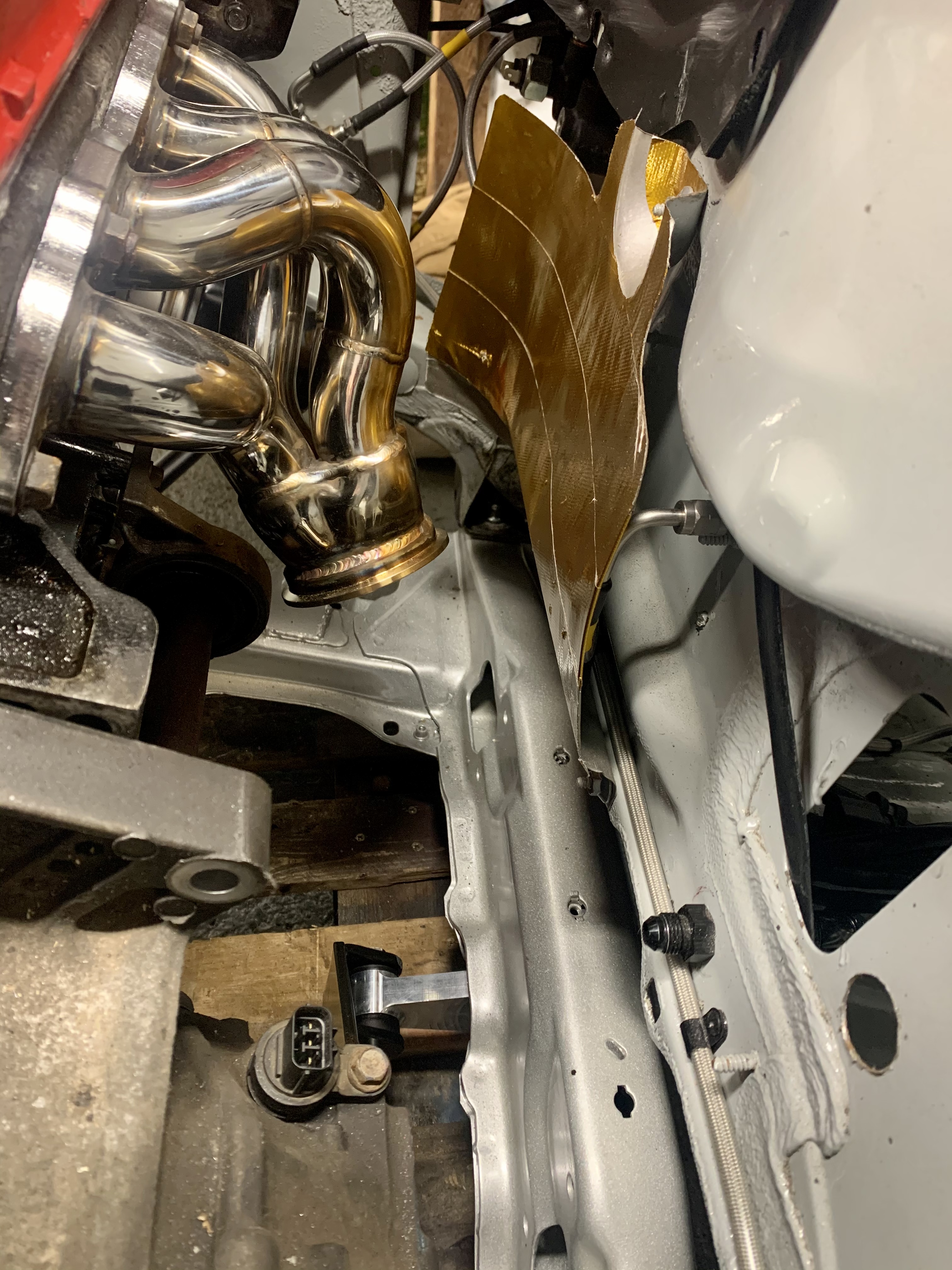

Need to fettle the chassis leg a tad more for the gearbox mount.
The mount has to take up the strength that's lost with the cutting in the chassis leg I suppose? Hence the thickness?
As it's a populair swap in the older (lighter) Honda's, it can't be too much, I doubt the handling will be affected much.
The mount defo needs the thickness but will be solid once in. I’ll post some pics of cutting the chassis leg.

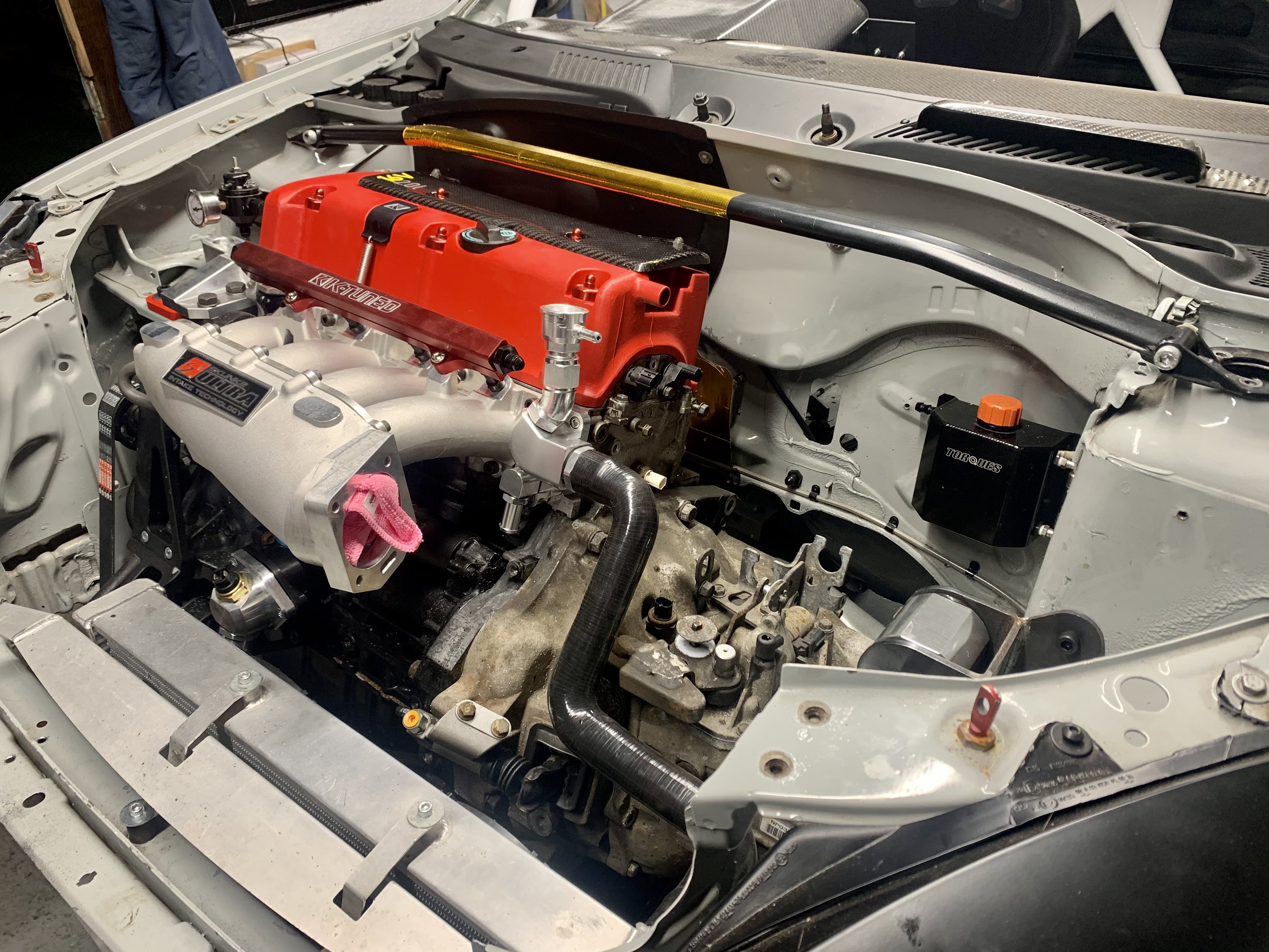

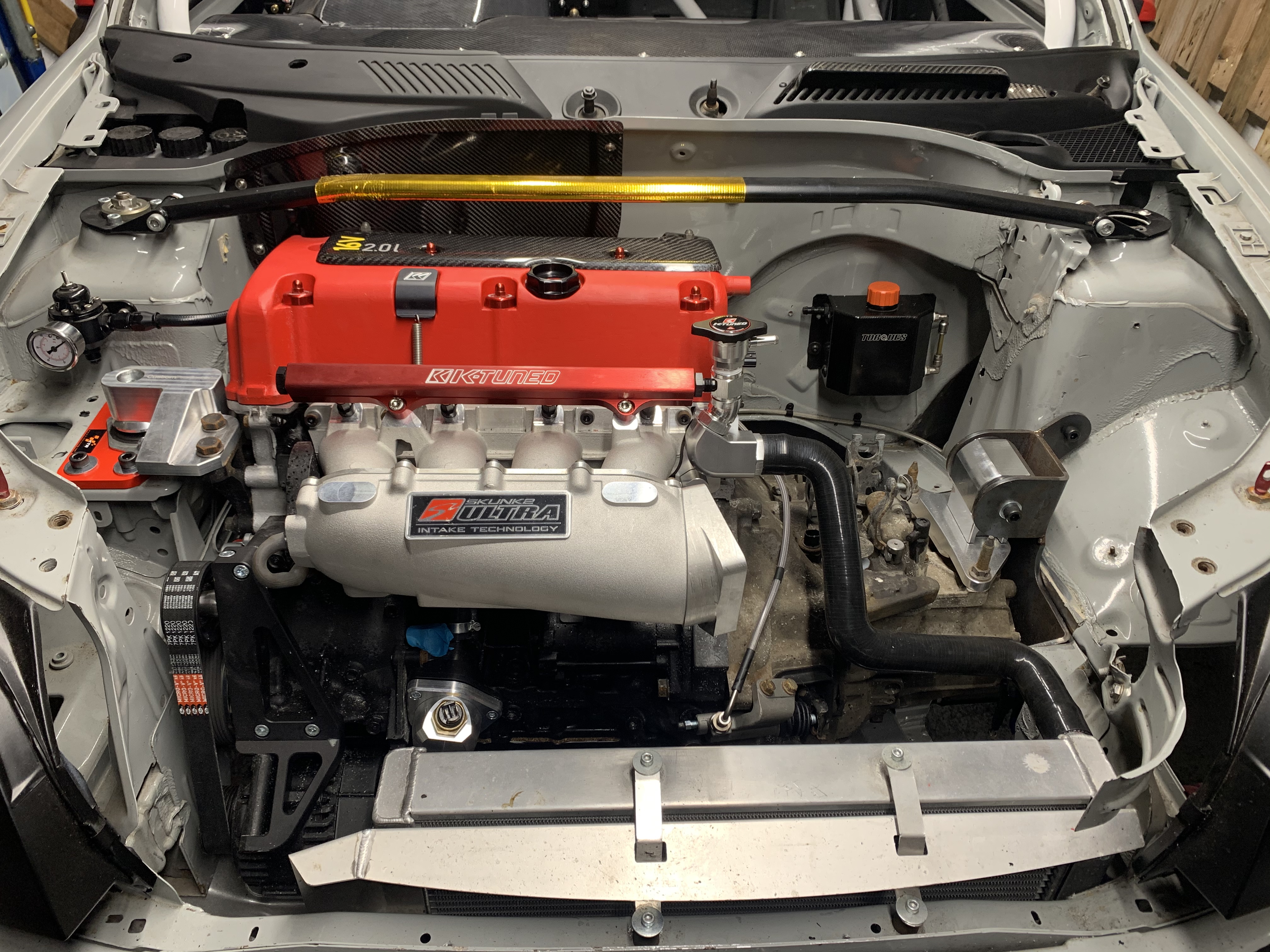

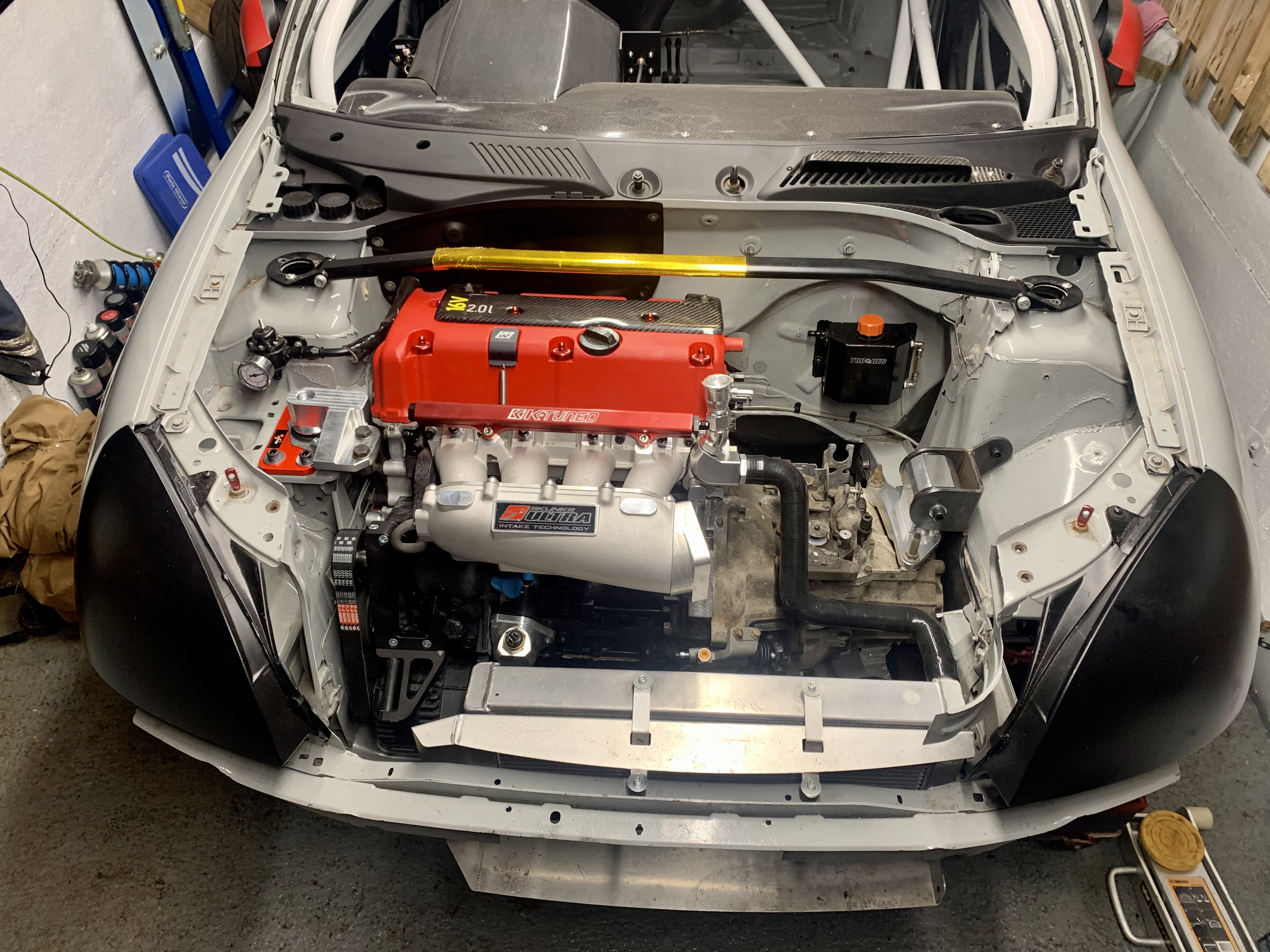

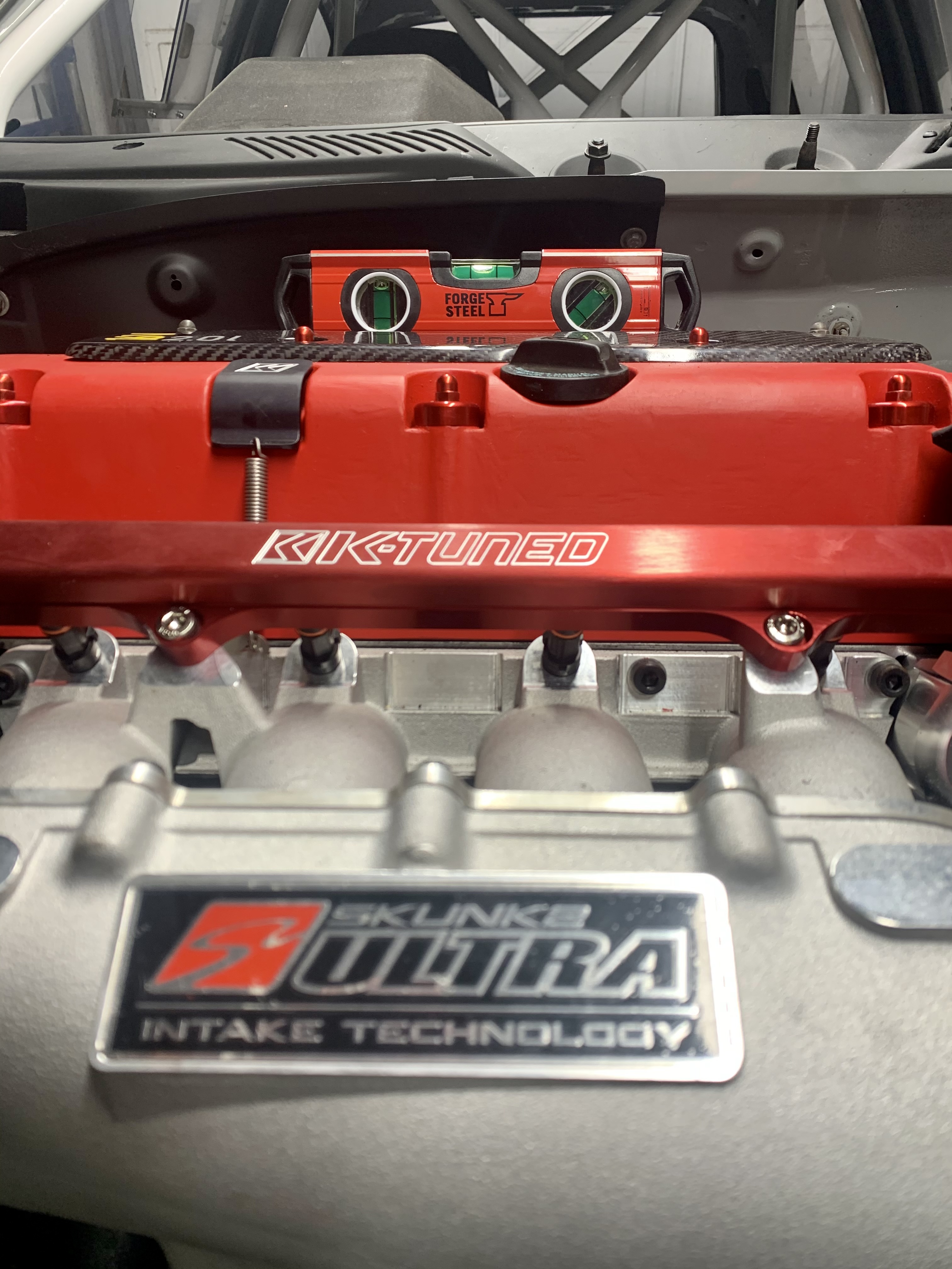

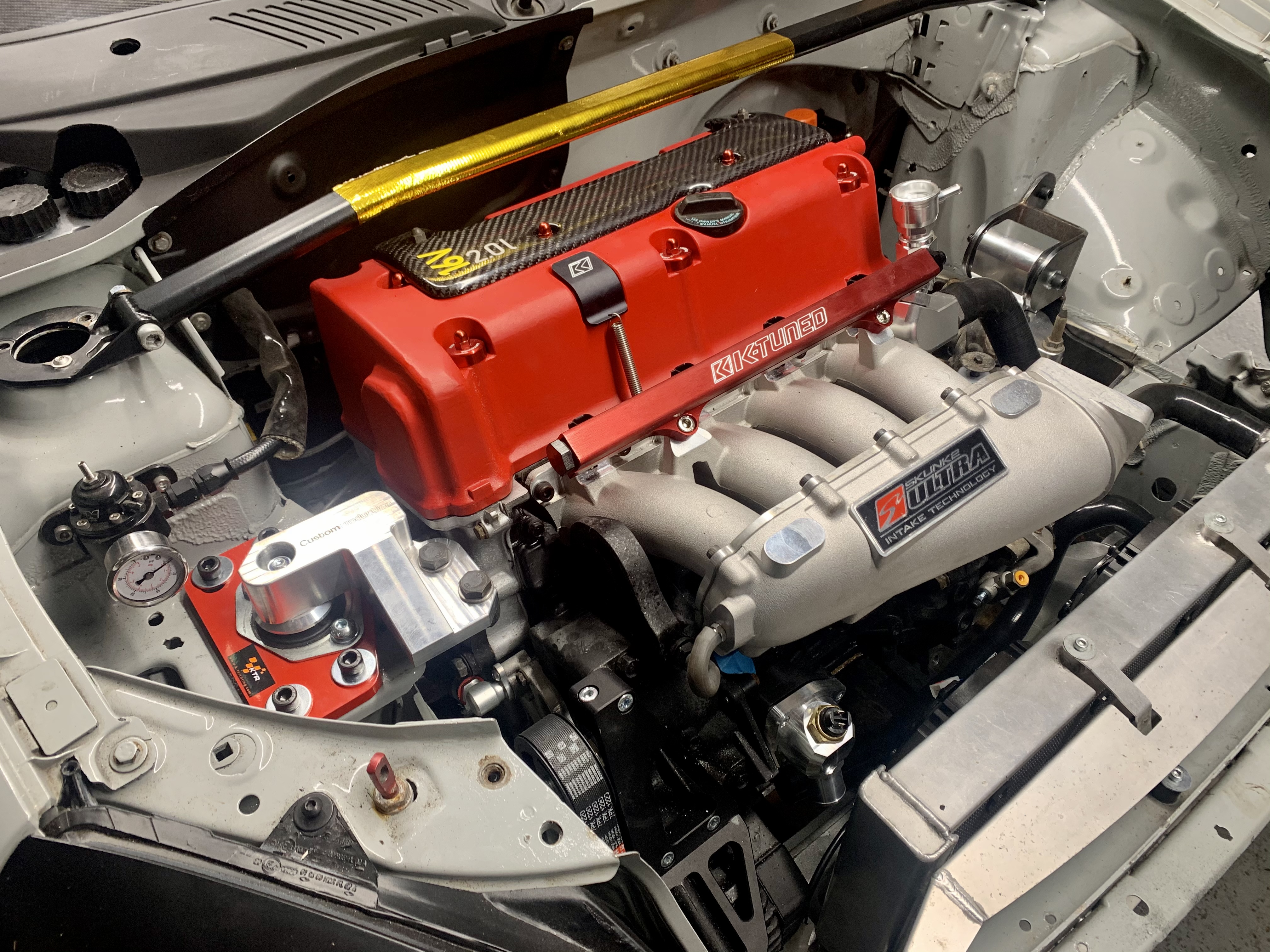

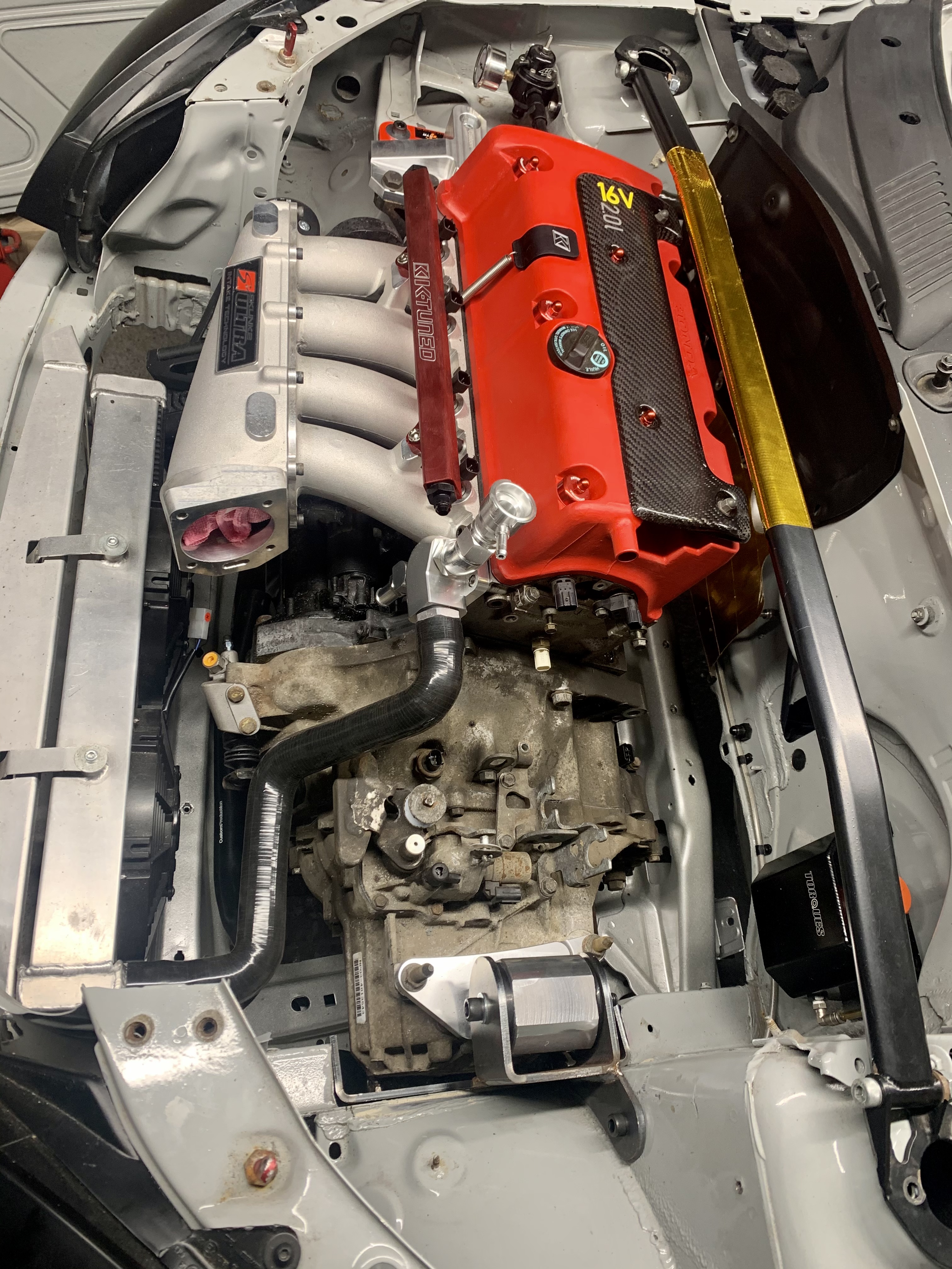

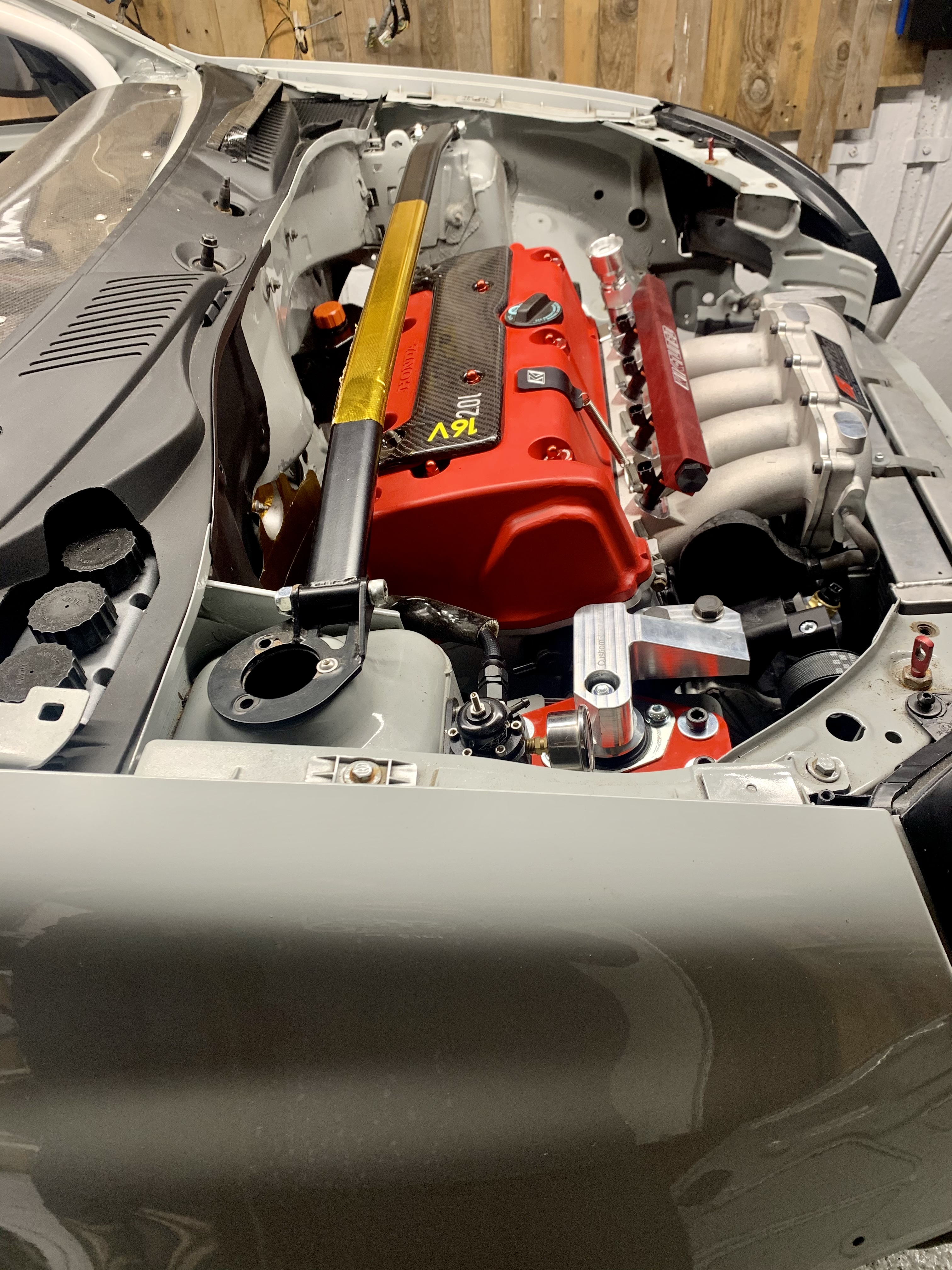

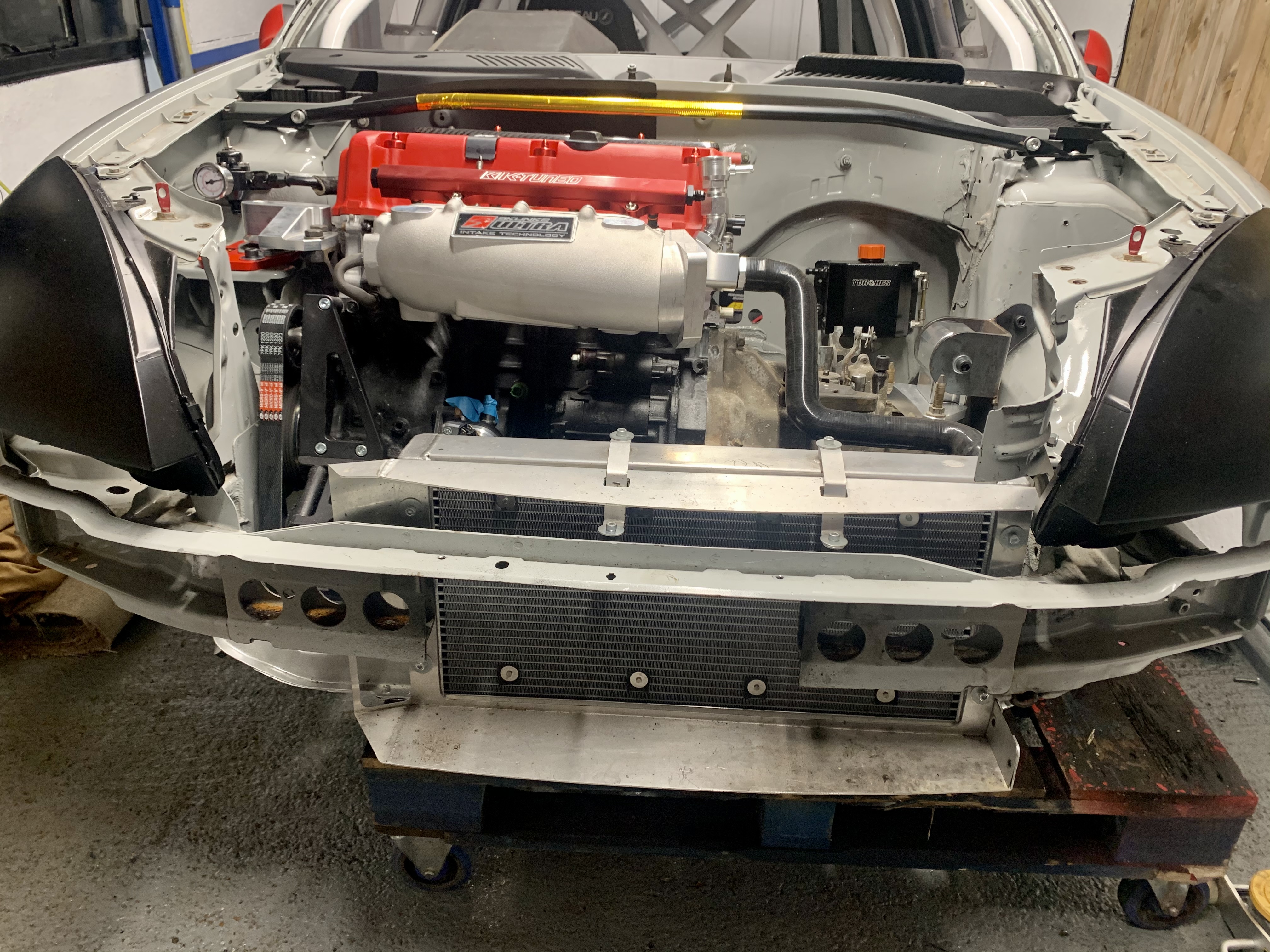

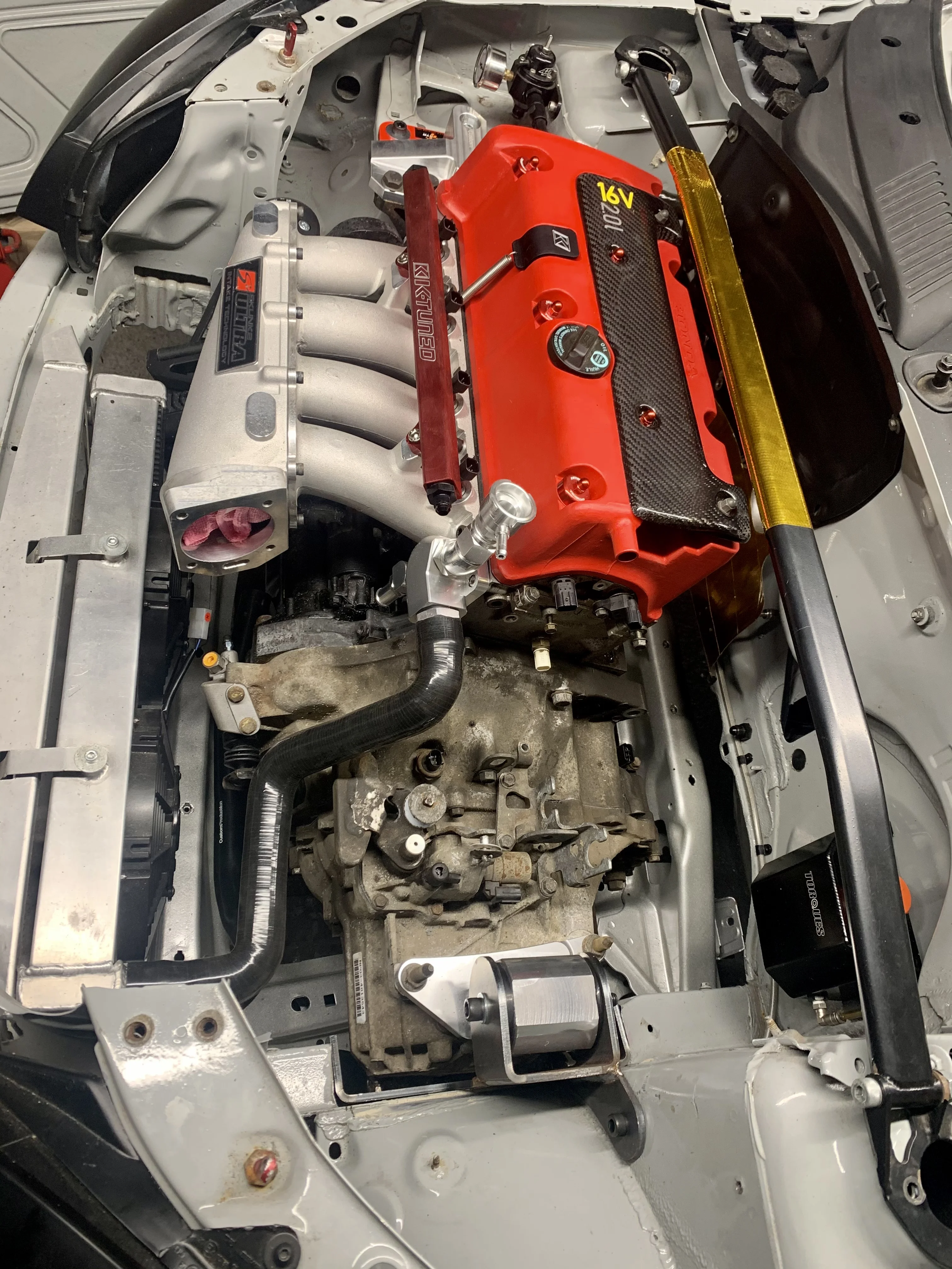

The K20 engine is in on all 3 mounts and checked for clearance on just about everything. I’m pretty happy with where the engine is sitting and how it sits, so the gearbox/chassis leg plate can be tacked where it is soon.
List of stuff I still need to sort or size up like clutch line, new feed and return fuel lines, need to notch the chassis legs for clearance on the drive shafts, need to notch the subframe for clearance for the 3 inch exhaust, the bottom hose supplied doesn’t work with my setup so needs adapting.
I should have a steering column arrive soon so can get the rack back on and check clearance there. Need to get a Clio outer joint as one of mine won’t fit the new shafts.
Plenty to do but here’s what it’s siting like.

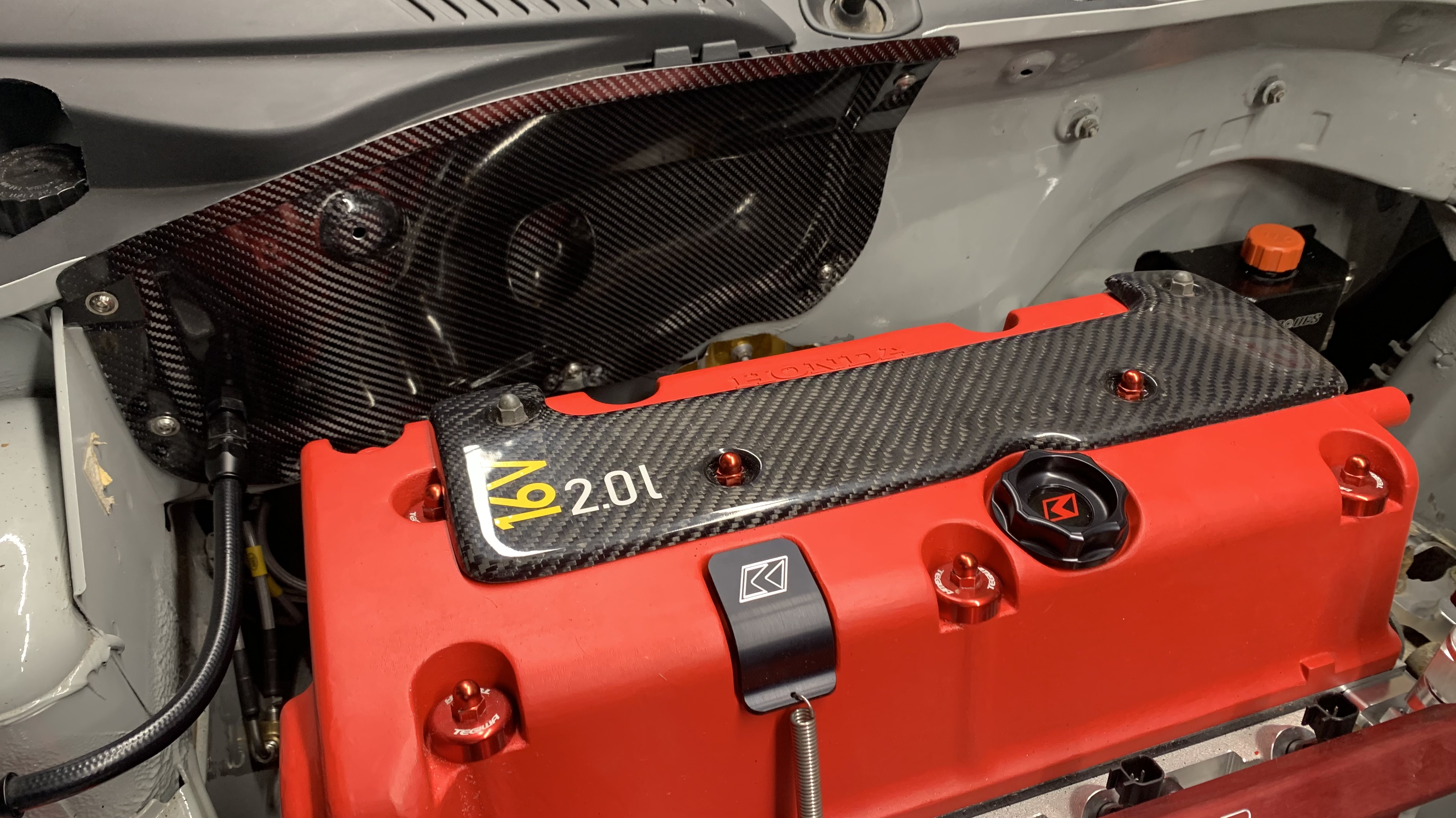

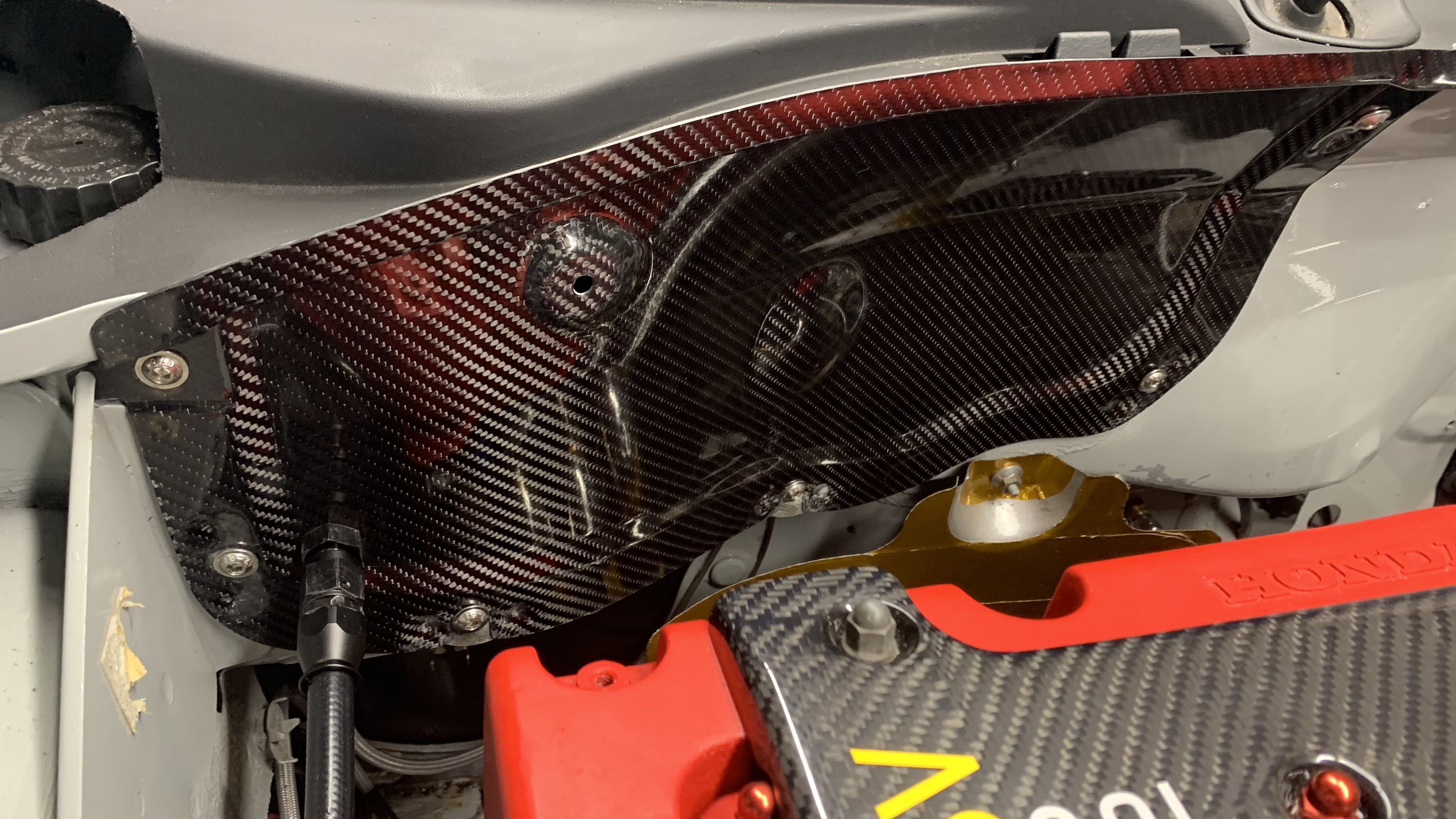

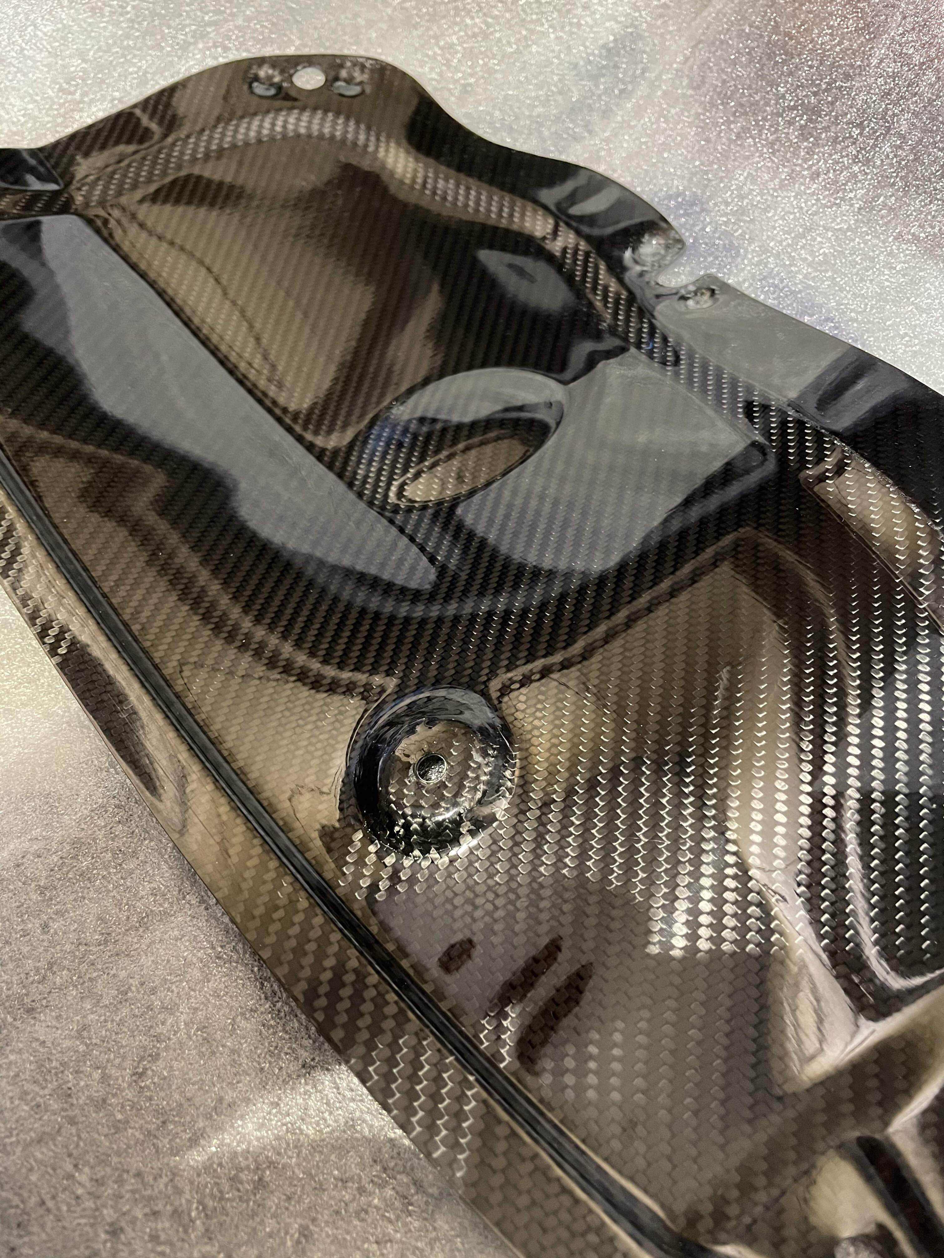

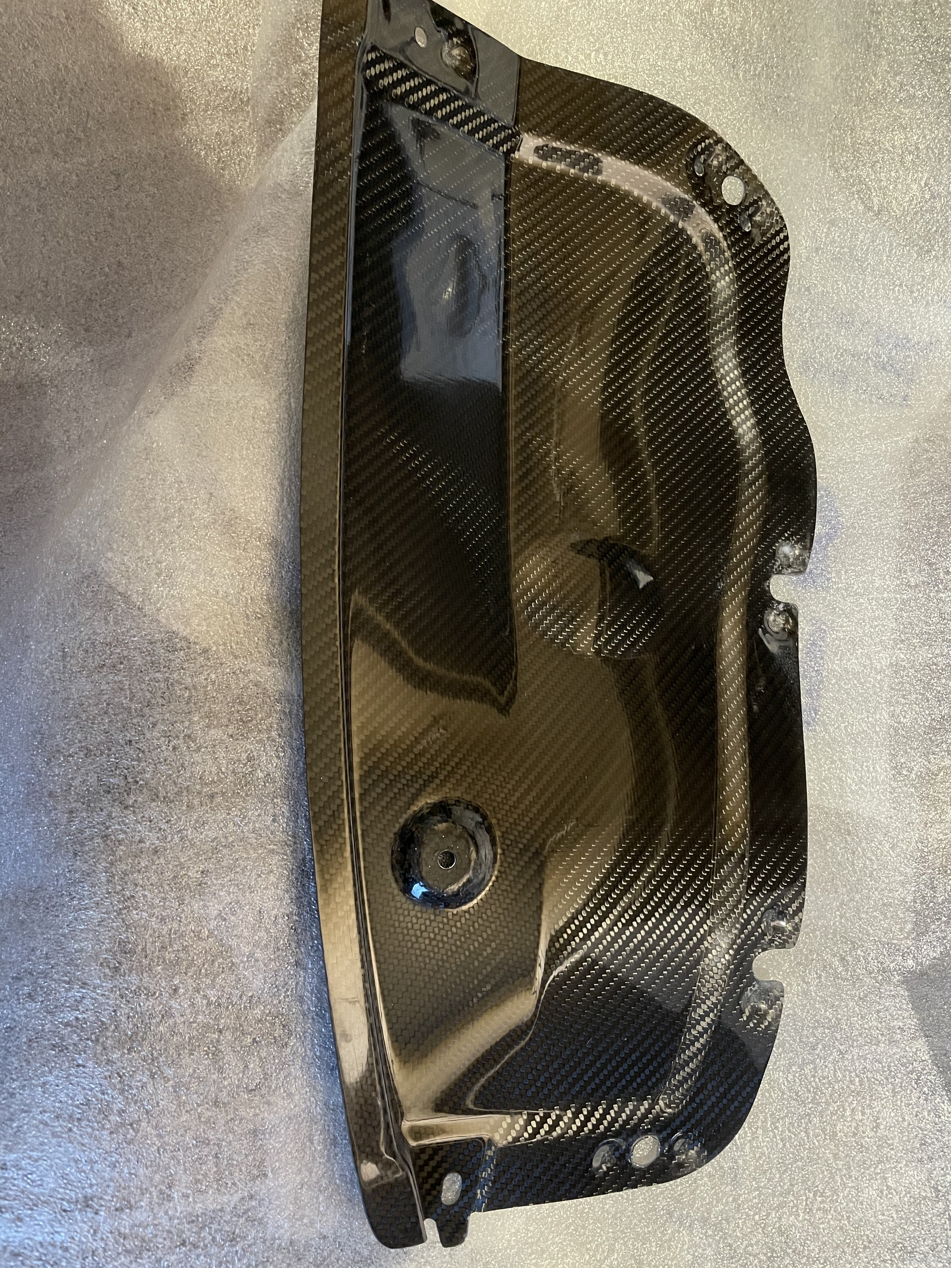

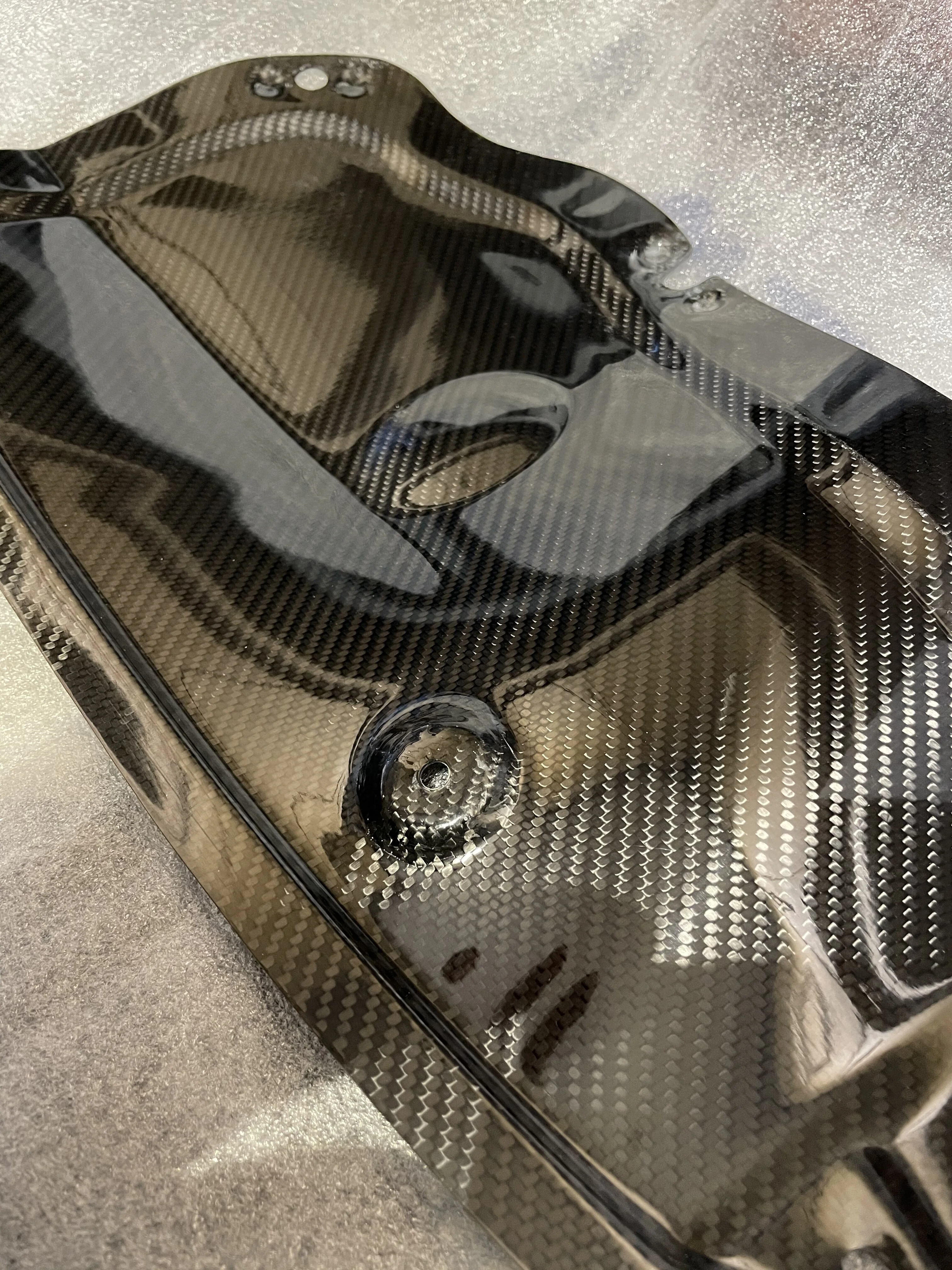

I received my carbon bulk head panel from @EVO 4LEX and its proper smart and perfect fit.

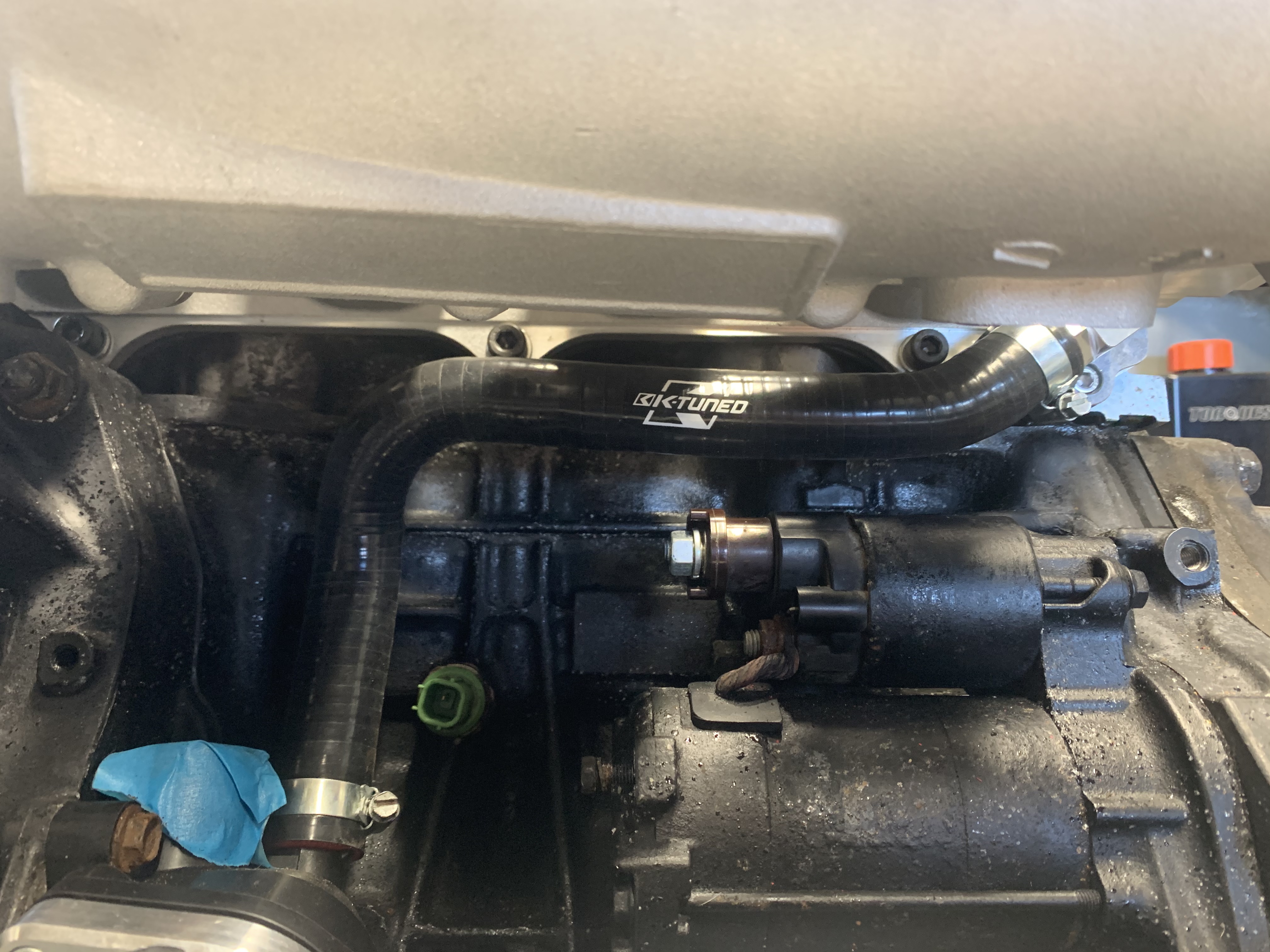

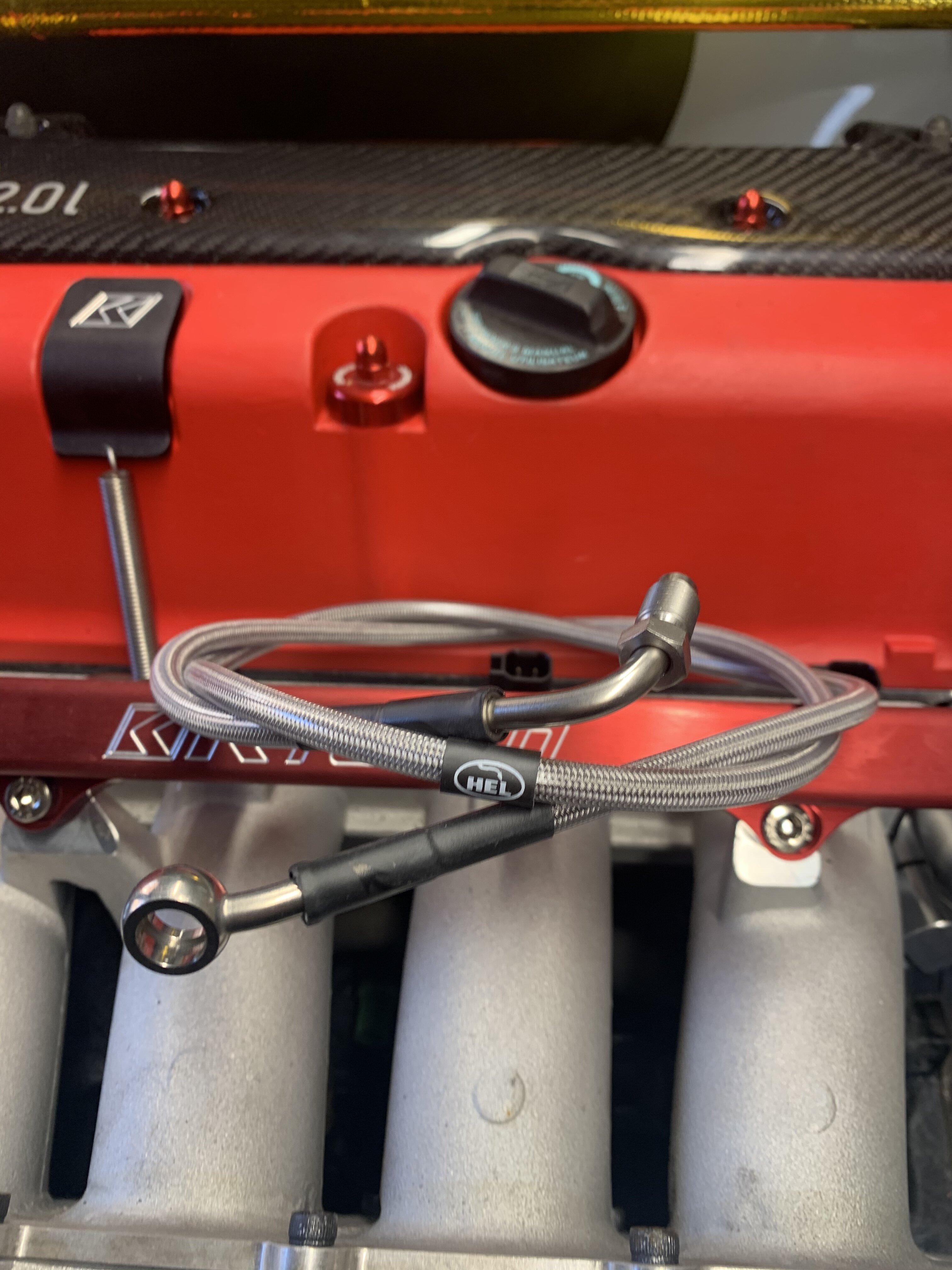

Got a new oil cap and coolant cap, I’ve also fitted a Ktuned recirculation hose, ordered a Ktuned blank for the housing and fitted the Ktuned coolant housing.
Also ordered the clutch hose from HEL
Glad you’re happy with it mate! Looks spot on in there with the rest of the carbon! 😎
Yeah well happy. Took a few brave pills to drill through it mind 🙈 but was fine 😂 rather that than make new bloody hoses 😂
Ties the engine and dash together nicely
