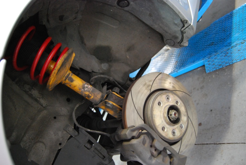

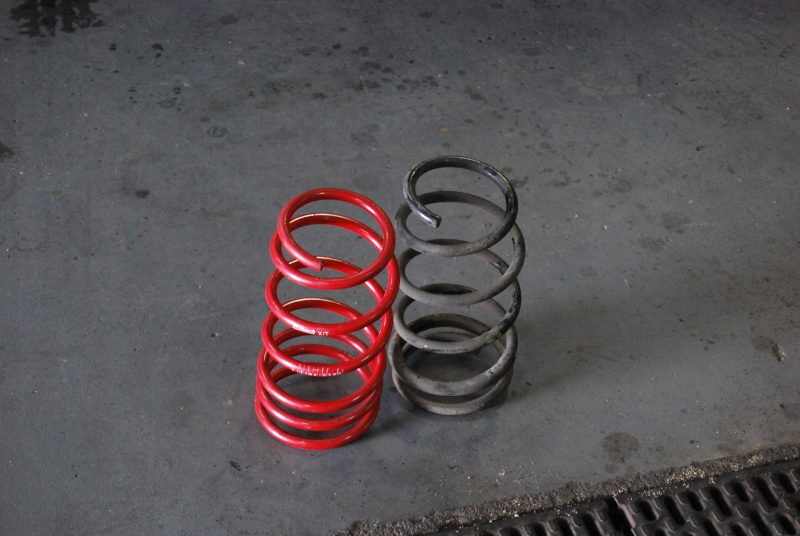

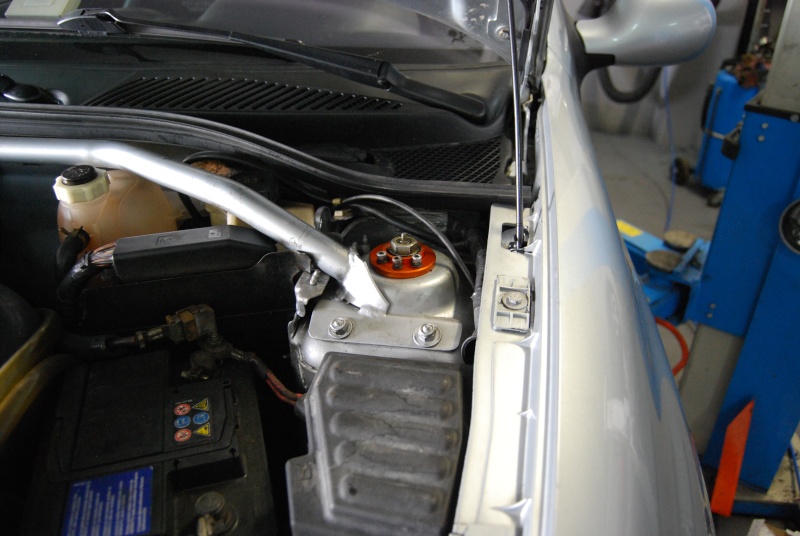

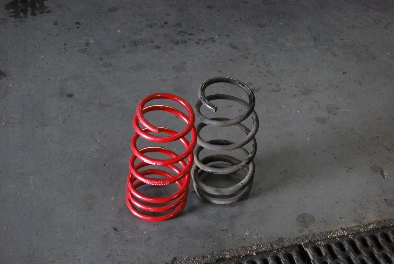

Eiback Sportlines + AST top mounts
Before:
There he goes..
All ready for the doctor...
Springs... old(cup ones) and new

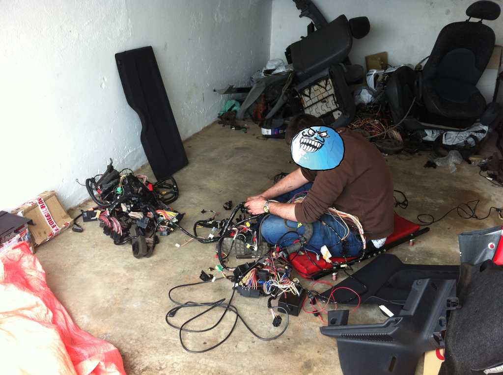

The wiring.
We had to attach a UK (RHD) wire whith GPS wiring with an LHD with ESP, cause my car is 2001 and didn´t had ESP to start with, it didn´t even had Cruise control. (But not anymore :p)

With all the pieces together, it´s time to start the transformation. We had to take all the wiring from the engine bay, fusebox to license plate light, including all the interior antenna too.

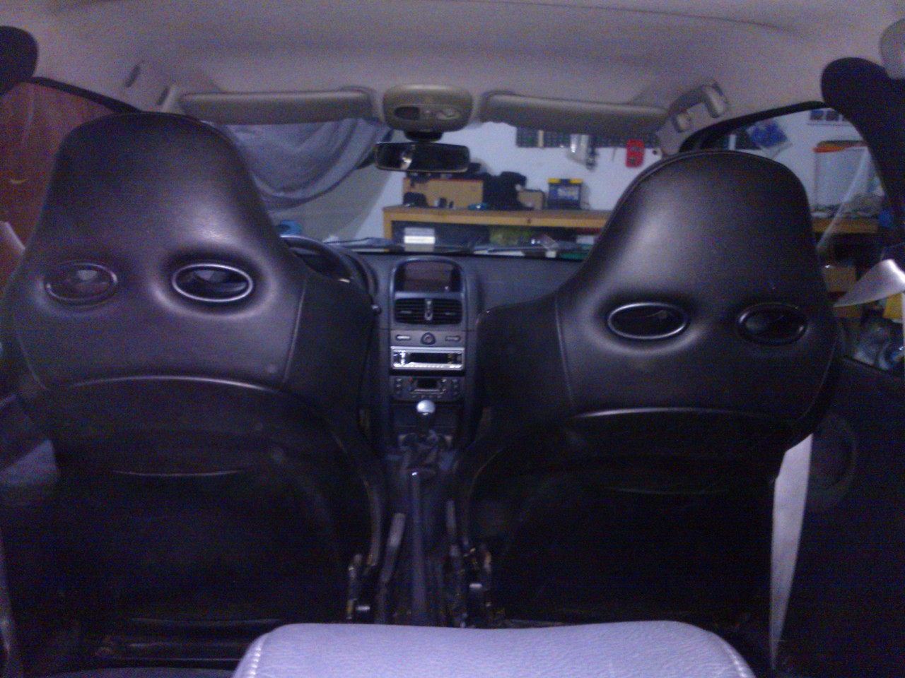

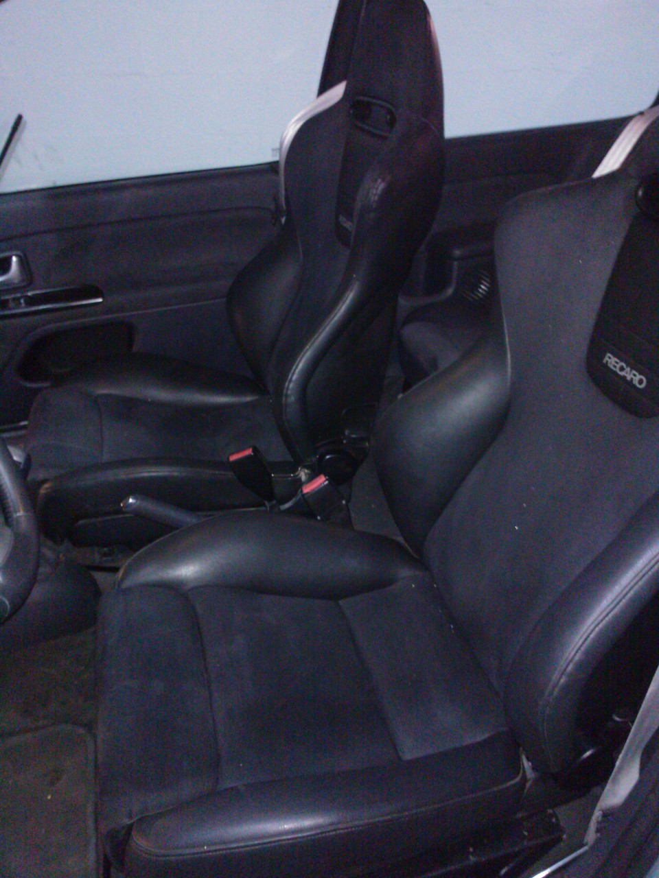

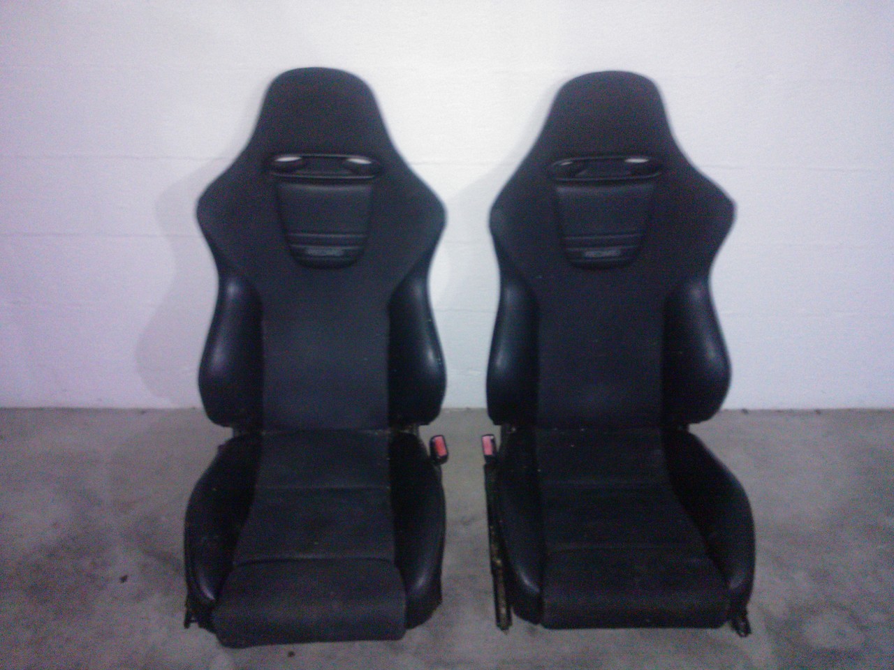

And last but not least, my cherry on top of the cake!!!! :rasp:
Gps was hard to get, but theses babys... You wouldn´t believe!
Took me a while but i got them!!!
:hail:

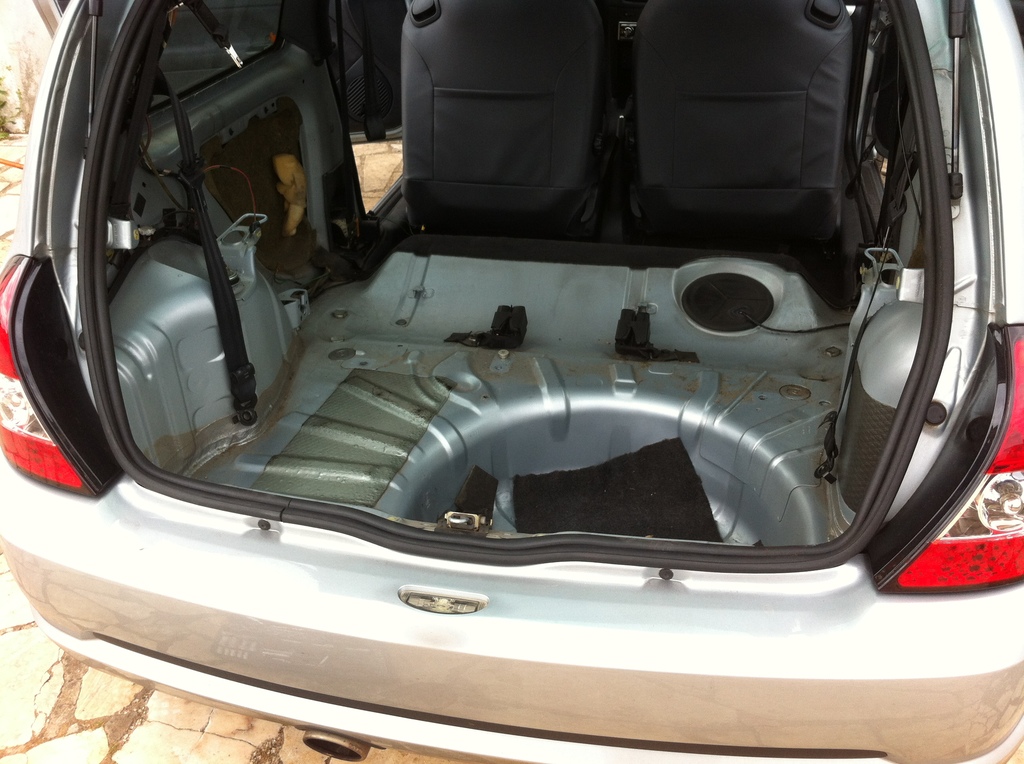

With this i had to downgrade the rear seats to 172 to perfectly match the recaro´s.
  F4R mk2 ph2
