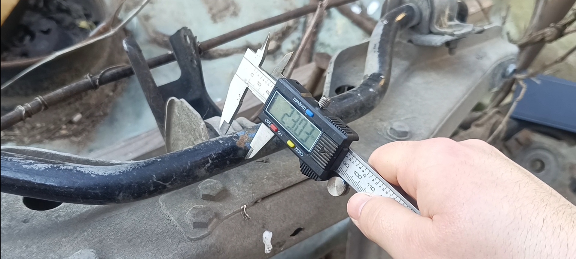

Greetings brothers, I need your help!
I have a kangoo 1.4 torsion bar but it's 23mm thic and there were four thicknesses 22, 23, 24, 25mm, and I'm looking to buy one thicker an 24 or 25mm, and the internet is full of very cheap bars, but in none of the ads does it say how thick it is, and that's why I want to ask you kindly, if anyone wants to help me, let me know, if on the 1.5 dci and 1.9 dci variants, the bar is thicker, if it is 24 or 25 millimeters, so that I know what to buy, because I don't want to place the order and when it arrives I see that it is still 23 millimeters ! 🙂
I am also attaching a picture to illustrate!🙂
