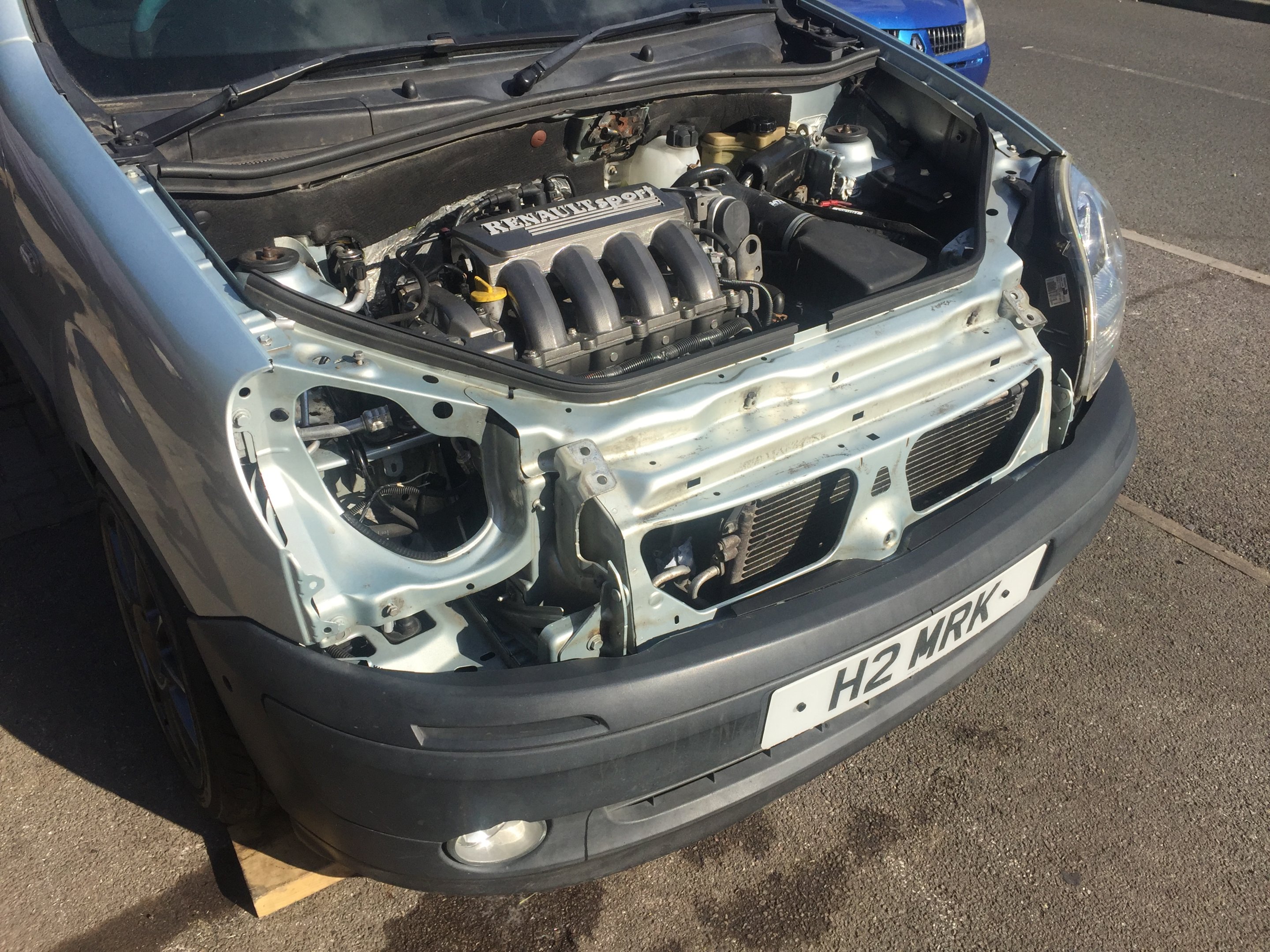

Oh and.....started the engine for the 1st time!!!!! Runs fine and exhaust sounds great!
Over the past few weeks I have managed to Finish all the wiring on the conversion, this involved matching up the Clio looms with the Kangoo switches and lighting. A big thanks to @Brigsy for all his help and sending over plug wiring diagrams for the Kangoo.

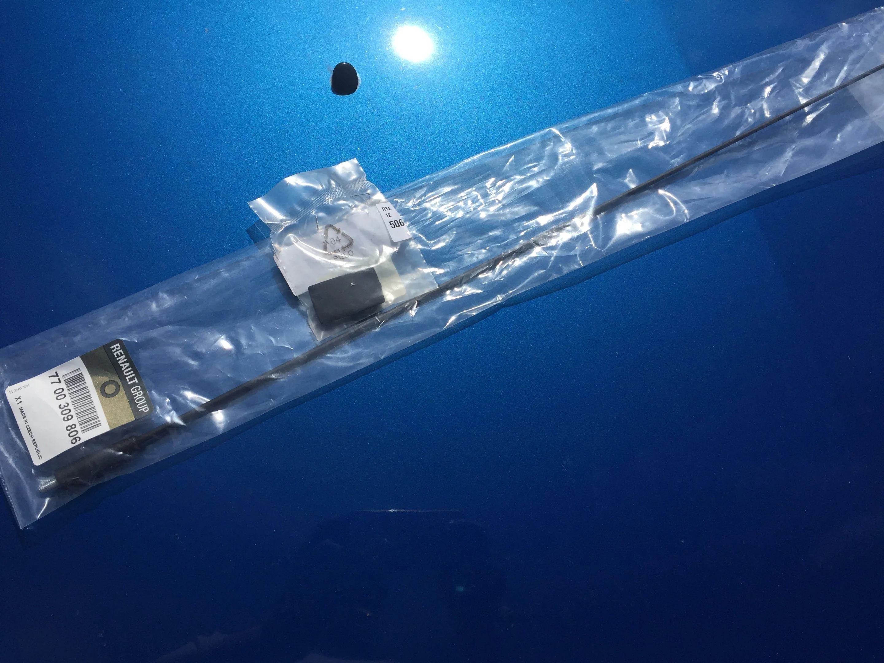

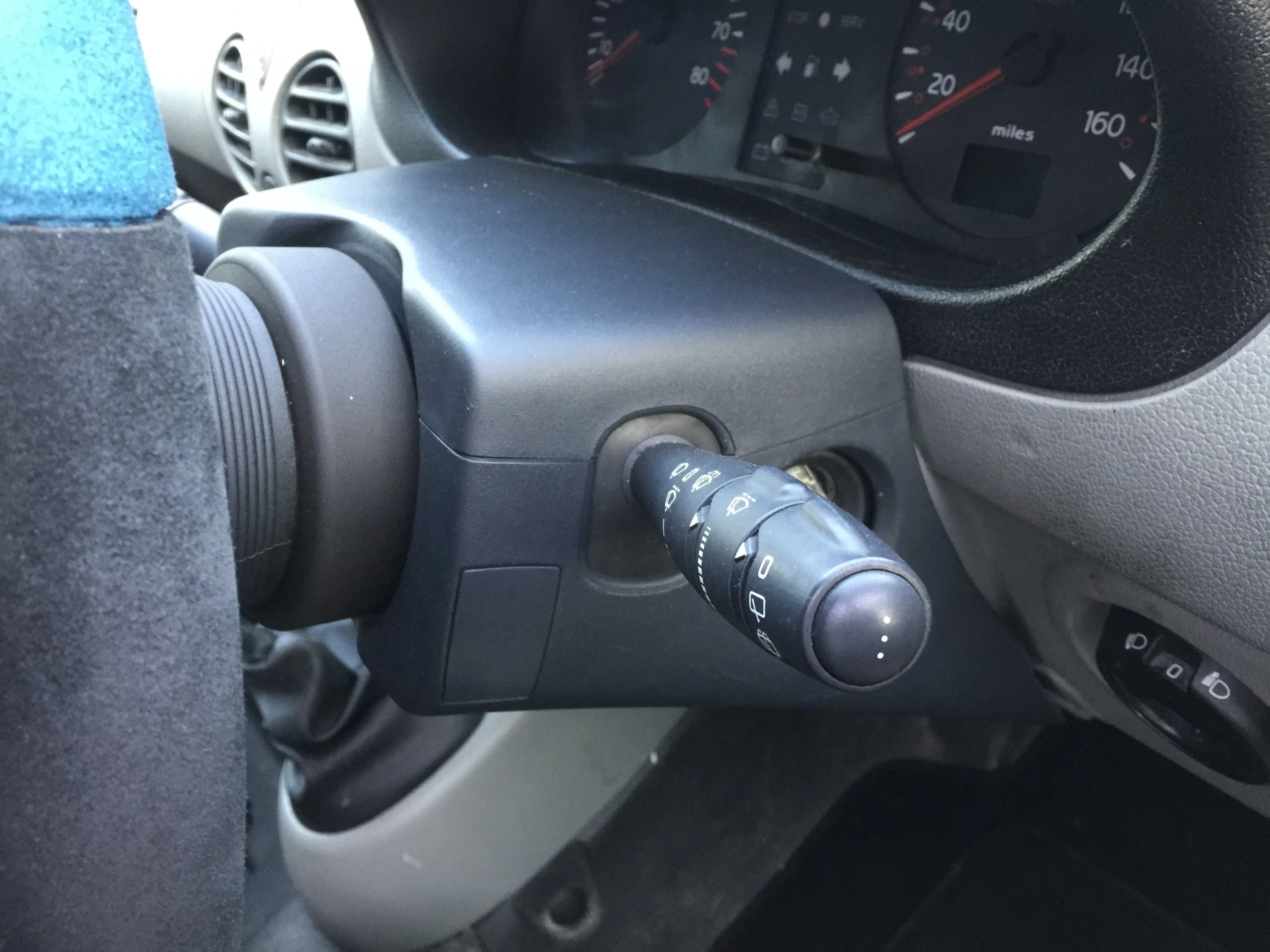

Also purchased a new aerial and blank for the steering column where the stereo remote would normally be.

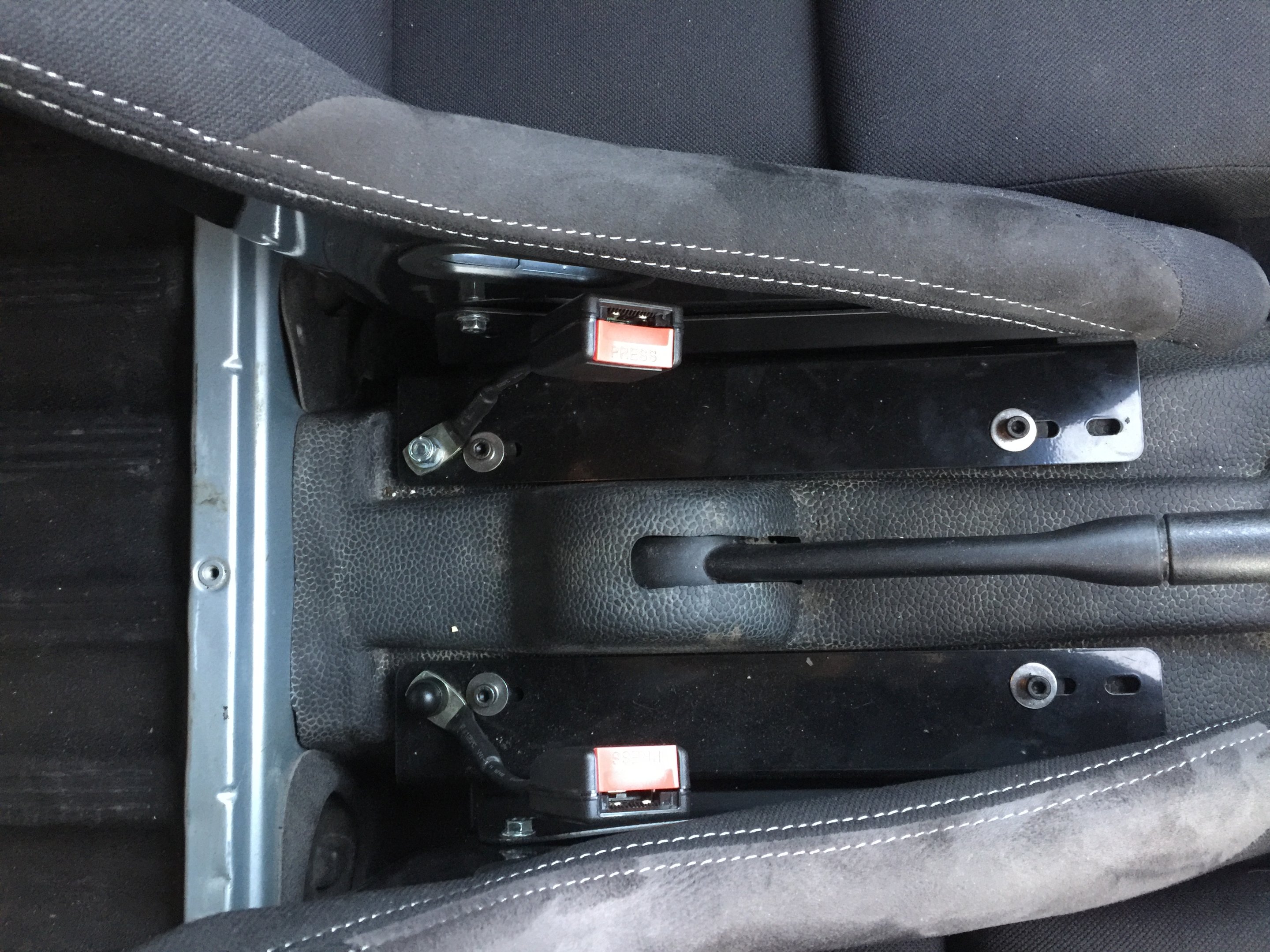

Now all the wiring has been completed I could finally fit the passengers seat, seatbelt buckles and all the trim back in.

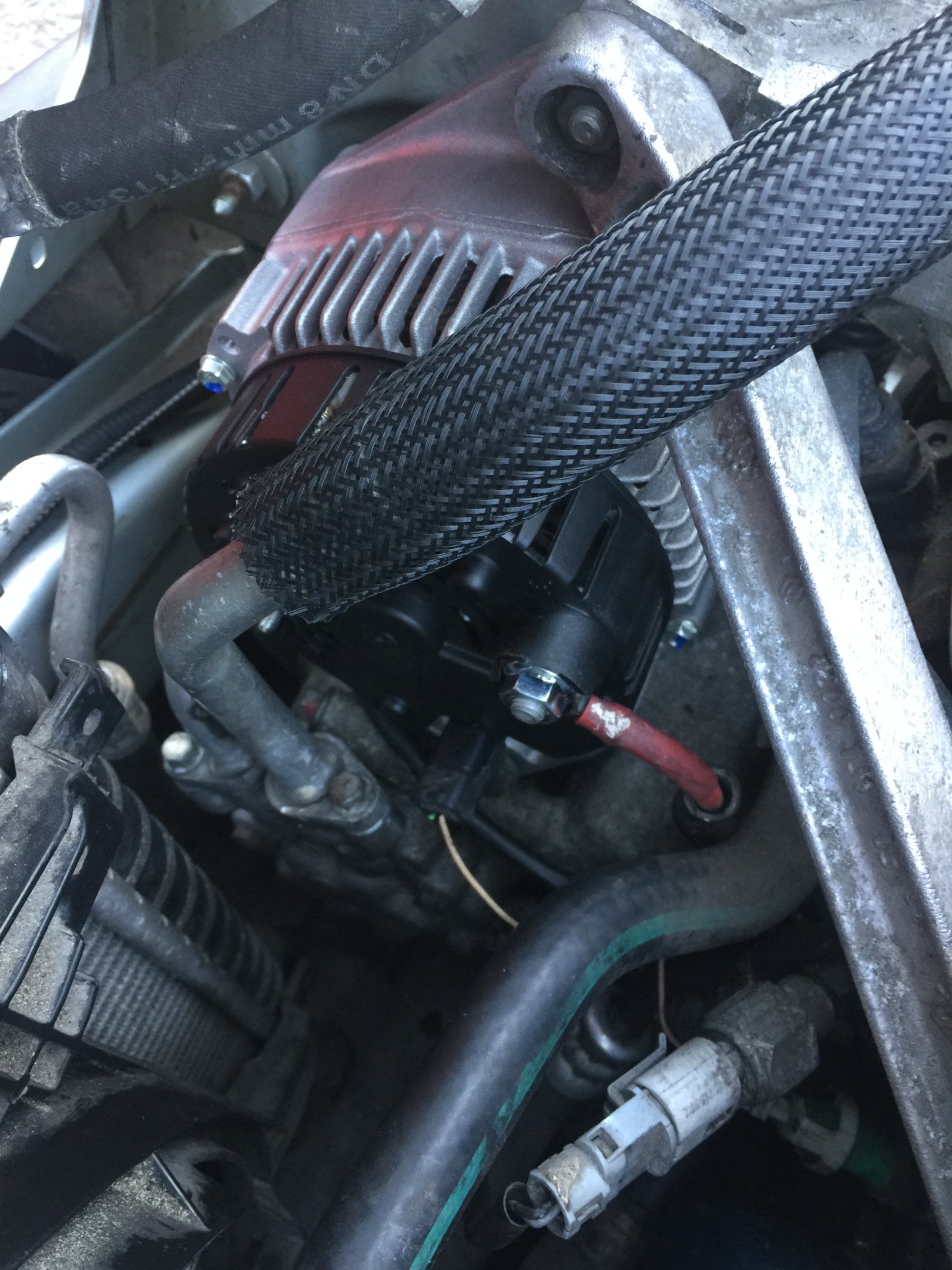

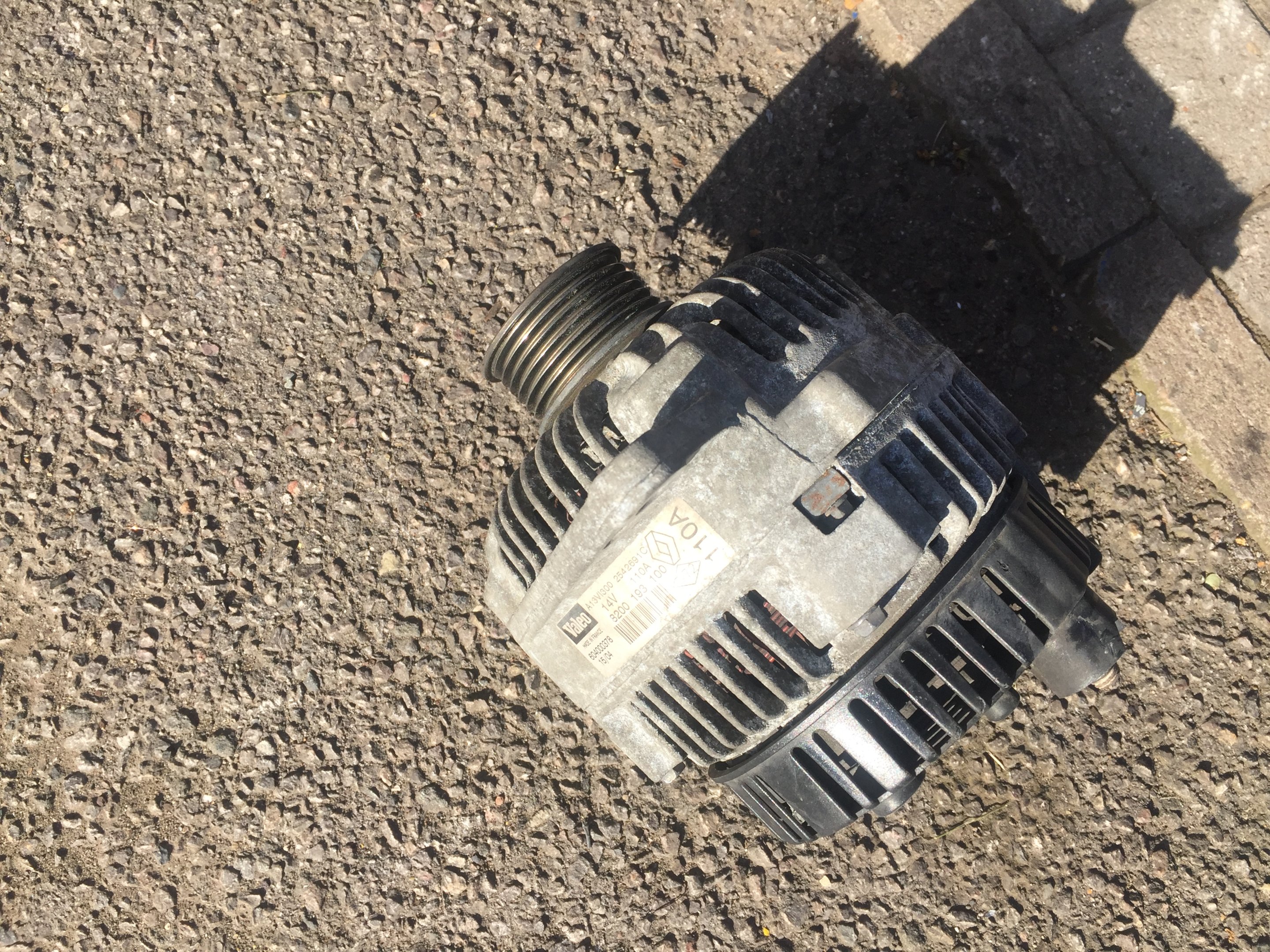

Started the engines and smoke started pouring out of the bonnet! Quickly turned off the engine and discovered a smoking alternator. Think as it had been sat for a while it must have seized. So had to remove bonnet, grille and headlight to gain access, luckily managed to get it out without removing the bumper and front section, was tight but once I removed the fuel rail guard it came out.
So after a hunt around I decided to go for a genuine Renault one, so quick call to Paul @RPD and the next day a shinny new alternator arrived and was fitted that evening. Old one was then returned to them for and exchange refund which I did not know they offered as not shown on there web site but this made them the cheapest place to buy from.

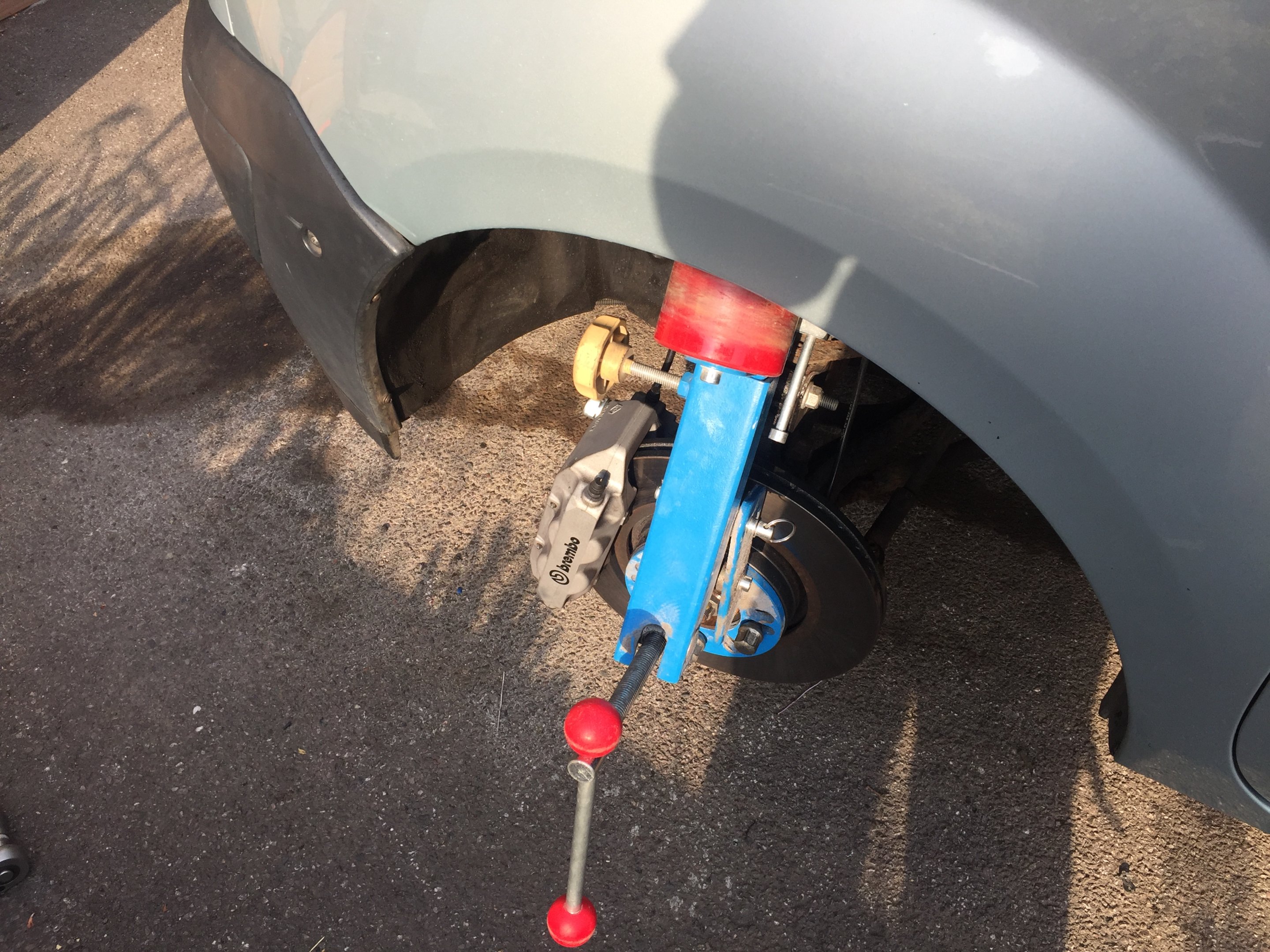

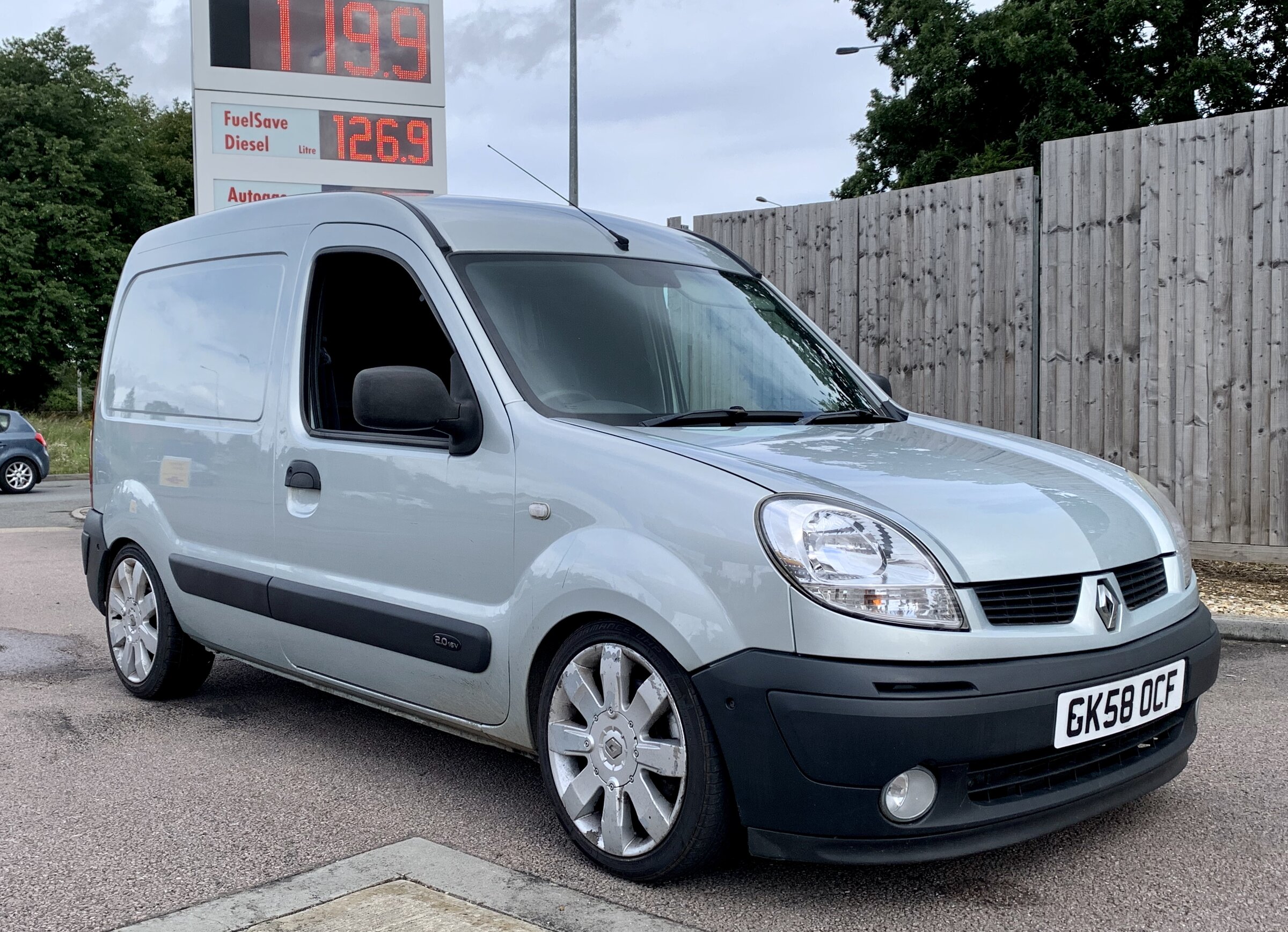

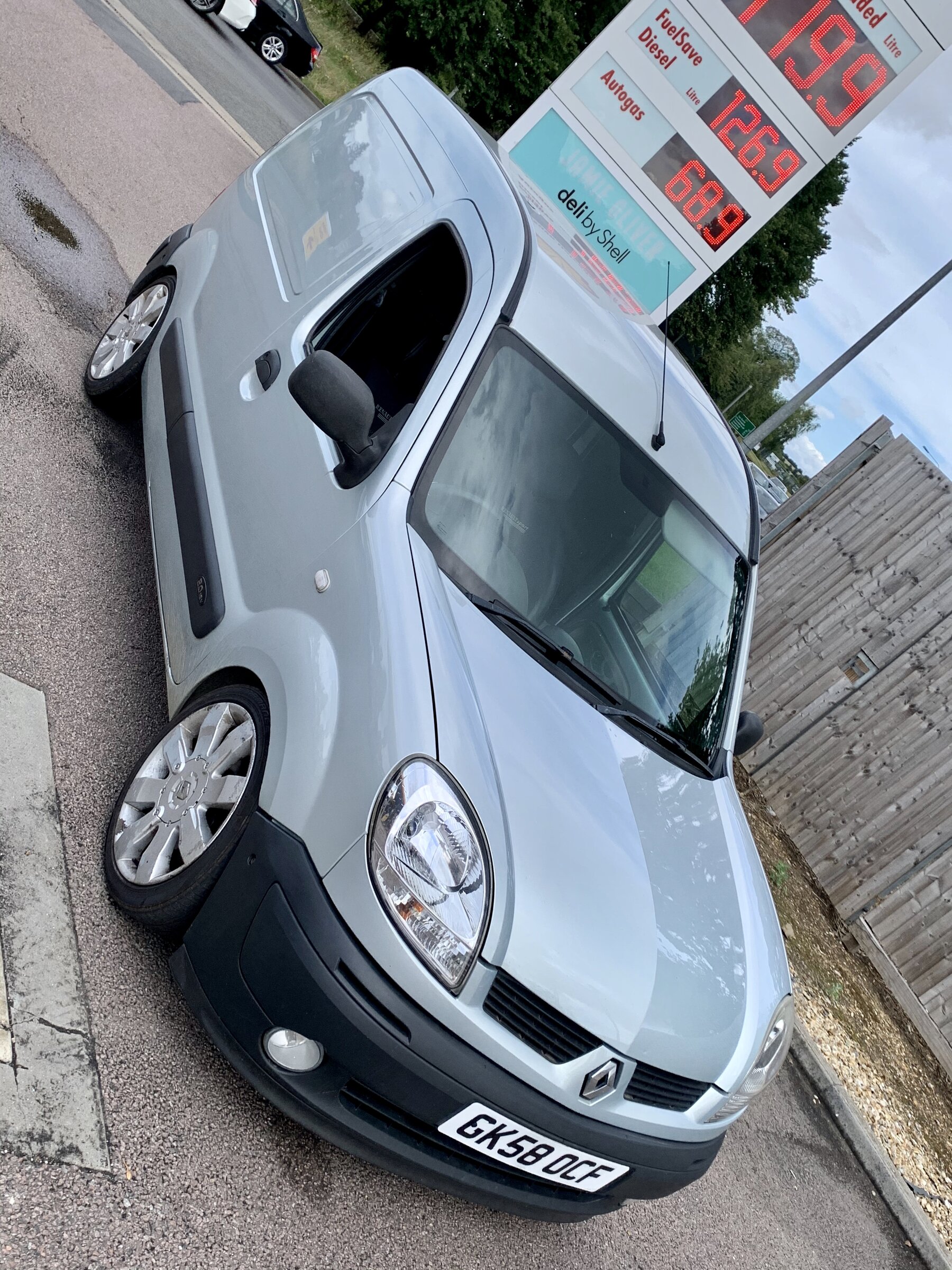

So 3 weeks using this as my daily and it’s great fun to drive, had an issue with the front tyres rubbing at the front of the arch under compressing on bumpy roads and it was worse on the drivers side.
So took some measurements and found the drivers side wing needed some adjustment, took bumper off and loosened front mounting point for wing and managed to pull the wing forward, now have the same gap on both sides.
Also as a precaution I rolled the lips on both front wings. I borrowed a arch rolling tool and set to work.
This has now cured most of the rubbing issues, still get a little bit on very bumpy roads so looking to have the front of the arches pulled out to match up with the bumpers as if you look in the photo you can see the arch dips in where it meets the bumper.
Also undesided on the bumpers, original plan was to colour code them and leave the black inserts but now I’m unsure....

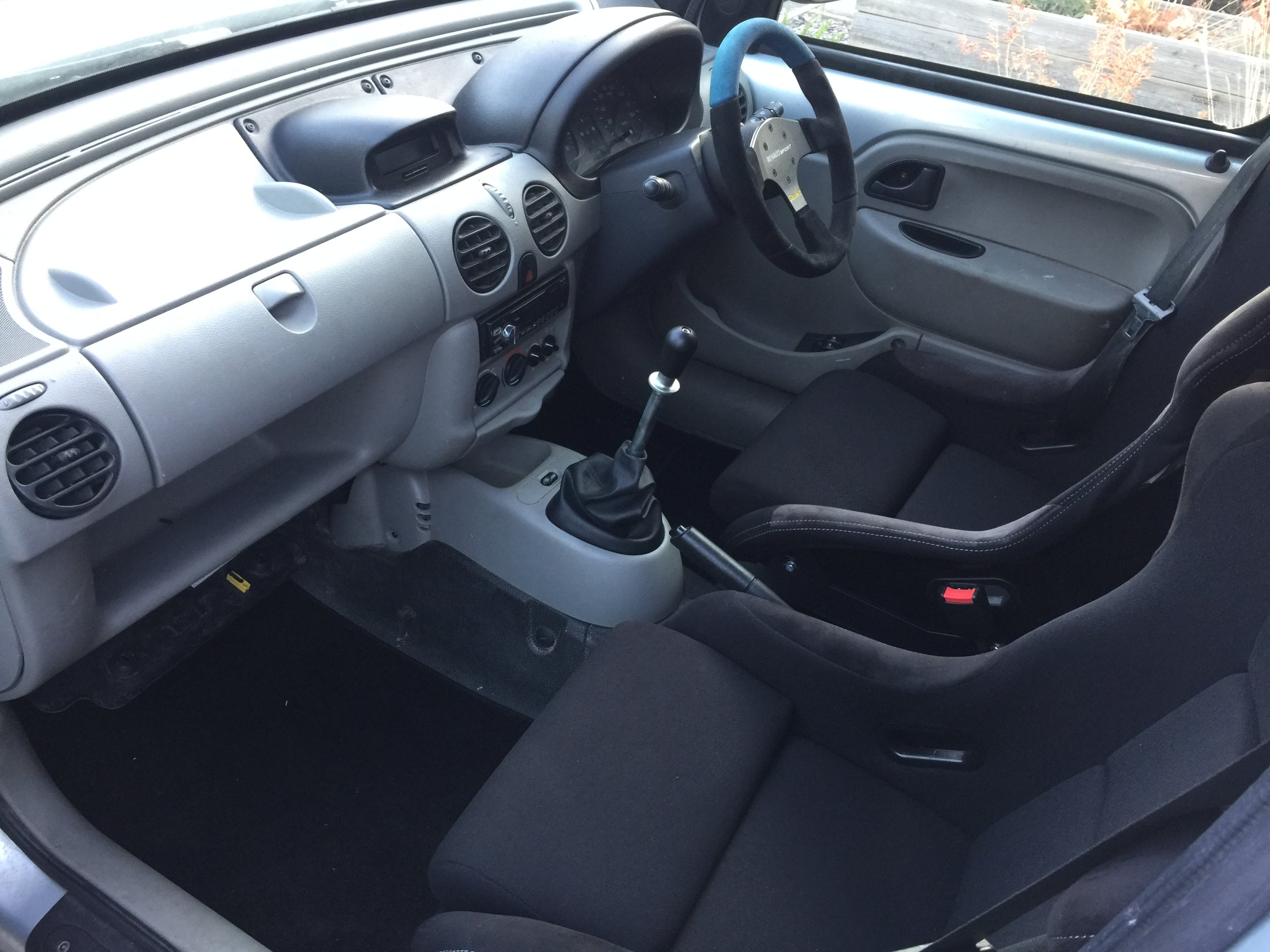

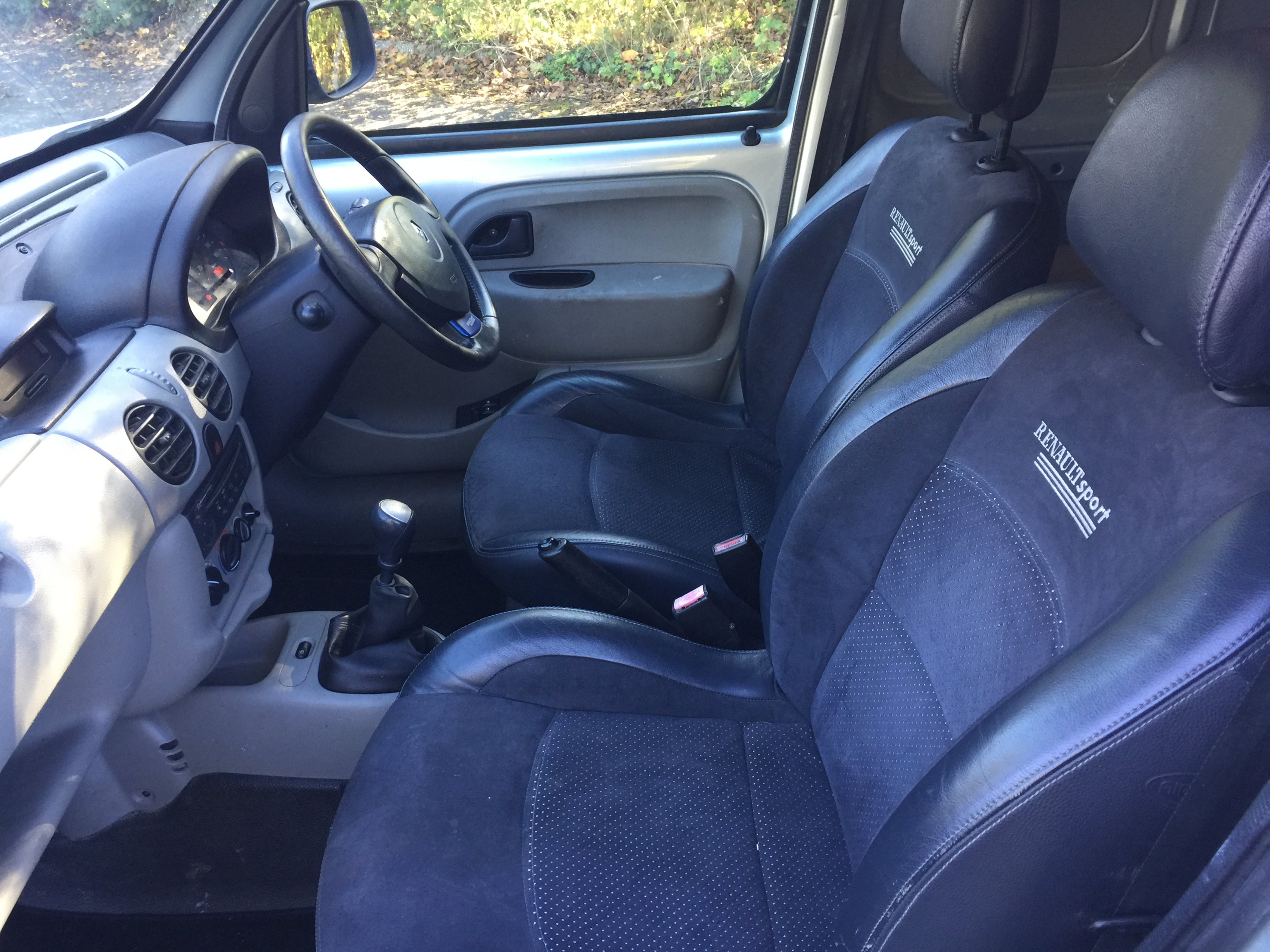

Not updated this for a few months...the van has had a few changes over the past months as I sold some of the track focused parts due to another project needing a cash injection.
It is now running 182 wheels and I have fitted a pair of 182 seats, 172 Cup steering wheel, 182 shifter & 182 standard front discs & calipers.
It is now a much better for daily use to the the seats and seating height.

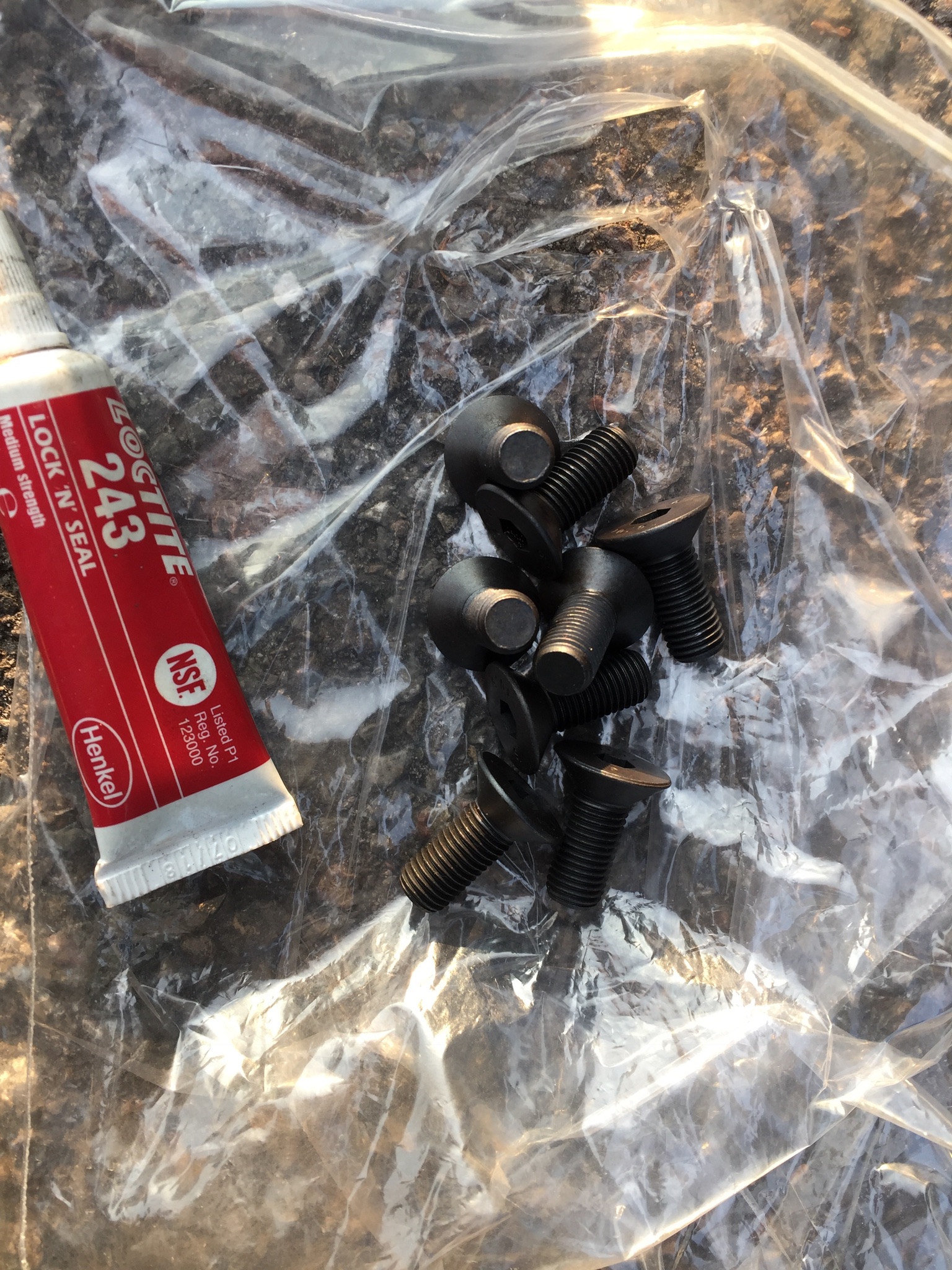

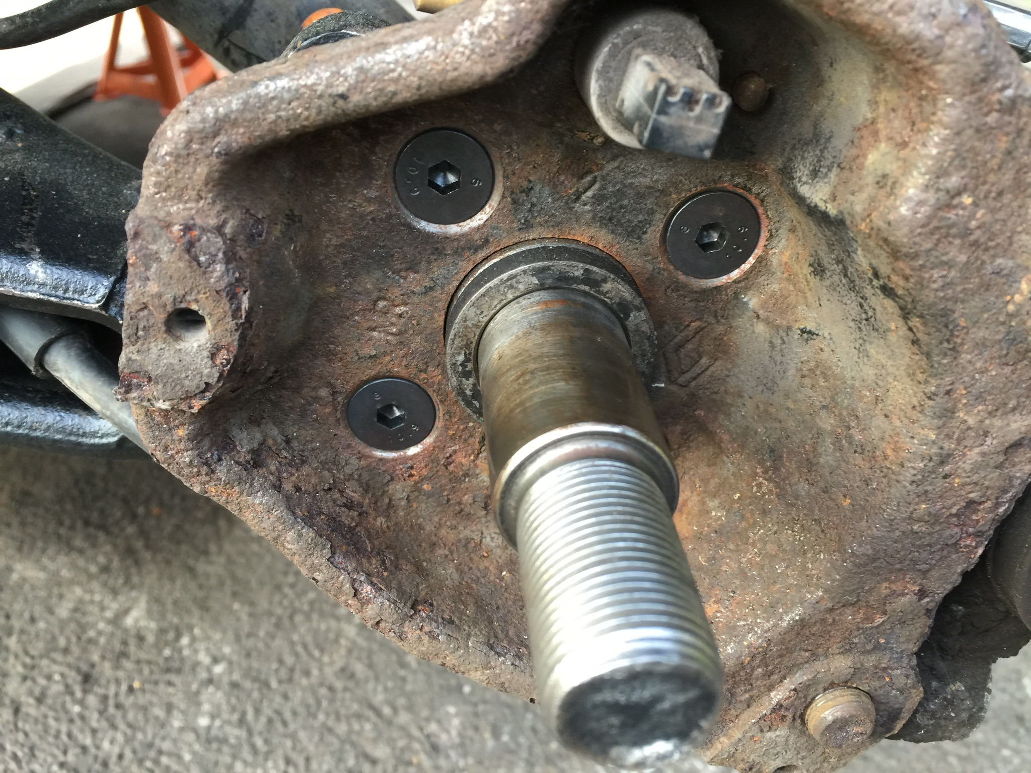

Managed to get some time to work on the van yesterday to finish a few of the little jobs, first up was to fin the 1mm thread countersunk screws for my rear disc conversion, struggled toscource these due to the fine thread but Mark Fish came to the rescue.
View attachment 1367912View attachment 1367913
Then reassemble rear disc and callipers and proceeded to bleed the brake system, only to have a massive fail due to a buggered master cylinder! Luckily I has a spare and got that swapped over and then all went ok.
Last up was to sort out why I could not select reverse with the PMS shifter, after some comparison with a Clio I worked out that the tunnel on the Kangoo is higher and was causing the linkage rod to hit the subframe. So ended up dropping the selector assembly by approx 20mm using some spacers and can now get reverse.

I know this is a couple of years ago but I’m struggling to get the same 1mm pitch countersunk screws pictured here. I’ve emailed mark fish, no response yet, but it’s only been a day or 2.
Do you know of any other suppliers or the Renault part number??
Cheers!
Mickb
  van low and 1.6 16v
Any engineer shop would have them im sure. I've got stainless ones find them on ebay. Work fine. Or you could drill and tap it to m10
Trackslag172
  03 Clio 172
I’m planning to drill and tap to m10 this week.
Finding m8 countersunk bolts with a 1mm pitch is almost impossible.
