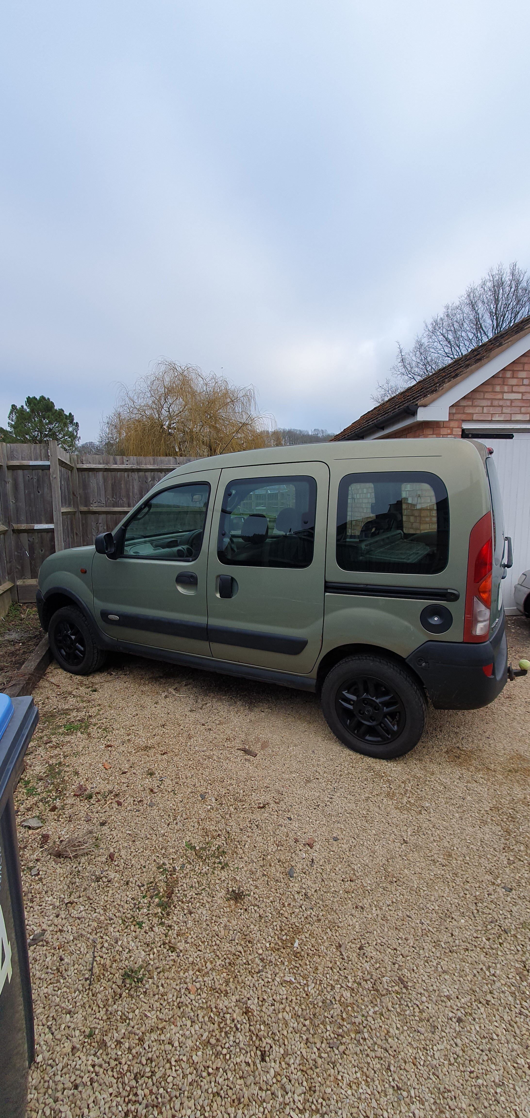

Just flew to Scotland (proof) to buy a 2002 Kangoo 4x4 1.6 16v after years looking for one but it seems like the K4M is quite tired after the 7 hour drive (head sounds like a box of nails). There's plenty of oil but doesn't seem to be reaching the head for some reason. Girlfriend wasn't too impressed either😂 Will probably refurbish it but... been wondering how hard would it be to swap in something like an F4R into it? Can't seem find anyone who's done it and I wonder why. Would be a nice rally van😅
