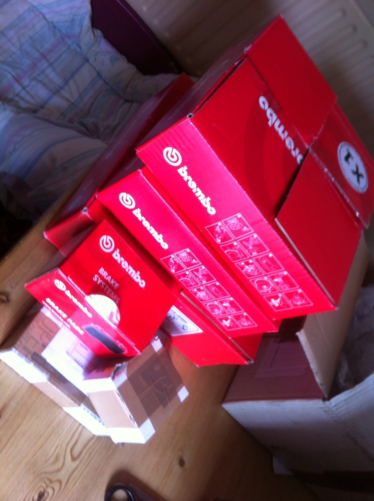

Anyways i have now ordered and awaiting delivery of :
Brembo rear discs
Brembo rear pads
Brembo front discs
Oem Front Pads
Drivers side Hub

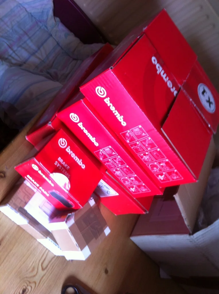

Parcels arrived today
Brakes all round and the hub turned up also along with spigot rings as 3 wheels were just running on bots not the hub

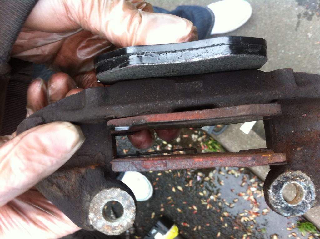

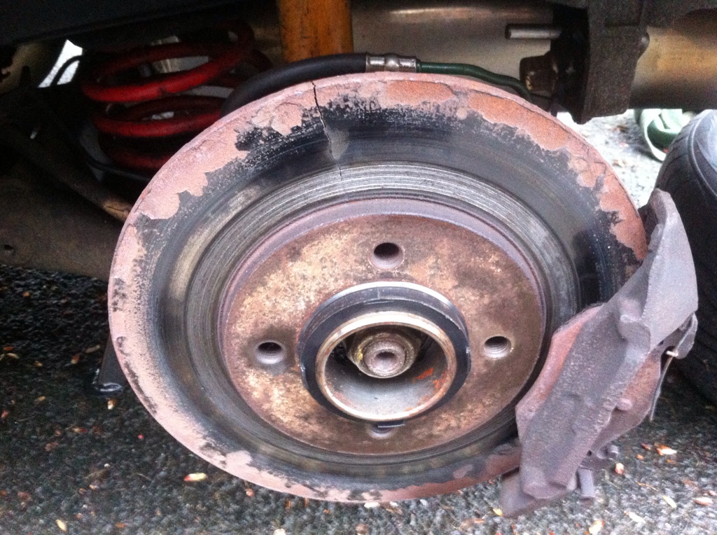

Well done the rear brakes
Old dangerous cracked disc
Wafer thin pads
So much better with new brajes
Little problem though, the head take seems rediculasy tight?
Yeaa in a bad state to say the least! Just unsure why handbrake is so heavy? Everything else seems fine so cant understand.

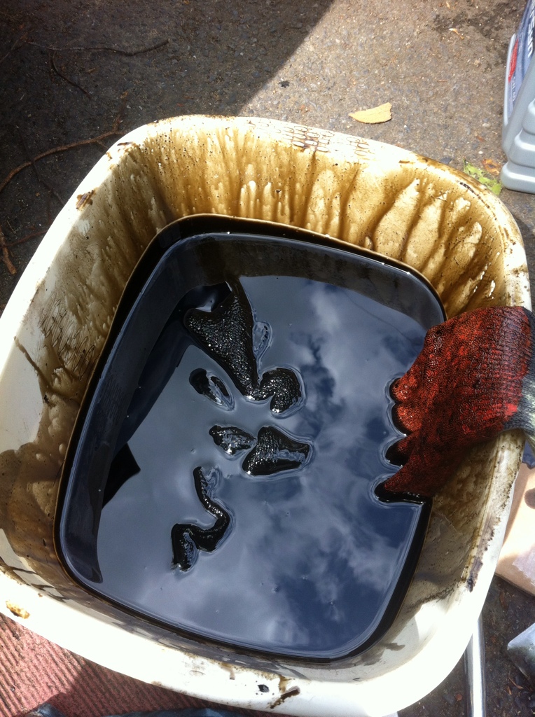

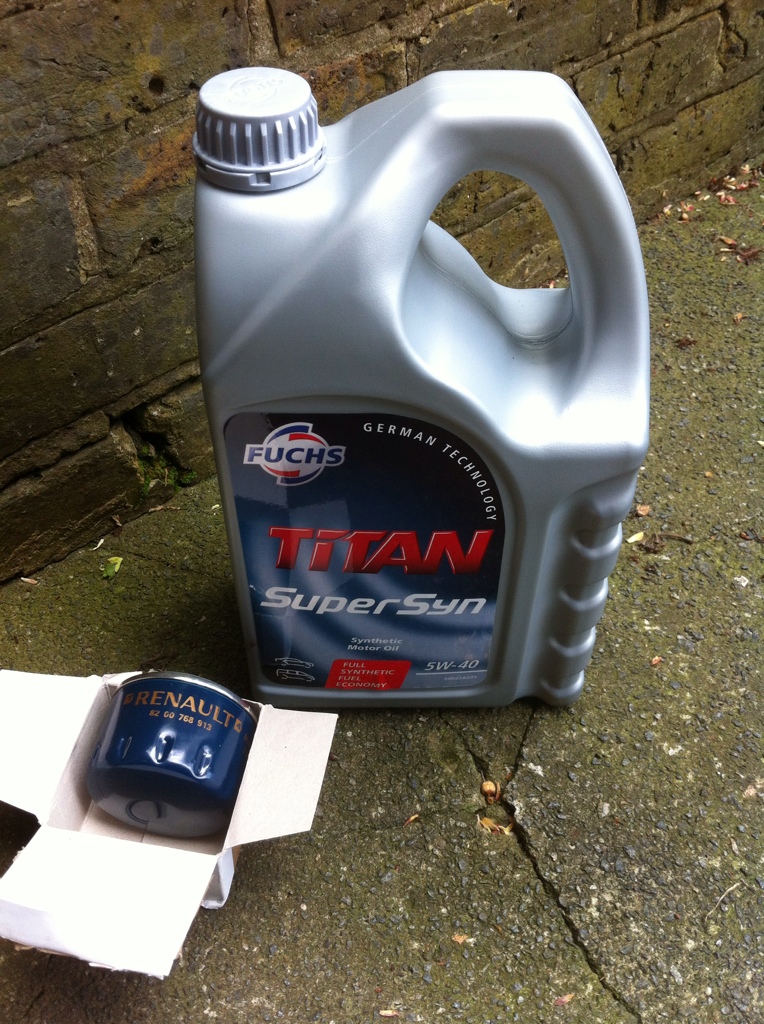

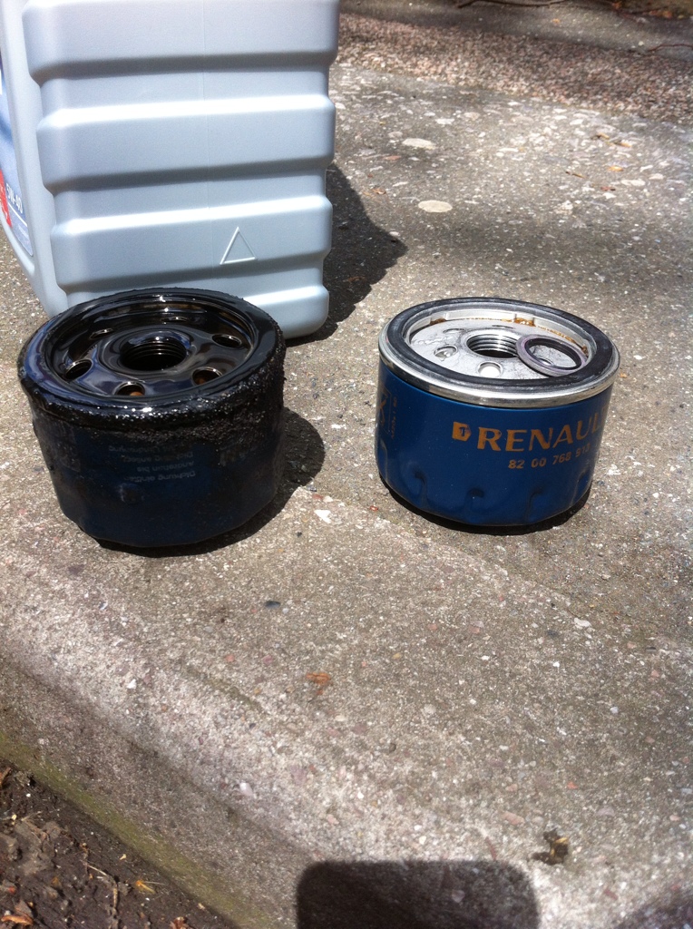

Well i cracked on with oil change this morning, thankfully the filter was nice and easy to get out. Used Fuchs Titan 5w-40 along with geniune filter and sump washer

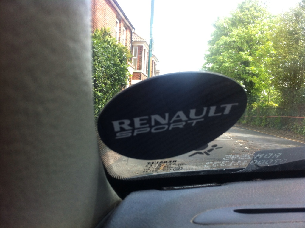

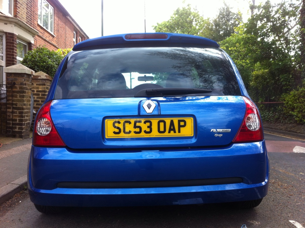

During this i got another little package and was my new RS badge so took off old ones and put on new leaving the cup badge also.
Before

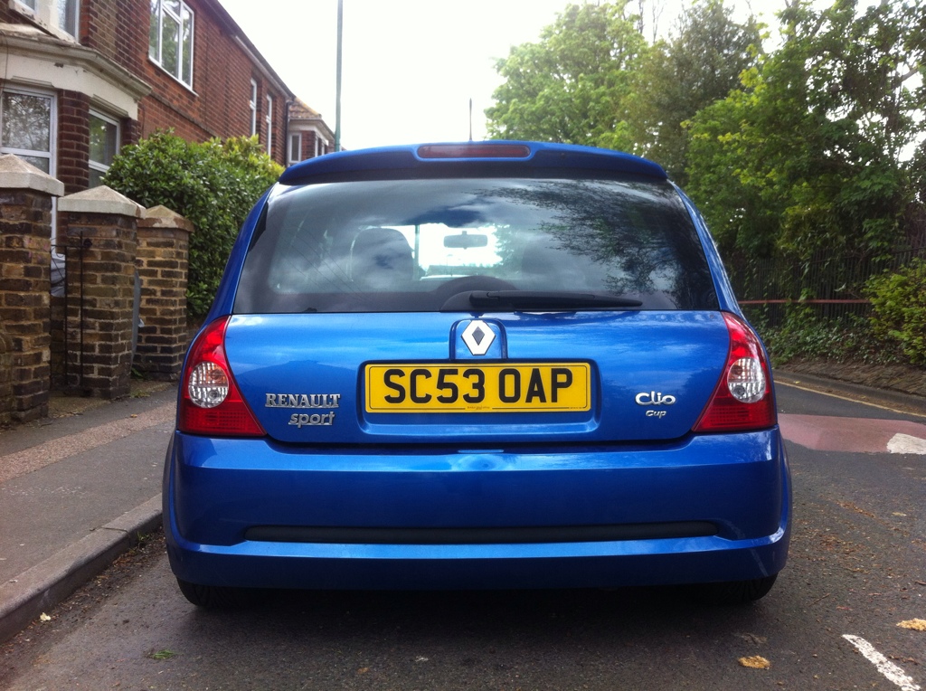

After (much better id say) Also sorted out rear number plate as was sitting way too high and loose

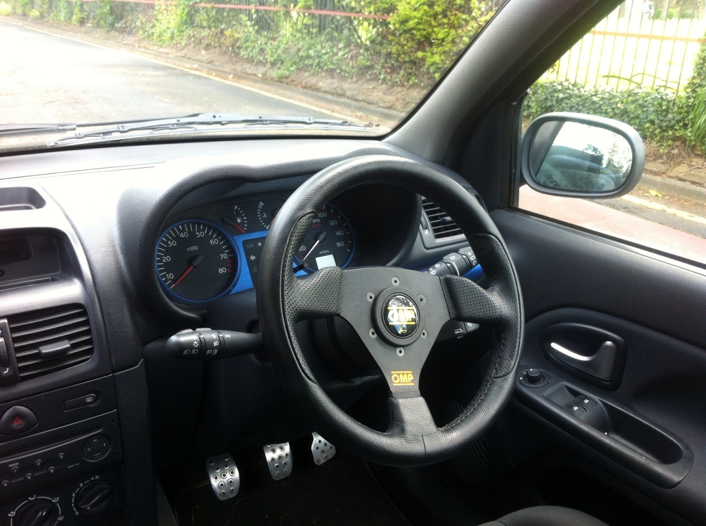

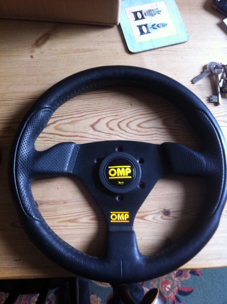

also Recieved my Omp 300mm wheel, feels soo much better to handle thanks to chris205 for getting it to me so fast, awaiting on airbag resistors and ph1 stalk
Fitted

Didnt realise dans car was such a dog, if that cracked disc is on the n/s/r then I ended up spending 3 hours removing the burnt on brake dust off the rear wheel.

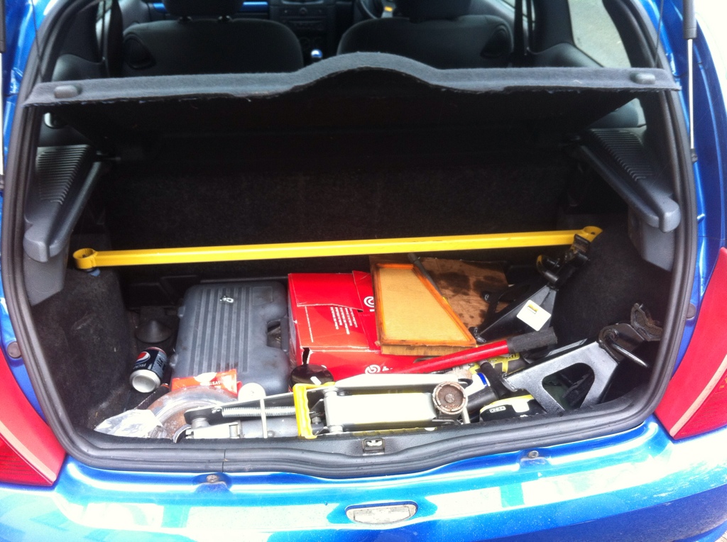

also got my rear strut brace already in yellow, not a nice yellow but will be resprayed at some stage

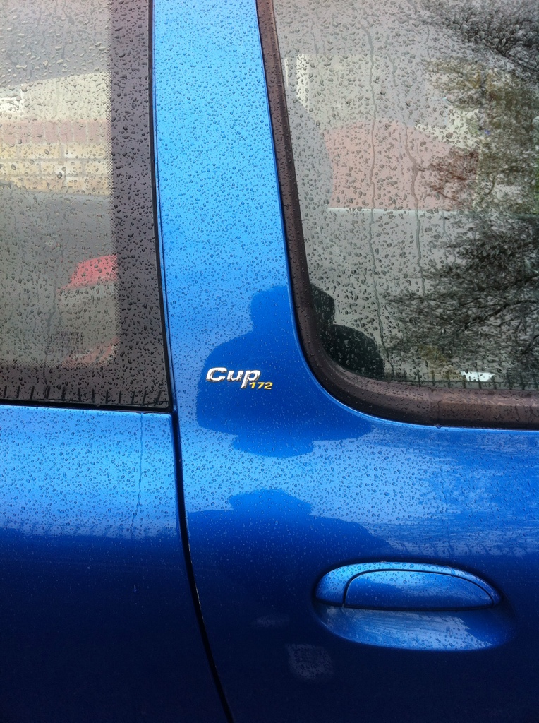

also fitted my cup 172 badges to the doors

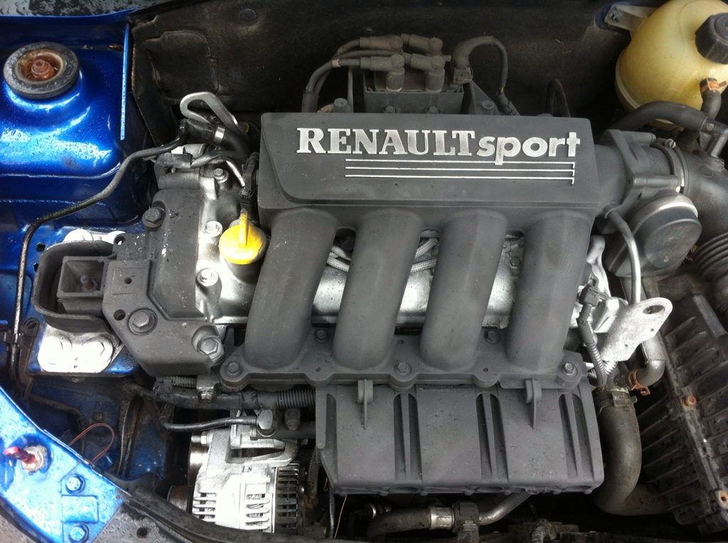

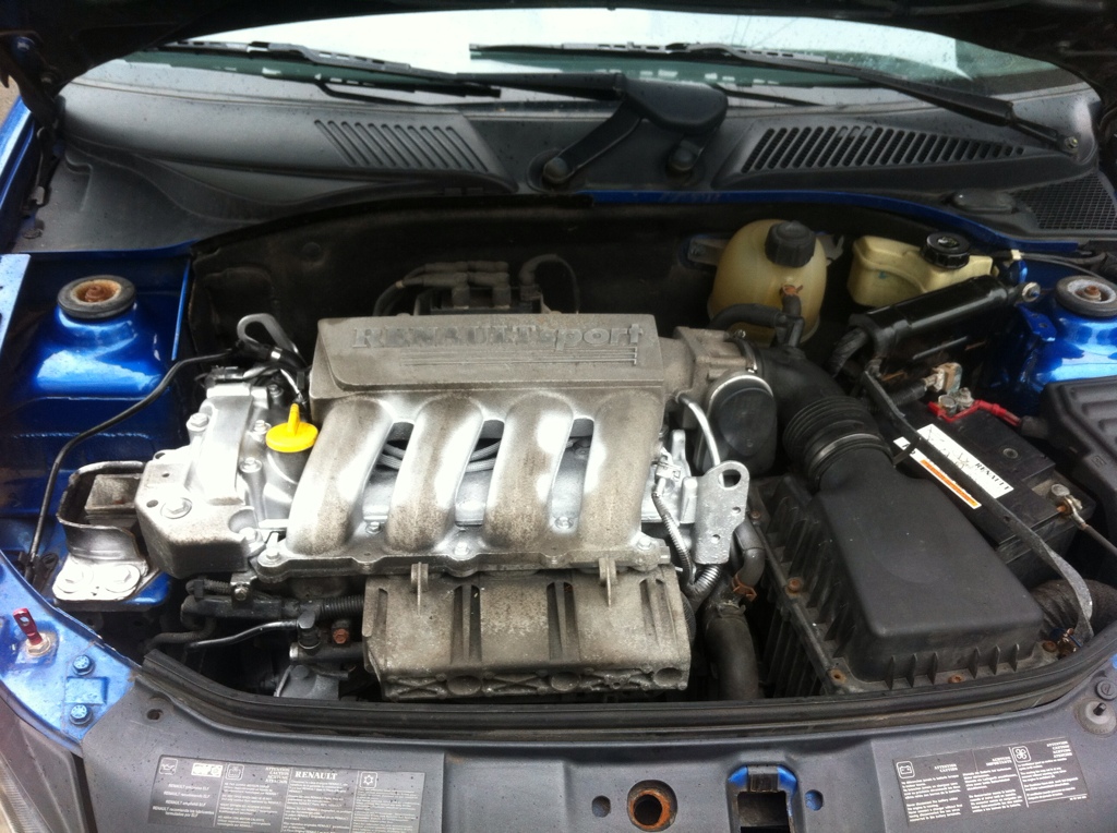

After the engine bay looking a right state, i have been meaning to do it and finally got round to it in the pouring rain lol so still needs tidying up but its almost there bar the oil caps etc and the engine mount brace i messed up a little bit
First i sprayed the bits i wanted silver including the alternator
then matt black on all the rest and the polished Renaultsport
So the car is finally getting all the attention it needed, looking loads better now and soon she will be on the road!
