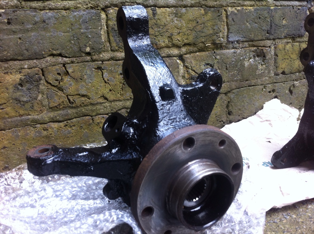

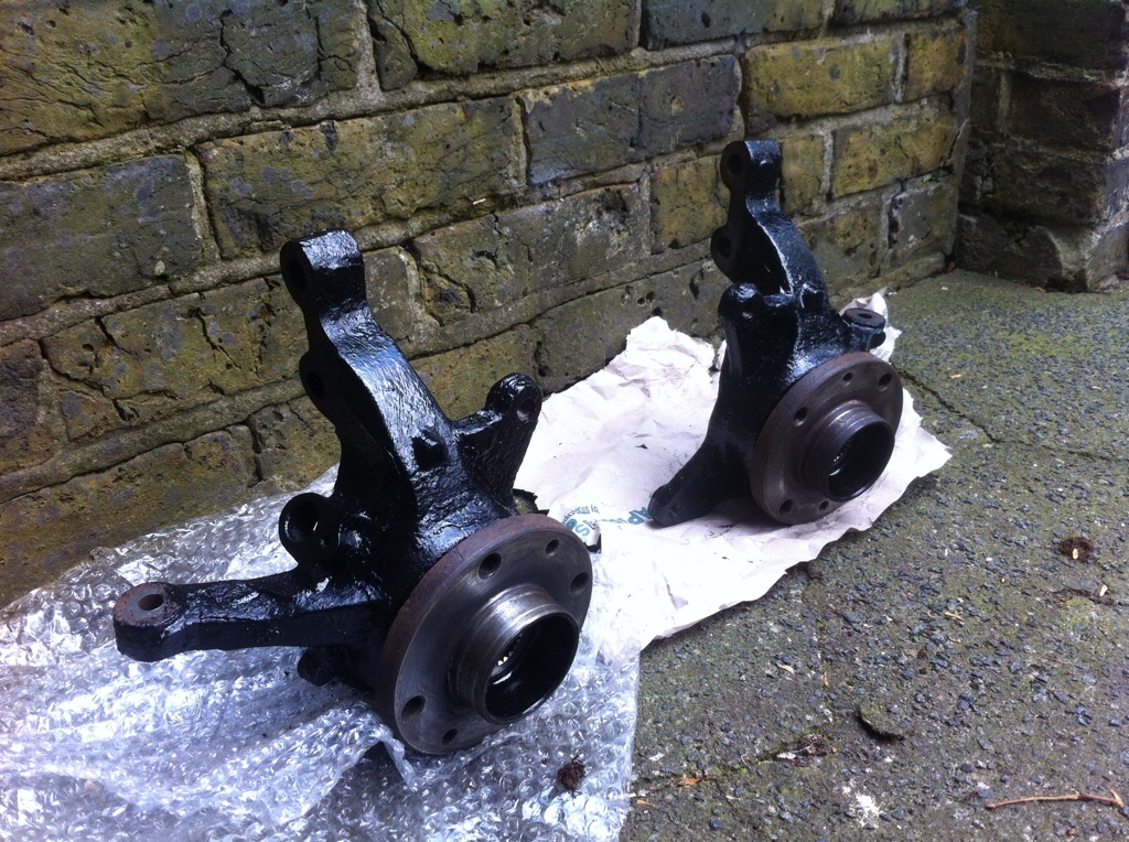

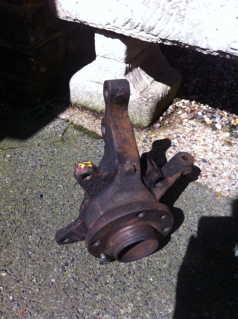

Started off with the 'new' rusty hubs that will be going on monday, gave them a good going over with a wire brush and then a couple of coats of black hammerite and look near enough new :)

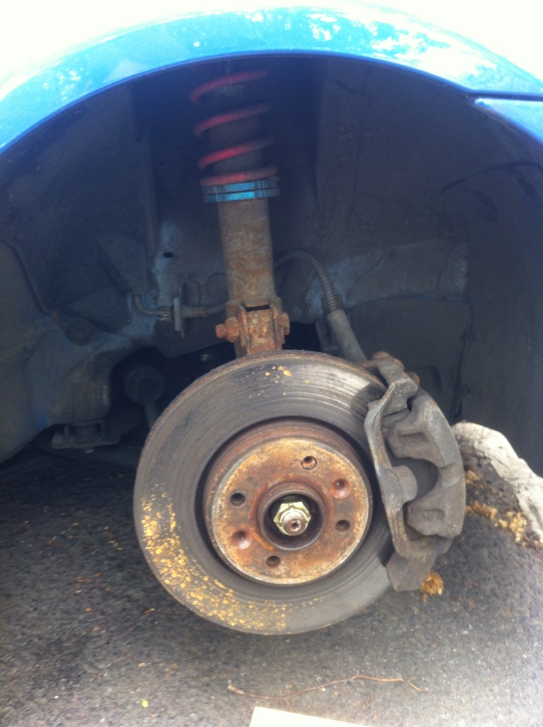

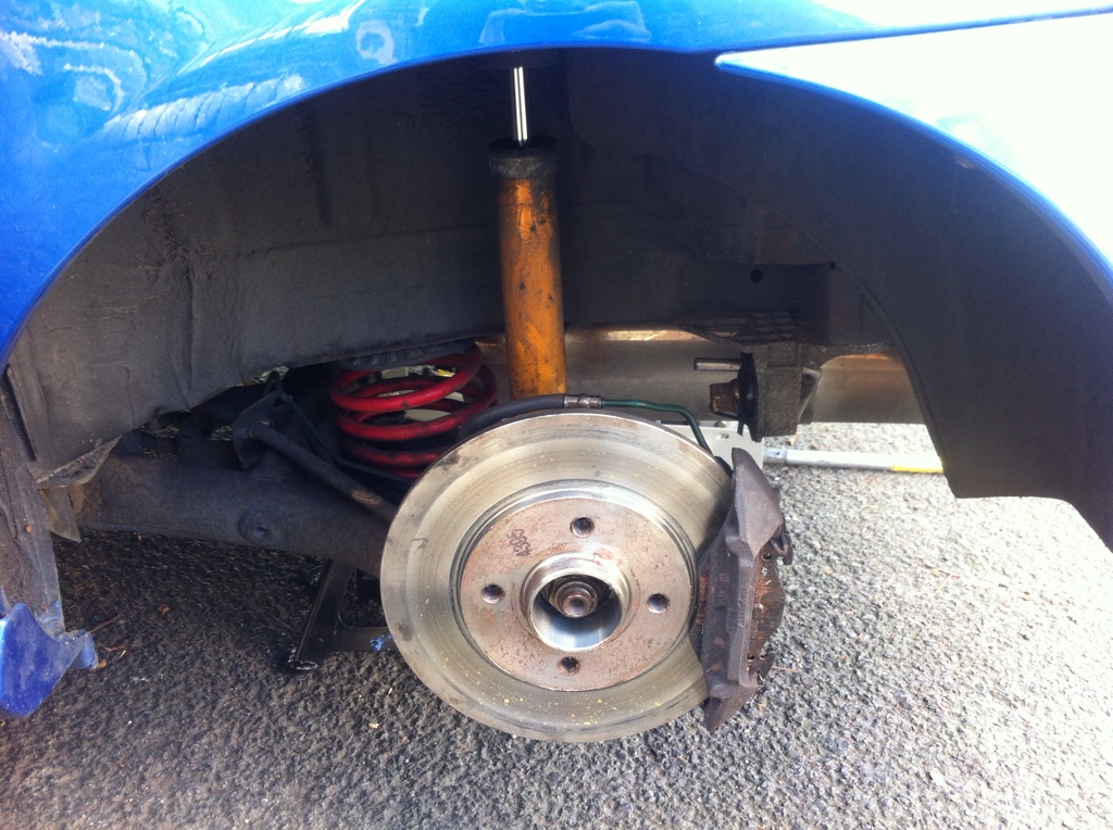

Then onto the brakes, ive previously had silver on my berg and just didnt stay looking clean for long so used more black hammerite
Before

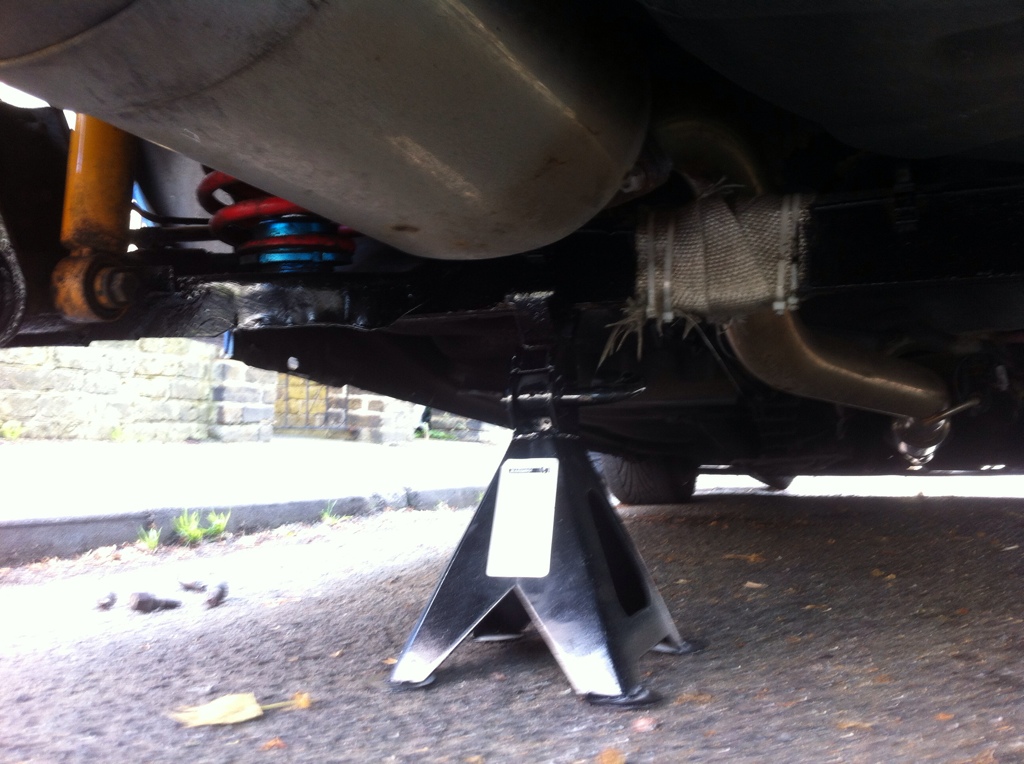

also got a bit carried away and ended up doing the axle etc too

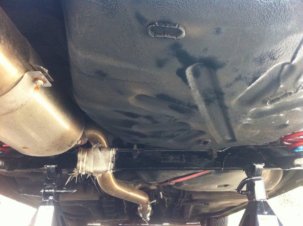

Also i then got more carried away with a can of high temp black spray and started spraying insides of arches and underneath, not much difference but better than before

Anyhow, why are you changing the hubs mate???
It really doesn't matter AT ALL if the disc retaining screws are there or not. Some cars/discs don't even have them.
You've got the four wheels bolts screwing the wheel to the hub, with the disc sandwiched inbetween.
Edit: Painting, do you know someone?
If you're going to go full respray, after seeing that one earlier, go grey!!!
  BlackGold 182
Thanks rob! Well One of the hubs has half a wheel bolt in it and no retaining screws and makes an awful noise so can only assume its that, the wheel bearing is fine so I don't no what else it would be. Seems too much of a Coinsidence.

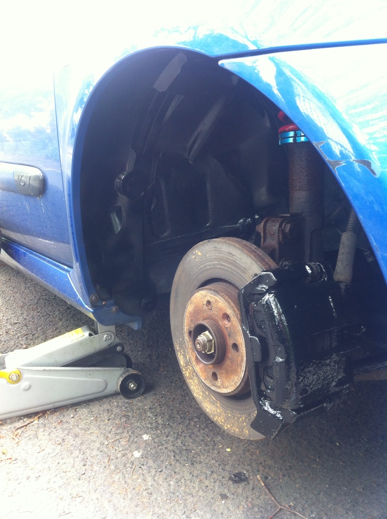

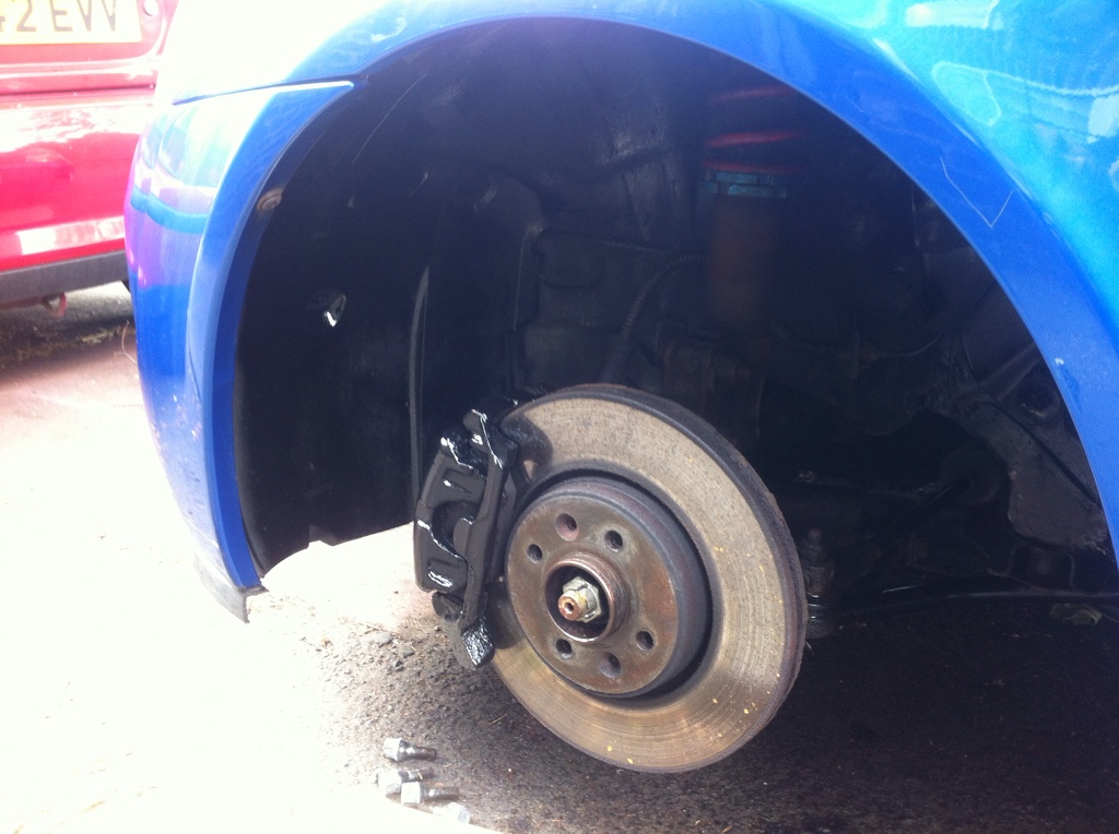

Well got round to painting calipers on front ready for when new discs, pads and hubs that go on Monday. I also sprayed all inside the arches gloss black
