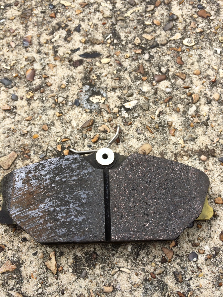

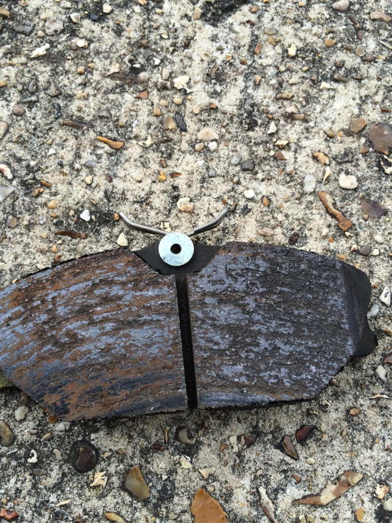

The last track day I did, I had to emergency fit some £17 halfords pads in the paddock area after the ds2500's fell apart after 2 laps.
I shared the car with a mate so it was out all day and the brakes were fine! Obviously not as responsive as the higher end stuff but no fade, no pad deposits and no disc warping.

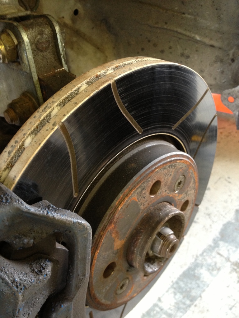

I have yellow stuff all round with standard rear discs and Brembo front discs bradded hoses all round high boiling point brake fluid no fog lights car stripped 2 seats 6 point roll cage and I am having problems with my front EBC yellow stuff pads after 10 laps at Rockingham
  clio 172
Would the blue stuff be better or Carbon Lorraine pads or should I ditch the Brembo disc
Really getting fed up with it tbh
My missus drives the car on track with no problems
I can drive it also no problems bit a soon as I try running it at race pace I end up with no brakes very quickly

I'd keep the brembo discs but get better pads. There's been plenty listed in the thread mate.
  182cup & 172 racecar
I would try the blues, they are for a slightly heavier car. Don't worry about bits coming off, that means they are working.

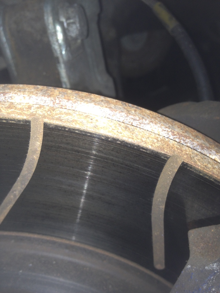

I warped a set at Anglesey on the GP layout (warped or not, the symptoms were the same).
I assumed it was an isolated incident until someone else mentioned it.

I mounted the DS2500's and did quite some filing down on the backing plates. Terrible stuff , just changed back to OEM pads.. Even when the brakes were not on , the wheels did not run freely and got real hot. The braking (after running them in properly) was also not all that . The OEM's (just now running 30 miles) are already far better. Mind you i don't do track but very spirited road driving.
A genuine f**king loss of money, these Ferodo's. Shame, but hey i learn every day

Never used ds2500 as they're just a road pad basically aren't they? CL RC6 I use but they are dusty and noisey lol
