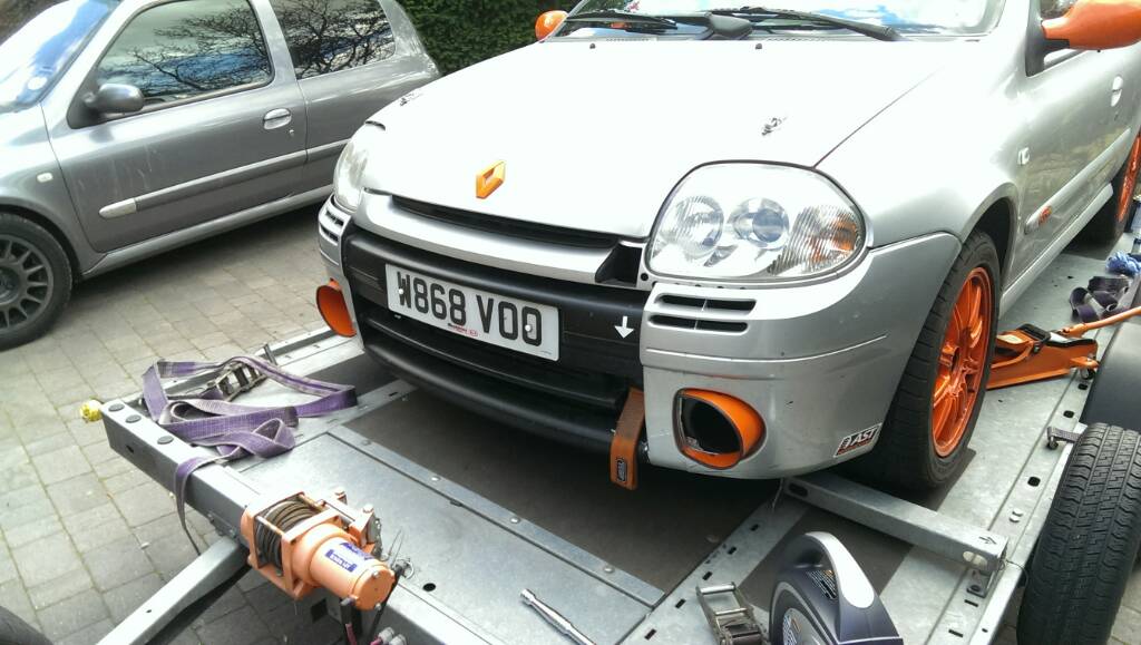

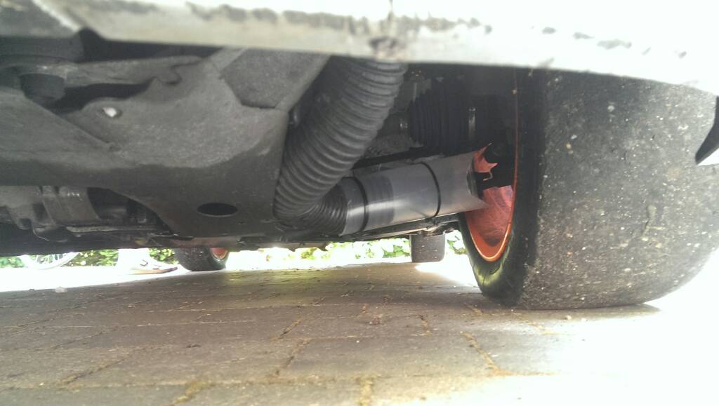

I always end up cooking brakes. Currently running the following;
RC8 pads
Brembo HC
Castrol SRF
Homemade ducts and scoops
The ducts have been improved since I last went out so we'll see how it goes.
Next stages are an anemometer at the end of the duct for testing different designs and stainless steel backing shims. If that doesn't work I might try machining some Macor shims
Cub.

Personally, i think you are better off just removing everything (i.e. fogs/arch liners) - having air flowing over everything is much better than directed through some poncy 3" pipe imho. Unless of course its designed using CAD & a wind tunnel because Racecar, which it wont be lol.
What makes you say that?
  172 Track Car
Having tried both ;)
Do a few laps with pipes from fog lights through holes in arch liner.
Do a few laps with everything ripped out.
Any pics? I desperately cooked them with everything ripped out. It's better now with ducts but still not where I want it.
Sir_Dave
ClioSport Trader
Pics of what lol. I just removed the fog lights & the arch liners, then put them in the bin
