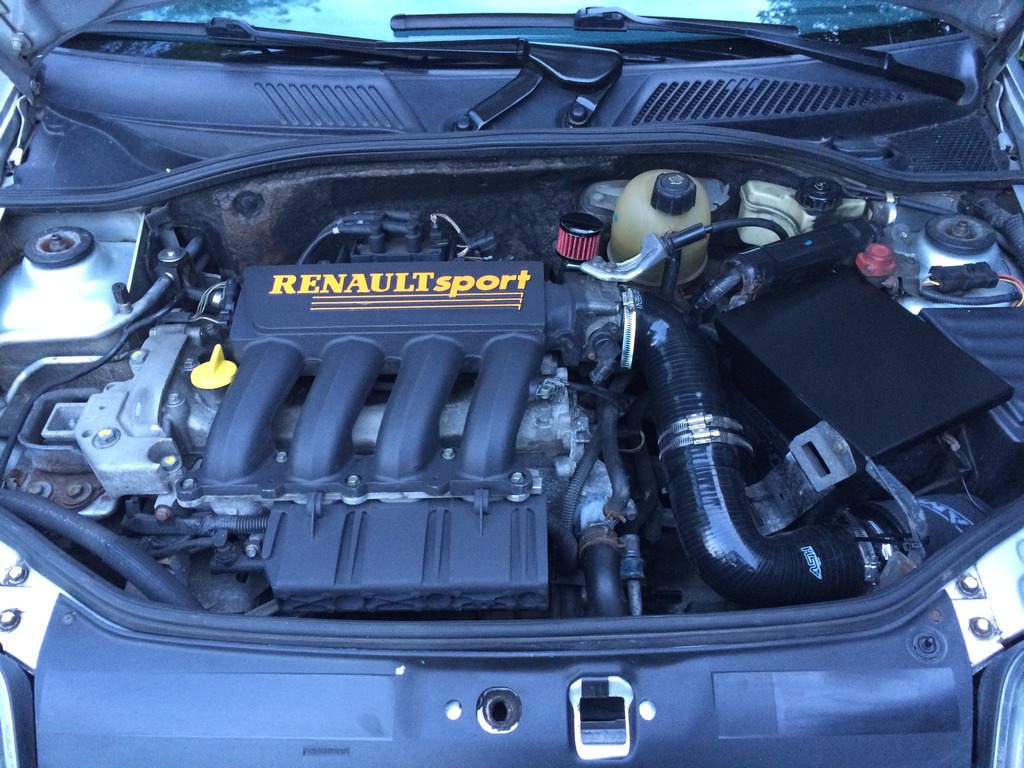

Fitted the induction kit!!!
Slightly different set-up to the Fatty's one for a Ph1, mainly as I didn't order a second ally joiner so I couldn't attach the second 90deg ben. I have one now so I am tempted to put it by the battery. Not as loud as people made out, or that could just be my lack of hearing and the extra added noise from no interior. But does give a nice roar when you give it a boot full!!!

Slight tweet to the induction kit set up
Need to dig out a a small piece of rubber to stop the hose rubbing

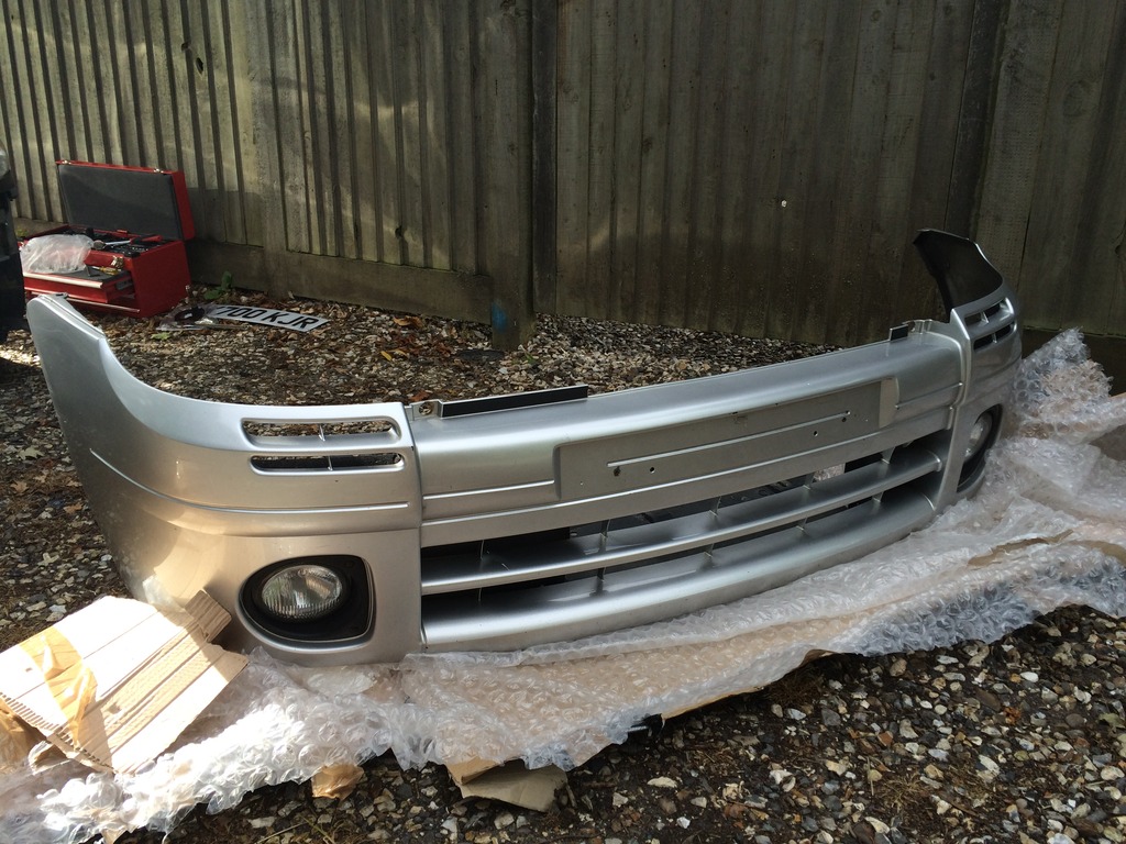

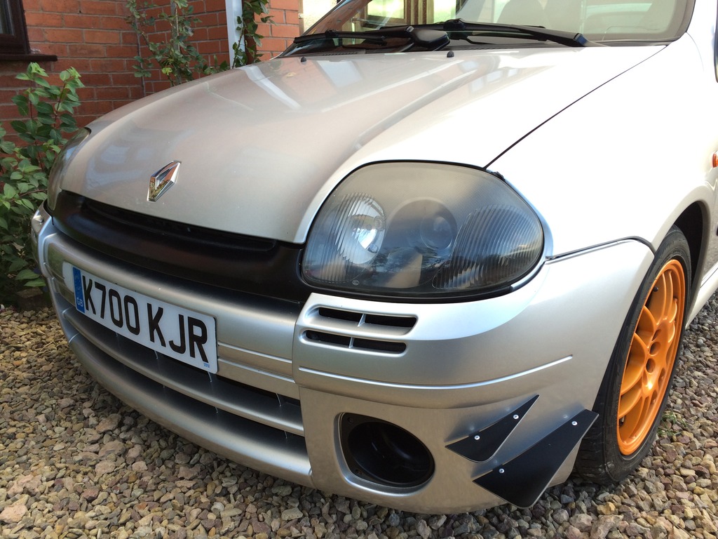

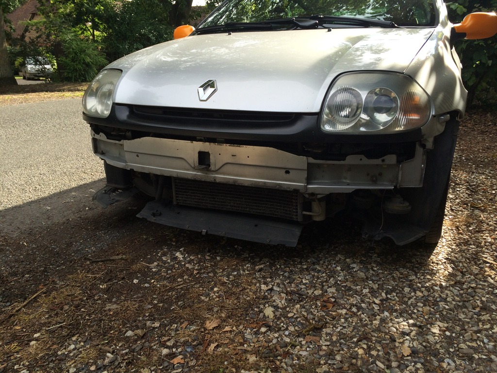

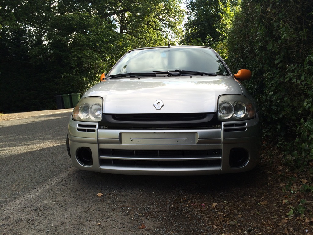

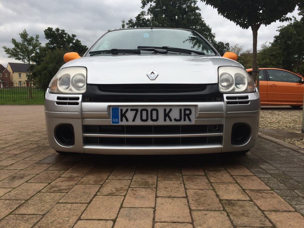

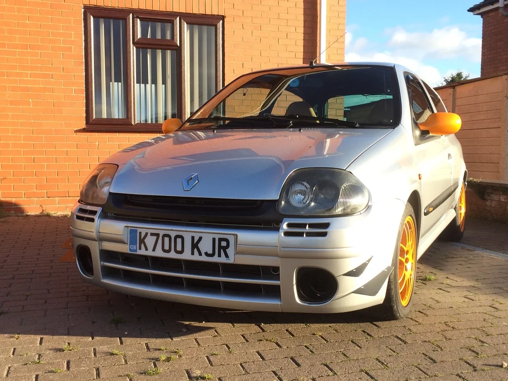

Managed to find a mint front bumper for sale so I bought it, thanks @Stu. (great seller).
I was home less than 10mins before I went out to fit it, and within 30mins it was fitted. Looks so much better than the previous one with all bad bits of paint on it, or not on it!!
New bumper:
Bumper off:
Bumper on:
Gave the "brake ducts" (they aren't connected lol) a coat of paint as they were a bit peppered from road crap.
Can't believe the difference it made.
Just need to sort the roof and bonnet out - they both have water marks burnt into the lacquer. Tempted to source an ally bonnet and look at doing the most heinous thing and wrap the roof in black. I do want a black roof.

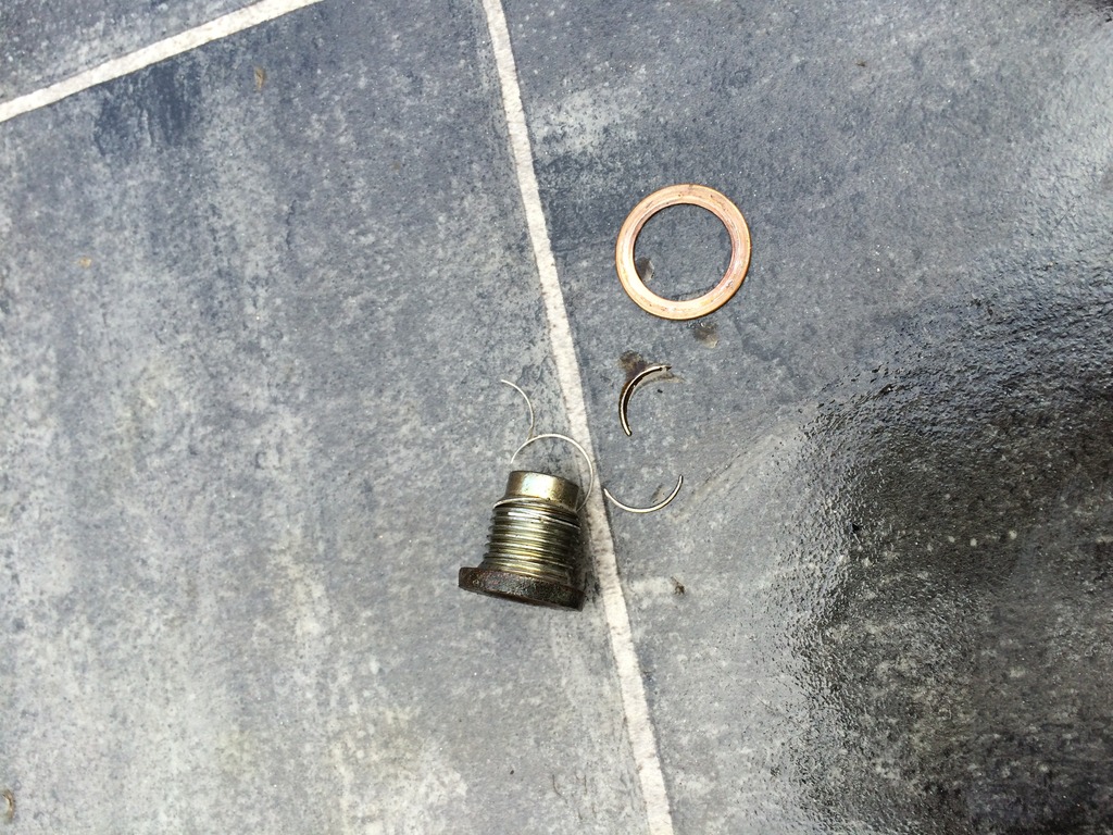

Serviced the car, aka chainged the oil and filter.
Glad I bought a new sumnp plug as this is what happened to the old one...whoops!!
Also removed some rocks from the under tray, not sure where they came from. They dont fit in the palm of my hand, so some serious weight saving!

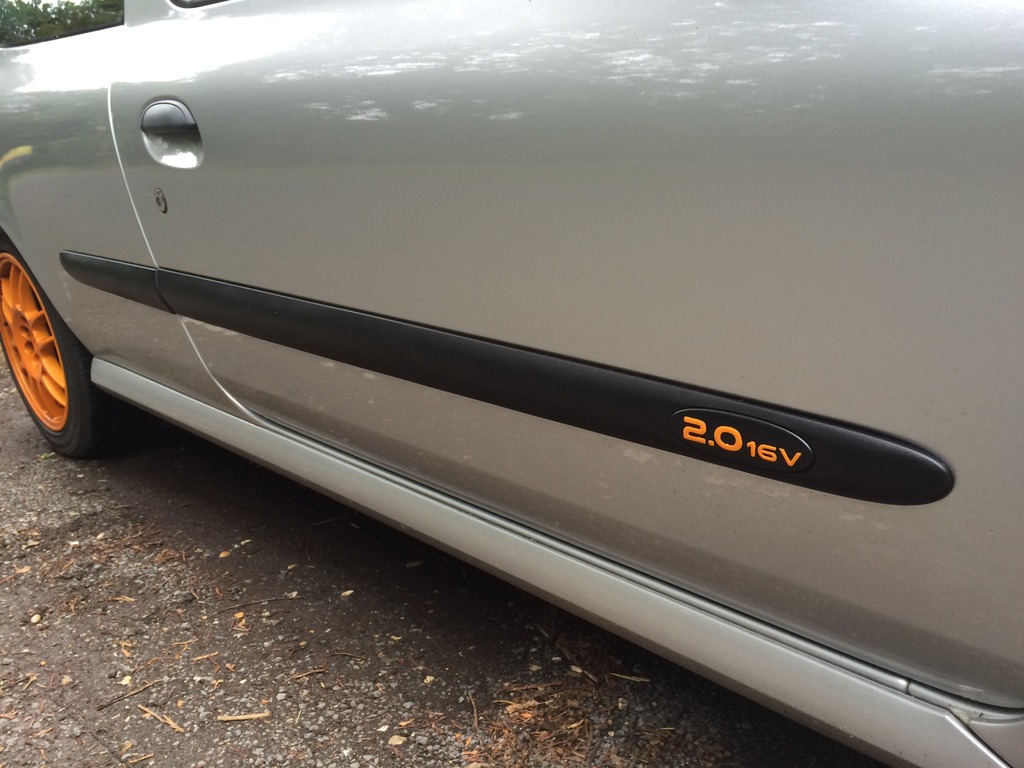

Also managed to finish my door strips. Sprayed satin black and then painted the lettering orange. Looks quite smart tbh

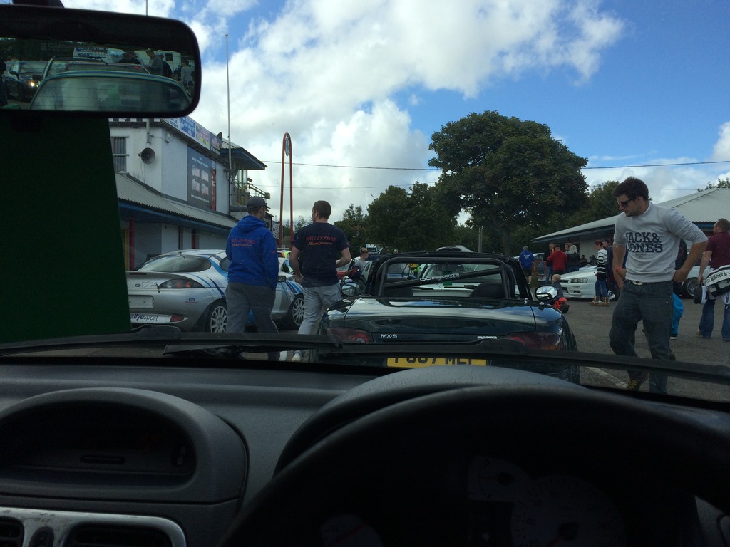

So I did the Forge Action day on the weekend. It's been 2 years since I was last on track so was a little nervous. I am a "sensible" track driver as I back off for corners and let quite a few people past to calm the nerves.
It was a really good day! Have missed abusing cars on the track. Went out with my step dad in his MX5 and his work colleage in a 200 SX. Step dad had a bit of a nightmare as his MX5 was a bit hesitant and wouldnt rev above 4k, then randomly worked at the end of the session!
The cars I went with. The kid with the Seat wouldn't go out on track and spectated, but somehow missed us. Like is my car not obvious with bright orange wheels??!?
Spending hours in the queue to go out!

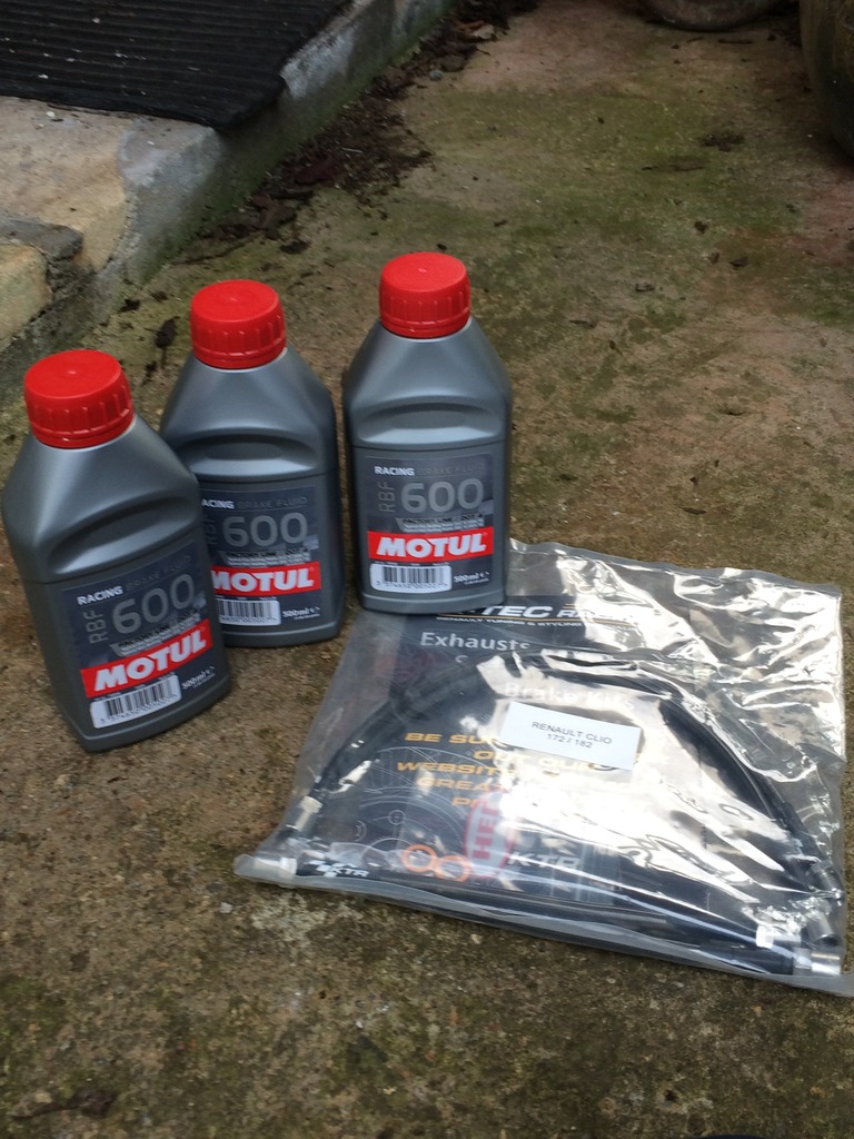

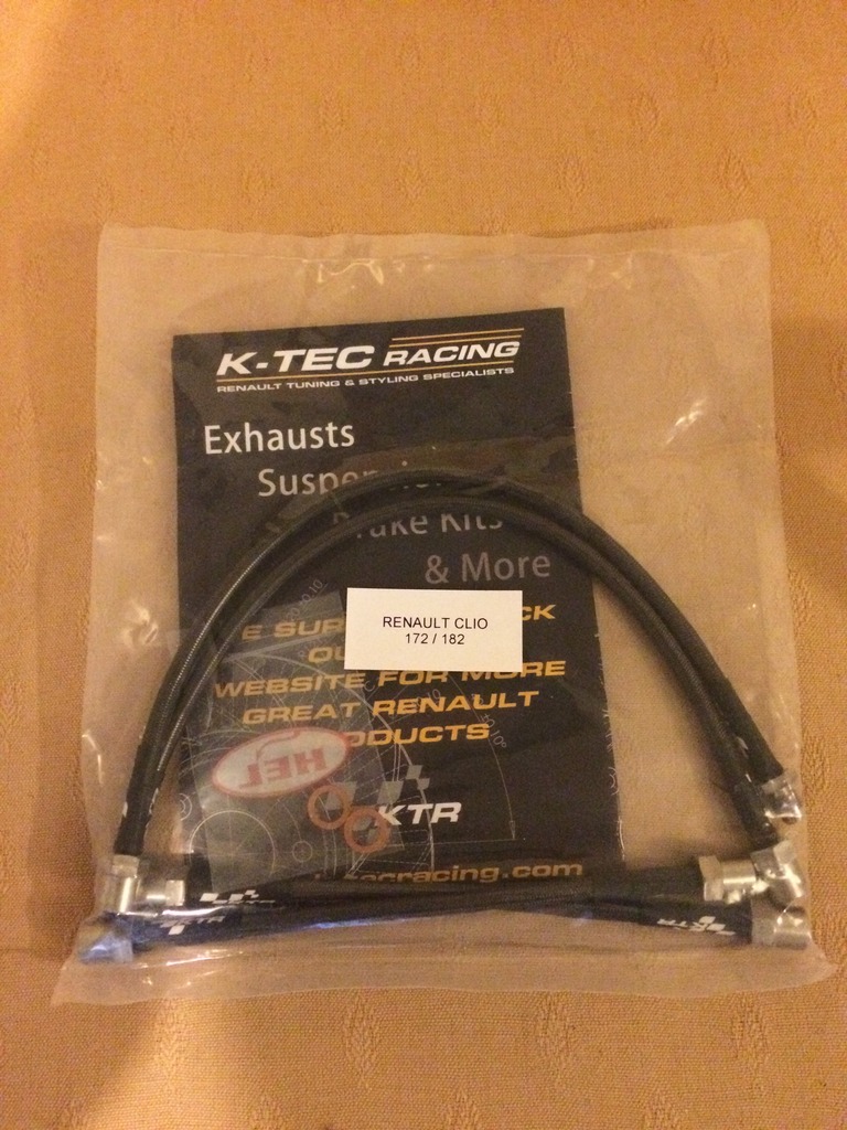

Some "updates"...aka it was my birthday yesterday and I was a very lucky boy and got some nice goodies:
Bradied brake lines

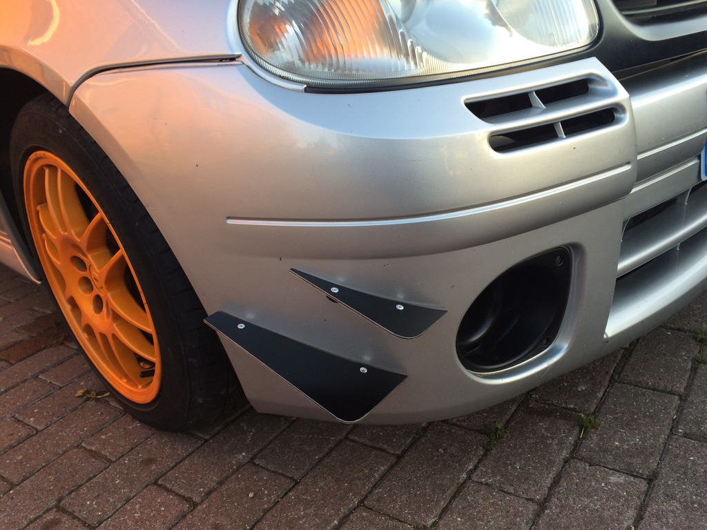

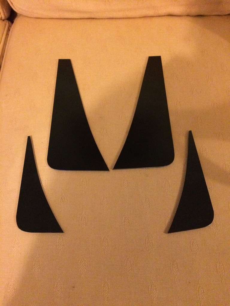

Aero Cannards, #BecauseRaceCar. These will definately add 3.647bhp
Next weekend is set aside for working on the car, aim to get the canards fitted and strip it out for painting. Brake lines will have to wait a few weeks.

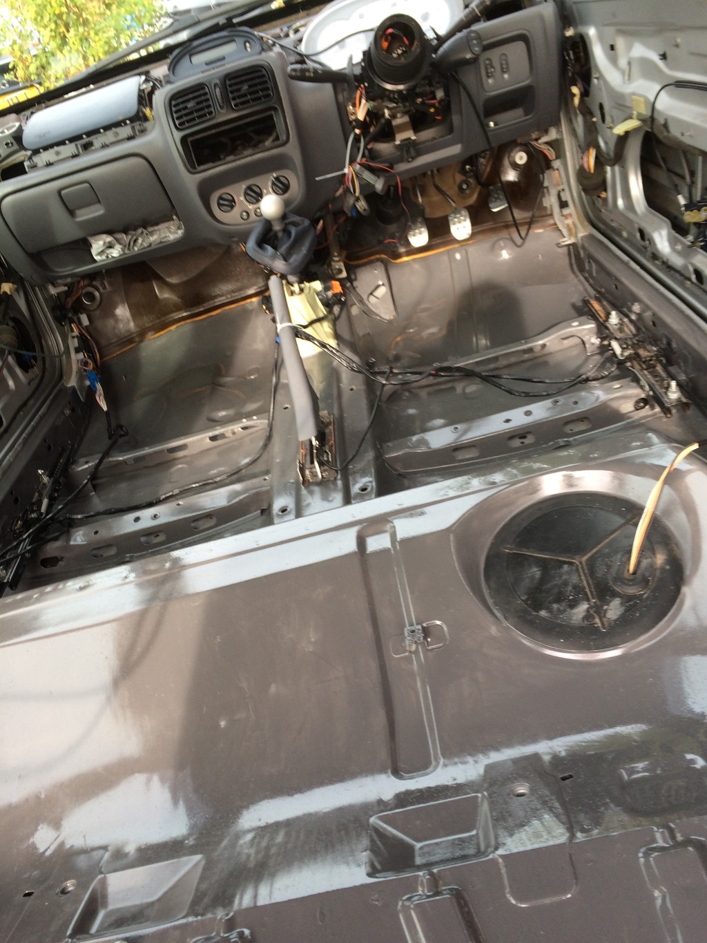

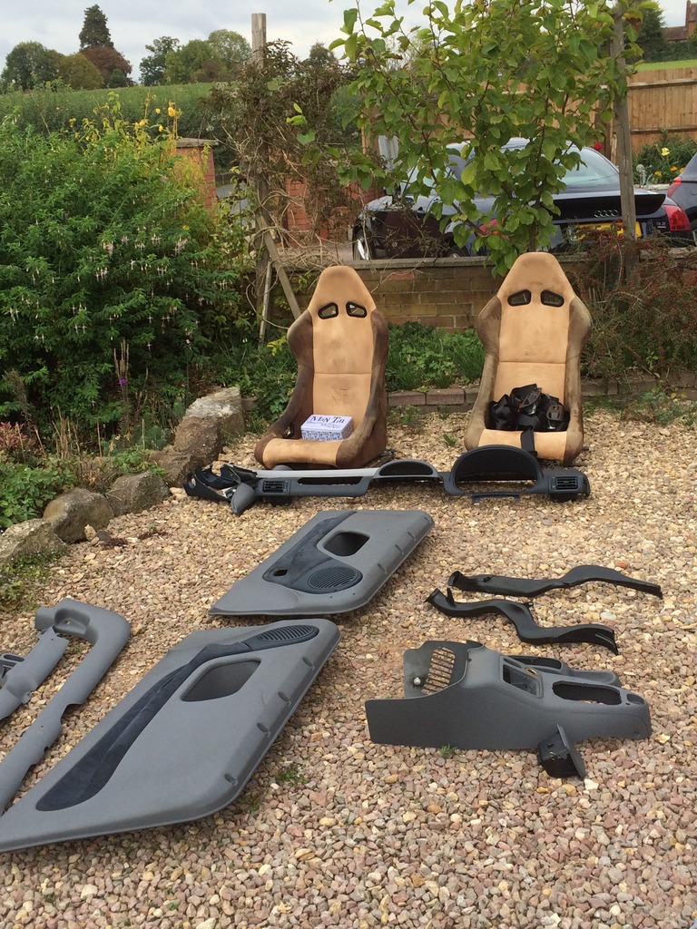

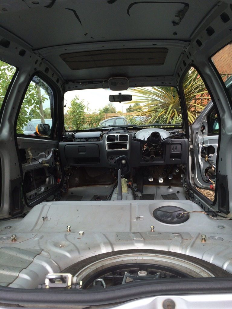

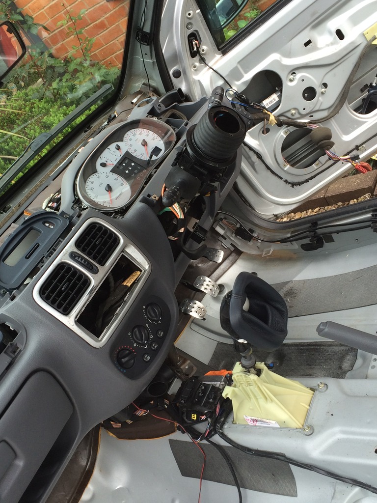

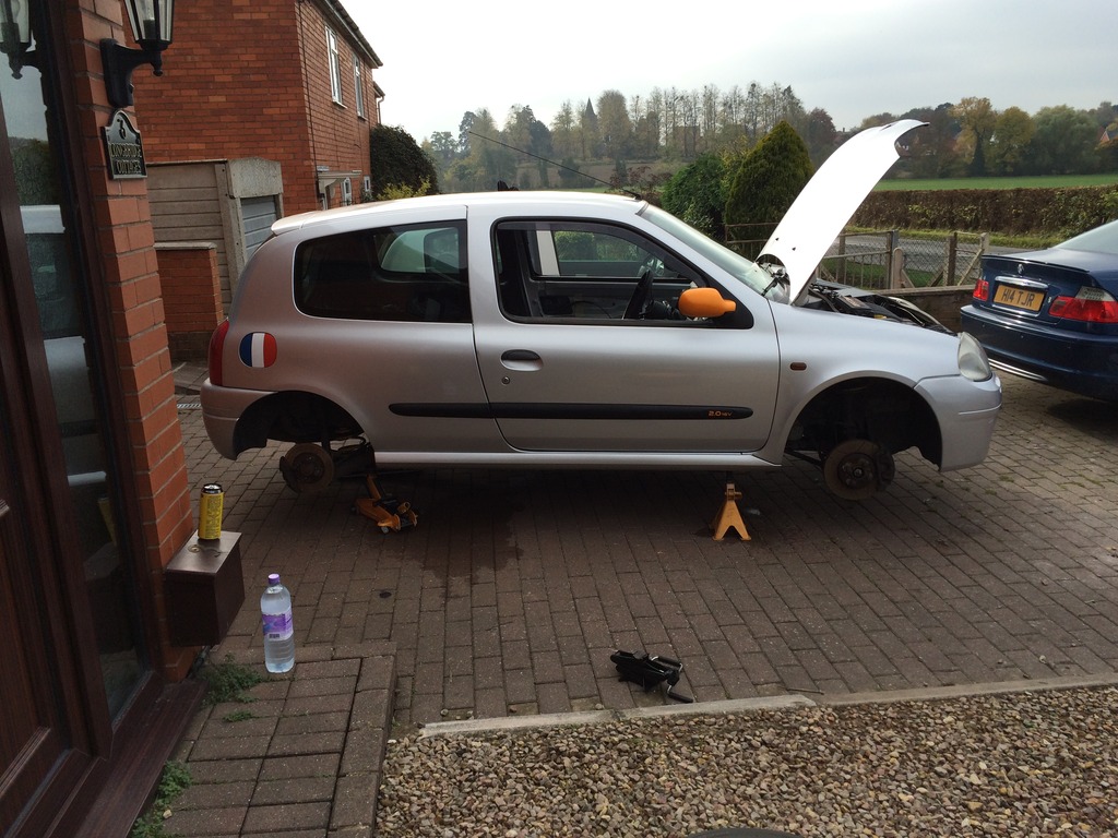

Then I set about stripping the car even more. Like so:
All the stuff on the drive

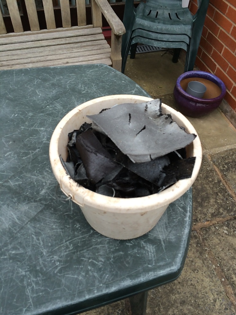

Then I set about removing the tar sound deadening...all 6kg of it!! Didn't realise how much there was!

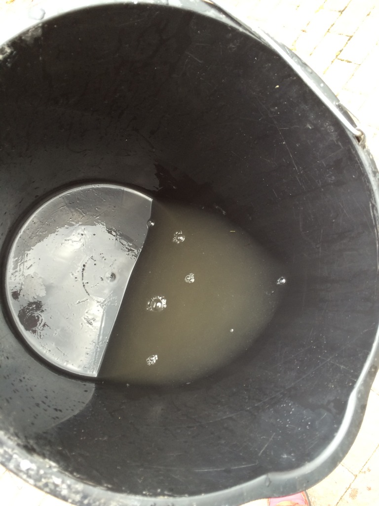

Then removed this quantity of water from inside the driver's sill.....no idea how it is getting in there or how long it has been sat in there. Hope it is all out.

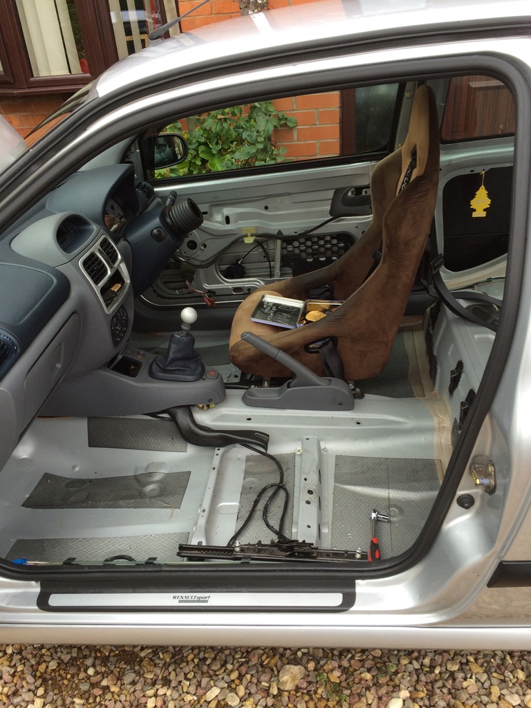

Then I took the seat rails off and put a coat of paint on them, need to finish this off as they were still wet before I had to leave. But before painting:
Didn't get around to marking my canards up, but just placed them where I roughly want them. With my two physics degrees, understanding of aerodynamics I have calculated they will do naff all apart from add some cool factor though.

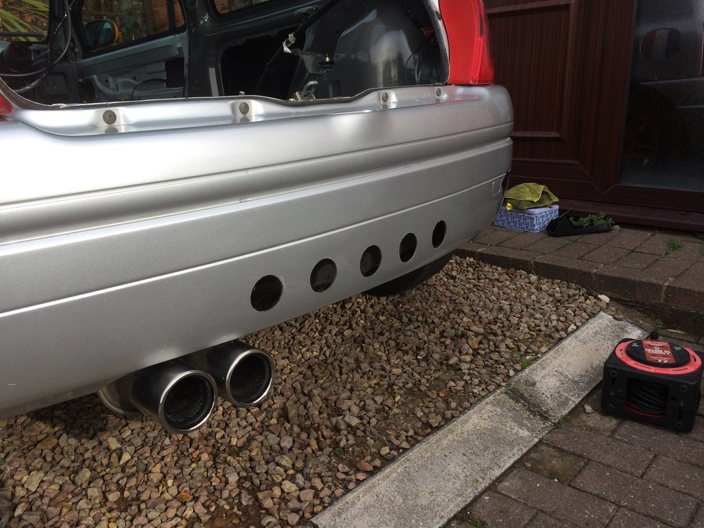

And a bit of aero tweeks of the rear bumper:

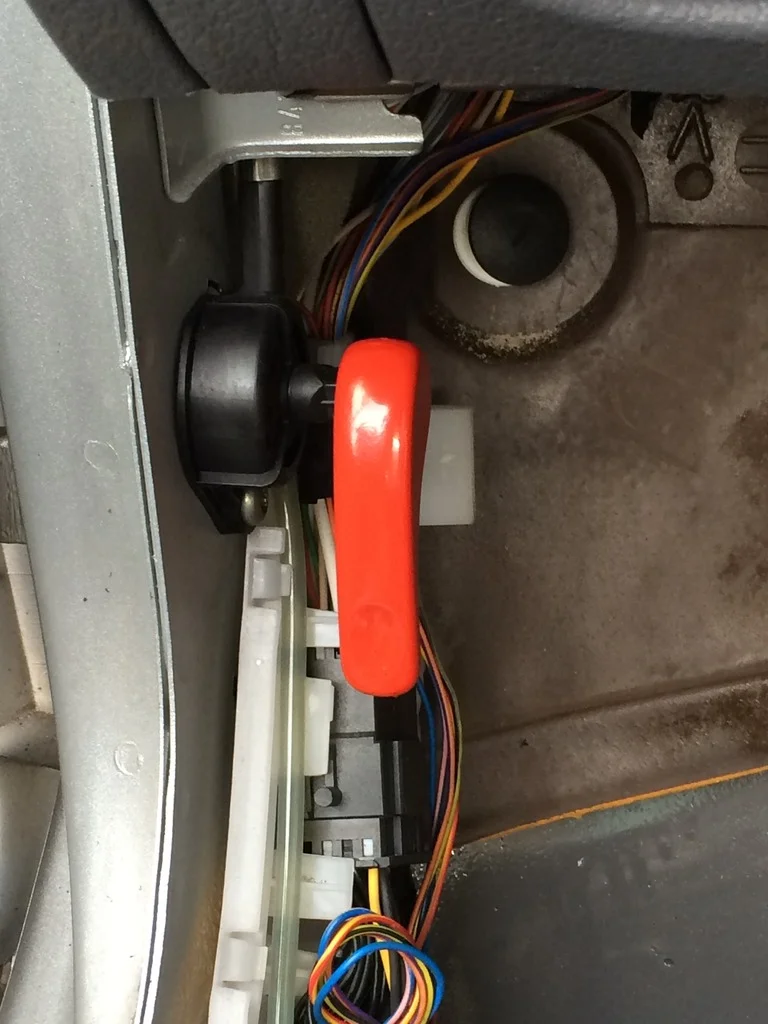

Fitted my bonnet release lever, pained in red for that "race car" feel lol

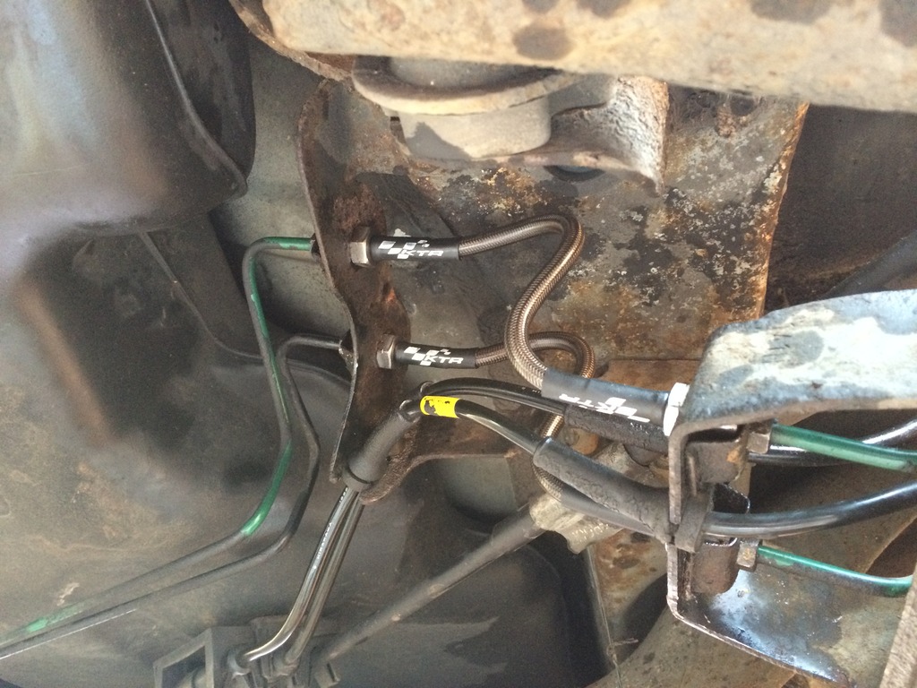

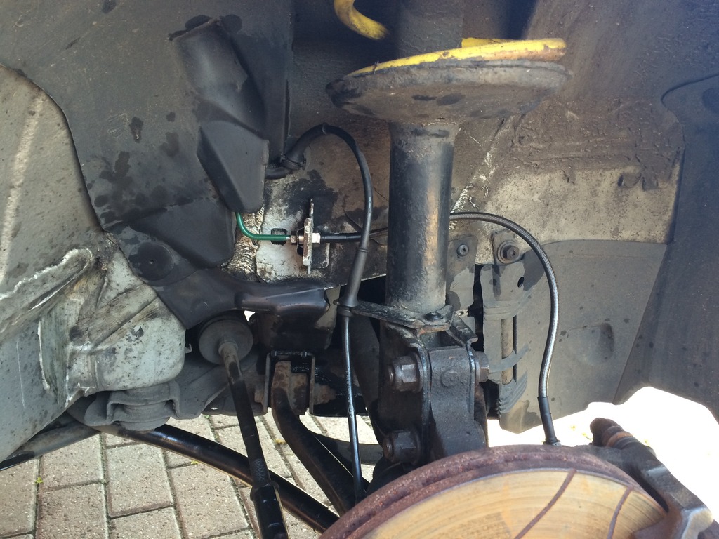

Then my brother came over and we fitted the braided brake lines and brake fluid change
My brother does not mess around, the car was like this before I finished my cup of tea. The big puddle of water under the trolly jack is the water that was in my sill and couldn't drain....fuuuuuuuuu!!!!
All lines were fitted with ease. Had a bit of a fight with both fronts. The one it looked as if some goon had over tighened the union on the car and caused it to flare outwards so the new hose wouldn't go into it. And the other one wouldn't go into the caliper, aka we were being a bit to pussy to force the thread to start, just needed a little bit of extra force and it was fine. It isn't corss threaded though!!

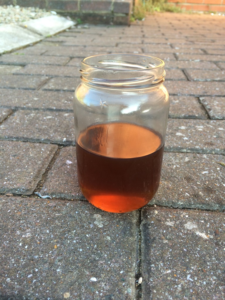

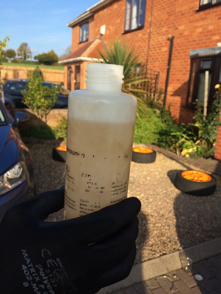

Then bled the system. The Eazibleed is a god send! New fluid to go in:
Old fluid that came out:

Then fitted my canards. Because they will obviously reduce lap times.....bit of bling really!

Fitted the seats so it now looks like a car! Such a pig of a job as what I thought were universal seat mounts my brother made only work one way and it took FOREVER to fit.
