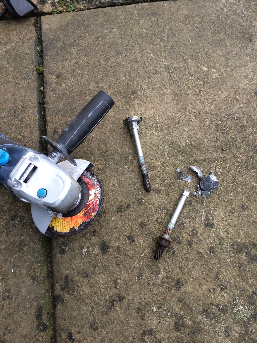

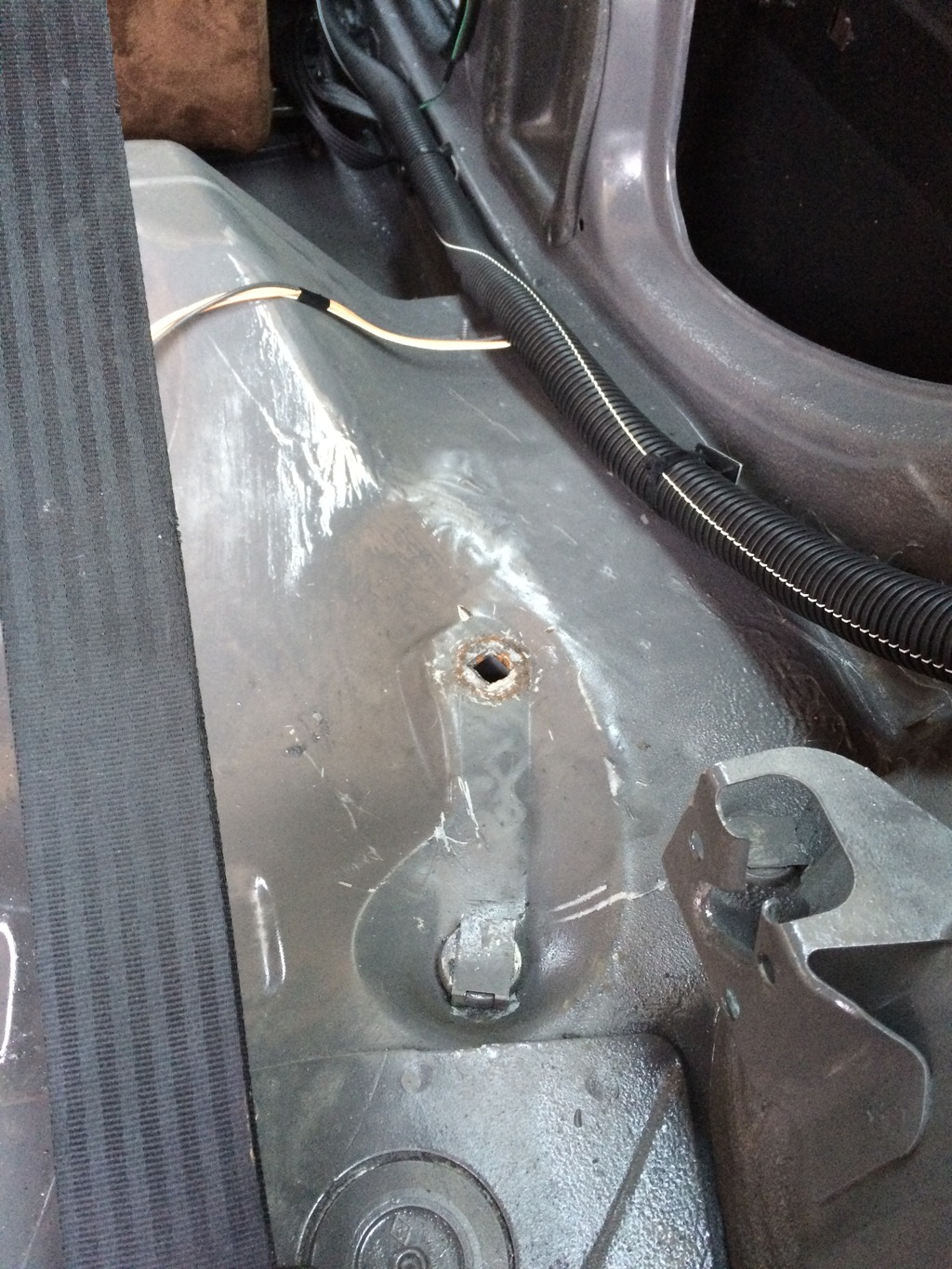

However......can't use the car as had to cut one of the bolts that holds the rear beam on. The worst design ever for a bolt. So it currently has two in so when I find one tomorrow/this week it will just slot in and be fine!!!! Just annoyed as it was a bolt that has stopped progress.
Car needs to be driven, adjust the ride height and then wheels aligned. Hen it's good to go!!! Pleased with the progress of it this winter. Few other jobs to tinker with the coming months.
Will post pictures tomorrow, and of the offending bolt.

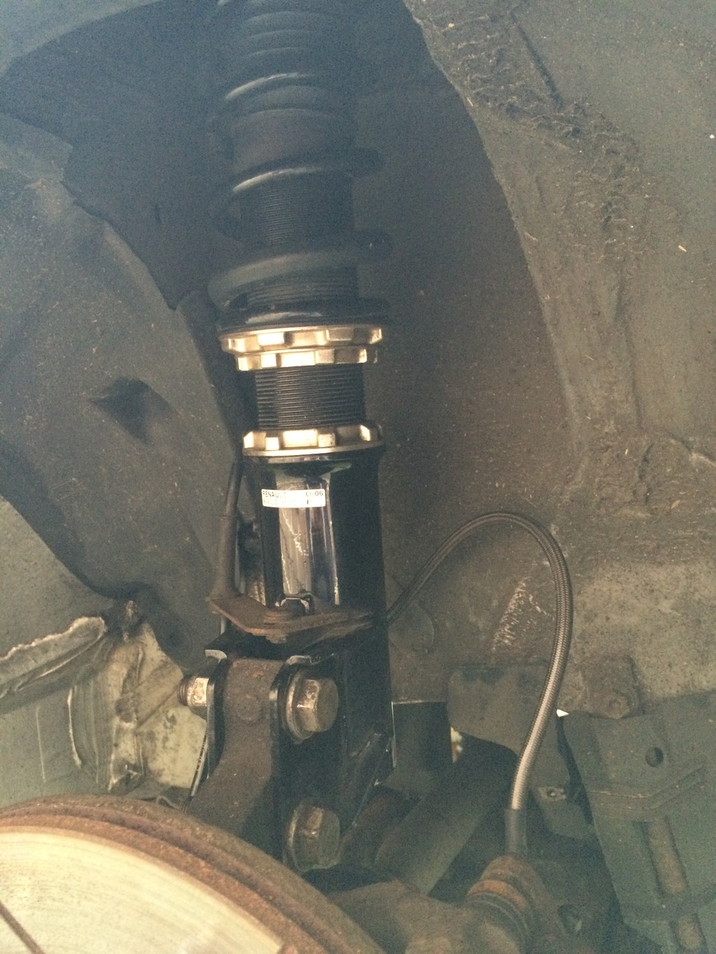

Some picture updates from the weekend, because it doesn't count unless pictures are taken 😂

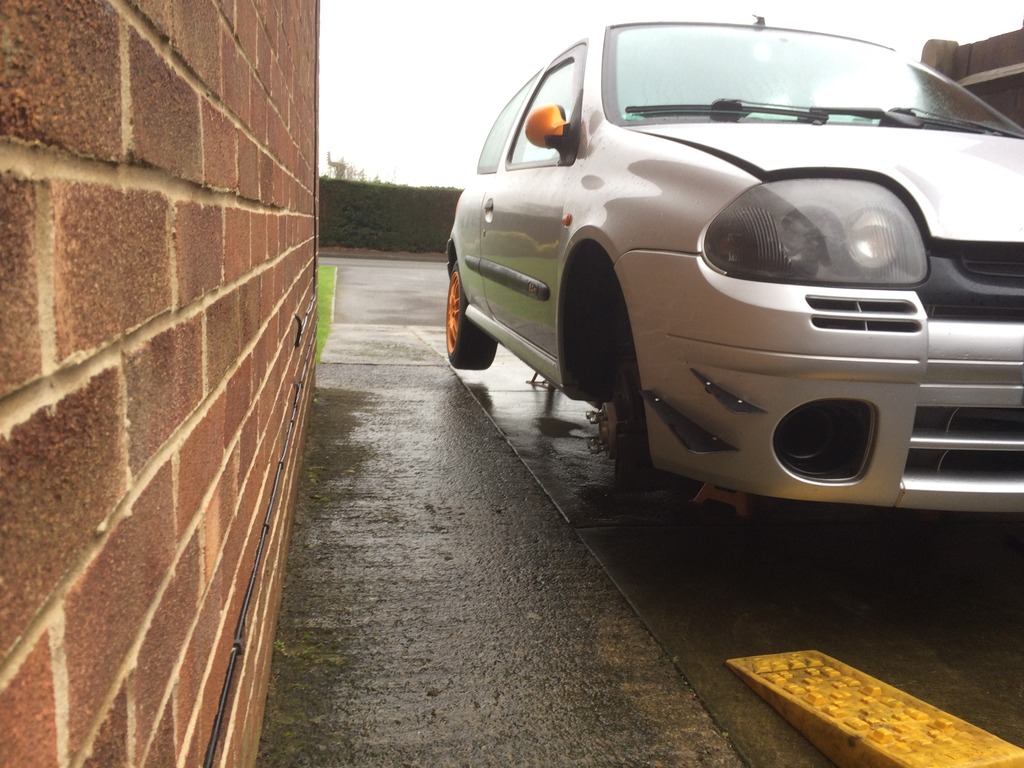

Car sat on axel stands within an hour of being back on the road, this time on another driveway!

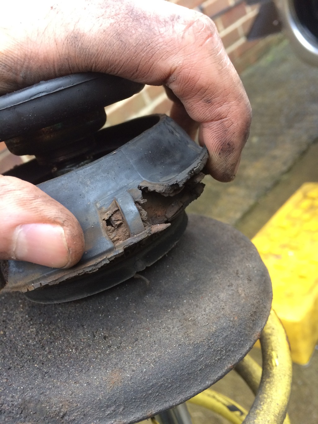

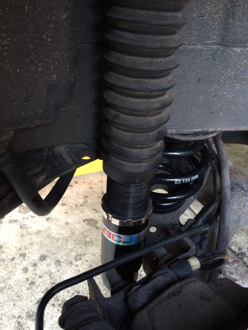

Front shocks came out with ease. Glad I changed the top mounts as this is what the one looked like:
Rears were even easier to remove. I think I would be happy doing it all on my own now, have that bit of confidence to do it.
Then set about putting the new stuff on. Glad the shocks came with lower mounting bolts as the ones I had ont here were passed their best.....aka they were an innocent victim in an anger rage trying to get the hub to fit when I changed the bearing over the summ, whoops :grimacing::persevere:

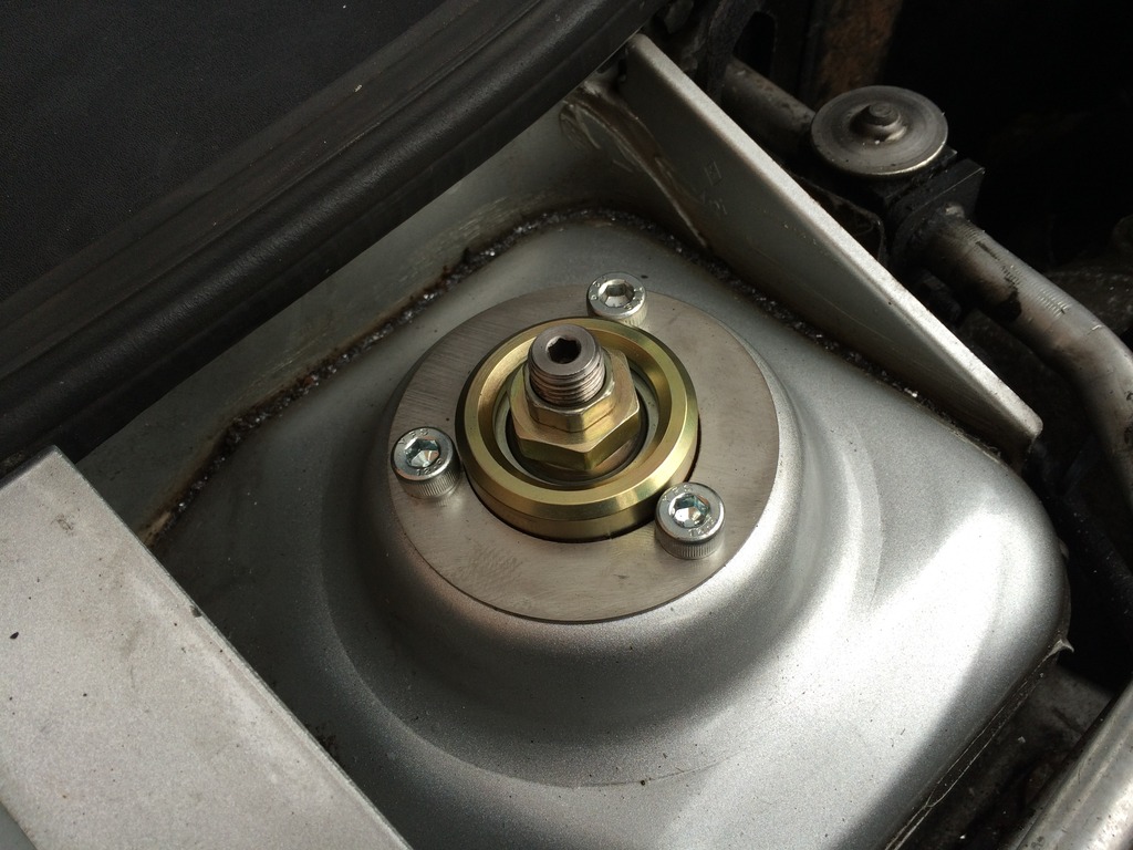

Top mounts look the business!!! I hope they make a difference.
The fronts were on within an hour, including measuring and drilling for the top mounts. The rears on the other hand were a bit longer due to a bolt holding the rear beam on. Wanted to put the RARB on so it is all done in one job, wish I didn't bother now! I don't know who approved the design of those bolts, but they seriously need a lesson! Captive bolts.....fine....but into a square hole that is in a thin sheet of metal, like wuuuuut :triumph::rage: so it turned and rounded the hole off so that was it fubar'd. As the bolt doesn't have a hex or torx head you can't undo it! After an hour of hitting it, struggling to grip it with a spanner on the top (m anged to get a spanner to the square part) me and my brother gave up and hacked it off with the grinder

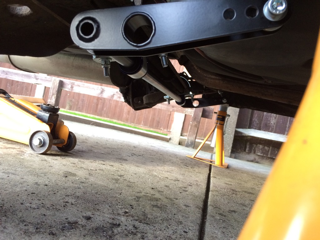

So more bling....rear anti roll bar fitted. It's the 22mm PMS one. I think it looks tidy and a lot better than the Whiteline one.

JOB DONE!!!! If it wasn't for theat bolt it would have been driven and then the ride heigt set, but it got dark. Couldn't get any pictures of the car how it stands now. But a simple test there is about between 2-3 finger's gap between the wheel and arch. But need to drive it to let things settle before I sort that out.

Bolts turned up today to fix the rear beam back on...thread isn't long enough ffs. Brother is taking them to work tomorrow to lengthen the threads.
Throttle cable ordered so will fit that Friday. Hopefully this will solve the throttle issue.
KitsonRis
My brother is a hero, get a picture from him with the bolts in a lathe as he is extending the thread. Then I get another text from him last night saying they are in and it's all done. I am not lazy, I just can't use a lathe and the car is on his drive way!

haimsey

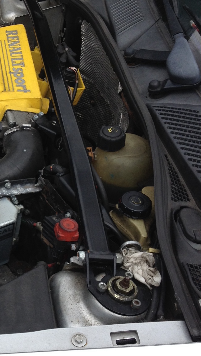

What method did you use to position the holes without the strut brace, I plan on fitting a set but not using the brace
  172 Ph1
That is a very good question : purely because if you get the holes not even near the correct position , you ain't getting the strut brace on at a later date. Wouldn't want more than the recommended 3 holes I can tell ya.
With regards to initial position - I'd drop the mount in upside down into the hole in the turret and then mark it for drilling . Just make sure the the forward facing bolt is facing the front [emoji12]
KitsonRis
Put the bolts in the wrong way so they poke up, put the top mounts in the wrong way and use a piece of string going across the back two bolts on the one side to the other side. This will make sure they are level and in a line so the bolt at the front is in the right place. This with a bit of an engineer's eye made sure they were right.
I didn't fit the strut brace because of money, didn't need it at the point so will do it later when I don't have other things to buy in a month.
When drilling, make sure you have a centre punch and pilot it as the drill will wonder. Didn't have a centre punch to hand, but my brother had a set of letter stamps we used instead!!

Car looks great and that update was good dude. I'd be sourcing some covers for the top mounts though as mine have got quite a build up of crap on them. Not sure how you'd do it though. Someone must have some kind of design.

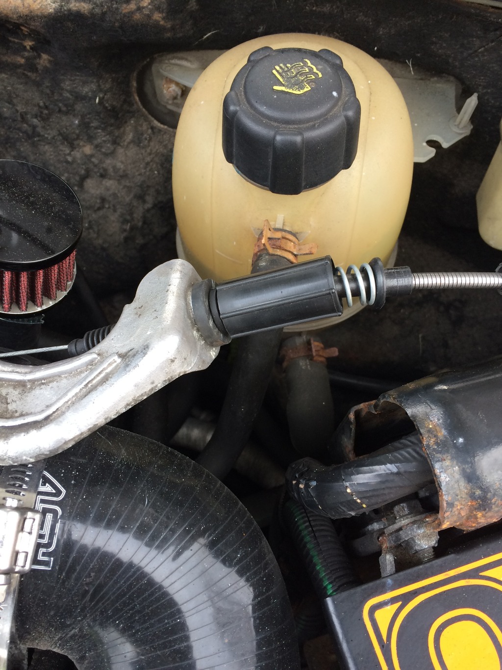

Throttle cable replaced! Pedal feels loads better. Didnt turn the car on as I had to fit an exhaust to my step dads car before mother came back....however led under the car and all I can see is mum's shadow looming over me, she wasn't best pleased :confounded:

The throttle cable change was a sucess! Did lose skin from my kunckels as I was removing the arch lining and slipped. But I think this may have been to do with the problem, the spring thing wasn't seated properly and didn't want to go back together. Also the cable that was on only had a rubber casing about half of the length, so the metal insert was all rust. Not good. Genuine Renault part went on, so that was good. And tip DO NOT DROP THE SPLIT PIN THAT SETS THE PEDAL TRAVEL. My step dad did and it took ages to find it in the engine bay.

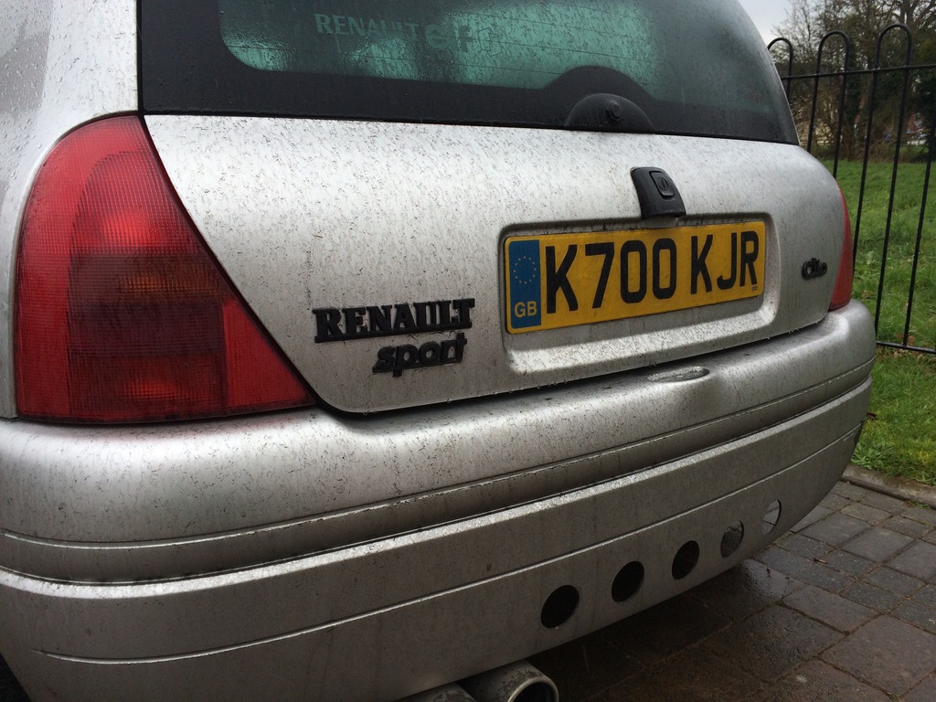

From this picture the rear could be dropped a bit more.

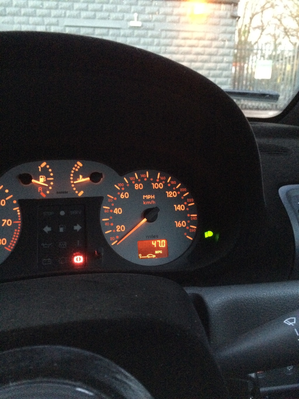

Did get up to 48mpg on the drive up, but did do the M6/M56 junction in an excitable manner so it dropped to 47mpg when I stopped
