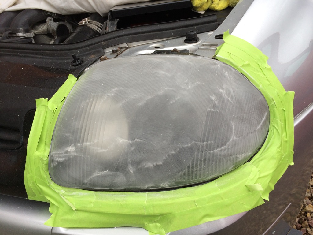

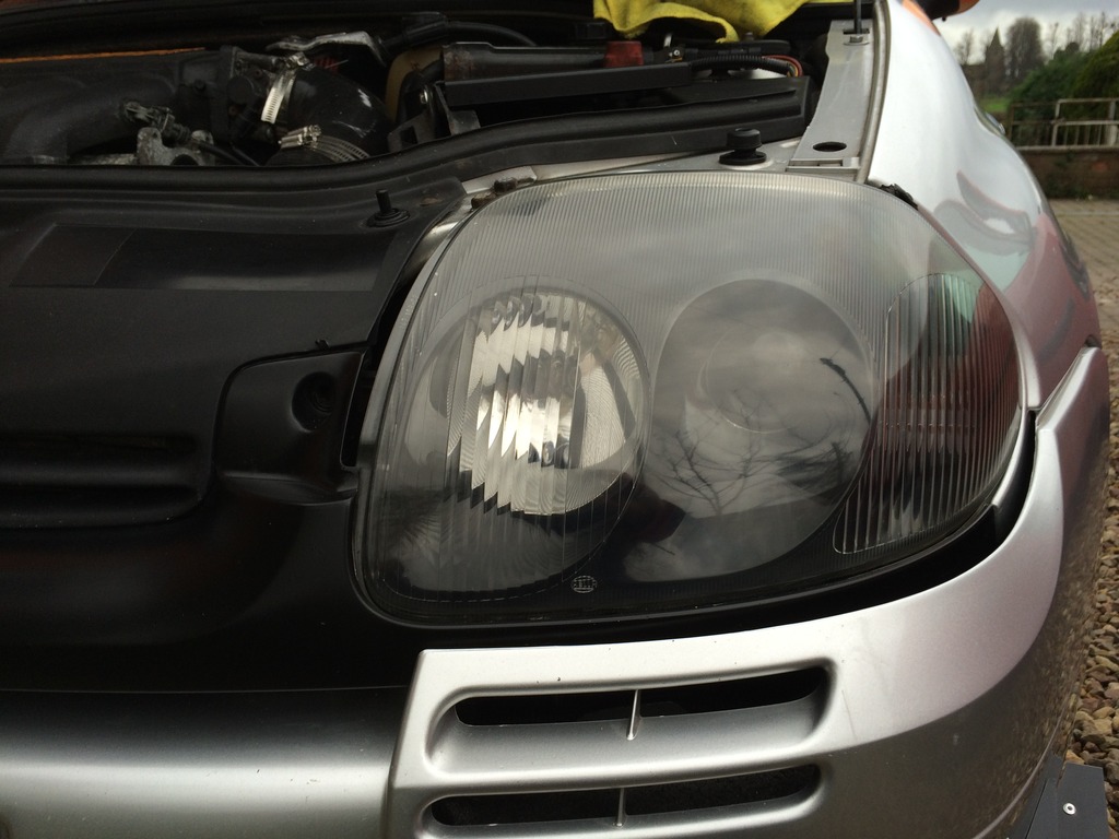

Re-refurbed the lights.
MUUUUCH better!!!

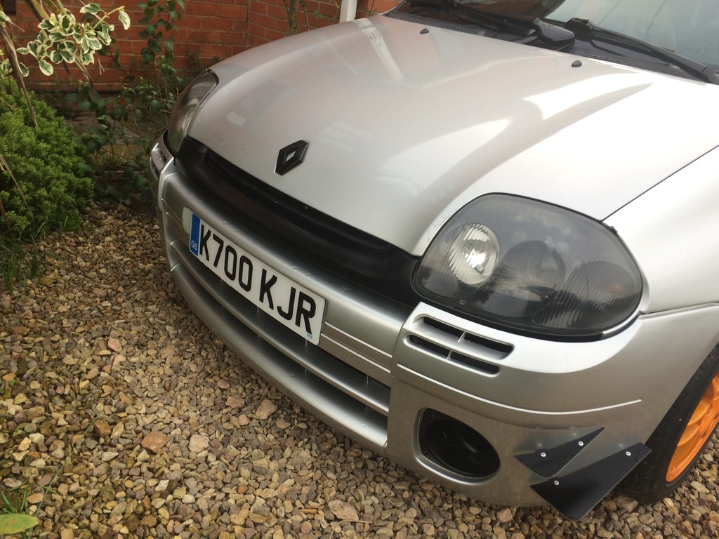

Painted the badges black. Now there isn't any chrome or blue trim left.

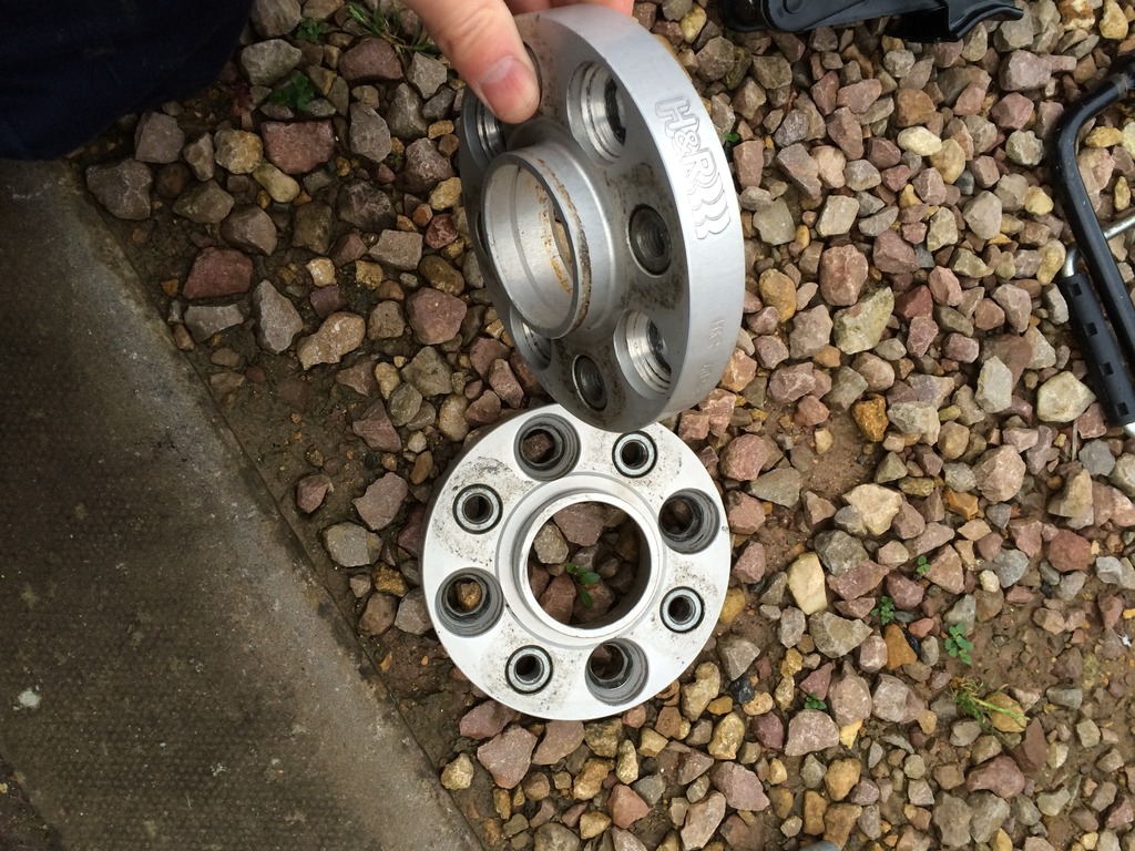

Front wheel spacers fitted

Its the second refurb in about 6 months, although I dont think I polished them enough the first time. When I made them black you could see it so I thought it best to redo them
YEah the spacers are perfect! Got some rears I need to fit at some point, just didn't get around to it this weekend.

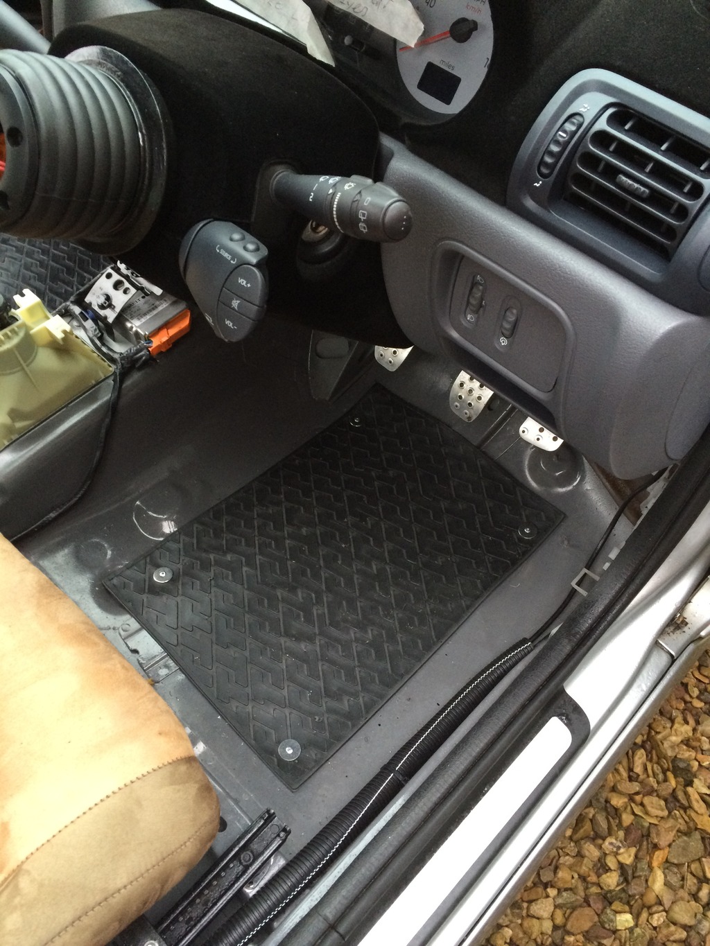

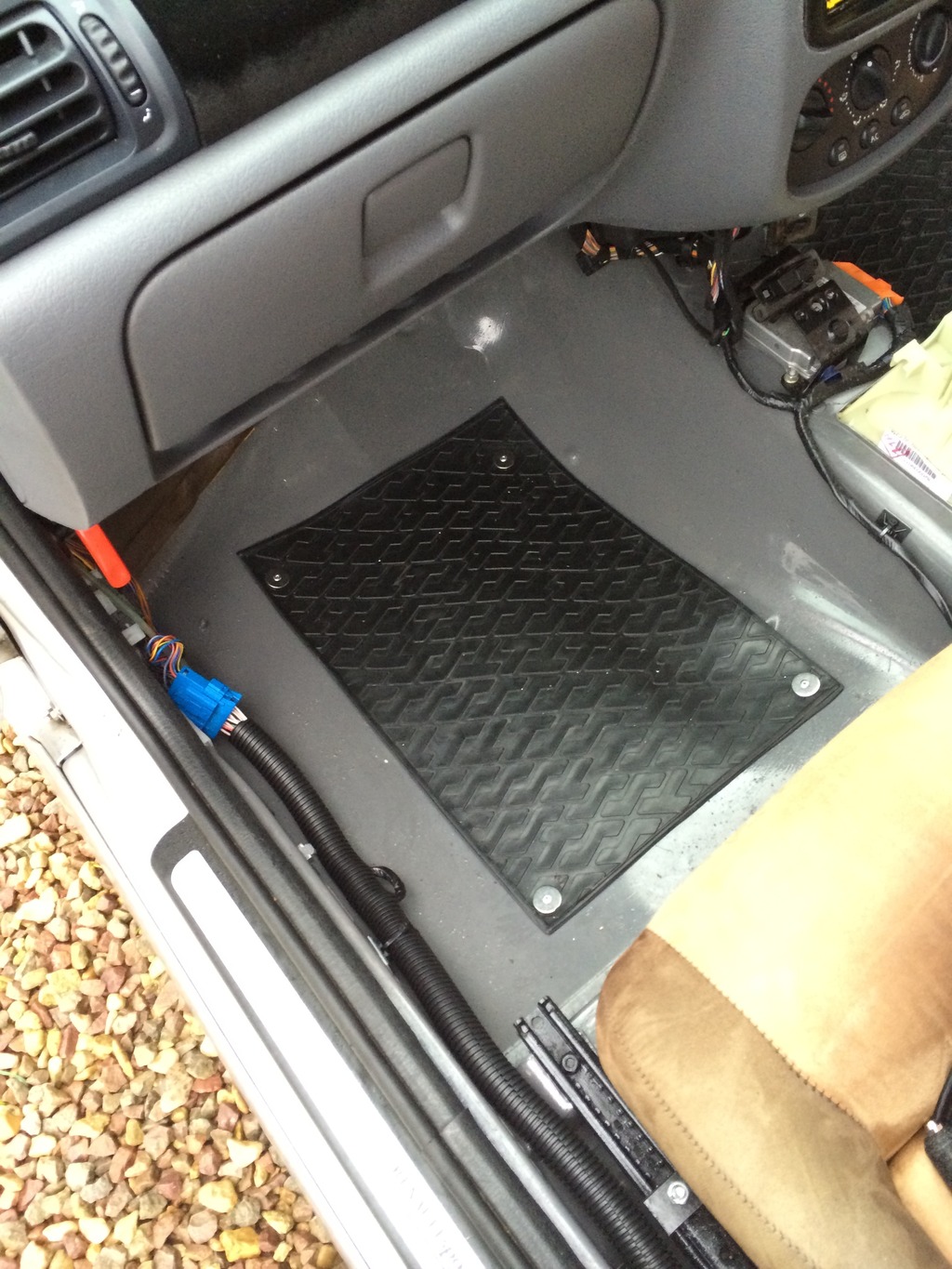

First was the goodies I got...new wiper blades and some rubber mats for the front
Also fitted Citroen C3 mist washer jets. THis is now how they look...yes a brilliant picture I know!
Riveted the mats down so they don't move about. Rivets weren't quite long enough and I didn't want to drill in some places/floor was contoured so the rivet placement seems odd, but there is a valid reason for this. They will do the job perfectly and help give foot grip and protect the foot wells.

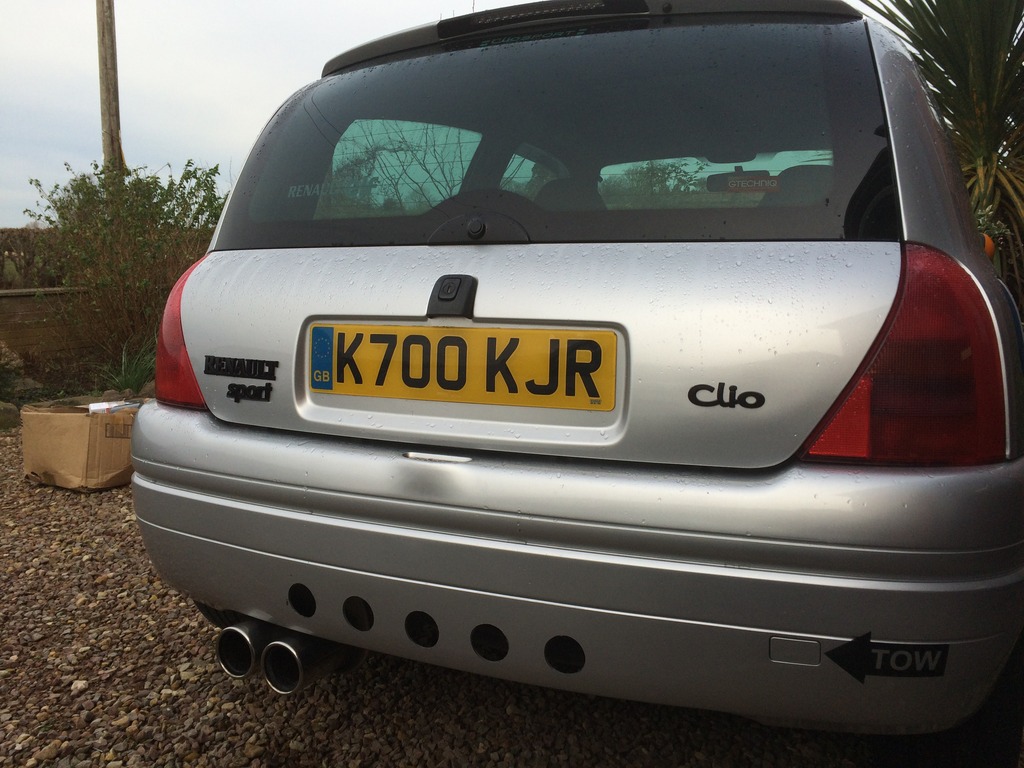

Exterior baded all painted black now, looks a lot more mean and purposeful. Annoyingly my Renault badge ont he back has pins and the Sport bit doesn't so the plan of replacing it with a sticker was stopped in its tracks! So I had to glue the sport badge on, so that isn't coming off ina hurry, but the only time it is is when the boot lid is swapped for a plastic one

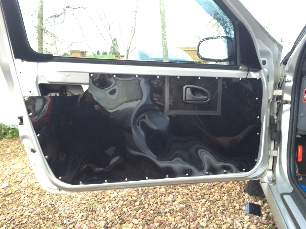

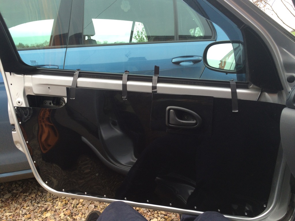

Got loads of blck plastic material to make door cards. So I made a start at that. I think they look good. However, the tops of the door where I want to rivet are double thickness and also vary in thickness so the rivets I bought didn't fit!! So I have only got this far, also the bit around the door handle in the picture is a template and a proper one needs making up.
The cut out is for a door pull. I have ordered longer rivets and a dremmel to cut holes in the driver's side for the window and mirror switches. Going to finish this this weekend. But the hard part of measuring up and making templates has been done so it shouldn't take too long. I have plenty of material for many other door cards so if I don't like these I can start again.

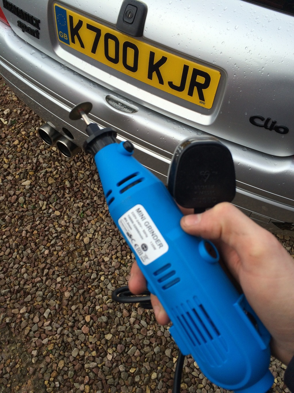

Bought a dremel to do the switches and it is simply the best tool I have ever used!! Simple things, simple minds :tongueout: although the passenger window isn't working, if it's because I don't have a switch on the passenger side (took it off but the connection block is there) then I am screwed as the door card is riveted in and I am not taking it off any time soon.

As promised pictures of my door cards as I knew some people couldn't contain themselved with the suspense of not seeing them :tongueclosed: lol
Simple and effective I think. Do the job. As I said, when I put Lexan windows in I will change the design slightly as I have learnt how to do it now! Future problems......

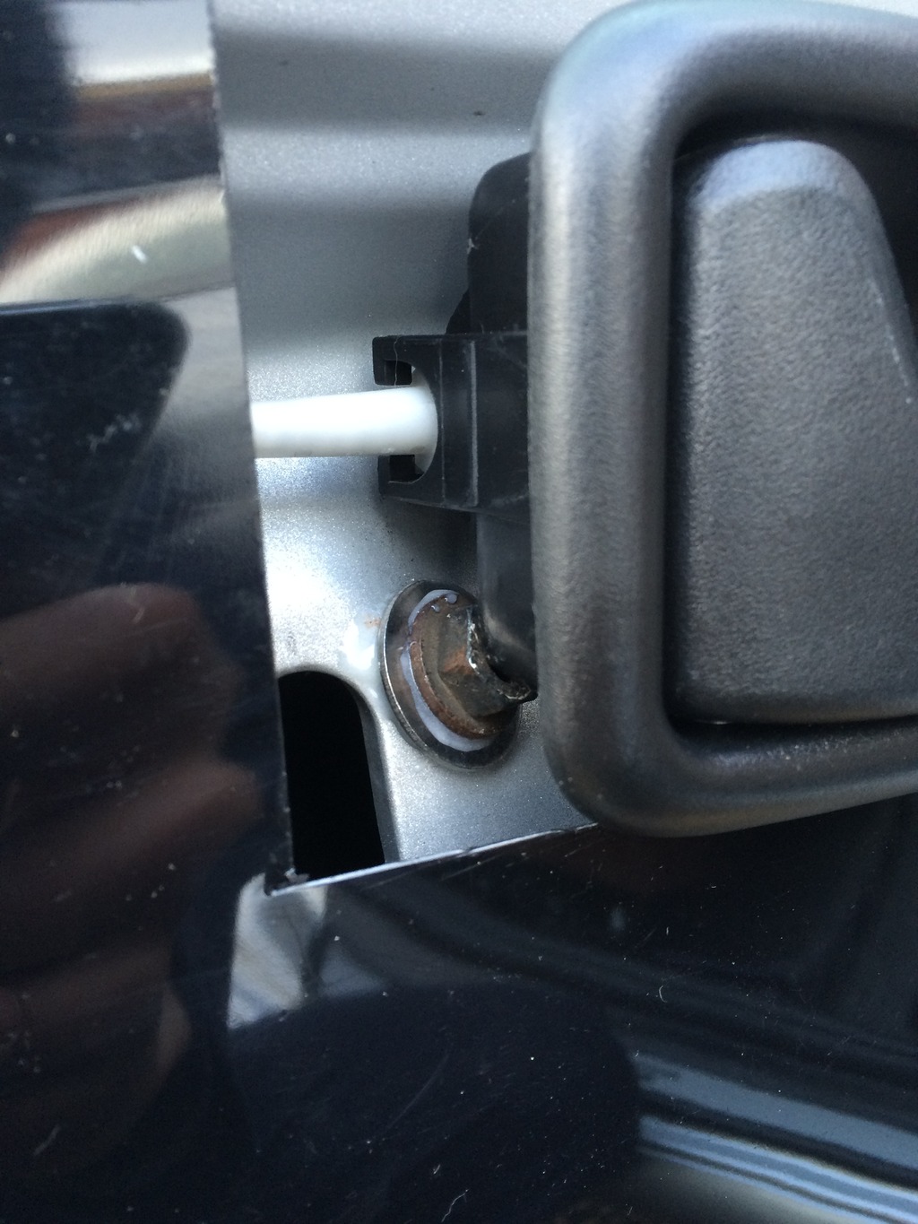

The door handles are held in by one bolt and they move as they are not support anywhere else. So I wedged a bolt underneath them to stop this! Top bodging :up:
The best tool I own. I am going to dremel ANYTHING and EVERYTHING now.

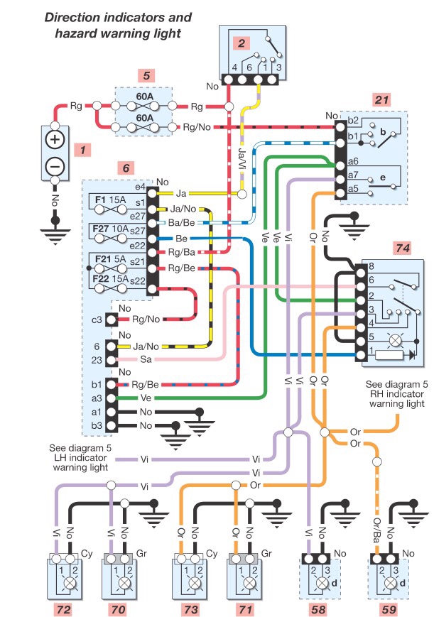

Just need to source a wiring diagram for the hazard switch connector to do some bodging
Brilliant thank you! All I was going to do was match the exisiting terminal block connections with what will be on the new switch and patch them in with a home made wires and spade connectors. So knowing what is what on the hazard switch will be needed
But looking at the switch, it is two rows of 4 pins with a letter "A" above the top row int he middle. Which order are the pins?! lol. Or is there labels on the connector (can't see as car isn't with me!)
When you get a chance - take a pic of the pins on the switch . I take it your going for the switch in the link above ?
Ok Pin 1 is 12v
Pin 2 is power from direction indicator stalk so that's an input
Pin 5 & 8 is earth
Pin 3 feeds all the lamps so that's flasher output
Pin 4 is also flasher output.
Pin 6 comes from UCH poss power
Pin 7 empty

Totally missed input 7 was missing! I will just look at the wire colours to determine pin number, didn't know why I didn't think of that earlier.
Yeah, hopefully it will! The new switch has numbers printed on the back next to the terminals so I am sure they mean something. So match the colour of wire to the terminals that you have said and then put them into the right place on the new switch?? Hopefully it is that simple
Try not to get to hooked up on wire colours as the diagram I supplied is a generic one and not model specific .
I'd say measure the 12 volt inputs and flashing circuits and label them. Go that route not colours .
ahh ok, would have thought the general loom would be the same over the entire range, but knowing the things on my car that have not been straight forward it could be anything.
