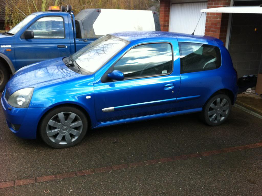

I got my first Renault last month and I am loving it! I always wanted a 182 as I just love the look of them so I saved up for a while and when I saw one near me (well 70 miles away!) I went to have a look and I bought it! Coming from a MK5 Zetec S is a big step up. From 20-40 I feel that the 182 is quite similar to the zetec s but before that and beyond that it is much faster!
I always like to keep my cars OEM or OEM+ so no rash mods are planned for the kiwimobile!
Below is a picture of my lovely MK5 ZS. I am currently getting ready to put it on autotrader!
Below is my FF 182!
I need to get a better picture! It's pretty crap quality tbh!

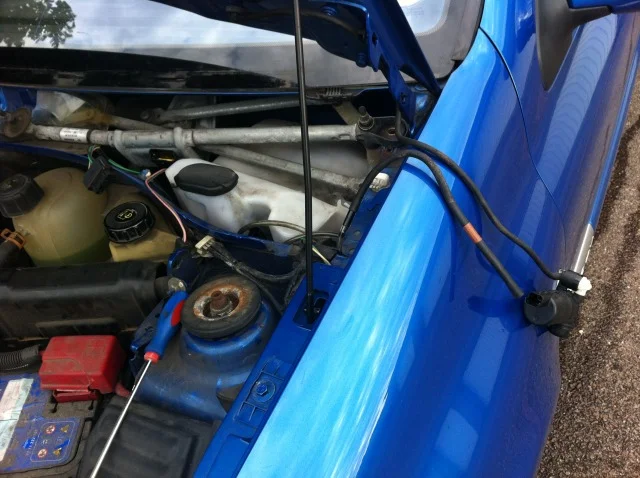

So far I have fixed the washers as they did not work. After hours of investigation I bought a new pump off eBay for £7 and it worked a treat!

I also got some citroen xsara washer jets for £1.25 off eBay and they are now fitted and much better than the single jet spray ones!

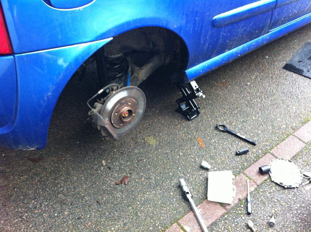

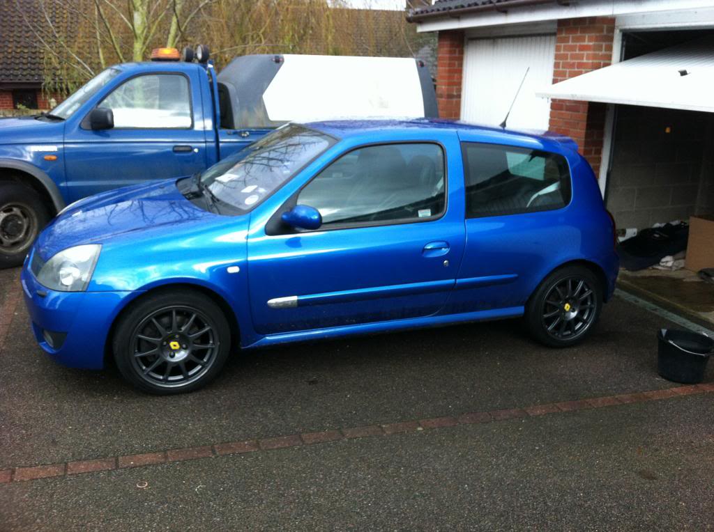

I finally found some Trophy Turinis on here for sale and they were 180 miles away so I made the trip in my mates GOLF 1.8 GTI (he was getting it re-mapped in leicester). They were a very good price becuase they did have some marks on them. One of them has a 2 cm chip on the face and 1 other alloy has a slight curb mark on it. Apart from that they are perfect for what I want! They have continental conti sport 3's on.

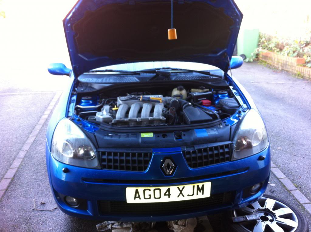

Here is a pic of my 182 just before I started work changing them over!
For a while I was trying to move the little alan key bolts on the wheel nut covers but they just would not turn! :mad: Then I realised they were for show so I just got a screwdriver and prized the cover off! :eek:
It is really dirty in general so I apoligise for the filthiness! Didn't have time to clean all the arches so I will add that to my list of jobs to do one day!
What do you think?
The previous owner of the Turinis had painted the diamonds yellow. At first I hated them but they have grown on me a bit! I have some Arctic Blue Spray Paint so I may just spray them blue or possibly grey. What do you suggest?

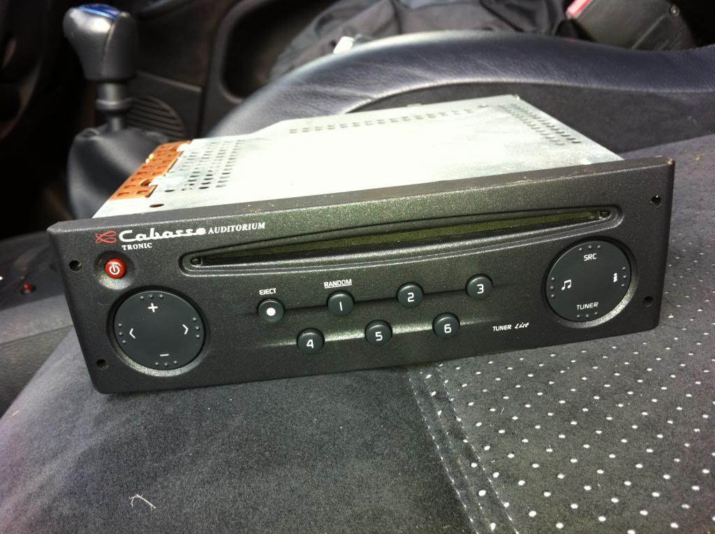

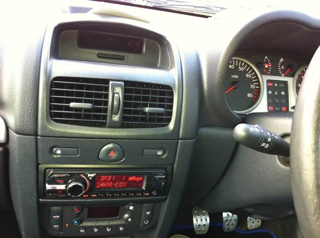

Next I swapped the standard radio for a Sony DAB700U Radio. I wanted a DAB radio because I was fed up of only Radio 1 & Kiss with average music. Now that I have over 50+ stations there is much more variety! I was also missing listening to my iPod so it has a USB and AUX input so I can plug that in! Not bad for £75 off eBay!
  1.6 ZS + Clio 182 FF
I have always wanted to keep my cars OEM+ and I feel that this radio help because I can match the Display Colour of my radio to match the Renault "Amber" lights around the dash!

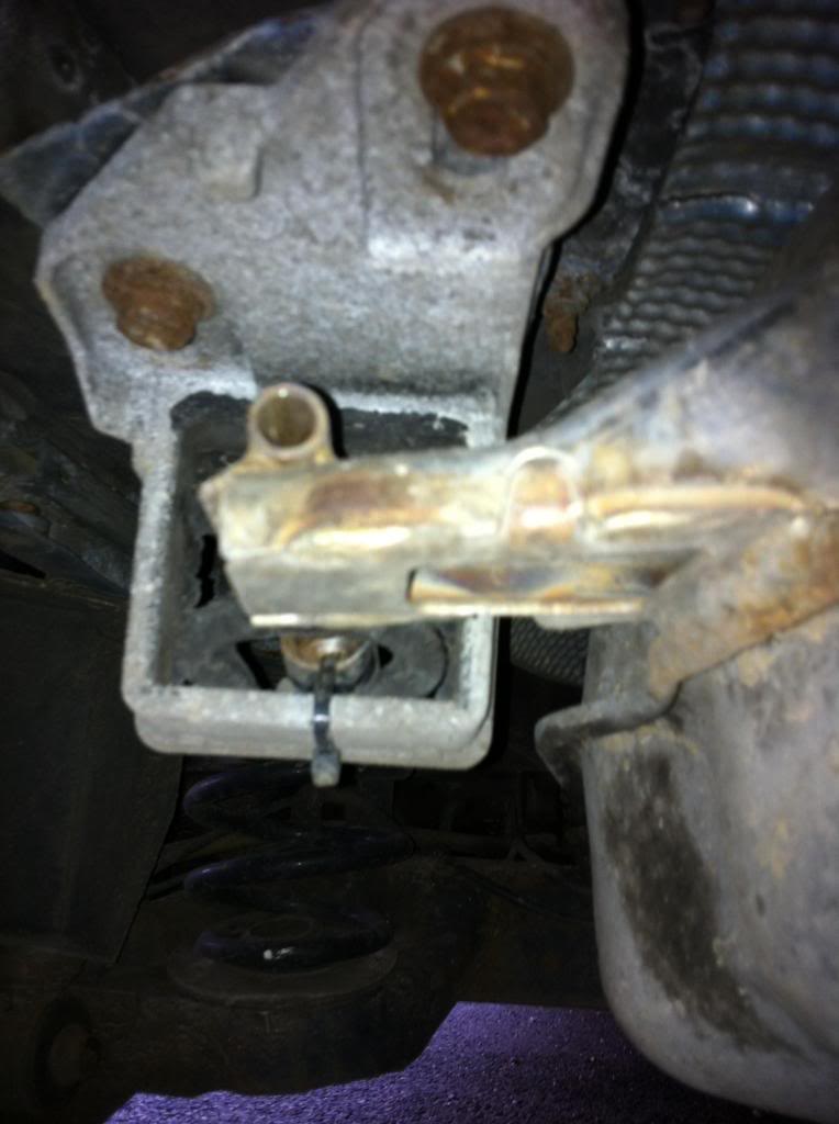

Also, I put some sockets in my exhaust hangers to lift my exhaust pipes up a bit but one has slid off! I need to sort this out sometime!

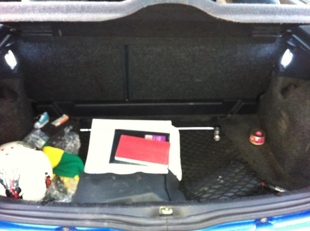

A few weeks ago I wired another boot light up as I felt that the light was quite weak in the boot at night. Both have a white LED bulb in so i can see all my mess in the boot now!

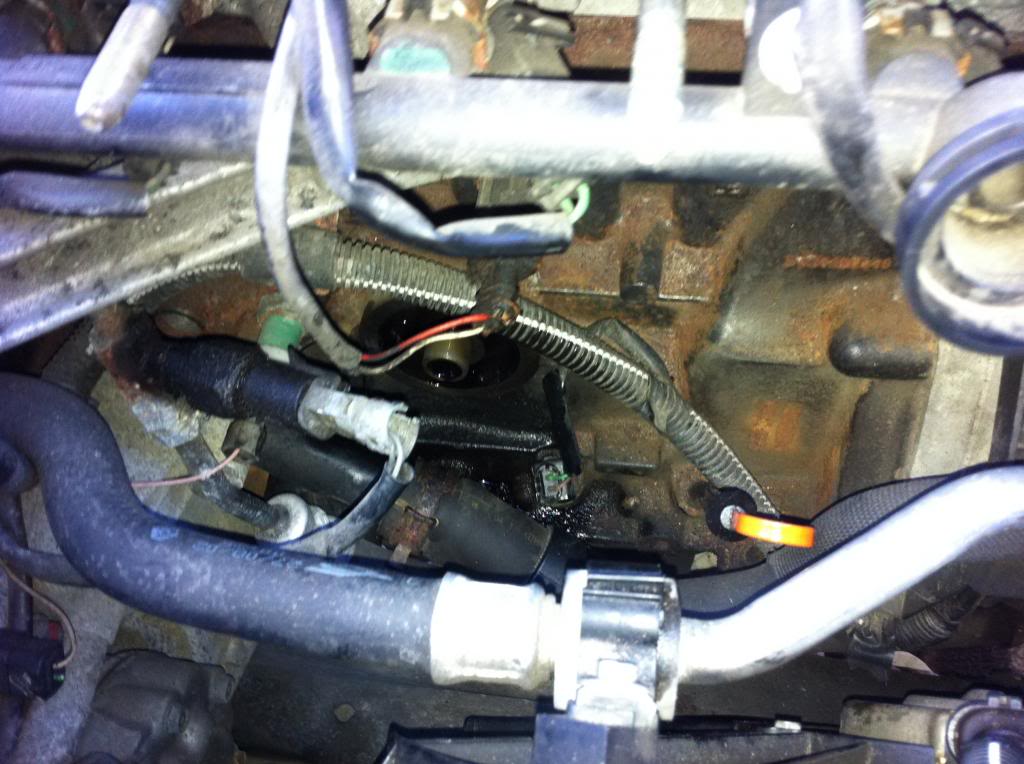

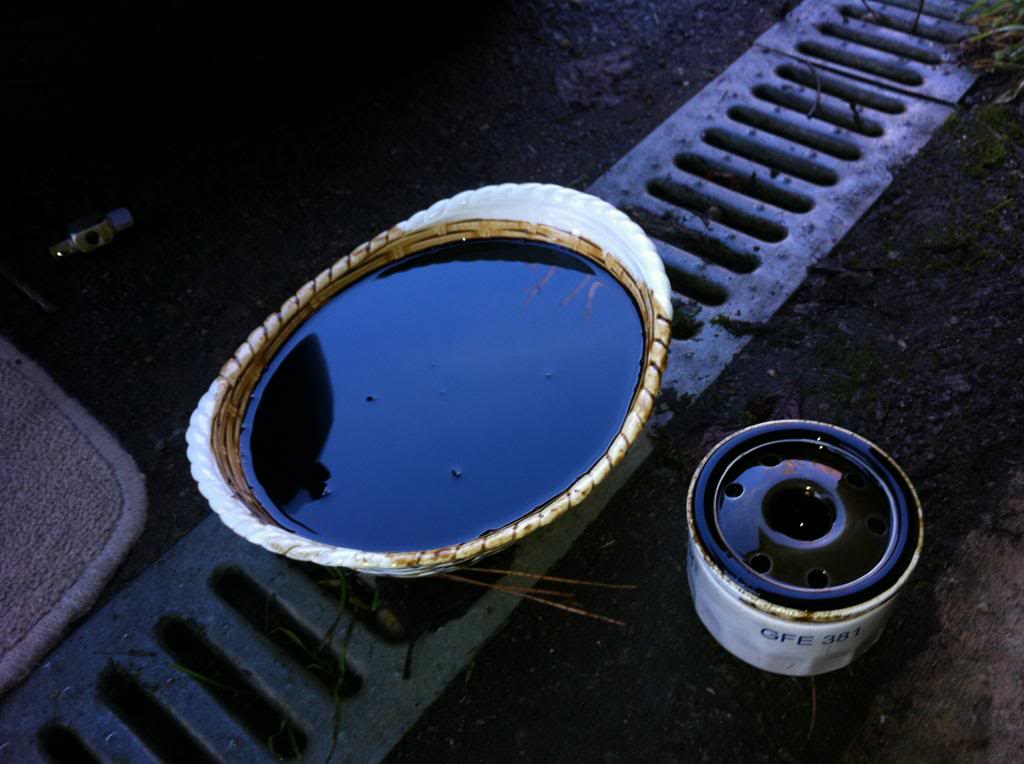

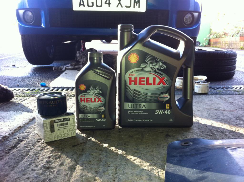

Did a mini service today! I changed the oil and put on a genuine renault oil filter and sump washer. Oil was quite cheap at £30 for 6 litres so that's why I chose this instead of elf etc. Here are some pics of me doing it.
First up once oil has drained is to take the old filter off! I was hoping it would come off easy and it did! It was just over hand tight so was pretty easy to get off.
These are the bits I used!
The oil that came out was very very dark brown so I think it was about due a change!
All Done! All in all pretty easy to do! It was my first oil change and I thought I did ok! One mistake though :eek: I cut open a 5l container so the old oil could drain into it and I did not notice it didn't have a lid on it :quiet:! Suddenly my I saw this black treacle coming towards me!
I took it for a drive and i was quite shocked how different it felt to drive! It just pulled better and it was a tad quieter too.

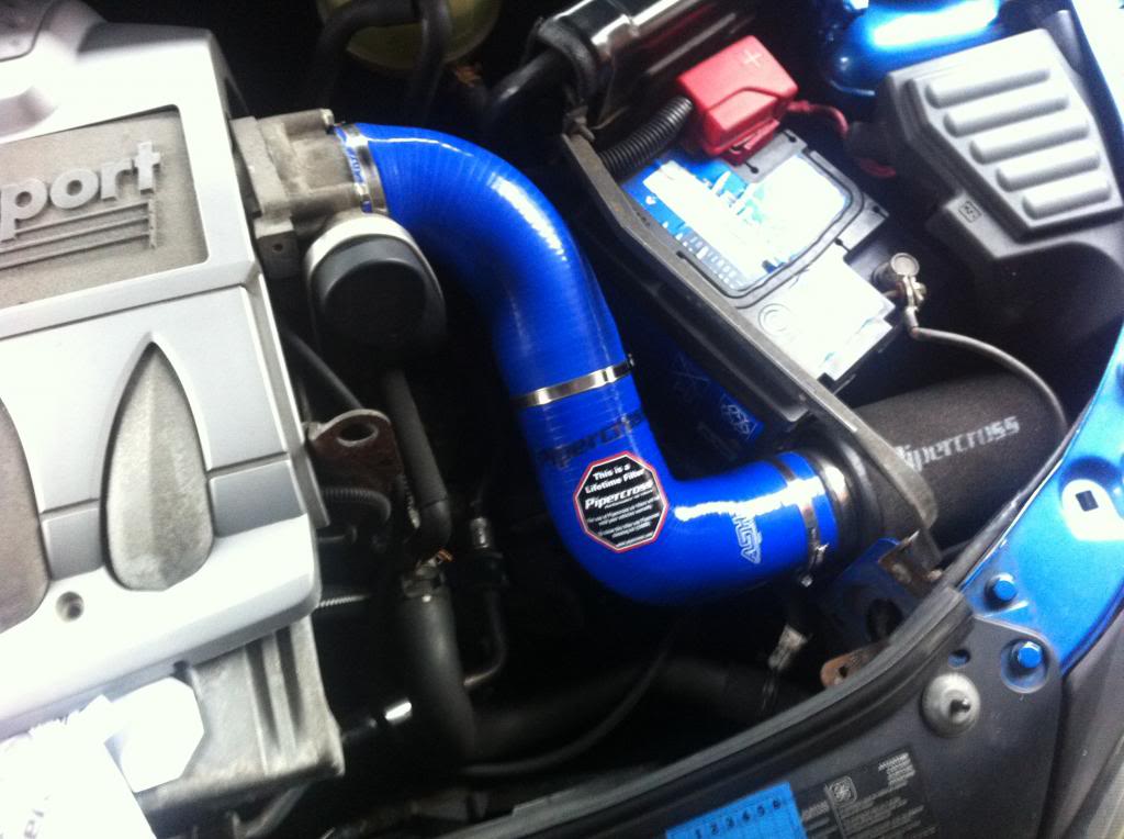

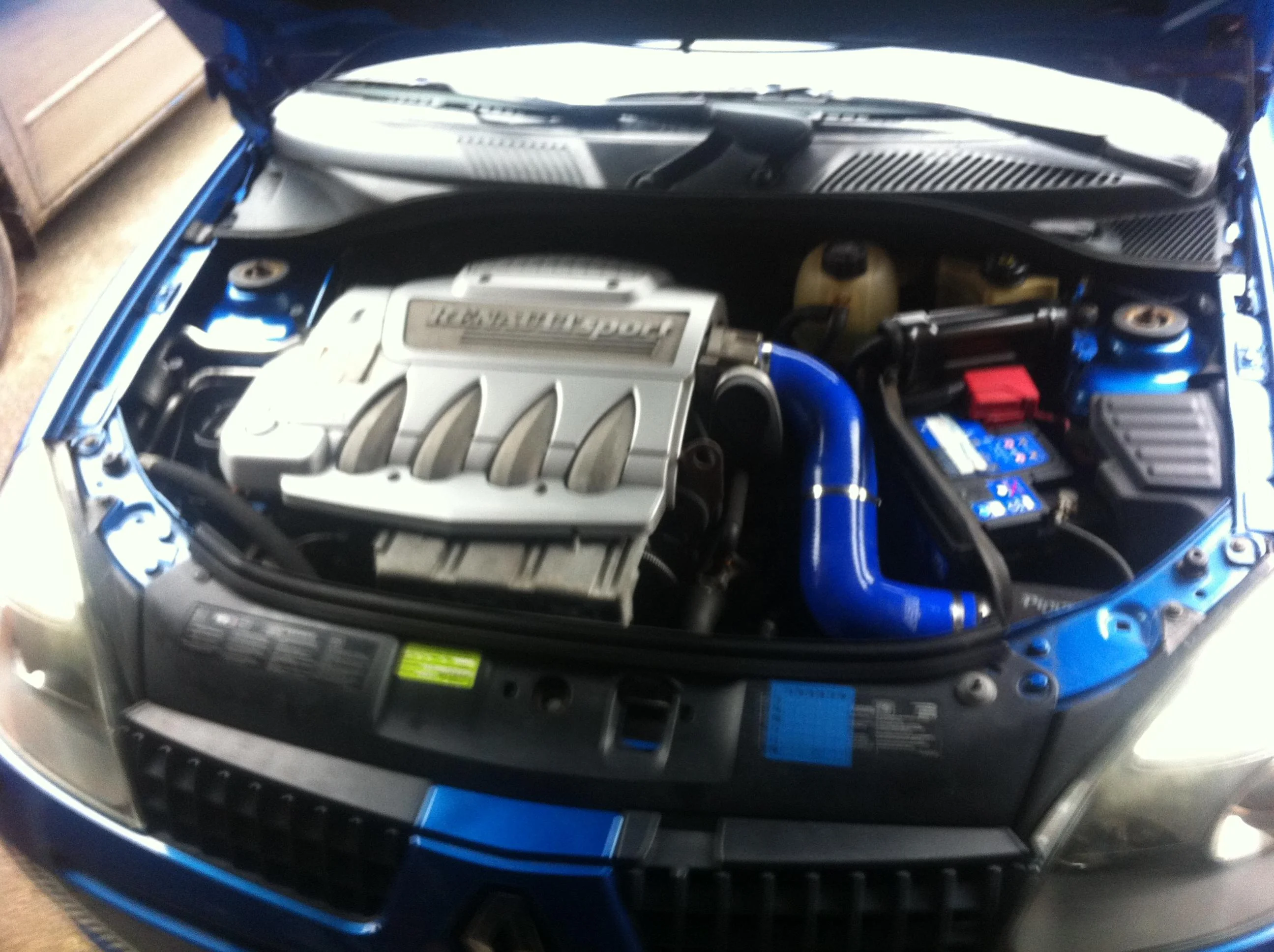

At the weekend I made an Induction kit for the 182!
After a lot of research on the different home-made methods of doing it I purchased 2 silicone 90's (in blue to match the arctic) and 1 alloy pipe connector and a C0131 Pipercross Filter.
Driving about up to 3200rpm there is no difference but as soon as you put you slam your foot down you can hear the air sucking into the filter and it sounds very nice! I drive like a granny most of the time but it's a good mod and puts a smile on your face when you fancy a blast! Cost £60 all in.

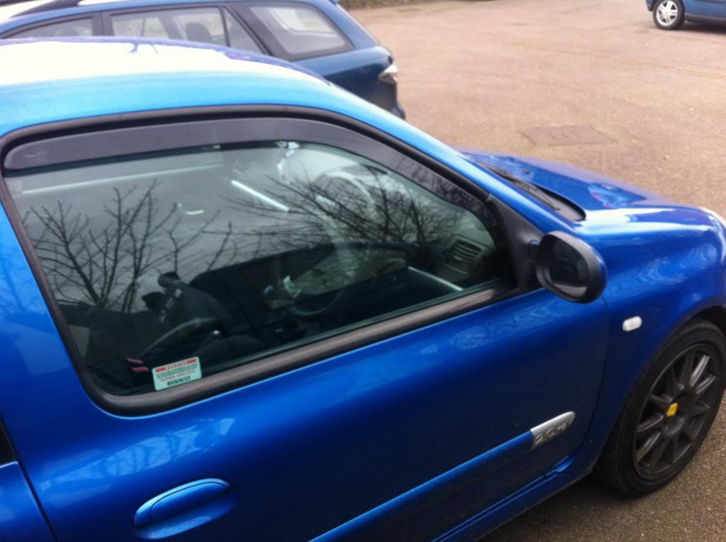

and i also got some team heko wind deflectors. They rub a bit towards the back but I can live with that. I thought that they would stand out too much but they actually look quite subtle imo.

Don't use the standard Renfault jack!
Haha I know why you've said this now! I was working on my car a few months back and I was using the original jack. Suddenly the jack let loose a bit and the car jolted down!
That s**t me up a bit so the next day I bought a 2.5T Trolley Jack and a pair of axle stands and they are much safer!

My wind deflectors are now sitting nicely, they no longer rub or catch. I think it just takes time for them to expand and get used to the window position.

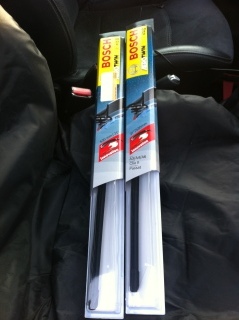

I got some bosch aero flats

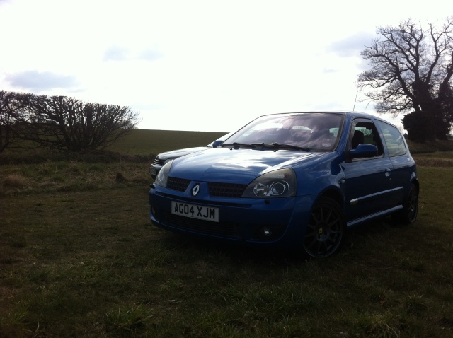

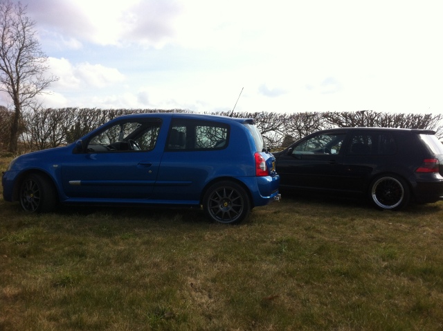

I went out at the weekend to get some pics with my mates golf!

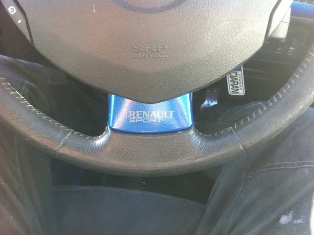

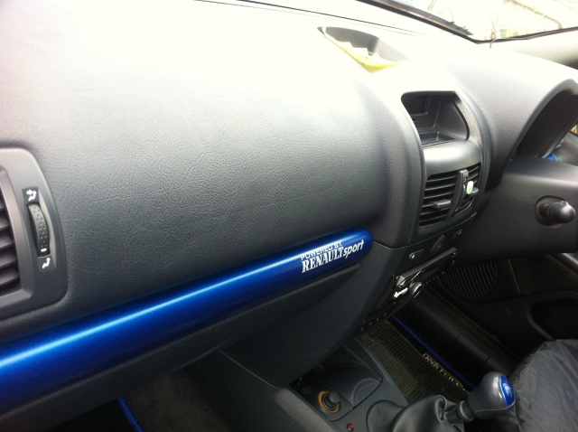

I've also sprayed my dash trims in arctic blue. They have came out brilliant and I have put some decals on them. I only have a pic of the steering wheel insert atm but i forgot this is the newer version of the renault sport badge! Nevermind!

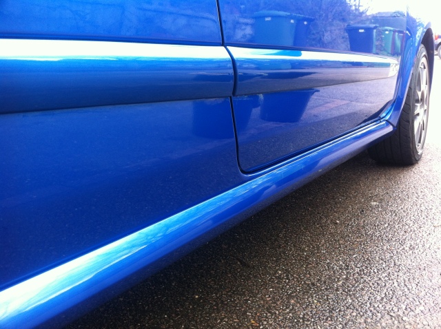

Had a bit of free time today so I decided to give the clio a quick wash and de-tar! I got some autoglym intense tar remover a few weeks back and I am in the process of getting rid of all the tar spots along side the skirts and bottom of the car. For some reason, tar is just attracted to the bodywork :mad:!
I also took a pic of the passenger dash trim that I finished last week. I'm trying to keep the OEM+ theme and I think the decal goes well with it.

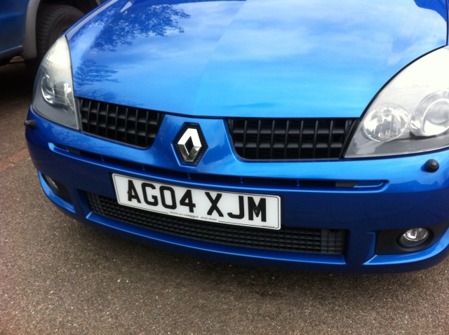

Today I de-tarred the other side of the car and now the car is nearly tar free! Today I decided to spray my front grill satin black as it was gradually turning to a horrible old faded grey.
I gave it 2 coats of white plastic primer then 2 coats of satin black. The grill was a nightmare to get off though! Here it is finished on the car!
You can really compare the new colour to the old faded grey on the bottom grill.
Looks really good now and the front looks brand new! I will probably spray the other bits now (Fog surrounds and lower grill). I was thinking of spraying the lower grill on the car as that seems a pain to get off too.
