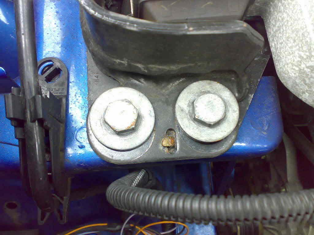

philmots said:are you pulling the engine forward at the top? so basically just changing the angle of it
easy fix this!!!! its the engine hitting the subframe/ and or steering rack, not axel tramp etc
i sorted mine by getting the uprated k tec dog bone mount.... and then slacken off the 4 bolts on the left hand engine mount (the one near the oil cap lol) pull the engine forward with the help of a bar/mate then re tigthen the bolts. Job done, mine never does this now, no mater how much right foot is given in 1st

Yeah I got a Cup and a Williams, the knocking was on the Cup, but is now sorted. 2 mins of a job, if its knocking under hard accelleration, it will the the manifold knocking on he bulk head.

Theres the 2 sorts of noise, ones a knocking which comes from the engine bay which is what the gaz fix sorts out, the other is from the tyres loosin grip what they all do..

This guy is right ^^, I could get both noises if I belted it, I know the knocking I was having wasn't the tyres jumping even though they were, my Wiliams does it, its just the wheels trying to grip, the mount noise is different, this axle tramp stuff bangs from the whole front end where as my mount problem seemed like it was coming from the pass side more than the whole front of the car.
I can now accellerate full beans with NO banging at all. Unless I wheelspin, but I have pedal control so this doesnt happen
I could get the noise in the dry at around 5k revs 2nd gear, the wheels didnt loose traction.
For the 2 mins it takes to adjust the mount its worth trying it to see if it improves, it was the last thing I'd tried
Does that 5mm of movement make all the difference?
