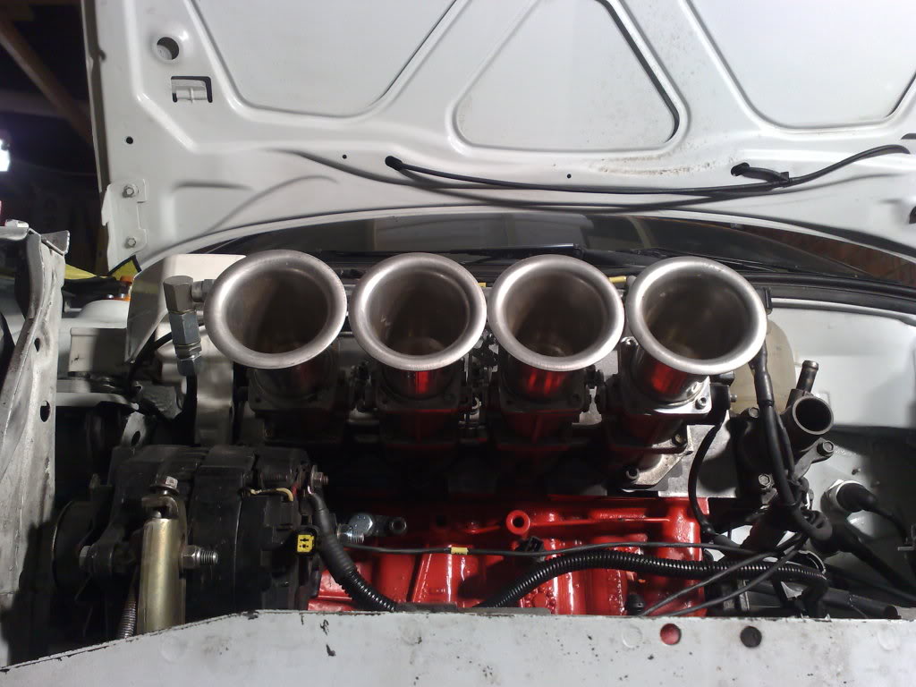

Can see a nice series 1 rs turbo in some of the pics aswell!
Just to let you know, your oil is not getting back to the sump fast enough. We had to open all the oil way's back to the sump and put an extra 1/2ltr of oil in to halt the problem, among aload of other tricks to stop these engine's blowing up in the rigers of rallying.

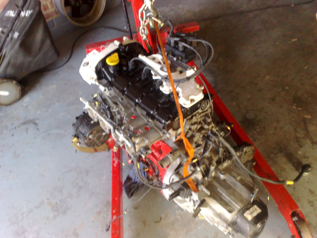

as promised. a little update.

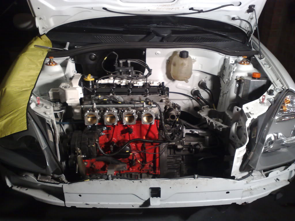

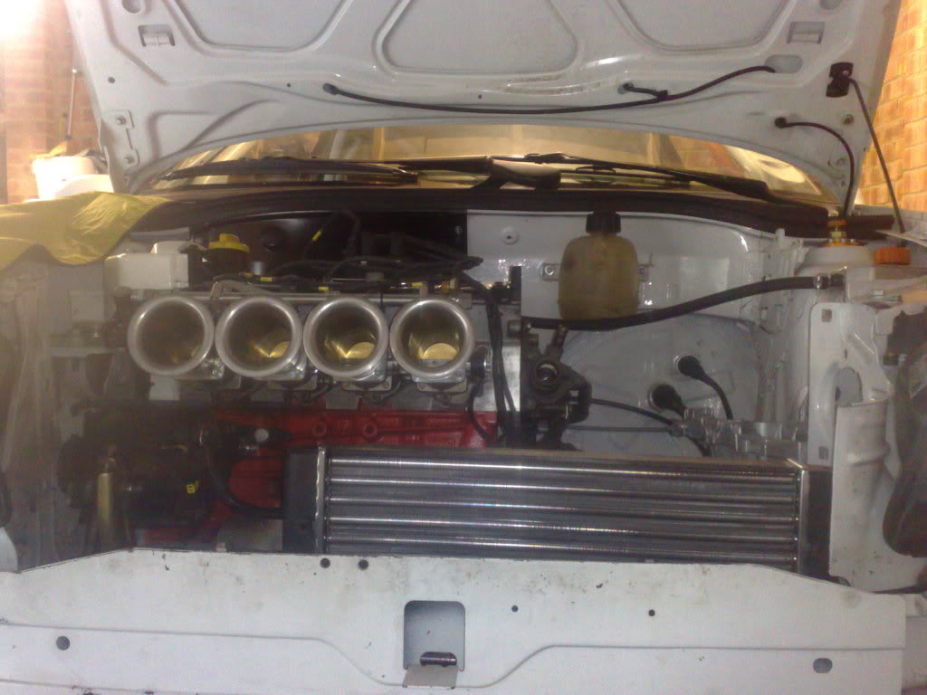

got the engine and box in, all wired up, just need to put all the fluids in and once i get the new fixings for the race fan to the rad i can put that in and connect all the hoses up. may wait tho and get some black samco's.
couple of pics...

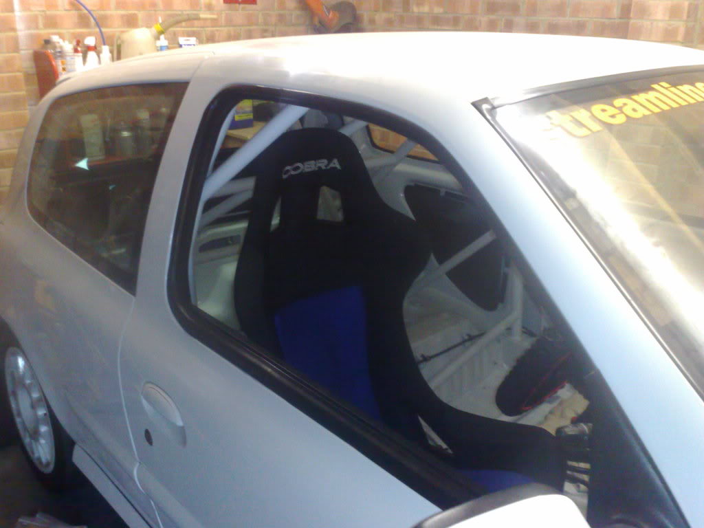

also picked a seat up of chrispy and got that fitted. my saftey devices harness is getting sent out on monday

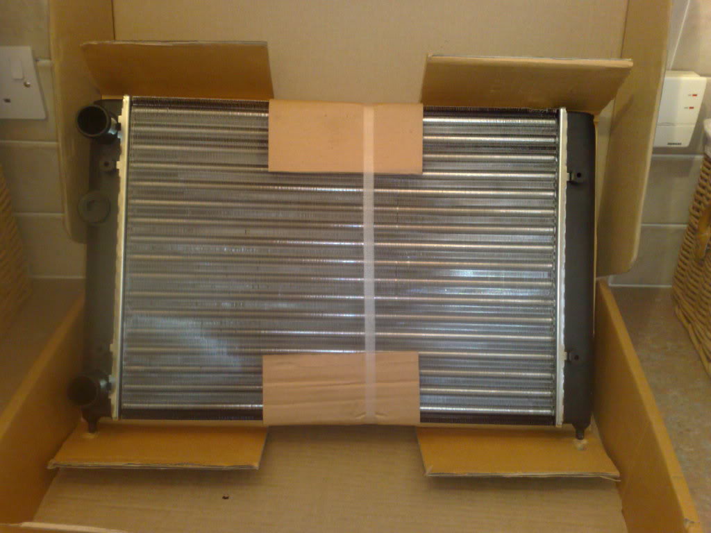

the new rad

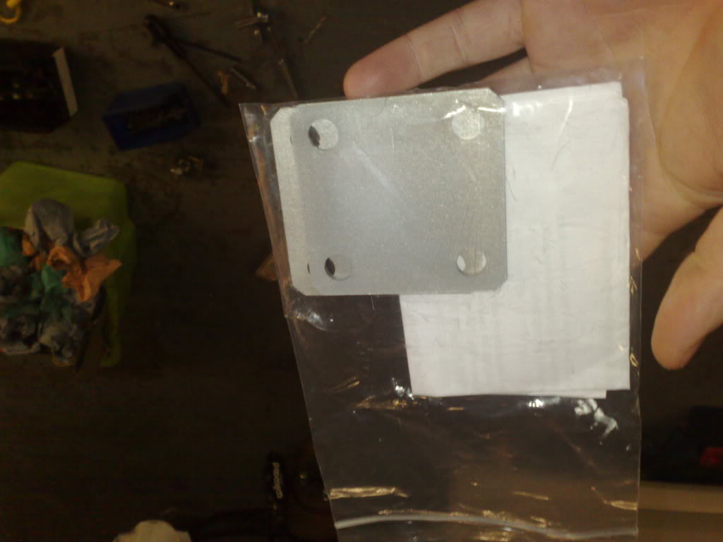

and a couple more shims for the rear

got these shims off ebay!
