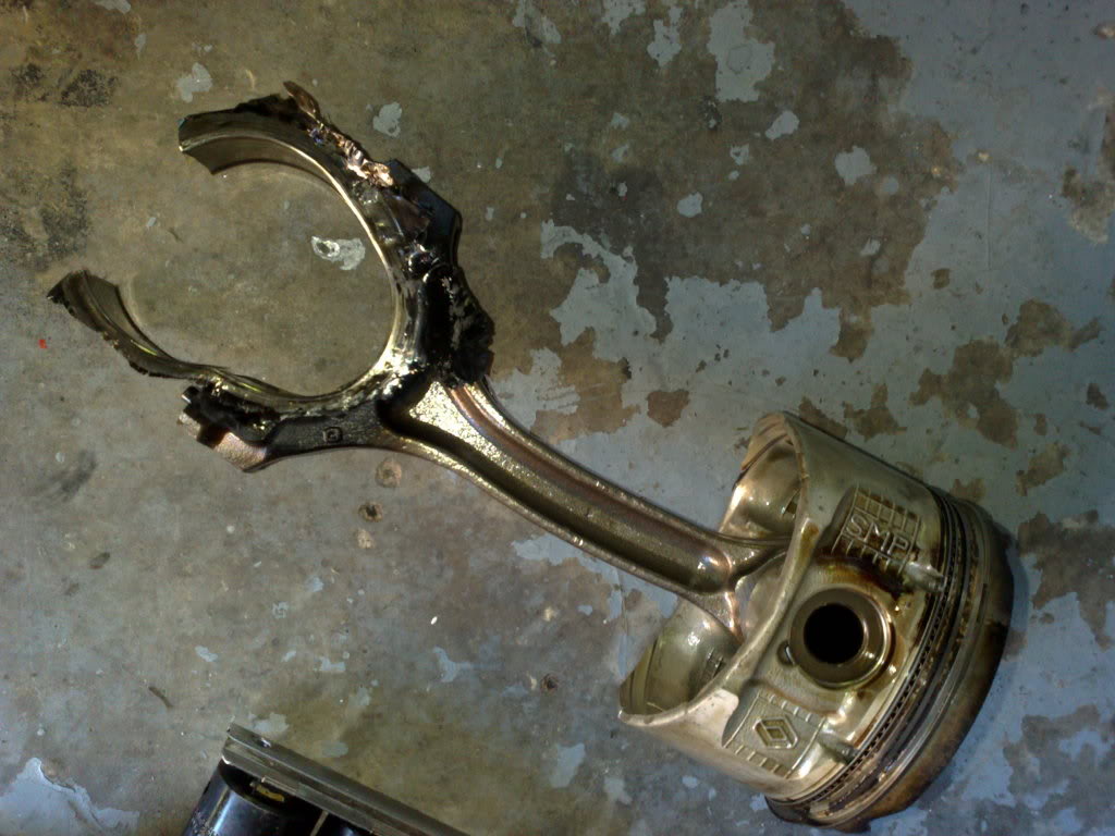

yeah edward is a top bloke and knows his stuff. My car was also getting a lightened fly wheel and uprated clutch and polybush all round and he did my big end that had gone due to the oil surge. Had ARP conrod bolts put in while it was all out to. Should be sweet when i pick it up tomorrow. I also got him to do my aero catches on CF bonnet cuz they are a proper pain to fit!!

My oil wasnt low i always check it before track days. Apparently according to edward at EJM he reckons its rockingham that does it because its a backwards track. He had run his clio race car without a baffled sump until he started to do rockingham and then he started getting oil surge. The pump is on the left hand side i believe so thats usually okay on normal tracks cuz theres lots of rights but rockingham is alot of big lefts and its on those that i got a a warning light flash up. Makes sense to me.

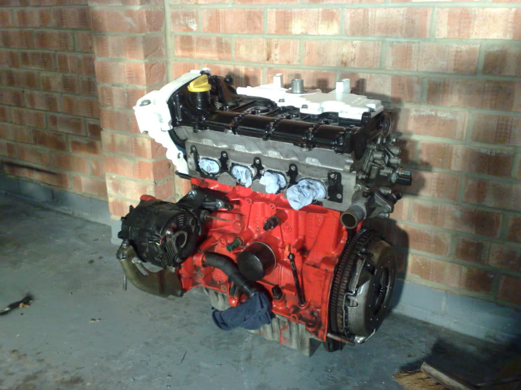

bought an engine of andy rg. bens old engine. managed to get my powdercoated parts on. just need to find a box now then i can drop it in!

spec of engine can be found here.
Full engine rebuild
Jenvey 48s parallels
Jenvey ported manifold
Jenvey 120mm trumpets
Jenvey FRP air box base plate
Jenvey alloy fuel rail
PiperX 600 100mm filter
Peco 43 injectors
Weber fuel pressure regulator
CAT CAM 422's (vanos cam)
CAT CAM PAC springs
Fully Ported Head
Full head rebuild with new steam seals, guides, inlet valves
Wossner 12:8 High compression pistons
Total Seal ring sets (gapped by headshop)
Lightened and balanced crank
Lightened Flywheel and balanced clutch cover
Weight matched rods
ARP 2000 studs (big end)
ACL race big end bearings
Glyco mains bearings
Glyco thrust bearings
New bottom end gasket kit (inc crank seals etc)
New crank pulley bolt
New water pump
New MLS Head gasket
New Head bolts
New thermostat
New oil pump
Full strip down and clean up
Block decked and head skimmed to bring clearance up
Block honed
Renault Cam belt kit with pulleys
Renault Aux belt kit
Cup AUX brackets
Cup alternator

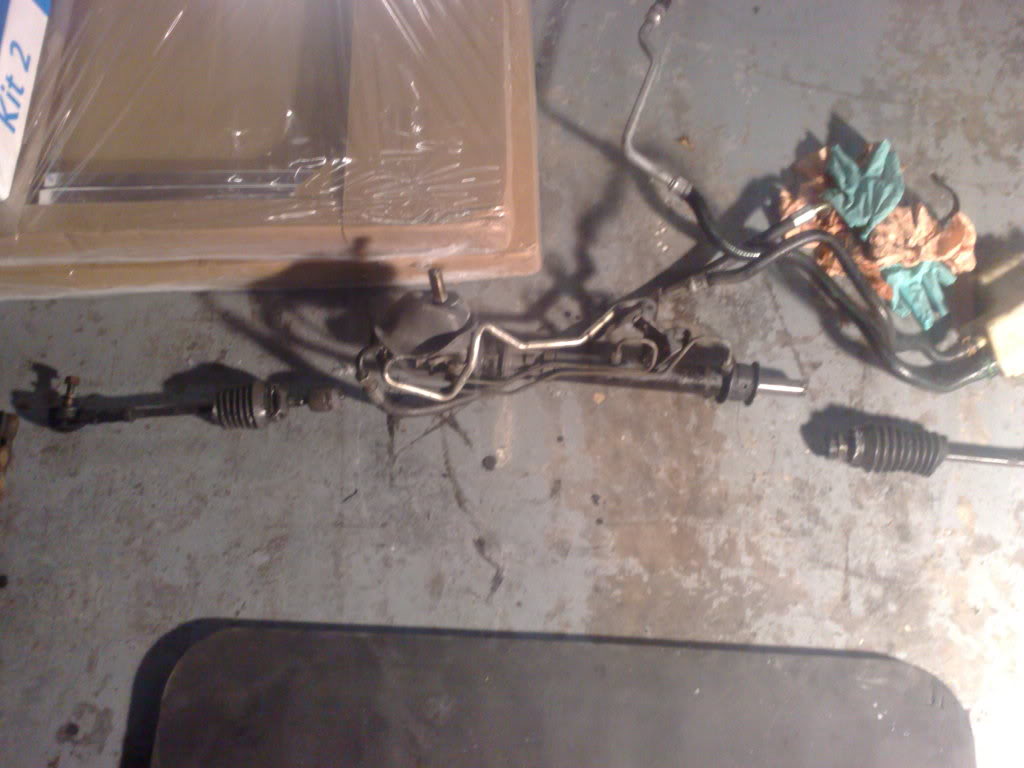

got an alternator set up on the clio that doesnt use powersteering, so had to change the rack, gone from this

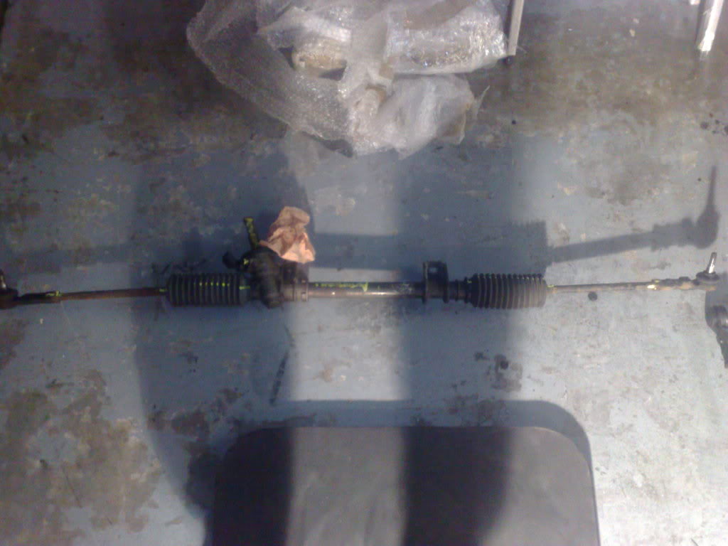

to this clio dci rack
had to swap the track rods, and track rod ends, as the 172 ones are slightly longer. but much lighter and only just over 2 turns from lock to lock. much happier.

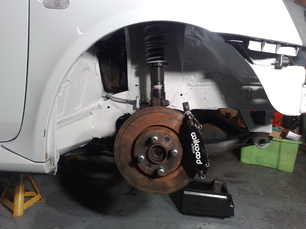

built the suspension back up last night! archs are so much better now there white
ignore the disks, they just need a little heavy braking!!

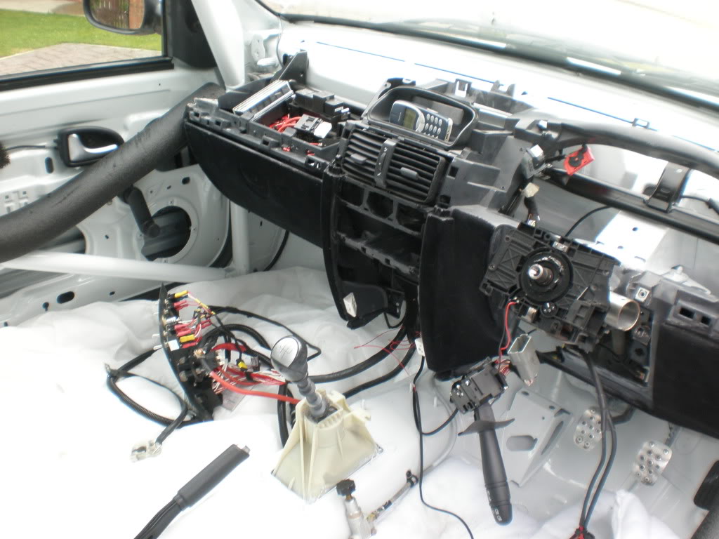

How much work involved in getting the dash in/out?
