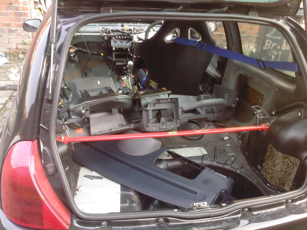

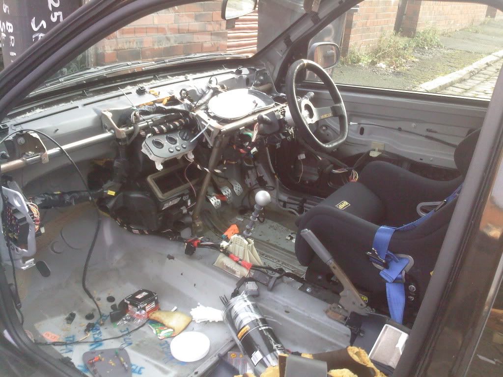

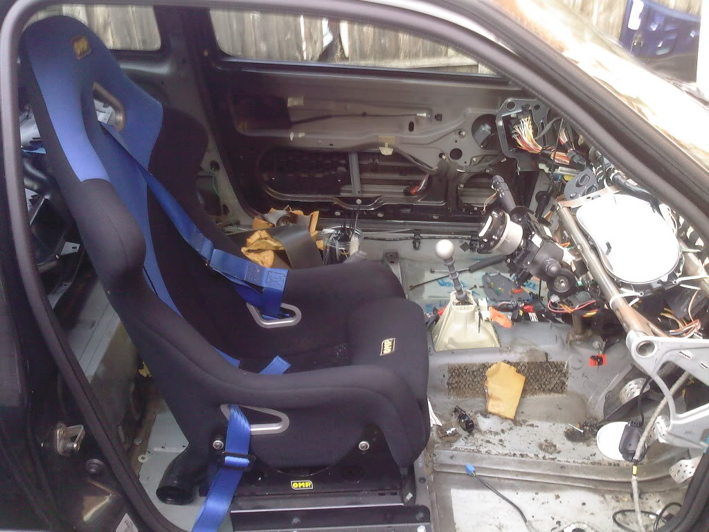

the car is a mess as i'm id way through sorting it but current pics of where its at
