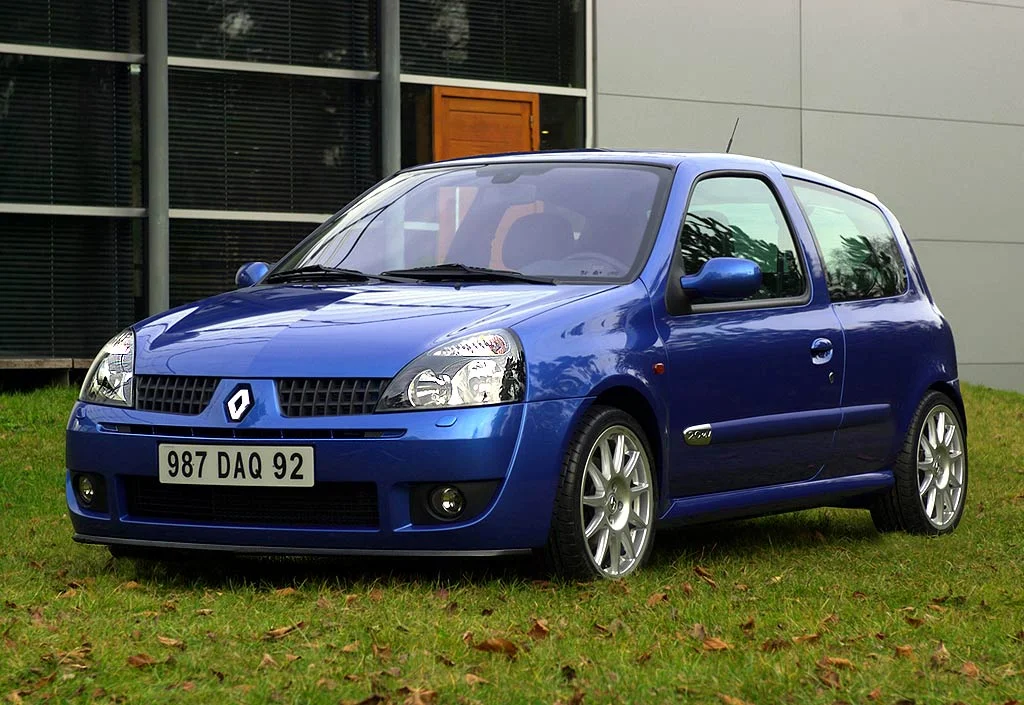

Hi there just a quick question does anyone know how light is the lightest cup 172 there is? Im getting one in a couple of weeks and want to make it as light as possible without actually taking interior out and stuff? Was thinkinig along the lines of carbon bonnett, mirrors, filter etc? Any more ideas?
