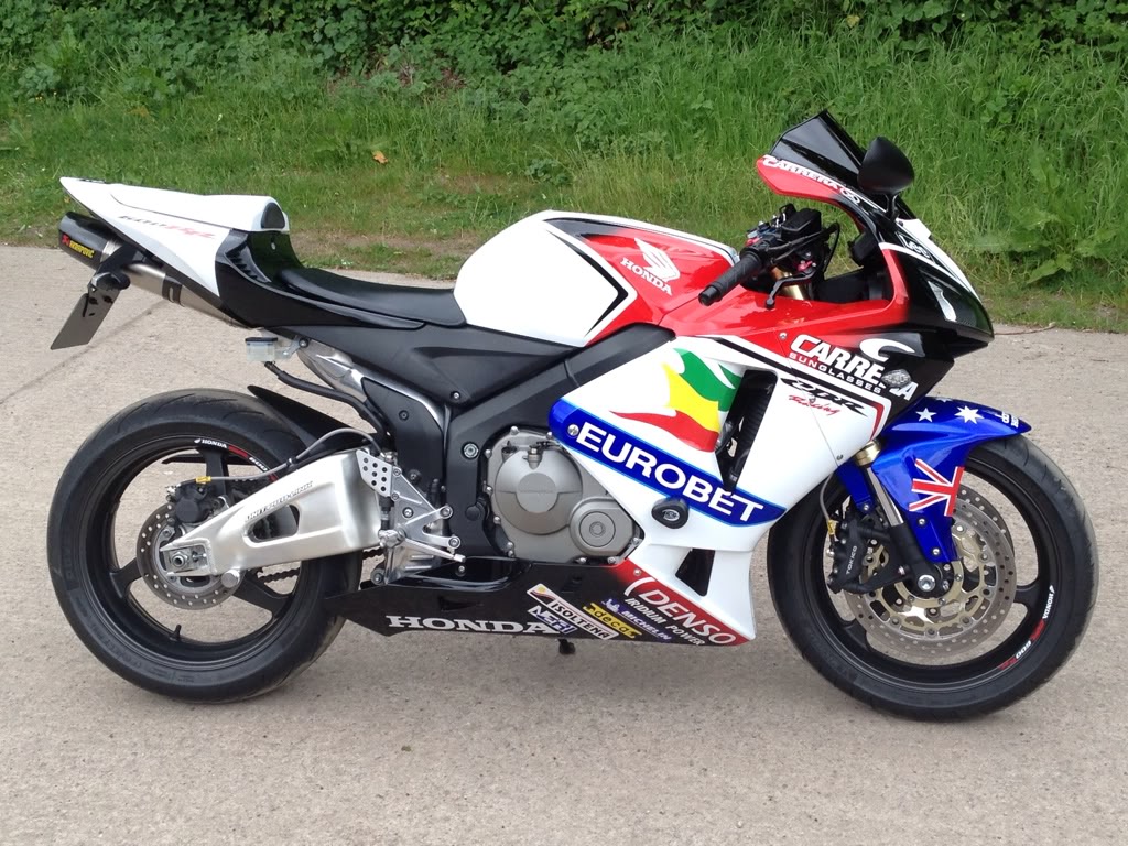

Honda cbr600rr 2005 (was standard when i bought it)
Spec list
honda lcr racing team graffix's (2008 season i think)
Blacked out double bubble (also have clear DB)
Stumpy levers in black (also have long type)
goodridge braided hoses (racing type)
Suzuki gsr1000rr K8/9 aero R&G crash bungs modded to fit
Flush fit front led indicators (clear)
Rear seat cowl (also have cbr1000rr fireblade seat cowl needs spraying)
Rear foot rest's removed
R&G tail tidy
Cbr600rr 09-12 akrapovic titanium exhaust (link pipe had to be made from scratch by longlife)
cbr600rr wheel stickers
Also have diamond rear set in black (needs banjo type brake switch to work on road)
Bike is still not finished though only little bits left :).

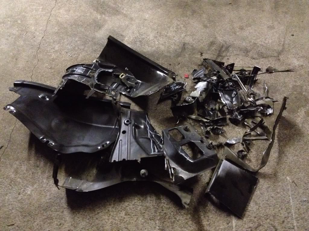

I've weighed the metal that was cut out from inside the car and it came to 8.52 kg seams low to me and that it should be more but didn't have a big weighing scales so had to use the kitchen scales 3times and add it together lol.
Will have to buy propper scales and re-test.

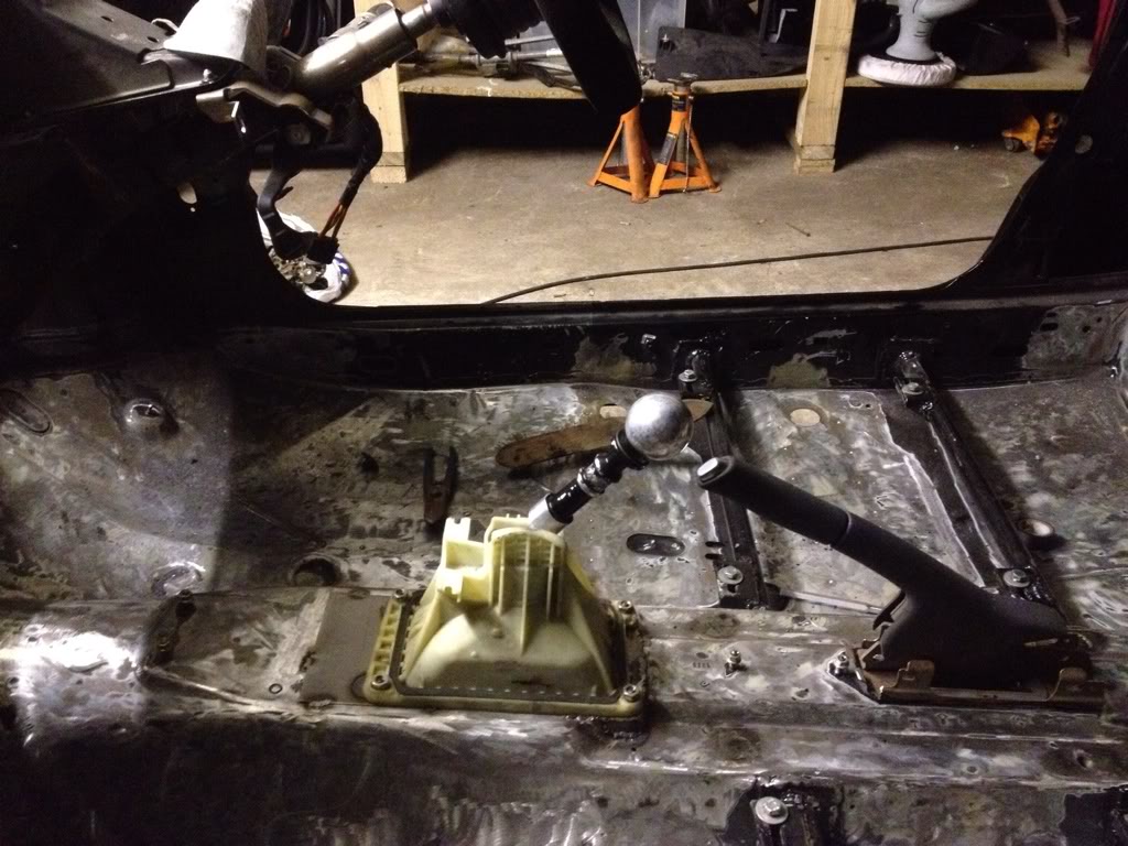

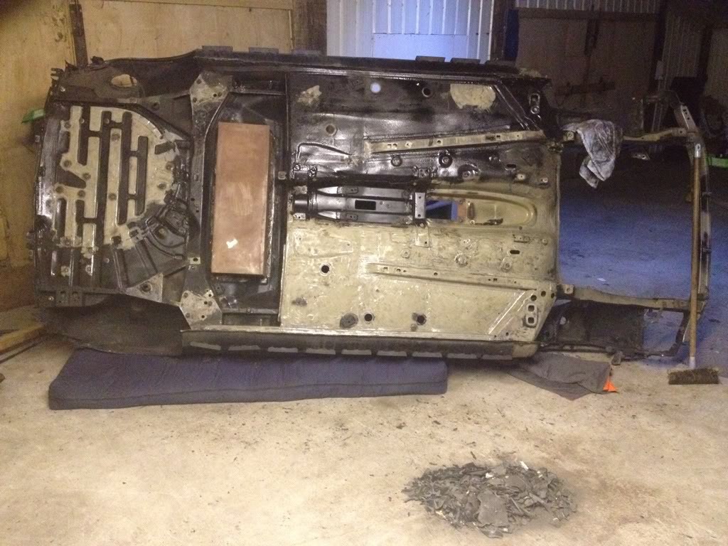

Been pretty busy lately with wedding's party's but still managed to find time to work on the car.

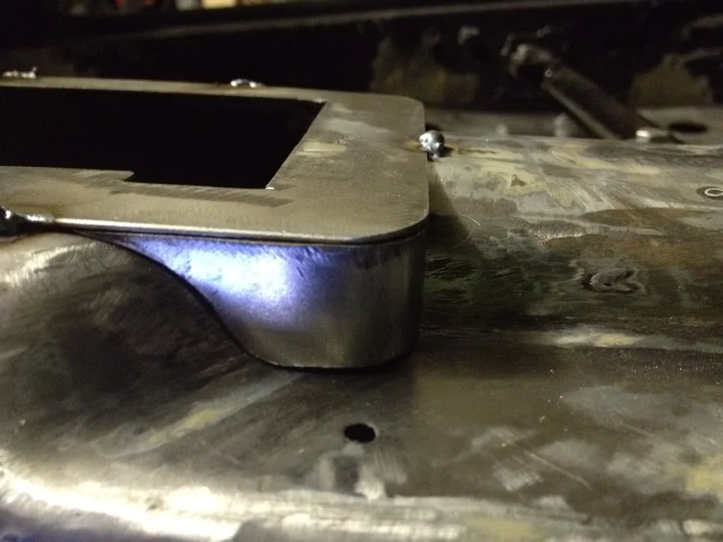

So here goes after finishing the interior (welding up the box for the fuel tank and relocating the gear selector 50mm closer) i then set my sights onto the engine bay and started to attack unwanted metal i was quite surprised that there was loads taken out.
Here's the fab work for the gear selector
Its all welded up and flap disc'd down to a smooth finish.

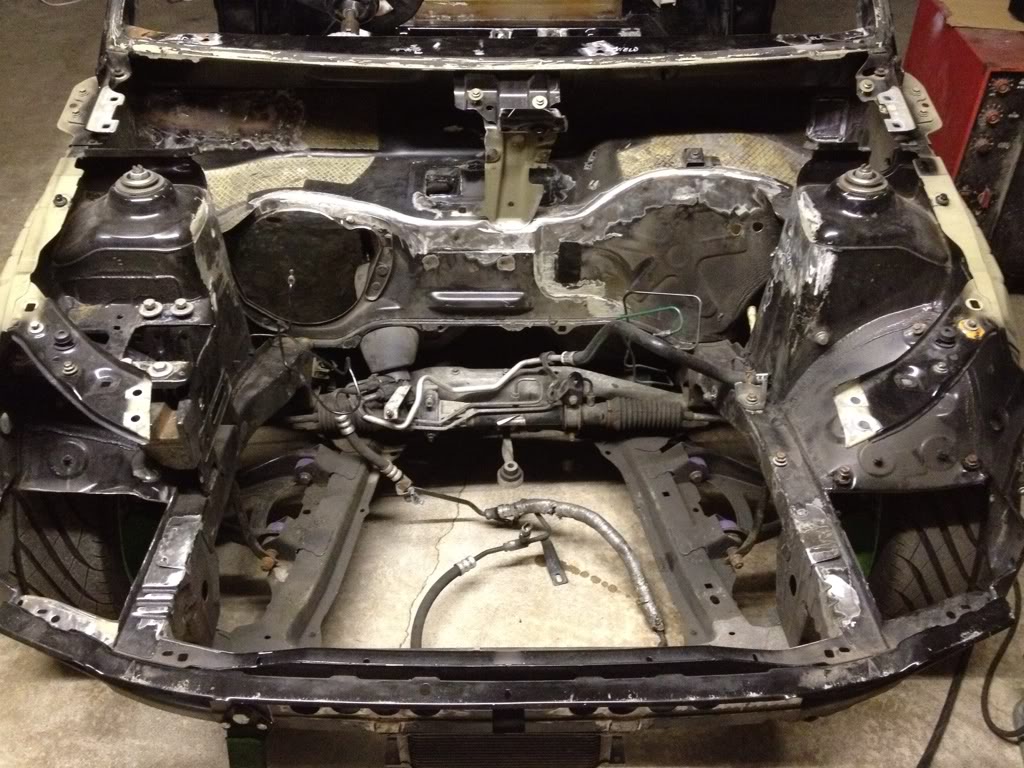

Here's the engine bay again surprised of how much come out.

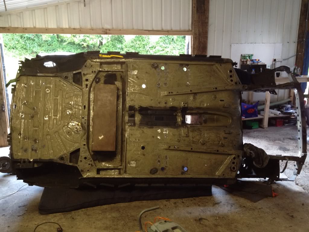

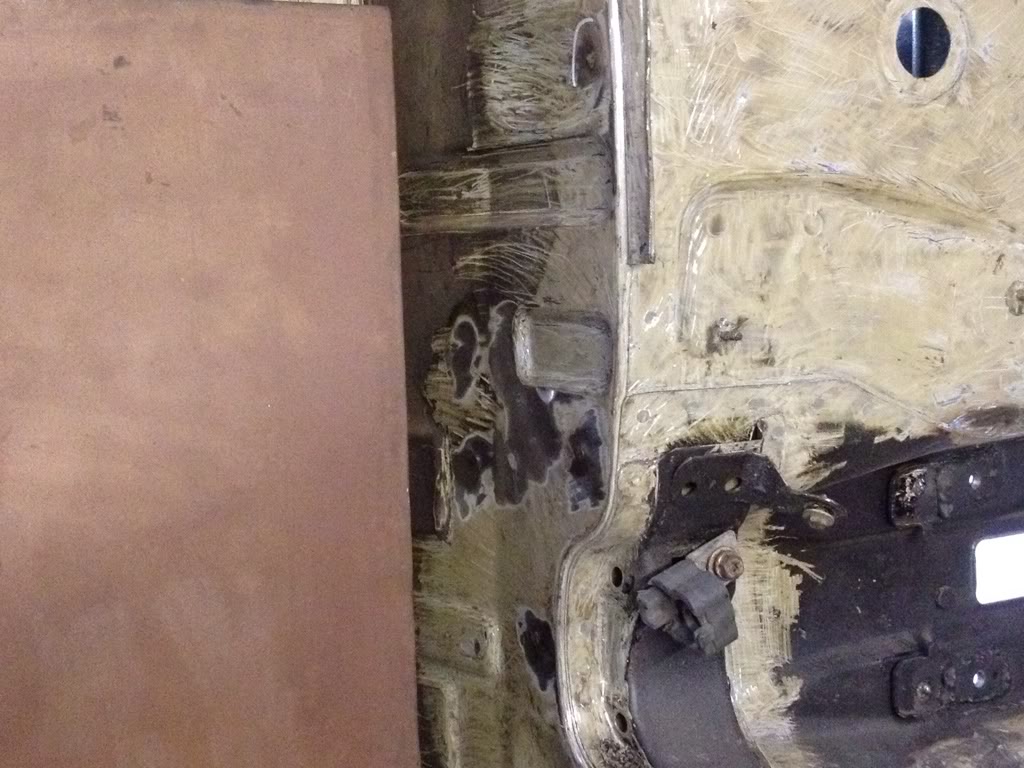

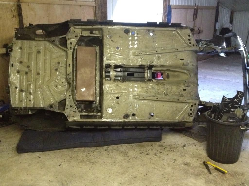

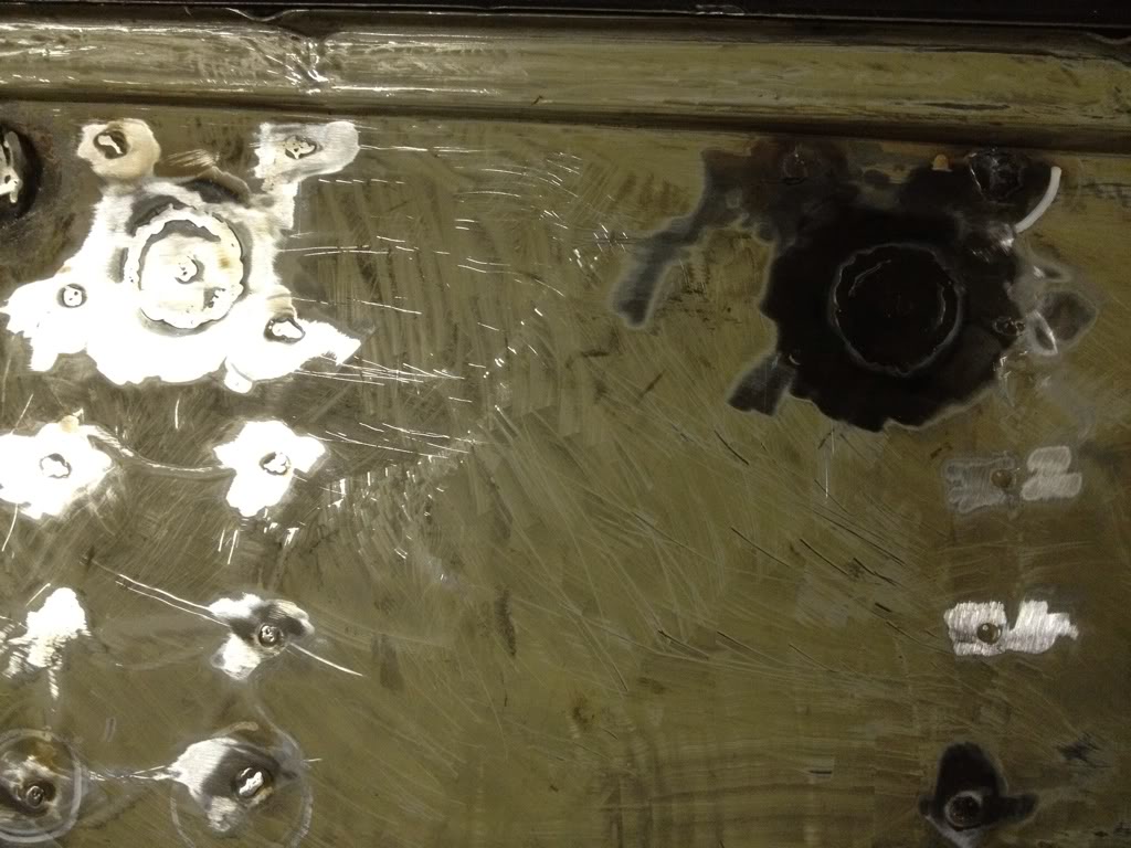

And finally after removing the axle and subframe it was time to attack the underside.
This is all i've done at mo but i'm removing all underseal and seam sealer.

i don't envy anyone having to strip the seam sealer and underseal its f**king hard work and takes ages :( so be prepared for very small progress.

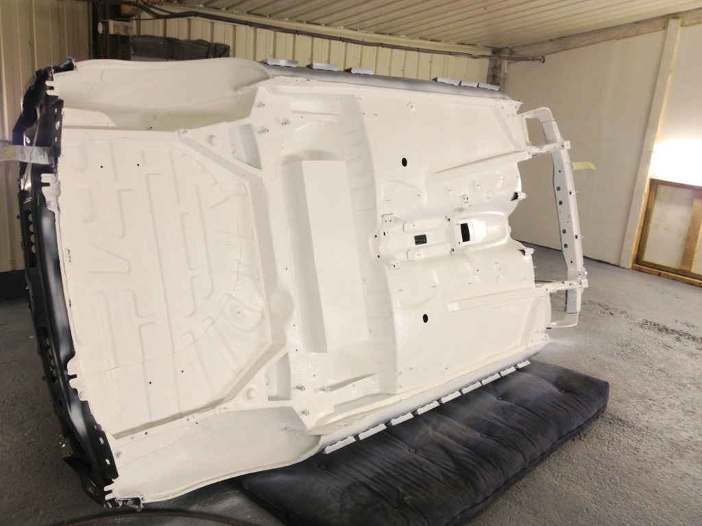

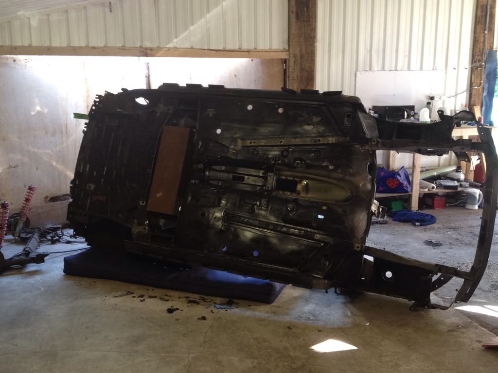

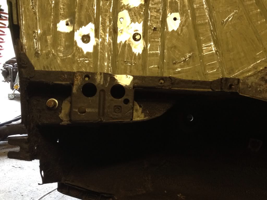

^Lol, ok so another eventfull weekend doing the same thing (scraping off underseal) but finally it's all off :clap:

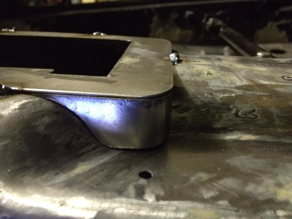

Ive taken off the fuel tank bracket to try and shred more weight, second pic is the box section i was referring to (passenger rear arch) but i can't remember what's it for so maybe someone can say if it's of importance and needed or not?.
Bought a 20gallon sandblaster in the week and planned to attack the underside this weekend but weather is pethetic (scatered showers) so i'll have to leave it untill a sunny weekend, if we ever get one that is. :(

I know what the box part is for now guys turns out its a ph1 design for the exhaust hanger, was thinking to much about stuff to do than look at another members ph1 car in my garage (waiting for a engine change)

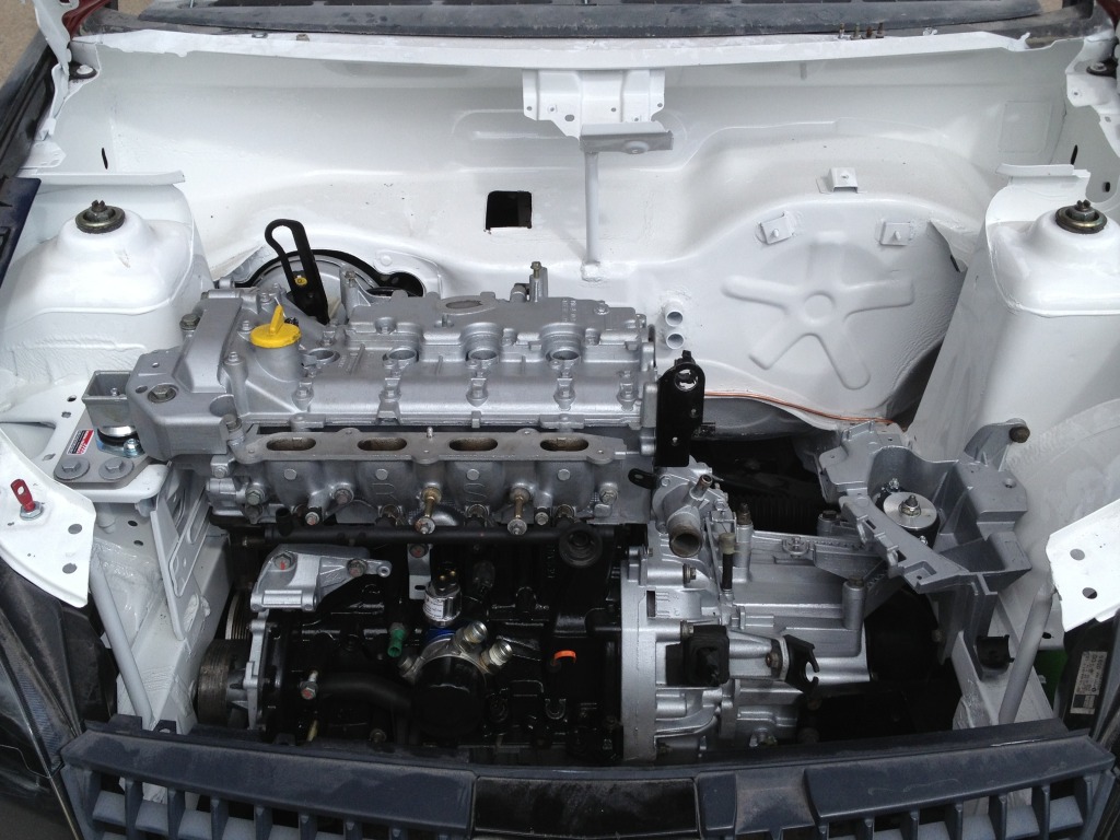

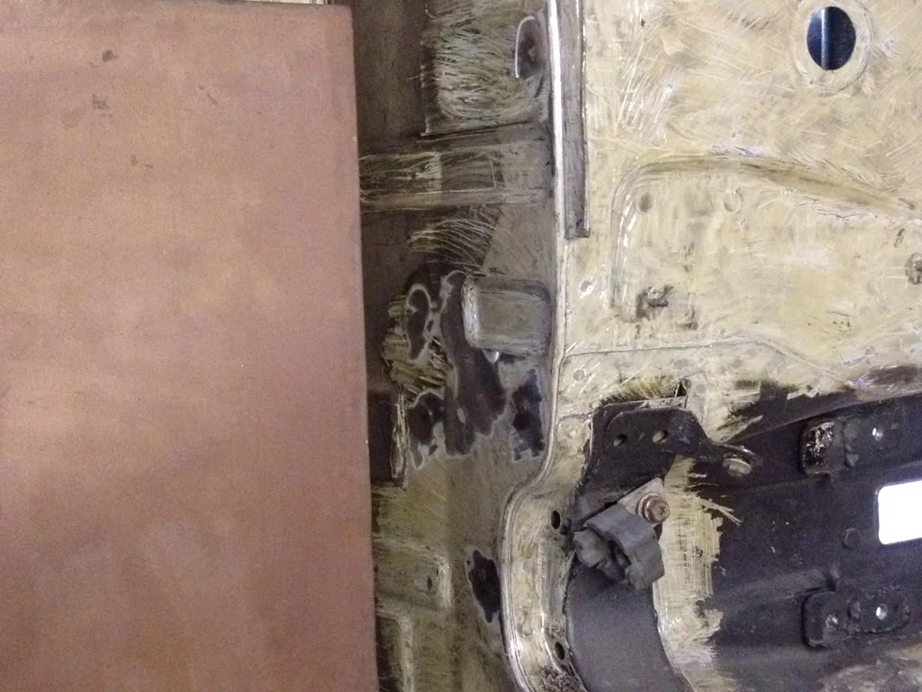

Update 2
Came over the garage yesterday at 16:00 and been out here since, so 1st i've been trying to get the sandblaster working earlier by trying it out on the front anti roll bar so loaded the container with kilm dried sand (been advised to use this but if it's no good i can purchase abrasives from a local company) well didn't get it to work as there's some chunky bits so keep blocking the end, will have to purchase a 1mm mesh sieve before i use it now.

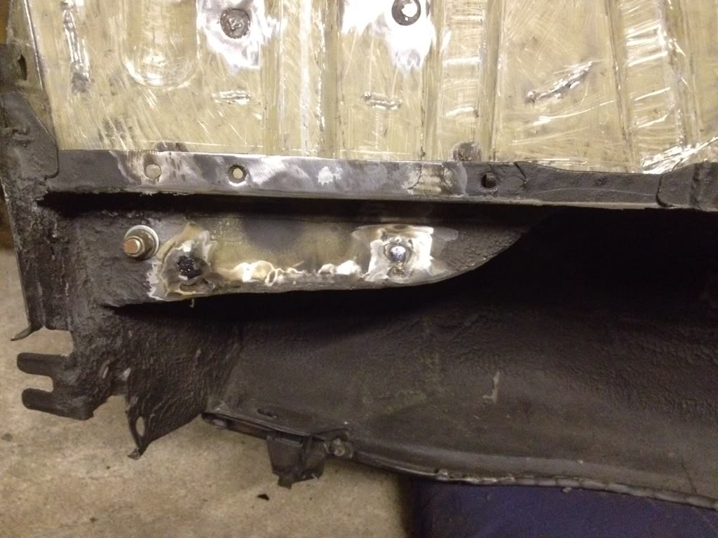

I removed the box that's used as a exhaust mount on ph1's and welded up the seam, i also welded up the grommet holes that's under the standard seat rails.

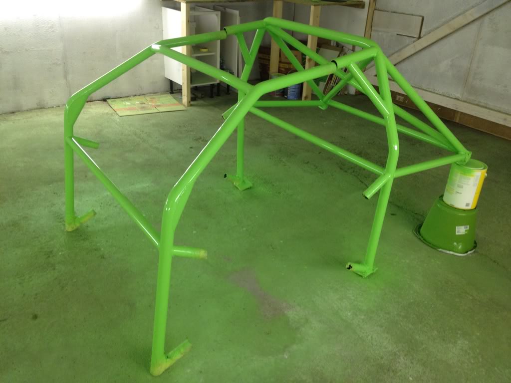

And finally after trying to find jobs on the shell i could do and not coming up with anything i got bored and decided i'll spray my roll cage ready and leave the ends so it won't burn the paint when it comes to welding it in.
Sorry for the pic quality all using a iPhone 4s as its easier to upload them without going on the laptop.

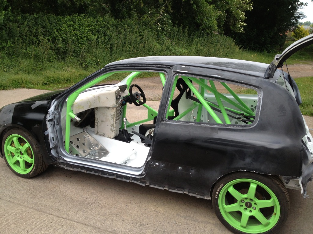

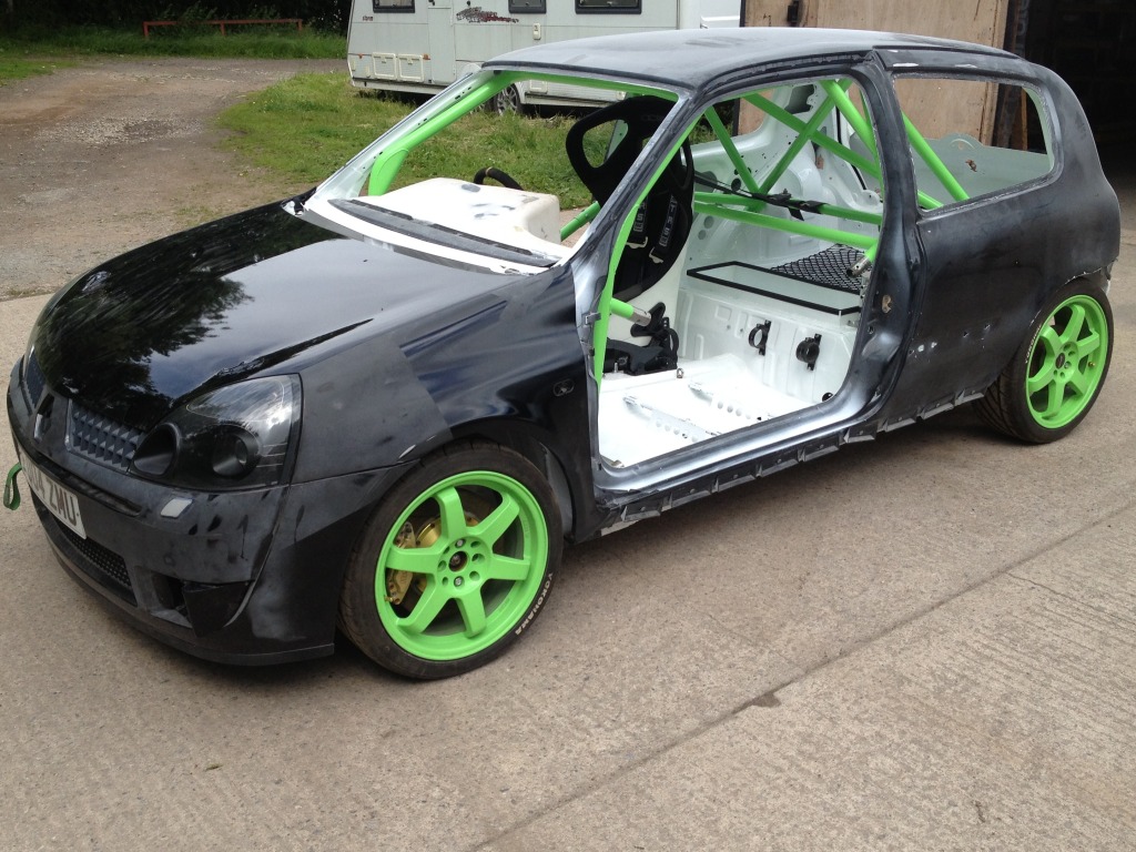

Haven't updated this in some time and to be honest at one point in the project like all others i lost interest in it and didn't touch it for a few months, but at some point i managed to get the inspiration to work on it again so rather than me babbling on and on i'll let the pics do the talking.

That dash looks amazing. Any more pics? Engine bay looks wicked too.
​Well done.

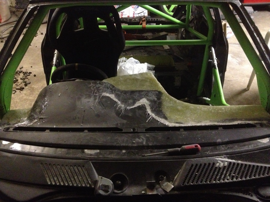

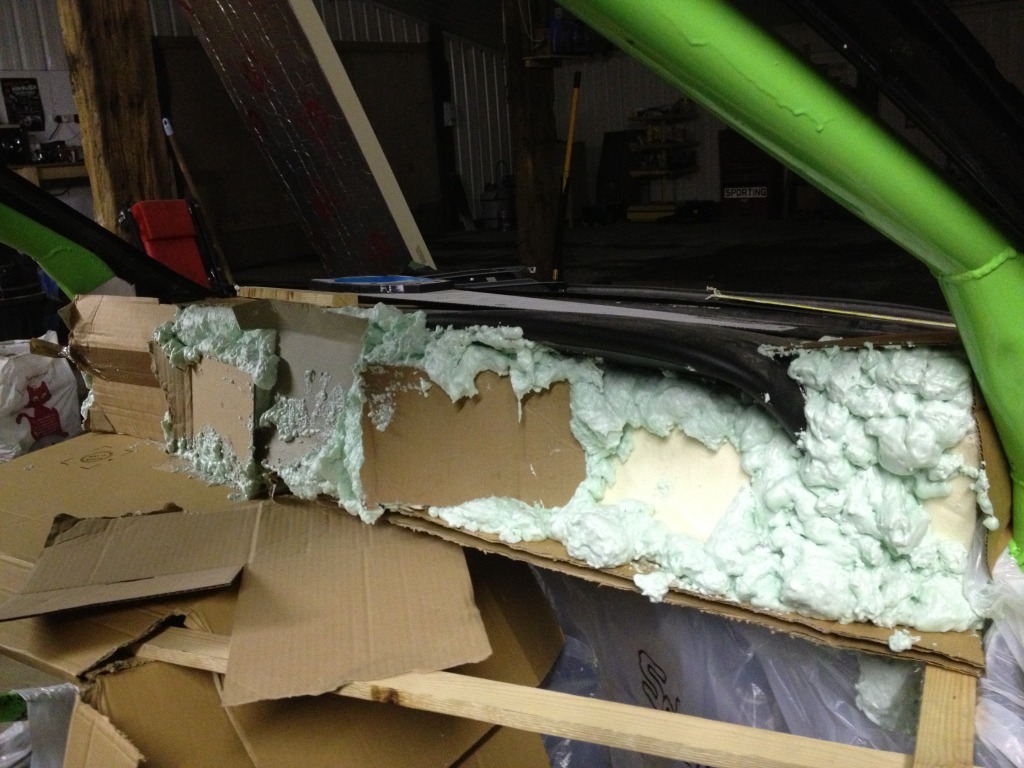

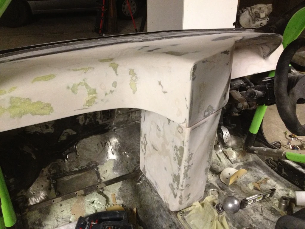

Here's a few more pics.
The dash originally started as a mk1 16v/Williams so to get the shape i used expanding foam.
I used fibreglass matting once i had the shape, and then removed all the expanding foam and added more matting and tidied it off flatting it with a da and once it was flat i used a thin skim of filler to smooth it.

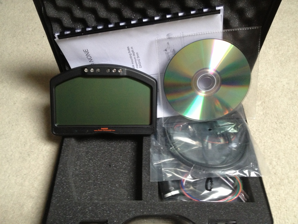

​For the clocks i'll be using this.

Are you using an ECU that can send a datastream to the dash?
Level of prep so far puts a lot of race car builds to shame TBH! :)
  M3, Cup racer'd 182
Cheers chip :)
As for the ecu i've decided to ditch the whole lot and use a omex 600 as a standalone, i'll keep some wires of the standard loom just to run the lights/wiper/water bottle/brake pot/fan and have them separate from the engine loom but for the engine side i'll be using a race loom omex sell that's all heat shrinked.

Great build so far mate..
Although you using a 2" brush when painting the cage :/

Yeah i did see something about a interface lead when i was doing some research, only thing that i had to do as i've removed the abs system was fit a "hall effect" speed sensor to the hub. But for the ecu and loom i'll prob leave all of that till last as i want fred@btm to map it and set it up as he's had previous experience with the dash and of course omex so best man for the job IMO.
  182/RS2/ Turbo/Mk1
I didnt think Fred did mapping at all mate?
Does everything else very well though from what I have seen.

Lol no that was my 1st attempt of spaying the cage in post #226 it's all been sanded down since then and re-sprayed after welding feet to the bottom.
