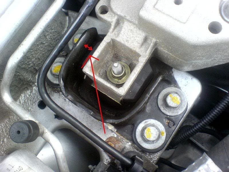

Undo the 4 bolts on the drivers mount and pull the engine forward then tighten. See if that improves things. (see pic below)..Where the arrows are there should be no gap between the rubber and the black metal buffer.
sorry to drag up an old thread, the pic above says to pull the engine towards the front of the car and there should be no gap where the arrows are, but surely if you pull the engine forward, you're going to increase the gap where the arrows are?
I should have worded it better, you pull the whole lot forward. So the black mount buffer needs to be moved forward as far as it will go with the bolts loose.
thanks for clarifying. it was already pulled forward, but i wedged a couple of peg halves in the back of the mount to push it forward another few mm. at least if it stops the banging i know what i need to replace. cheers.
