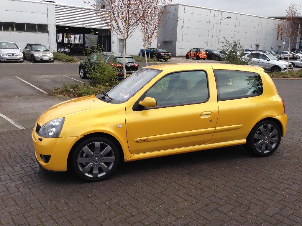

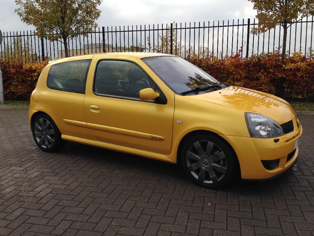

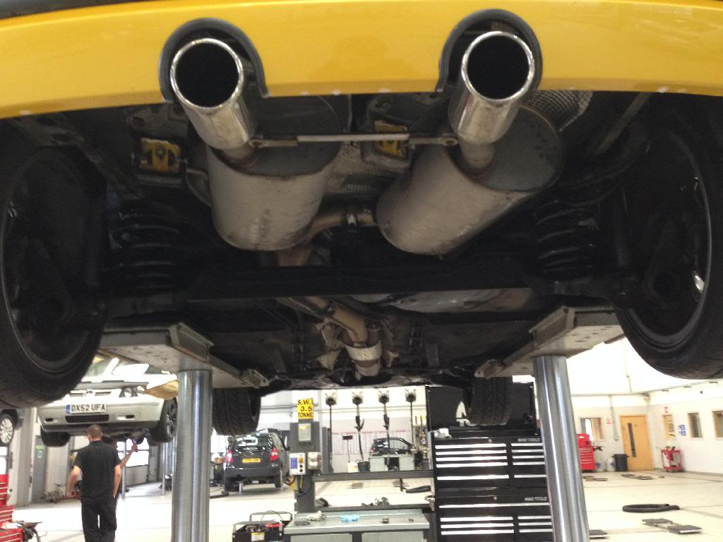

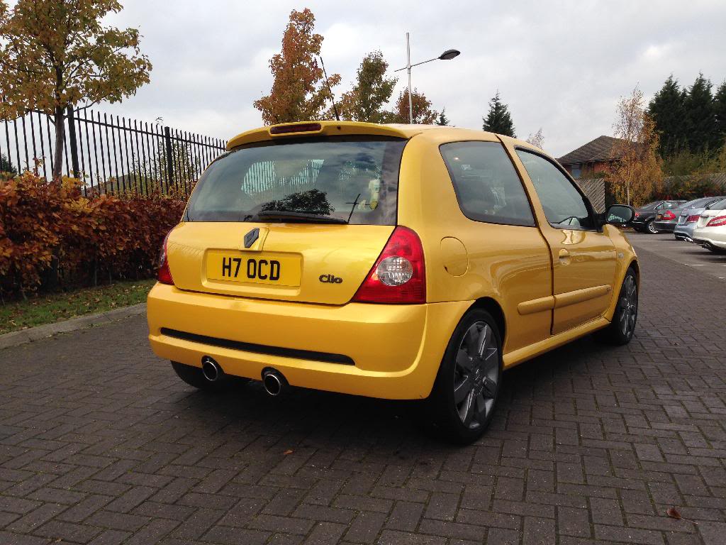

Soo then, owned the car for 5 days days now already started doing a few things so thought i would get a progress thread up ASAP before i get too far ahead, The car is a 55plate 'full fat' 182 with 3 previous owners which i bought from Luker1990 of here. It had 105k on the clock with more than full service history including the original bill of sale and spec list. The car is really clean in total and has really been looked after, I bought it with a Scorpion RS192 catback exhaust, JMS matched inlets and Eibach proline springs,
some of you may remember my old car which is sadly going back to standard and up for sale,

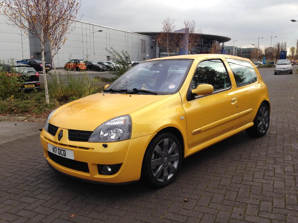

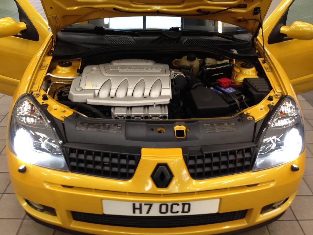

so here are some pictures Luke sent me before i went and picked up the car.

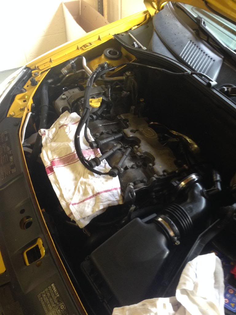

on the 120mile drive home on friday night the car picked up a miss-fire and was only running on 3 cylinders luckily about 10miles away from my house, Luke did everything he could to try and help as obviously its not what you want from a car you have just sold, after changing the coilpack and plugs on the saturday it was finally fixed which was just a loose connection on the electrical plug on top of injector 4,

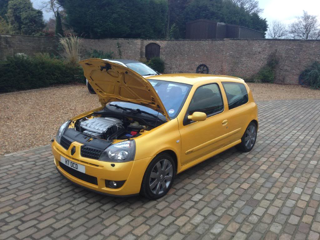

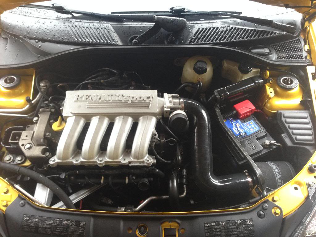

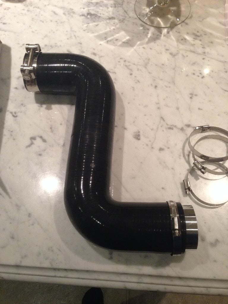

parts had already started arriving even before i picked the car up! i had ordered a ktec style induction kit from Auto Silicone Hoses and a ram air filter as advised by Pearse on here,
and fitted
All i can say is WOW it sounds unreal! cant really say i noticed a power increase mostly because i hadn't really drove it much before putting it on, in total the kit cost under £85, makes you drive very heavy footed aswell as it sounds that good!

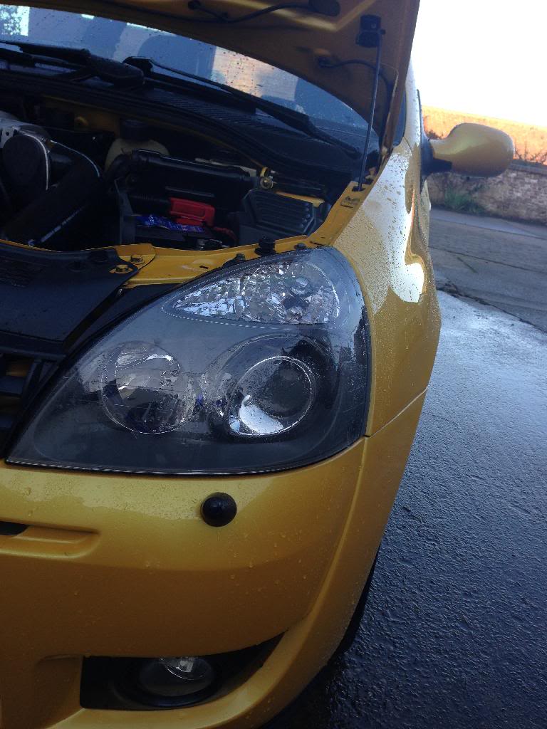

gave it a quick clean on monday before my drive down to york and fitted some silver visions, and thats it for now!

http://www.autosiliconehoses.com
it is 2 90degree silicone pipes (70mm inner diameter) with a 100mm alloy pipe (70mm outer diameter) connecting the 2 and a 50mm alloy pipe on the end for the filter to attach to, i was going to use 2 jubilee clips to keep the two pipes together in the center but there was no need as it got stuck lmfaoo! they do need cutting down do get the filter in the desired location but youll see what i mean if you buy one.

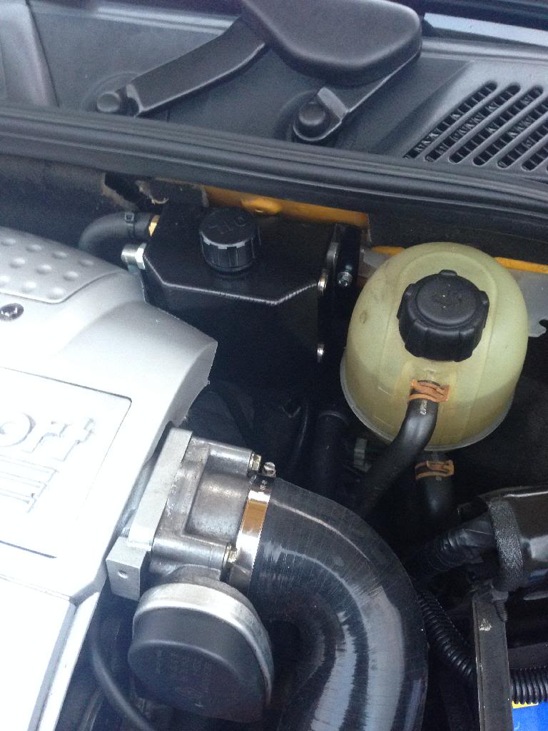

Is that an oil catch tank for the standard breather pipe next to the coolant tank? If so il be fitting one as ive got a brand new one i never got round to fitting on my zs180,will look nice on the 182,lovely car by the way my favourite colour :-)
yep it sure is! had to cut away abit of the webbing on the coolant bottle for it to sit flush

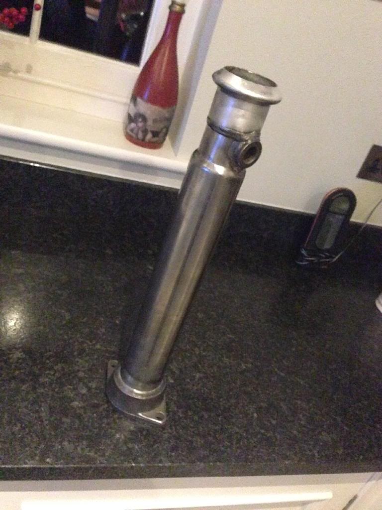

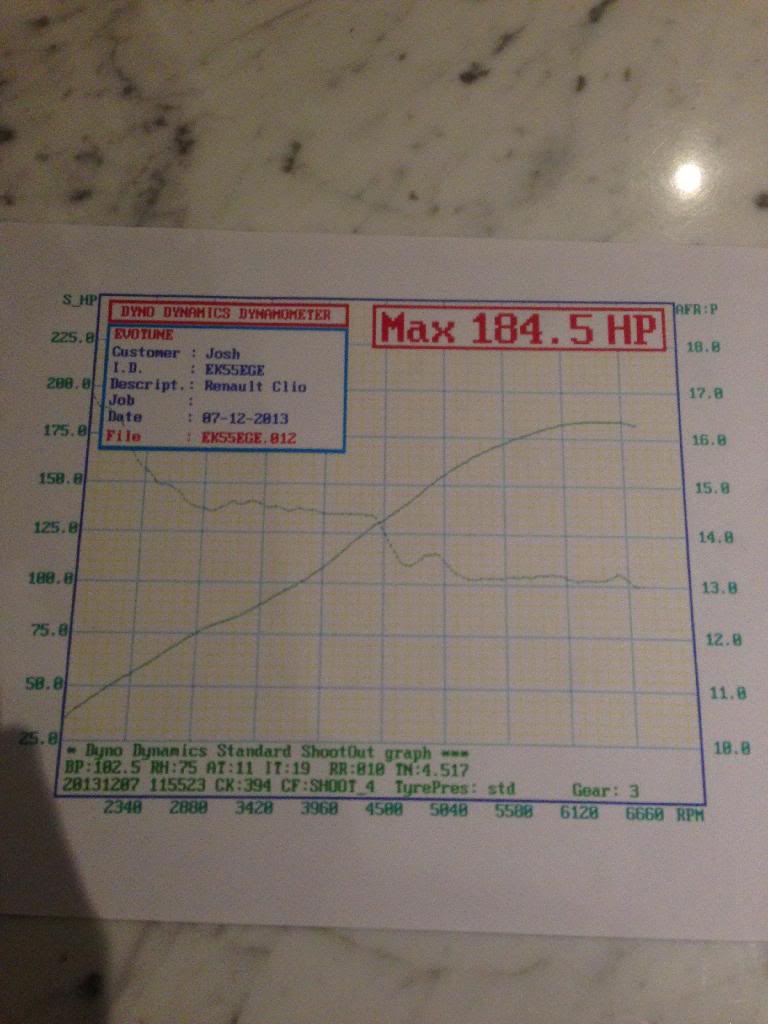

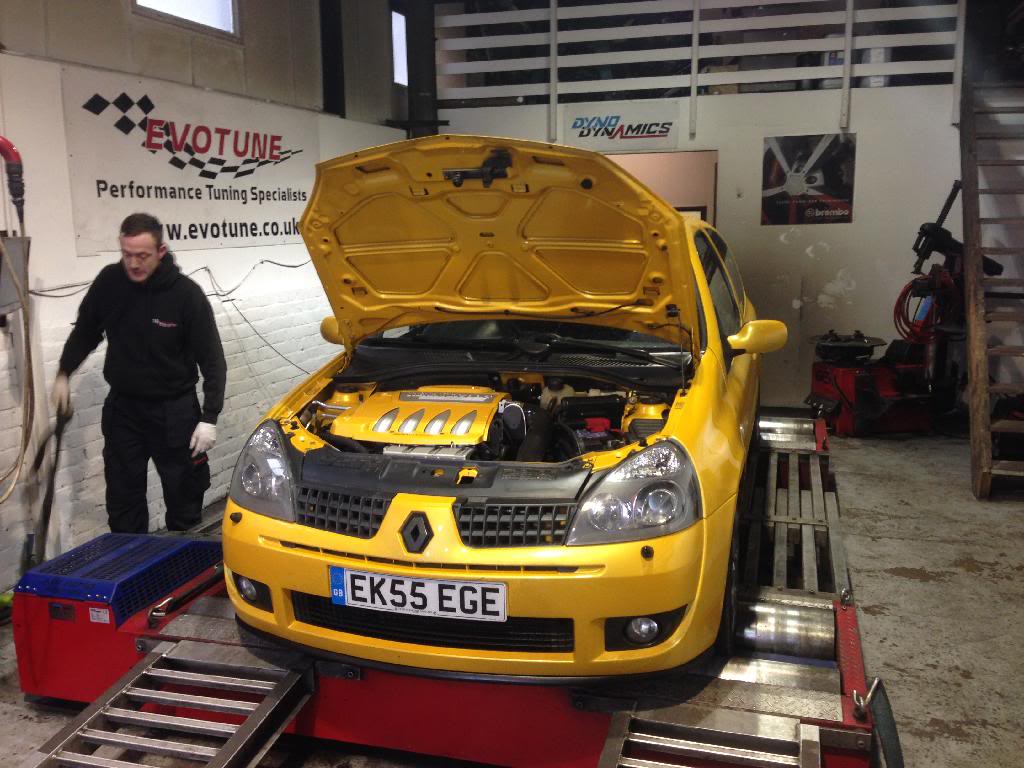

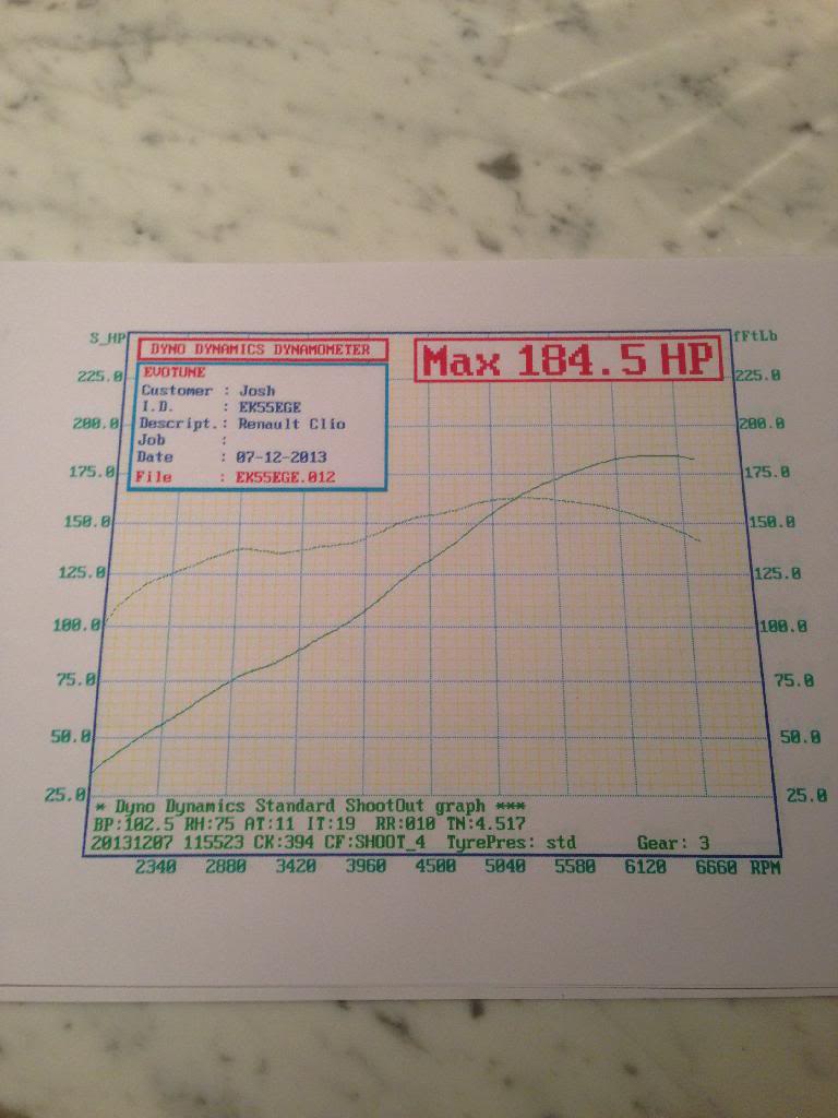

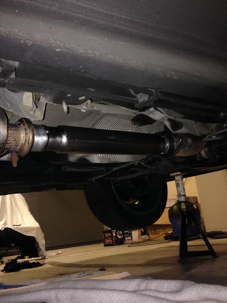

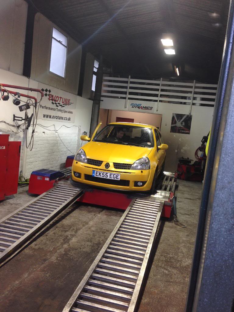

Well a few bits to update! The decat pipe came in the post on thursday, got that fitted friday night ready for the rollers on saturday at evotune! Also had my engine cover sprayed LY
first couple of runs were mid - high 170's and i was happy with that! Then it kept climbing every run untill it settled at 184.5, was over the moon with those figures, think it was the highest out of all the 172/182's that went on the rollers
Great results there Josh! Gutted I couldn't come..

Yeahh i think everyone was supprised! Thats a nightmare that, mine isnt too bad, just the welds on the scorpion center box have cracked and blowing!
Slightly rich at low revs but high revs seems to be about spot on.. Your engine electrics must all be working well :) where yours is 13 and a bit.. mine is 12.5 so thats why yours makes decent power and mine is at 174
Ahh right i see, mine would probably benefit from a remap to suit the decat and induction kit
To be honest.. I'd say you've got a decent map on there... Not standard map is it? smooth power line, good figures and decent afr. what mpg do you normally get?
Dont know if its mapped or not tbh! Previous owner wasnt sure either, getting 28mpg over 700 miles, and ive only had it for a couple of weeks coming from a dci! So its spending most of its time above 5000rpm atm! Lmao
