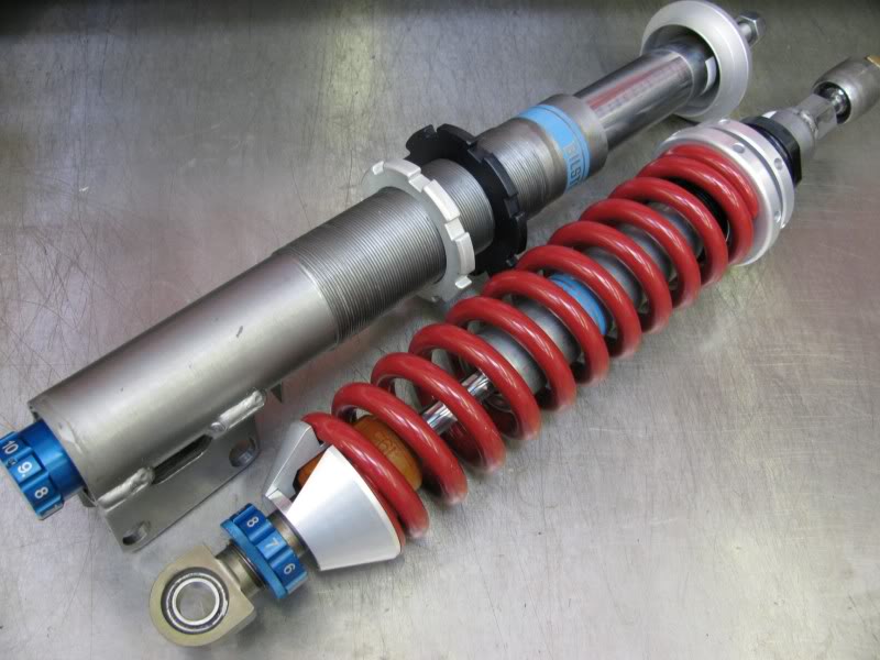

very nice indeed. b16's cup racer setup? I believe dyno cup was running rears at some point, or that was the plan any way.
aye it still is, we redesigned the rear lower damper mount (see that beefy b*****d in the picture) as the cup racer items had a habit of snapping, plus the "pressed insert" type dampers i'm not a fan of, especially after seeing several AST units fall apart
So how many of these AST bottom mounts fell apart and in what way fred? Can't see the pic here in work, but you've presumably just fitted a heavier duty balljoint compared to the cup series rears?
yeah its a mean b*****d!
Re AST, the pressed in rubber bush in the lower mount that bolts the the axle, well it stays bolted to the axle, but the damper pulls away from the bush! VERY dangerous! The eyelet the bush is pushed into is larger than the 18mm bolt, therefore if you pull hard enough you can pull the damper over the lower 18mm bolt!

In regards to what Fred said, they are pressed in. The car has done several trackdays with no problem at all but I was shocked at the movement they give. Fred just tacked some washers onto the bolt to ensure it will never come off.
Every suspension kit i've ever fitted with this design I've added a washer to stop this happening. So many kits have these pressed hard rubber bushes bigger than the bolt holding them. I've seen them fail on BMW's, Peugeots and many others. Apex even told me you can solve it by only fully tightening the bolt up when the car is on four wheels but i'm not convinced. Washers are inexpensive and sort things nicely lol
