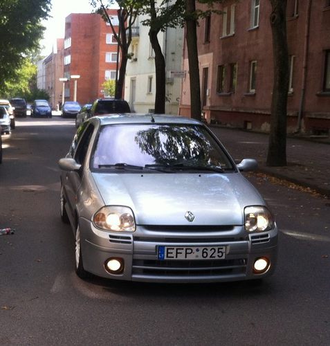

Hello,
Just so that I would not lose my list of what to do and what I have done I have decided to make a project threat to throw all my pictures and ideas at.
So here it is:
Renault Clio Sport 2.0 16V upgrade megalist
Performance
- Gearbox oil change
- Clutch change
- Gearbox stiffness
- Rear axle thickness
- Front Willwood brakes
- Rear disc brakes
- New brake fuel
- Braided brake lines
- Long hydraulic handbrake stick
- Aggressive cams (197)
- 4-2-1 exhaust manifold + wrap
- Stealth rear silencer + mounts
- 2.5 inch exhaust piping
- Strut bars
- Top mounts
- Radiator coolant
- Limited slip diff
Exterior
- Rear bumper 182
- Antenna fix
- Fabia front splitter
- Tow straps front and back
- Colormatch black bits
- Rear window tint
- Front bumper attachments
Interior
- Bucket seats/harness
- Steering wheel and boss
- Air filter
- Battery relocation to rear
- Sport pedals
- Full cage
- Carpet for trunk
- Weight removal
Rally
- Mudflaps
- Plastic rear windows
- Gravel tyres
Under The Hood
- Remove sound deadening
- Remove ac bits
- AC replacement bracket
- Replace vacuum hoses
- Remove fuel rail guard
Style
- Hooning sticker
- Rear spoiler
- Full polish
Already done:
v Cold Air Intake pipes
v Pipercross filter
v Oil breather filter
v Remap/programmer
v Spark plugs
v Fuel filter
v Oil filter
v Summer tires
v Shocks and springs
v Toora 15” wheels
v Engine mounts custom
v Decat
v Headlights + new bulbs
v Taillights + new bulbs
v Foglights + new bulbs
v White sidelights
v New motor
v New belts
v Clutch cable
v Front and rear wipers
v Engine guard
v Removed rear seats
v Removed spare wheel
v Removed AC unit
v ABS switch on/off
Feel free to make any comments or ninja my list for your own sake.

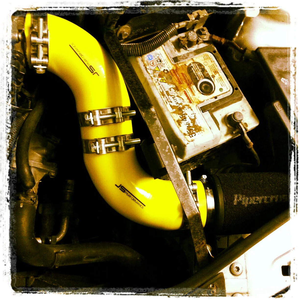

IMG_20130131_111630.jpg I know it is an instagram picture, but since I made this myself, I thought it is worth sharing.

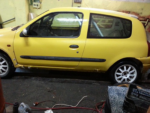

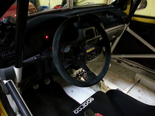

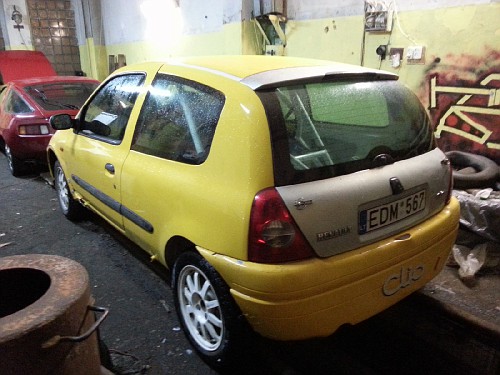

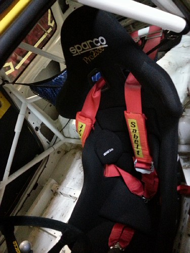

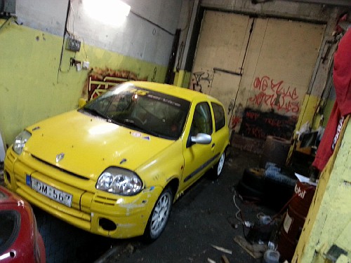

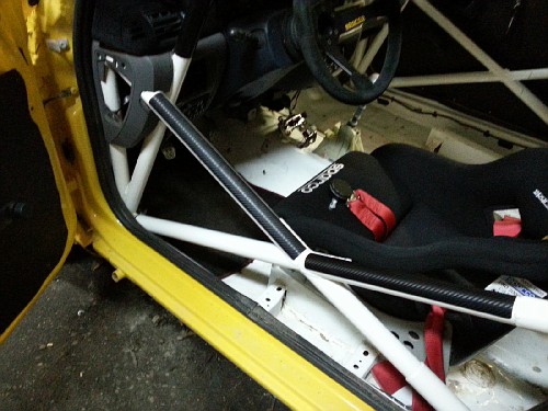

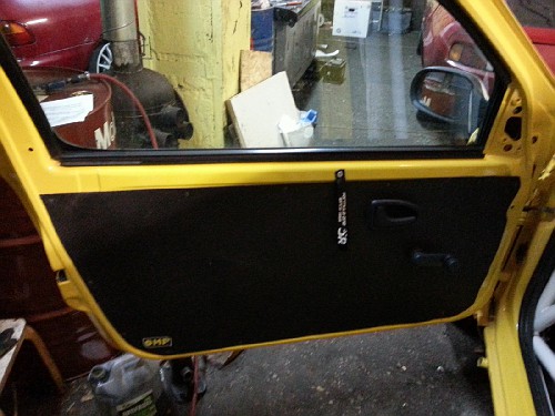

You guys are not gonna believe this. My buddy, national rallycross champion has no time to drive his practice car, and henceforth gave me an offer to buy it for dirt cheap. I could not pass up the opportunity so I have just purchased it!
I will be getting her back to my garage tomorrow. This is what I know for sure: it has a genuine renaultsport shell from France, it has full new roll cage with homologation, has a sparco seat, a new steering wheel with boss, harness, most importantly locally made rally shocks and springs (price around 1800 euro), the interior has been all removed and inside painted white, also it has some nice wheels and somewhat new gravel tyres. Furthermore, the gearbox has just been freshened up, as well as the motor has also been just renewed. This all has been done to get the car ready for this seasons practice, but champion has decided he will be taking his Volkswagen polo racecar for practice rather then this sunflower clio.
I cannot begin telling you how happy I am with the purchase! I have driven the car before and I know he has cared for it really well. It is just not all finished (exterior bits), but already ready for any events I would like to participate. The plan is to take all the new good bits out of my silver clio and put them in the new clio. I will have to readjust the whole mega-list but hey it is great news. Here are some pictures from his build of the clio:
I will be asking you guys for bunch of advice, and I will be giving this little thing hell and all the love I got. I hope you all can also feel the excitement in the air!
tadas
  RS Clio 172 Ph1
So a bit of an update, I have got the car back to my garage, and the first impression is just WOW, it drives so much nicer, my car feels like a medusa compared to this one. I guess the full roll cage, suspension, seats, wheel etc, give this feeling of rigidity.
Exciting bits are that my racing buddies looked into this chasis and it seems that it all has nice welds throughout and someone has done a great job on it. However, I have yet to figure out what chasis this is (posted in different section to ask about this). Also, a nice addition that I did not know about is that it has a good quality brake control unit, and a different silencer in the back to save my ears.
The bumpers are all in rough - horrid shape, but hey it is a purpose built car that needs attention.
Many things to come, and many more pictures soon.

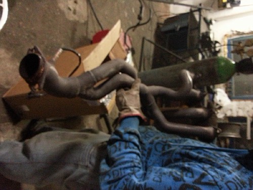

Ugh it has been a while since I got to work on my new clio, and this is because I was busy with the old (silver) clio. However, since the weather is going to get better in the next few weeks I will surely do much more work. First, I have already bought a used 4-2-1 (182) exhaust manifold, and I will be installing that tomorrow, as well as getting a custom 2.5inch exhaust. Furthermore, I think today I will bring myself to clean the inside of the car, and readjust the seat to my own dimensions. Here is a picture of the manifold, and some more pictures of the car that I took after I have gotten it to my garage.
I am just wondering of how much money should I spend fixing up the car, or should I just go out and thrash on it properly on gravel roads, without worrying that it is missing a bunch of exterior parts and silver at some places.
