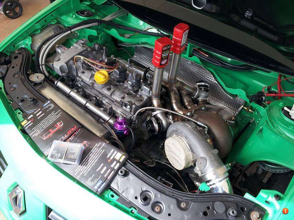

Little turbo for the megane
RSTuning
  R35 GTR
Just called into work and it looks awesome!
Chi
  Z4, VW172, R26
Wow this car is a true testament to what you guys are capable of, absolutely brilliant..
RSTuning
  R35 GTR
Thanks guys, hoping it's going to be running next week some time. Will only be on gate pressure for a while then I'll turn it up once the dry sump kit is fitted
  big boost cup
Much work involved in the dry sump kit? only ask as we had one die the weekend due to oil starvation bits of rod everywhere
RSTuning
  R35 GTR
The kit is easy enough to fit, you need to mod the block near the water pump and if you run a vag box that needs to meet a cutting blade too!
