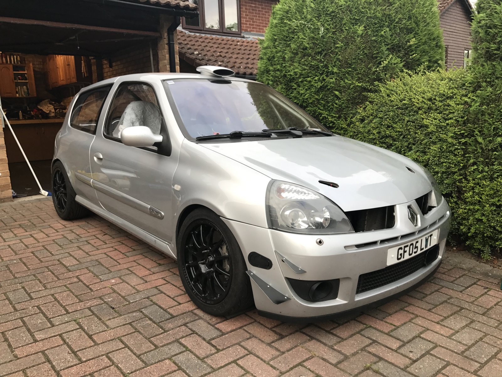

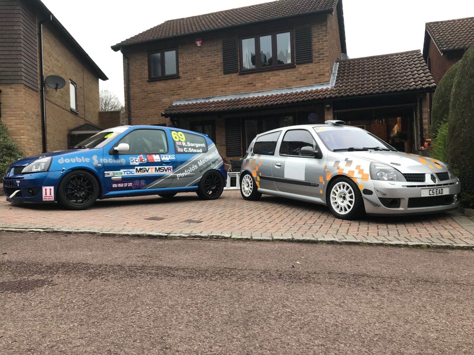

Some of you might be aware that I have built this car up over the past three years....
1408451
Build thread.....

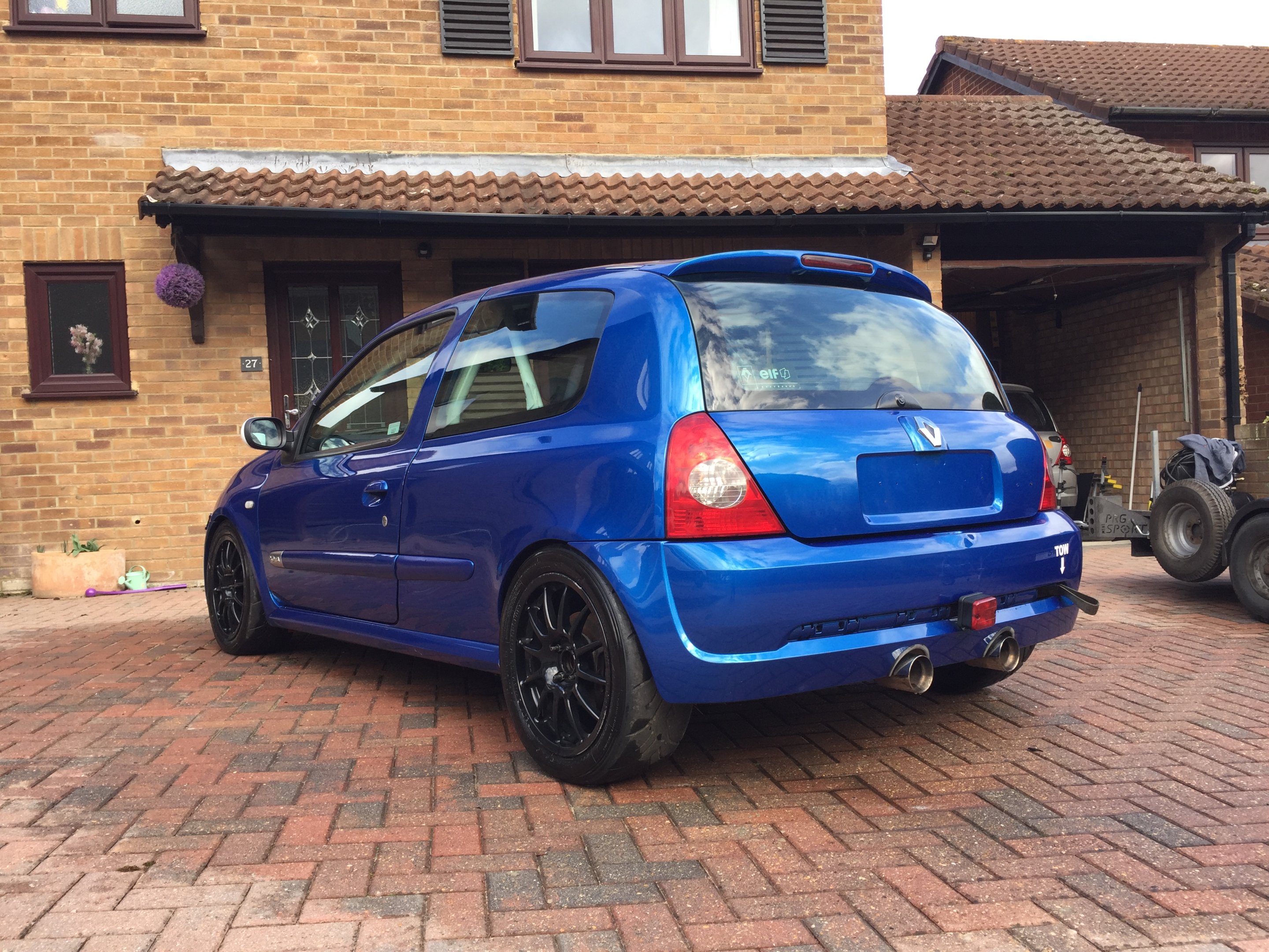

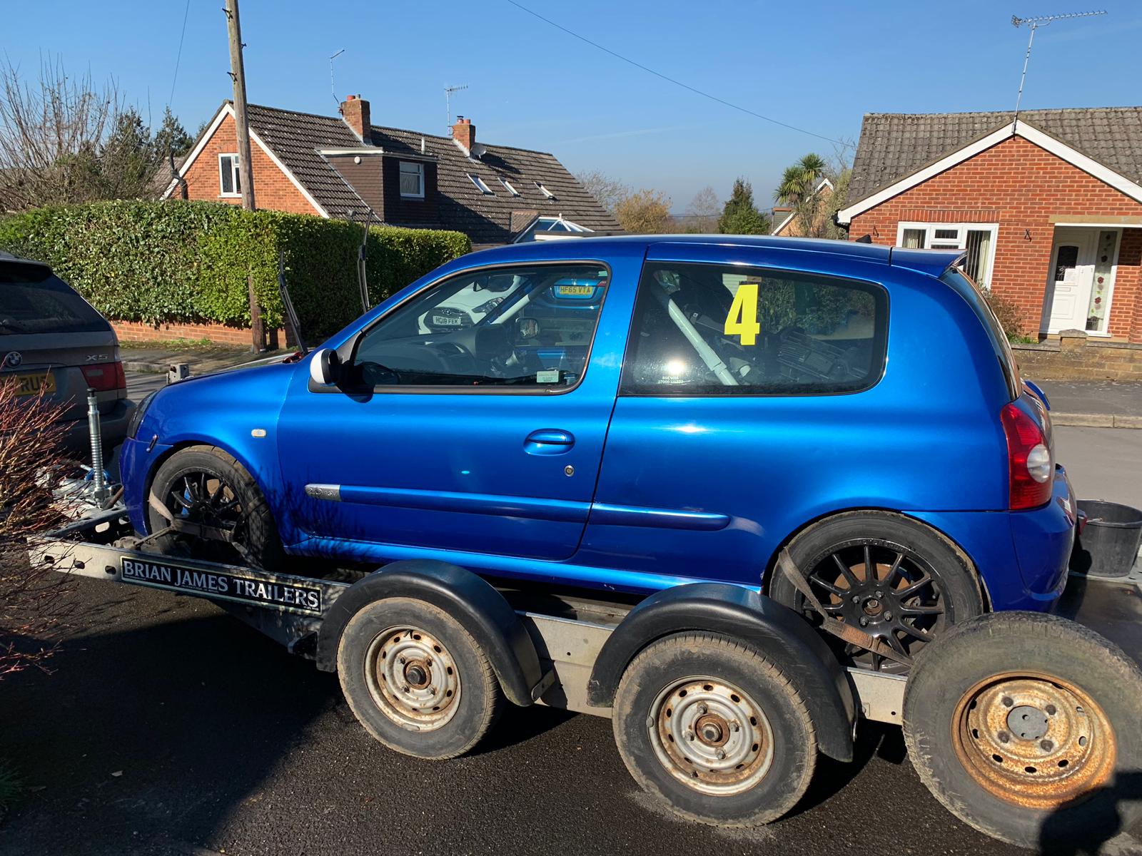

Sadly I went a bit to far with it and can’t justify racing it. However a good friend of mine bought one ready to race. Trackday trophy is 40 min races split between 2 drivers. Ideal for us the costs are split.
So here she is....

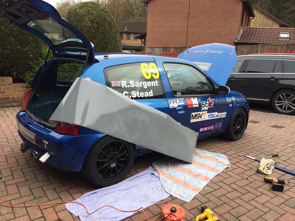

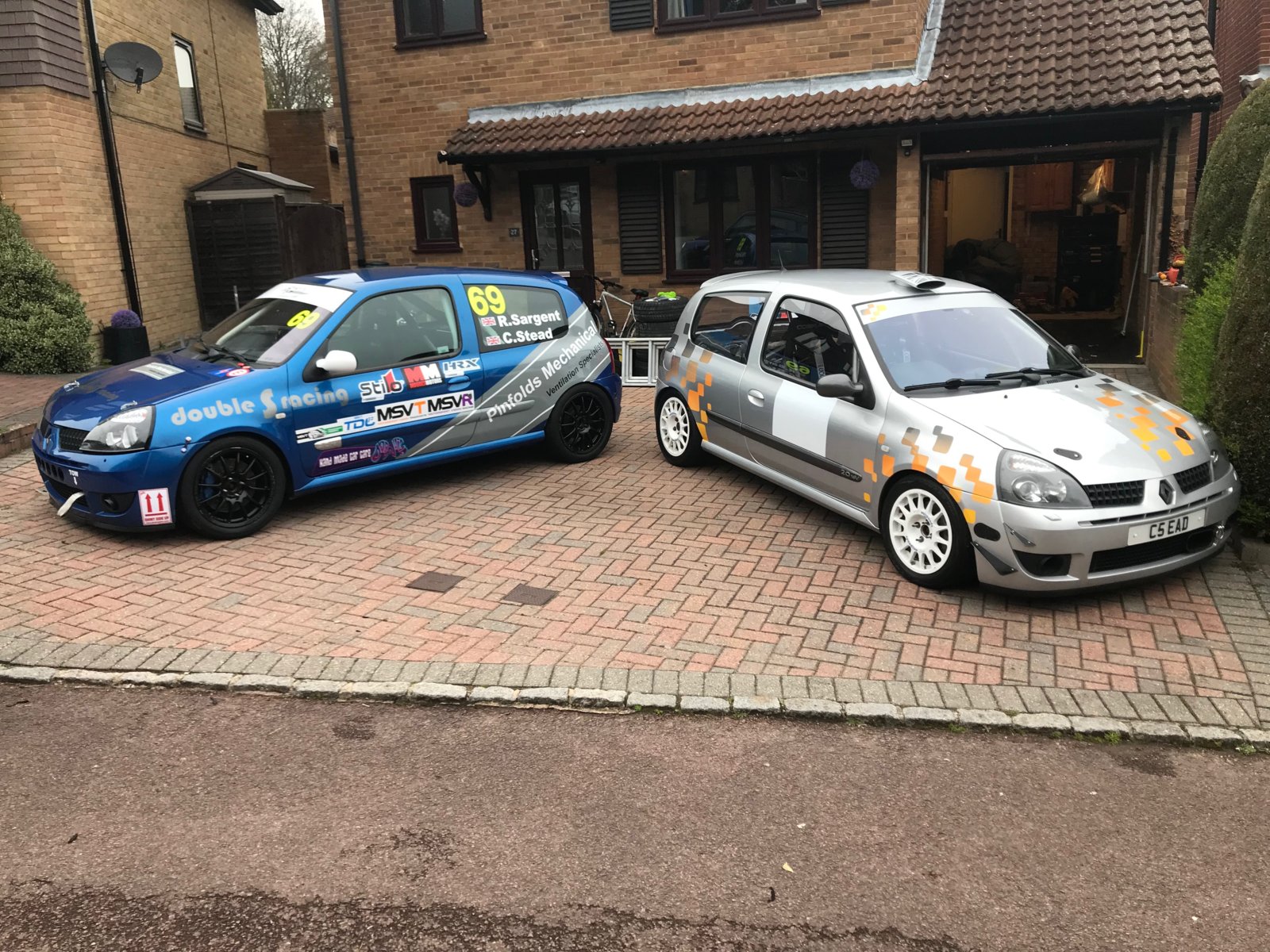

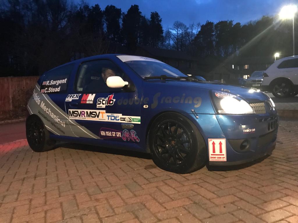

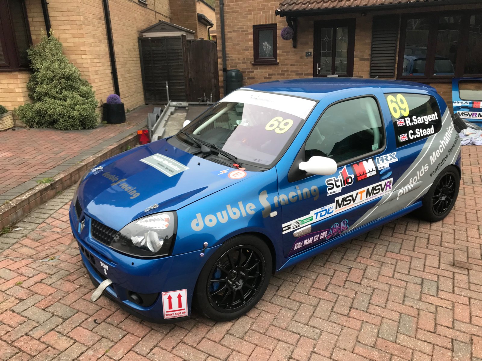

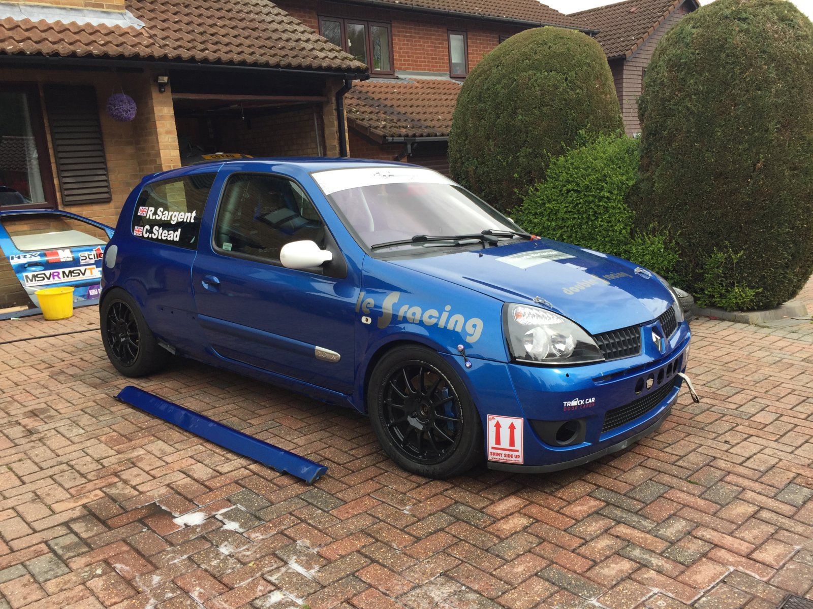

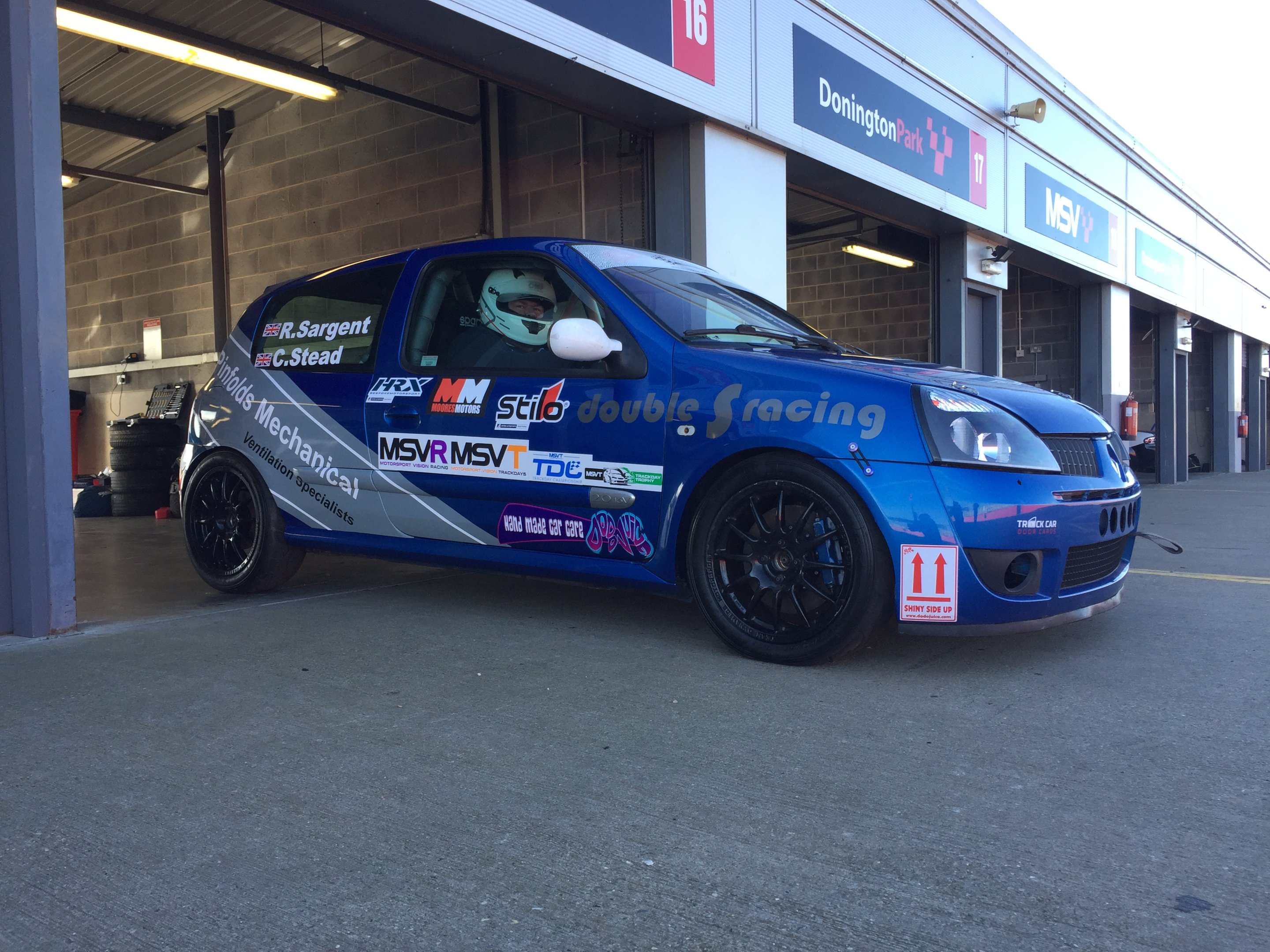

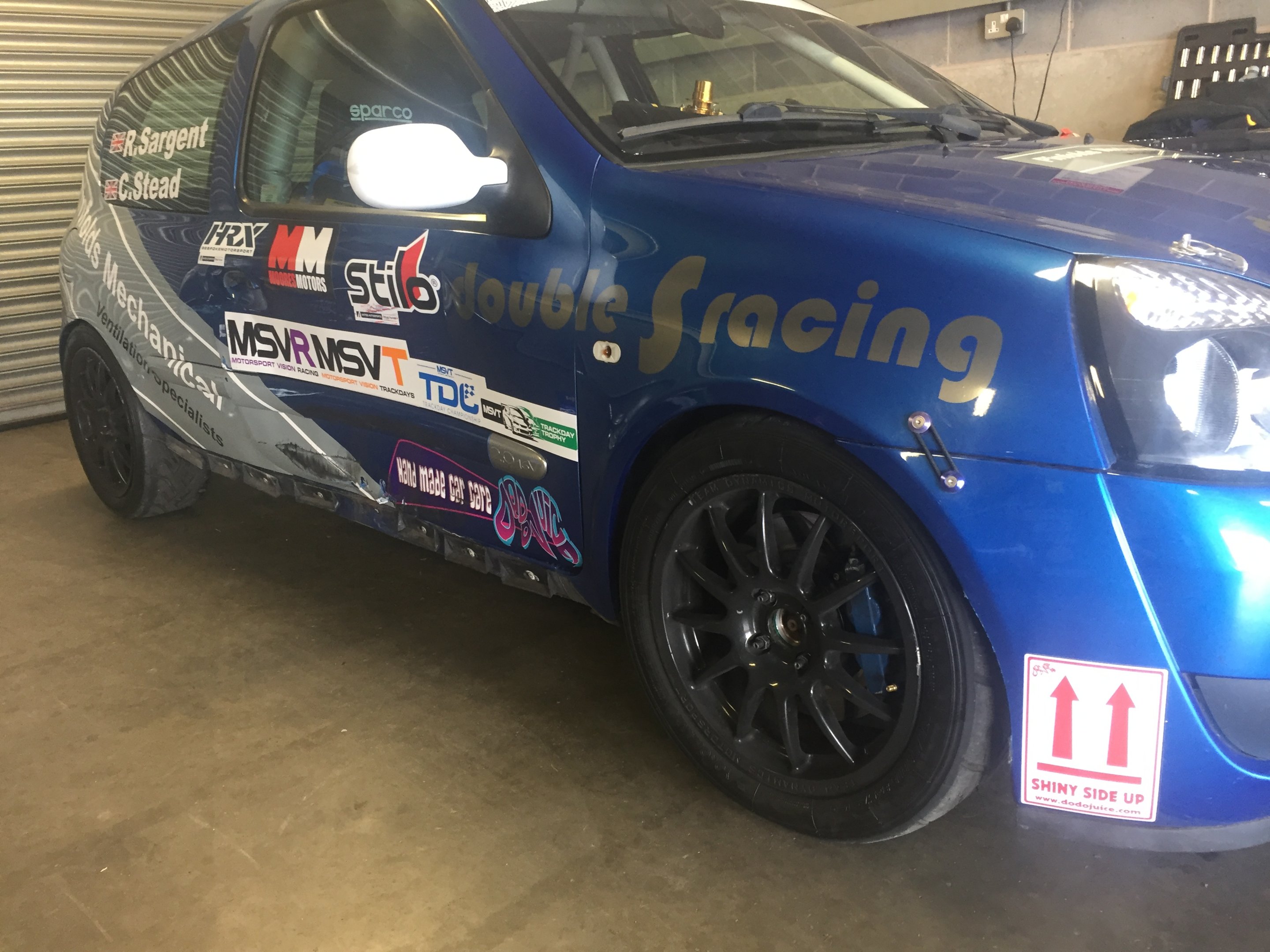

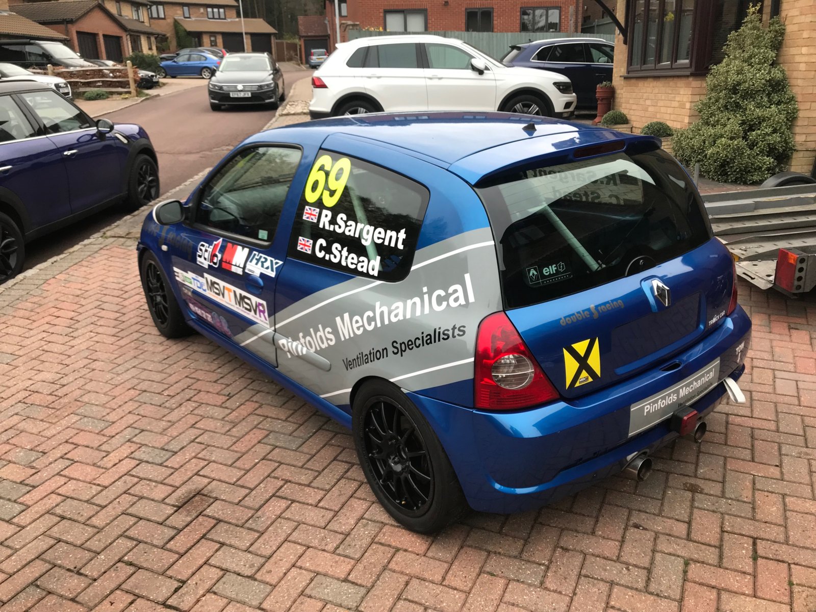

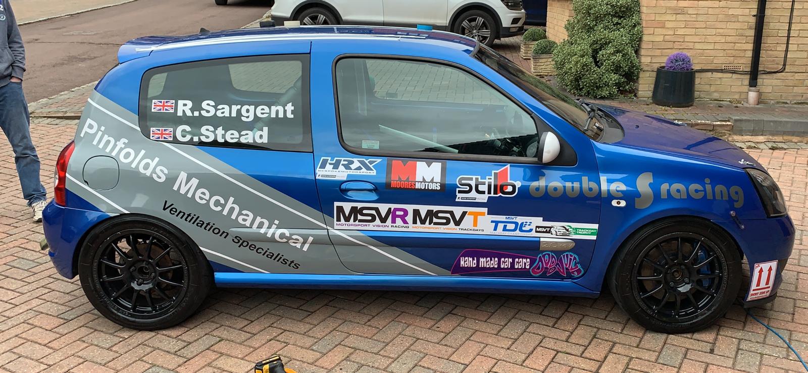

Today I met my race car for the first time ?

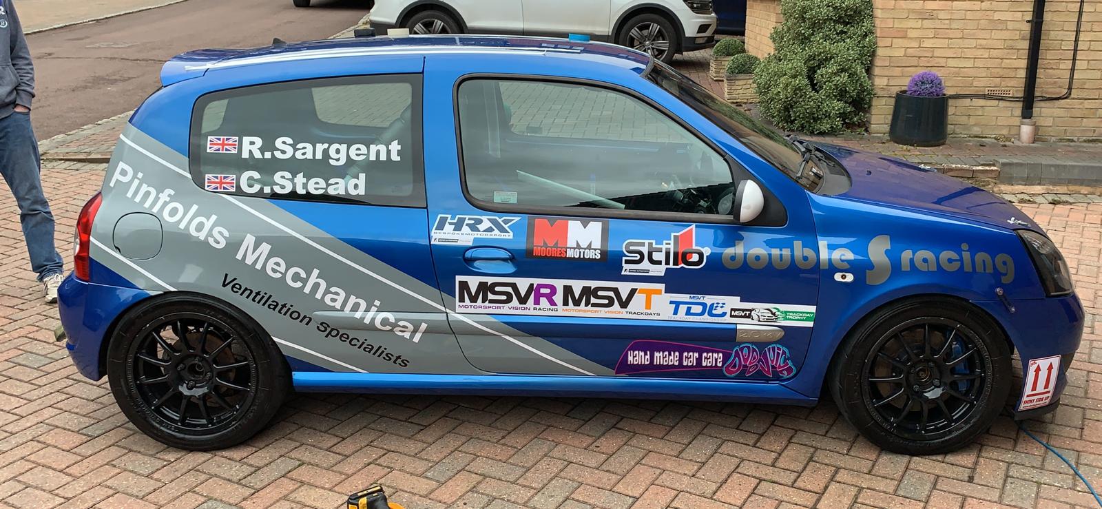

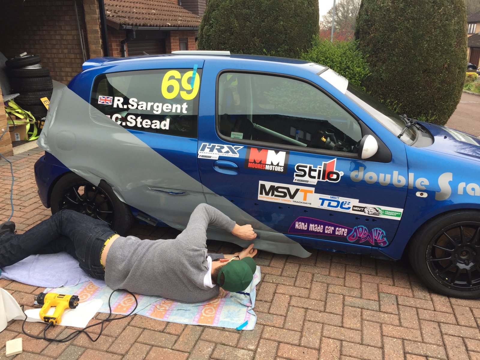

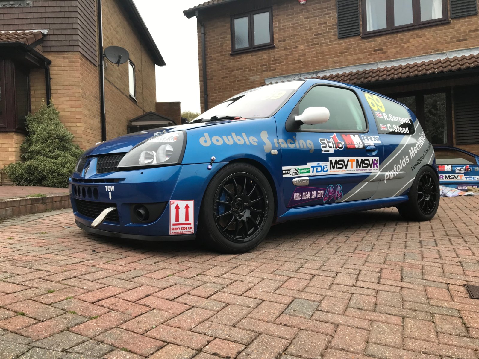

With the sticker man booked in we gave it a quick wash.
1408553
1408559

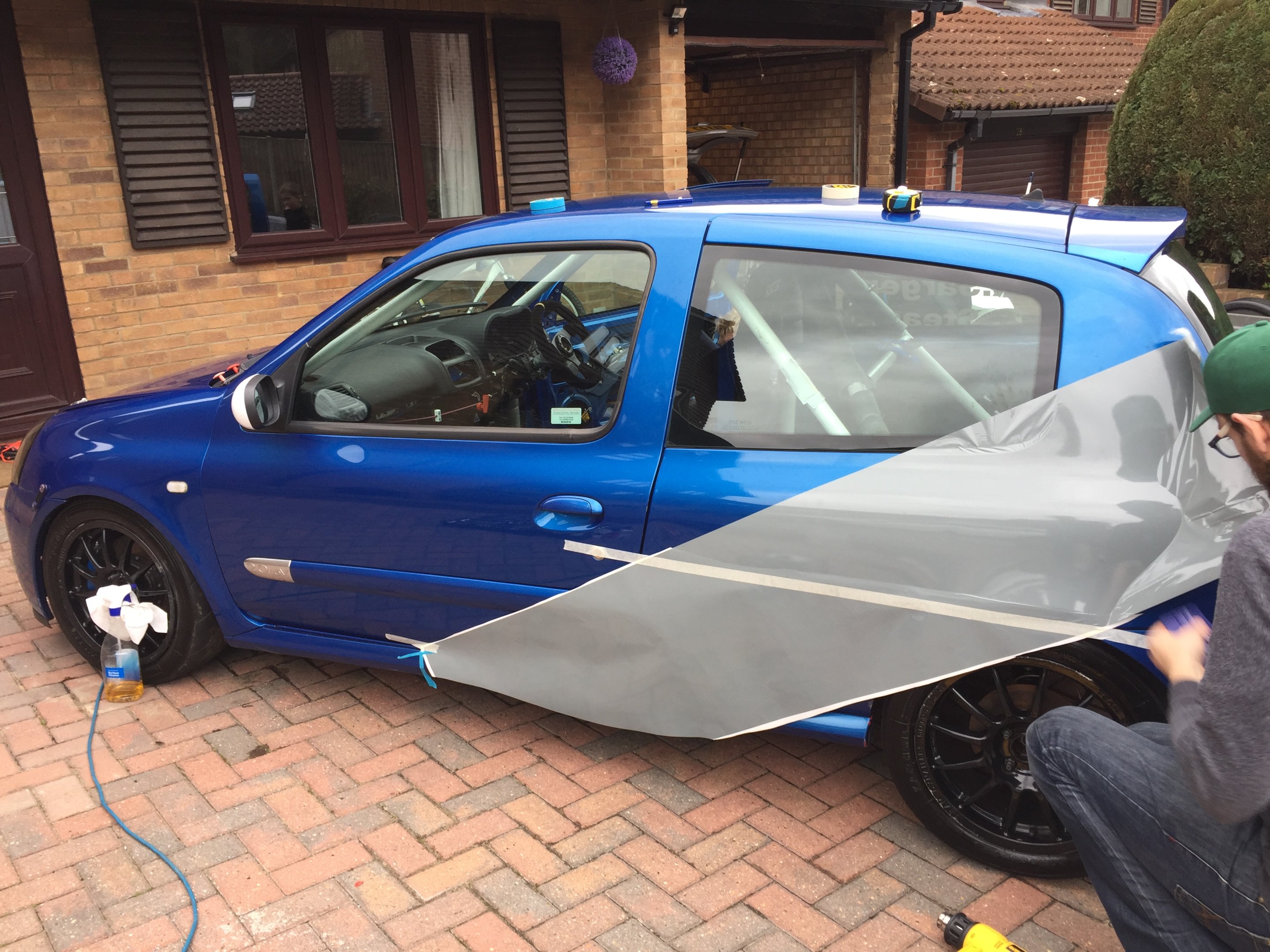

Then on with the stickers. Time beat us so the lightings poor but you should get the idea......
1408554
1408558
1408557
Can’t believe how many compulsory stickers there are! We still need to add our number but need 100% confirmation before we do.

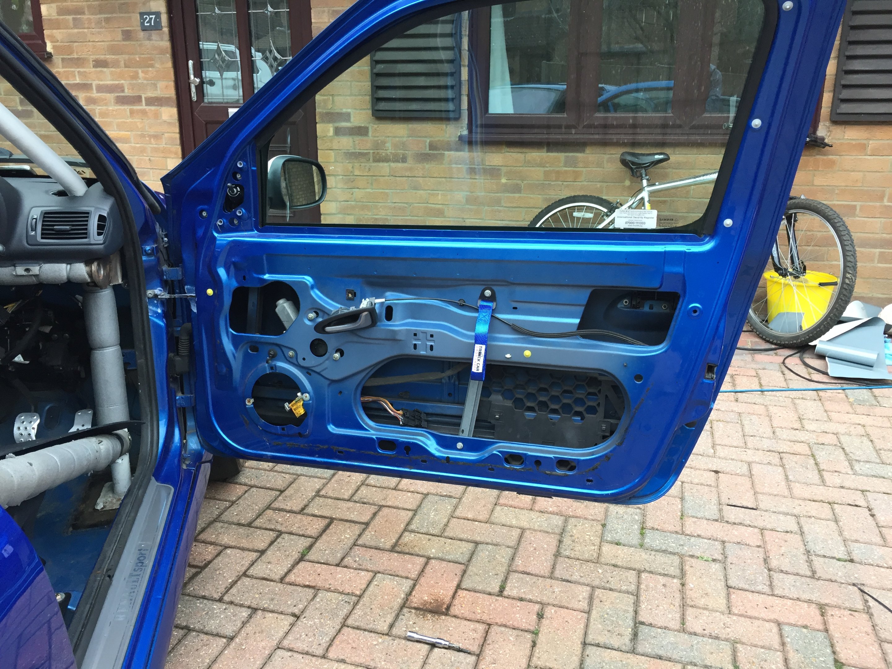

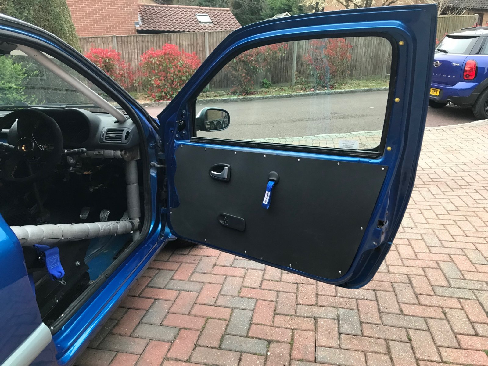

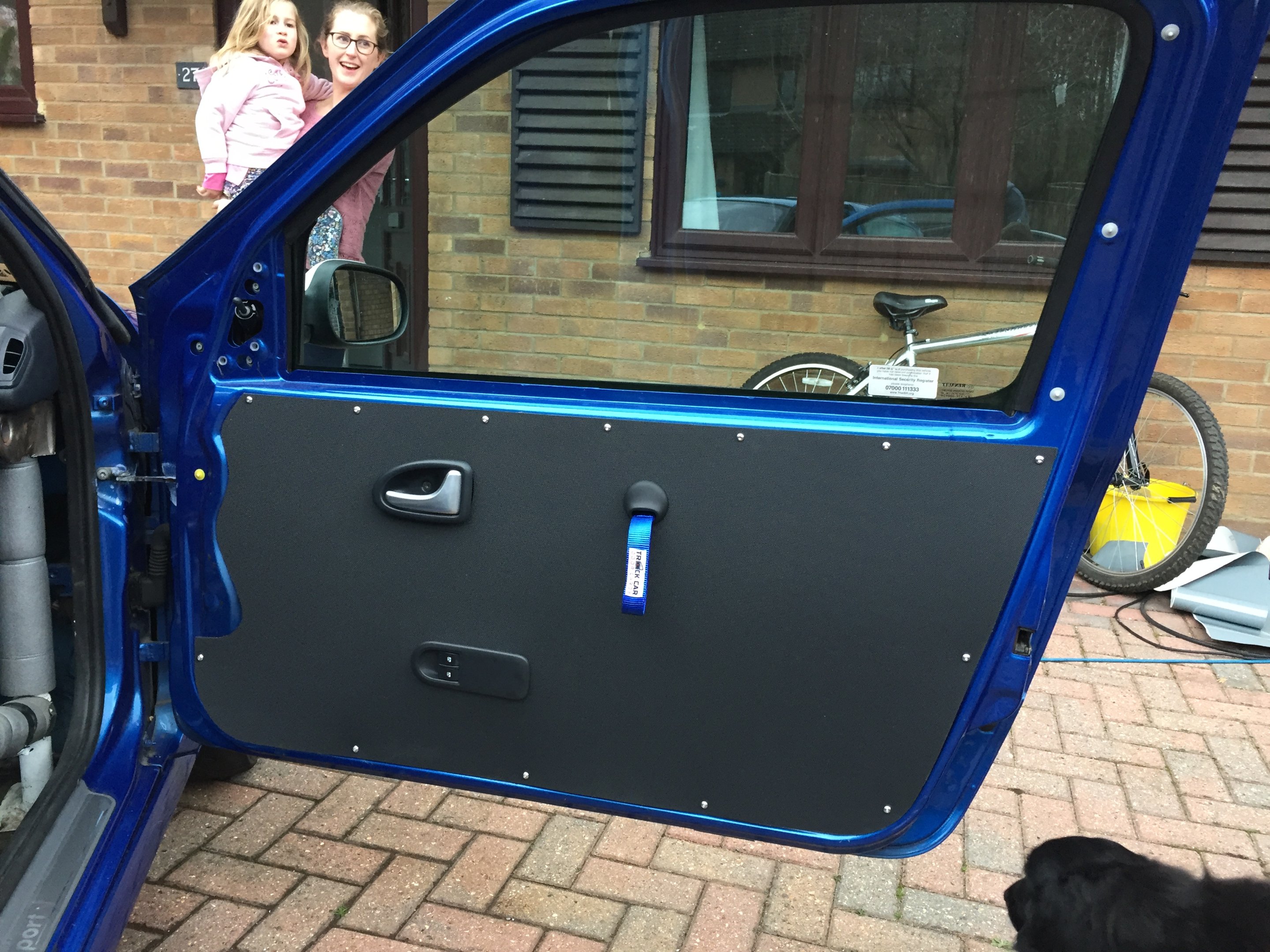

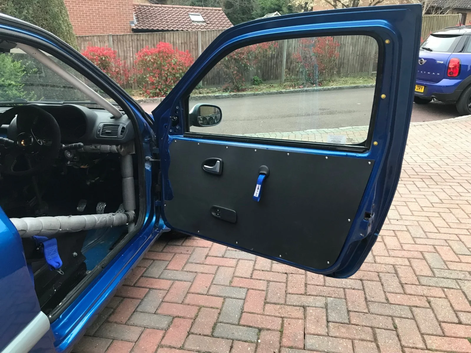

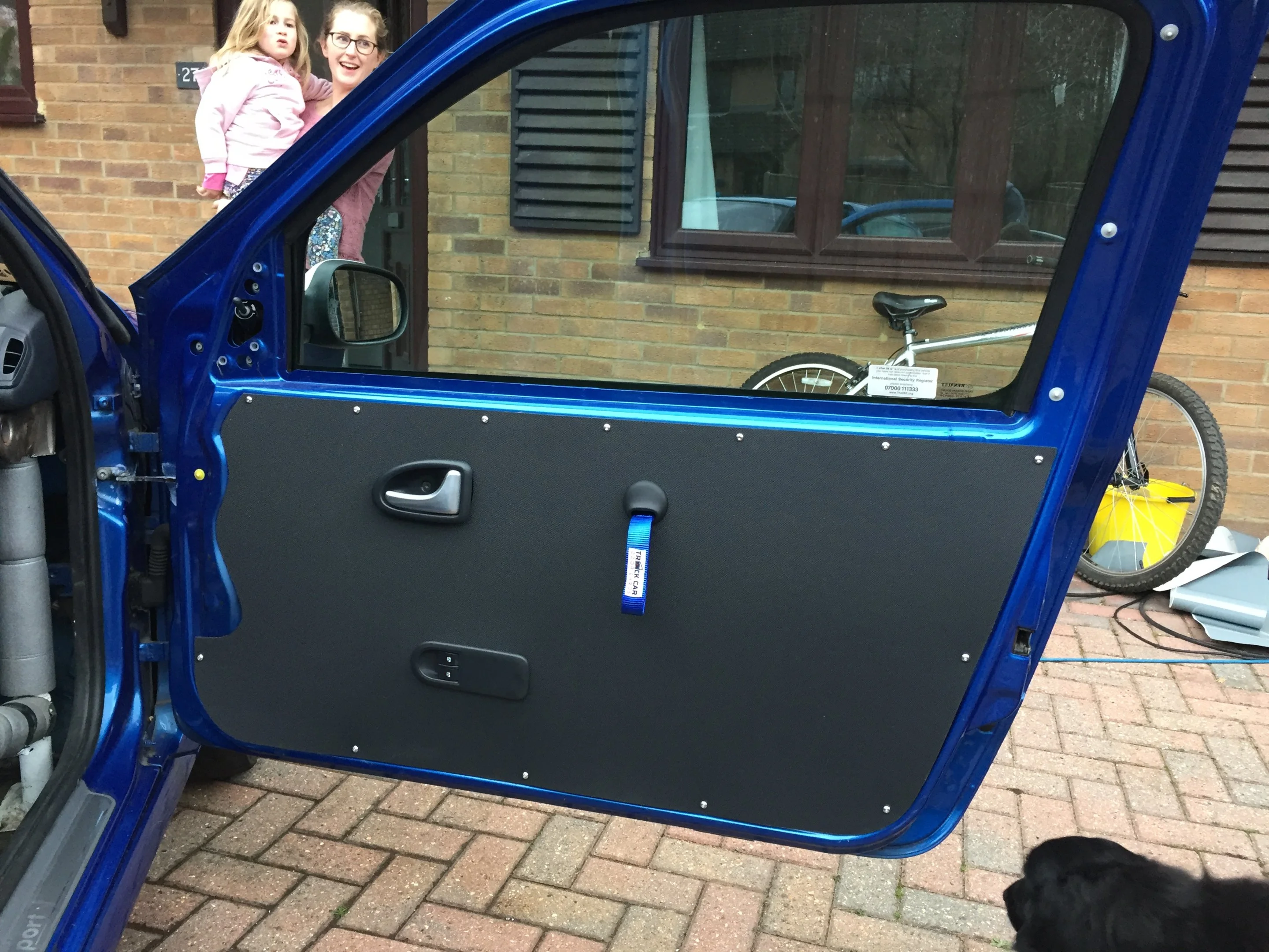

Whilst the stickers went on we fitted some door cards from @Track-car-doorcards . Fantastic product. Wish they were about when I spent ages fitting my ones to C5EAD. Literally took 20 mins a door to fit. With the dash reinstalled to the car the inside is looking 100 times better. Definatly recommend them.
1408555
1408556
So the cars ready for test day.......... apart from the intermittent misfire ? New coil pack has been installed and we have a boot full of parts if it isn’t that. Sadly we can’t test drive the car on the road it it seams ok now! Next stop Donnington ?

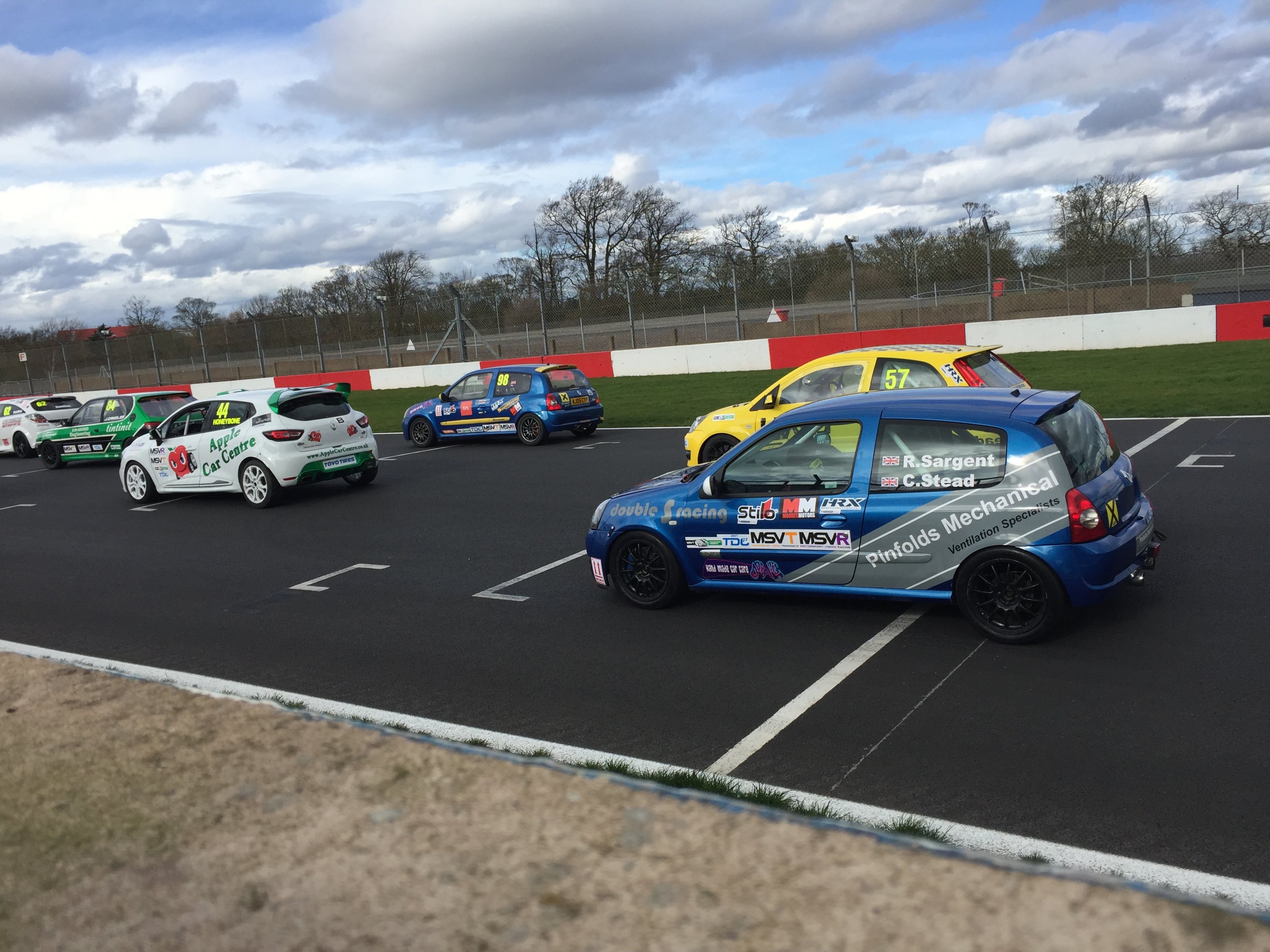

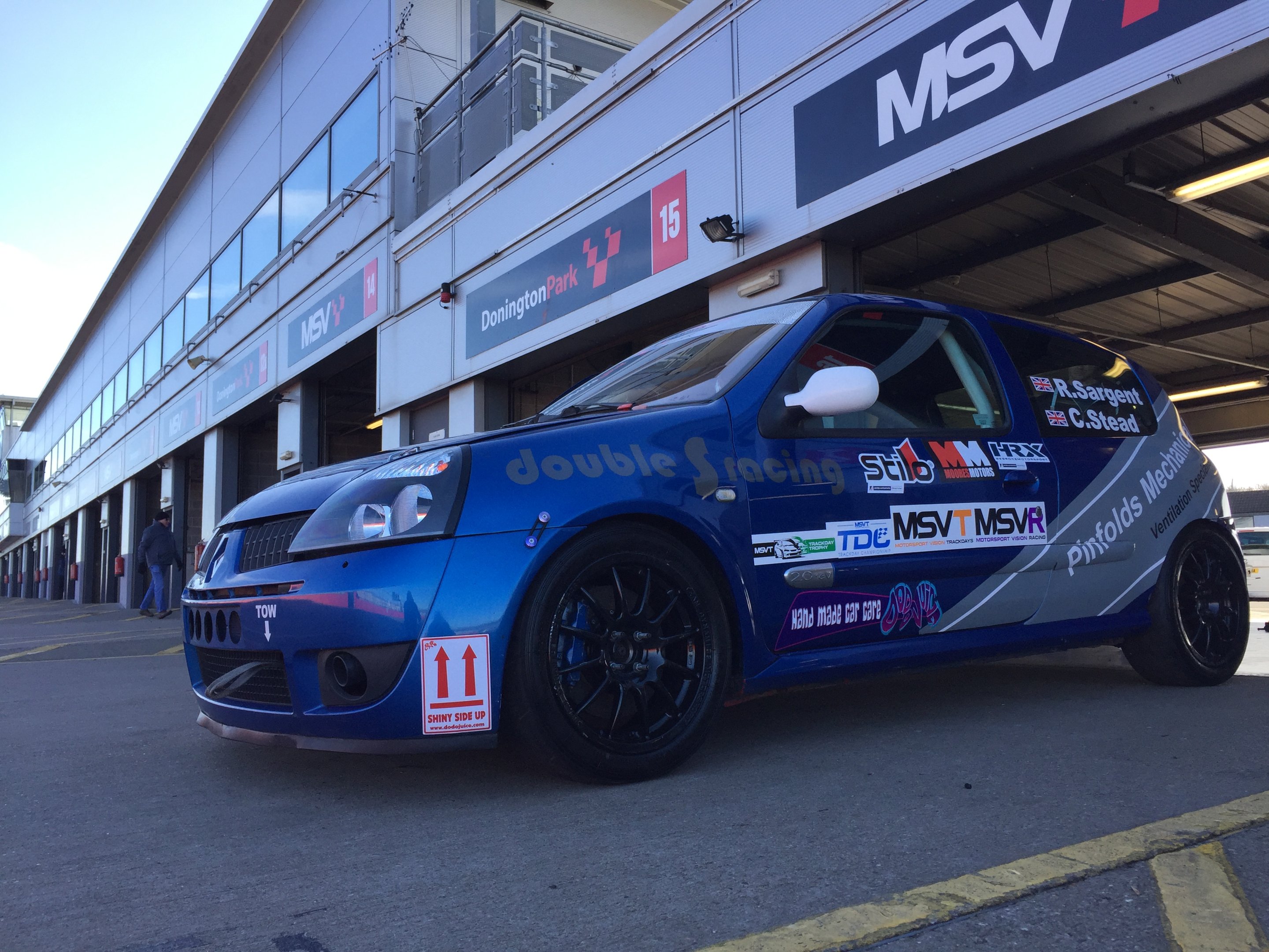

Monday we went to Donnington for our first outing in our car. We went up the night before and ventured in Monday. Weather was forecast dry, happy days
1409301
So we had a few issues to deal with -
Getting the wheels to fit on with huncentric spacers. Believe it or not the car had been running on generic 10mm spacers! We bought the new ones but the hubs had corrosion on them. Que 45 mins cleaning the hubs up. No problem we cleaned them up and the wheels fitted on.
Next - noticed the car had a miss fire. Changed the plugs, coil pack and leads but it remained. Then noticed the leads for 2 & 3 were the wrong way around. Swapped them over and hey presto she works!
1409302
1409303
1409304
A great moment to see the car going out for a few laps. Back in and all is ok so I took it out for a few laps. Very strange to drive as this Clio has no ABS and no power steering! Also the driving position isn’t as good as the C5EAD but i’ll get around that. Then out for another go and........... it won’t start. Que another 45 mins lost. Turns out one of the relays was loose in the fuse box.
1409306
Then we’re off again! Russ did along sestion and the cars running fine. Happy days as it’s an unproven car. Then my turn. Longish session and I was starting to carry some speed around the track when.........
1409308

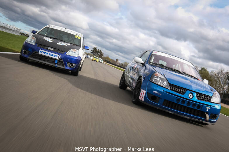

Disaster, I can’t and won’t go into it to much but I was passing a classic mini and he turned into me resulting in him bouncing off of me and into an Astra.
So for the first time in my driving life (22 years doing 25-40k miles a year with countless trackdays) I’ve been involved in an accident with another car, and it’s in my friends car. Gutted
1409307
The damage for us was superficial, for the mini it was worse. Que meetings with the officials. We were allowed to carry on.
From that point I had no interest. We had a further issue with the top mount coming loose and then it rained.
I have driven Donnington in a lot worse wet weather in C5EAD. I had no issues with that. Having no ABS or power steering and running on Yokohama’s just didn’t cut it for me.
1409305
So what’s next, we have a car that was untested and we come away with a seemingly good engine, gearbox, clutch etc but we need to get some speed into it. It’s not slow but C5EAD is confidence inspiring.
We’re aiming for the first race a month from today at Donnington. Last night I drove 400 miles to pick up a new door and side skirt in blue. The car is going to the body shop to have the side pushed out a bit.
Rolling road is at Brands in 25th so it looks like we’re taking this opertunity to test again.
I said I’d be honest with this, it’s been a massive eye opener this week!

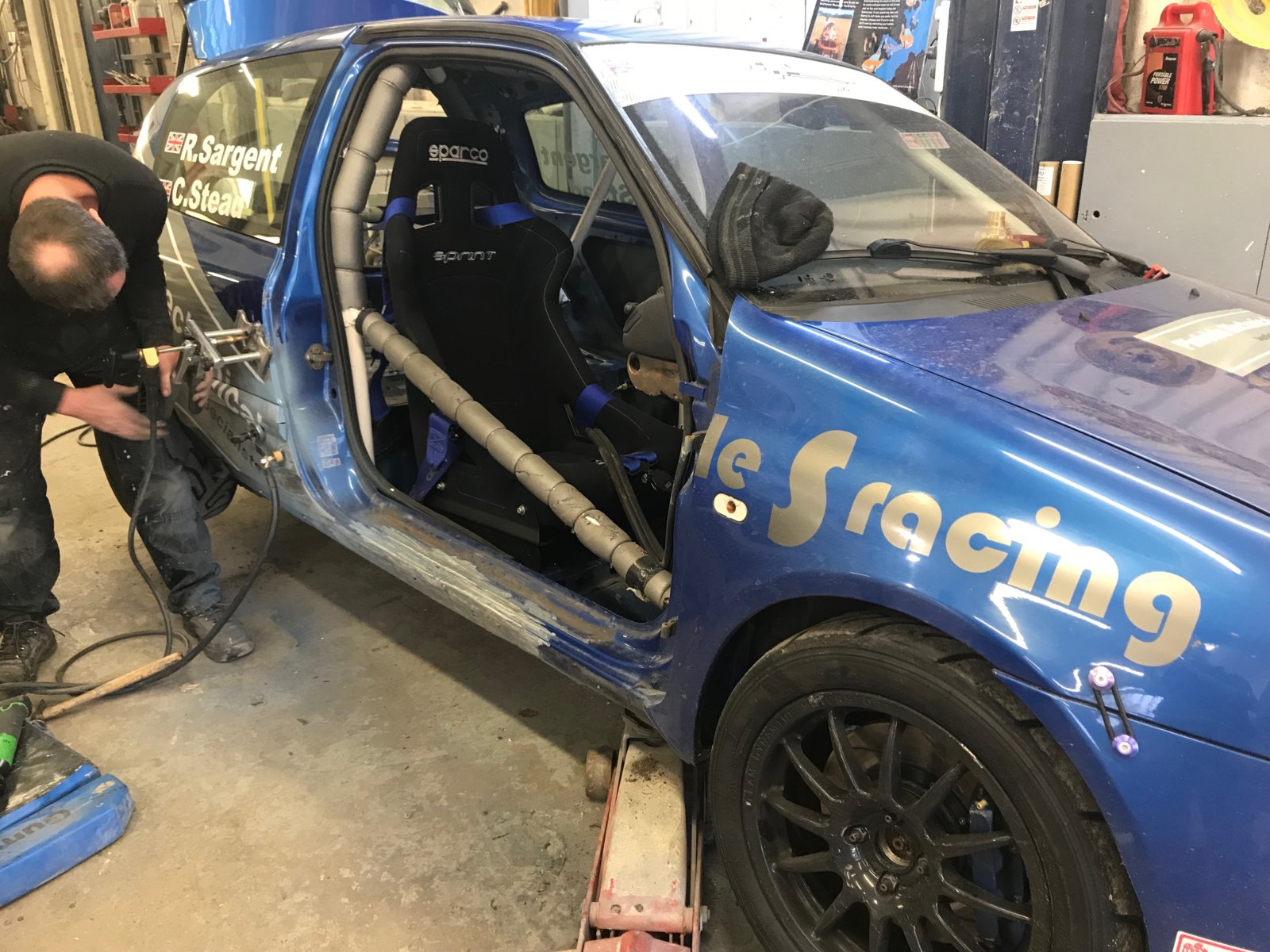

The clios down with body shop having the repairs carried out. Some good has come out of the bump (pint half full not half empty!) they have come on board as a sponsor for the season. In exchange for some space for branding on the car they are going to carry out the repairs and only charge us for parts used (paint etc). That’s not just this incident but any going forward! Not that we’re planing any more bumps!!! I dropped off the door and side skirt off and the reality hit home of the damaged caused with the bump......
Ironically we received the photos of from the pre season test day. Its nice to see them but every photo seams to have the damage in it :(
The car should be ready early next week ready for the dyno day 25th March. We're going to turn this into a test day and play around with the car because........................... we're now officially entered for the opening Round at Donnignton 7th April. o_O

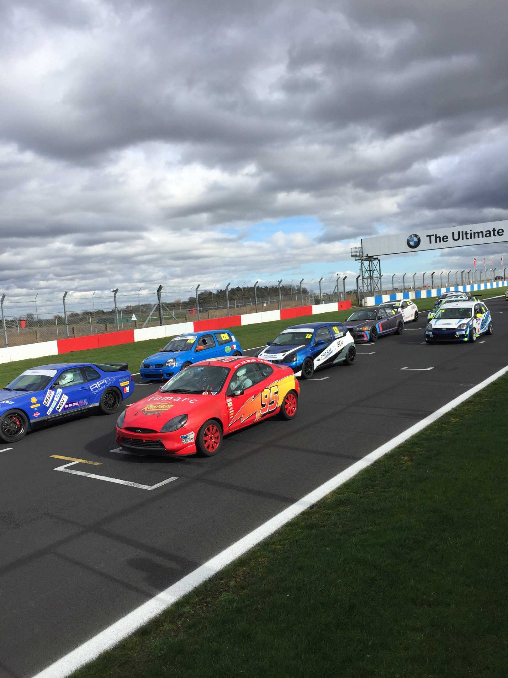

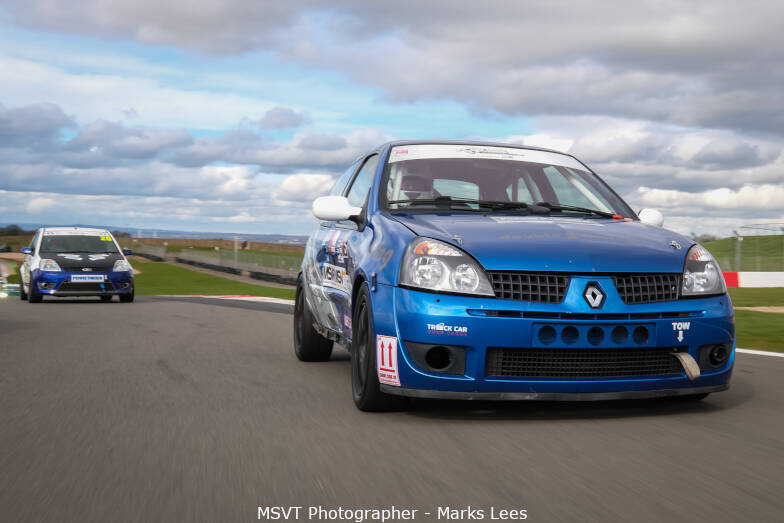

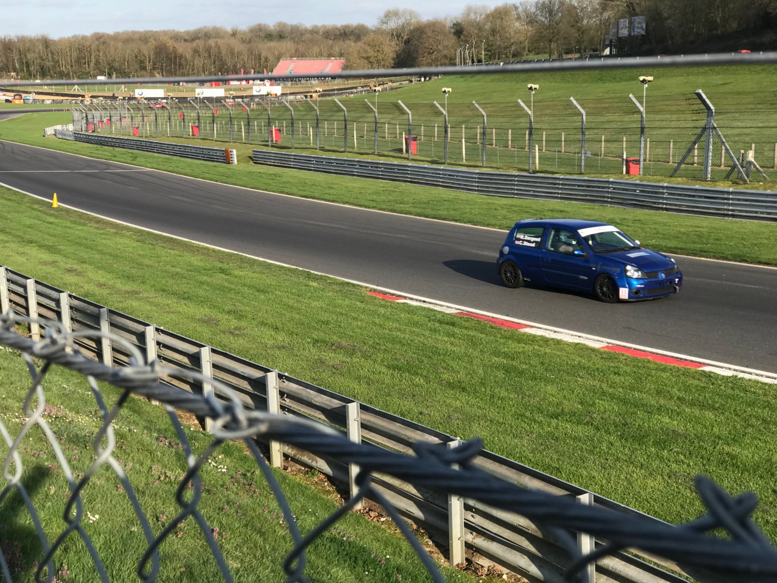

Second test / final test day, next time out we're racing!!

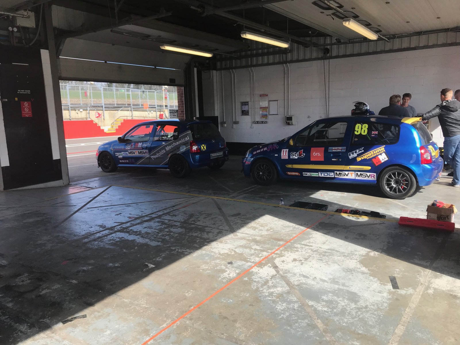

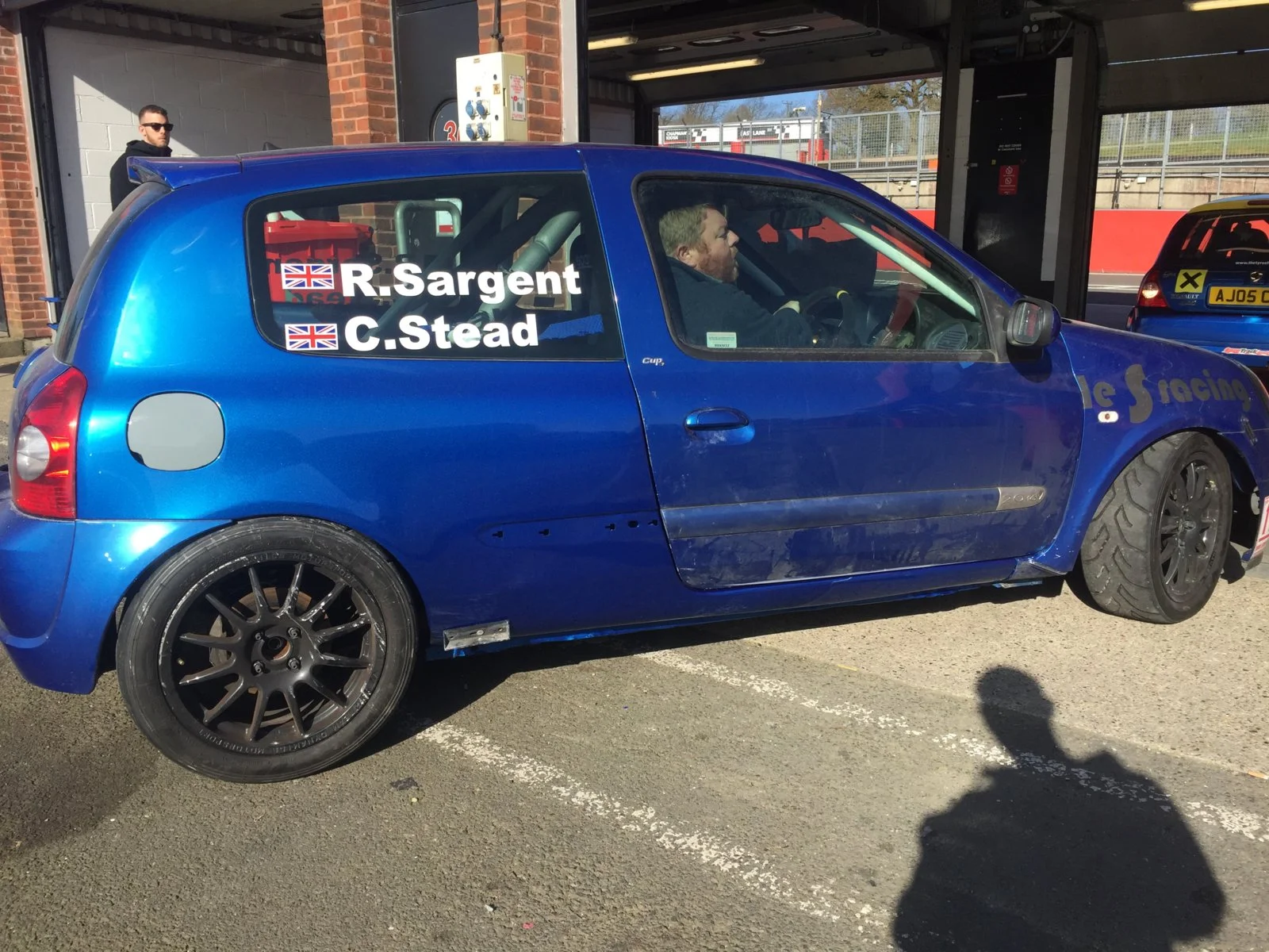

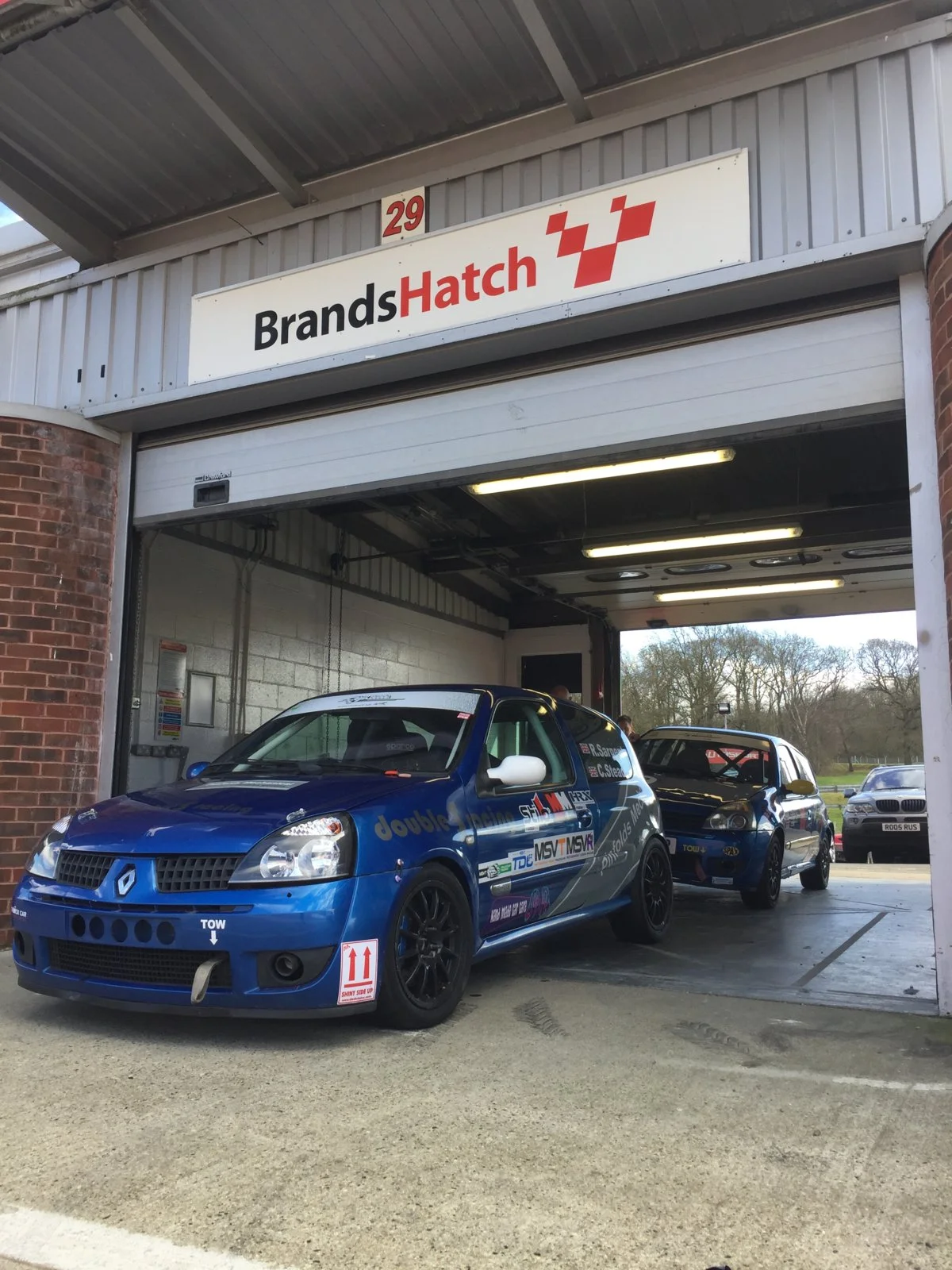

We spent the day at Brands yesterday. Weather was great which is good if we have a dry day at the first race. First off the car is straight again but is looking crap as its missing the side skirt, trim and graphics. Its 12 days until race one so we'll try and get it looking good before then.
It was a busy day and we were on the reserve list but come 10.00 we were given the go ahead to join in the fun. Quick in and out lap and there was a massive banging coming from the front. Turns out the drivers side ball joint was loose. Once we fixed that we never had another issue all day! result

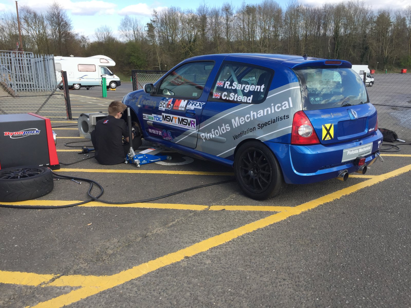

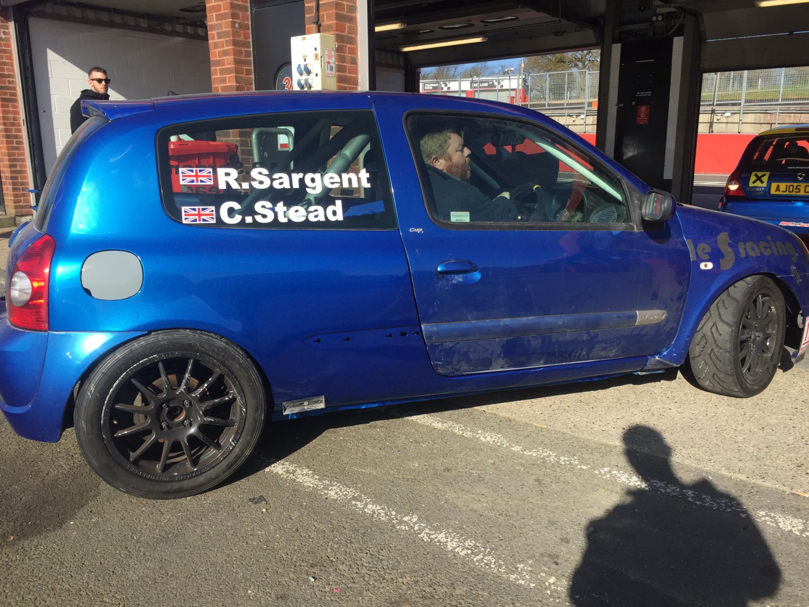

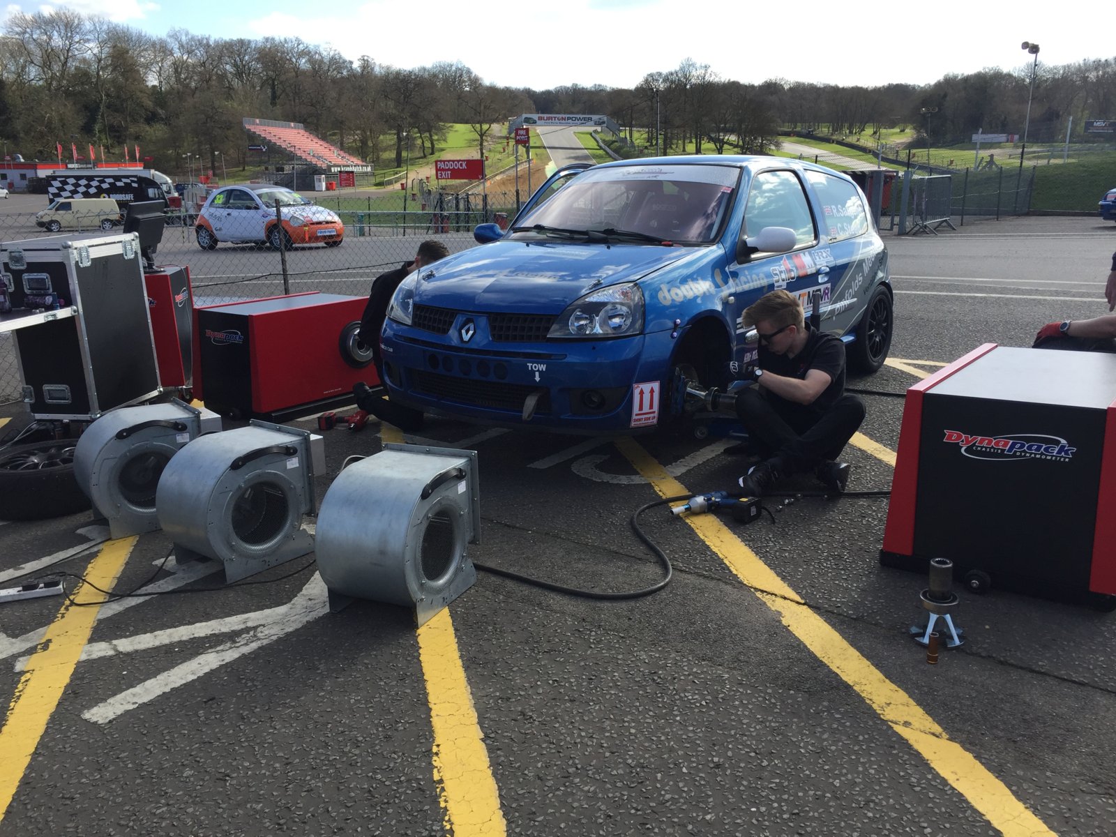

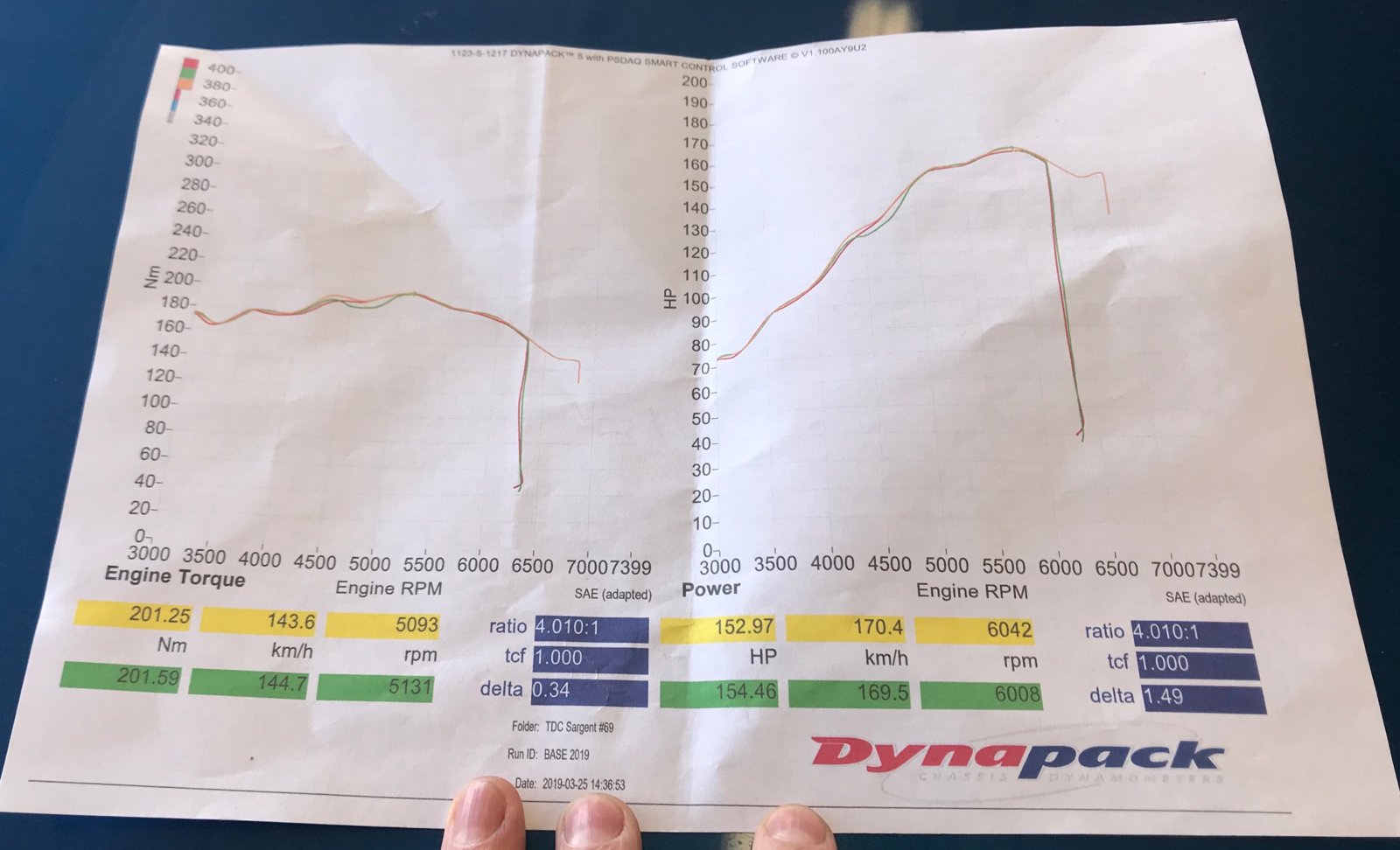

At lunch we went for our RR. Knocked out the below. Depending how you look at it, it looks great for an unknown millage engine with an ST ST exhaust and a 'Fatty' induction kit. Personally I think its to much as the other 'team' car made 12 bhp less and is as fast as ours in a straight line.
Onto the afternoon and we softened the suspension a little. I hate to compare but C5EAD rides the kerbs better. A little softer allowed us to use them. We're within a second of the sister car (only in the dry) but I know I can go faster in C5EAD which is frustrating. There's a couple of cheap bits we can do involving camber. I'm also looking forward to some new tyres when these are used up.
Personally I hate having no power steering. The other team car now has the electronic rack. We'll see how the first race goes and then I might push for this. I'm also not a fan of no ABS as we had a couple of moment. In the rain it 1000 times worse but I don't think there's an easy fix for this so we'll just crack on.
All in all the cars working and we're picking up speed. Lots of little jobs to finish but no fundamental ones. If its dry in 12 days time it'll be alright.

This has GAZ GHA, C5EAD has GAZ gold. Both run 600 springs at the front but this has 600 at the rear and C5EAD has 400s
We have a spare new set of 400 rear springs so might try that at some point.

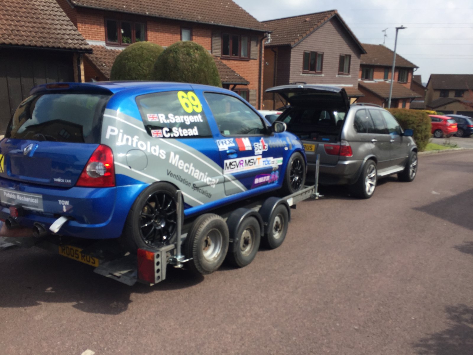

The night before the night before...............
So here it goes, race day is less than 48 hours away! Are we ready? Sort of...

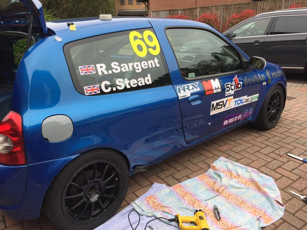

I picked up the car yesterday and have spent today trying to get it ready. As you can see above the right hand side of the car isn't looking to good at the moment. First up was fit the door card to the new door. What didn't help is we have a door from a 172 cup so the multiplug connector is different so I had to change the wiring loom. Once done there was still an issue with the central locking so I changed the locking mechanism.
Then time for a wash ready for the stickers. I managed to fit the 'series' stickers with no issues but when I went to fit the grey band down the side things went down hill quickly. Its harder than it looks! As a result graphic man will be down first thing in the morning to finish it off.
That's right, we're team 69! not my choice:LOL:
Another issue is the black side skirt clips are currently 90 miles away. So when Russ gets here tomorrow we'll fit the new side skirt.
I also re fitted then fog light, tried to get the indicators working and mounted the GoPro (this is mandatory)
So are we ready? Debatable.
Are we having fun? We will but there's lots of anxiety ATM.
What are we aiming for? 37 cars entered and i'll be happy to finish............37! I just want to finish the race. I'm second driver so we need at least 20 mins out of it so I get a go!
