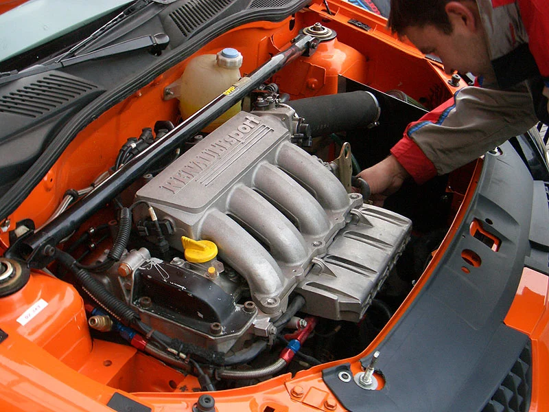

Why do the cup cars have one?
cup racers run slicks which generate incredible amounts of lateral G's, a road cars high nylon content tyres will slide into a bush before then even get close.
if you had a strut brace on the front, and you had a side ding..
would the strut brace bend or would it transfer some of the force to the other side of the car? like twisting the whole front end?
On the cup racer the front strut it looks as if its not bolted through the strut mount, more of secured by the strut tops.
If this is the case why does all the struts (that ive seen) require you to drill the strut mounts?

That comment was aimed at a rear brace, but i stand by the fact that very few (if any) would notice a front one on a std road car.
As std the clio has a very good stiff shell and being so new its doubtful its gone weak.
In the past ive had cars that once jacked up the doors wouldnt close, now they are a benefit on such vehicles.
The cup cars no doubt run suspension rates twice what a roadcar has and fat slicks. Even the design that you picture could be improved by triangulation and fixing onto the bulkhead.
bingo, hence i was saying a tri point front brace for the chap to make.
