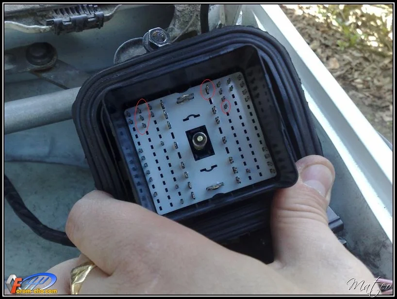

I wonder if anyone has a pic of the wiring under the skuttle panel near the washer bottle please? Apparently there is a plug back there that can get wet and cause idle issues. It feeds through to the bulkhead on passenger side.

It's called the r107 connector and has a rubber seal. I fail to see his this can cause any idle issues as once the car is running the interior electrics have little effect other than turning the a/c on and off.
this is the bit from the interior loom
and this is the bit from the exterior they bolt together
Thank you! I read somewhere a fellow had issues where the bottom pins got wet causing some kind of issue with the FBW throttle cnotrol.
