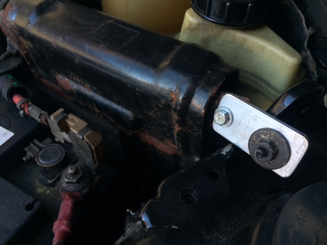

What looks like a whacking great piece of pig iron behind the battery box covering the ECU is loose on my car and I'm sure it's rattling away under the bonnet and I can hear it whilst driving. I want to remove it to see if the rattle goes away. What is the point of this thing and is there any likely hood of problems if I leave it off (must be there for a reason). Alternatively does anyone make a more refined aftermarket cover - something a bit lighter than the great big standard chunk of metal lol.

Hast the bracket snapped which bolts it to the car?
If it has its a common problem.
I had this issue but just made a simple aluminium bracket with 2 holes drilled in it and bolted it on.
