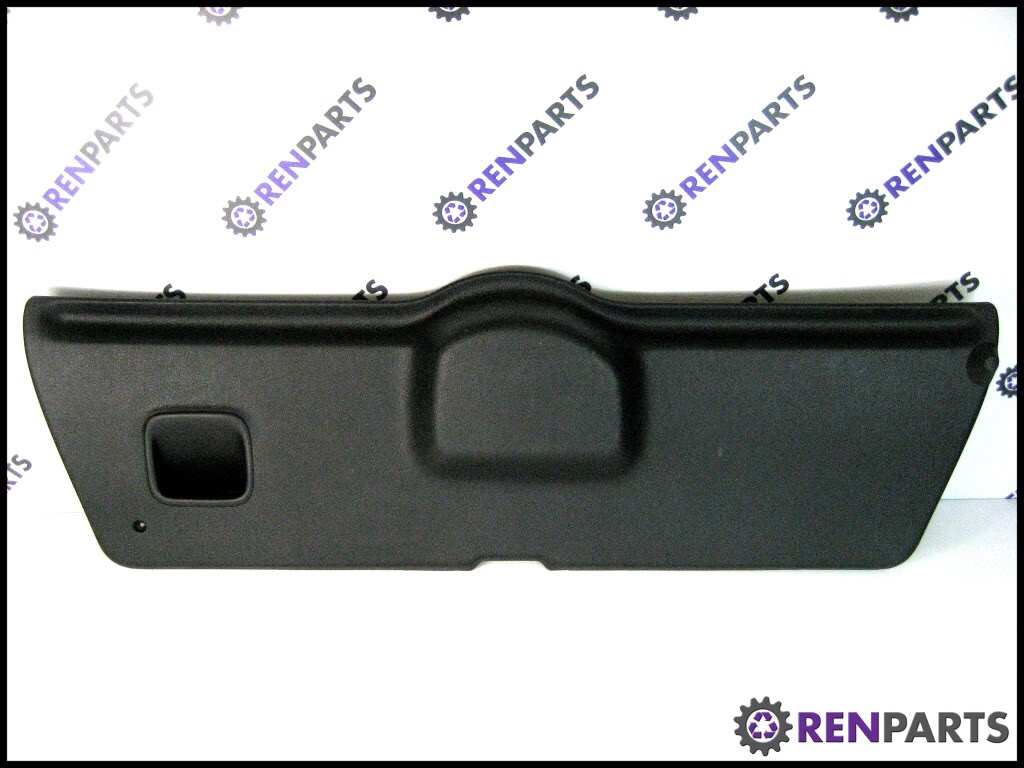

That's the only picture I can find similar to what you are looking at, so your bolt will either be where that hole is on the picture or inside the handle
The rest are just clips like below, (same as what you see in the long trim on the inside of the doors above the door cards)
Hope this all helps :)

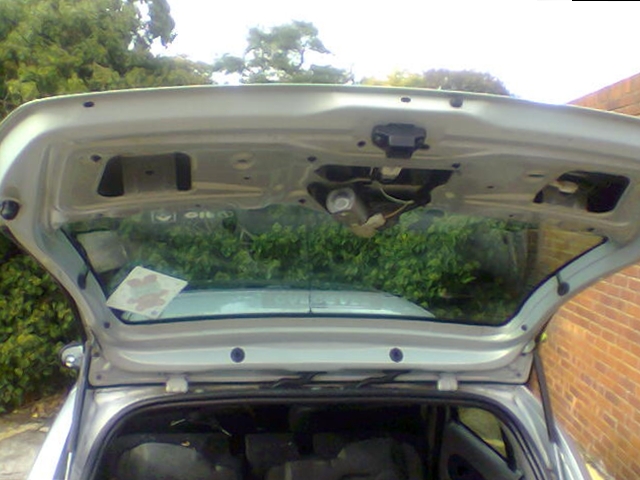

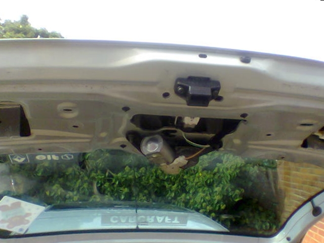

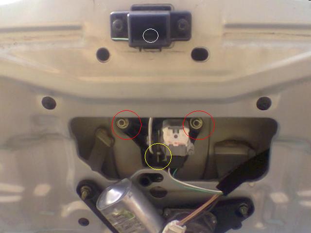

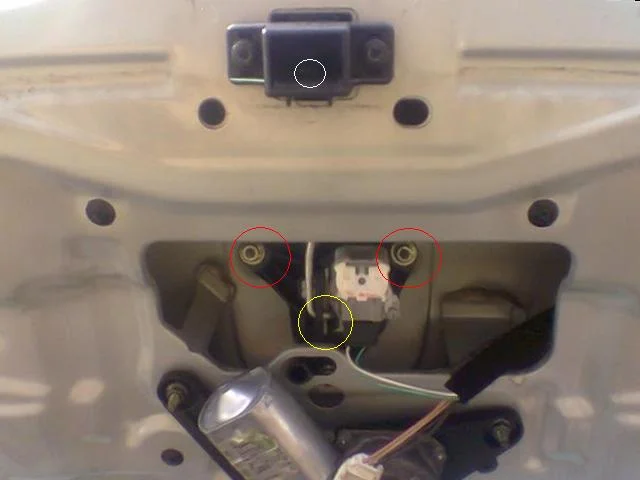

Fixed the boot lock today.. Dropped the rear seats & removed parcel shelf.. Managed the release the boot from inside by pushing up against the black plastic tab (circled in white).. Removed the trim panel & stripped down the boot lock mechanism from outside, working upside down with the boot fully raised. The cause of the problem was that both 10mm brass nuts (circled in red) that hold the boot lock handle had worked loose & fallen off inside the trim panel. Would have thought Renault would use locking nuts for the handle!? So the metal rod (circled in yellow) wasn't moving when the button was pressed or cenral locking used..
Reassembled everything and boot closed but lock stuck open lol. Had do do all again & now have a perfect result with everything in sync with the central locking.
Hope the pic's might be of use to anyone with similar issues :wink:
